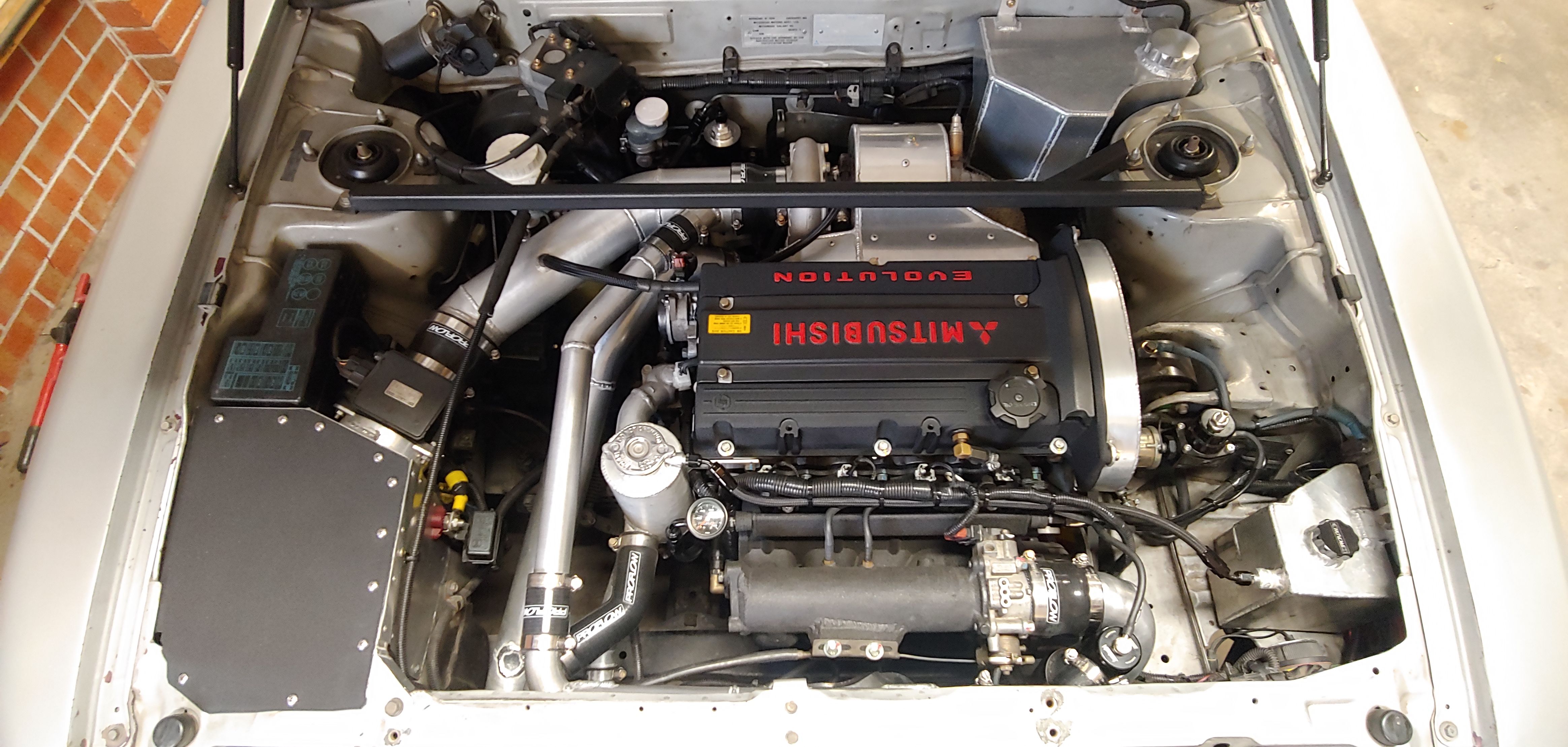

ZR4 (RIP) to VR4 Build...

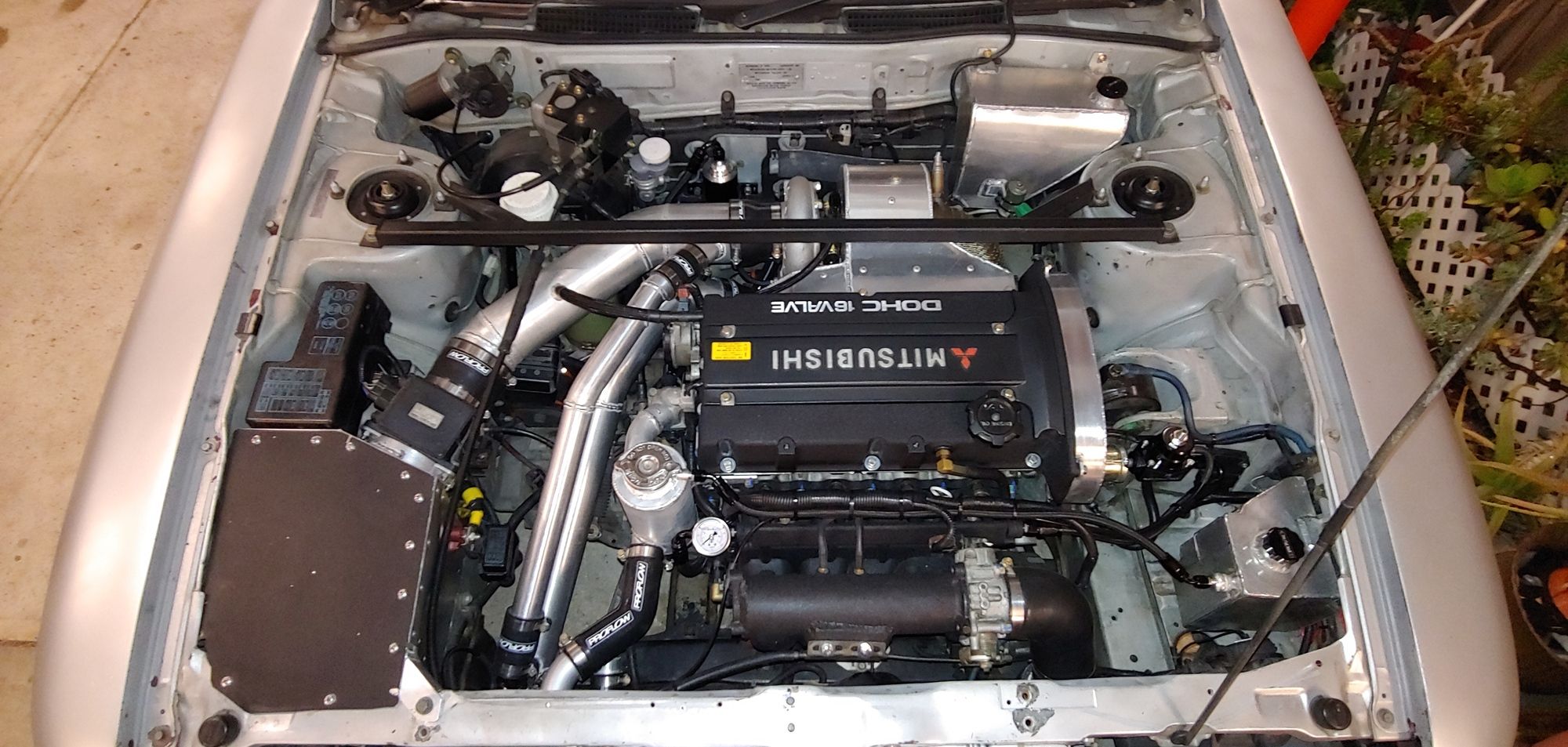

almost done...

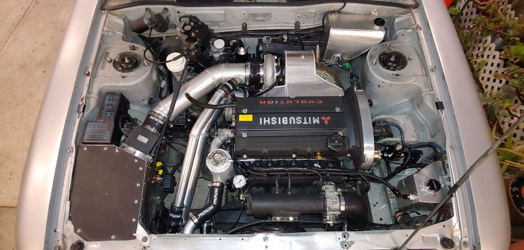

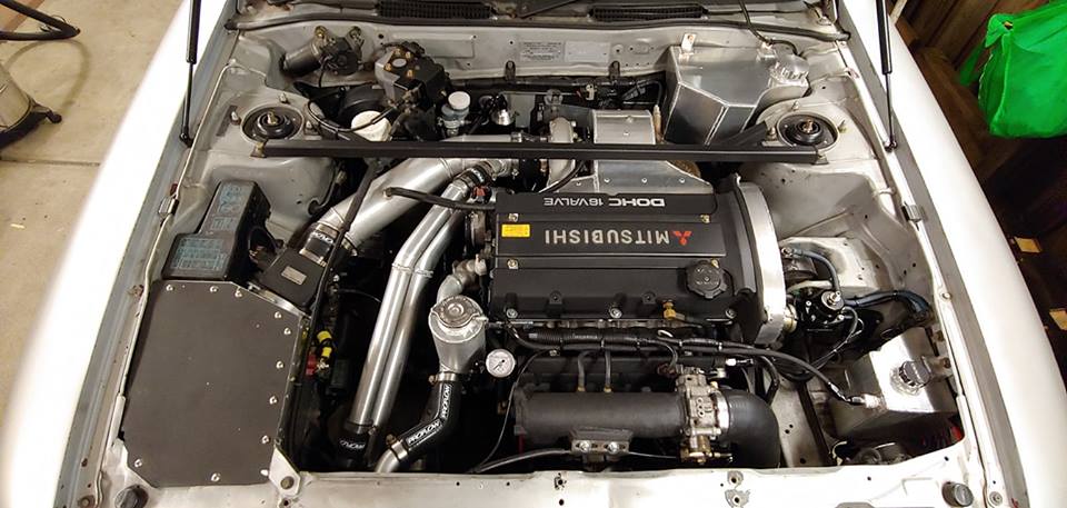

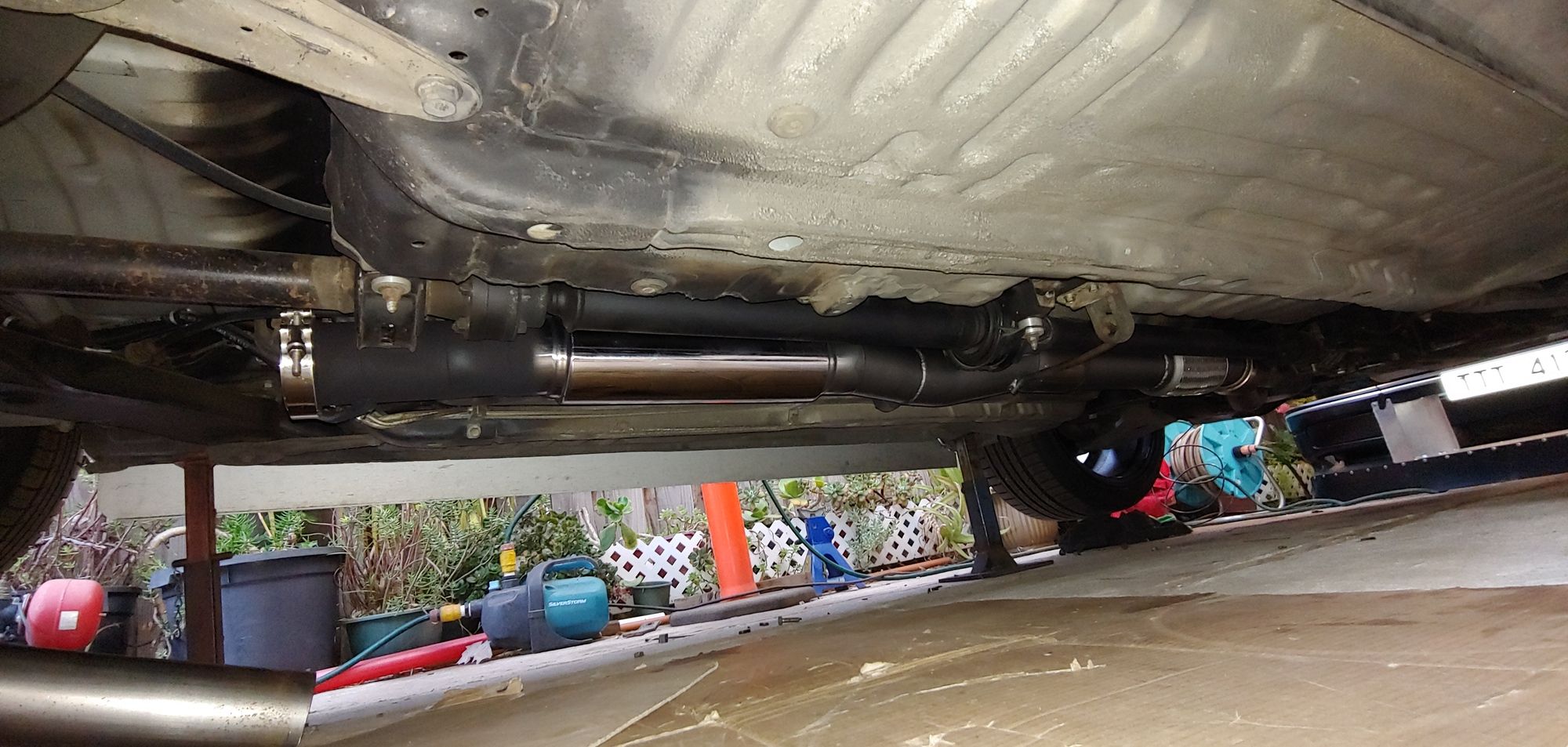

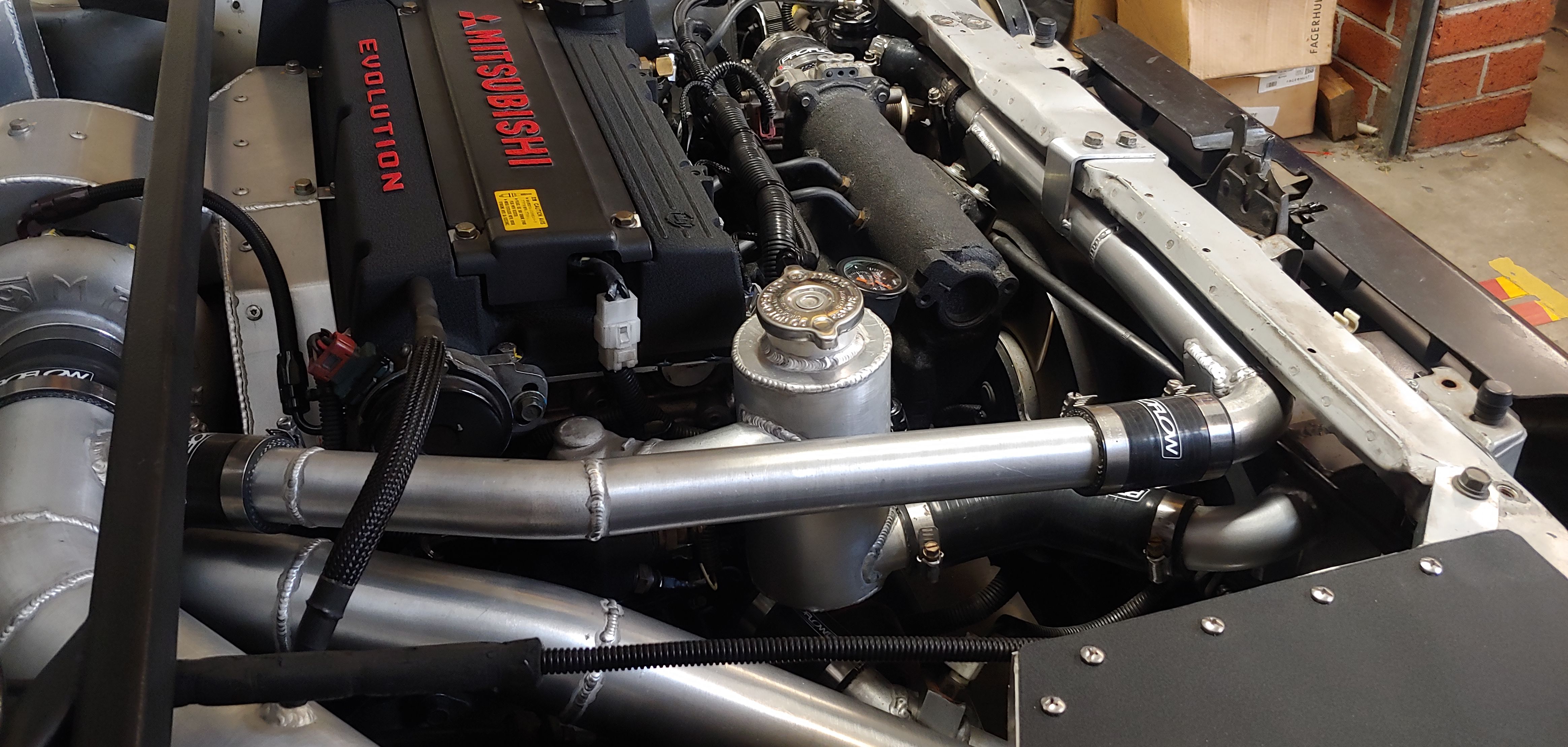

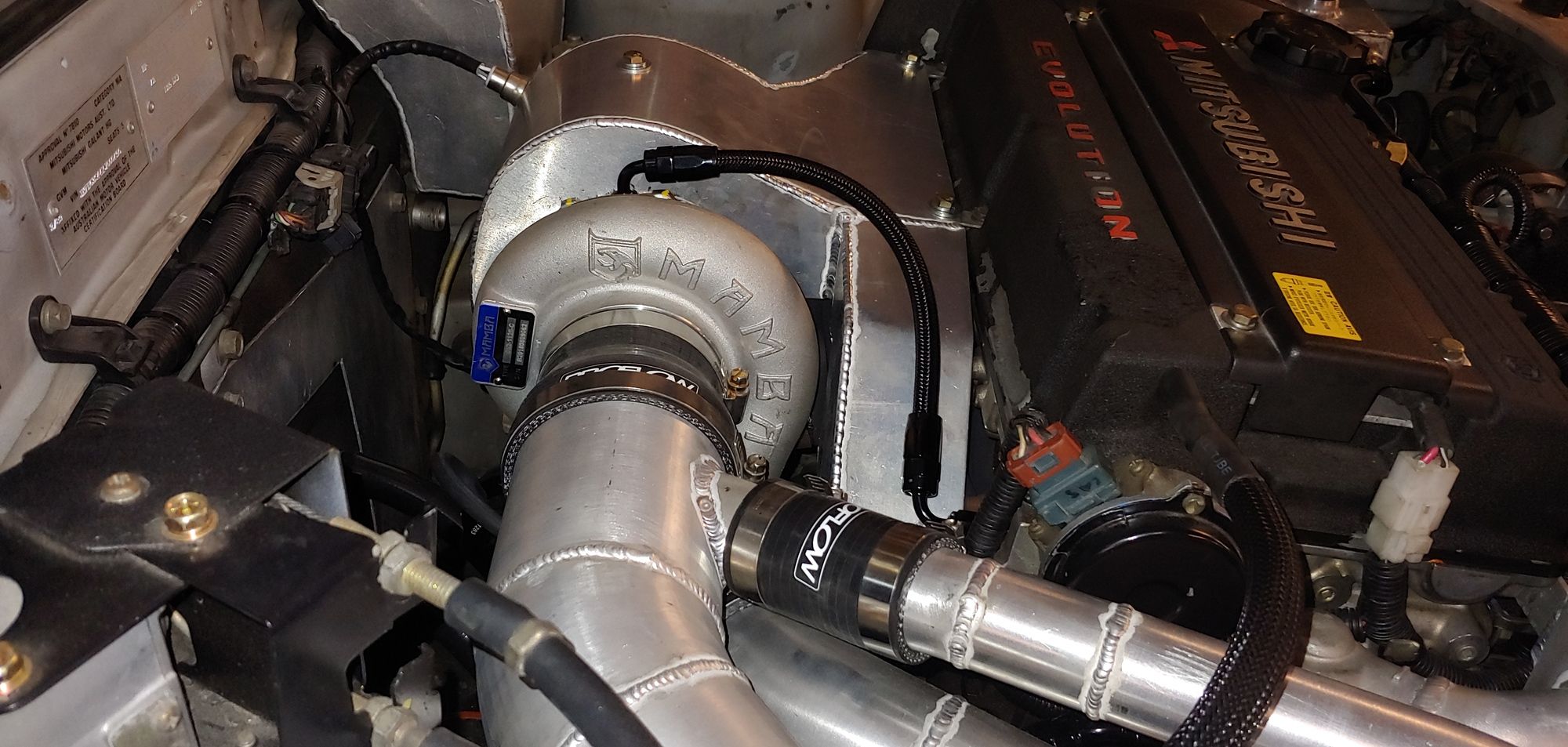

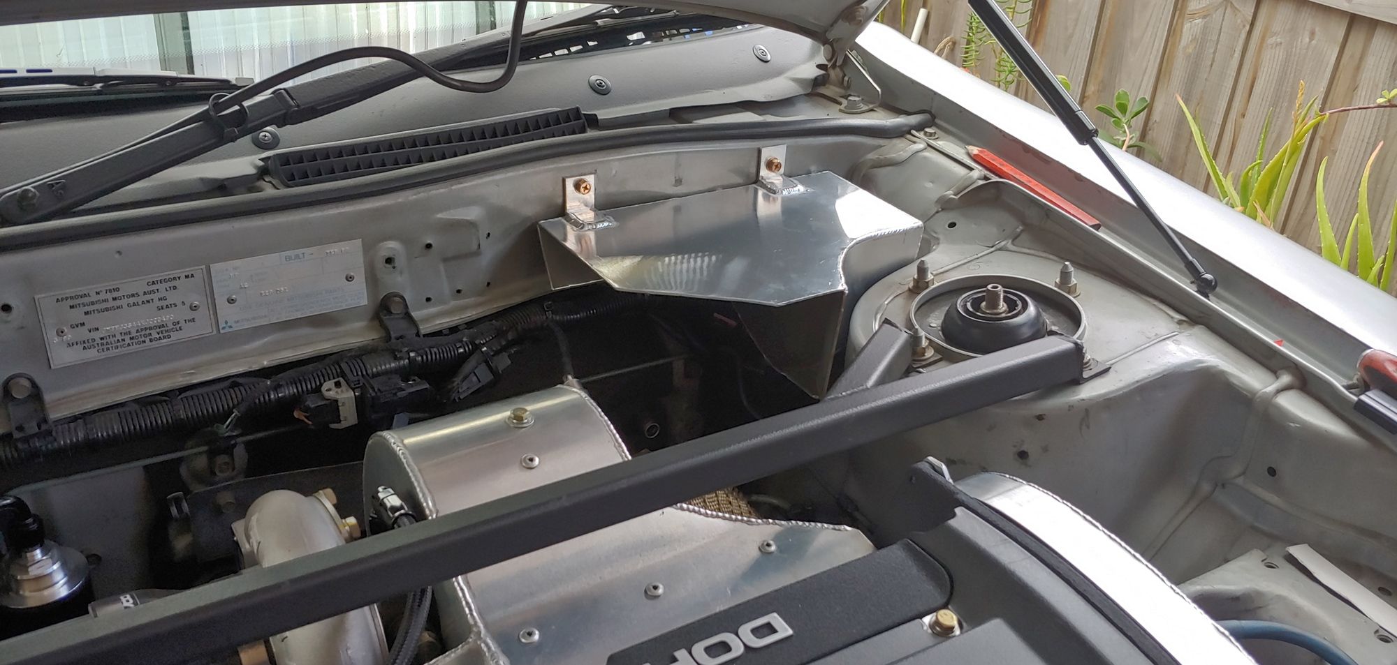

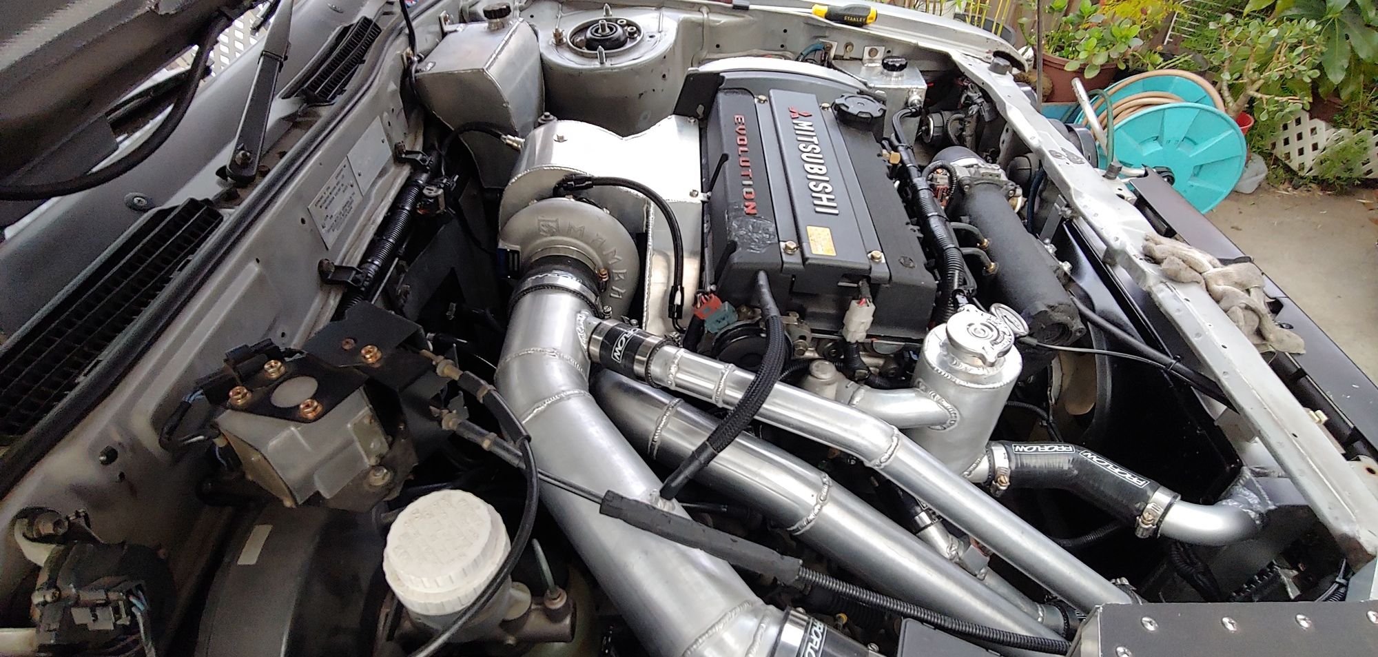

3.5" exhaust

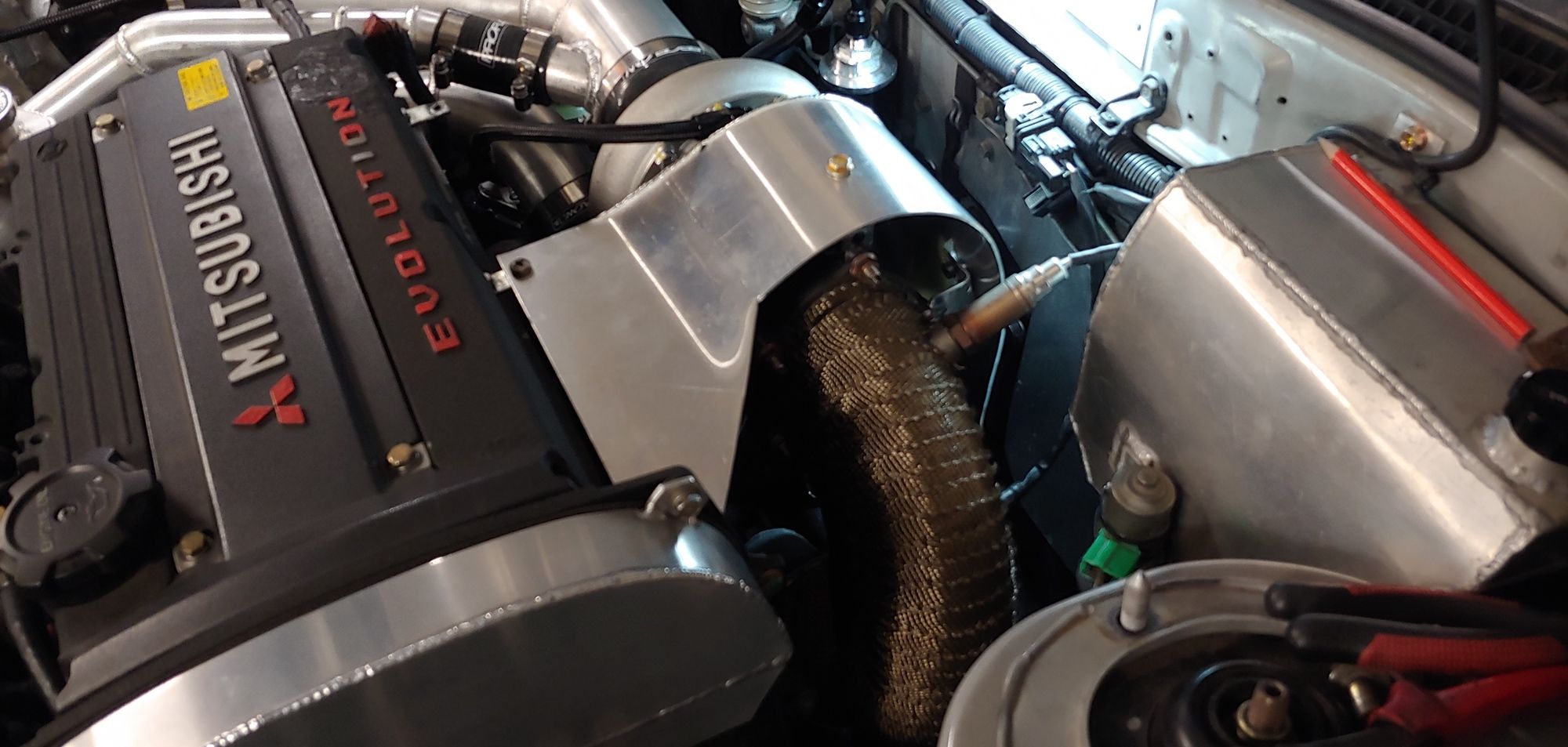

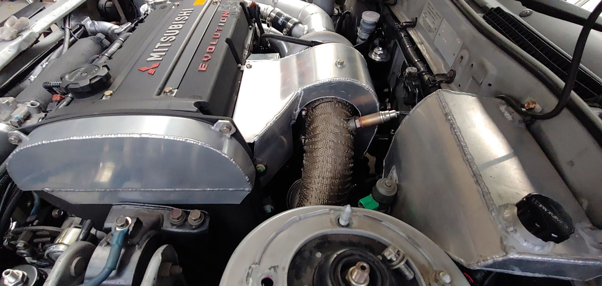

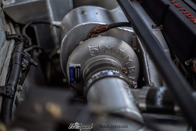

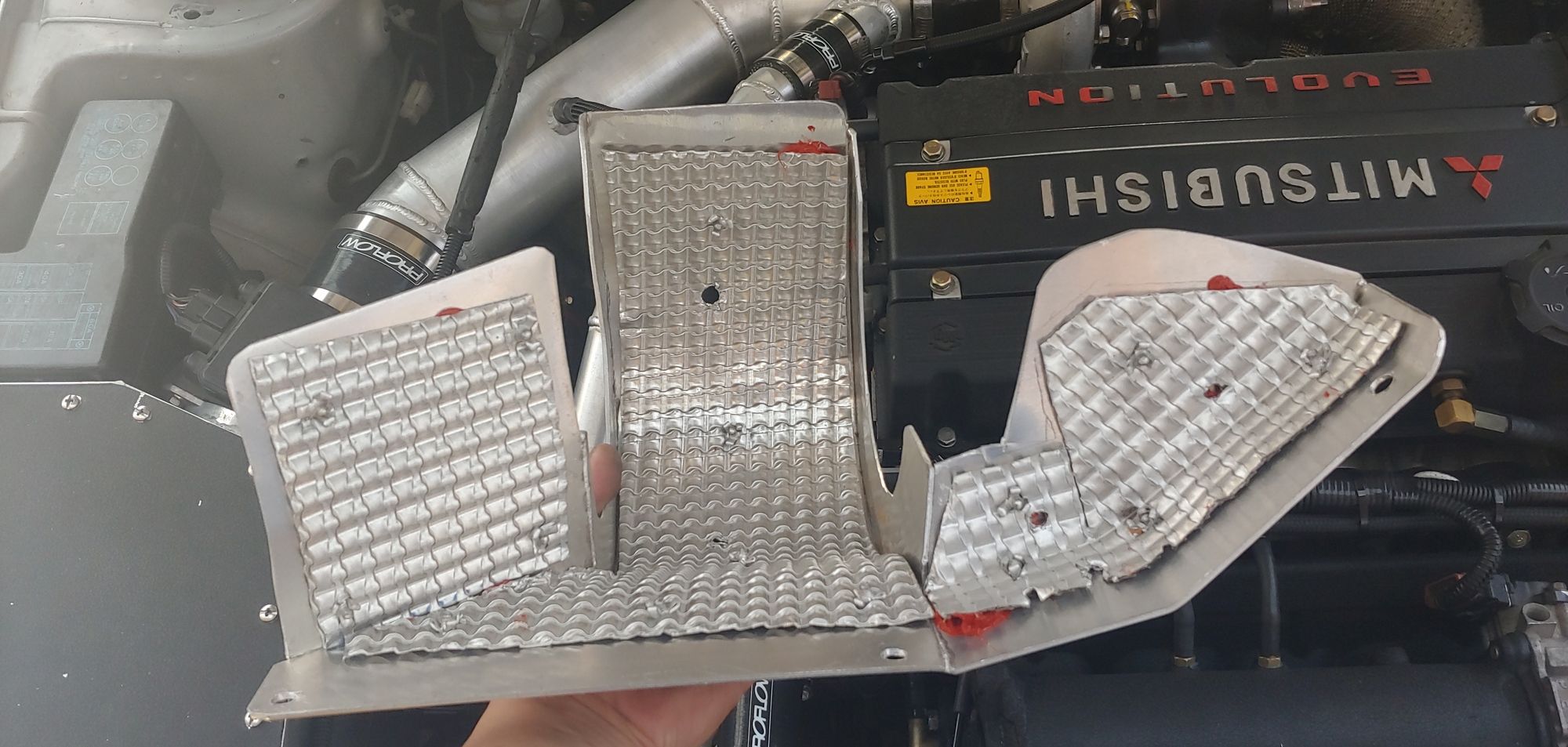

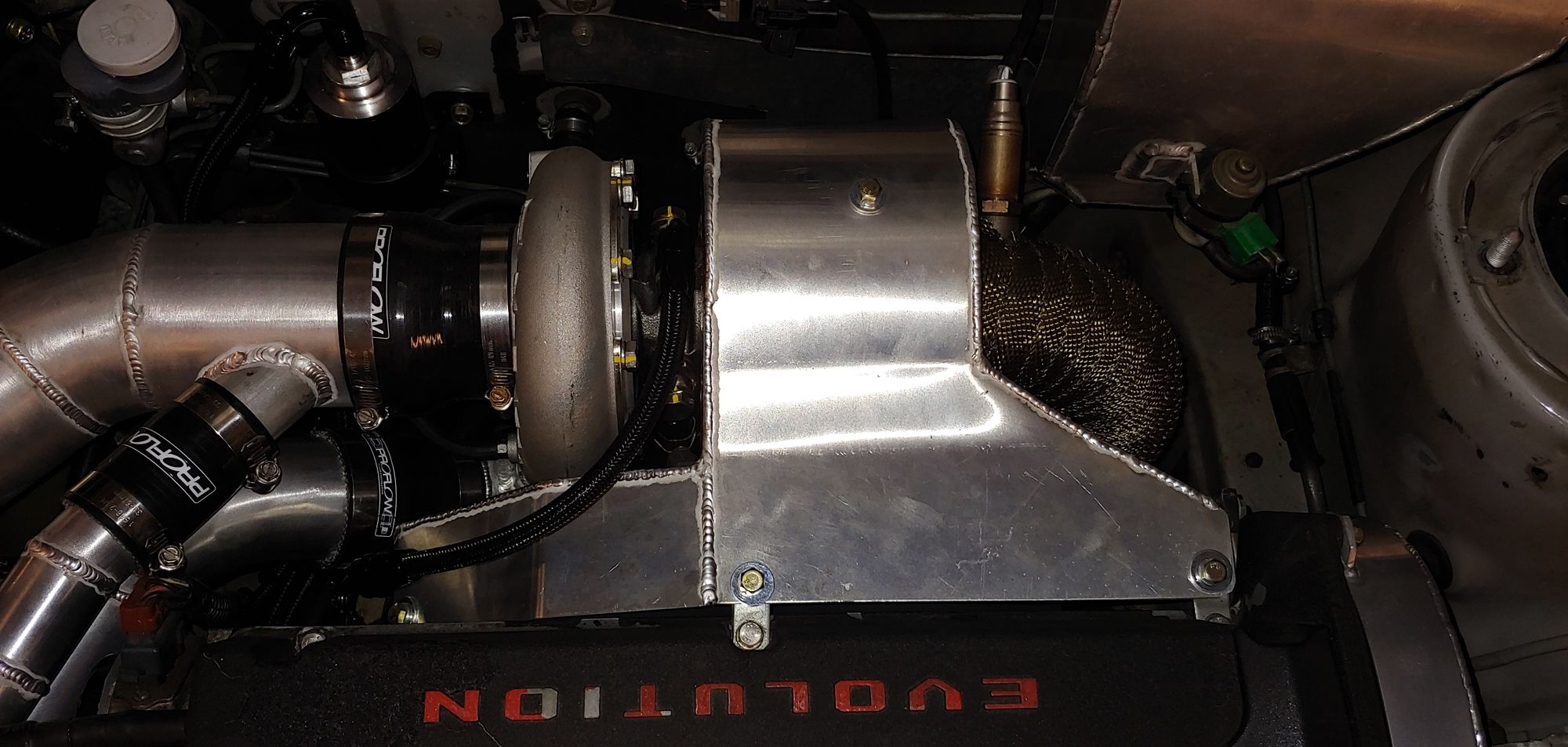

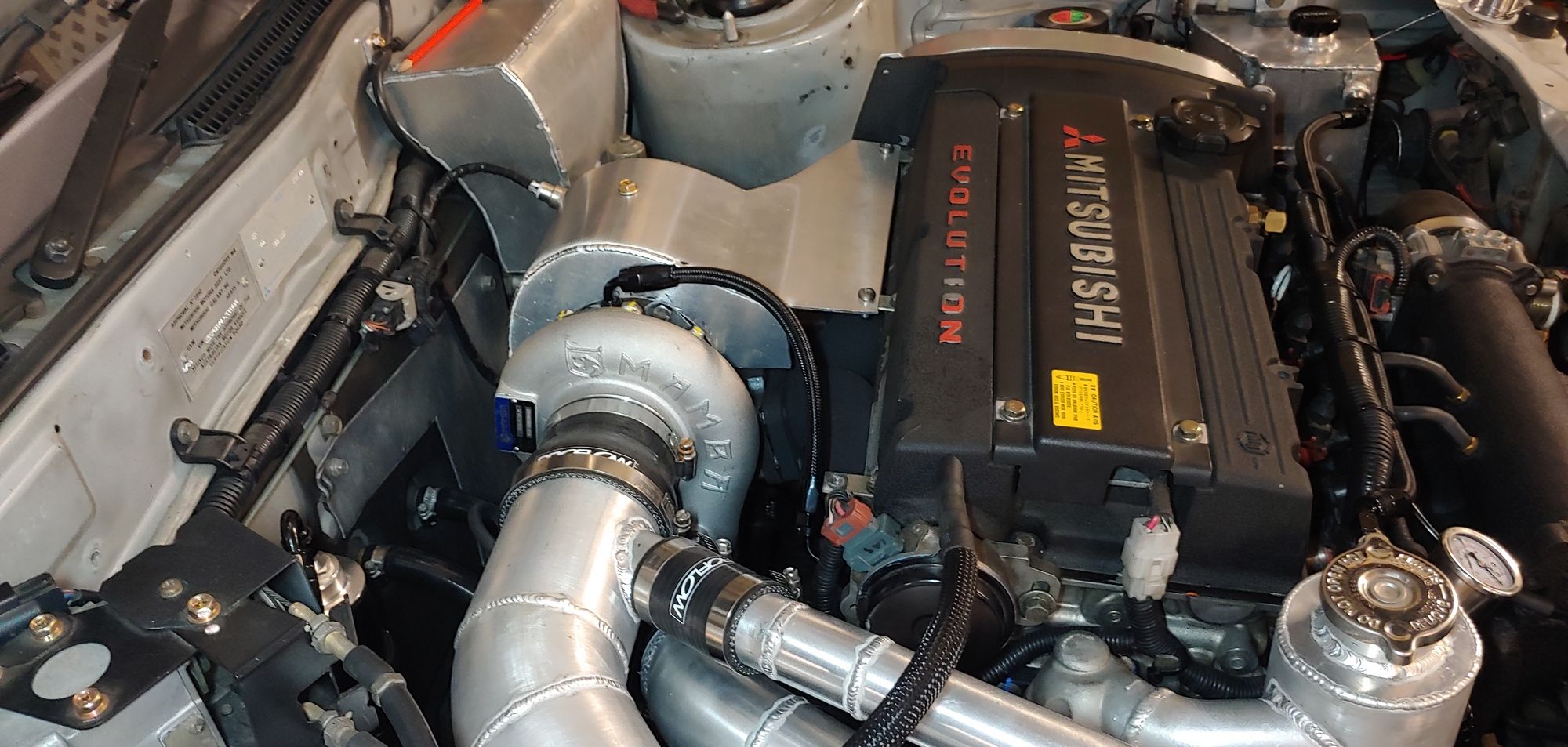

alloy turbo heat shield

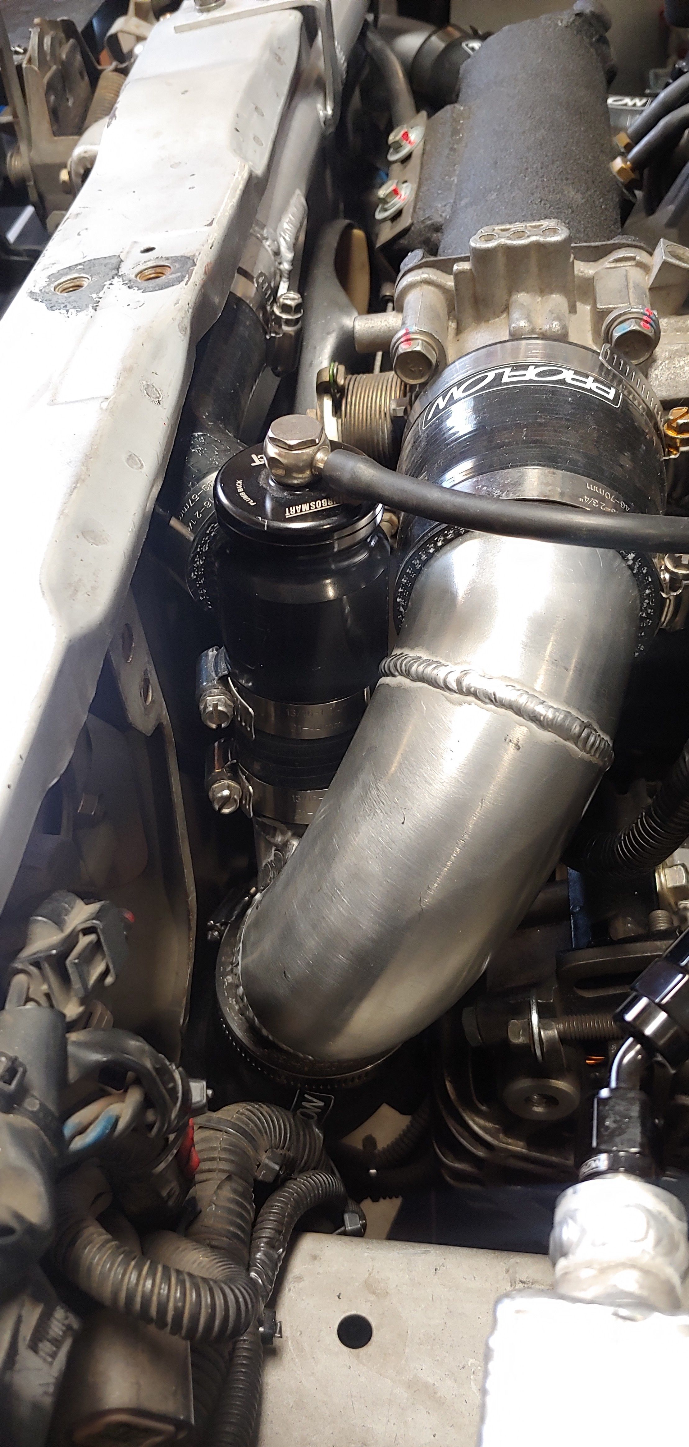

Last bits... now time for a shake down before turning up the boost

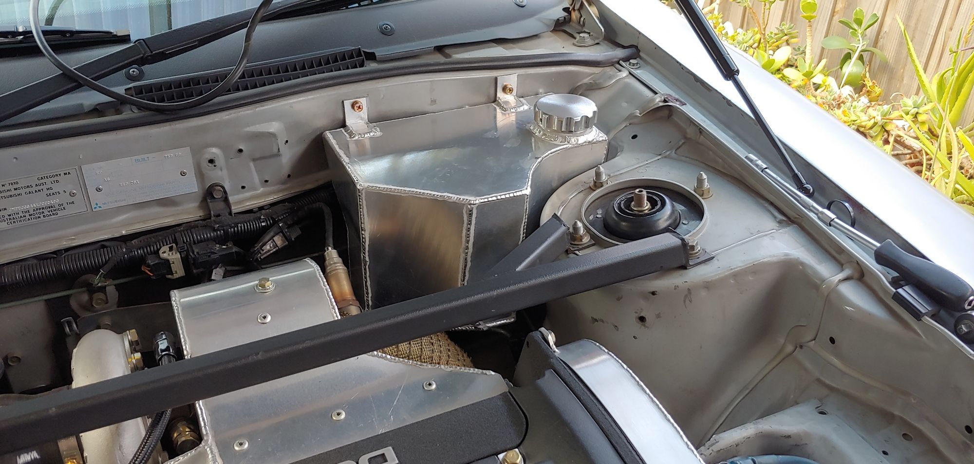

ACL heat shield matting under the turbo shield

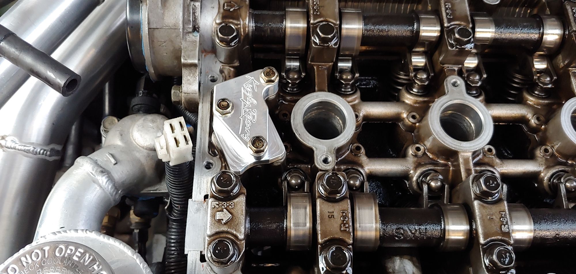

Kiggly Racing HLA, surprisingly my upper drive train got quieter
Evo 4-6 Valve cover, stronger than the e7-9 units ....

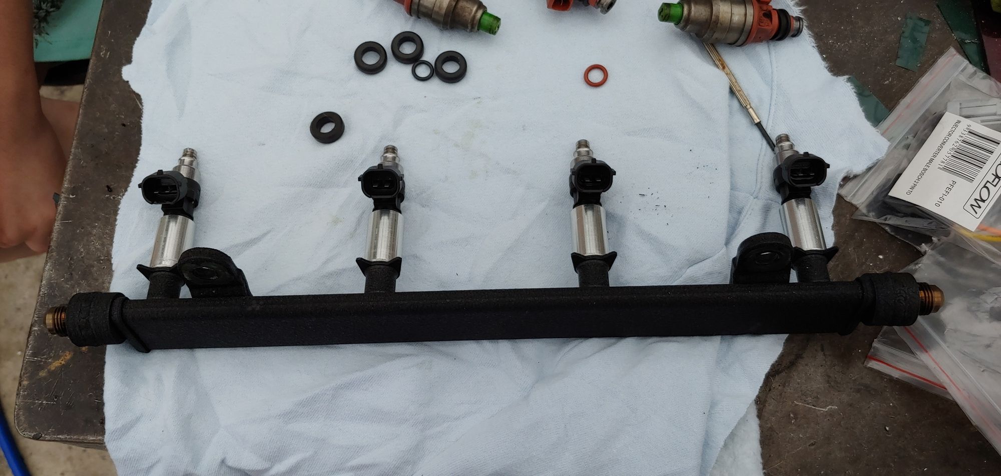

2200cc injectors idle like stock on e85

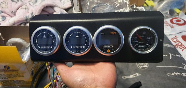

Its been a while... small update:
Old gauge setup:

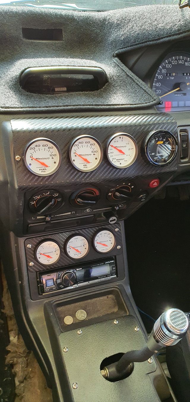

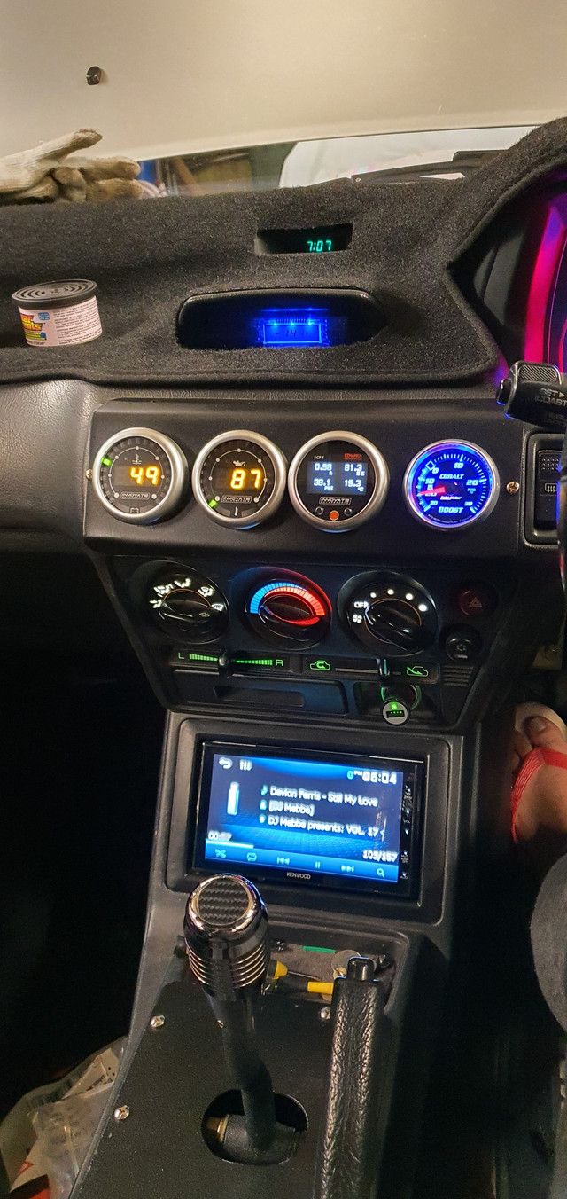

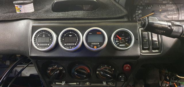

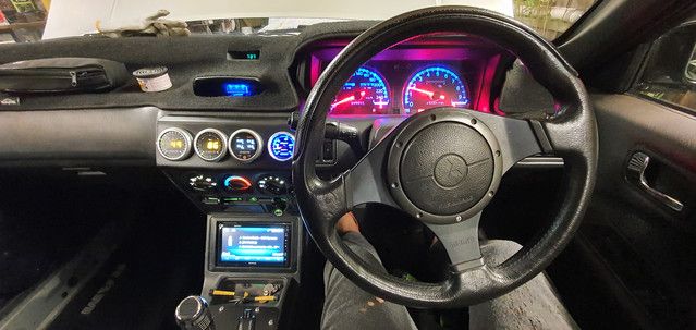

New gauges Innovate and Autometer

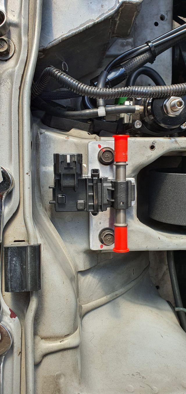

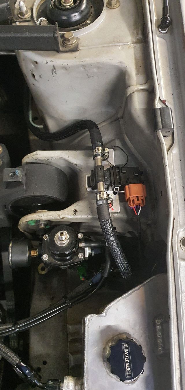

Flex fuel sensor for Gauge and future flex tuning

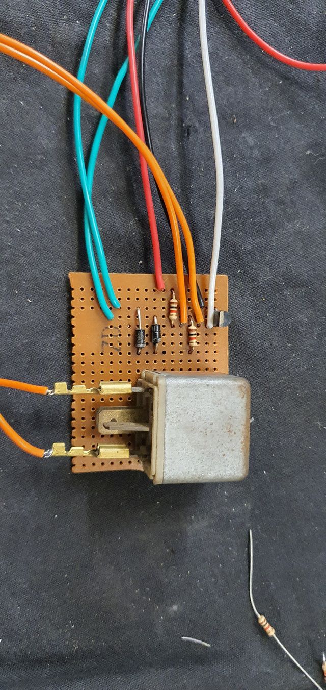

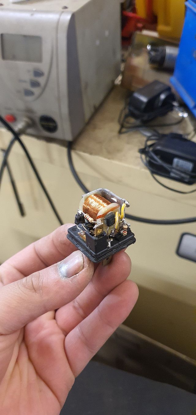

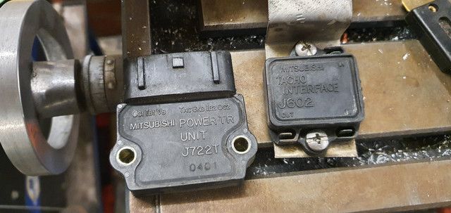

RPM gauge adaptor: Previously running stock vr4/dsm original ignition system with dummy load to get my RPM gauge to work with Evo7 ecu with COP, but now have figured out simple electronics to work without needing other parts. And it will fit in a relay case.
Stock ignition:
Test:
Final product:
