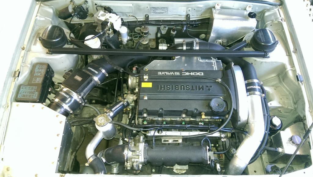

ZR4 (RIP) to VR4 Build...

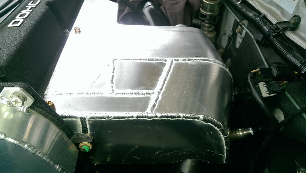

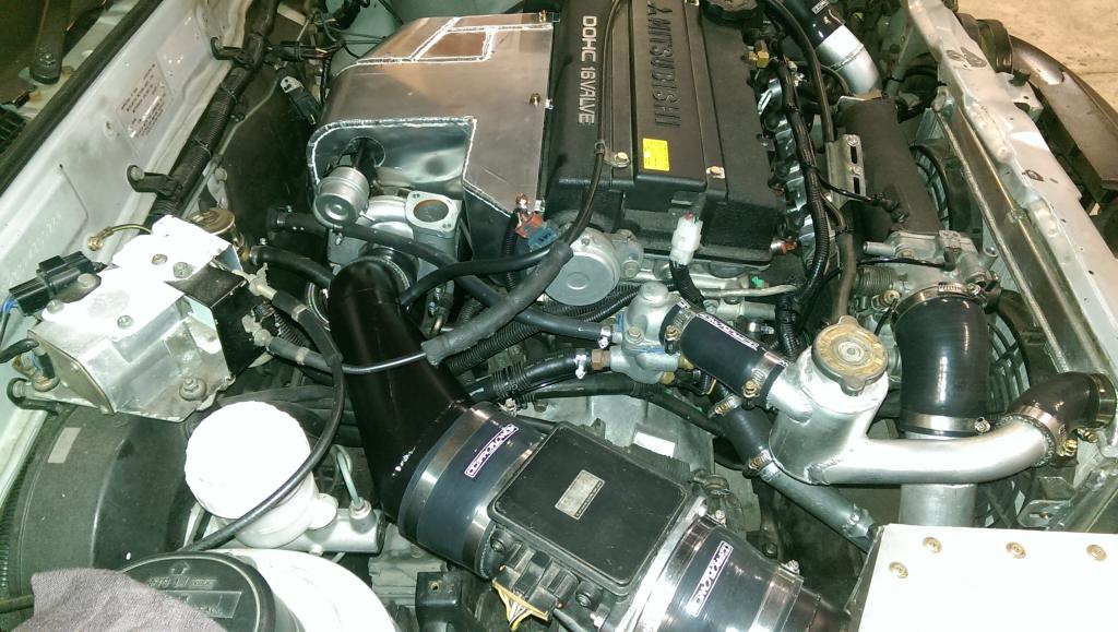

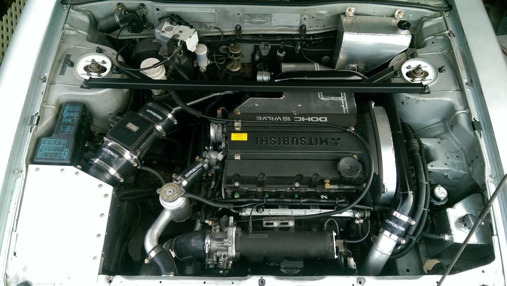

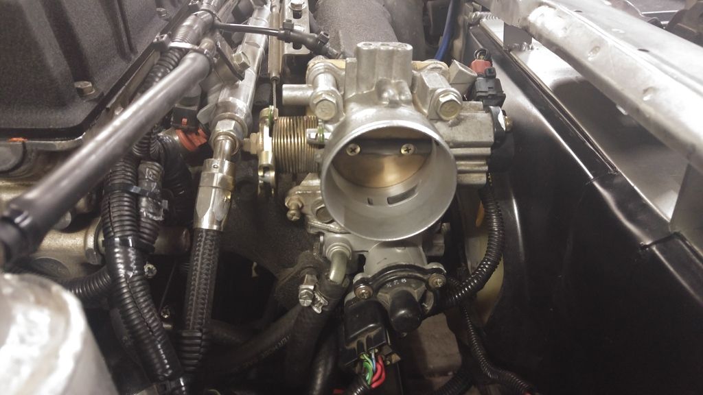

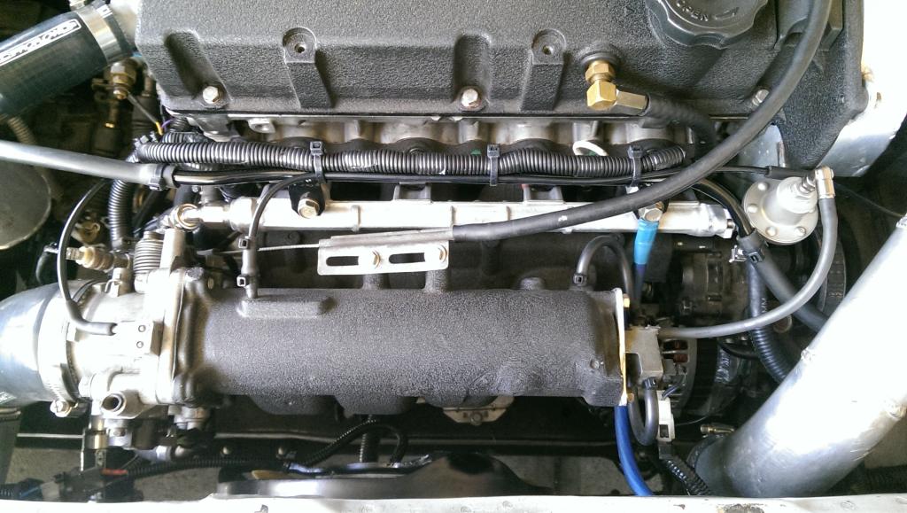

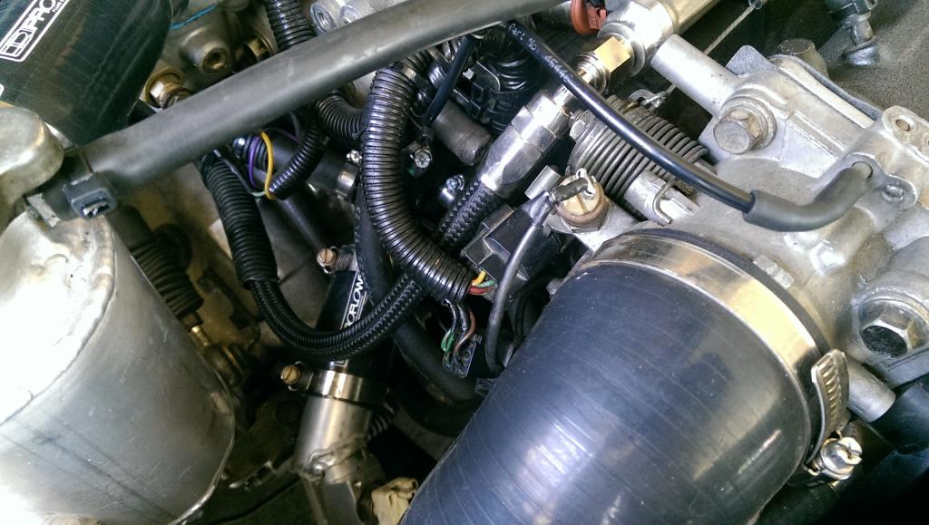

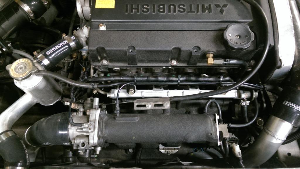

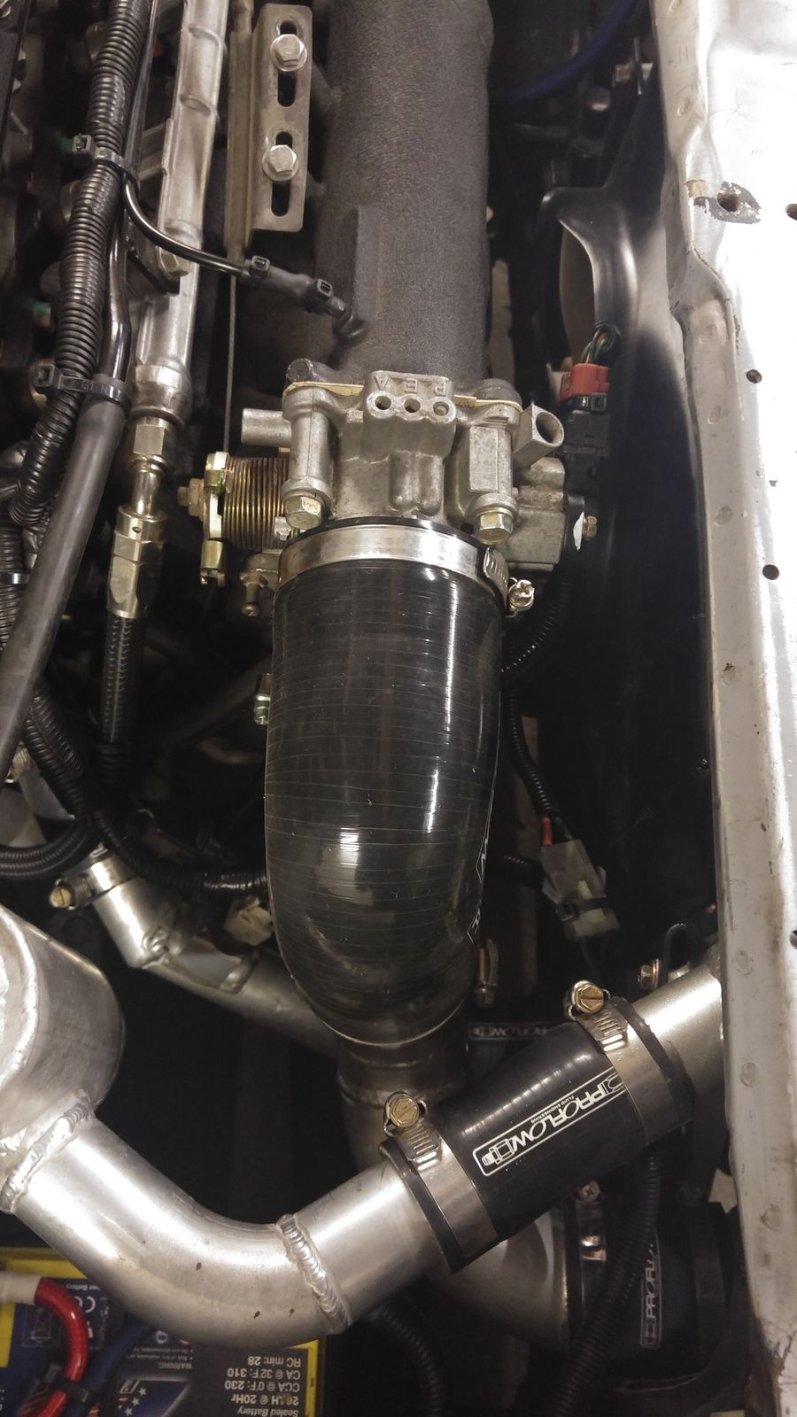

fixed up wiring and hoses on the intake mani....

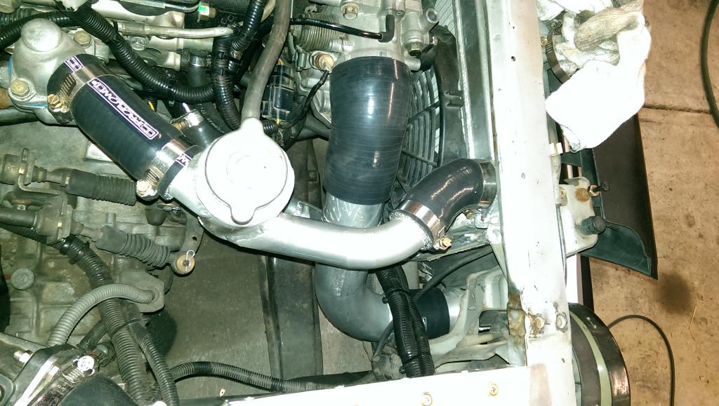

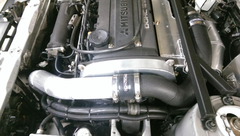

changed cold pipe route, shortest possible..

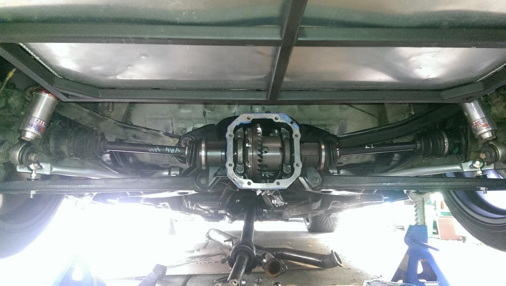

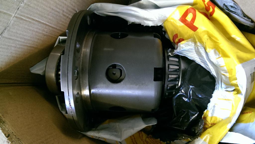

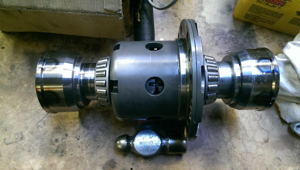

and more fun times ahead..... KAAZ 1.5 rear lsd! just have to set up the drive shafts...
Your engine bay looks amazing!
I wish I had the fabrication skills you have.
Some of the things you implemented I couldn't even dream of in my wildest dreams let alone build it and test the idea out.
Keep up the amazing work. I look forward to what you come up with next.

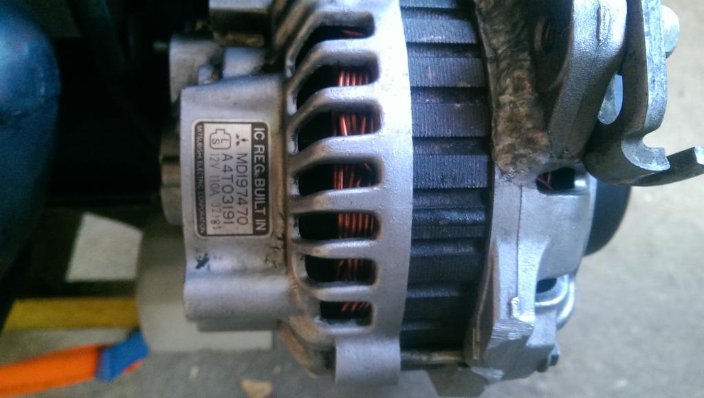

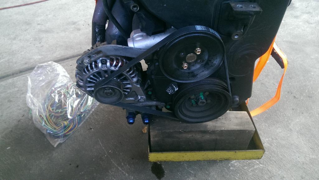

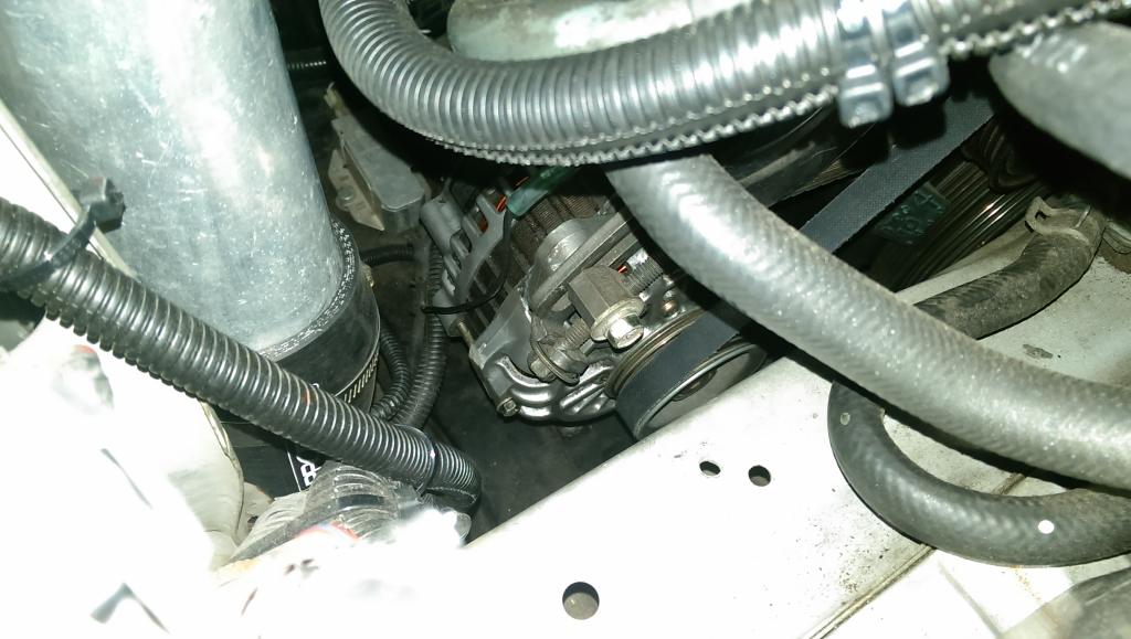

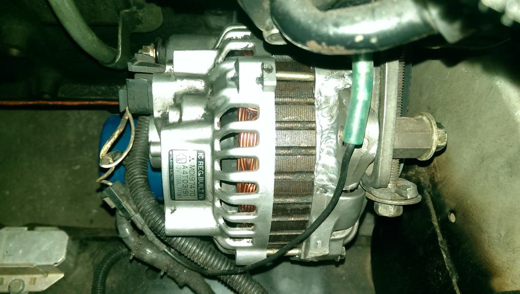

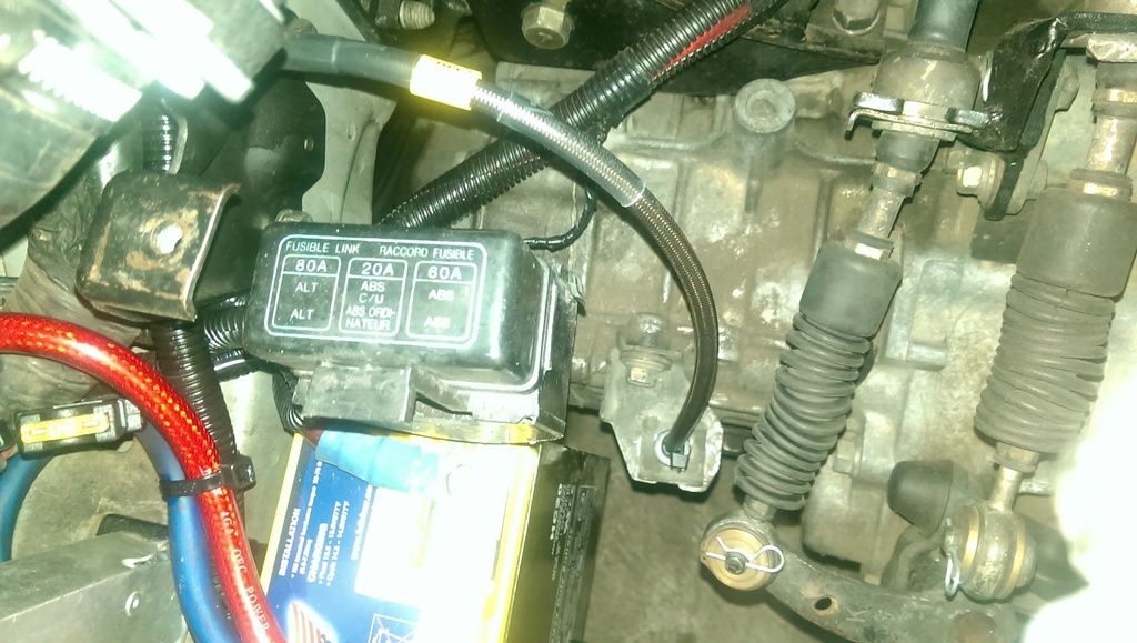

75amp alt decided to shit it self... I had a 110 amp GTO/3000GT 6G72TT Alt lying around... not a straight fit, but all the wiring is the same
Mock up
fitted
almost ready for the streets

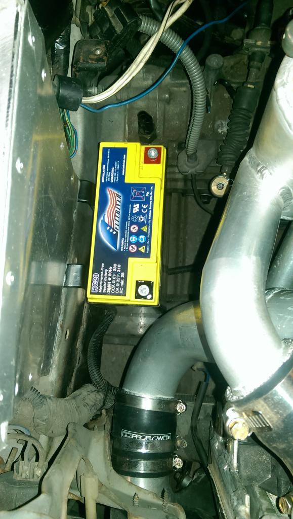

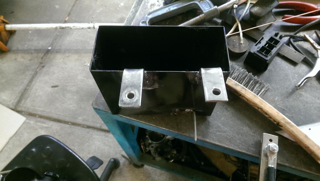

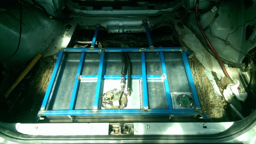

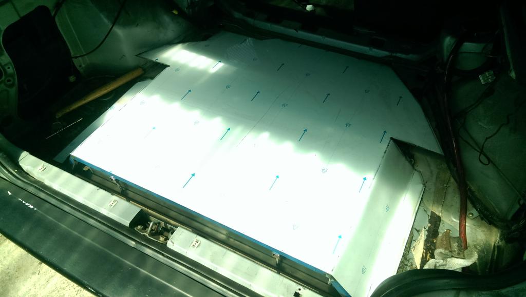

new home for the battery

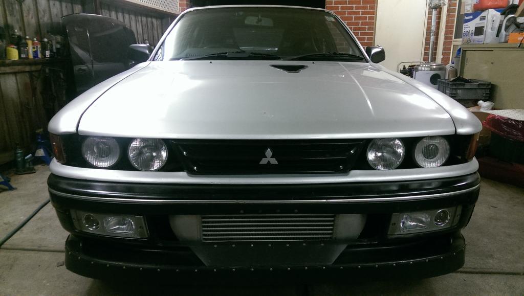

And gooooold...
Jap spec projector fog lights with caps and no CRACKS!!!!

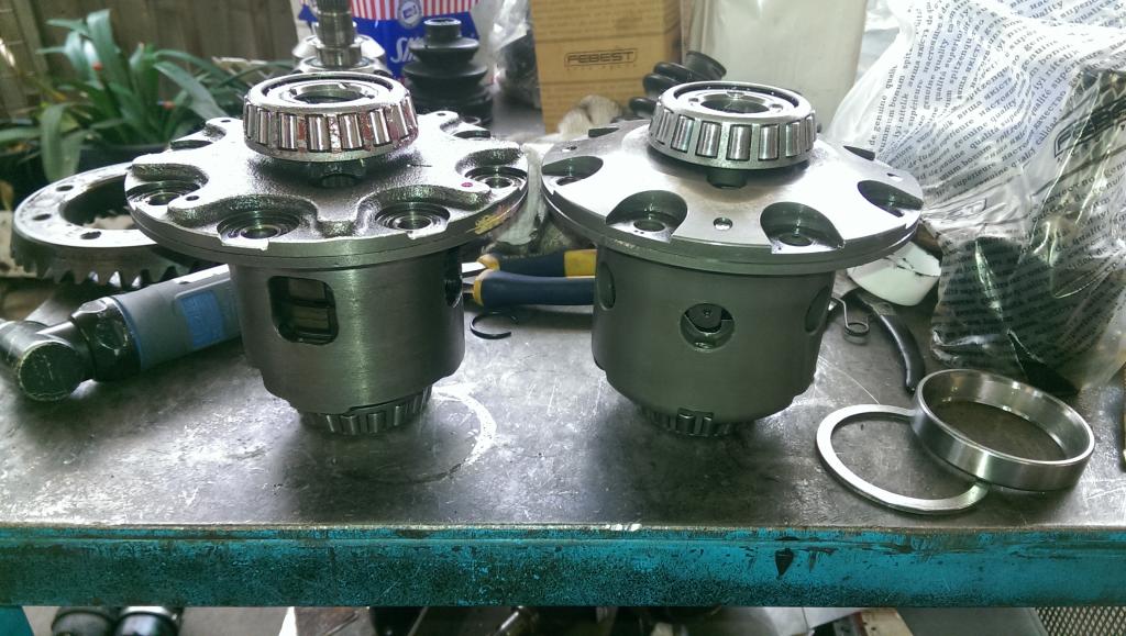

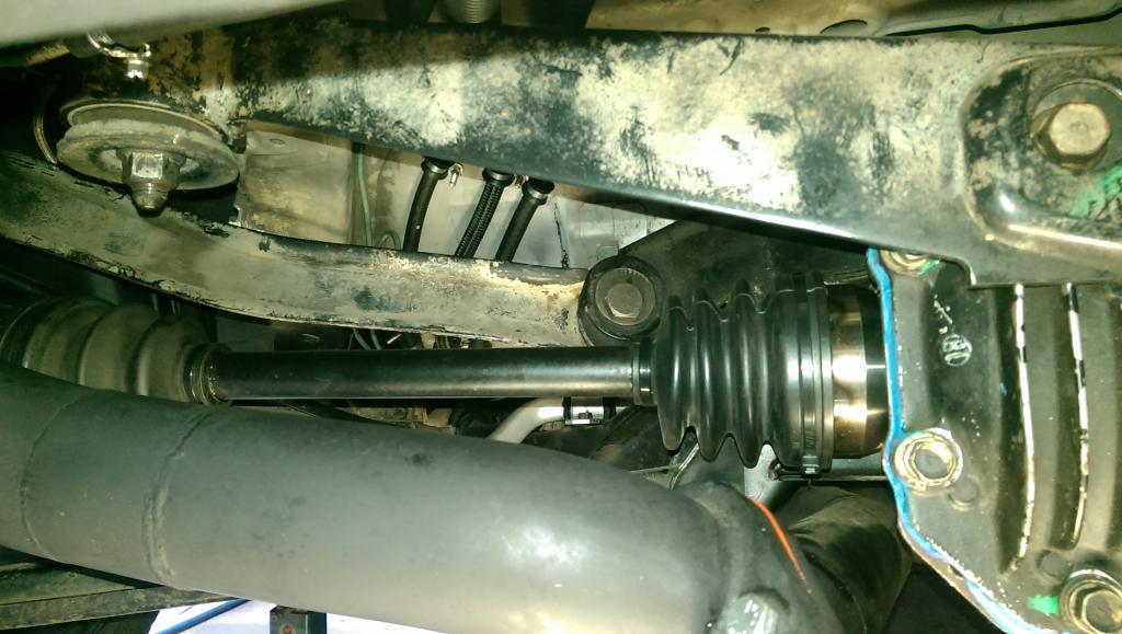

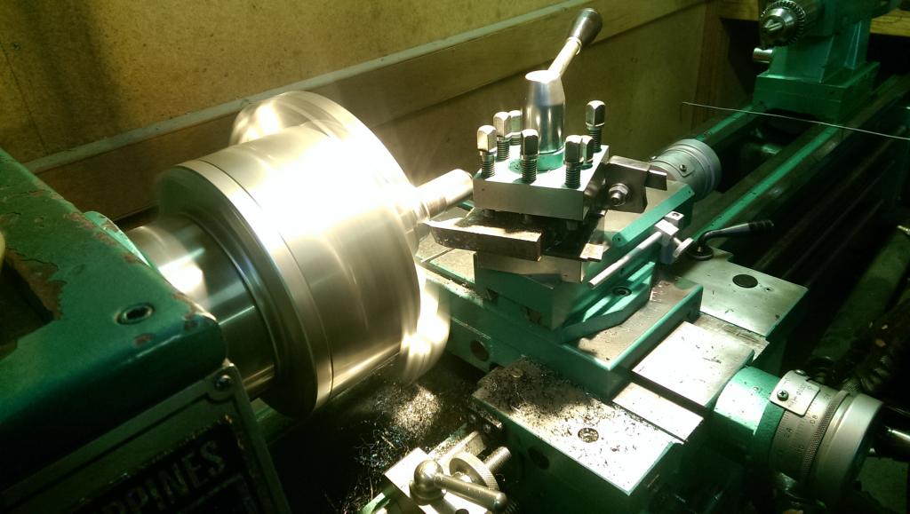

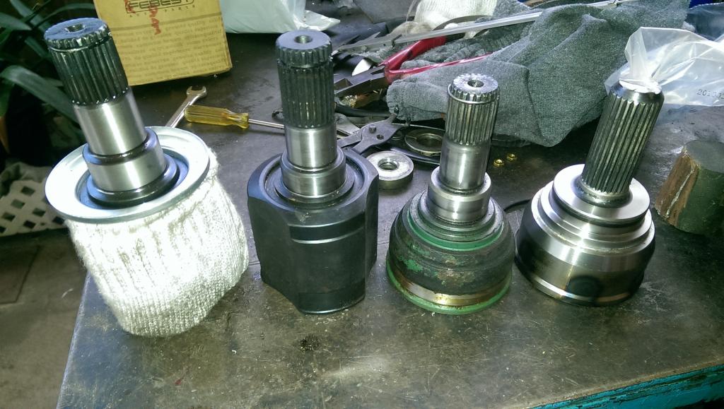

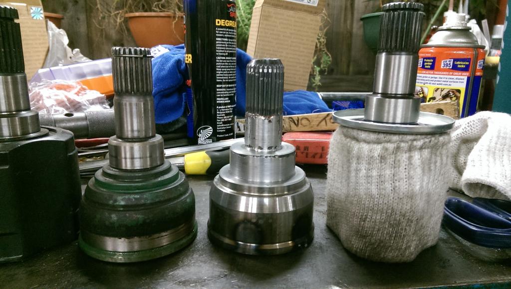

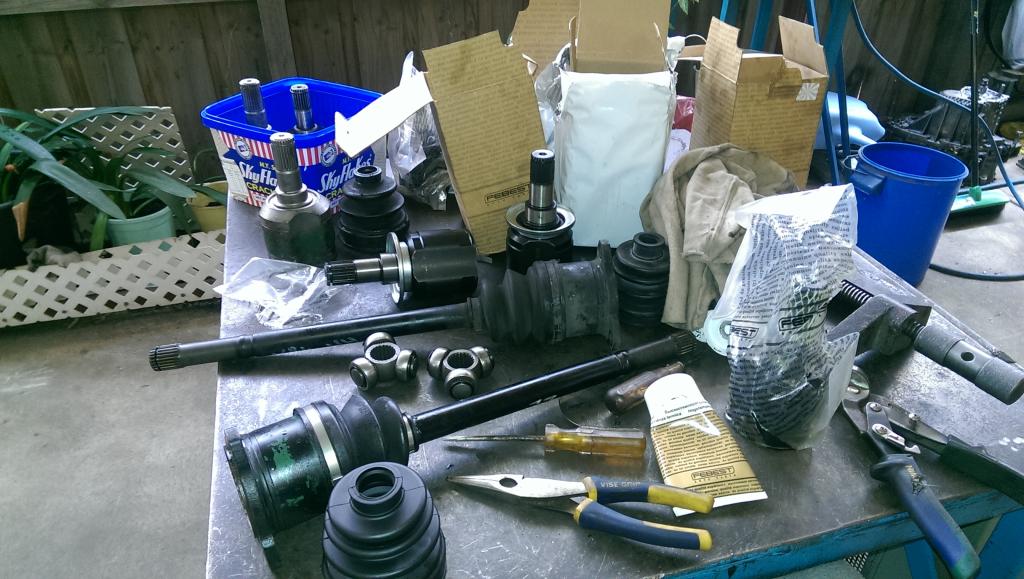

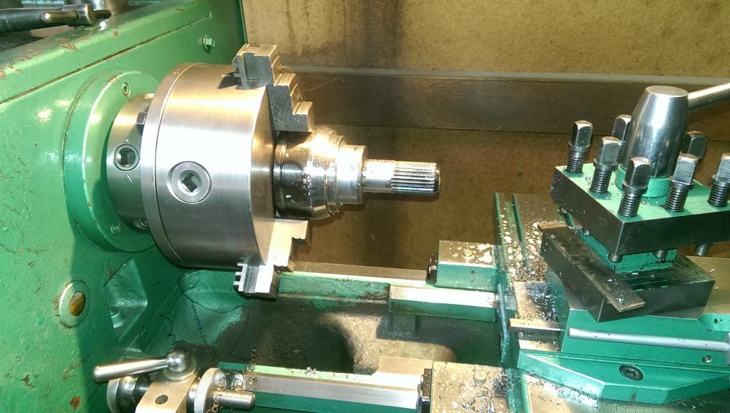

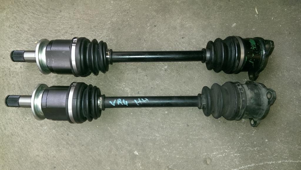

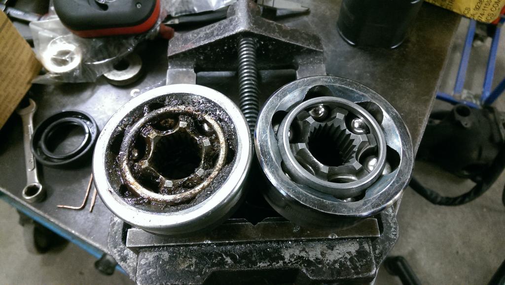

Designing rear CV cups for 3 bolt rear shafts to adapt to LSD (no longer needing to find "4 bolt parts")
on photo: LSD cup, Front inner CV cup, Rear 3 bolt inner universal CV, Customized cup
Unfinished prototype, but should be thicker and stronger then 4 bolt cups,
Installed

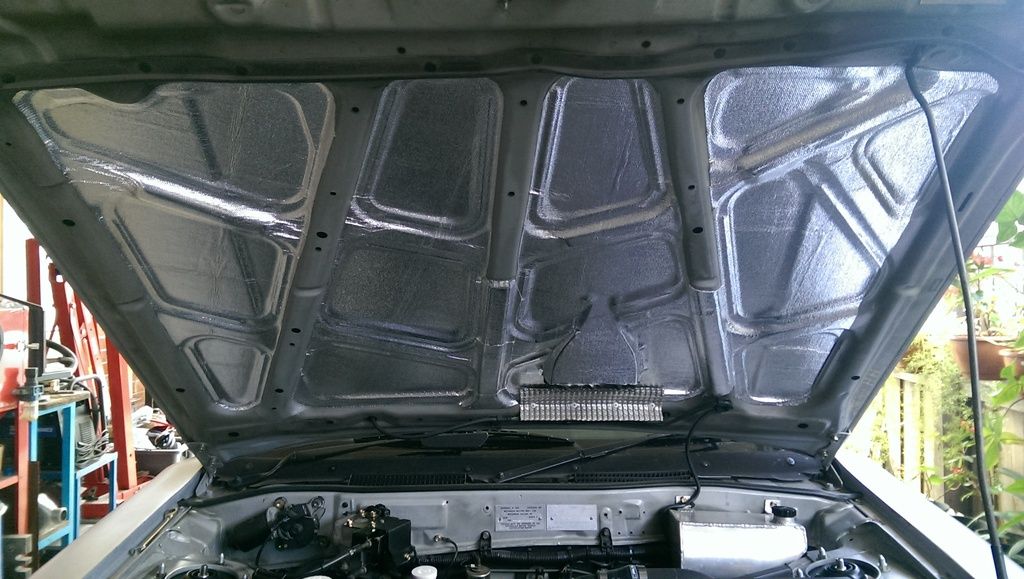

Got sick of cleaning the leather/rubber shifter boot

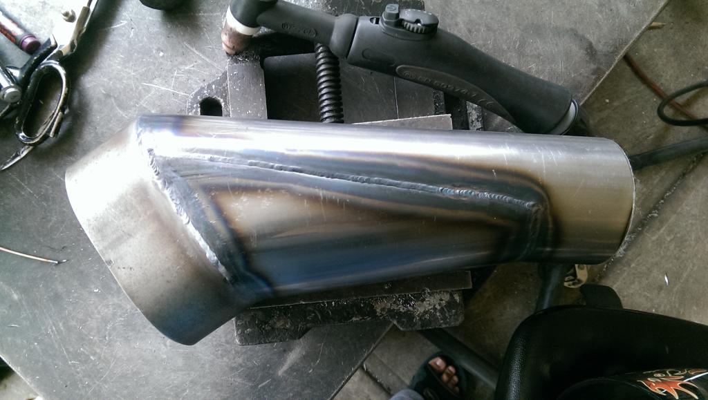

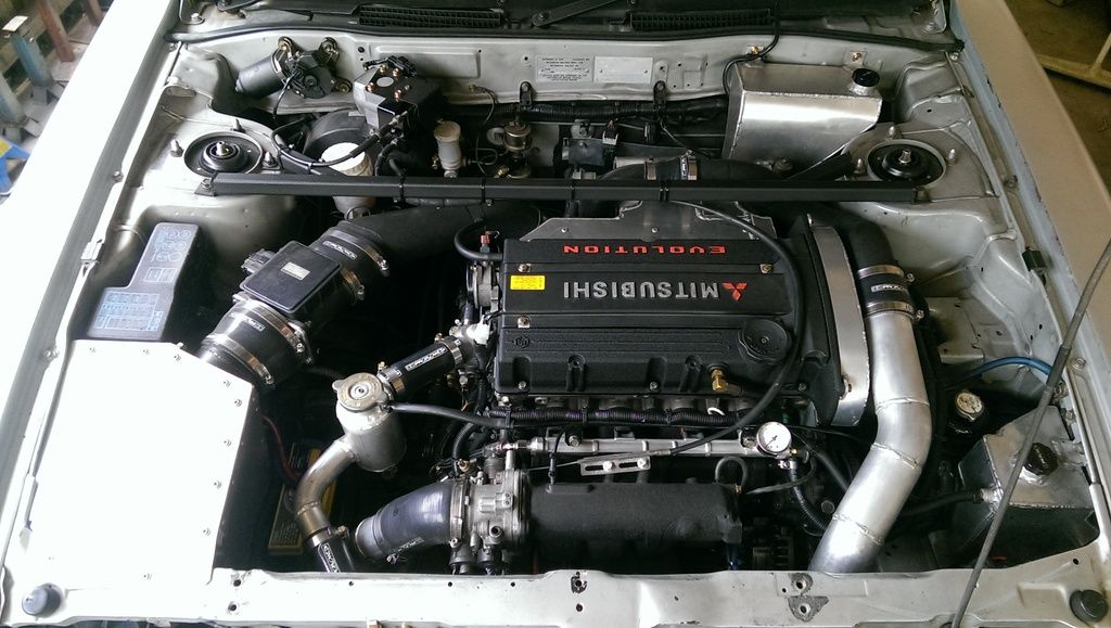

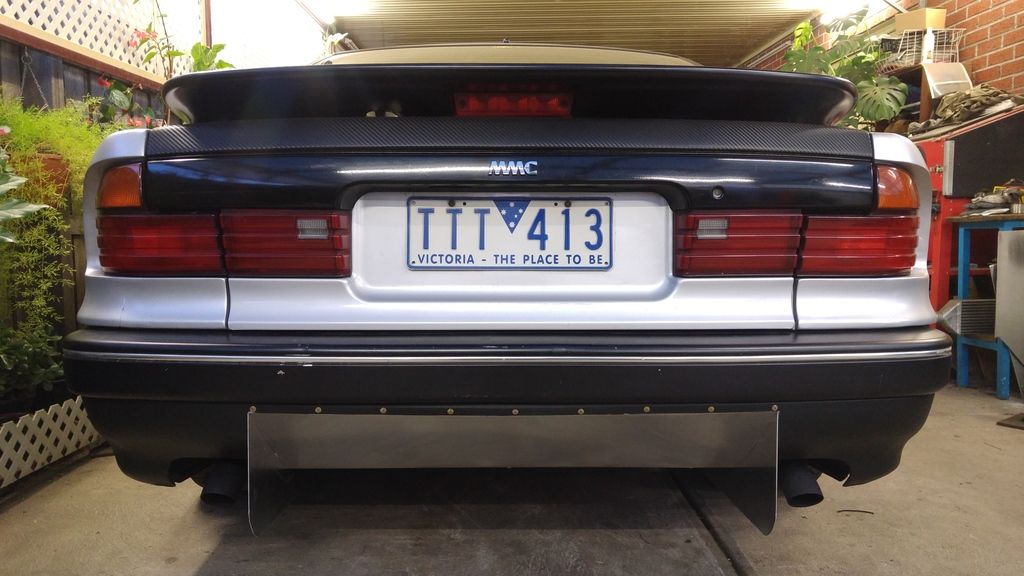

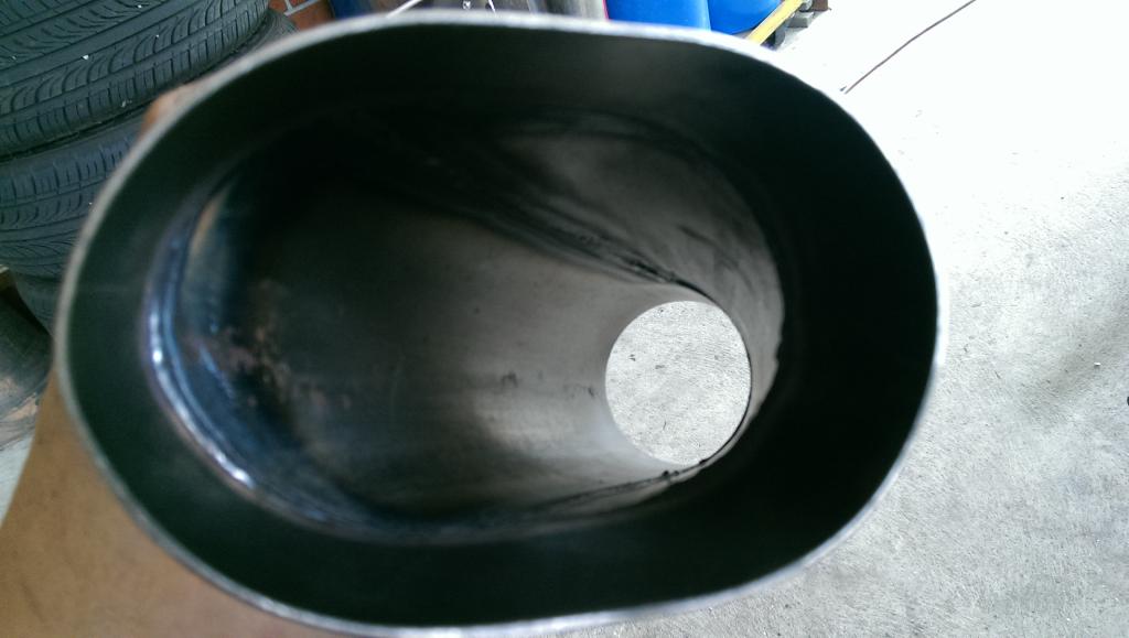

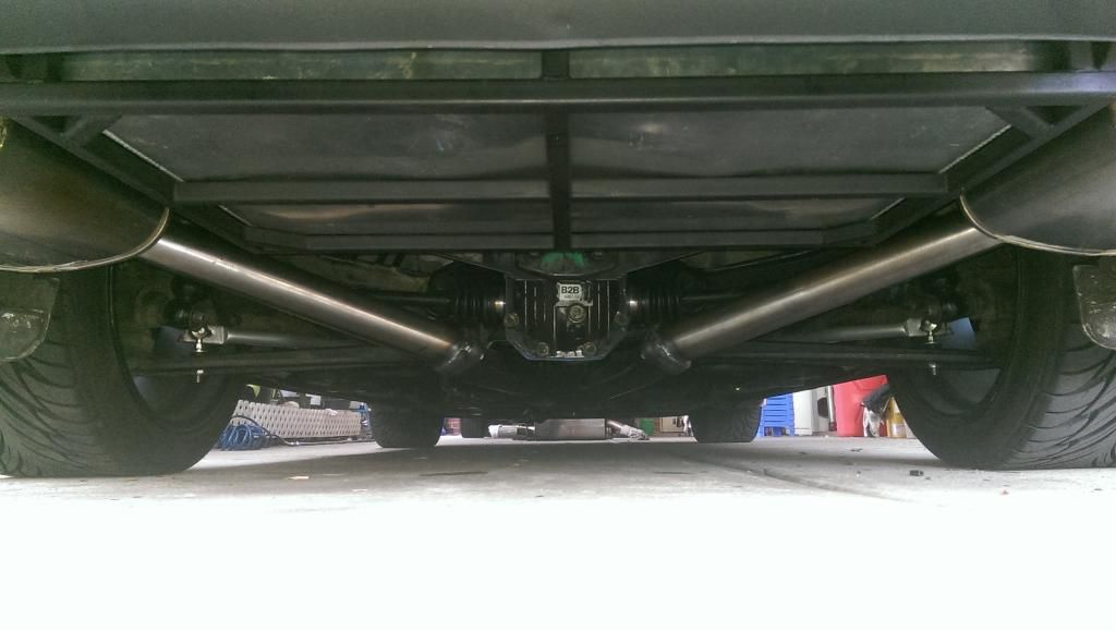

And another exhaust to give it a little bit of stealth..

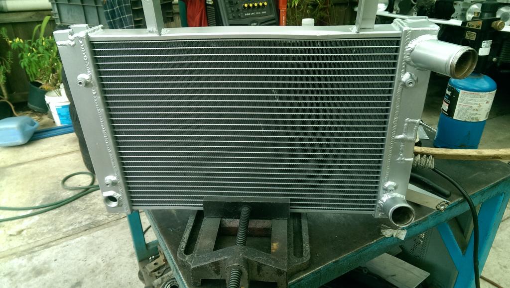

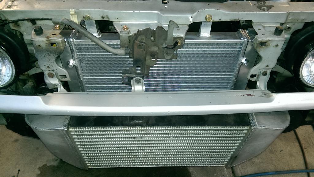

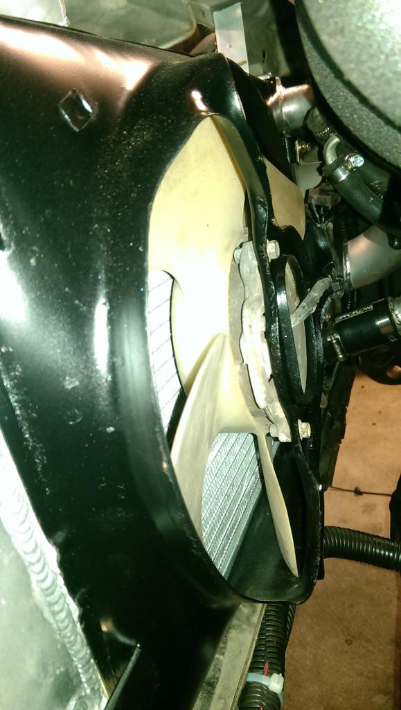

Mazda RX3 rad decided to die.... so replaced with VW MK2 radiator (slightly modified)

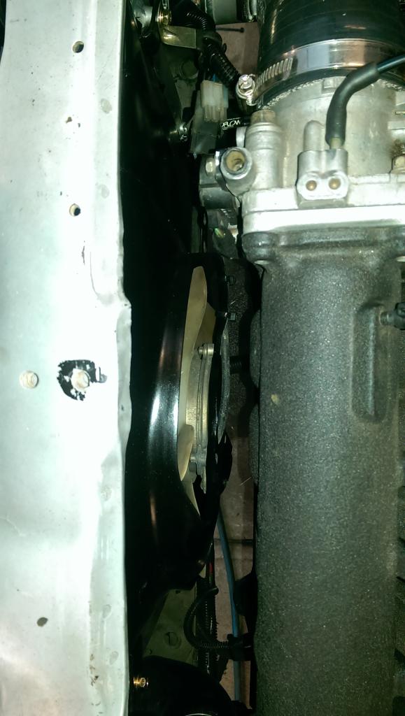

Modified stock fan to work (much quieter then slimline fan)

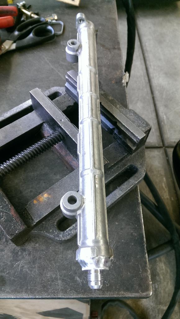

Upgraded fuel lines to nylon/stainless braided -6 line, weld on bung for fuel rail, Sard FPR

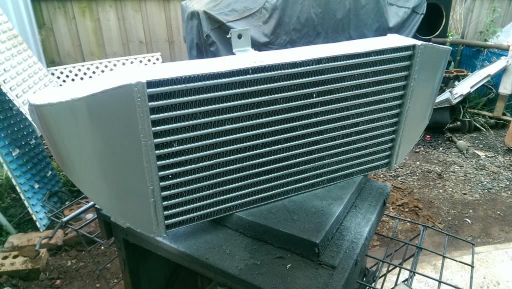

cleaned and painted cooler and rad
Jay, this is such an epic build. I just picked up another Galant VR4, and have some cool ideas for it. Some of those ideas are coming straight out of your thread, so I hope you don't mind! Keep up the good work.

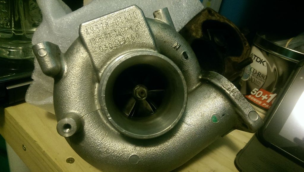

switched turbo's .... again....
Evo7 RS TD05HRA 16G6 9.8T with the Titanium Aluminide front wheel, very responsive stock turbo.

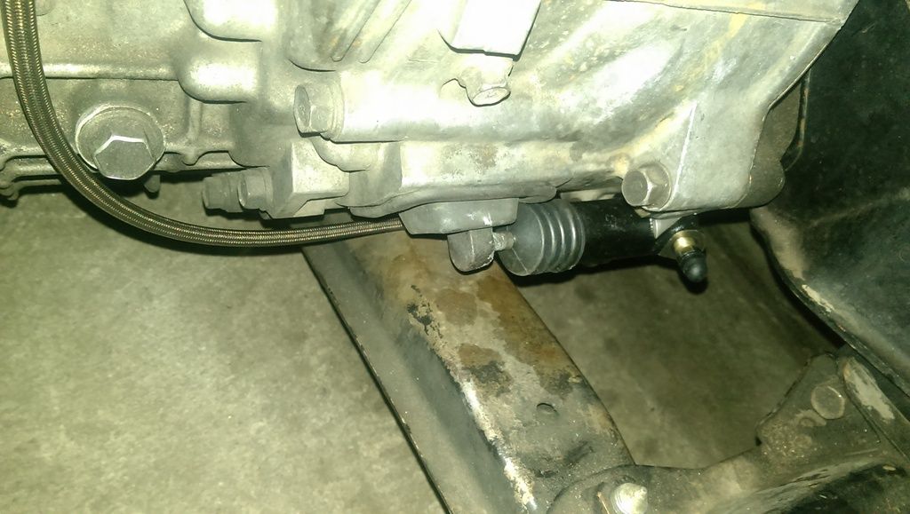

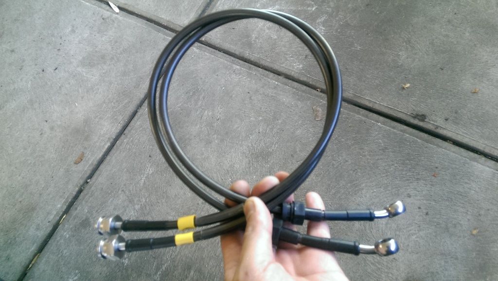

custom braided clutch lines, a hell of a lot better clutch pedal feel
