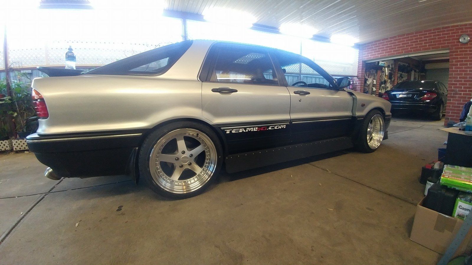

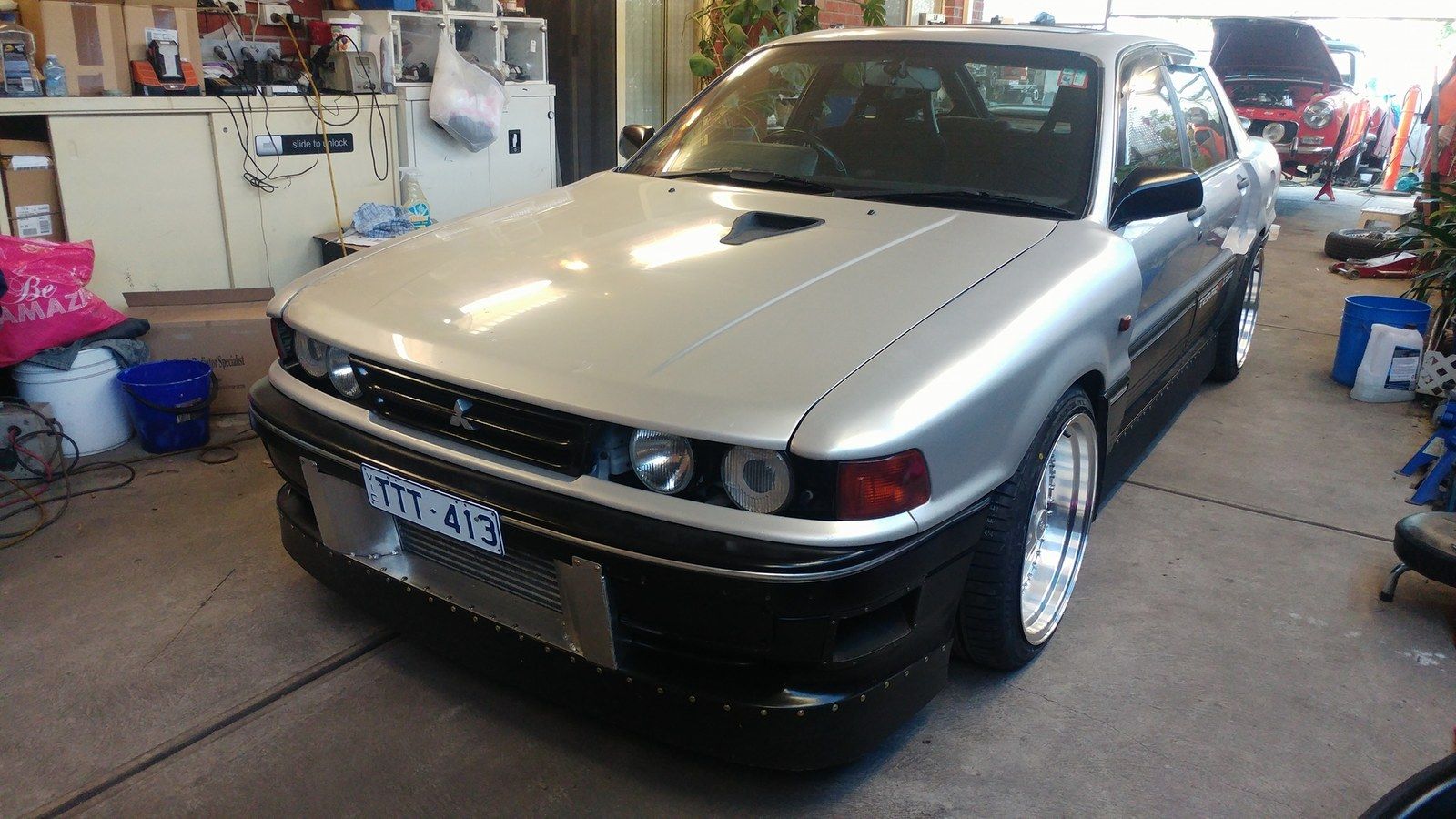

ZR4 (RIP) to VR4 Build...
Haha thanks,
I'll be honest, I just like confusing people. Its actually fun watching them scratch their heads confused of what the actual car is. I actually don't say much unless someone asks.
Its even funnier when they see my engine is "backwards"
Cheers for the kind words!

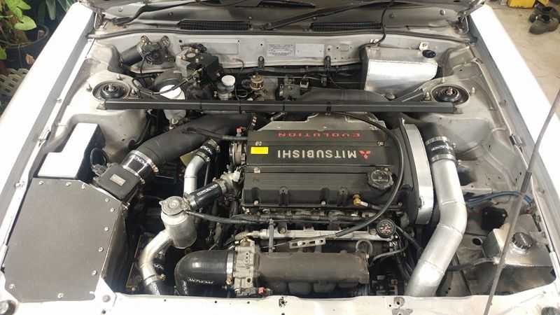

Does the head simply bolt on with the same timing belt tensioner as the old school 4g63?
This car is a work of art!
Cheers..
all the timing equipment is factory 6 bolt, belt/tensioner/idler bearings etc..
Was also wondering what was done to the head exactly.
Heads aren't that far different from each other, needs some welding and machining, other wise its straight bolt up (but custom work for everything else obviously

Thanks for that. So why an evo 7 head? Why not a 9?
We have plenty of evo 4-8 parts floating around Aust. Evo9 heads however are fairly hard to find, let alone cheap.
I have been looking for a while now, evo 4-8 heads are around $50-300 (pending condition), Evo9 MIVEC is around $1-2K (pending what is supplied with the head)
Its a hell of a difference on price just for MIVEC head
Also the Evo7 head was free :)

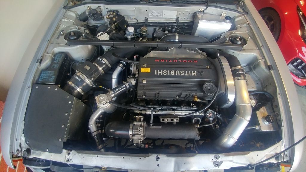

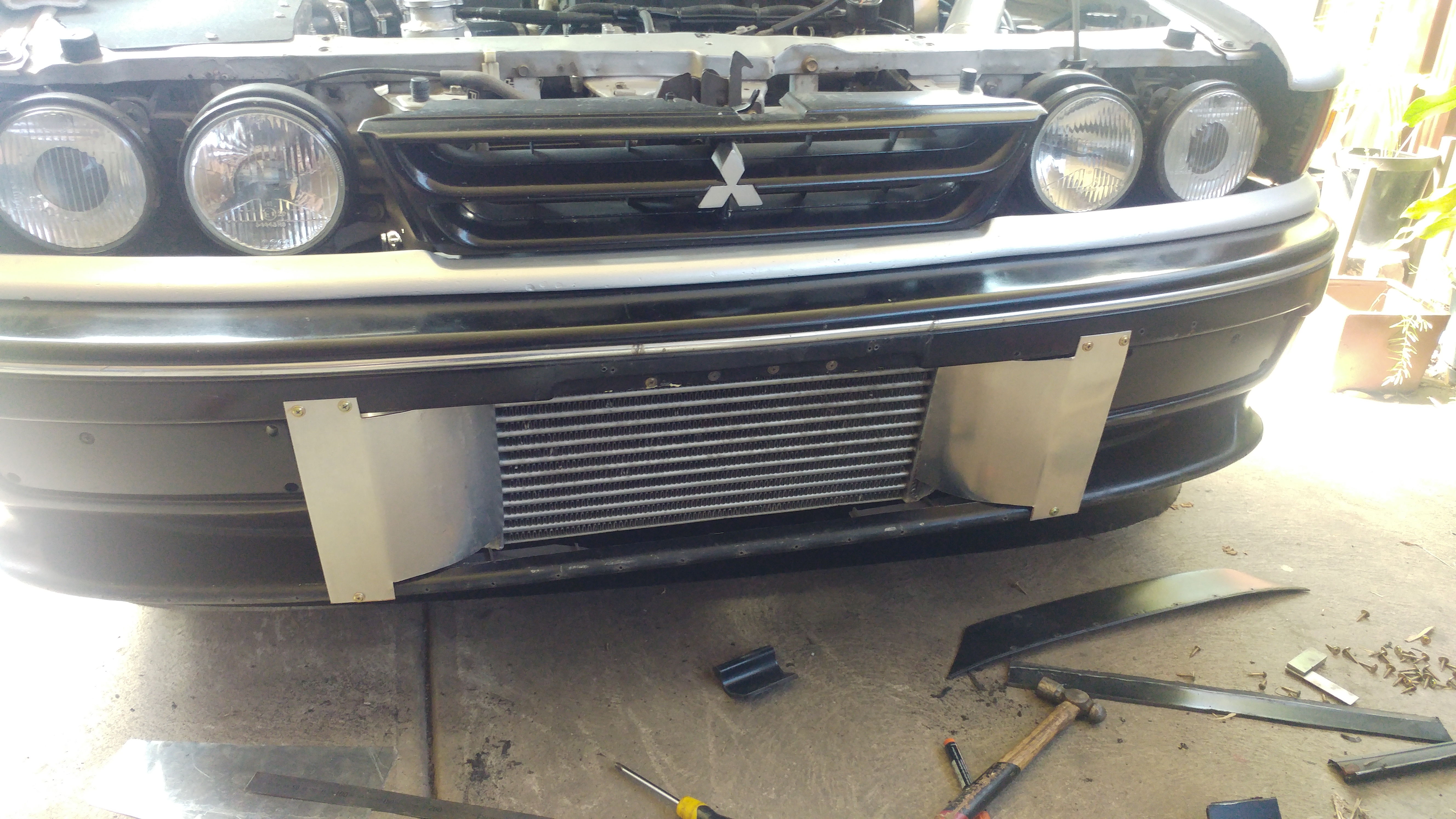

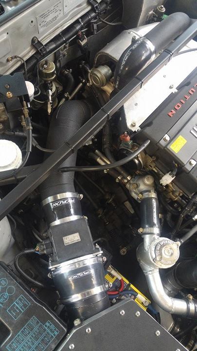

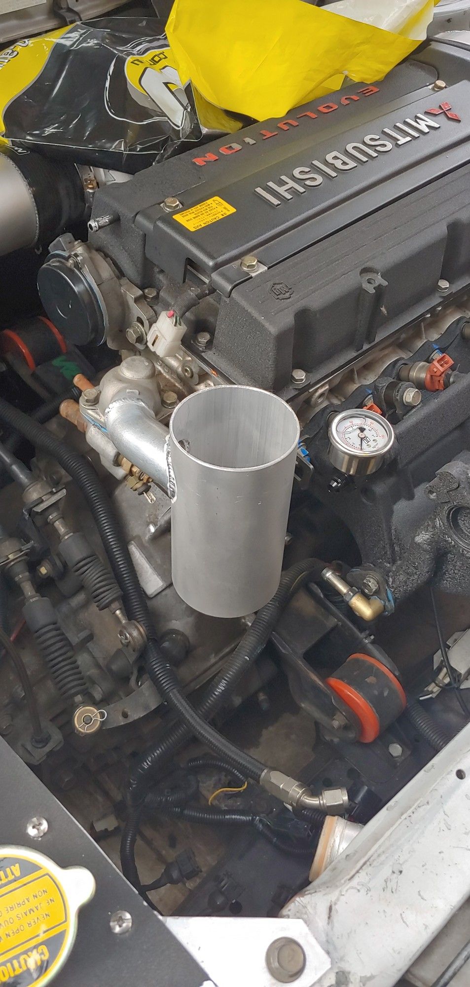

Updated with 3.5" intake pipe to prep for larger turbo, planning a twin charge set up shortly... pending on if I switch to electric power steering and size of supercharger available (cheaply obviously)...

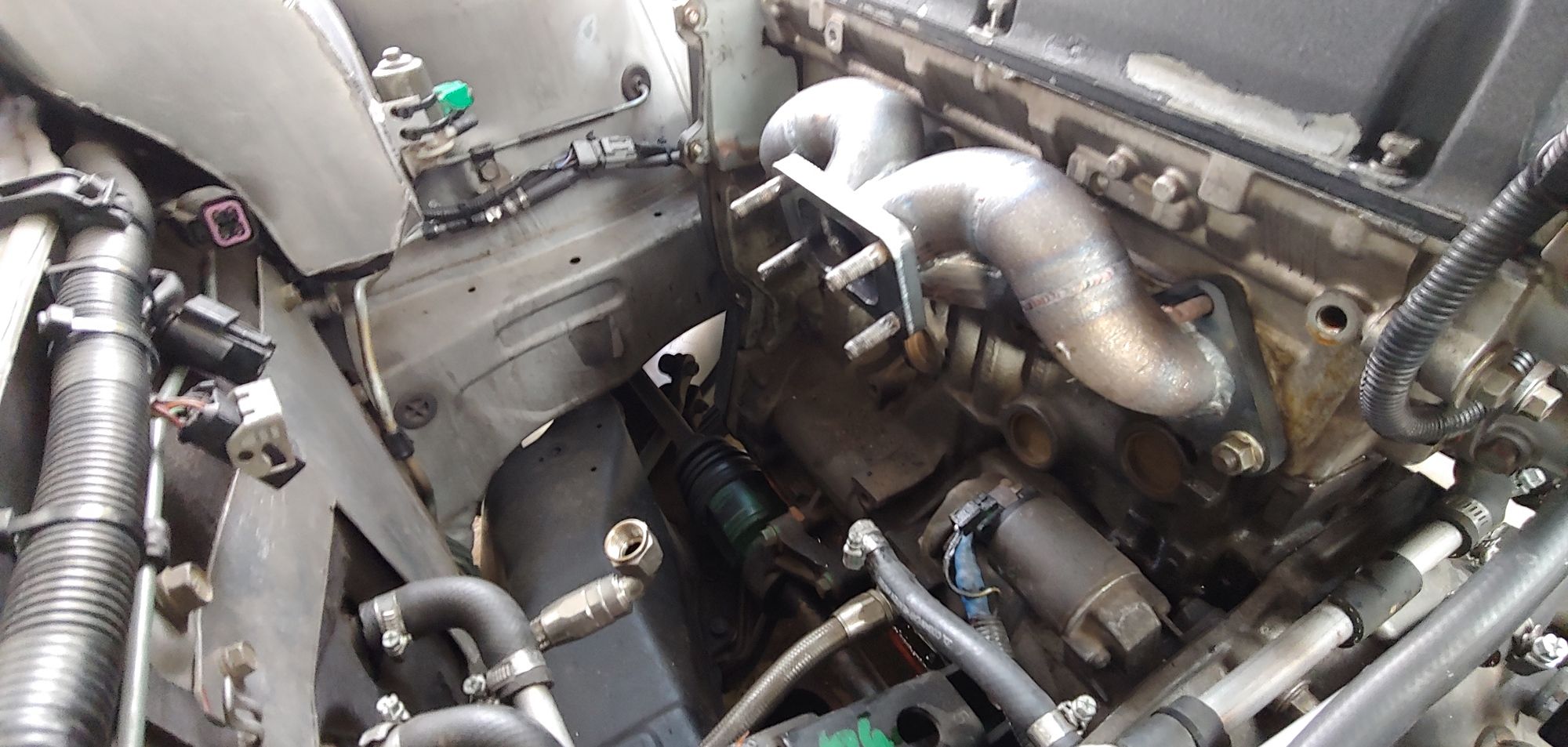

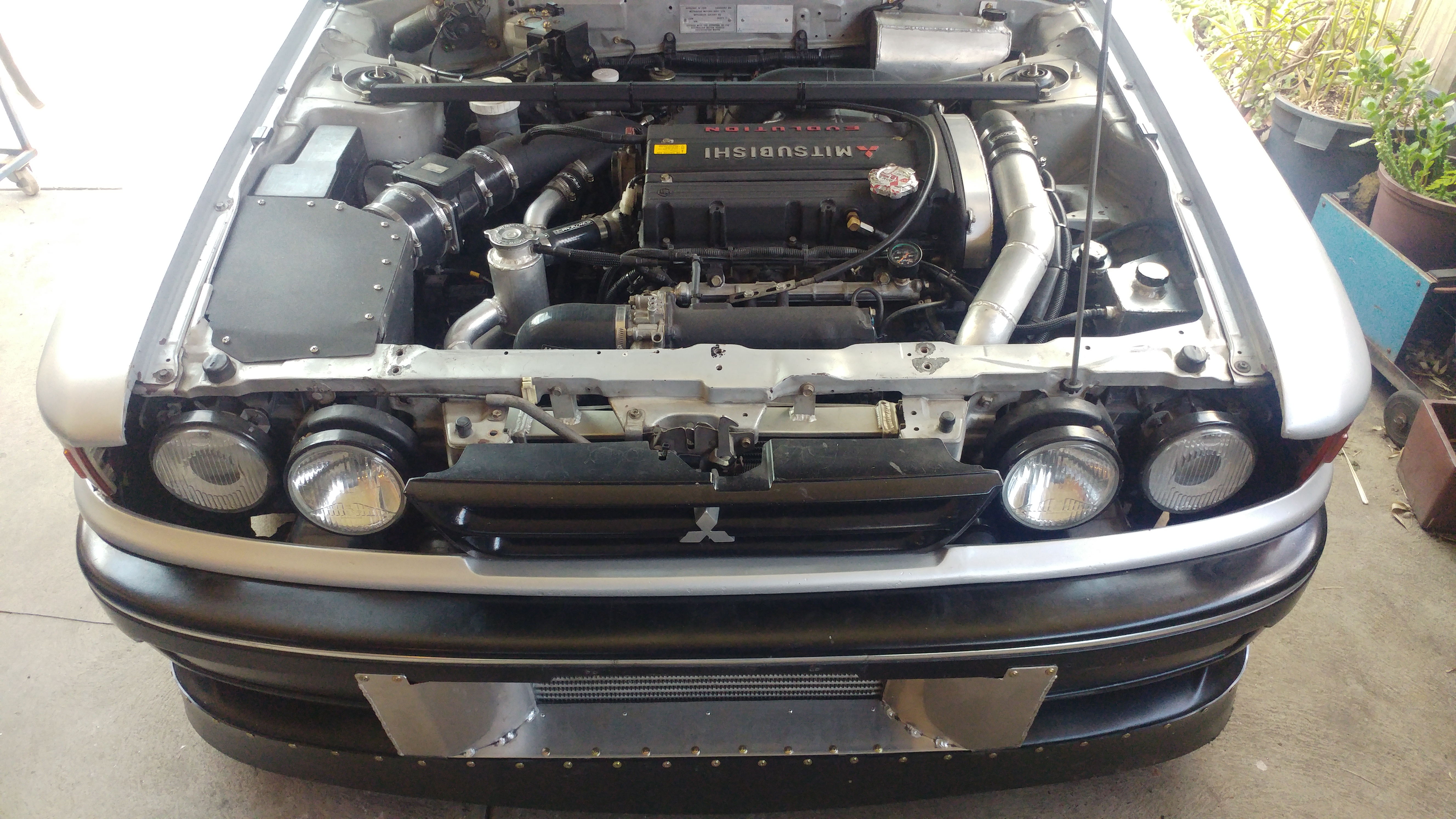

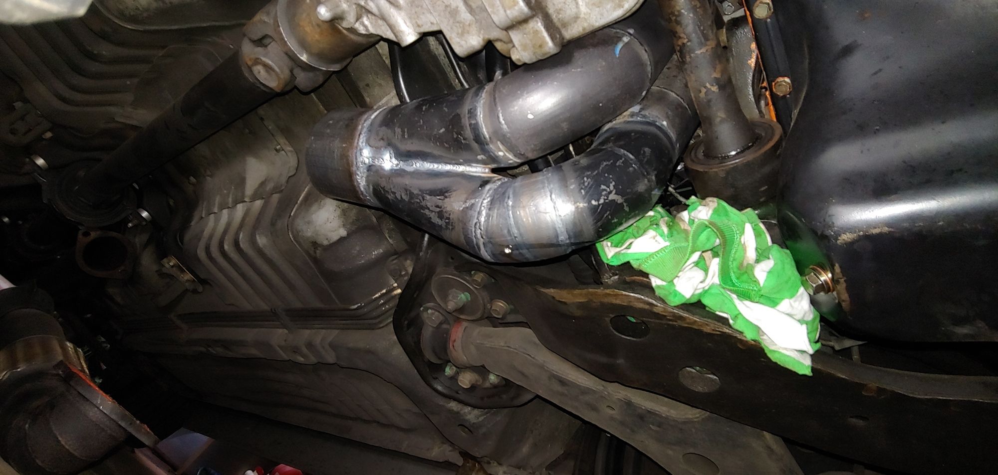

Any pictures of how you routed the exhaust between the front subframe and the axles? Its gotta be a tight squeeze..
Its been a while since updates...

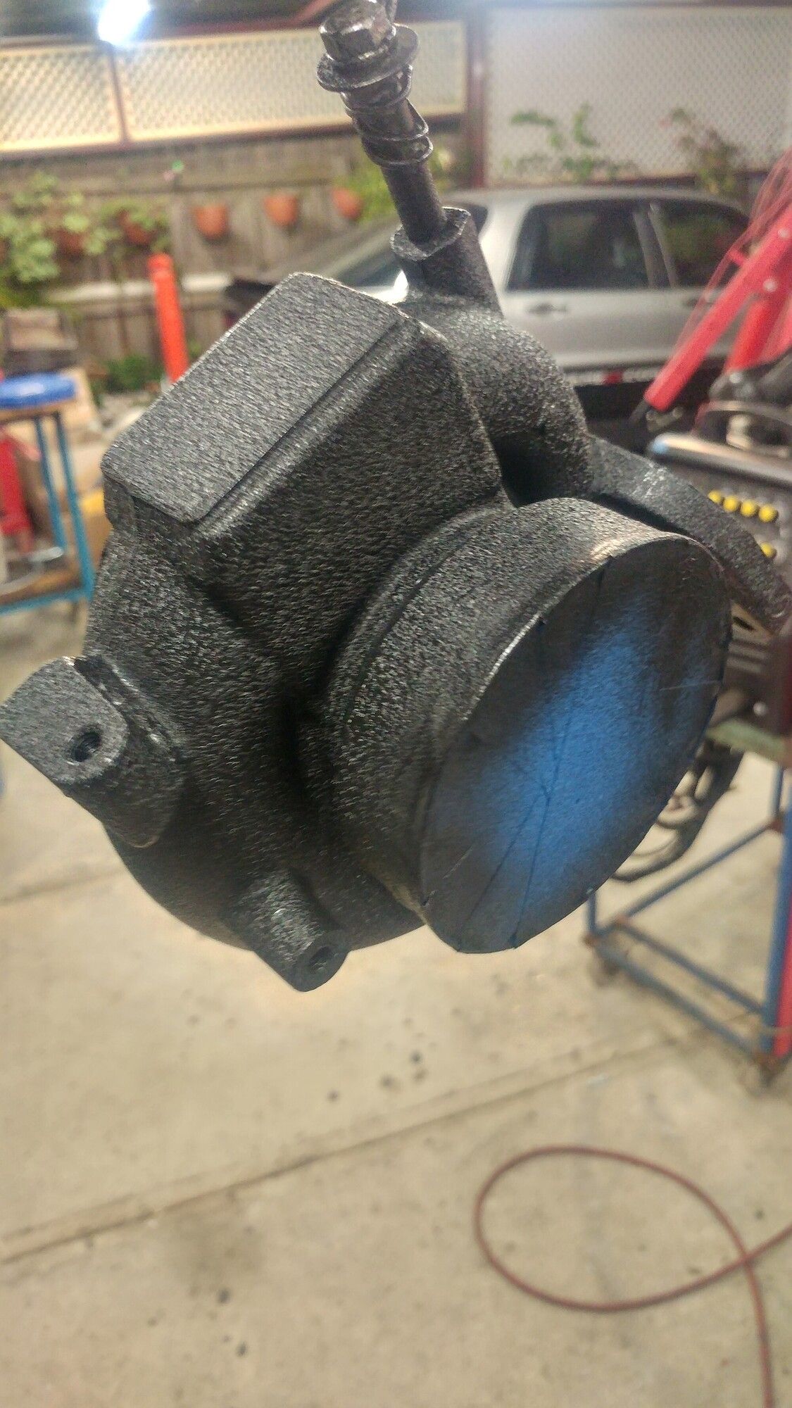

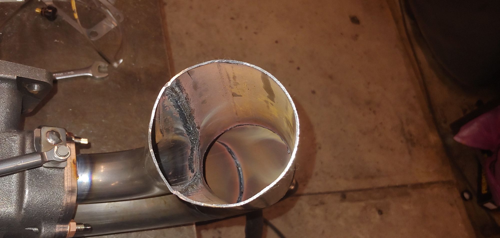

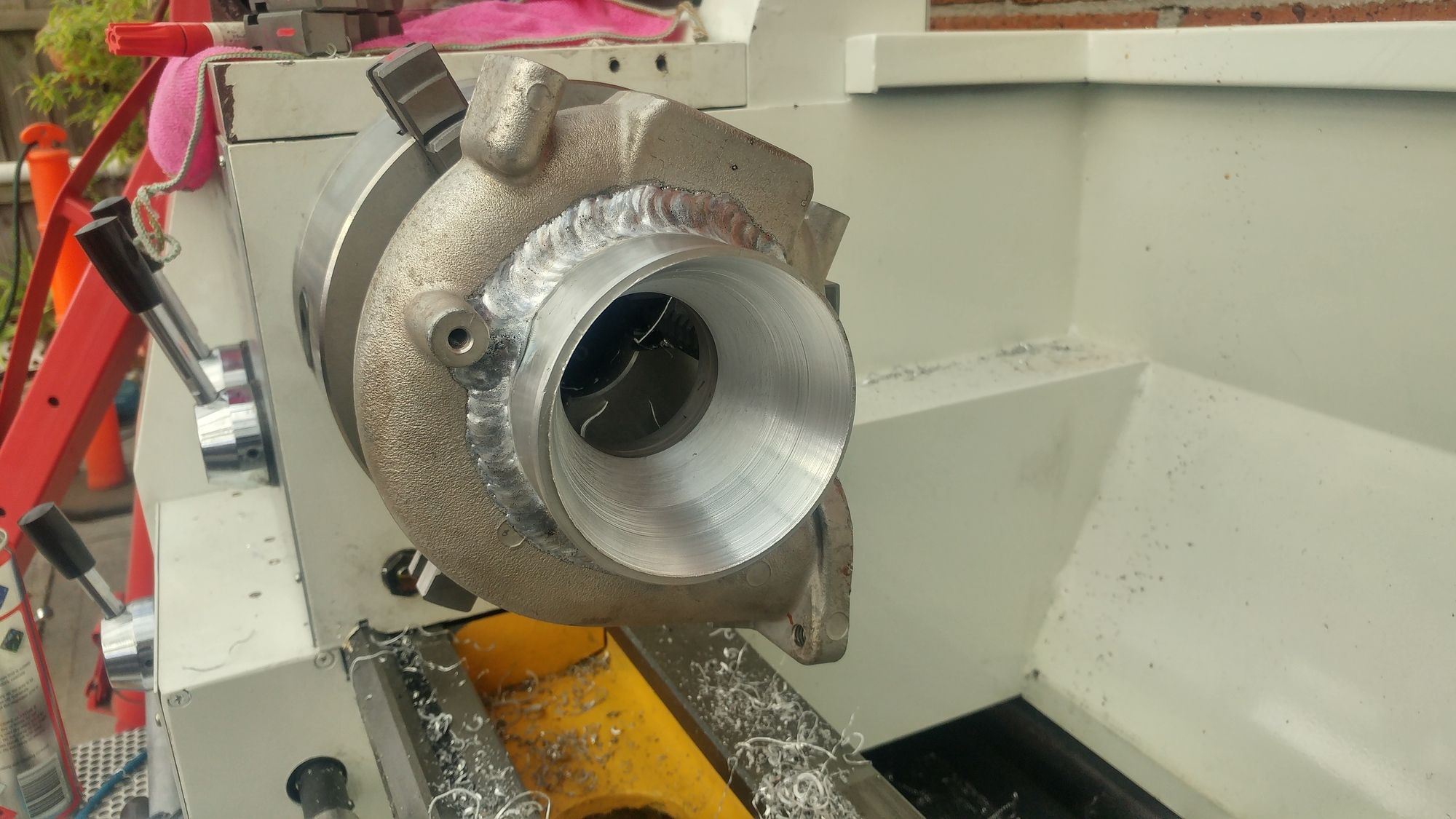

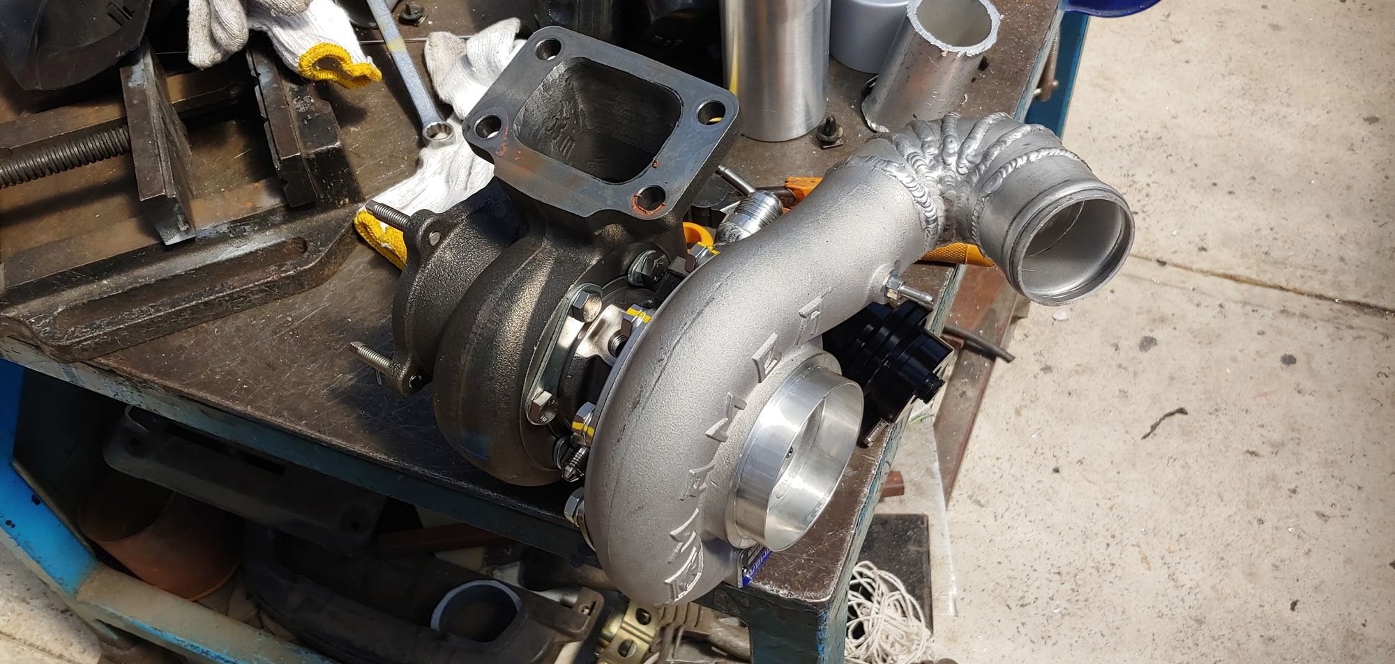

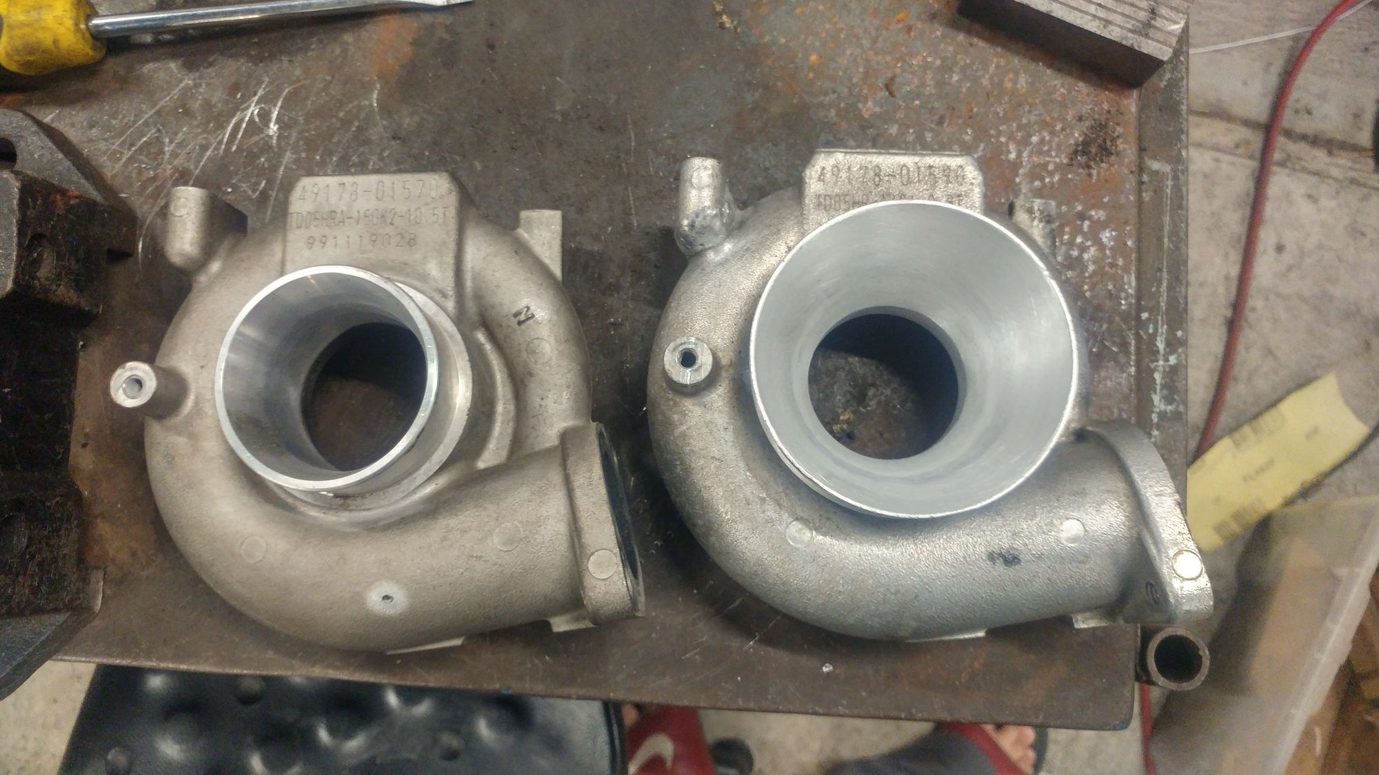

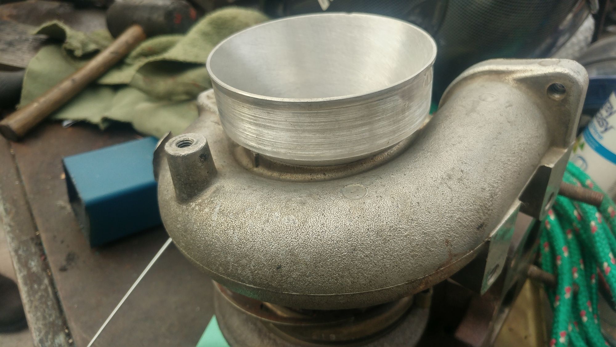

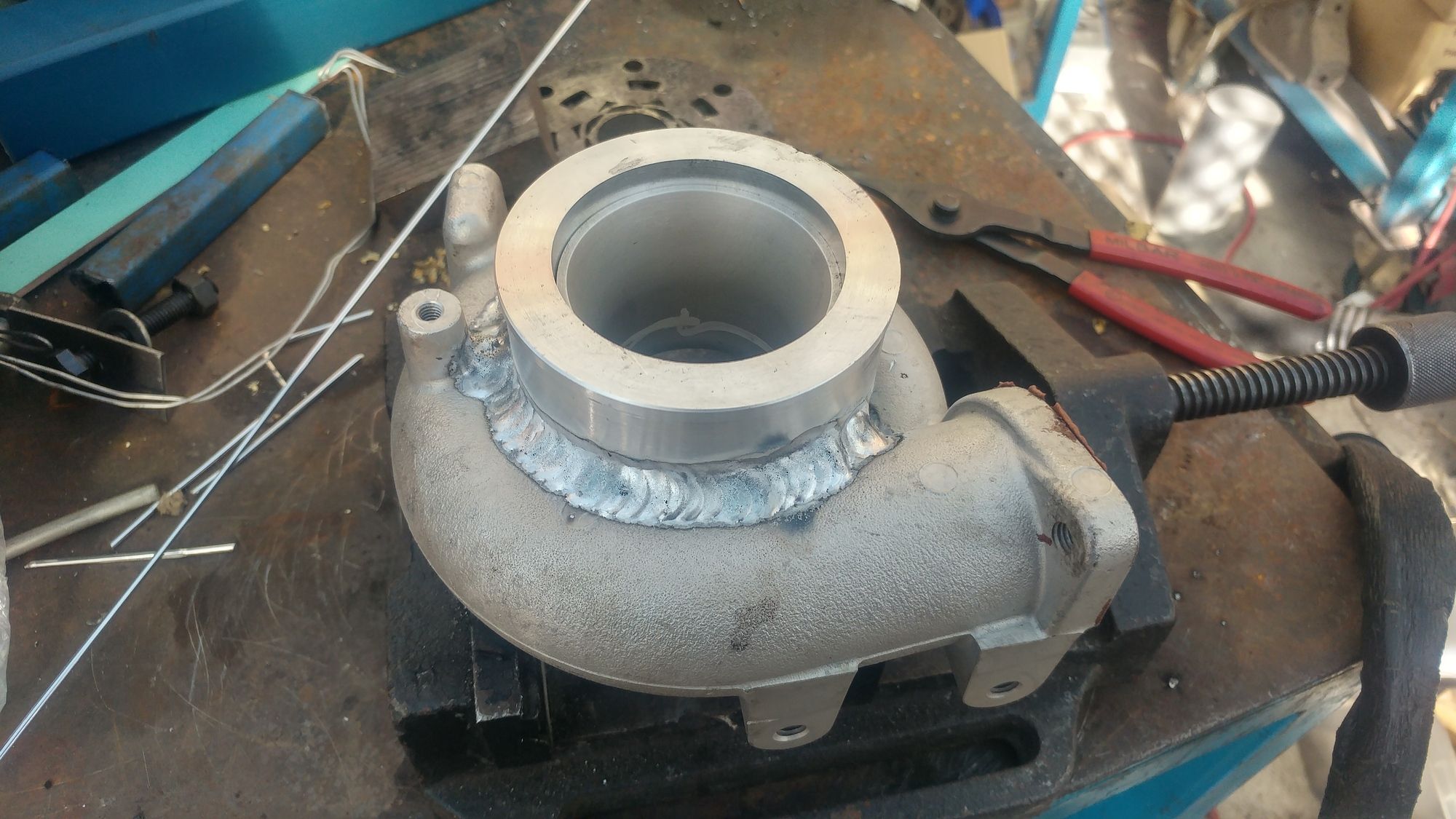

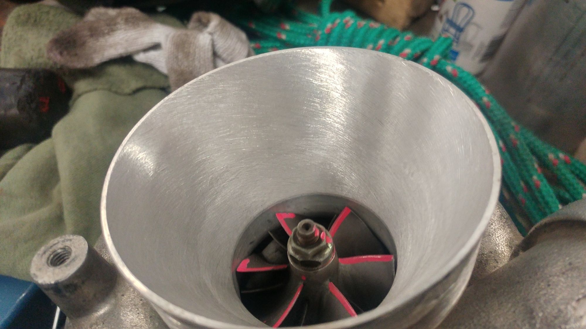

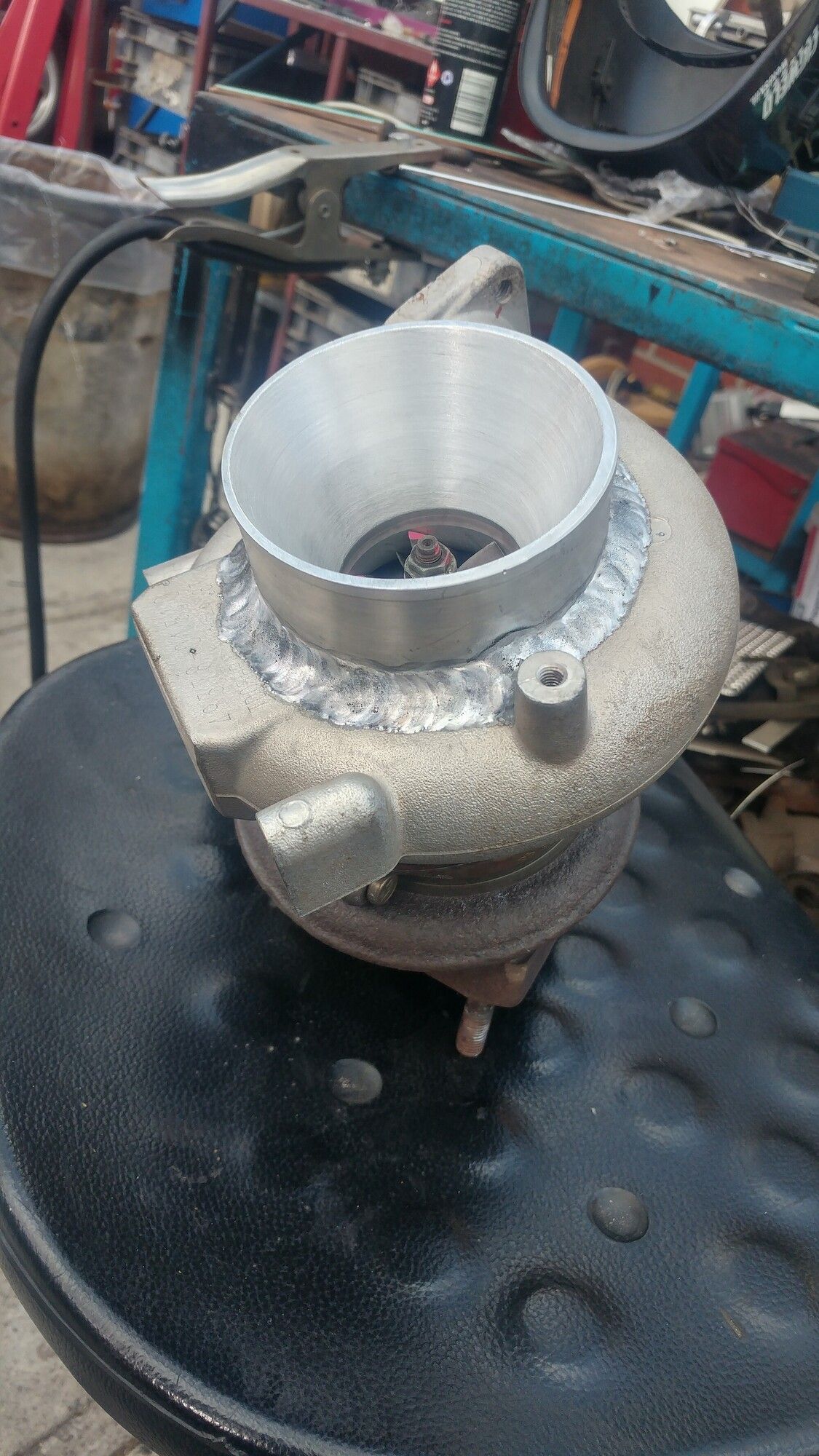

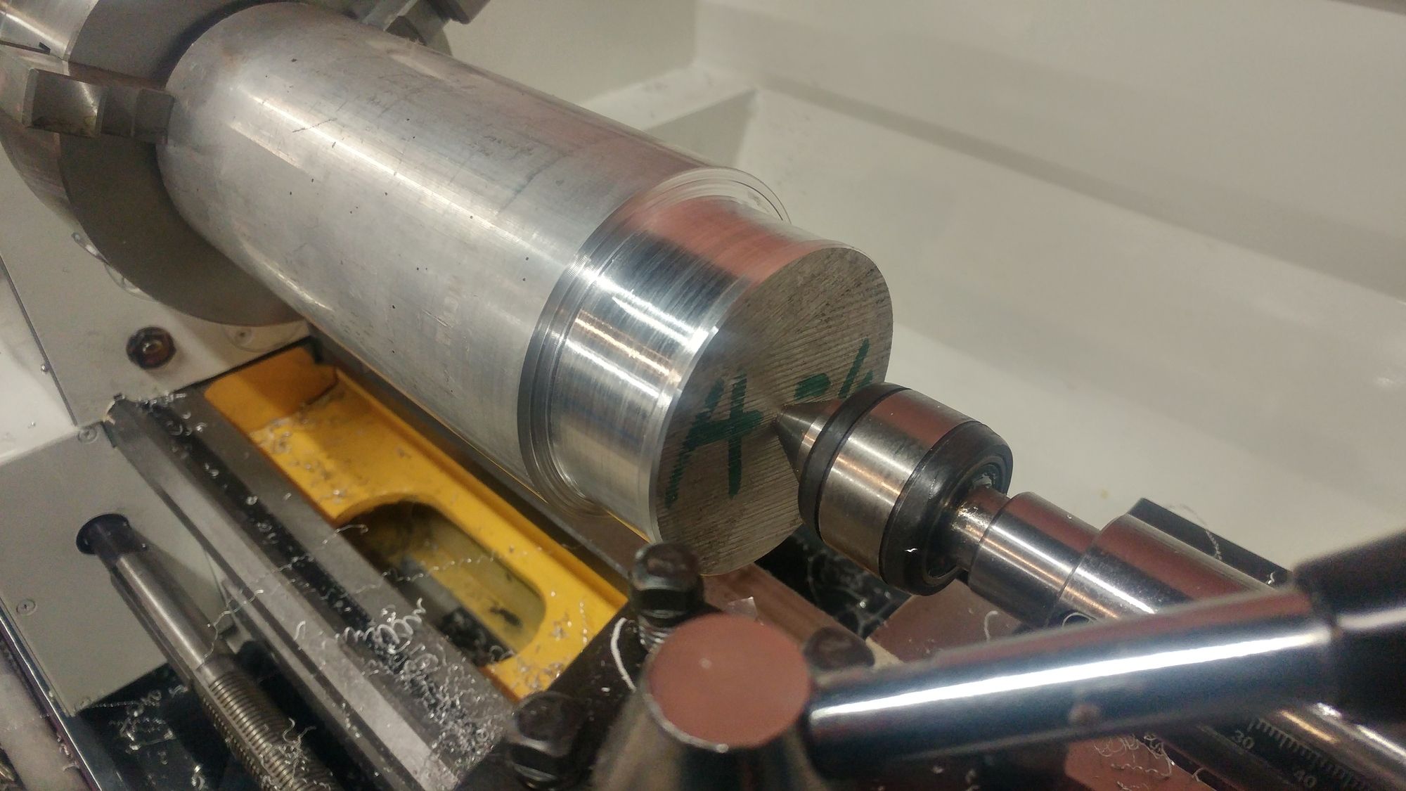

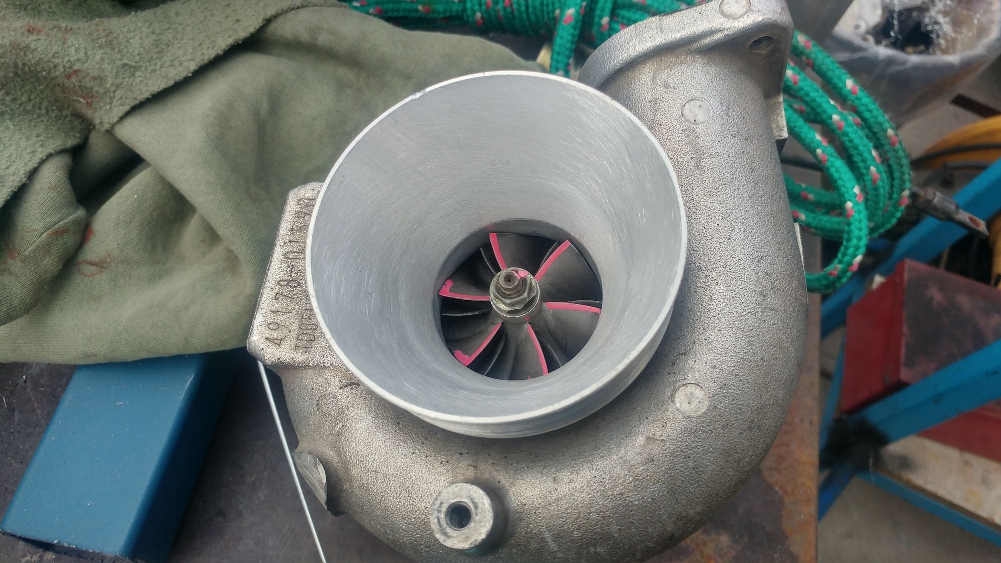

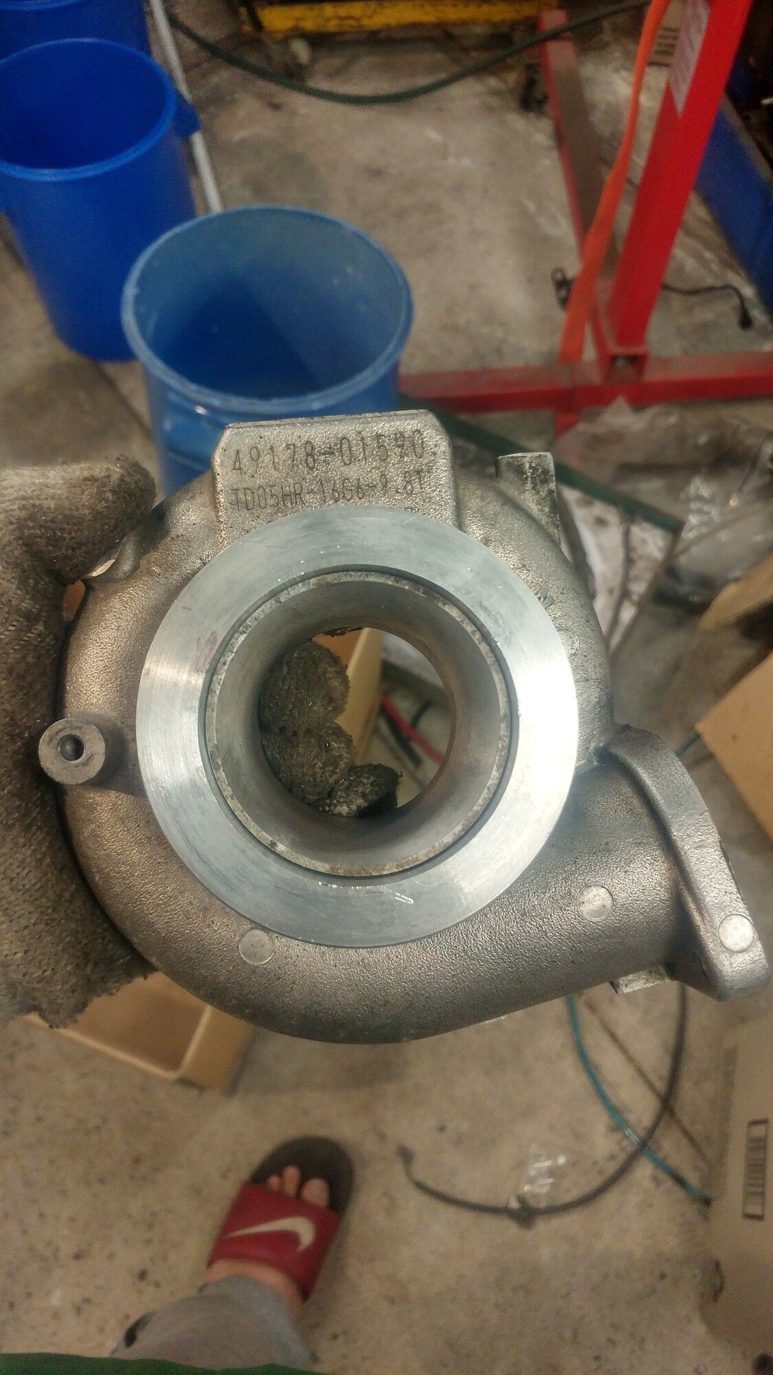

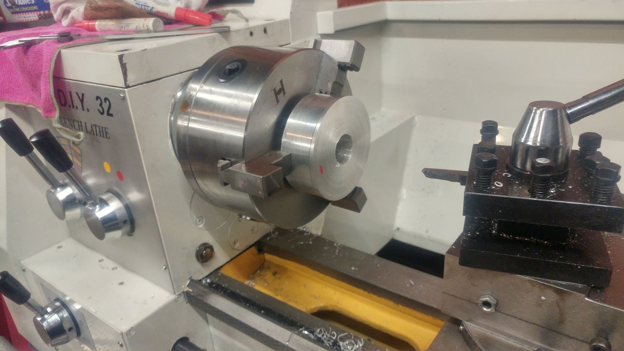

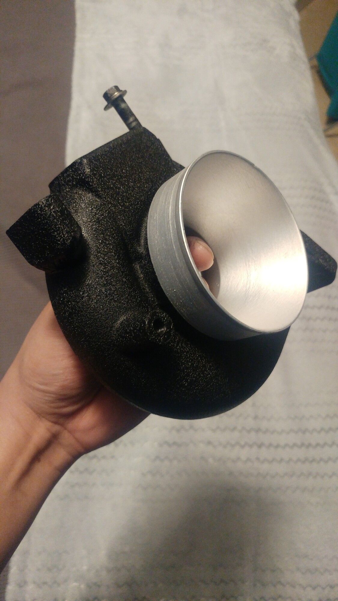

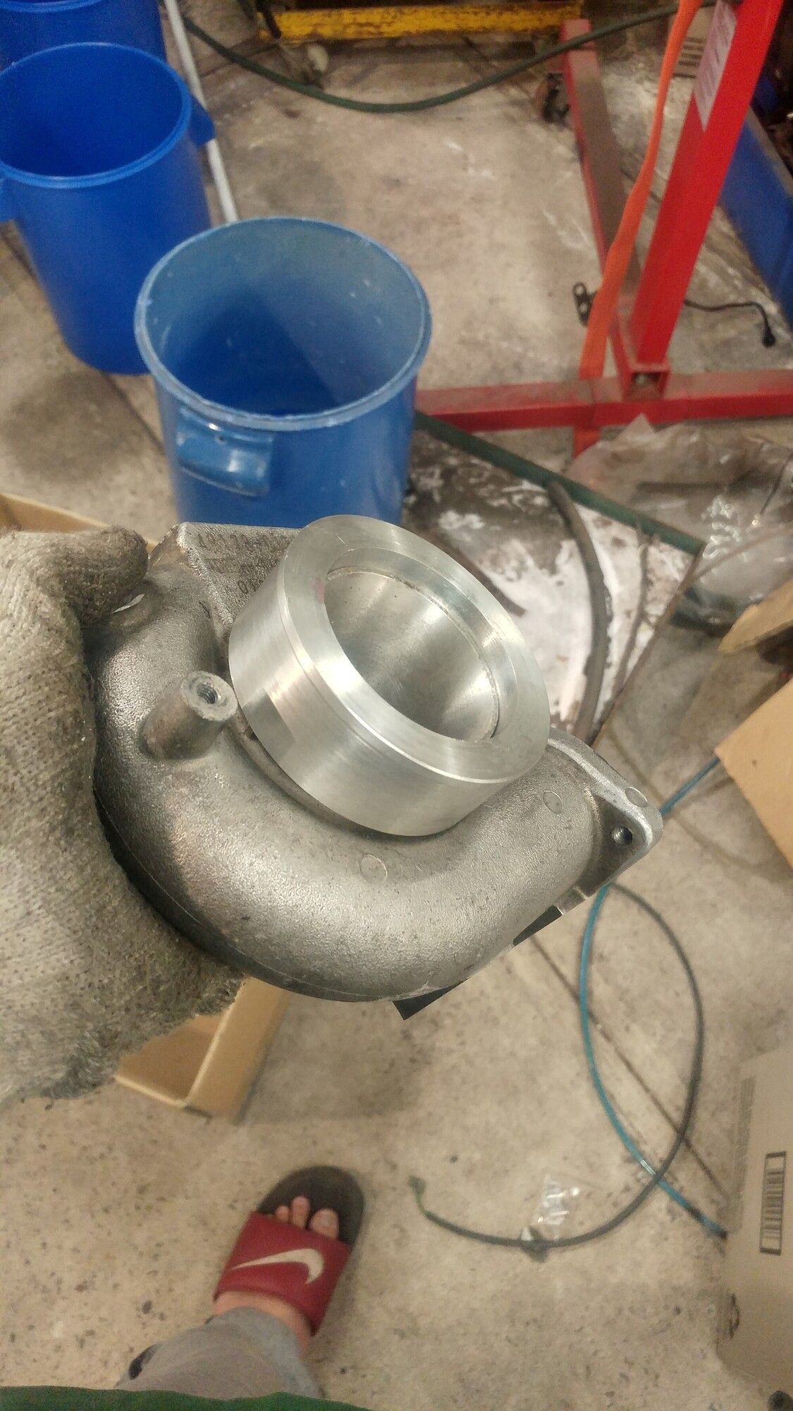

Testing out my new lathe: Version 1 turbo bell mouth

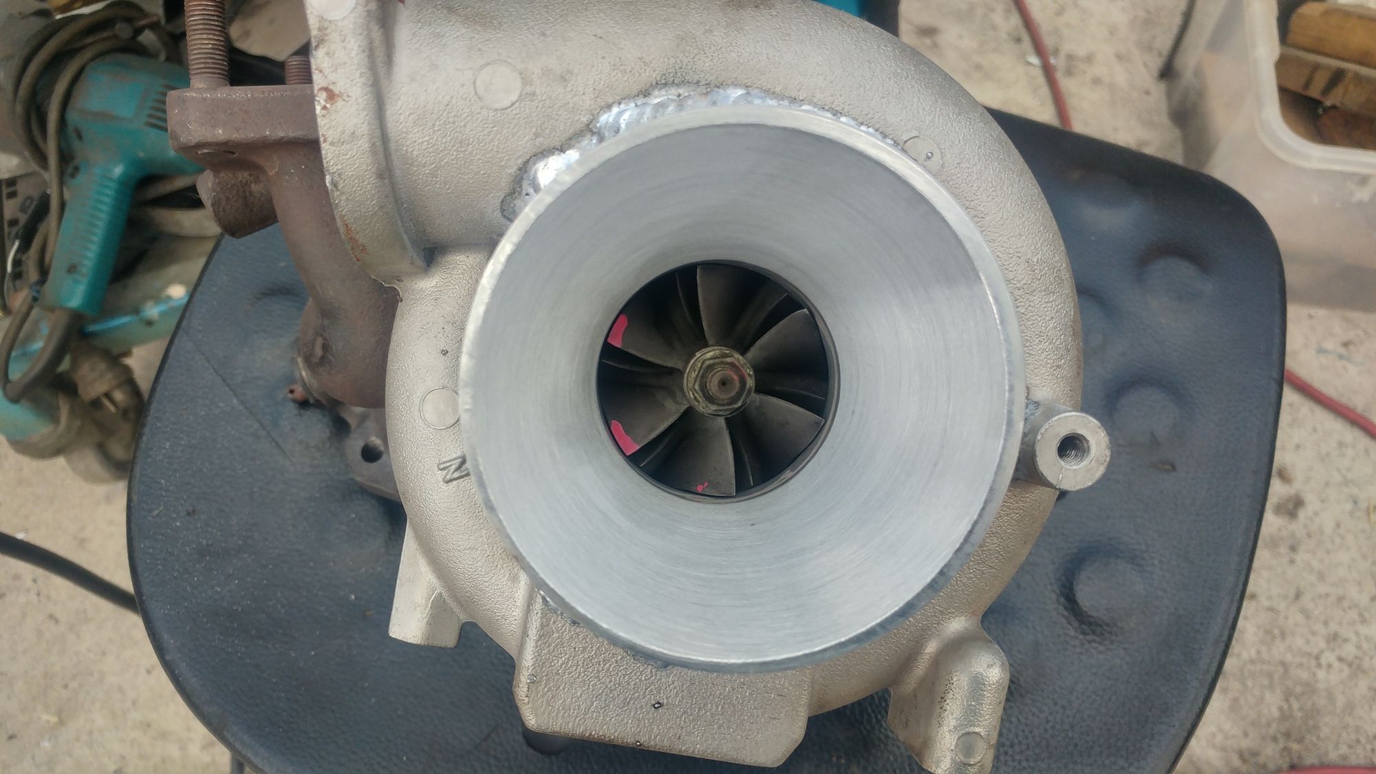

Version 2 turbo bell mouth clearer look...

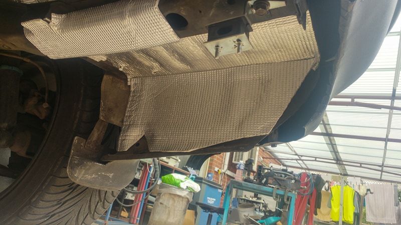

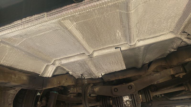

Heat and sound shielding over the fuel tank

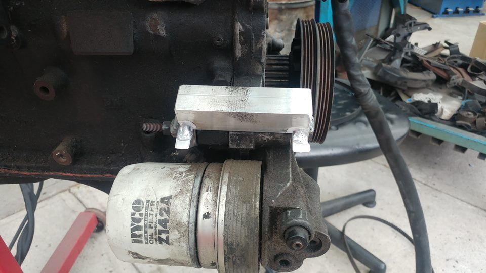

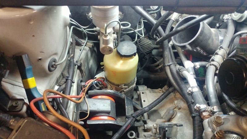

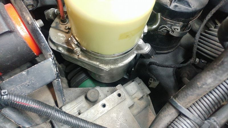

Vauxhall Astra Electric power steering pump conversion

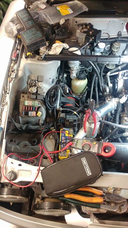

Wiring fun
Clearance

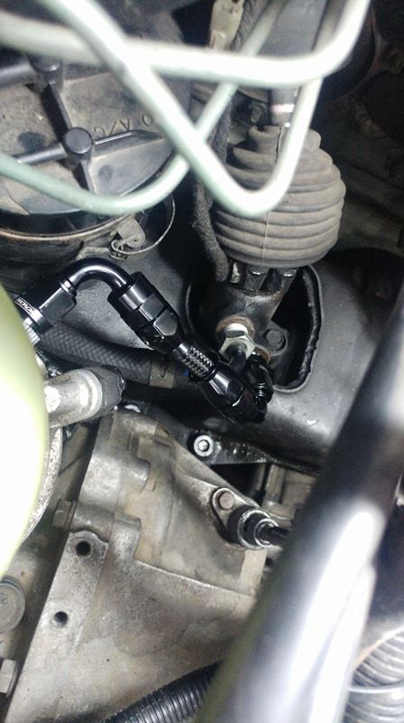

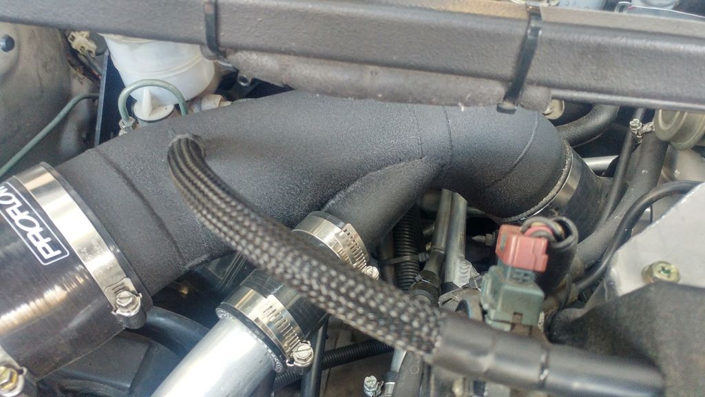

Really really long power steering hose
Reused power steering return line as fuel return line

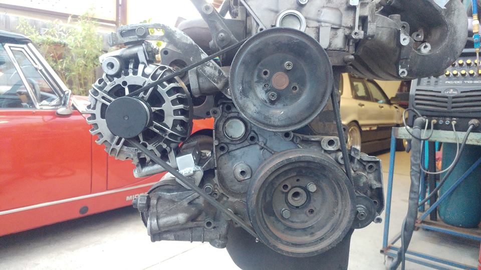

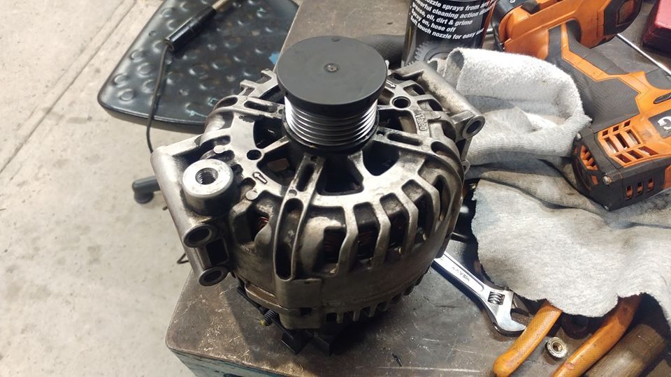

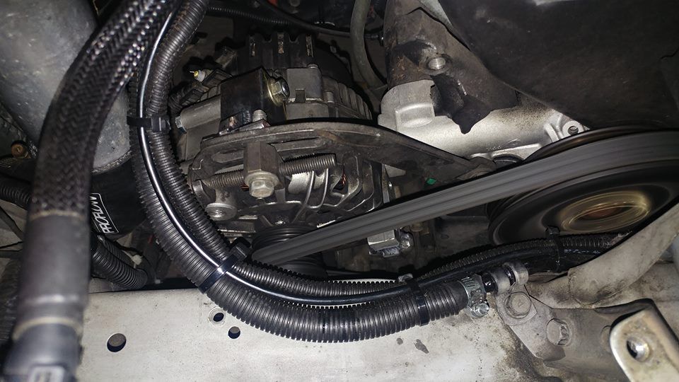

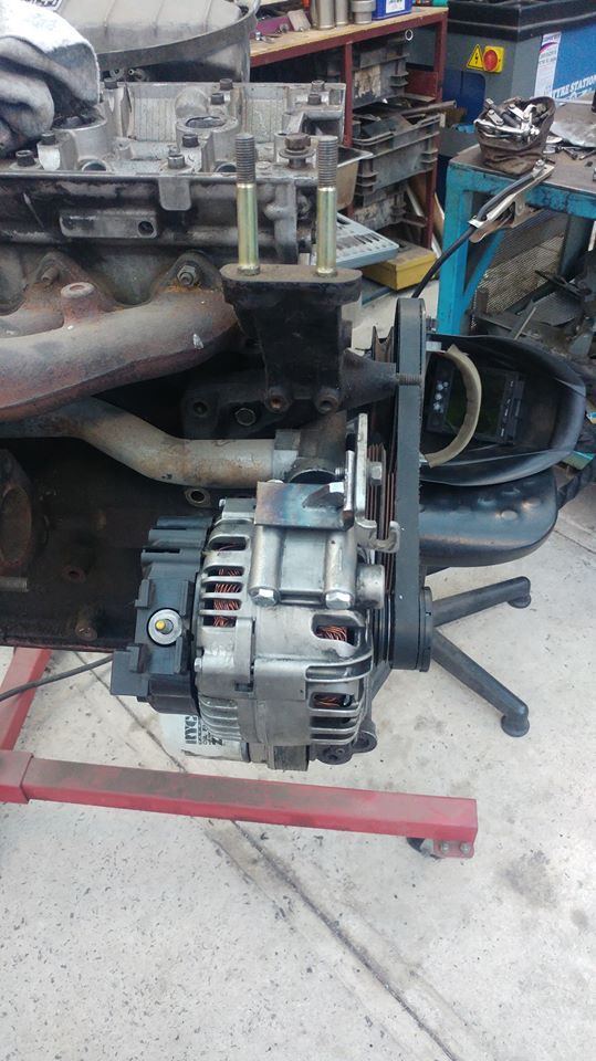

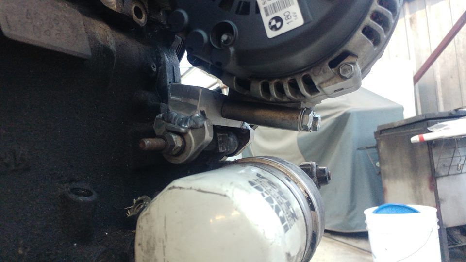

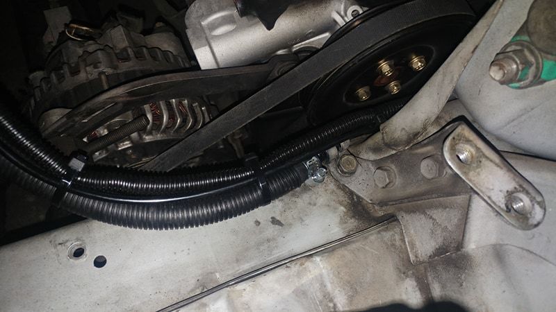

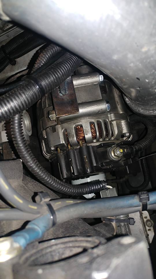

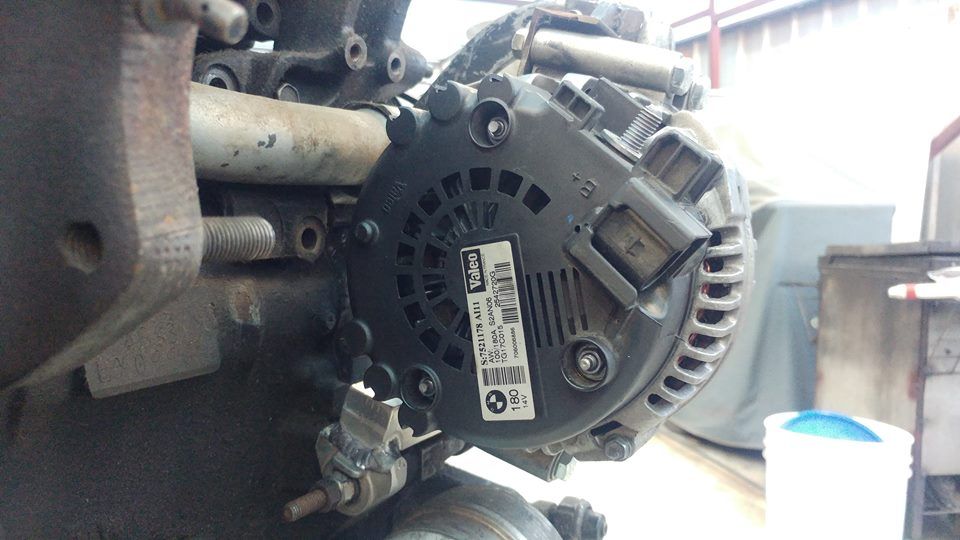

BMW E90 180Amp Alt upgrade (Why you might ask? cause it was $20 and cause i can :hellyeah:)

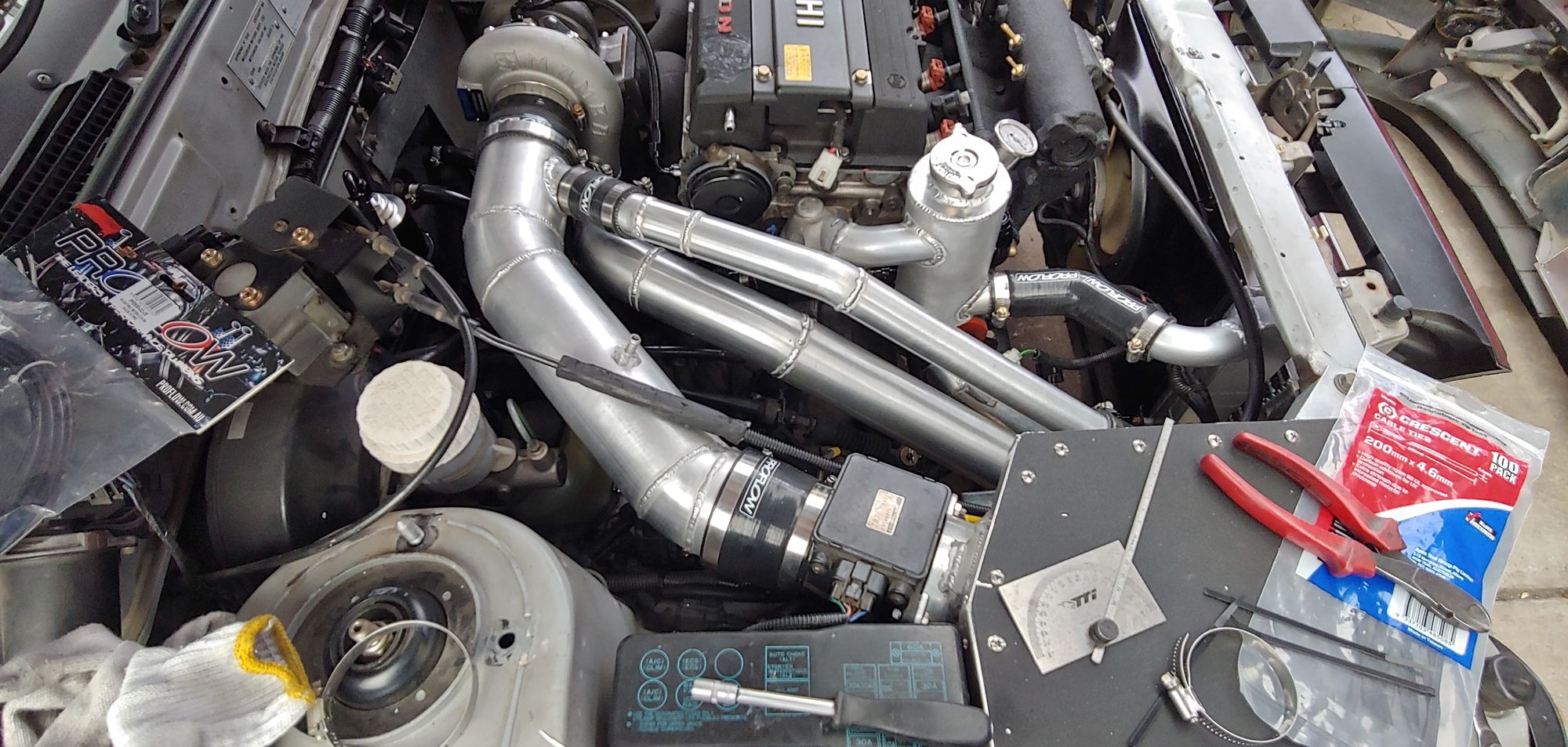

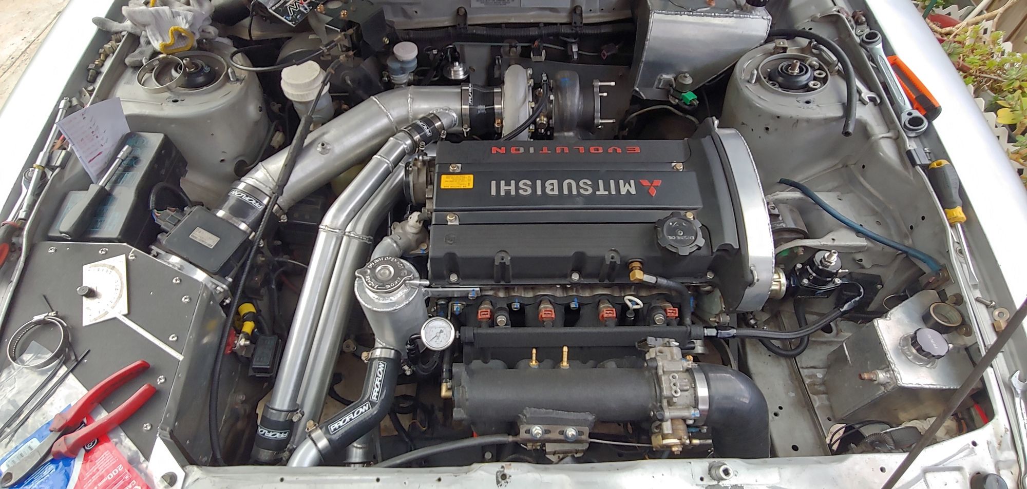

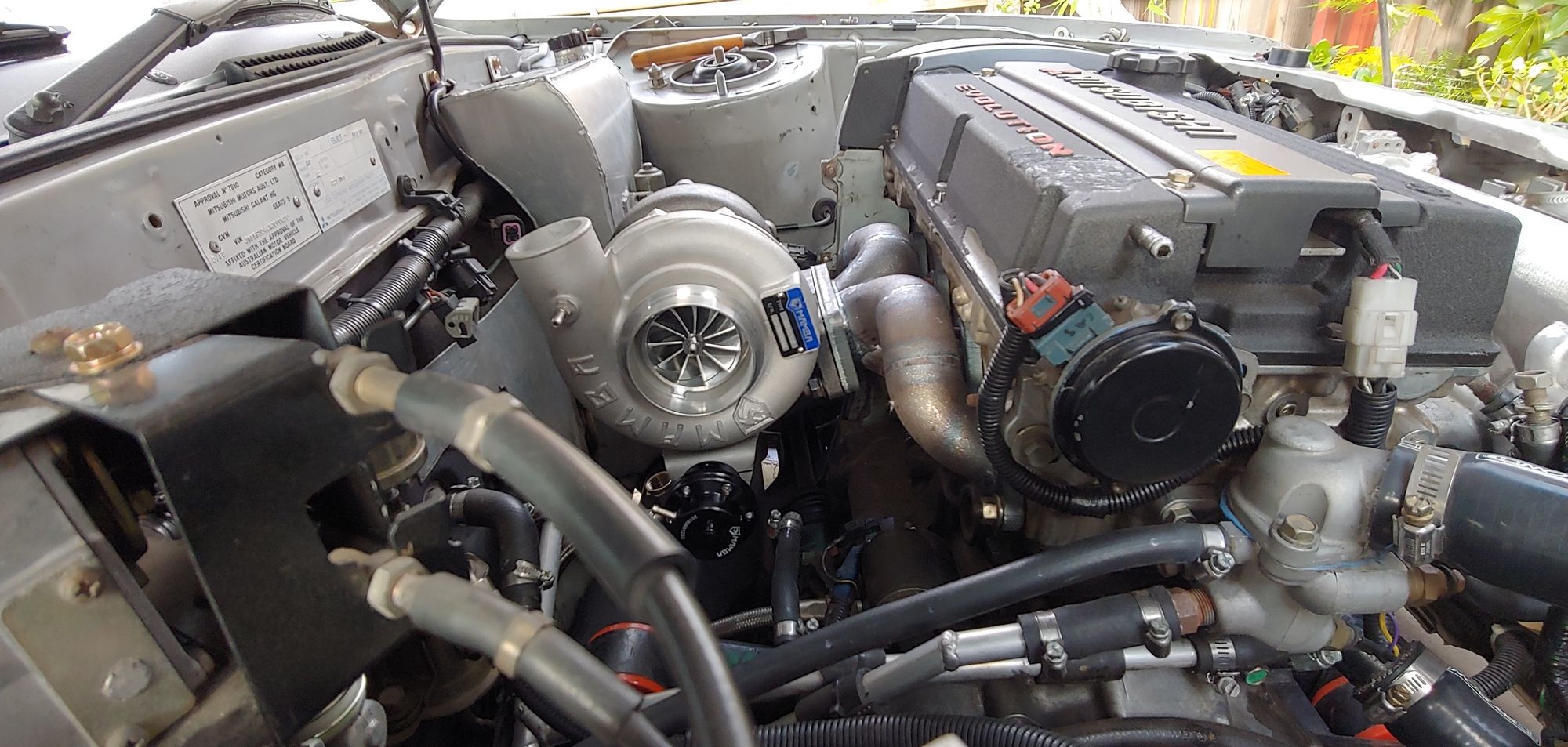

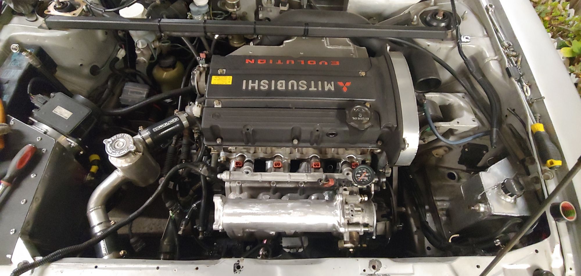

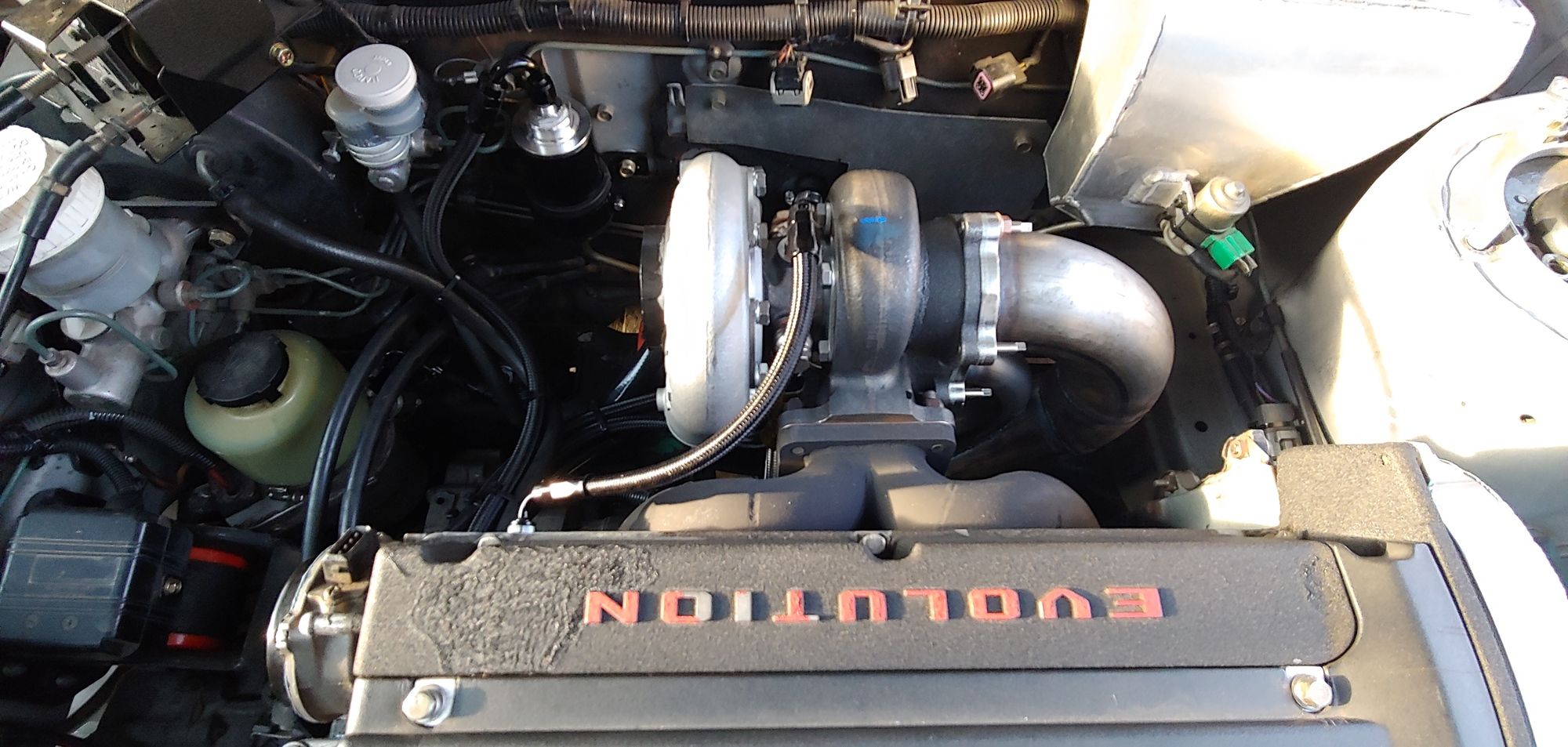

New set up:

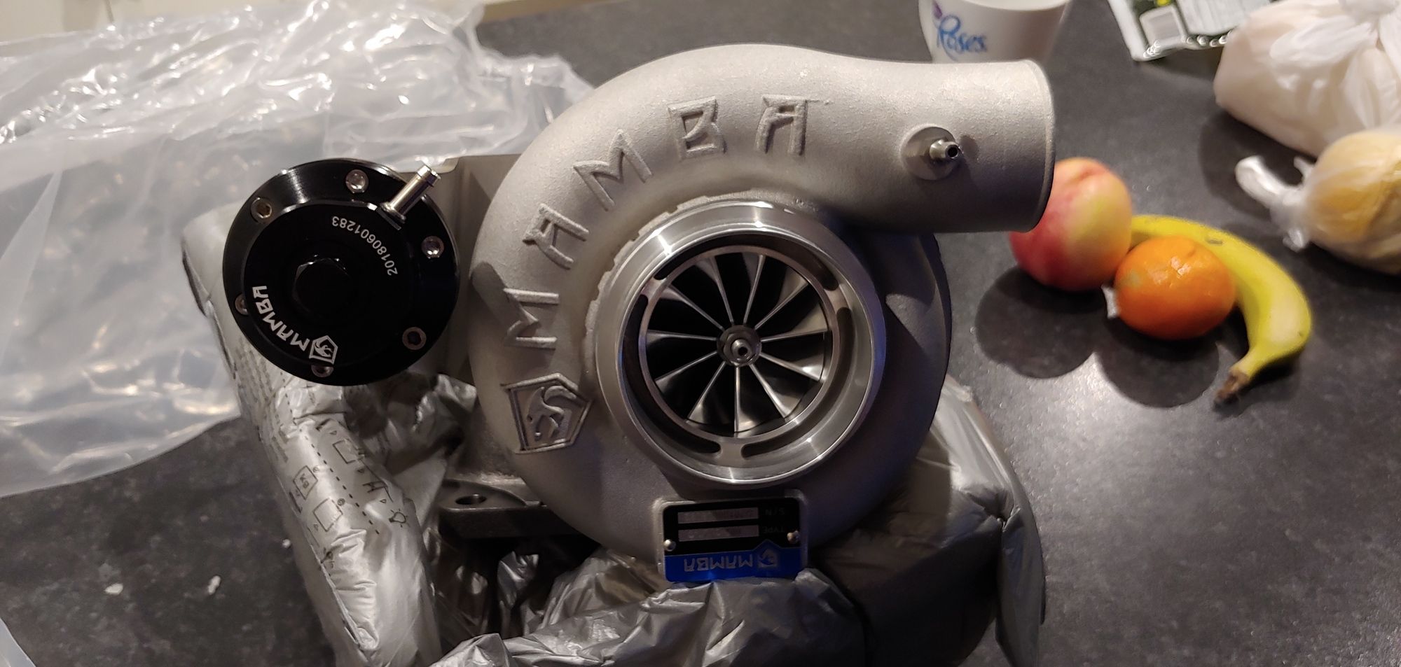

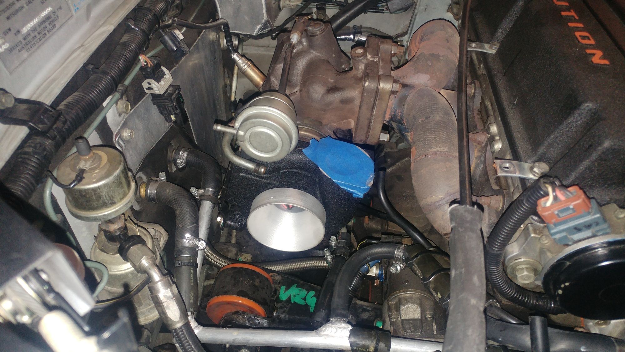

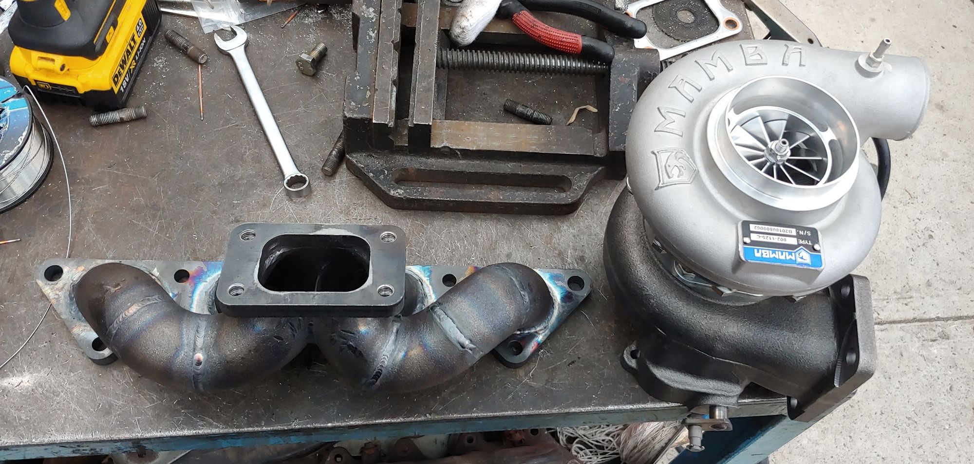

GTX3076R
Bosch 2200cc
Walbro 525

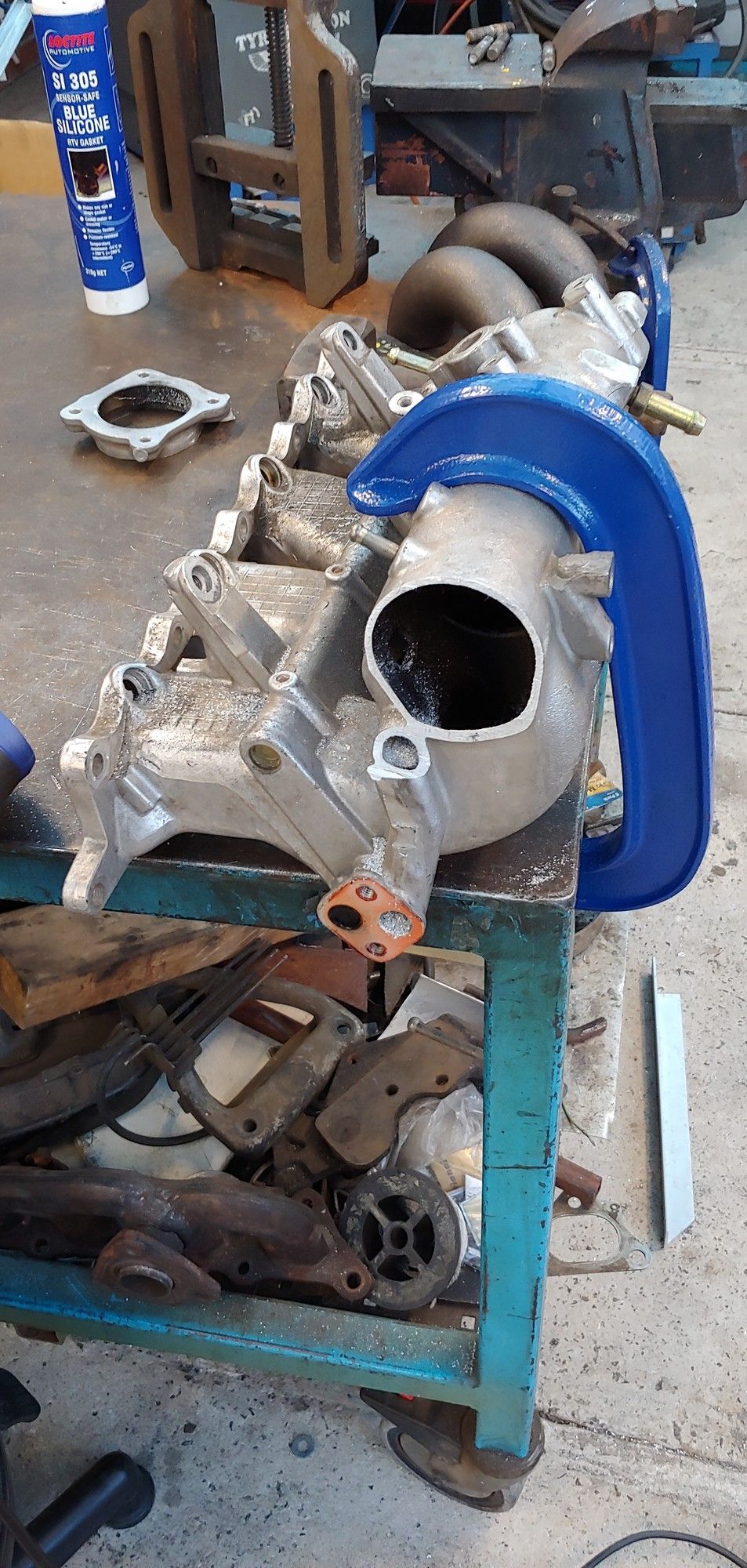

Intake flip

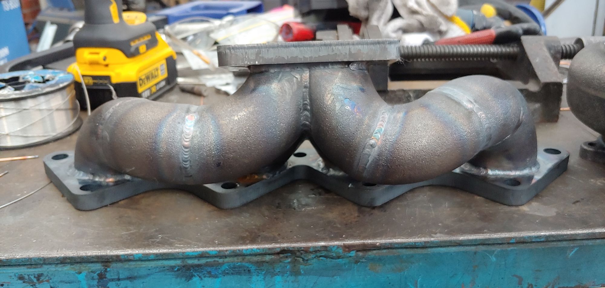

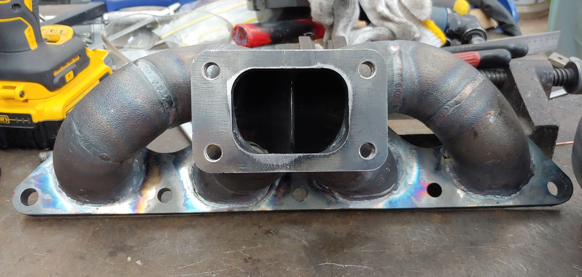

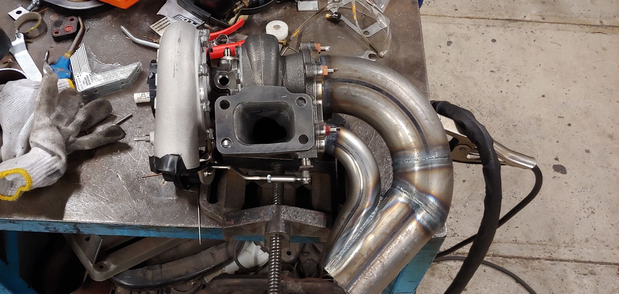

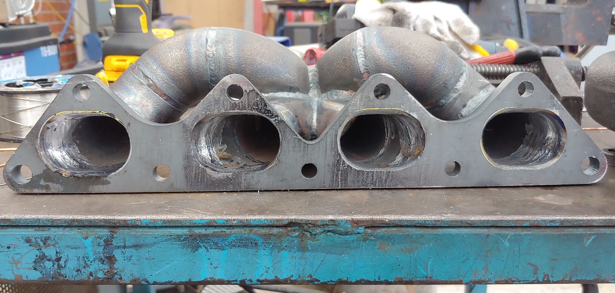

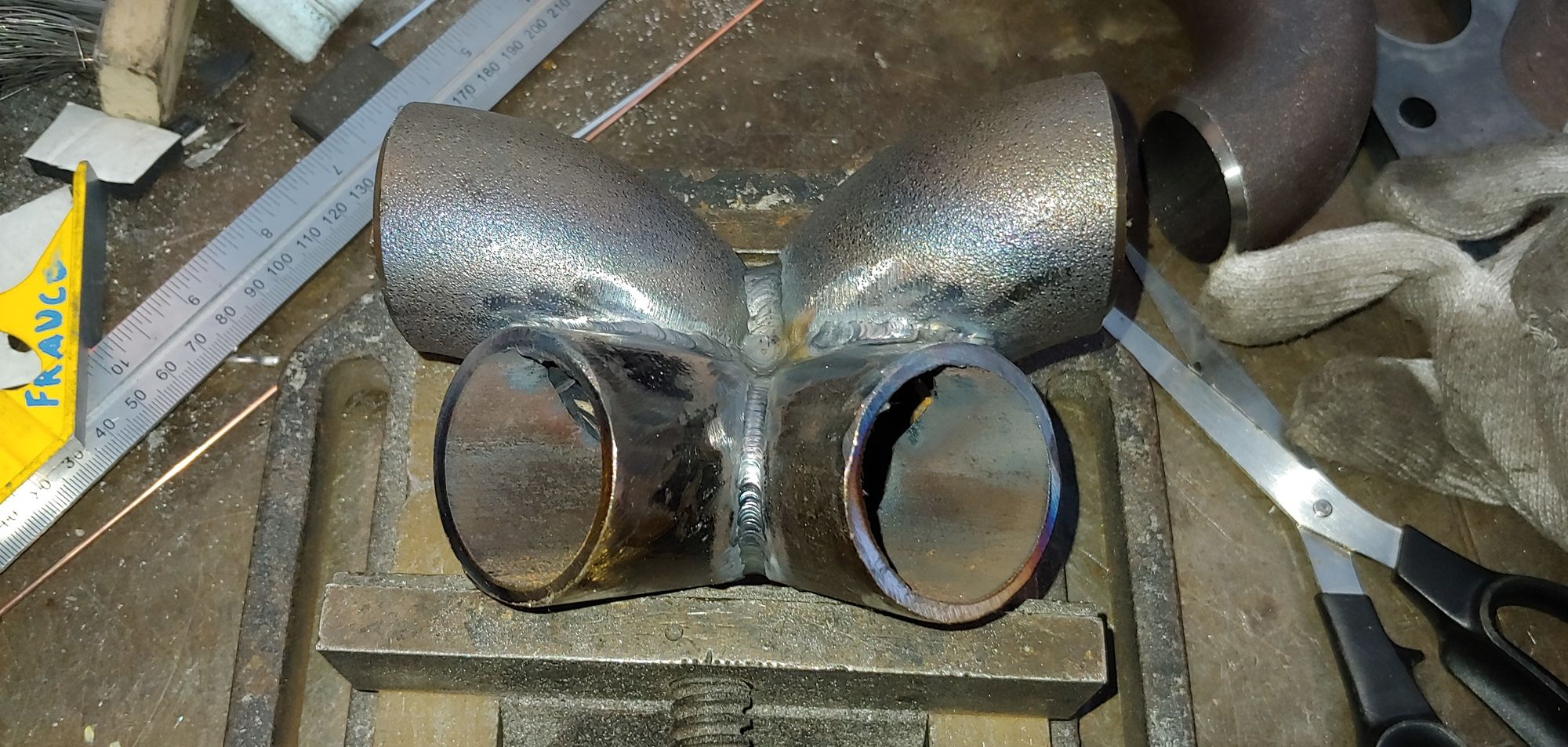

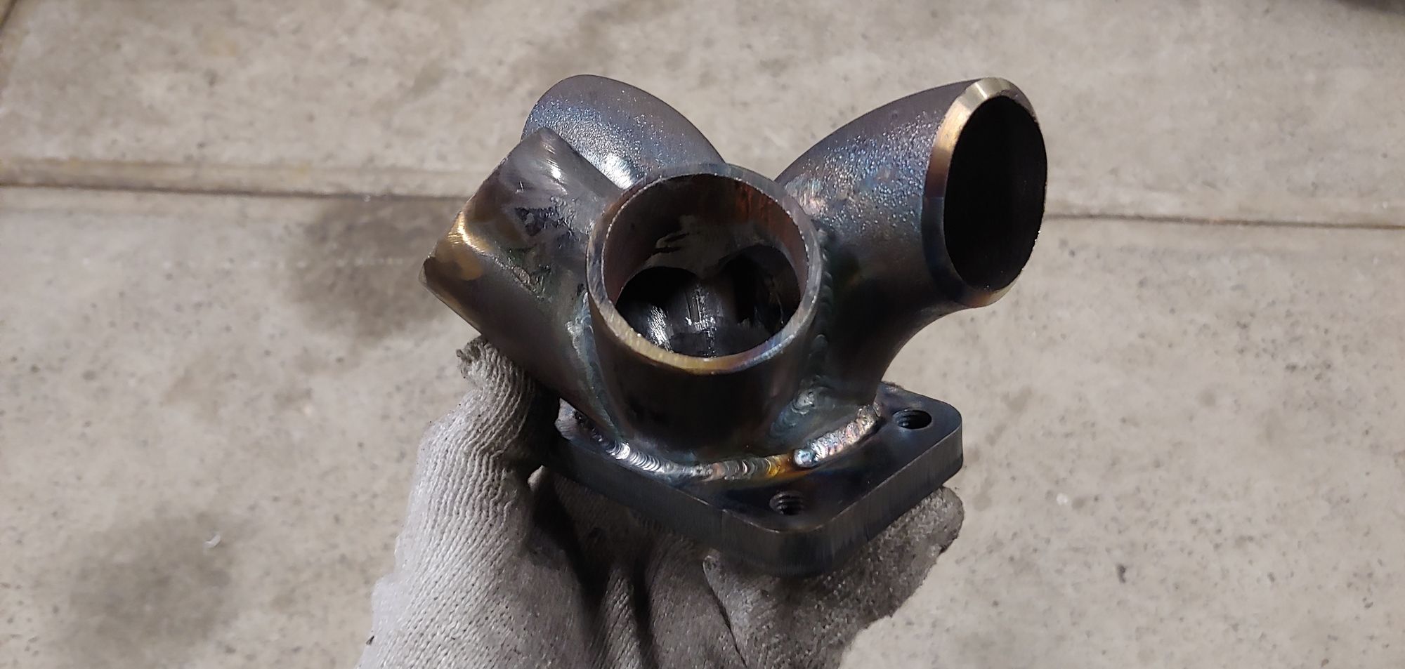

Custom steam pipe manifold to T3 flange
3.5" split dump

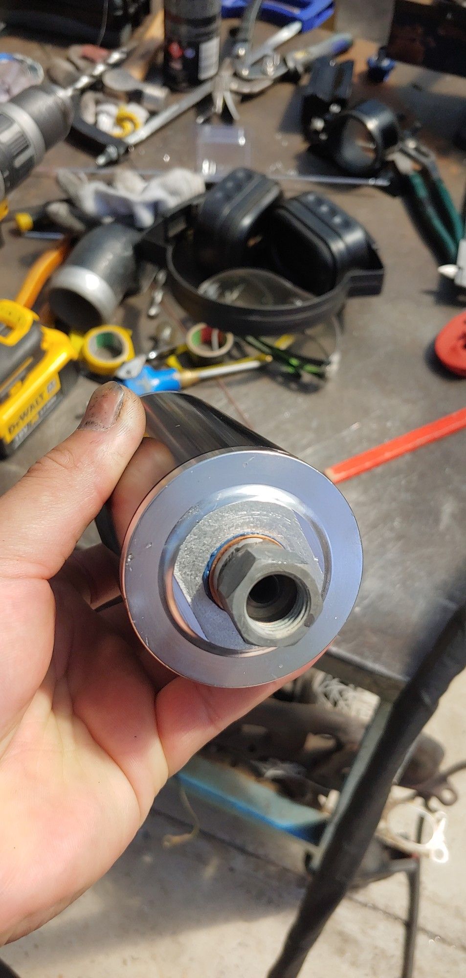

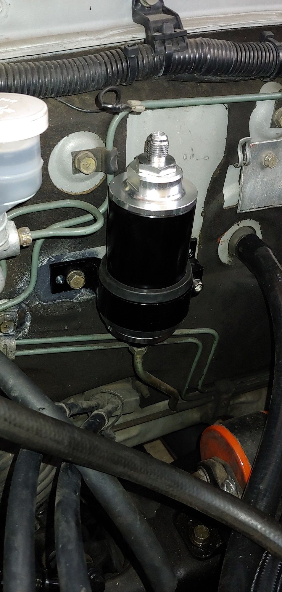

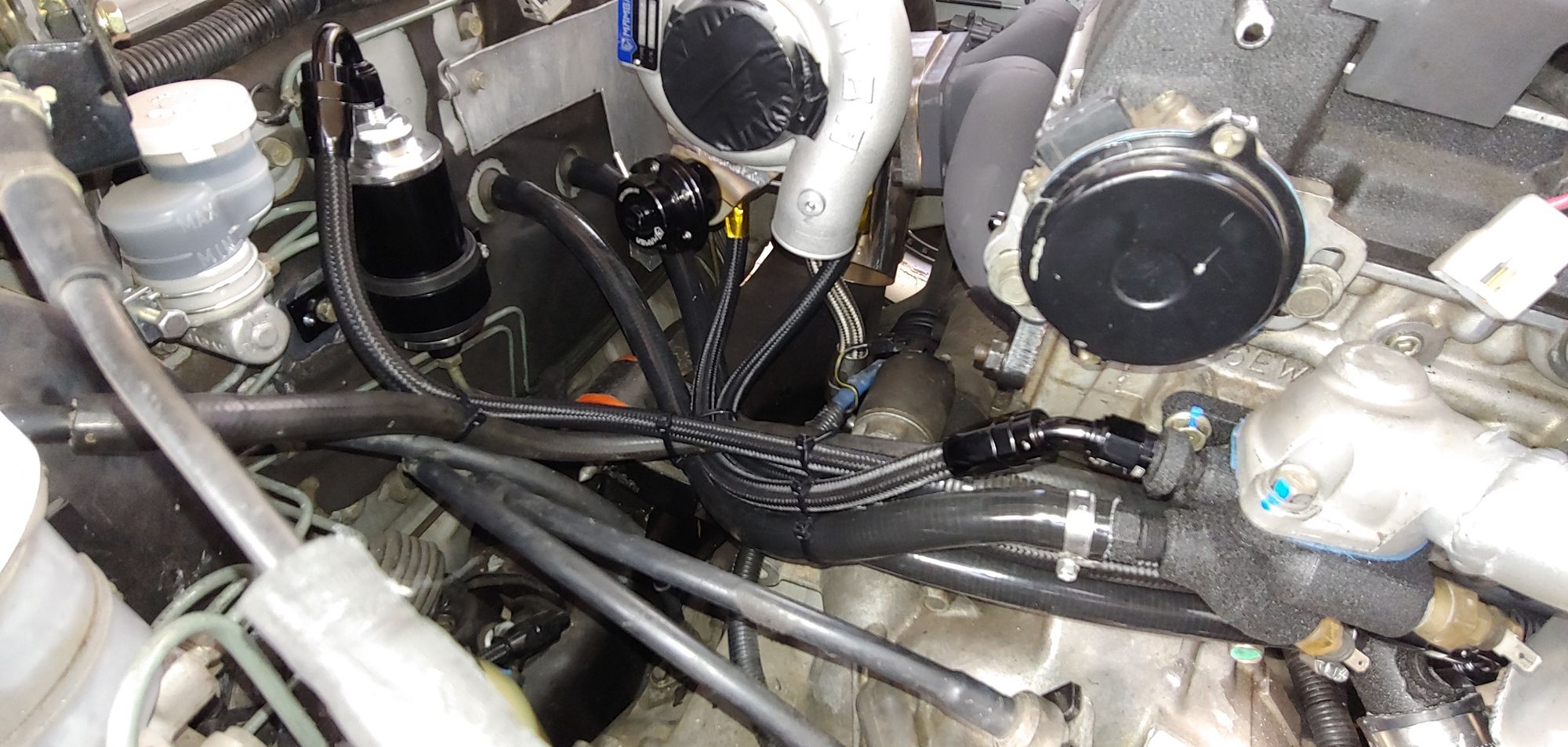

Micron filter in stock position with custom adaptor for stock fuel line, into 6AN fittings

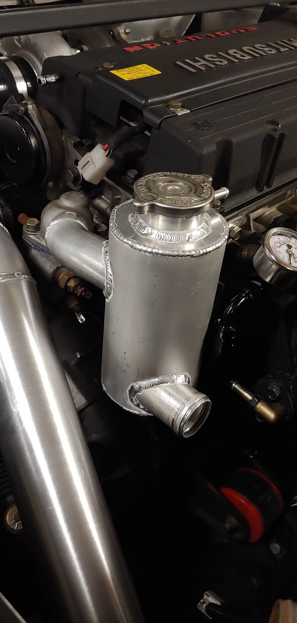

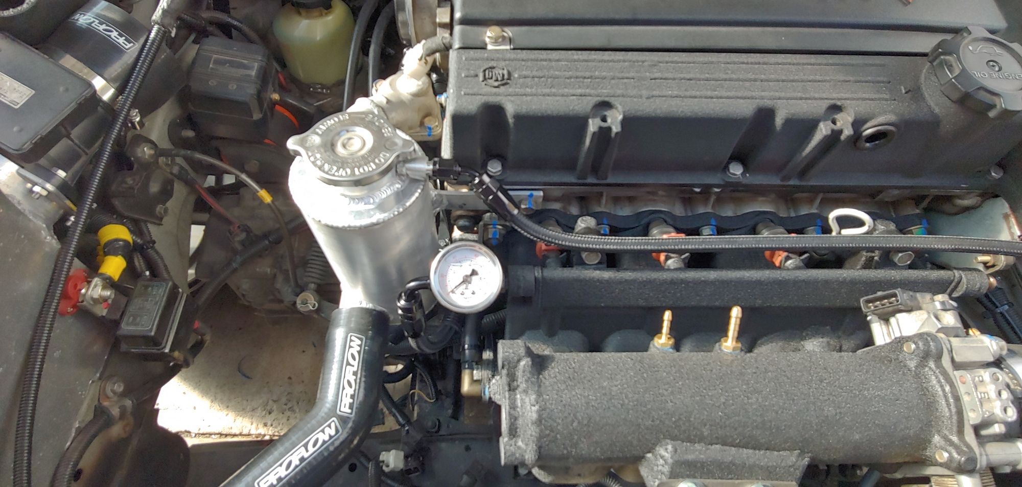

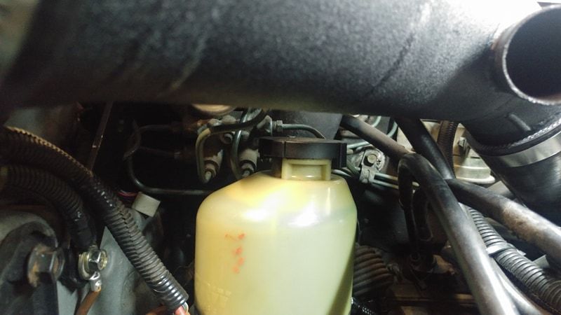

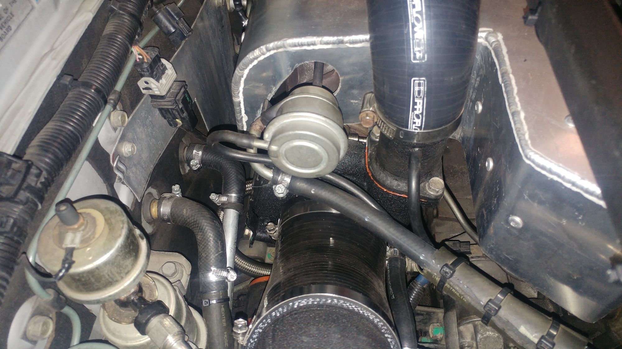

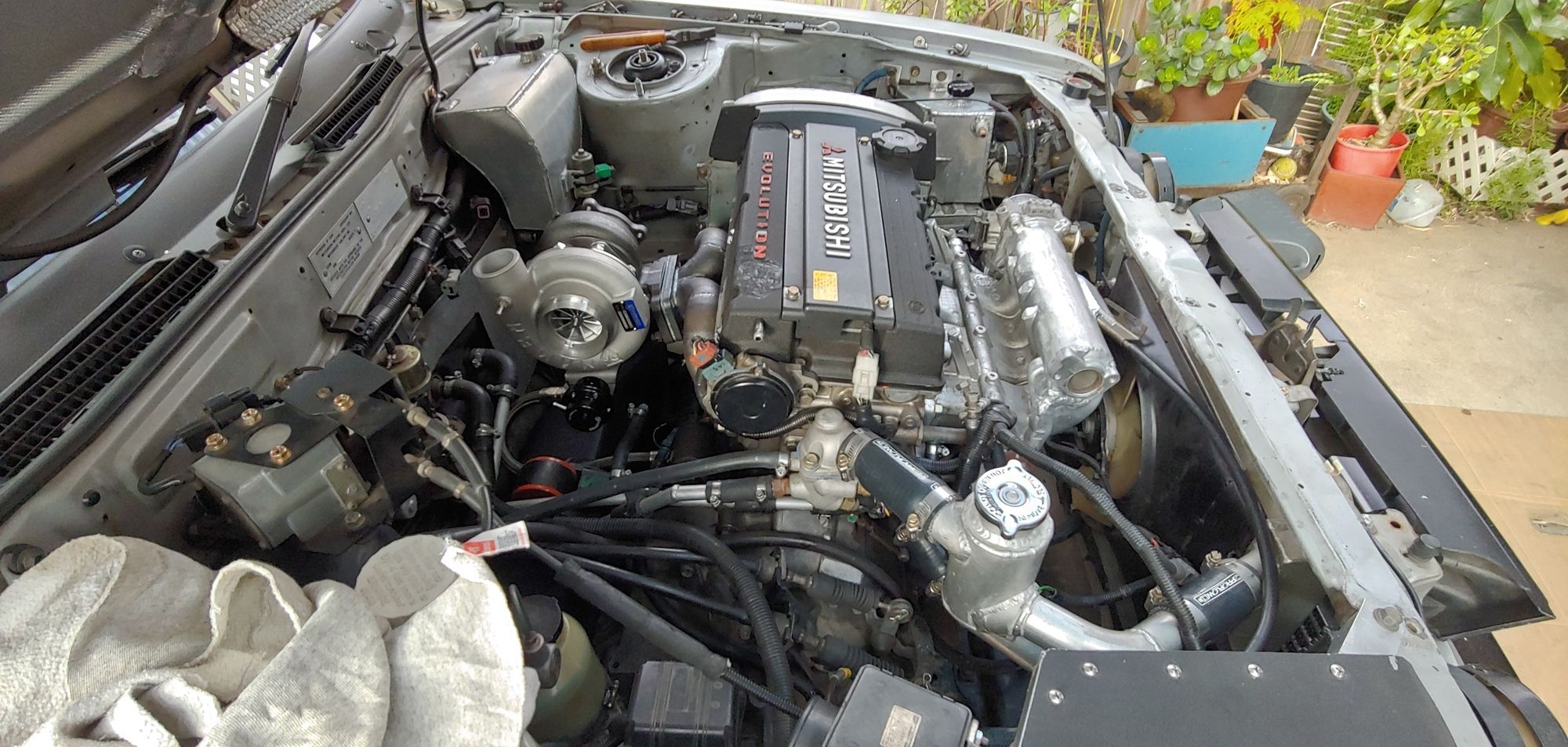

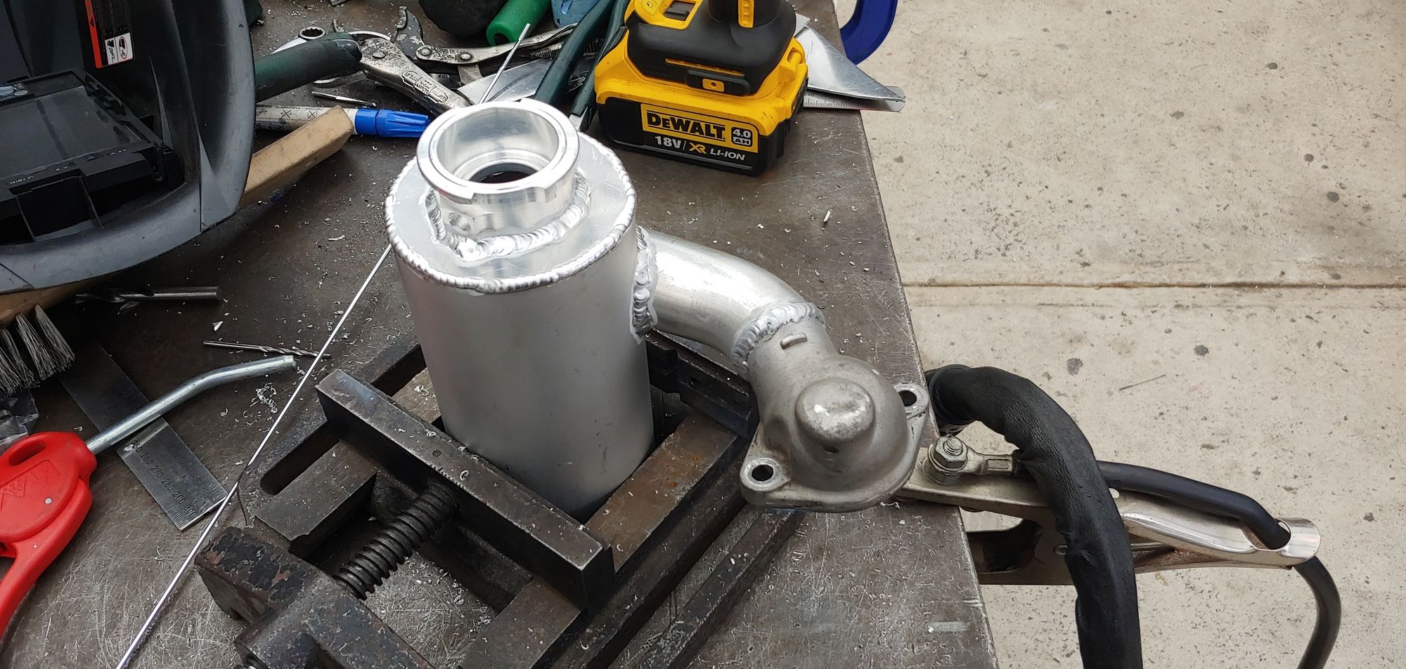

Coolant swirl pot
GTX3076R

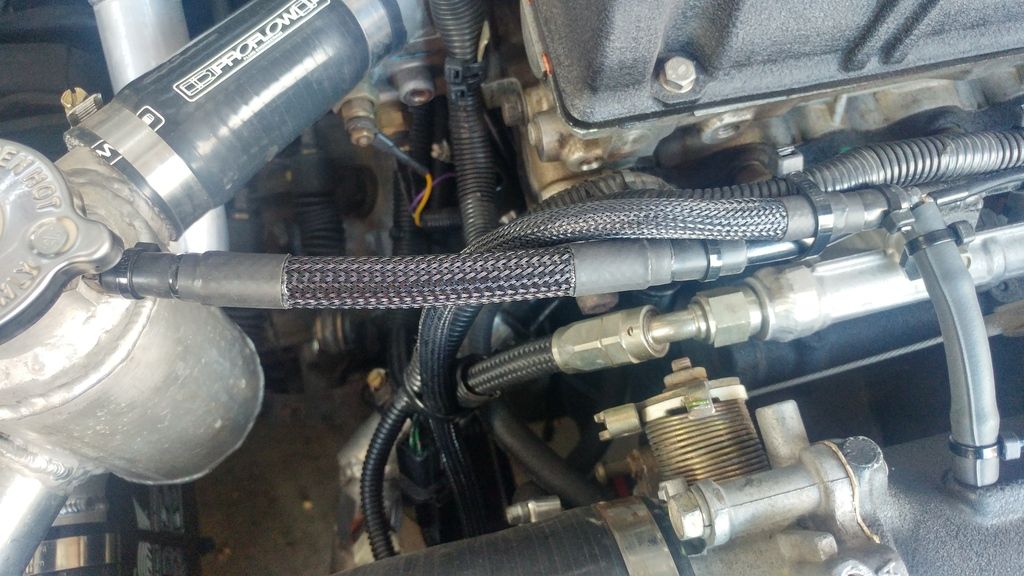

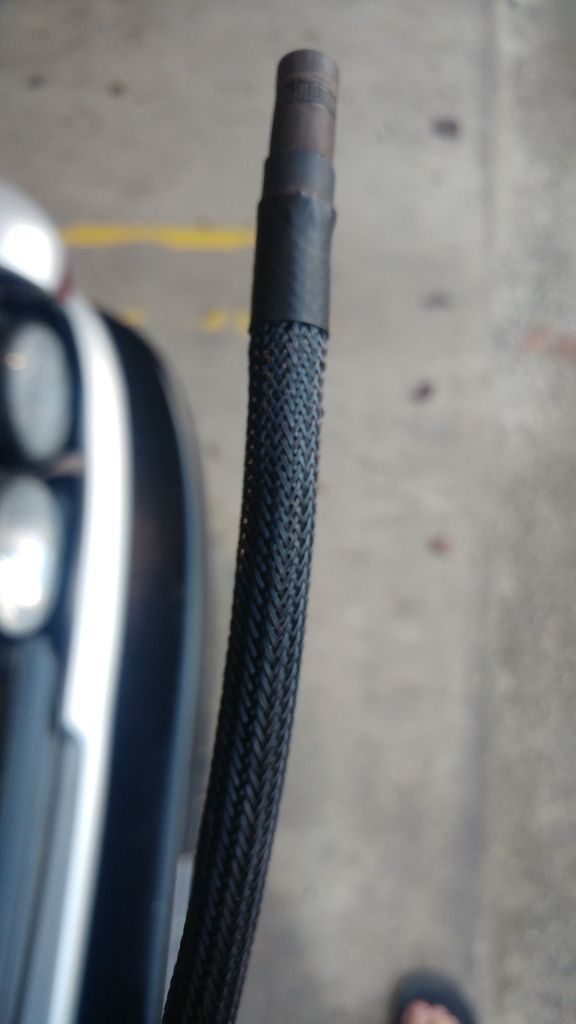

E85 nylon/stainless braided fuel line
Nylon/stainless braided turbo coolant lines
Silicone heater hose

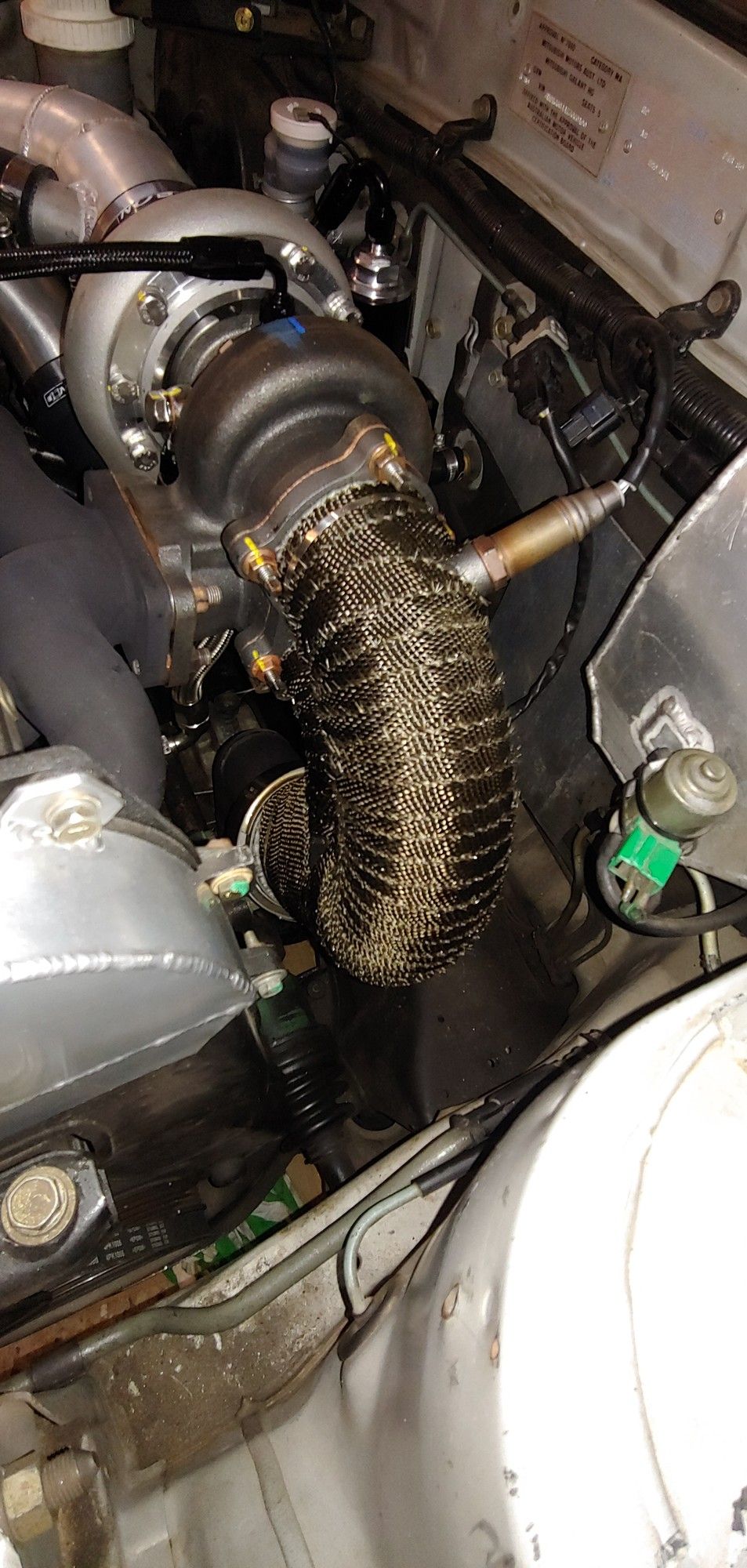

Stainless braided turbo oil supply line

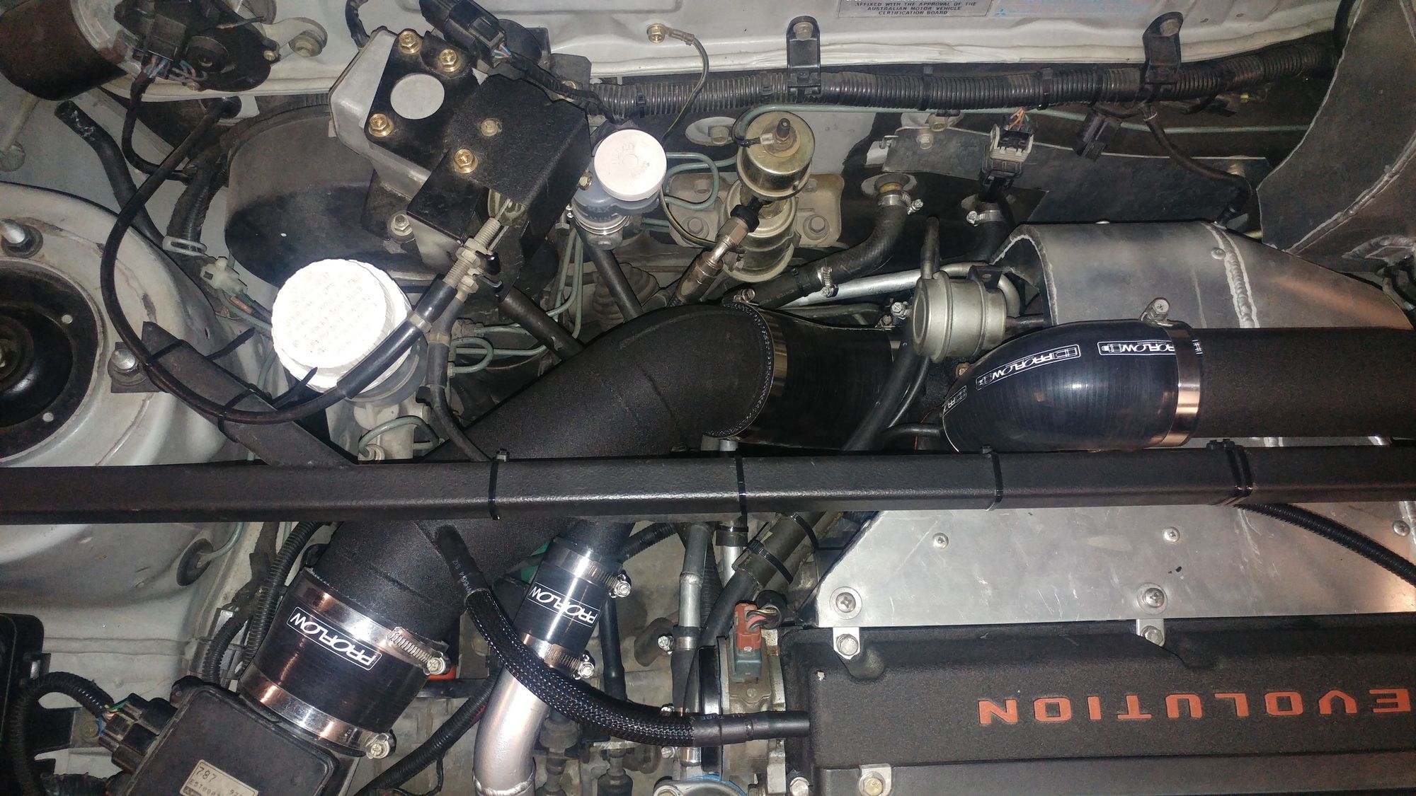

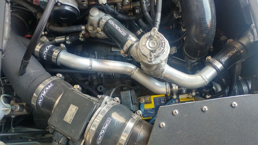

pipes hotside/intake/bov

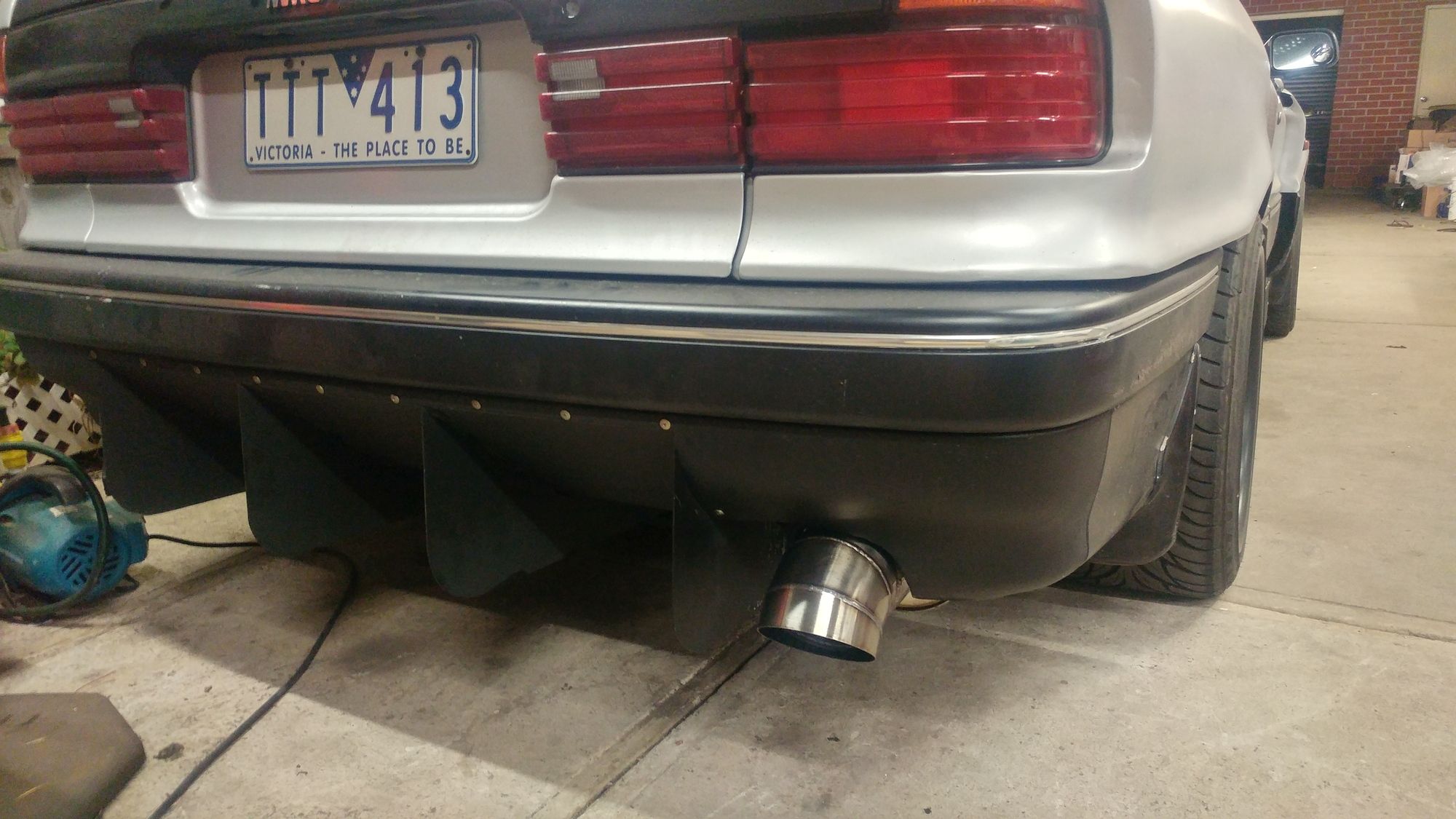

3.5" dump and split 2.5" front pipe (recycled pipes)
damn, love this.
what was happening that you require a coolant swirl pot. or mostly ballin' factor?
Interested in the mamba turbo reliability, I've considered buying one in the past for my focus st and possibly for my eclipse in the future. It's hard to find really any firsthand experience from anyone really pushing one.
He already had one because his radiator is tucked and has no cap. He re did it because he is ocd about attention to detail and he's removing the silicon hoses as much as he can.
I have installed a fair few and haven't had any big issues with them. I will have to admit some of the machining and porting can be a bit average, but nothing that cant be easily fixed. A lot of the budget builds/drift cars down here use their turbo's or parts from them to rebuild/high flow other turbos.
basically what "chrysler kid" said, and also raised it cause the turbo is higher then last set up.
His fabrication level is off the scale. He creates things and makes them work because he is an artist with what he does
