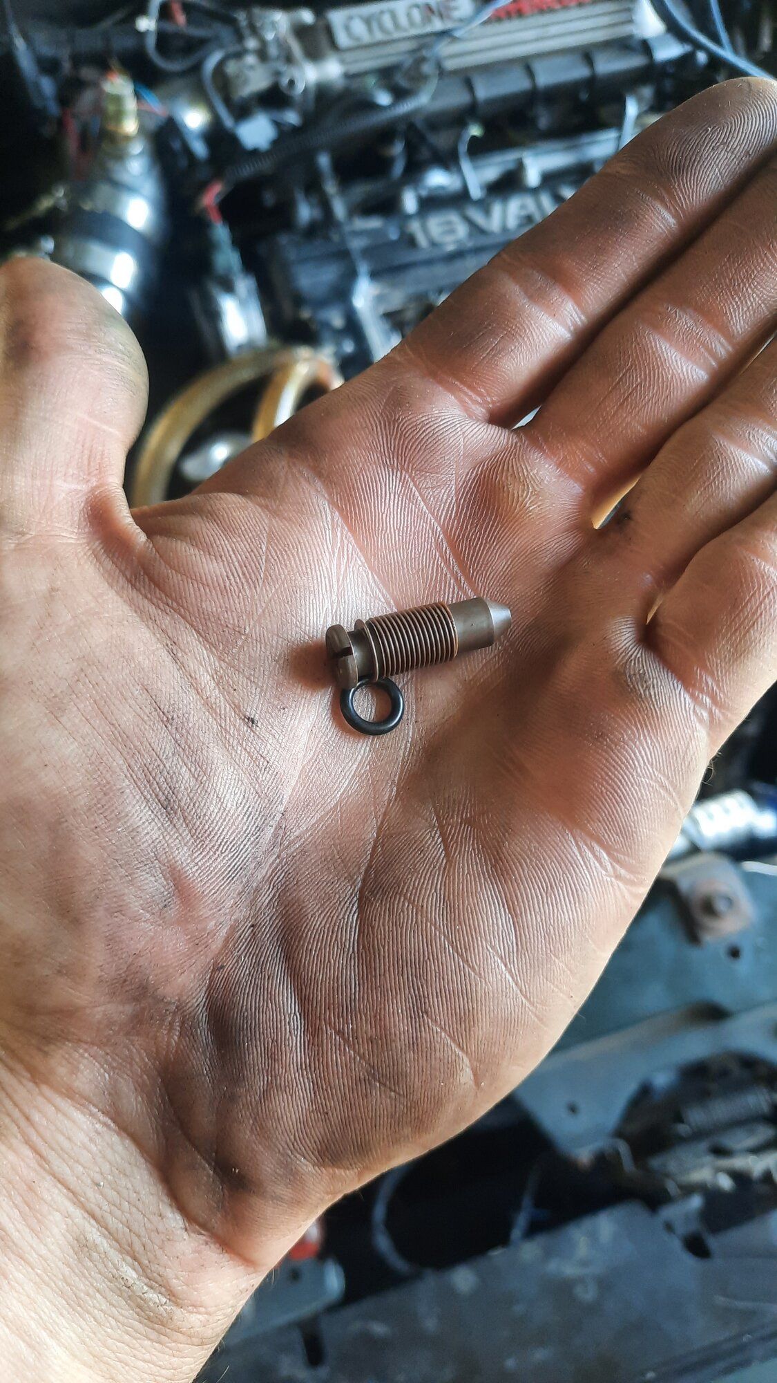

With soft metals like aluminum, your natural strength should be enough. Especially with some type of lube, rotating 2 turns in and one out. Have you ever had a situation where the drill was absolutely necessary? (On a aluminum head)jw
Thinking back, no. The drill seemed a bit excessive at the time, but I never bothered to look up how others were doing it hahaha.
Well, disclaimer for anyone reading: don't test your luck with using a drill like I did.
I've done this on eight + DSM's, and I replace every exhaust stud, never had any issues except for what I mentioned LOL.
Guess doing it by hand is the preferred way?
You literally just said doing it that has given you problems, but you recommend it to others? How do you feel confident enough to tell someone to do something like that? It boggles the mind, honestly.
YES, turning by hand is preferred for hand taps.

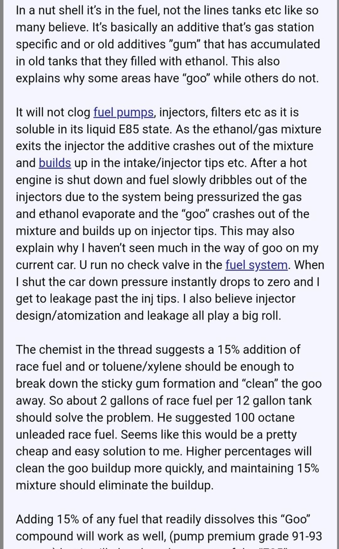

Most ppl will say that the goo is from factory rubber fuel lines that weren't meant for e85. Others claim to be running e85 on factory lines for 10+ years and NEVER see e85 goo. Here's some info that you can believe or not haha I'm still not sure what I think.

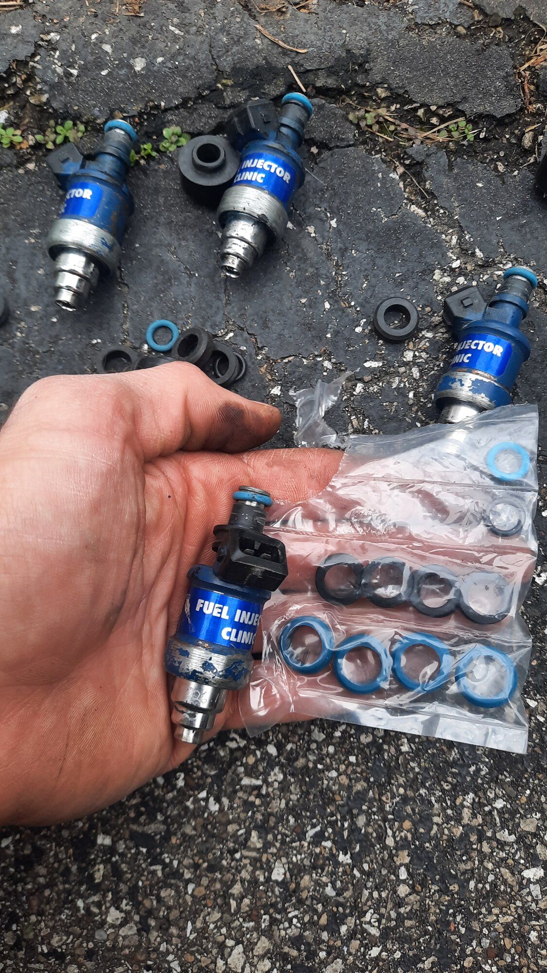

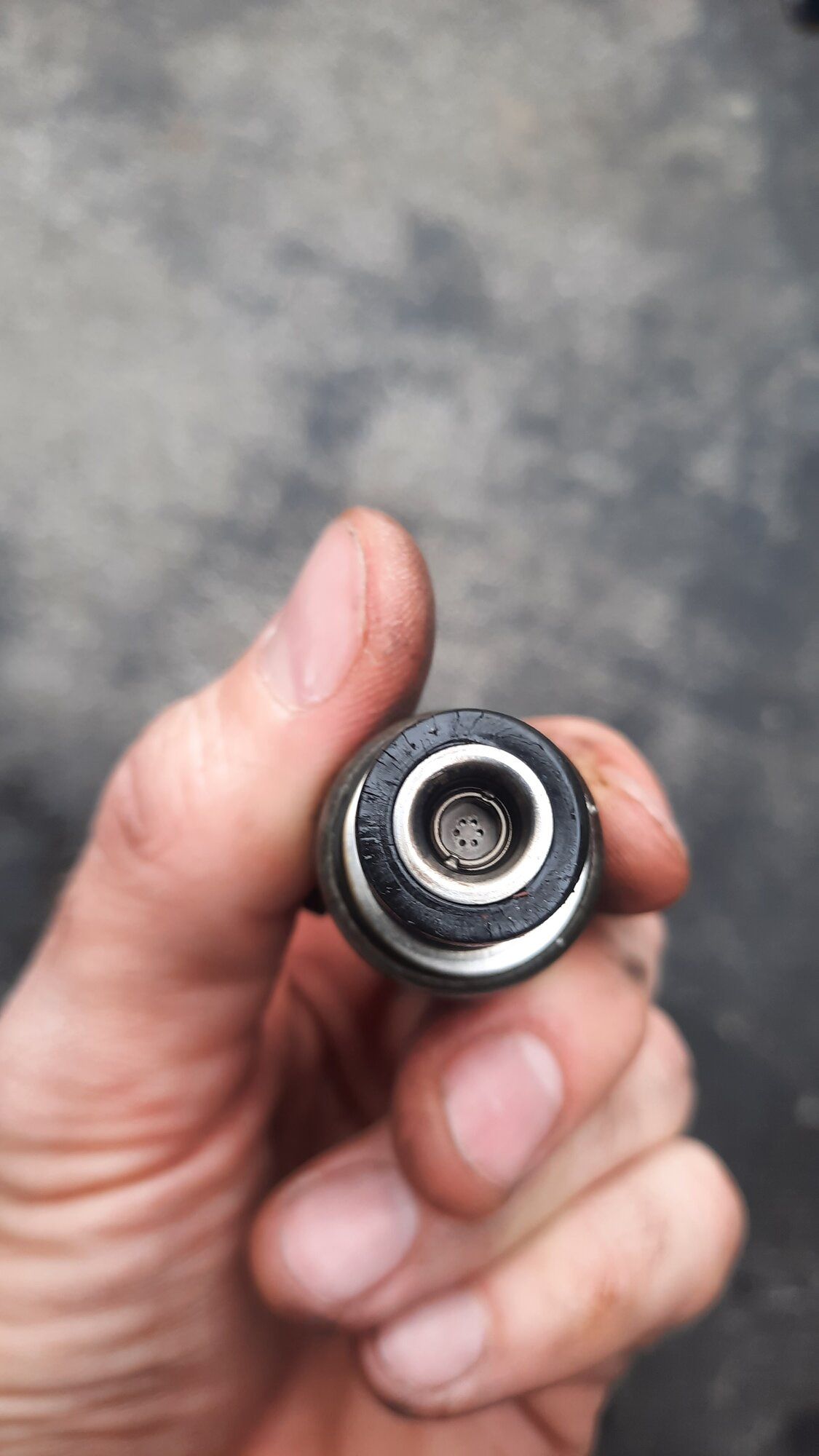

We aren't going to have to wait until spring to check how they look with the 50/50 e85/unleaded mix tho, cause I pulled the injectors today in order to install some 12+yr old fic 1250s. The 850s were running too high idc even with the mix and I want to run full e85 in the summer. I also had my base fuel pressure set to 50psi to help the 850s out and I didn't care for that either.
When I first tried starting the car it wouldn't. When we cleaned and flowed these injectors 2 months ago, they weren't opening at first. I chalked it up as a loss and figured it was cause they've sat in the garage for the past 11yrs. Well thankfully another car buddy was there and he took a screwdriver and started tapping on the injectors with it. One by one they opened up and started flowing 😄. Well they've sat again for the past 2 months and I guess they just needed a little tap again cause once I did that she fired right up and idled on its own 😲🙌
850s look clean af. The unleaded gas works for sure.

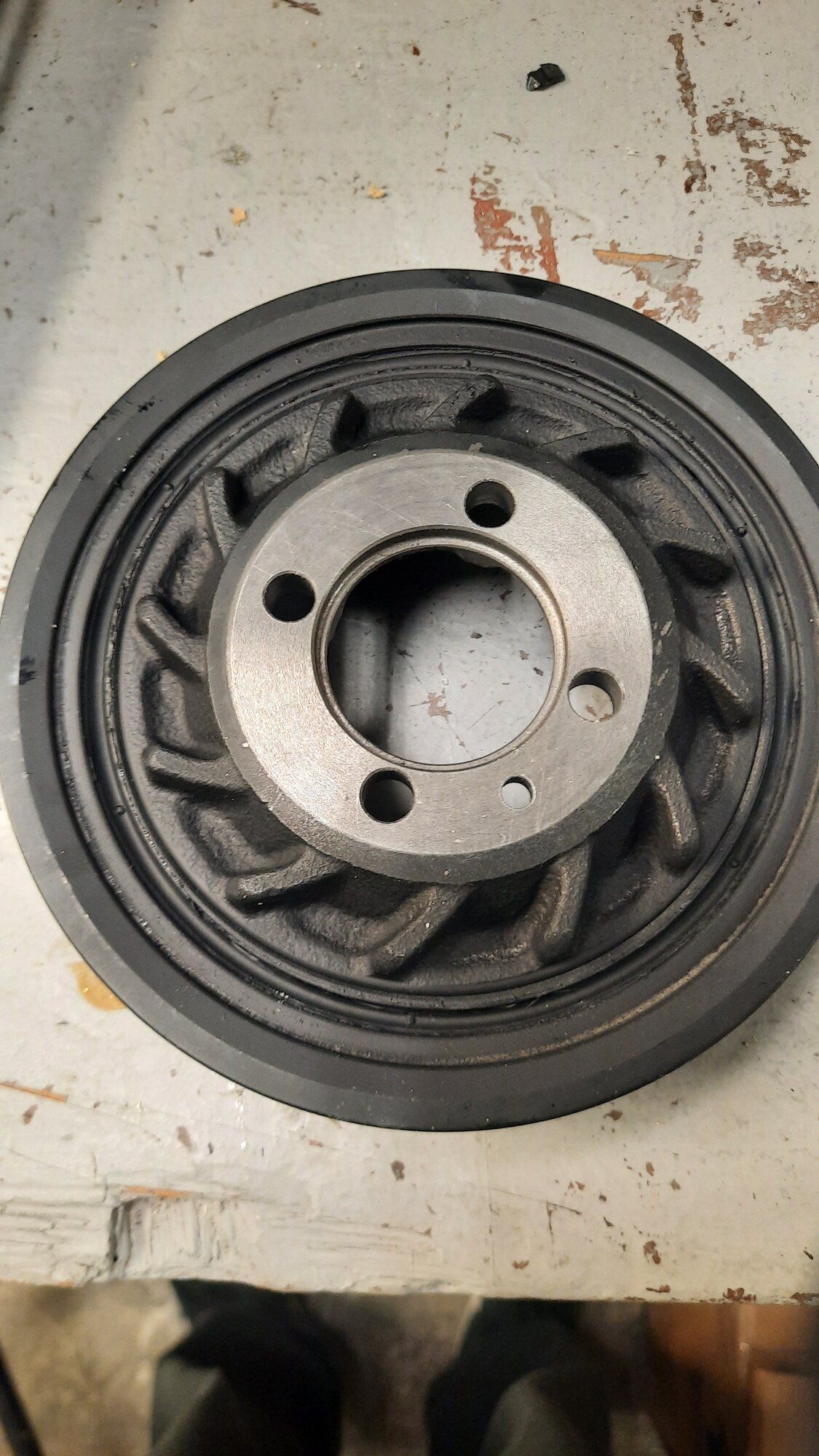

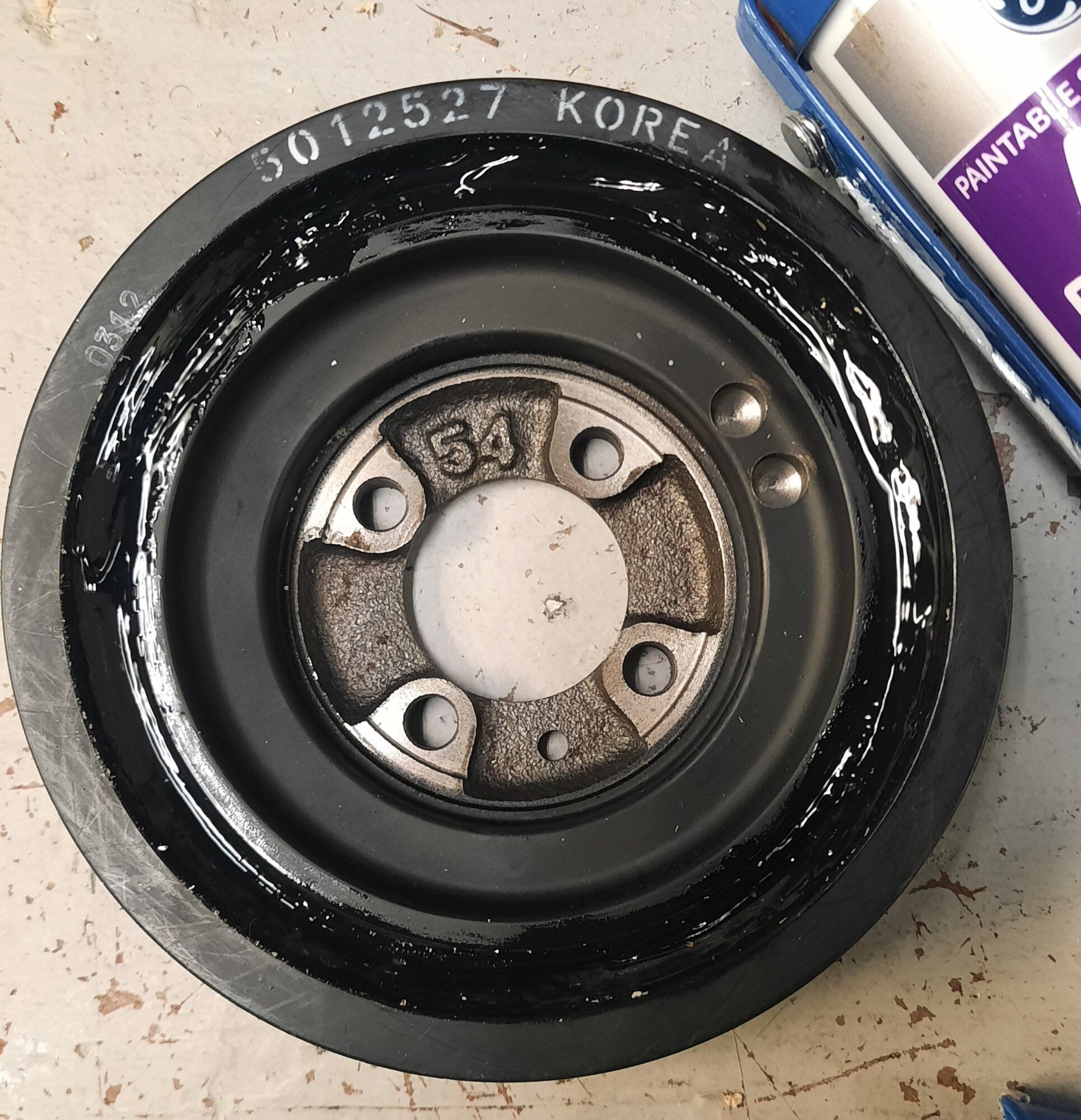

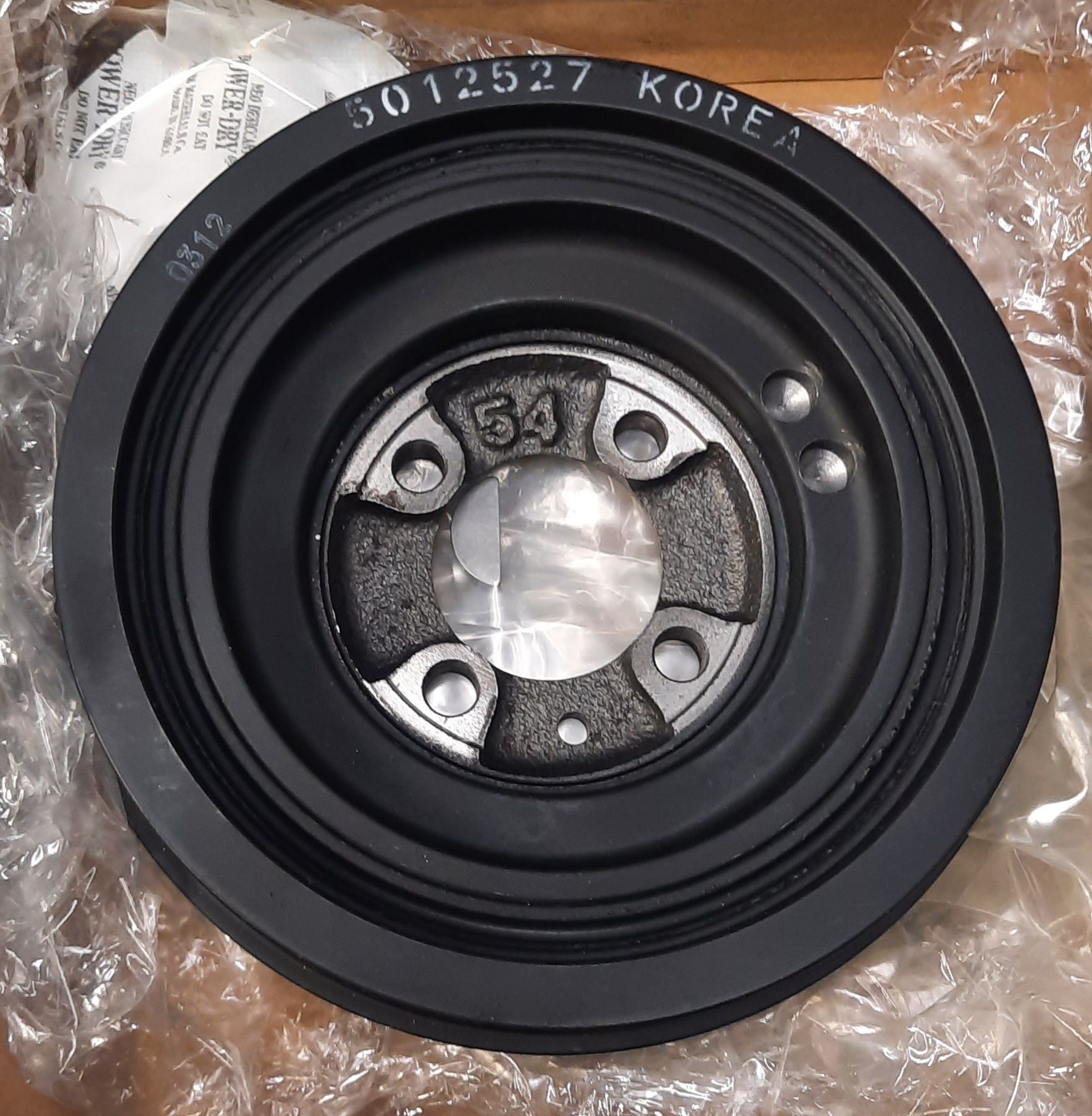

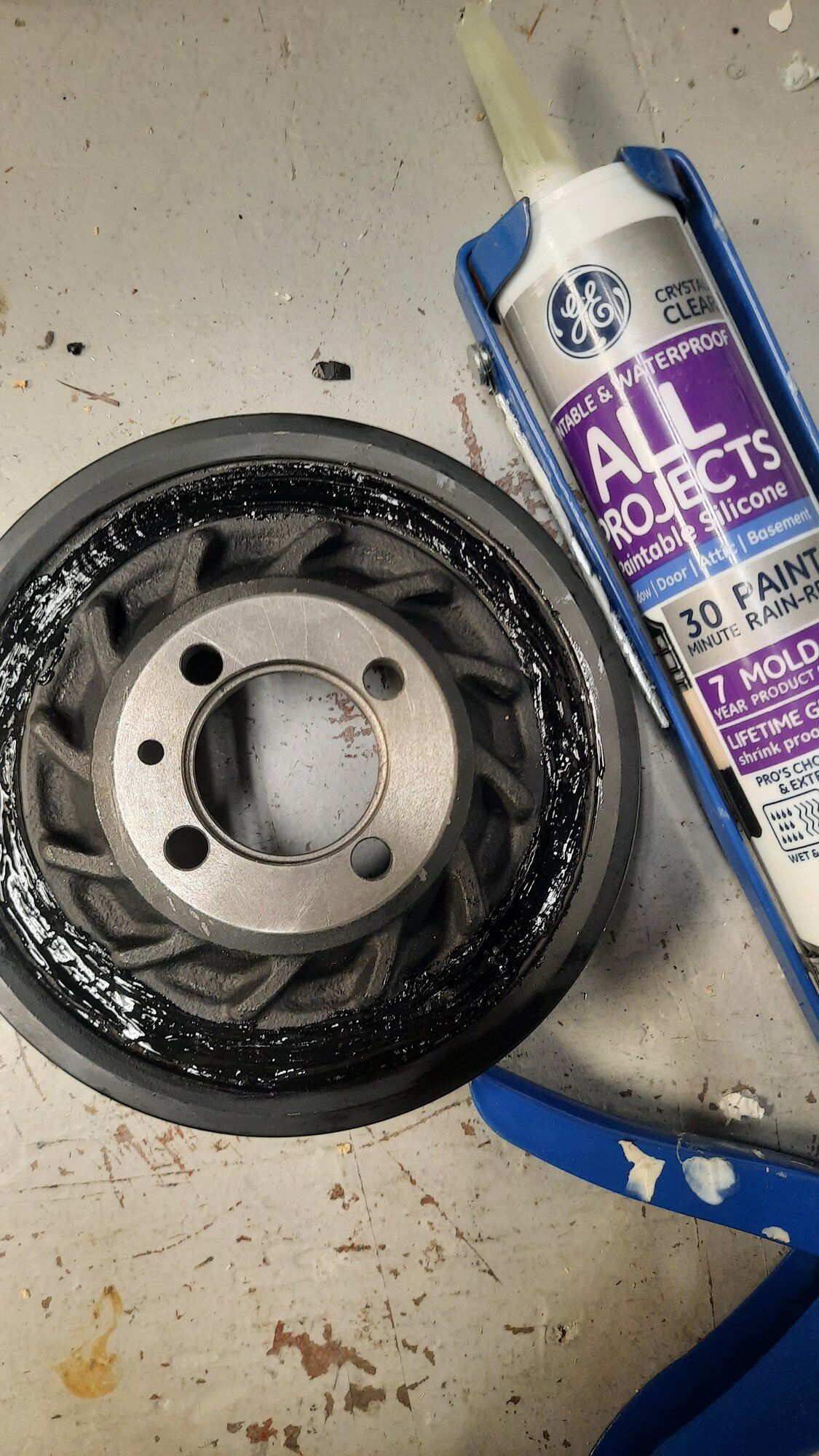

Current order of business for the galant is replacing the old damper pulley. I picked up this bnib ATP brand (pn: 102082) damper off ebay for $35 shipped. I've read horror stories about the autozone brands coming apart on ppl even when new, but I don't have $400 for a new fluiddamper so what did I do?...what any real dsmer does haha, I improvised.
Remember this is a harmonic DAMPER, not a balancer. Yeah I changed it a little but I'm not worried about it. If my crank breaks down the road then I'll acknowledge this was a poor decision LOL but I think it will be just fine 👌

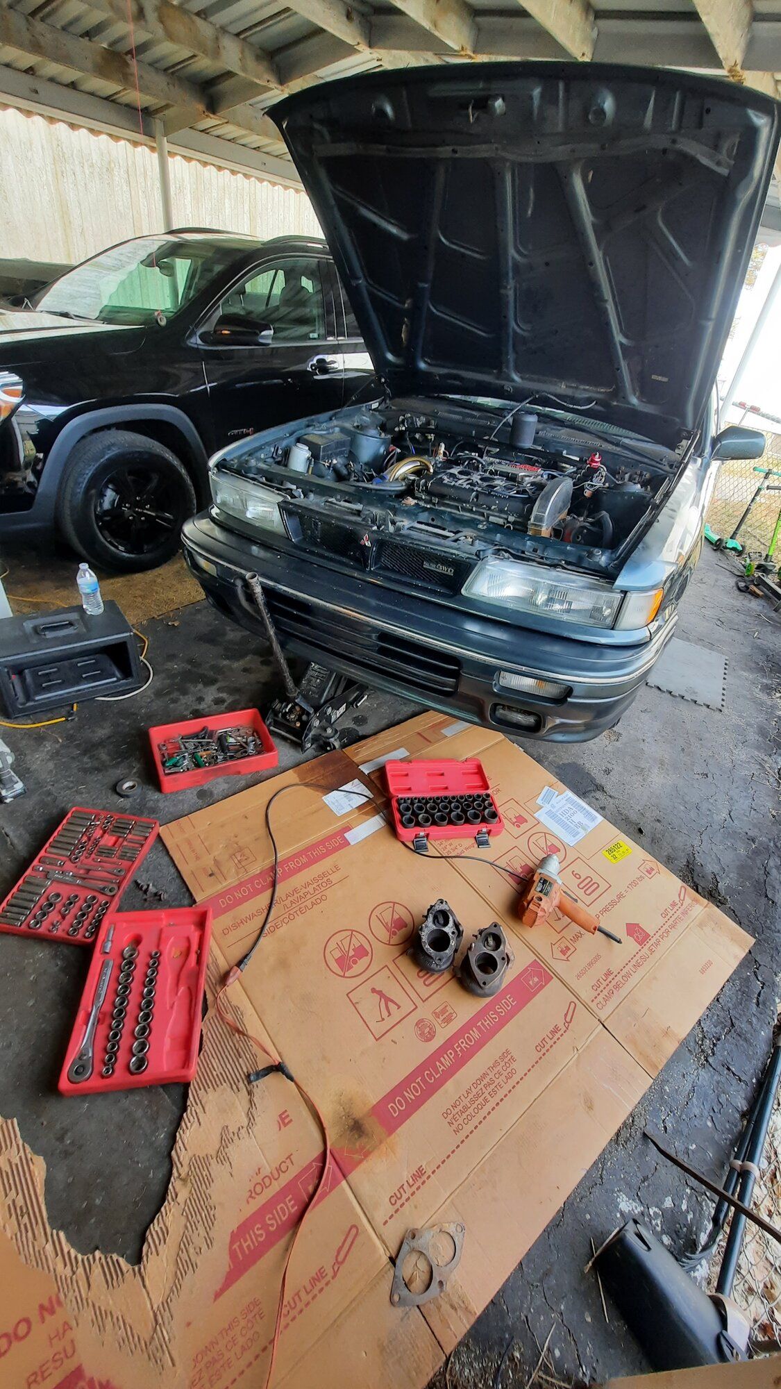

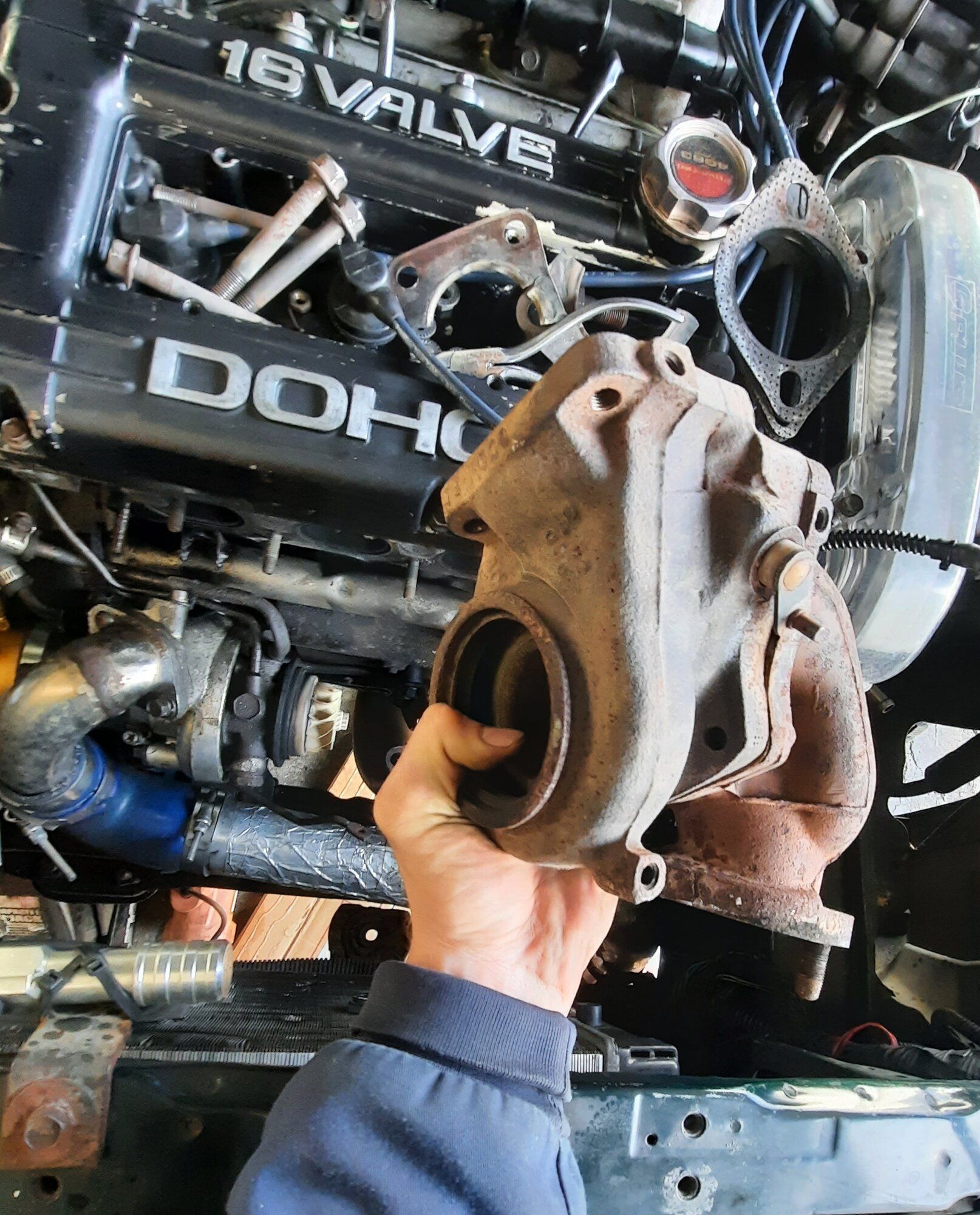

Well, the good weather coming all week and day off work today got to me and I started messing with the galant. Decided to swap swap 6cm turbine housing on the mhi16g back to the 7cm housing. Of course have to do some more cleanup while in there. On to pics
6cm housing off

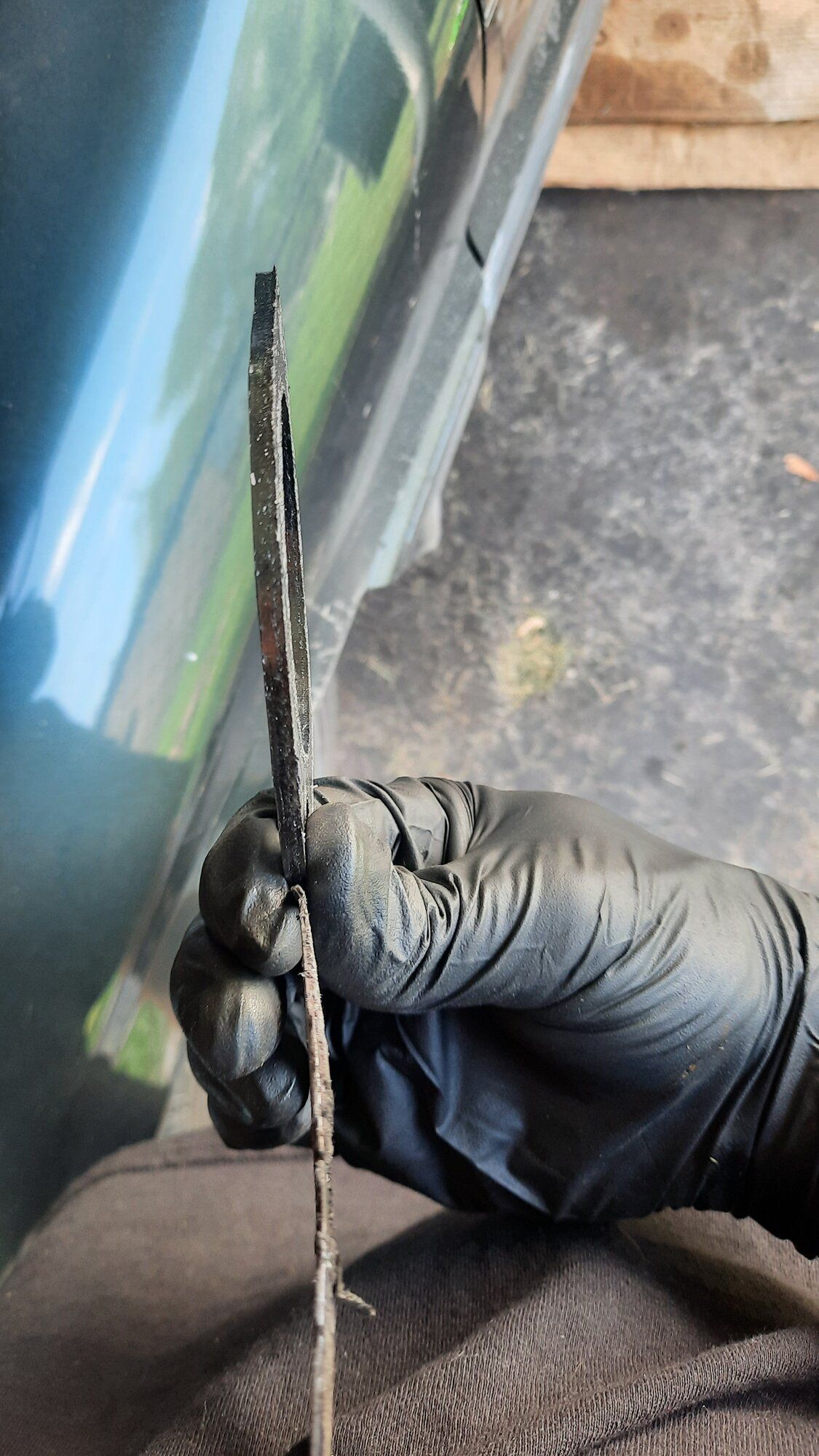

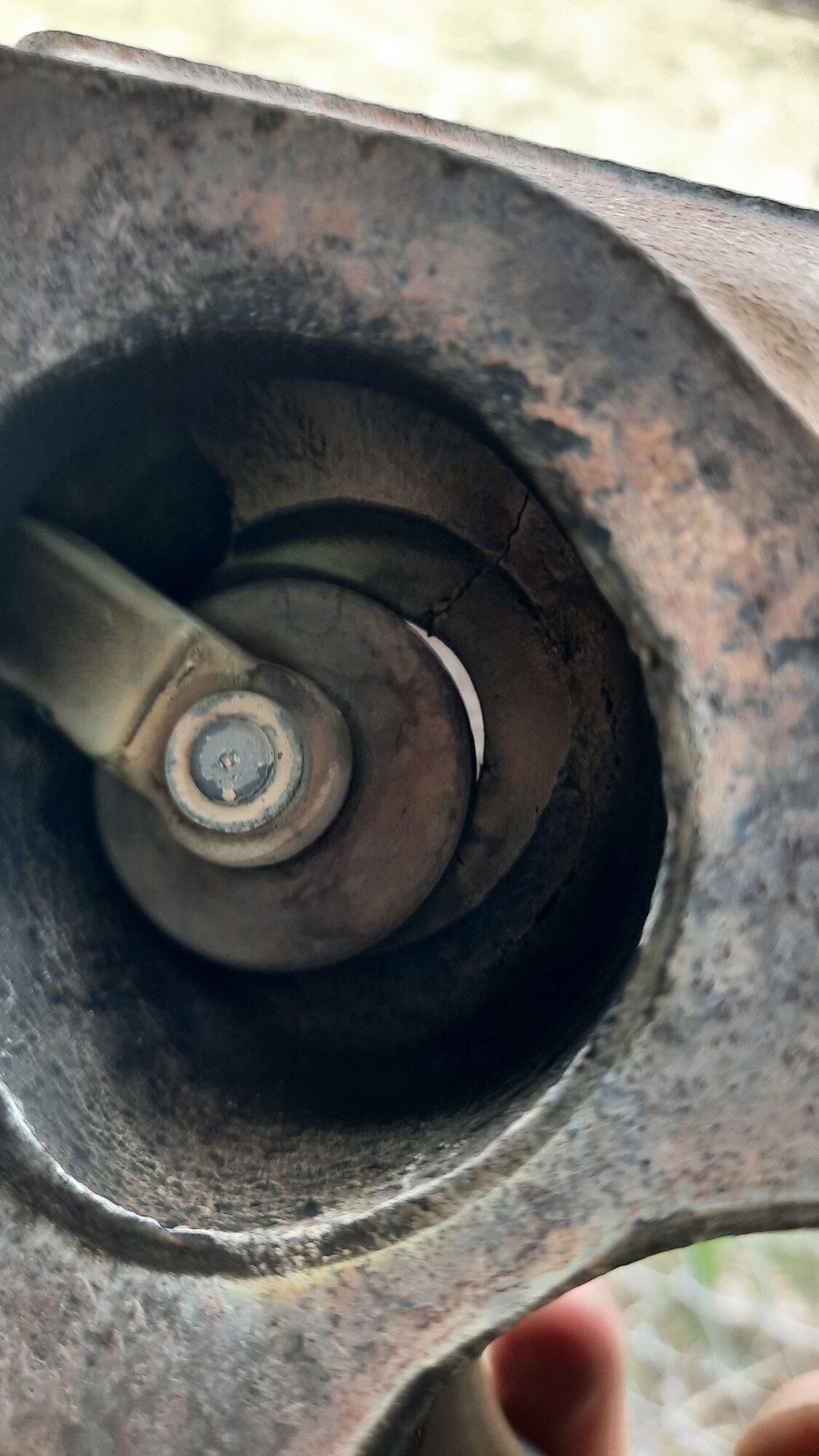

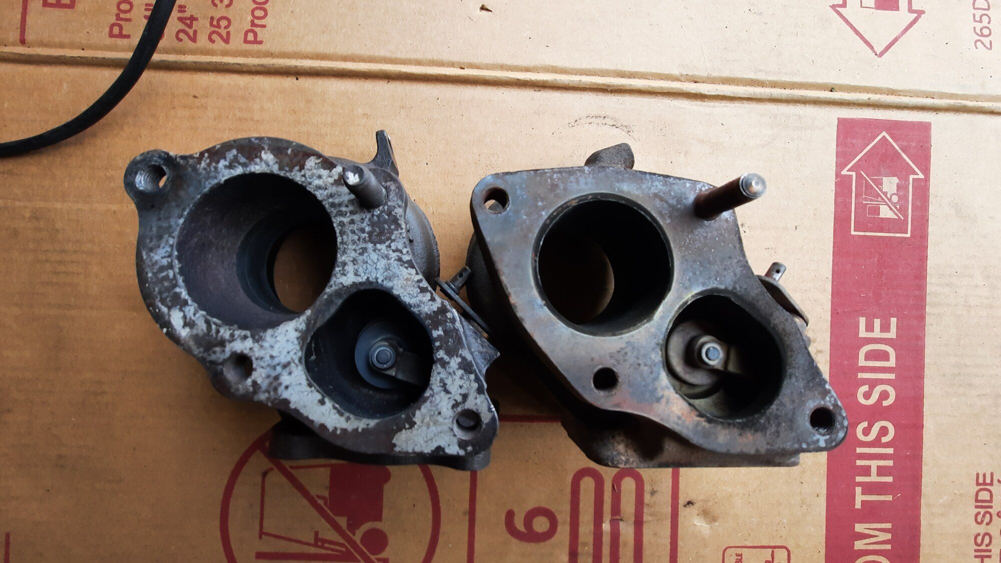

Wastegate flapper was.... bent?

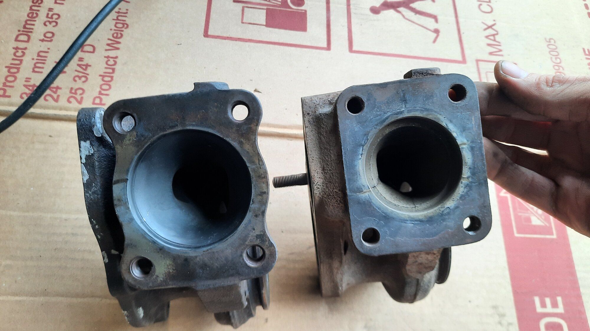

7cm/6cm turbine housing comparison

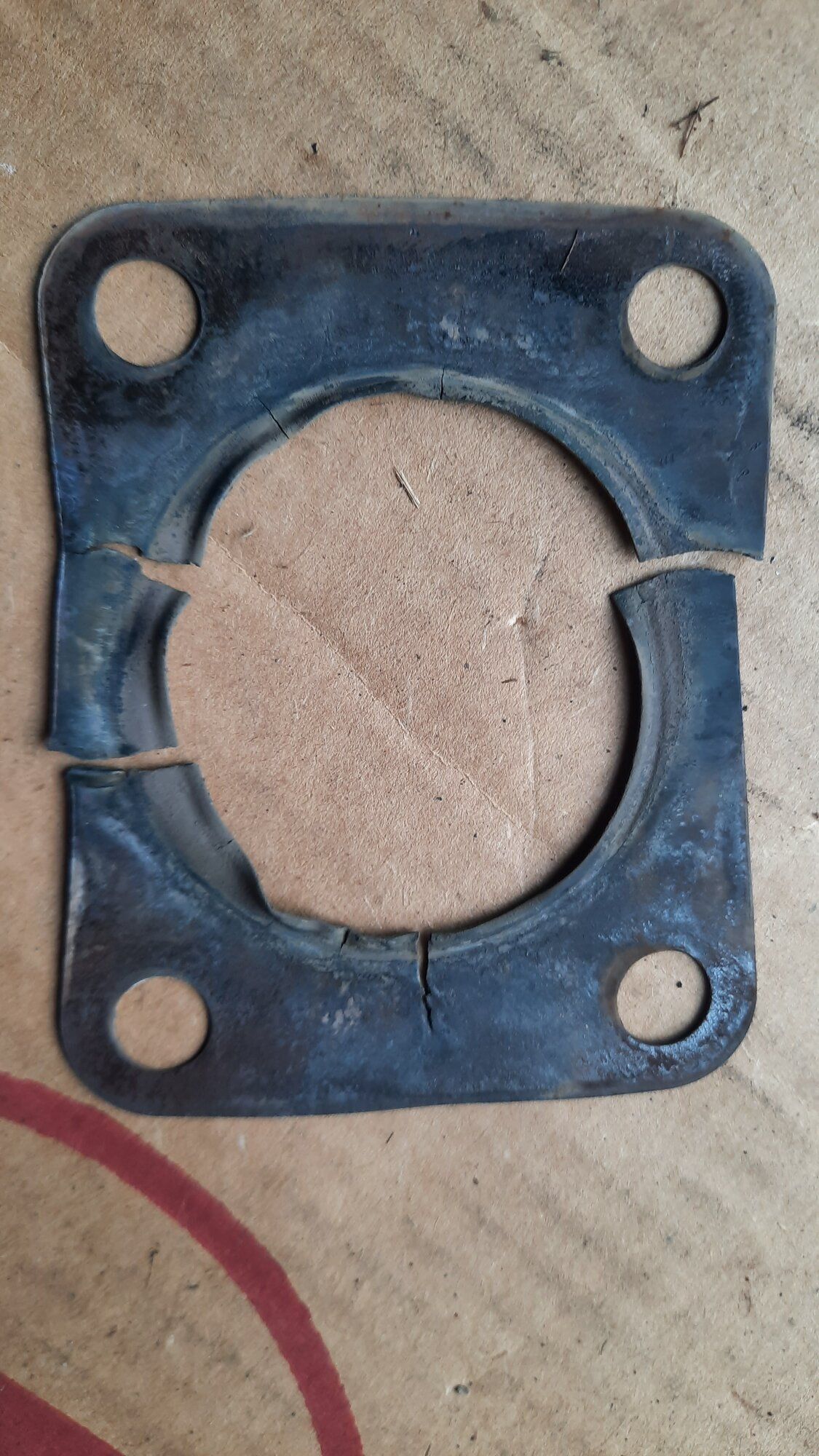

Had a broken mani to turbo gasket

When you put the housing back, it'll press that cap back and it won't touch the fins. I've never seen yellow propellers
Ahhh sweet makes sense. And yeah... I just ran seafoam through the intake about 5 miles before I took it apart. It was still smoking when I parked it I assume it's the seafoam cause the turbine wheel wasn't that color last time I pulled it.

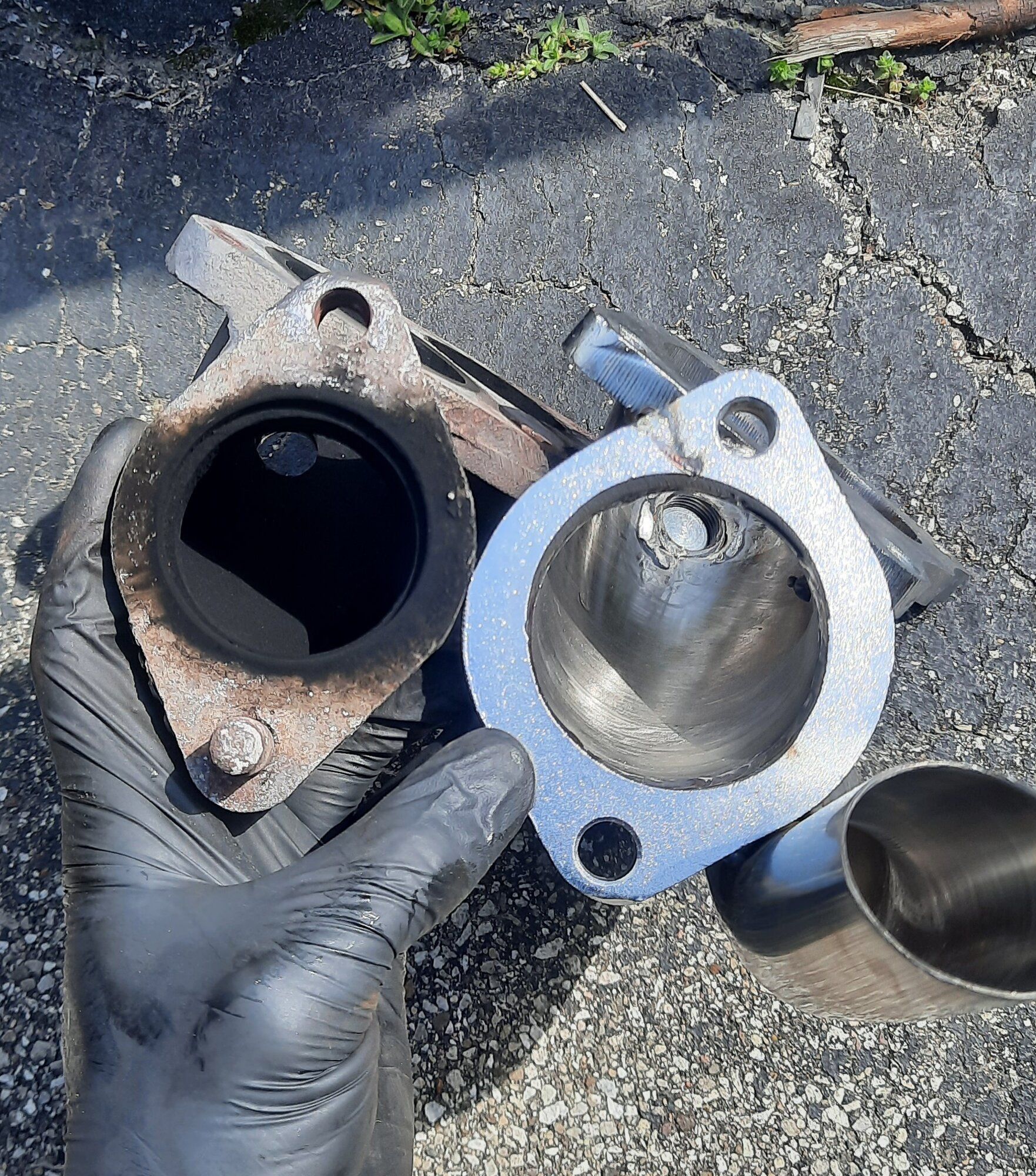

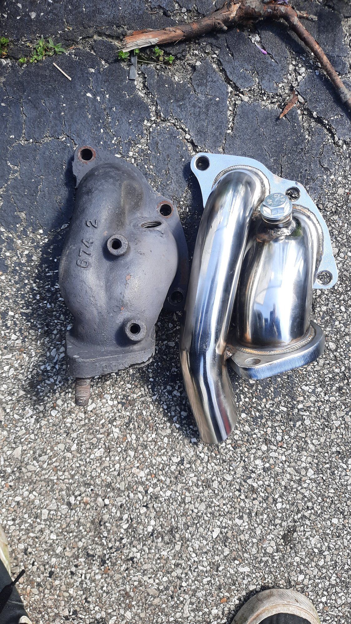

Replaced my factory o2 housing with this o2 dump I bought from ebay for $90 with gaskets. The fit is perfect 🙌 but I had to come up with new hardware and the install was kinda shitty because of that.20220426_171941.jpg20220426_171916.jpg

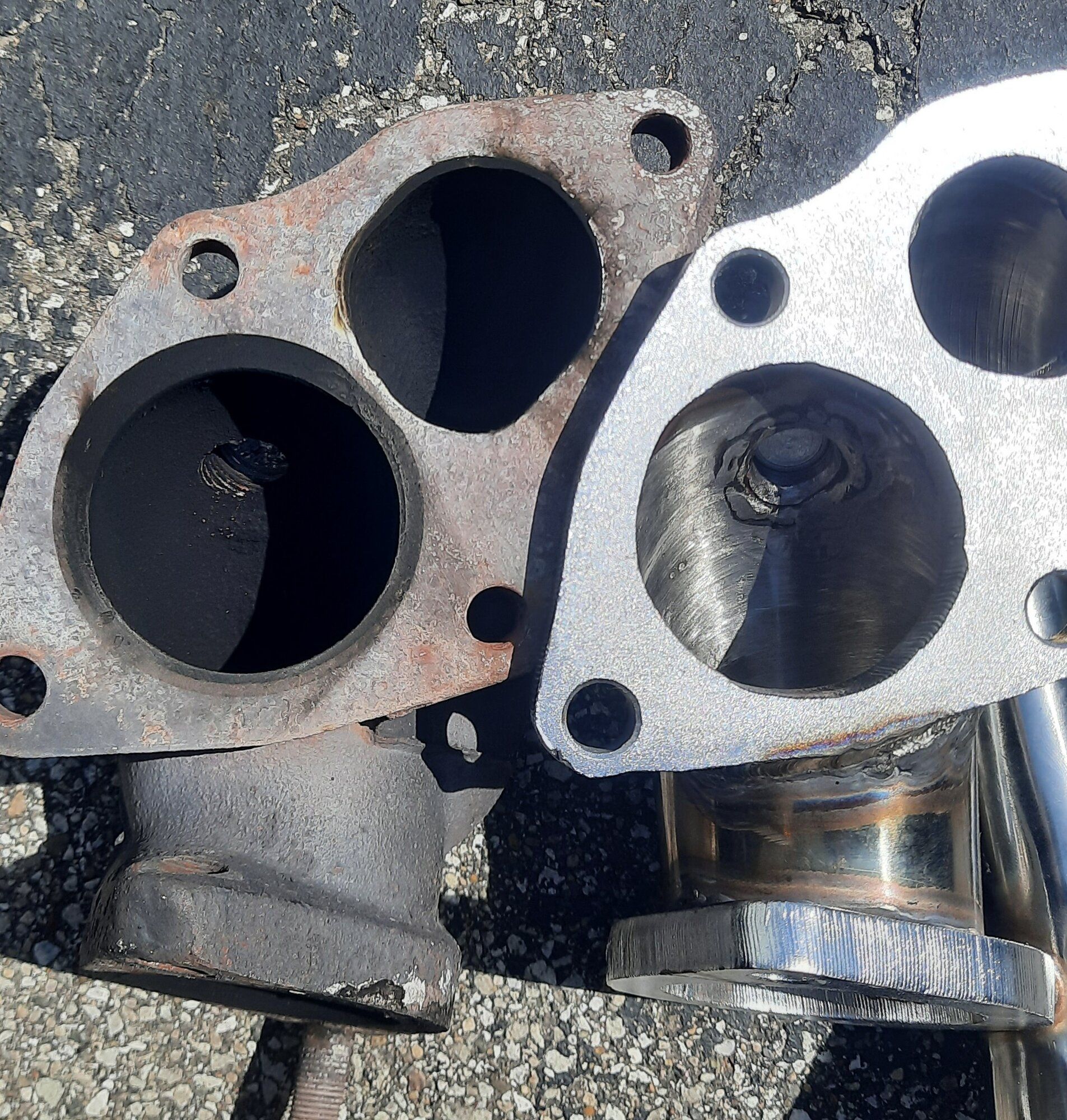

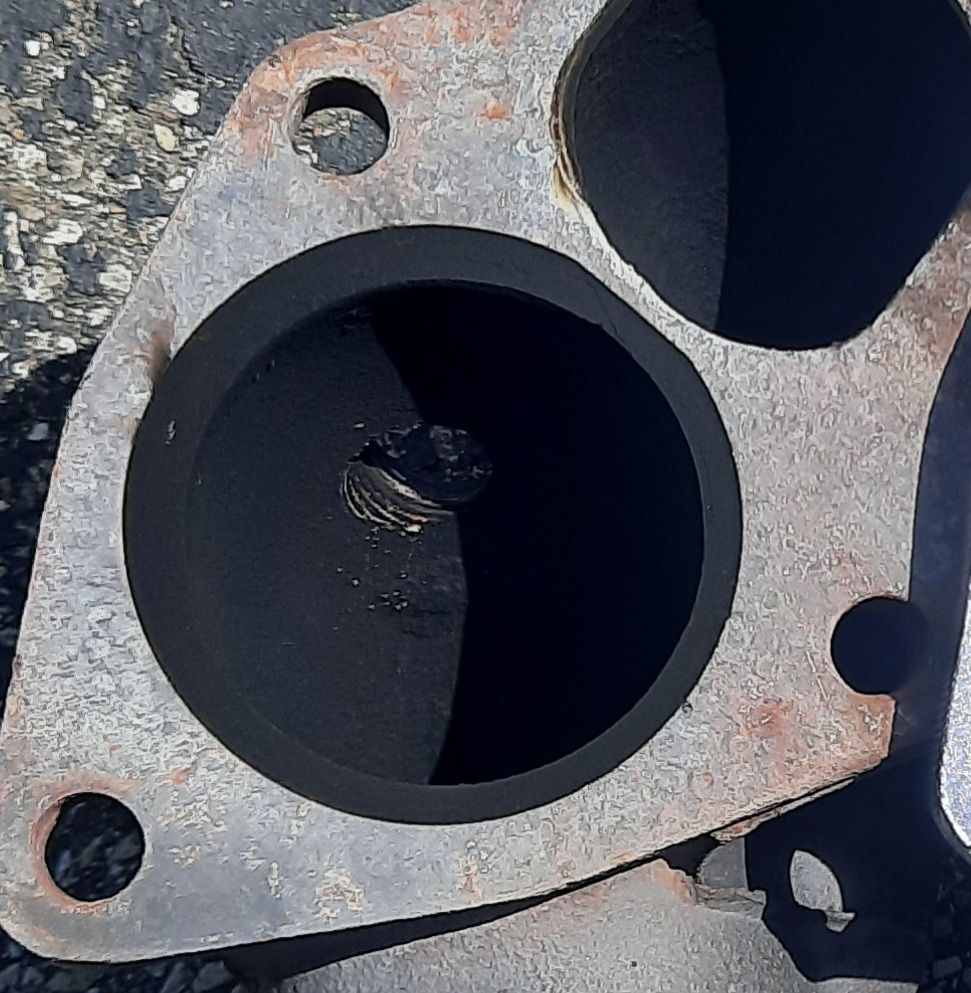

Here's some side by side pics. You can see on the old o2 housing where the 7cm turbine outlet was blasting the perimeter of the o2 housing inlet.... no beuno for flow.
First impressions.... wow!! The spool-up and power delivery is WAY more linear and it seems to be holding power better up top, but I haven't really got on it too much yet. Planning to go out tonight and get a log/hopefully have to add more fuel to my SD table 🙏🤘. Seems to be a ripping mod performance-wise! At least for my setup
Well, I am definitely happy with the o2 dump upgrade. I think that the 7cm turbine housing mated to the stock 1g/vr4 o2 housing (see pics above) was really causing a lot of turbulence and back pressure. Here's a couple wot logs from tonight. I didn't touch my tune from before the o2 housing swap when it was spot on. As you can see from the logs, I need to add quite a bit of fuel in some places (linwideband). It also helped spool and I feel like I am finally getting some decent mhi16g spool times. Also, I GRANNY SHIFTED the 2nd-3rd gear pull log because I'm just tuning. Don't bring it up LOL
The bushing the flapper rides in walked out of the housing. You can hammer/press the bushing back into the housing and then tack it in place if you ever wanted to use that hotside on something again. I see this a lot on the ebay housings, can't say I've seen an MHI do it before. That'll hurt some spool though LOL

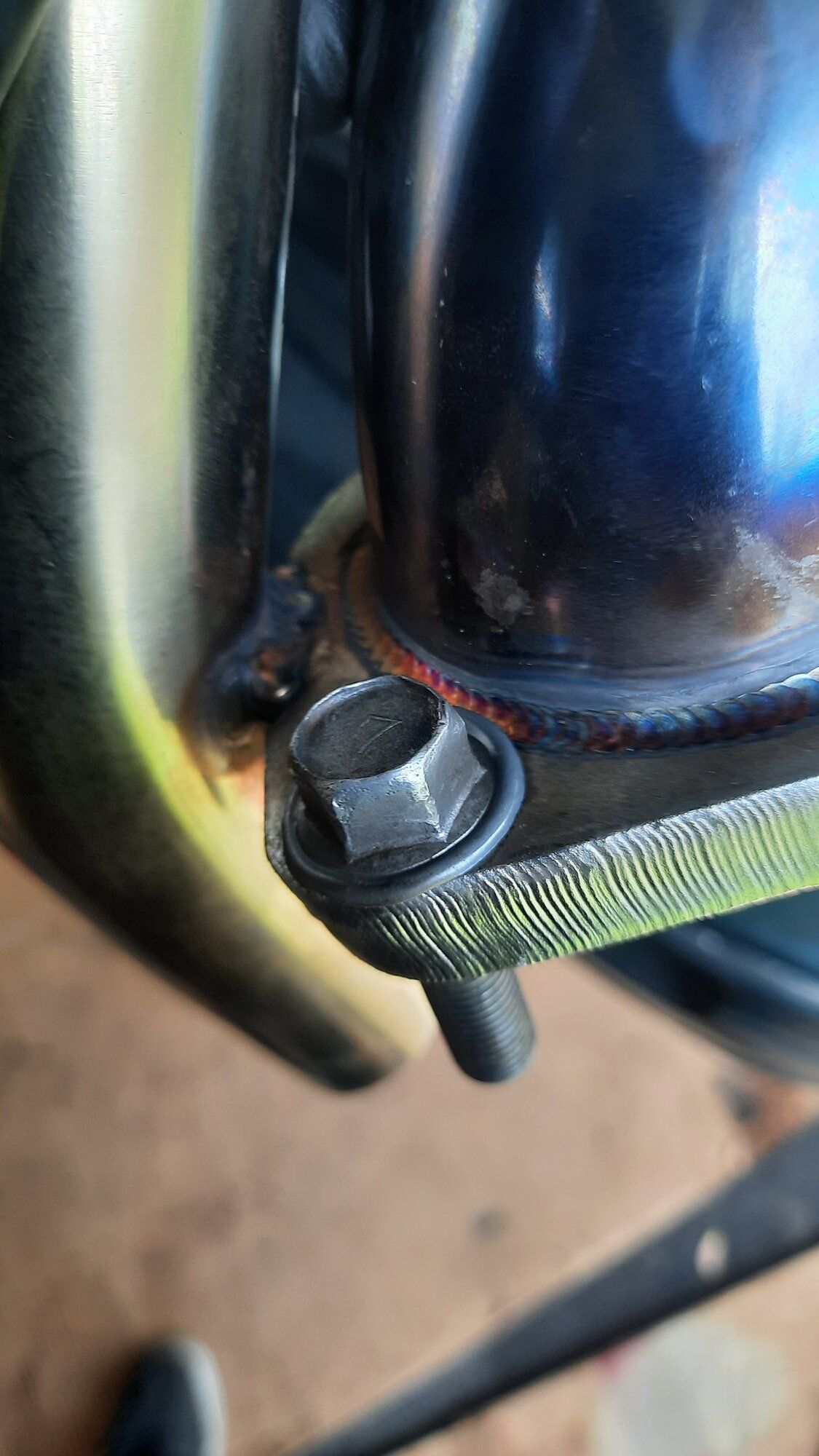

I was beyond-tired of the exhaust leak from the o2/downpipe flange. After going through 3 3 parts stores gaskets and none of them sealing right, I finally got it to seal using this beefy remflex gasket I got off Amazon. Here it is compared to the autozone gasket

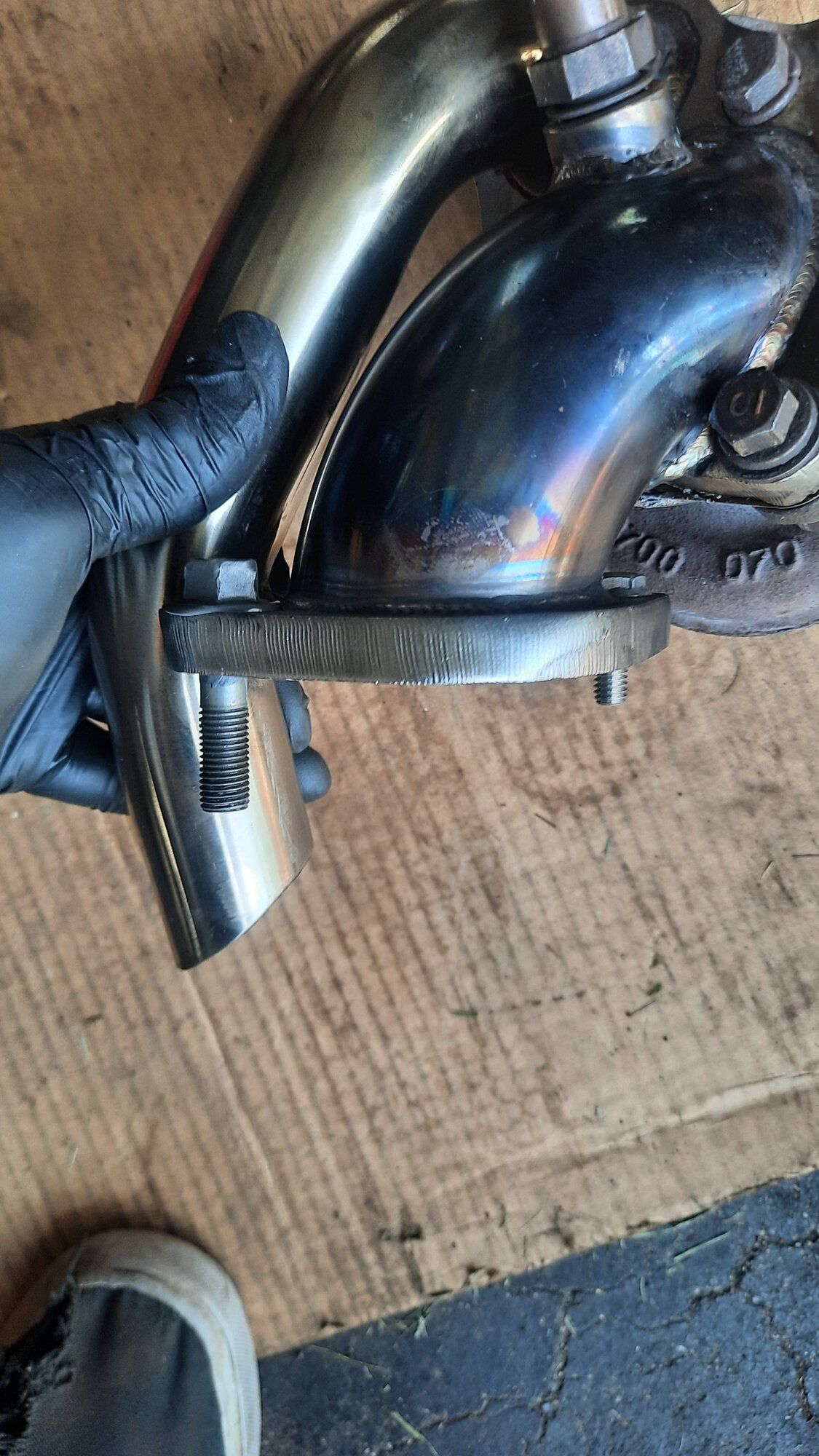

The new ebay o2 housing made removing the downpipe a reeeeal pain in the ass. I don't have a welder, so I jb welded some bolts into the o2 housing.

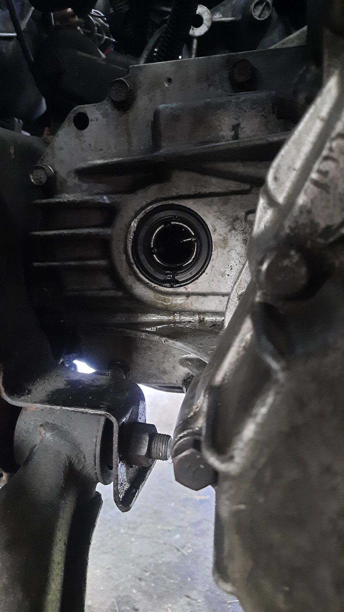

Last up for this post was a passenger side trans output shaft seal and biss screw. The original screw was plastic, and I ended up breaking this plastic one upon install ugh. It's still idling great tho haha 🤷‍♂️
