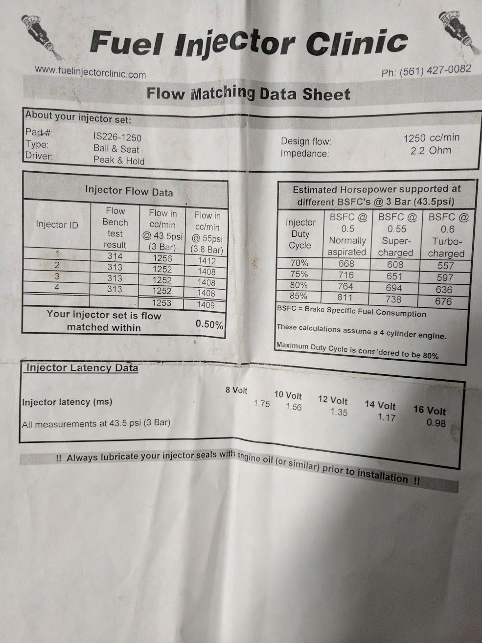

Attached is a 3rd gear pull and my injector flow sheet. I can't help but think that these injectors are part of the issue, since users have wildly different settings for FICs. Maybe increasing global fuel and adjusting my airflow table would bring these closer in line?

Bluemax injectors are notorious for being an ass pain to tune, but that's usually at idle. Your air fuel curve looks good overall. I seriously doubt you're going to get it to track well at such a low RPM. You started that pull wayyy down in the rev range. As boost starts to come up and settle, your AFR tracks well, so there may not a whole lot you can do down low. You can tweak your MAF comp a bit between 2.5k and 3k RPM, but you'll probably find it will be hard to get the MAF to track perfectly during that initial spool-up period.
