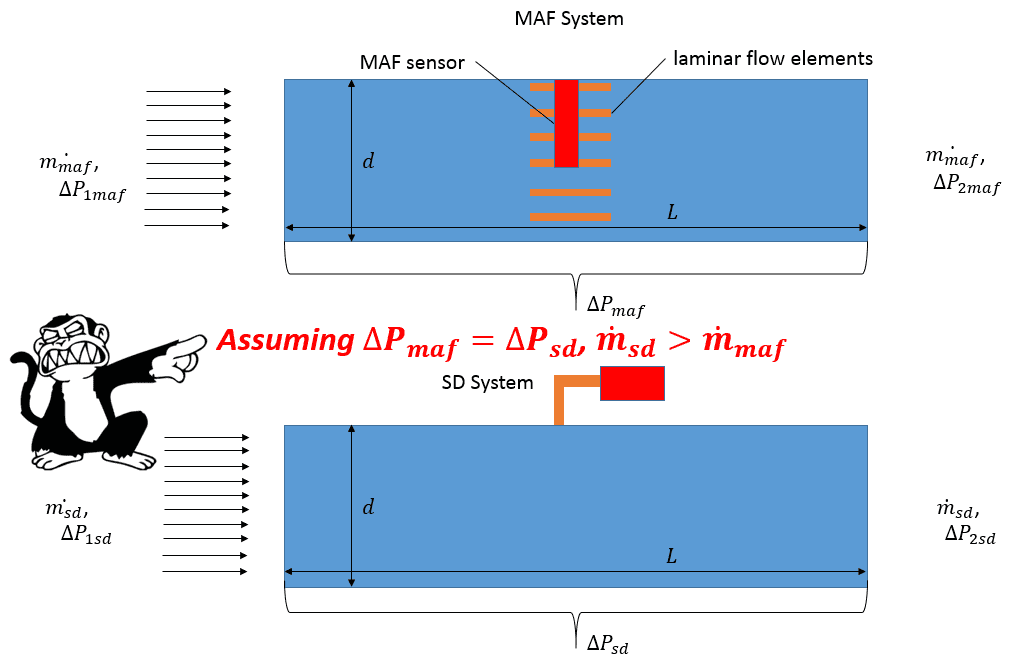

While I generally agree that you sometimes have to make lemonade with the lemons you're dealt, I think Brett might just be pointing out that using MAF introduces a flow restriction not present with SD. All things held equal, this will cost you a bit of power, even with a lower power application. There's also the fact that SD is a bit more versatile from a tuning perspective; MAF tuning can be super finicky about air routing, close crankcase ventilation, air leaks, etc...

Anyone who wants to claim that, all things being held equal, a MAF system is better than an SD system has the burden of proof to disprove fundamental fluid mechanics.
The argument of MAF being better than SD is therefore rendered to functional requirements, system limitations, and/or personal preference. These things may be perfectly valid reasons to favor MAF over SD but for all out performance, it's simply. not. true.
