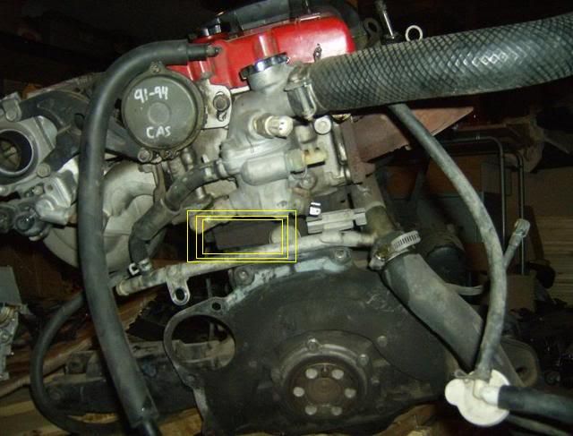

That isn't the vin. It's the trans code. You need to look about 2 inches higher.
Alright I finally found it. I had to use some break cleaner and a brush to make it readable. So I used one of those free vin checks and the vin check came back from a 1996 Mitsubishi eclipse spyder. the head is also a 2g head, the stamp read G6S 1. So I guess that solves that finally.
I assume the red plate I was talking about saying the engine is remanufactured means at one point the engine was somewhat rebuilt by a shop or the dealer maybe? idk.
