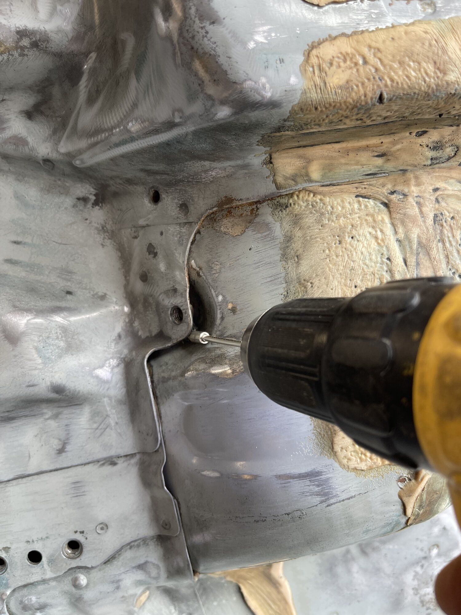

100% stock, un-wrenched 1g. Been sitting on it for over 20 years waiting for my chance to build. Diamond in the rough at this point?

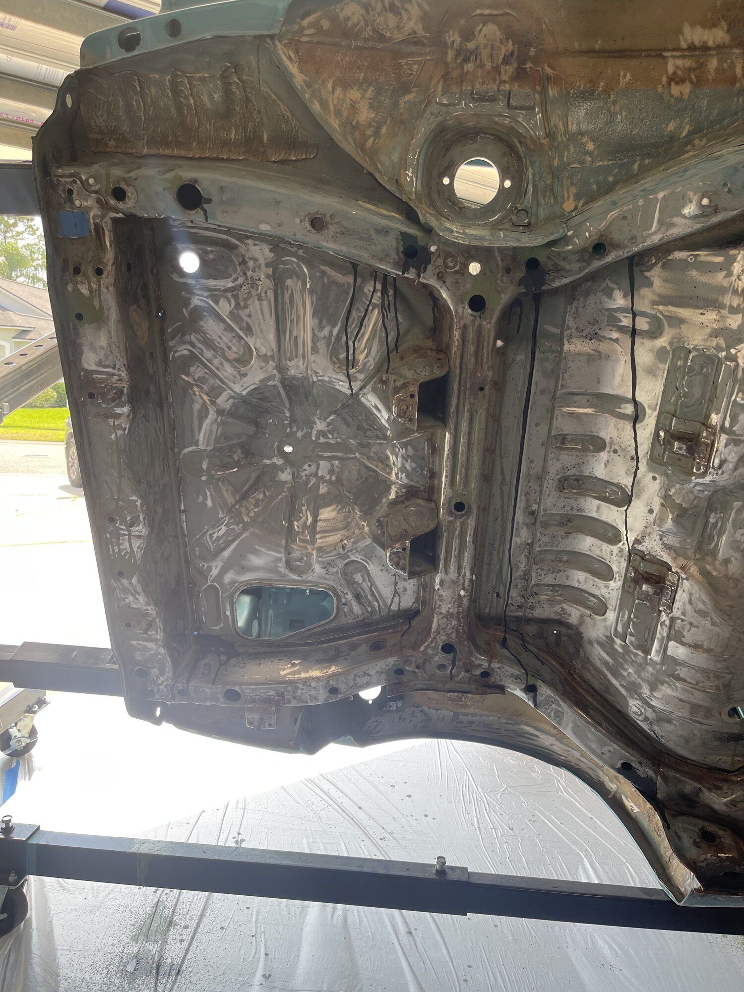

Another 6 or 7 hours grinding and sanding. The pics don’t do the work justice yet so I’ll pop one in here showing the arsenal of crap I’m using. “DSM chassis prep kit”. The 1g chassis has way too many little corners and crevices, kinda wish it was a 2G at the moment. ;)

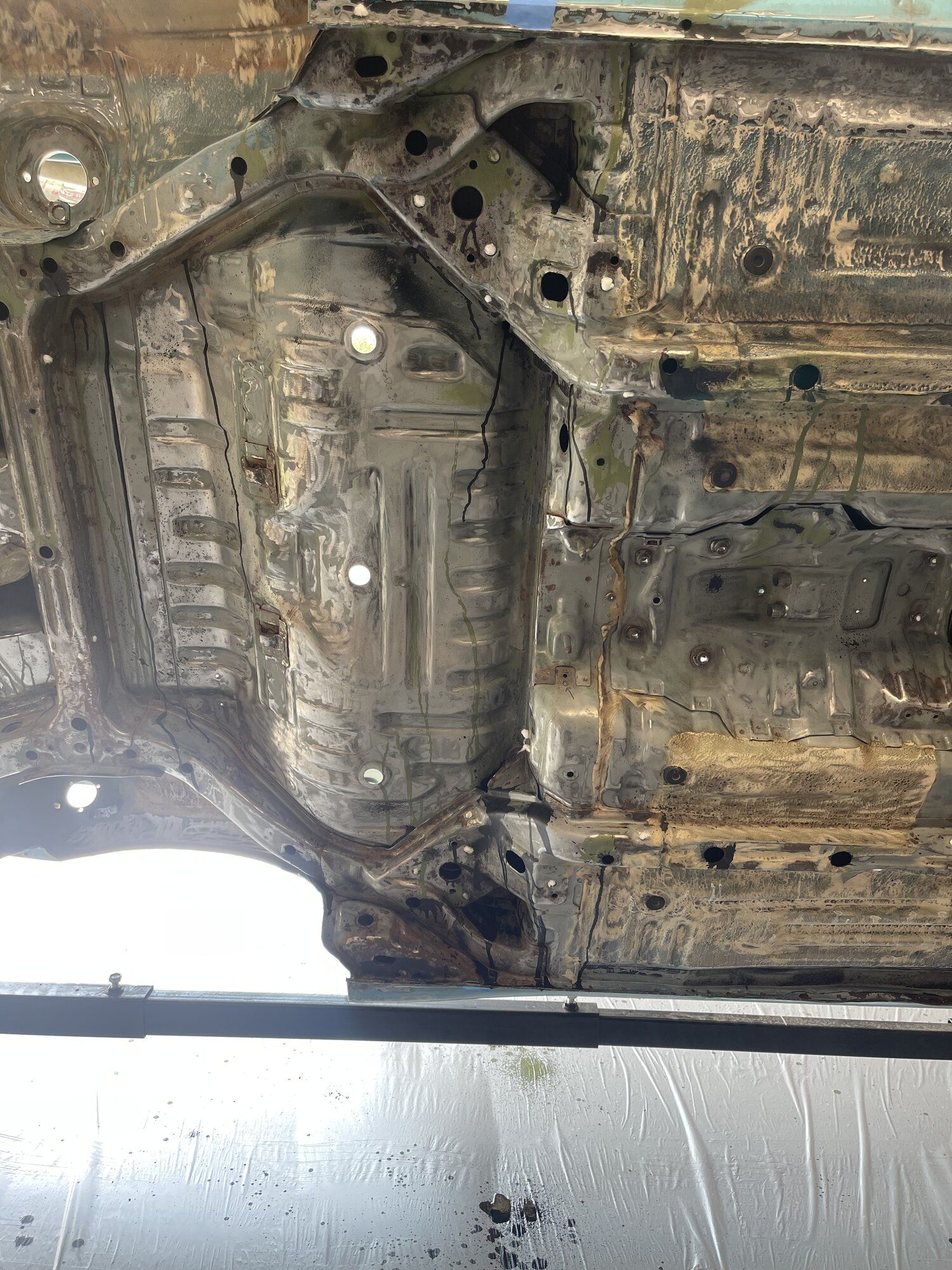

Another 7 hours wheeling and sanding on undercarriage. Getting kinda discouraged with the speed of progress but still plugging along.

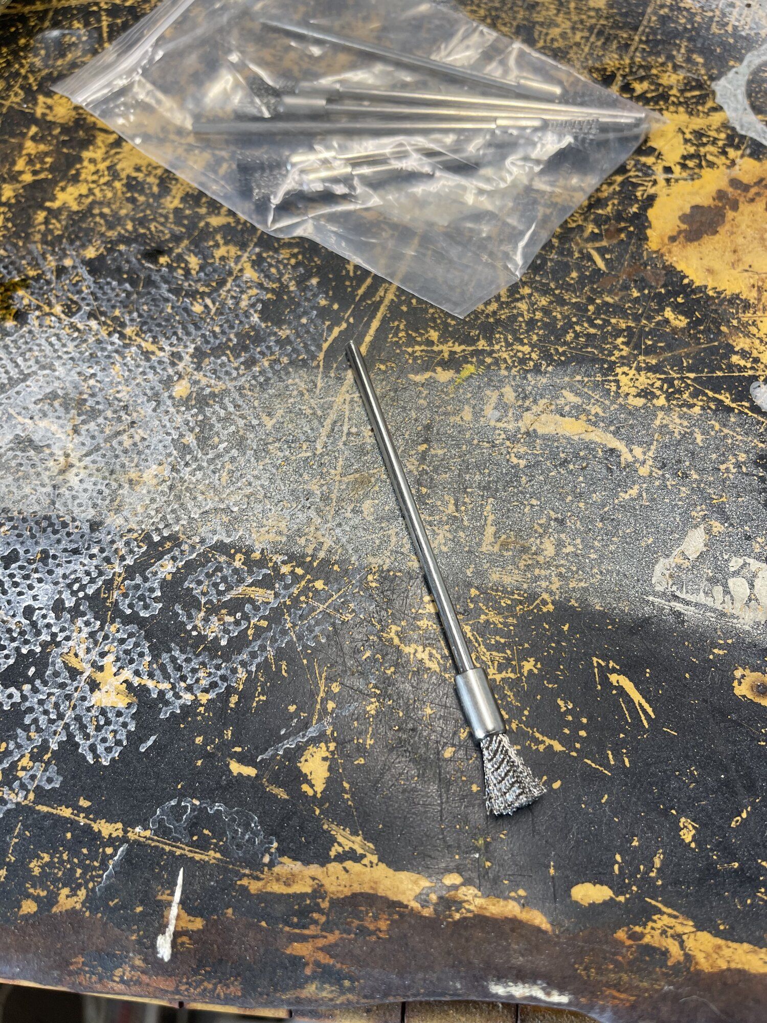

Did find these little wire brushes that actually work pretty well at getting into tight corners and whatnot.

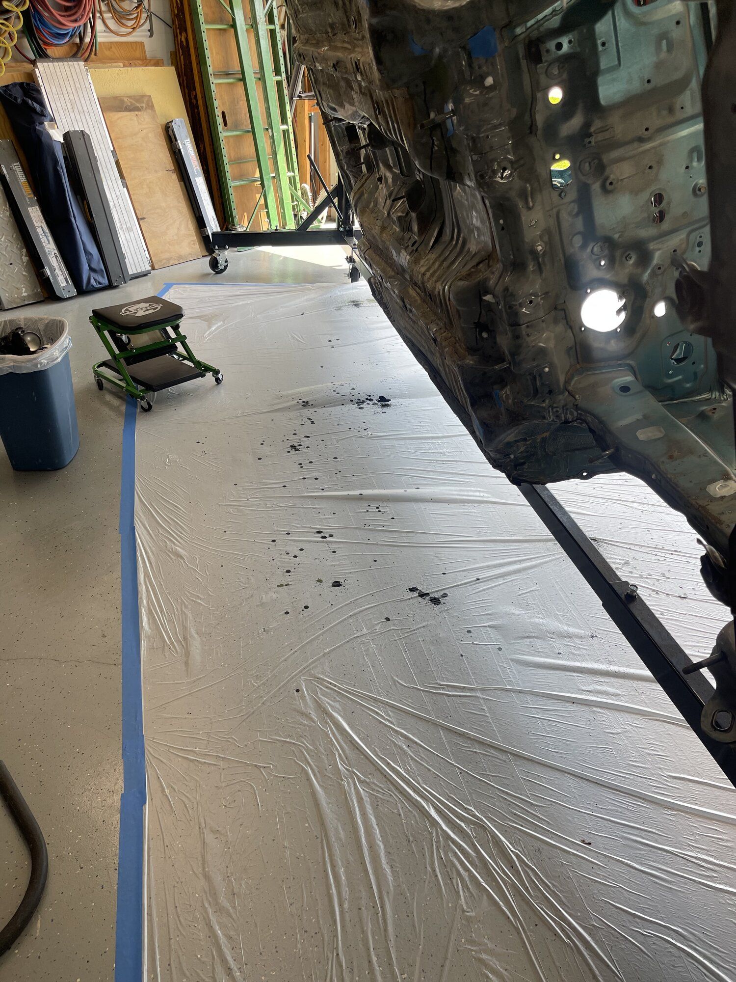

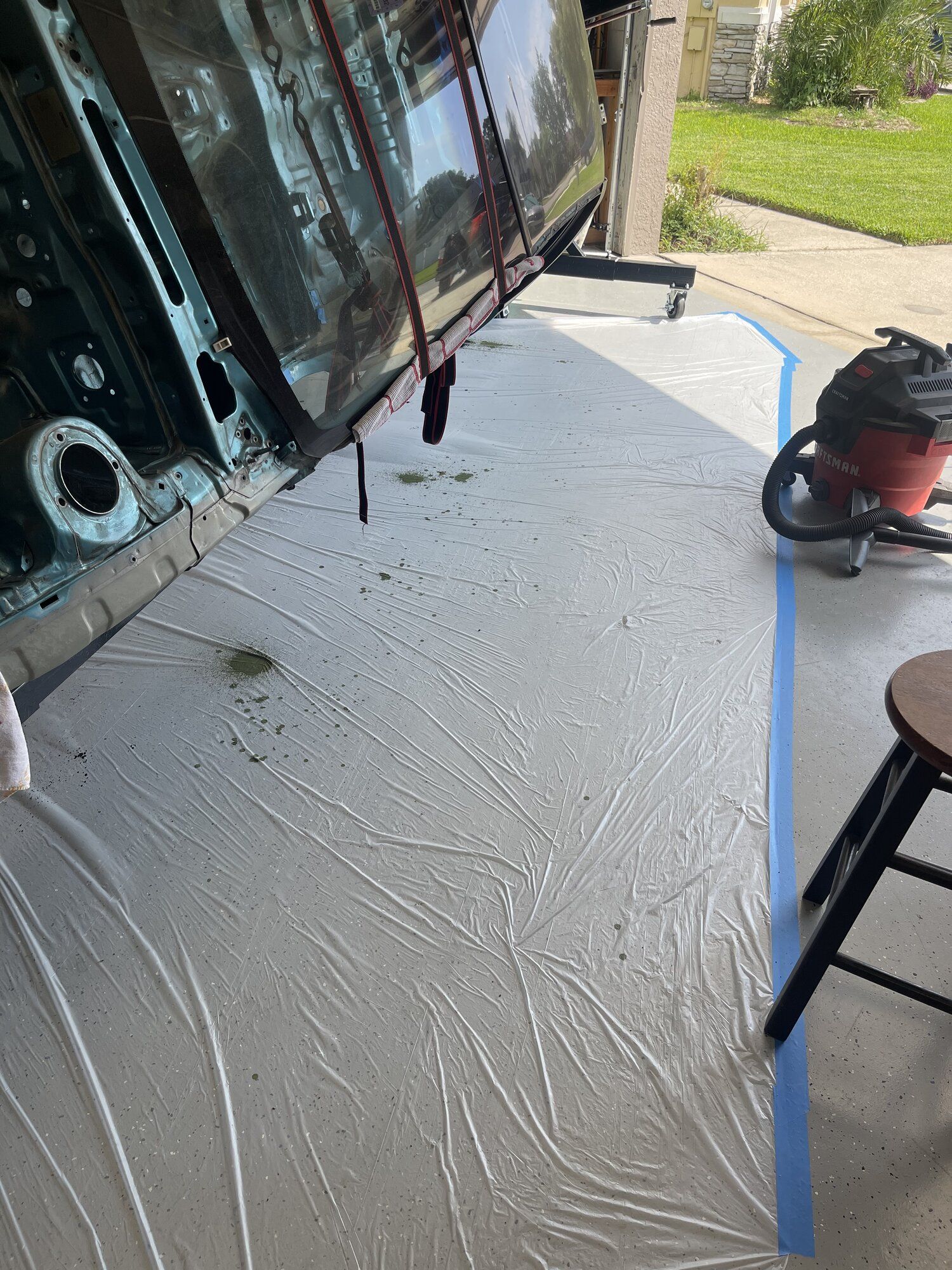

Well based on how much the bag weighed I just changed in my shop vac full of rust, rock bits, sand, etc., I must have gained 10HP and there’s not even a motor in her yet! :cool:

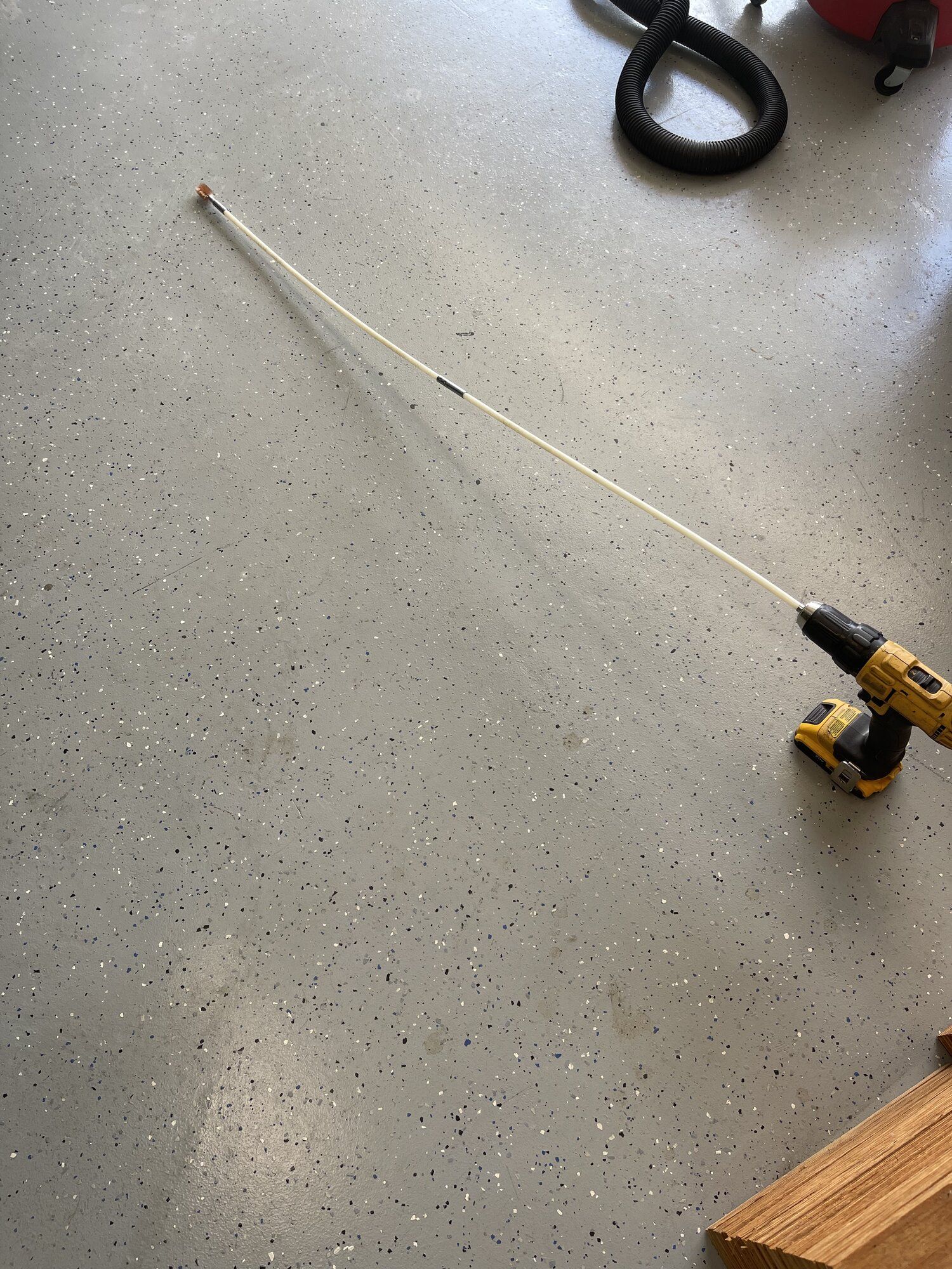

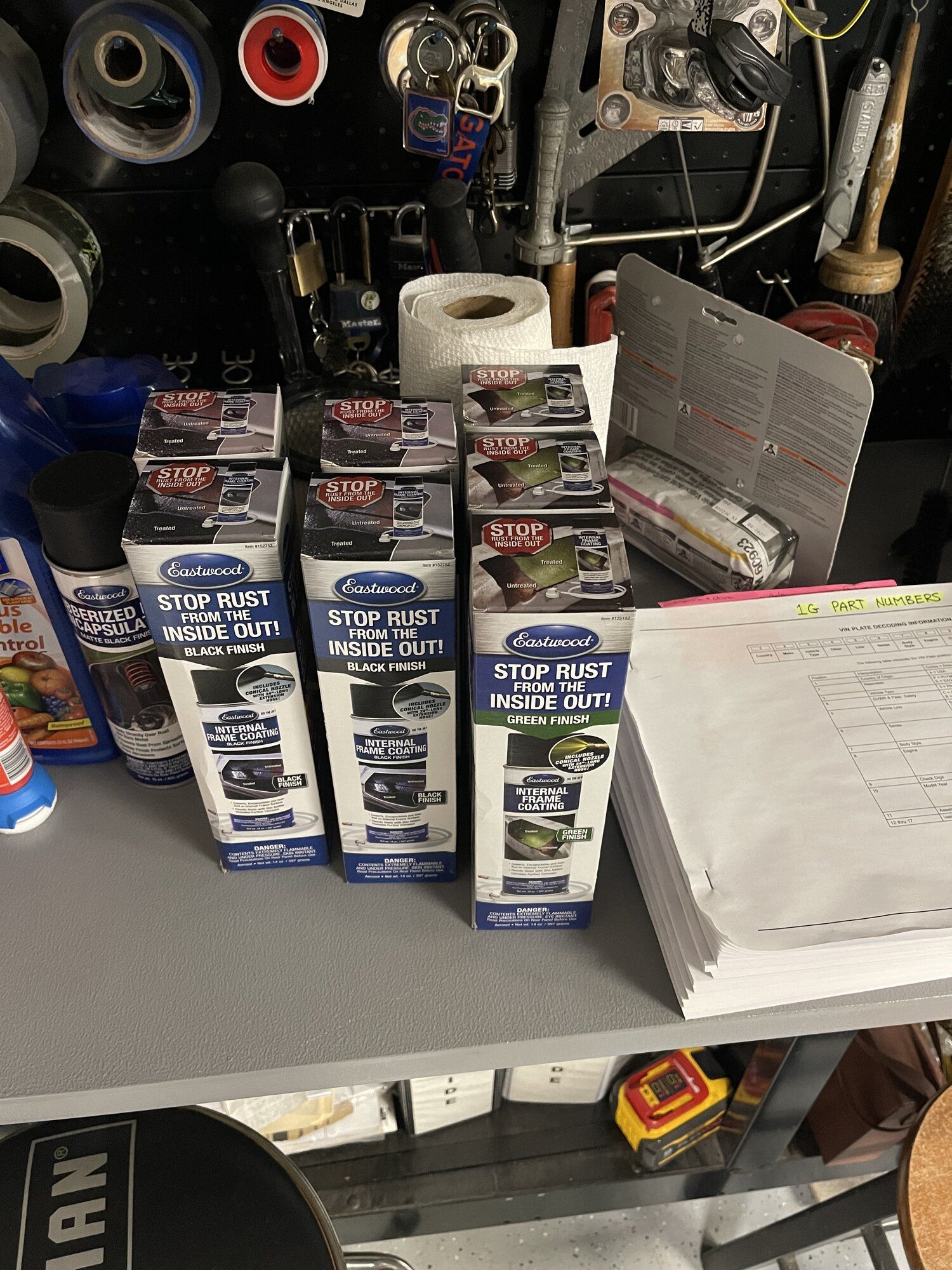

So I finally did something other than wheeling and sanding. Rigged up many different apparatuses to try and get to as many spots as possible inside. Thing that worked best was 12 gauge bore brush attached to end of dryer vent cleaning extensions. Then sprayed the only can of Eastwood Internal Frame Coating I had. That didn’t go as far as I had hoped and at 30 bucks a can, this is going to get pricy!

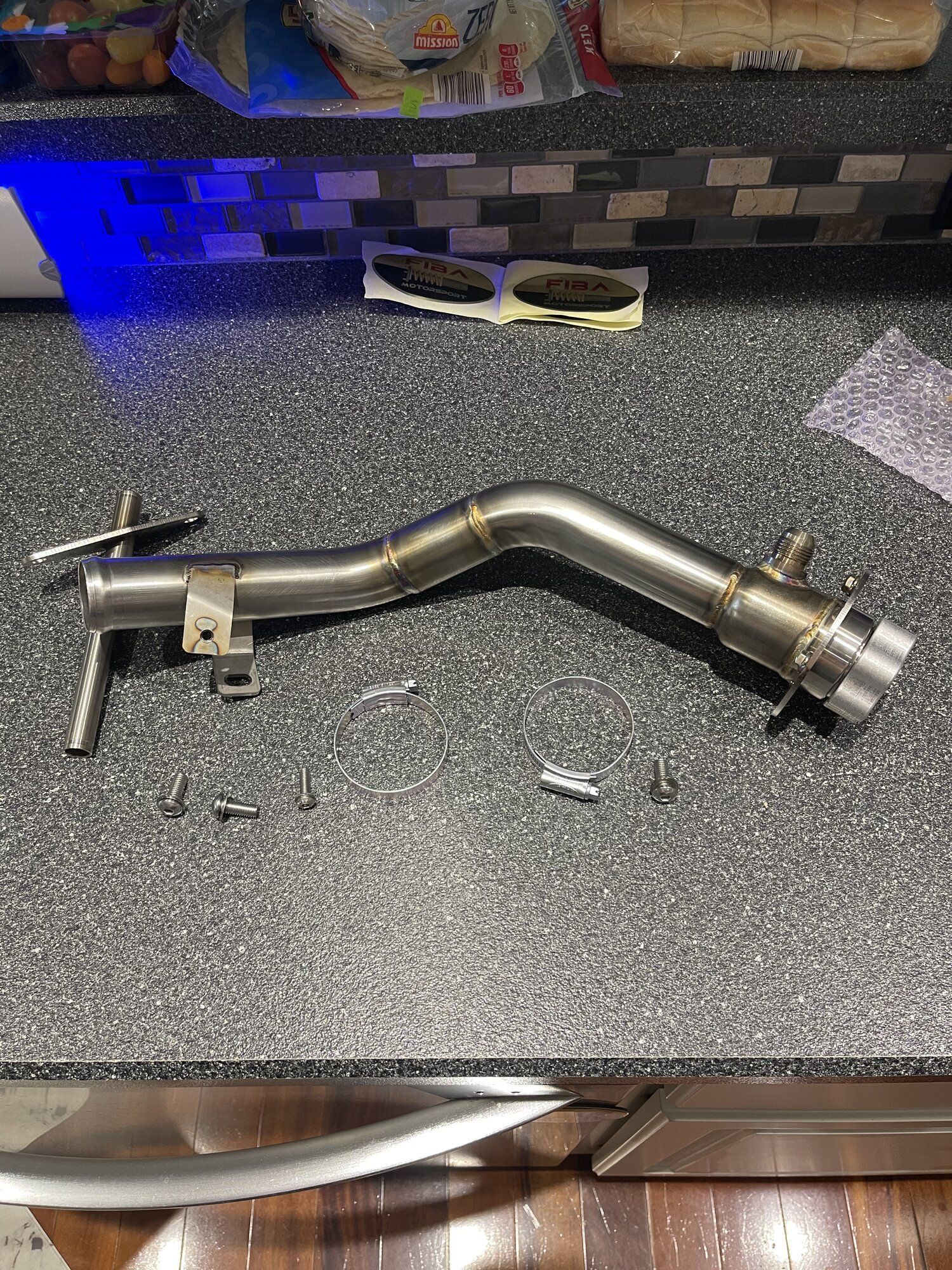

This came in the mail today. Looks great and high quality work! Just wish I was close to installing so I could see how it all goes together and looks on car. Thanks @EC17PSE and keep up the good work Bobby! Eyeballing those brakes and other things now..

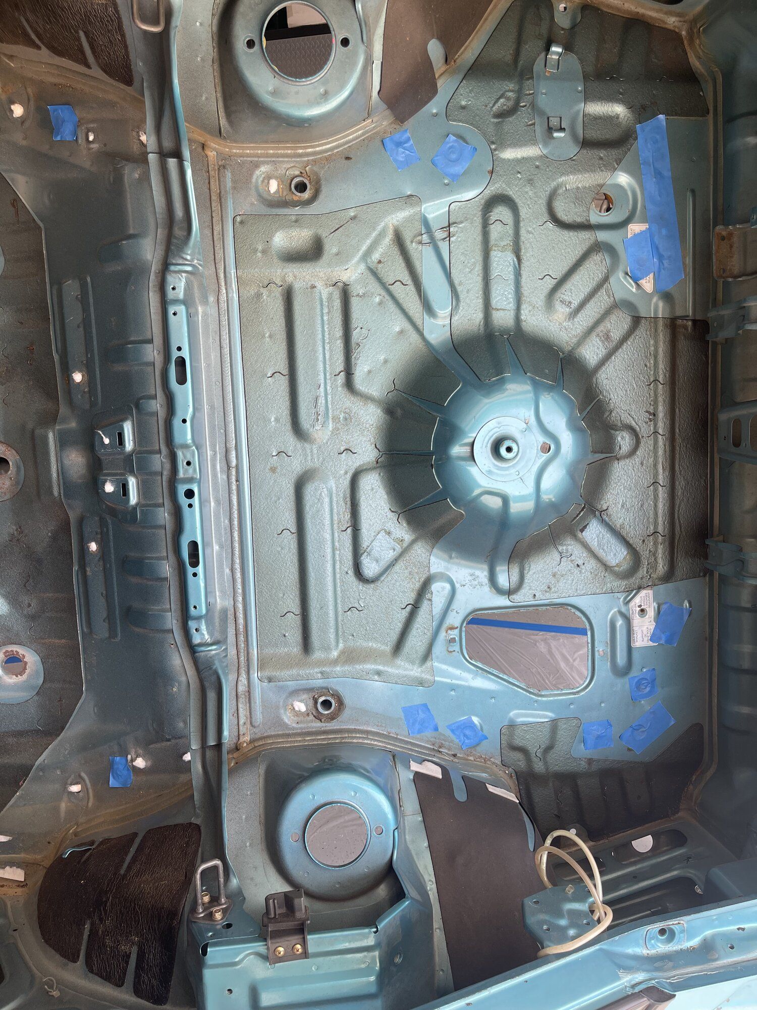

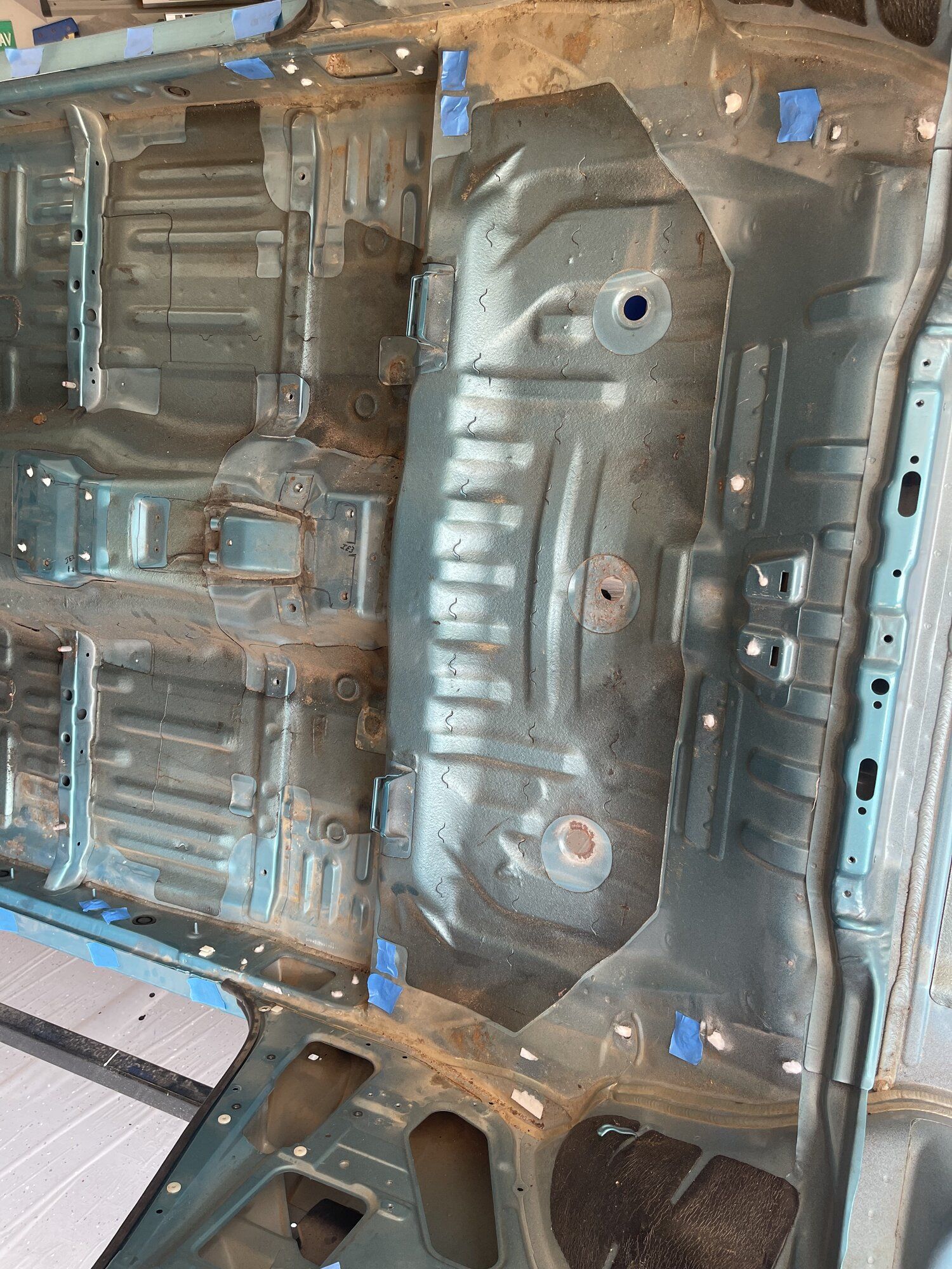

So first coat green. Let it settle in and dry. Flip her over then spray black to settle in the other direction to get all crevices as much as possible. Put pieces of cotton balls to plug wherever there were threaded holes to protect the threads from getting gunked up, and taped over any other holes or plastic inserts. Need a couple more cans, only the rails at the engine bay left.
Also sprayed Ospho on any residual surface rust that was left underneath that the 50+ hours of wheeling, sanding, etc didn’t want to take off. (And the oxidation that already forming where I had it down to bright bare metal.) That stuff is pretty cool! I know I didn’t really need to as the Rust Encapsulator Platinum is made to apply right over the rust, but figured it could hurt right?

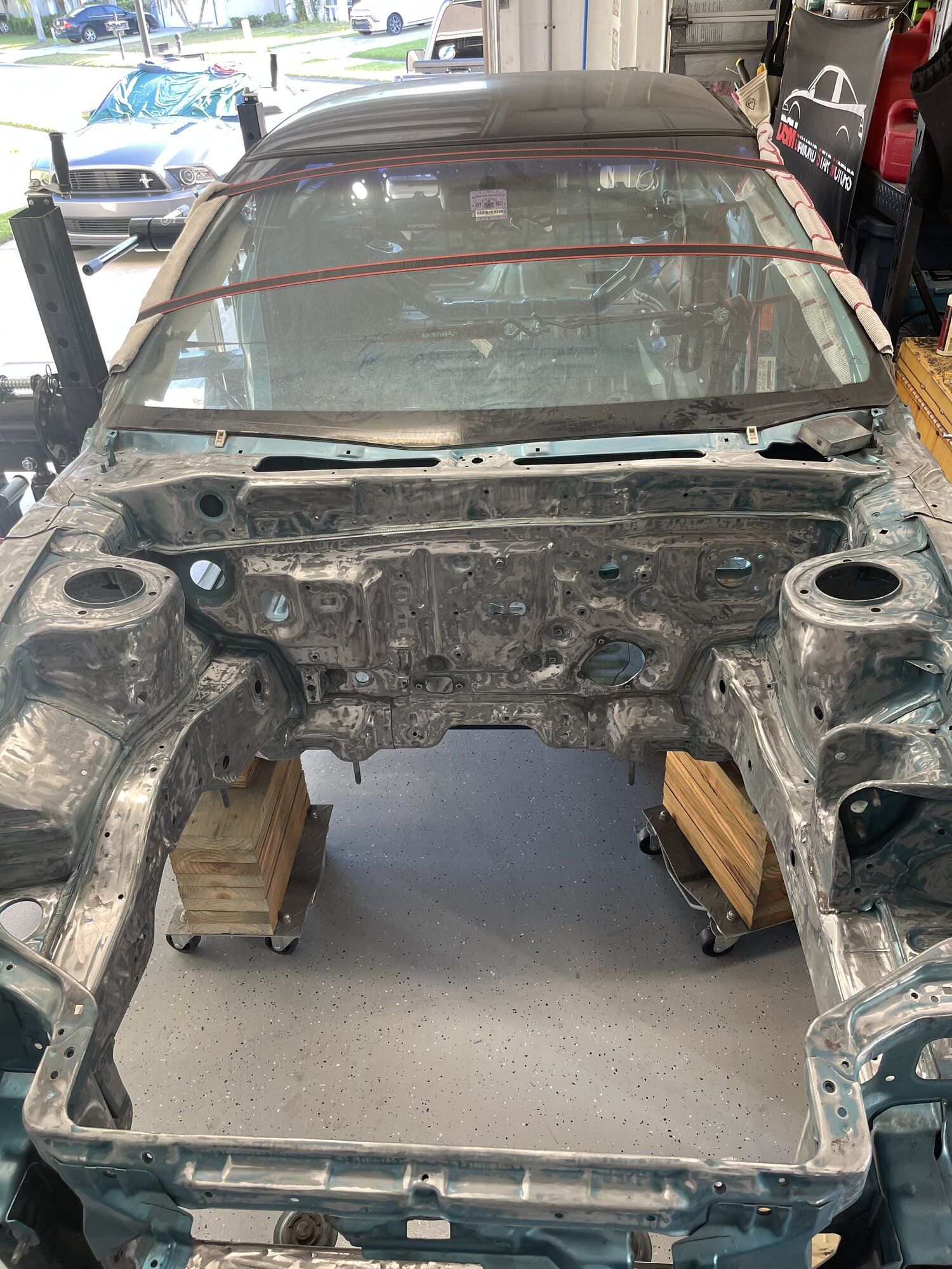

Internal frame coating didn’t come in yet so couldn’t finish that part yet. Got a jump start on prepping engine bay.
Finished all the internal frame coatings finally. Getting into the detail part of nooks and crannies in the engine bay now. Ugh. Must be around 70 hours now prepping underneath and engine bay.
