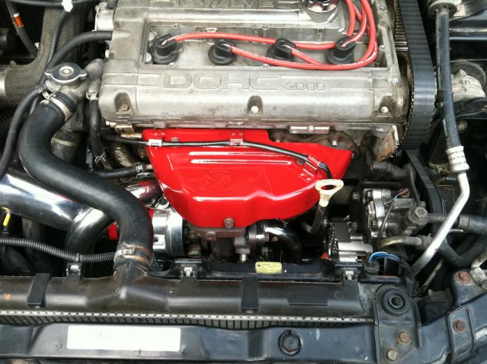

The Cause: we began tearing into the car to search for the issue which we quickly found.. the bolt holding the Intake cam gear to the camshaft had backed out allowing the cam gear to fail on the dowel pin and lock up on the exhaust cam gear, timing belt hanging loosely.. we began the search for local parts, starting with the cam gears. amazingly we found some from a local DSM guy Bryan, who proved to be insanely helpful. we began checking to determine if we had bent valves, and initially all signs pointed to we got insanely lucky. We put the factory cam gears on and re timed the engine. I nervously sat in the car and gave it a crank, and it started up.... however was definitely only running on 3 cylinders. Now that the motor was in time we could dig deeper and do a compression test. This proved cylinder 3 to have 0 compression. Houston we found our problem.
The decision was made by the team to go ahead and try to repair it and get it back out on the track for Sunday and try to get that perfect lap. What a long trying night. Bryan knew of another local guy that had some stock used valves, which he brought to the track and after a quick soak in fuel to get some of the carbon off, and a 5 min valve lap job we had them in the head and began reinstalling everything. It wasn't until about 3:30am that we had the motor together enough to do a compression test. 180 on 1,2,4 and 175 on 3. we were in business, not bad for a slapped together job, oh and we had to risk re-using the HKS MLS head gasket as no one local had a new MLS we could get.

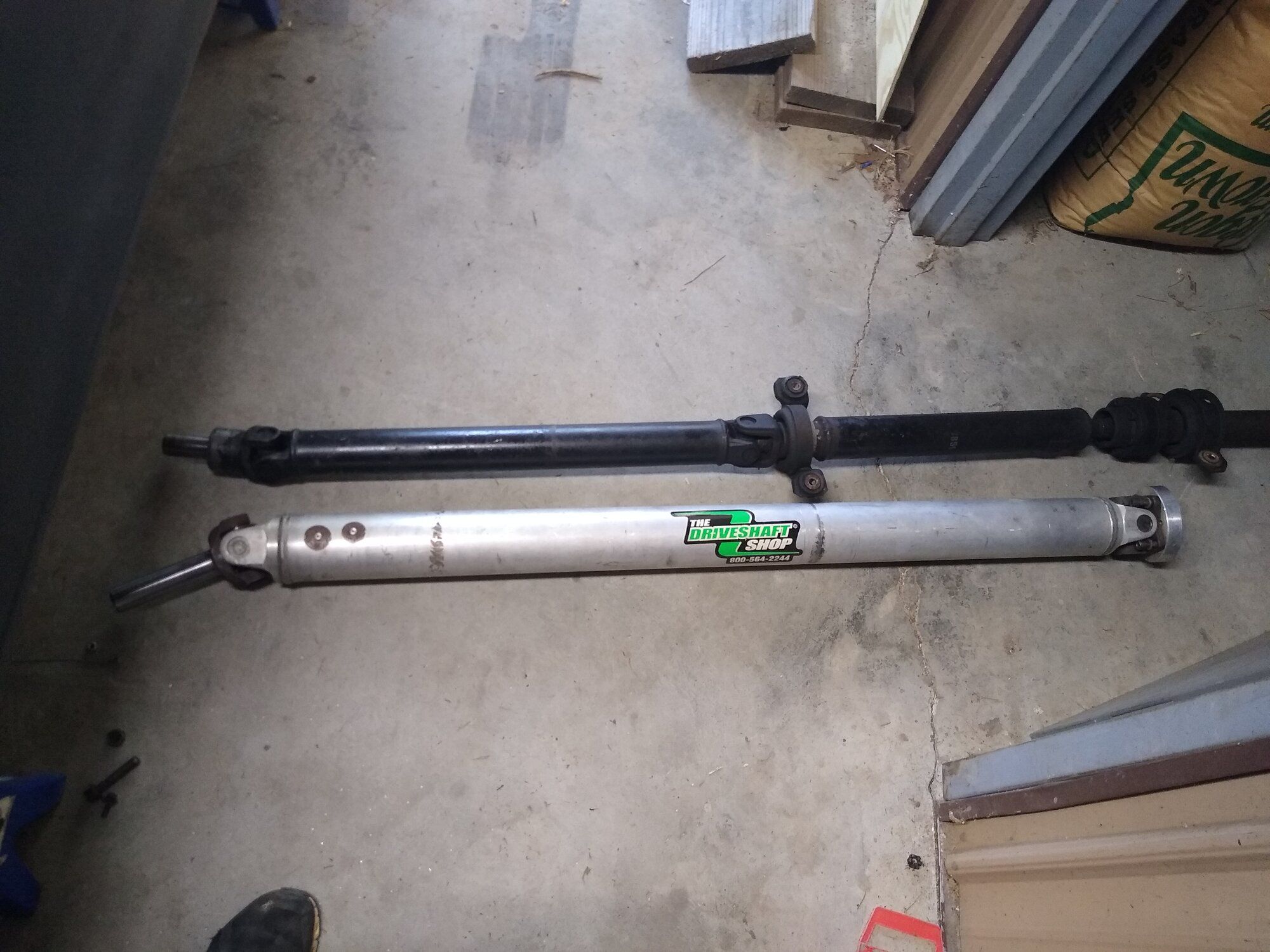

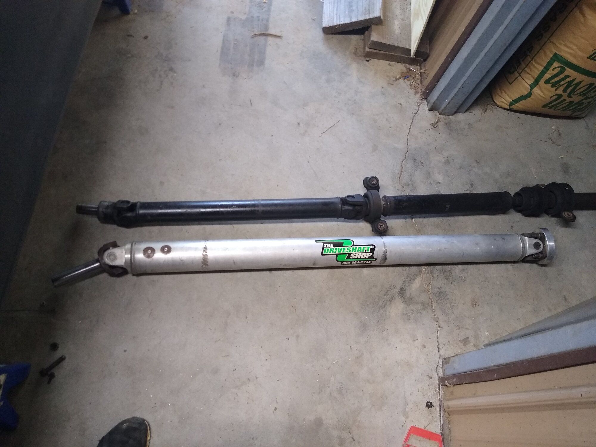

So Super Lap Battle 2022 has been officially announced and will take place February 18-20. Currently the car is literally a bare chassis, with the front end cut off in prep for a custom tube chassis to help support the new splitter being built at the end of the month. I have been busy cutting out all the weight I can from the car while still maintaining structural rigidity, and we are down close to 250lbs from where we were last year. I am converting to a aluminum driveshaft to aid in reliability, as well as adding a Meth kit to try and help with temps. My main goal for the car this go round is reliability and being able to run more than one hard lap per session. I will keep updating this as best I can while scrambling to get the car back on track by October to get some test time in.
