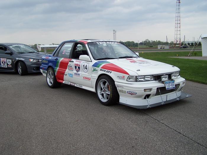

What wheels and size are those on that. I have a '90 GGSX I'm fixing up. I may paint it like your's if you don't mind.
The wheels are 17x9" Mustang Cobra wheels with 255/40-17 tires. You have to run a coil-over suspension for them to clear. For more information about the car you can check out our webpage here

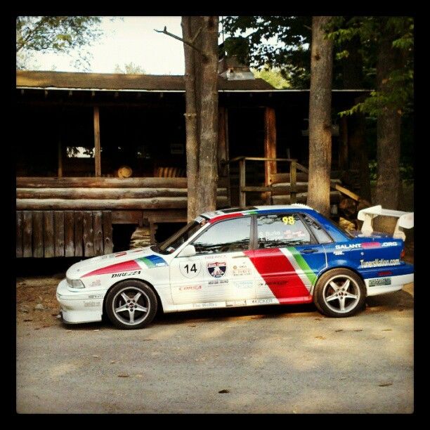

The paint scheme on the car is an homage to the 1989 Works Rally VR4.
Thanks, Any idea what the offset on those wheels are? I have some 16x7.5 +35 K1's on the car now, but they belong to my talon..
I'm not sure what the backspacing is. I've been running them for quite a while now. They started life on my 92 GSX before I swapped over to the VR4.
They are off the shelf Ford Racing Cobra R 17x9 wheels. I think they are 5.96ish backspacing.

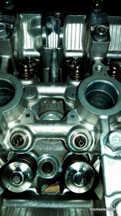

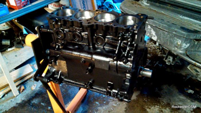

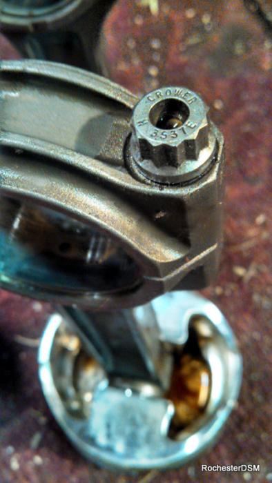

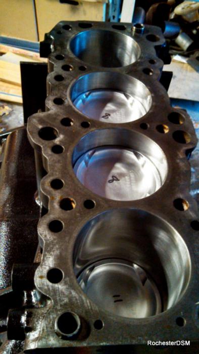

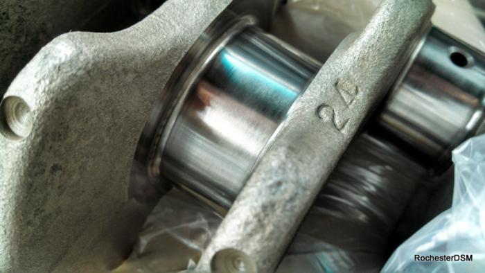

Just got the short block and head back from the machine shop ready for assembly. Here are the spec's
Seasoned block (216K miles)
Mitsu 2.3 crank un-cut and super finished
Crower rods
ARP main studs
line honed
Wiseco 8.8 stroker pistons
Ferrera 1mm over int&exh valves
crower springs/retainers
2g lifters
lightly ported
HKS 264/272 cams
With a FP3052 we made 400whp at 29psi with the old 2.0L block. The goal is to be in the 450whp range with the same boost on the stroker.

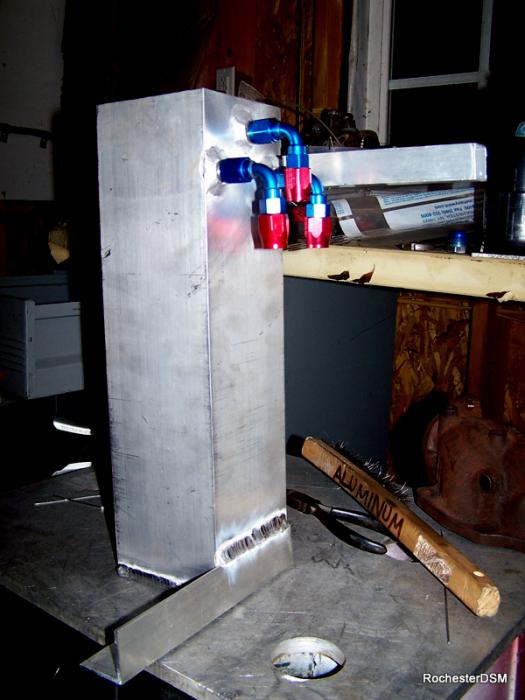

It's been anywhere between 0 and 10F up here the last week so I am a bit behind schedule with the build. I started a surge tank build last week and I was hoping to finish it up by this weekend but like I said. Its been too cold.

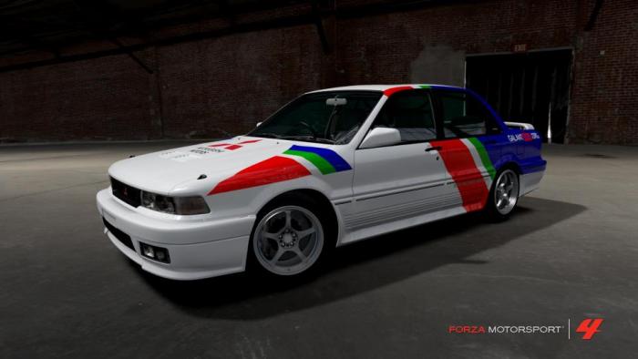

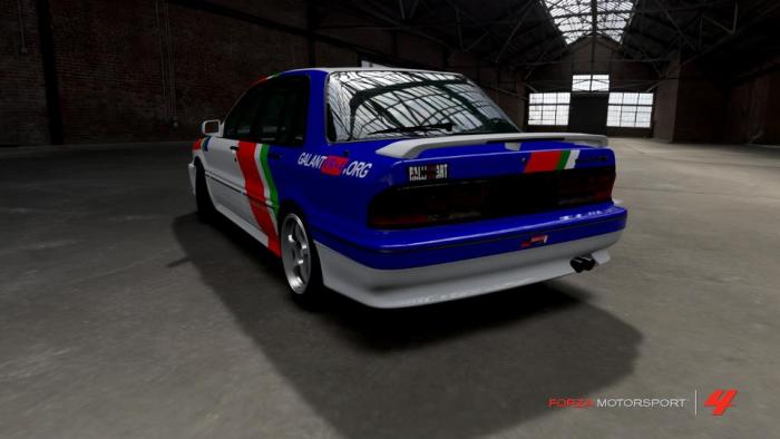

Our Forza artist (Les) has been at it again. Forza doesn't have the right wing for the car, but he has the base of the car ready to receive graphics. We'll update it when the all the sponsor graphics get sorted out.
We actually have both the One Lap cars on Forza. Just search for "Magnus Evo X" or "Galant VR4 rally car". Both were uploaded by sheeley91.
I don't have an xbox system so if anyone gets this working snap a screen shot of them in action for us.

I tried to find your cars on Forza 4 by searching but couldn't find either one. I searched "Magnus" and "vr4 rally" under designs but found nothing. Searching his gamertag returned the ams gtr and a black talon tsi but thats it.
