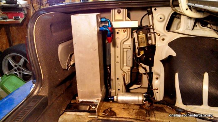

Just curious as to where you are going to mount that surge tank. I need to build one myself as well this year and just curious as to your placement.
This really is exciting to hear! Glad to see you guys move back to the Galant.
I've been going back and forth with the location. Currently its located in the trunk in the drivers rear corner. I put it there for two simple reasons. First it presented a smaller area to "wall off" and secondly in the of a fuel leak that area of the trunk floor tapers off into the rear fender area where I simply put a drain hole in. That would keep fuel from pooling in that area.
Some of the cons of putting it there is if I were to back into a wall hard enough that tank could be compromised. What's keeping me from moving it is knowing that it is semi-protected because its sitting on top of the rear frame rail that accepts the bumper strut. That, to me, means that if I hit hard enough to crunch the surge tank then my main fuel tank is just as likely to get crunched too.
I am also considering placing it between the rear strut towers bolted to the floor. That would put it in the safest place in the event of an accident but, it really puts me at risk in the event of a fuel leak. The spare tire well is right there and its a perfect spot for fuel to pool. It also means I have to build a bigger and more complex bulk head wall to go along the back seat and under the rear speaker deck.
The other option is to mount it under the car. That makes sense for fuel pooling and depending on where you mount it can be safe in a crash as well. But there are not a lot of options under the car to mount it. The biggest area is up under where the diff is located and along the rear behind the rear tire. I don't want it near the diff because the exhaust passes through that location and it would get beat to death in the event of a u-joint failure. Mounting it behind the rear tire makes it even more vulnerable then the corner of the trunk.
So, right now I'm planning of the rear drivers corner. I built it out of 1/8" extruded aluminum which should able to sustain a beating with a hammer without rupturing. Also, I am not limited by any racing sanctioning body with the location. I have to be smart and careful how I do things but One Lap pretty much unlimited when it comes to modifications.
Love the way that surge tank looks, with what you said I think the best position to place it in is where you have it now, seems to make the most since. I have always loved watching your build up to get ready for the One Lap of America race, I remember the first time you guys entered it with the galant such a great read.

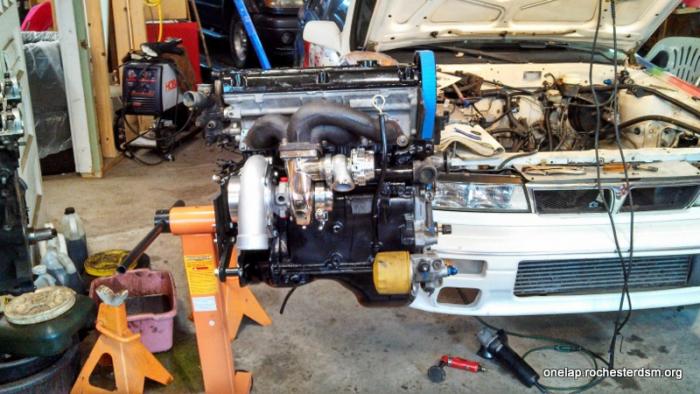

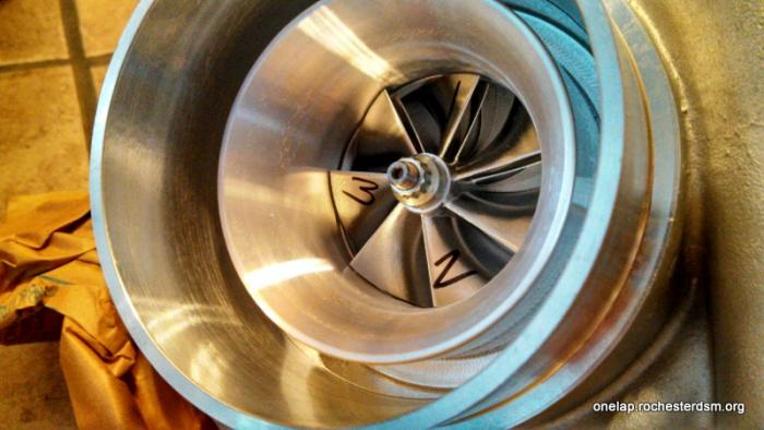

I'll update the thread once we get on the dyno but we are shooting for 450whp on a new 2.3L I'm building.
A quick update on the project. The engine is assembled and waiting to go back in. I am still in the process of picking out a clutch and the transmission isn't back yet. So the process has been stalled a bit.
I've begun collecting the parts to build a manual transmission cooler ala CJ Moses and I'll detail that as I go on. The surge tank is 95% done I'm just waiting on a few AN fittings and mounting the JayRacing pump to finish it. Once that's done I'll detail everything I did to build it.
I have some smaller things to work on like a bad front wheel bearing, wiring, etc..etc. that will keep me busy until the transmission comes back.
