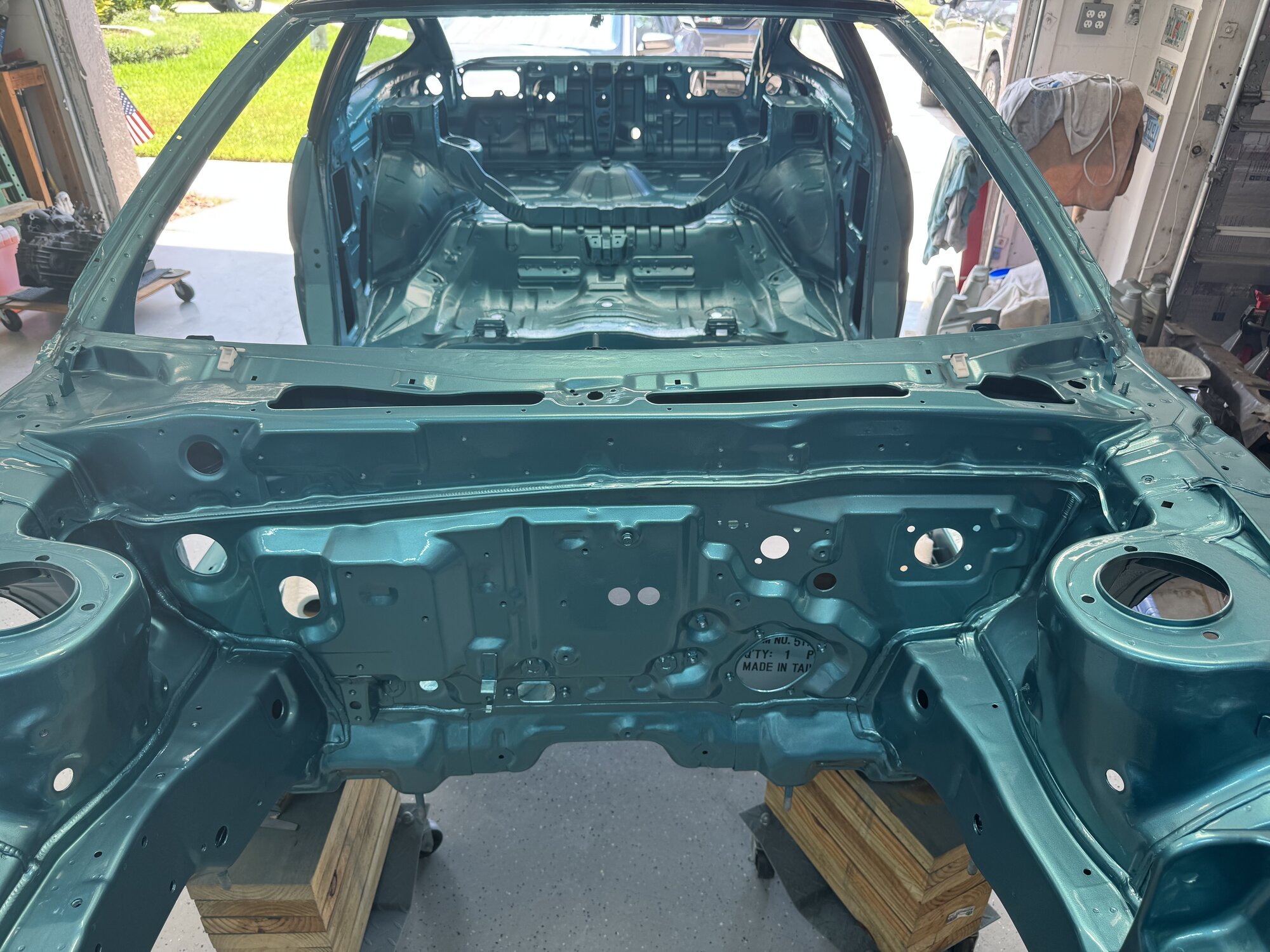

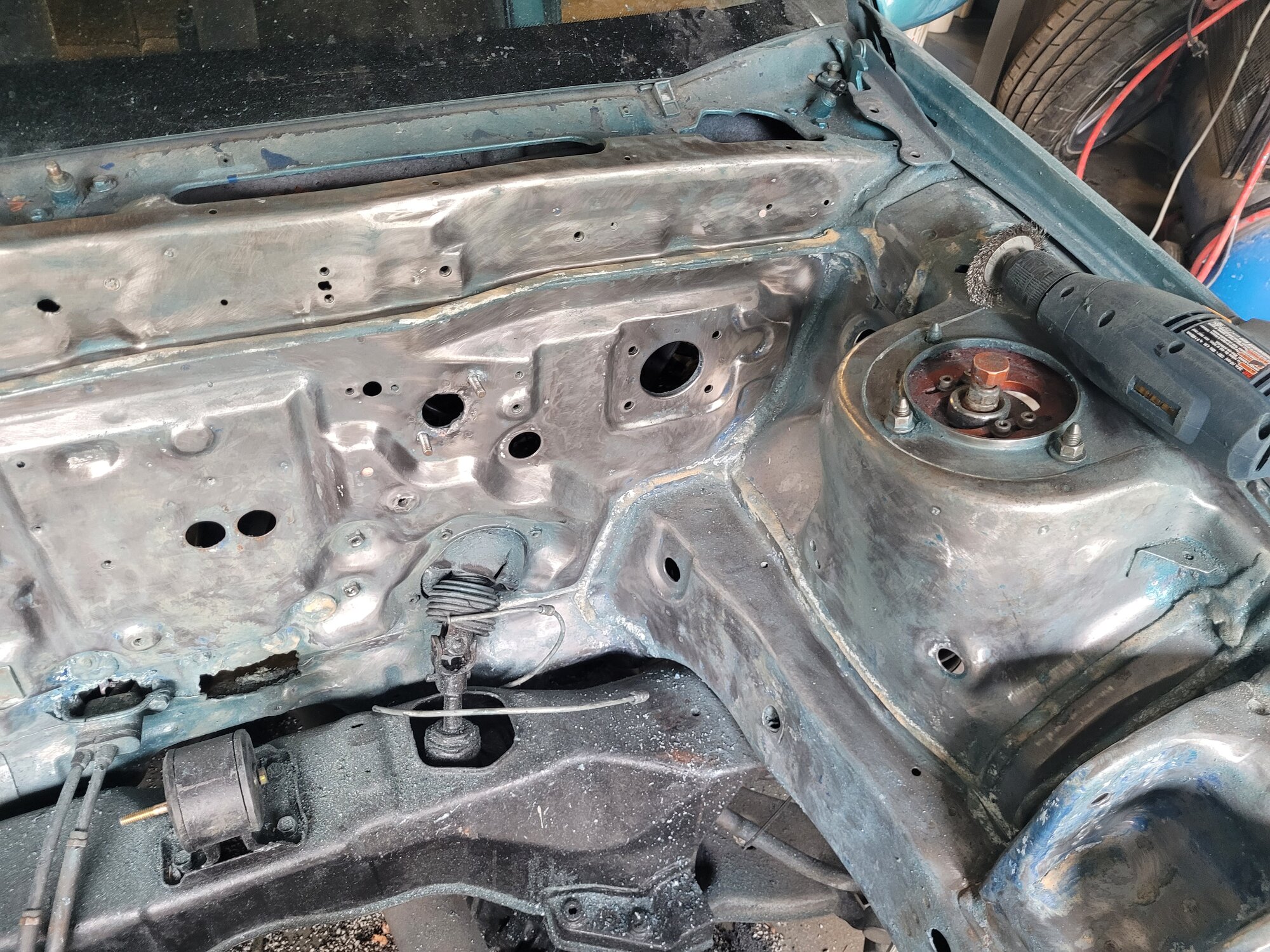

100% stock, un-wrenched 1g. Been sitting on it for over 20 years waiting for my chance to build. Diamond in the rough at this point?

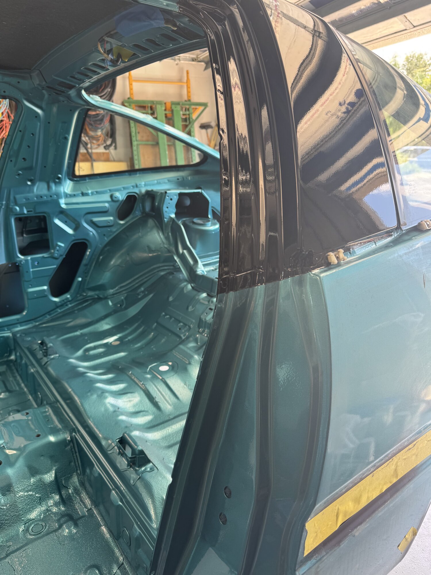

Well my house smells like paint again. OMGWasn’t planning on doing this today but got it prepped and ready to paint so said the hell with it let’s go for it instead of waiting for a long weekend which is preferred. It came out pretty good for battling the storms around here today and not taking a whole day to prep the garage as much as I normally do. Couple of tiny pieces of lint or something did get on it in a few spots which bummed me out with how good the paint job looked overall. Maybe we can correct it out later? Paint gun gave me a fit during the base coat to start, had to take it apart and re-clean every part three time before it would behave, that was fun right in the middle of trying to spray.
Awesome job! You do great work especially out of the garage. I now know first hand how hard it is to paint in a garage.
Thank you. Ya it’s definitely tough and been a good learning experience. If I can ever build the house I want with shop I’ll be putting in a proper paint booth!
So this may seem silly to some but today was actually a milestone for Eris and I. She officially got her first new parts installed! :p

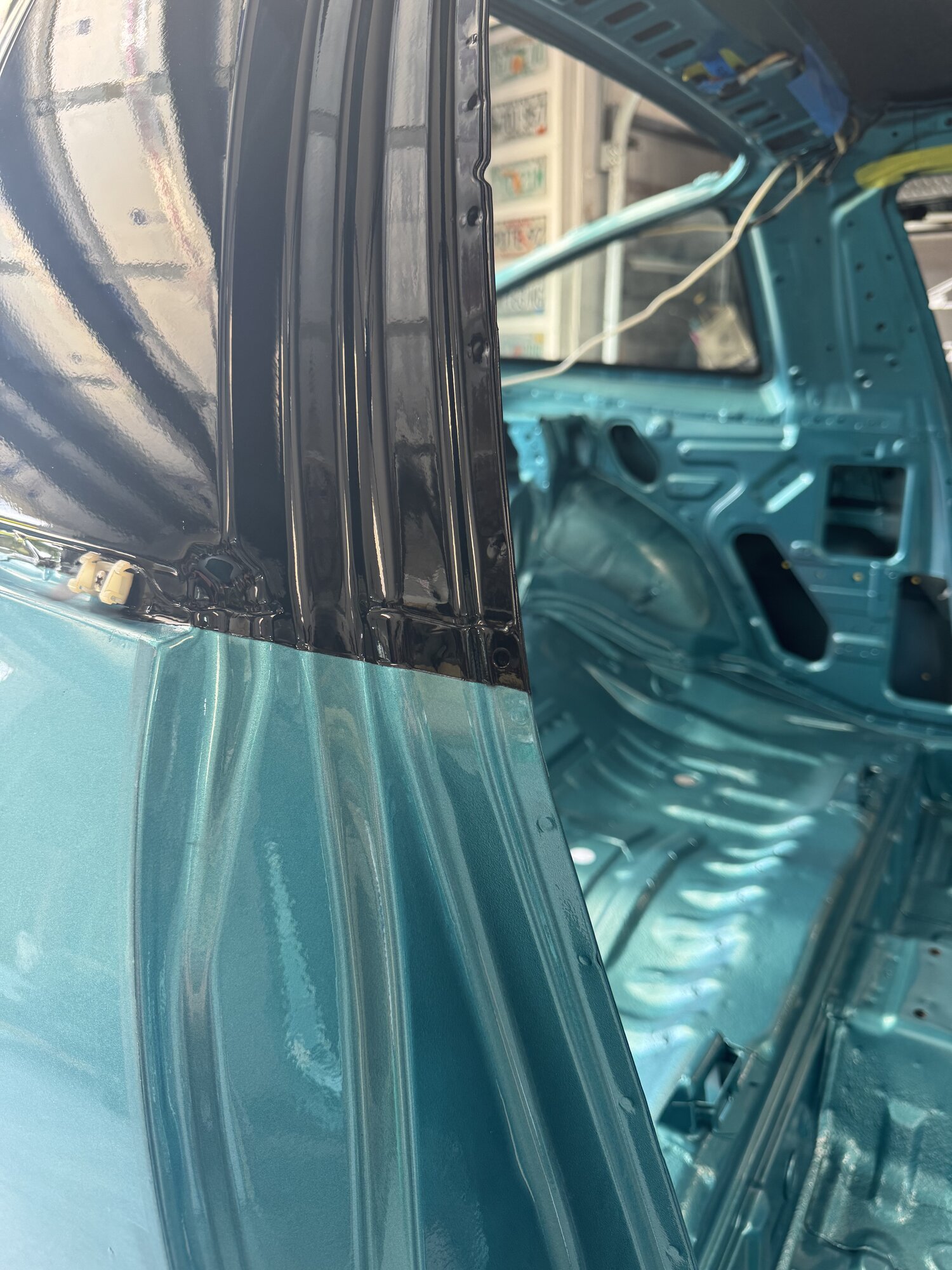

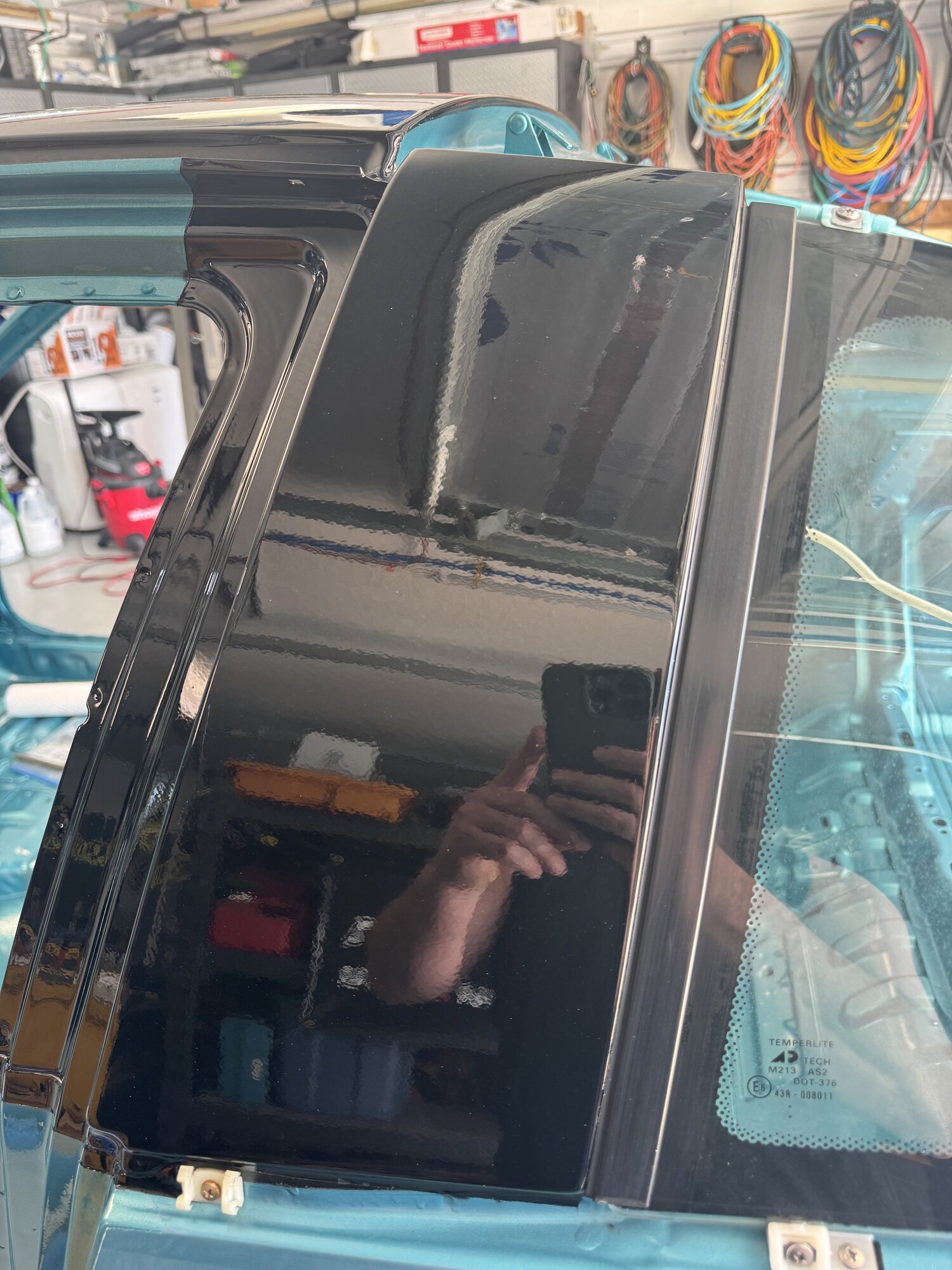

Not gonna lie I was dragging my feet the last couple of weeks to pull the plastic and tape as I was terrified about the lines between the black and blue getting screwed up. All in all definitely not perfect but I reckon pretty damn good for in my garage with a cheap setup and it being my first time, at least that’s what my wife says.
I’m an idiot though I forgot to back tape the two holes on top of the door jambs and got black mist overspray on the beautiful jamb. Hoping I can get that off with some clay maybe?
Edit: Clay did not work. Tried three different types. 5000 grit Trizac sandpaper and Chemical Guys luber spray with lots of rubbing got the overspray mishap removed with zero damage to the clear coat. Was VERY happy with this!
