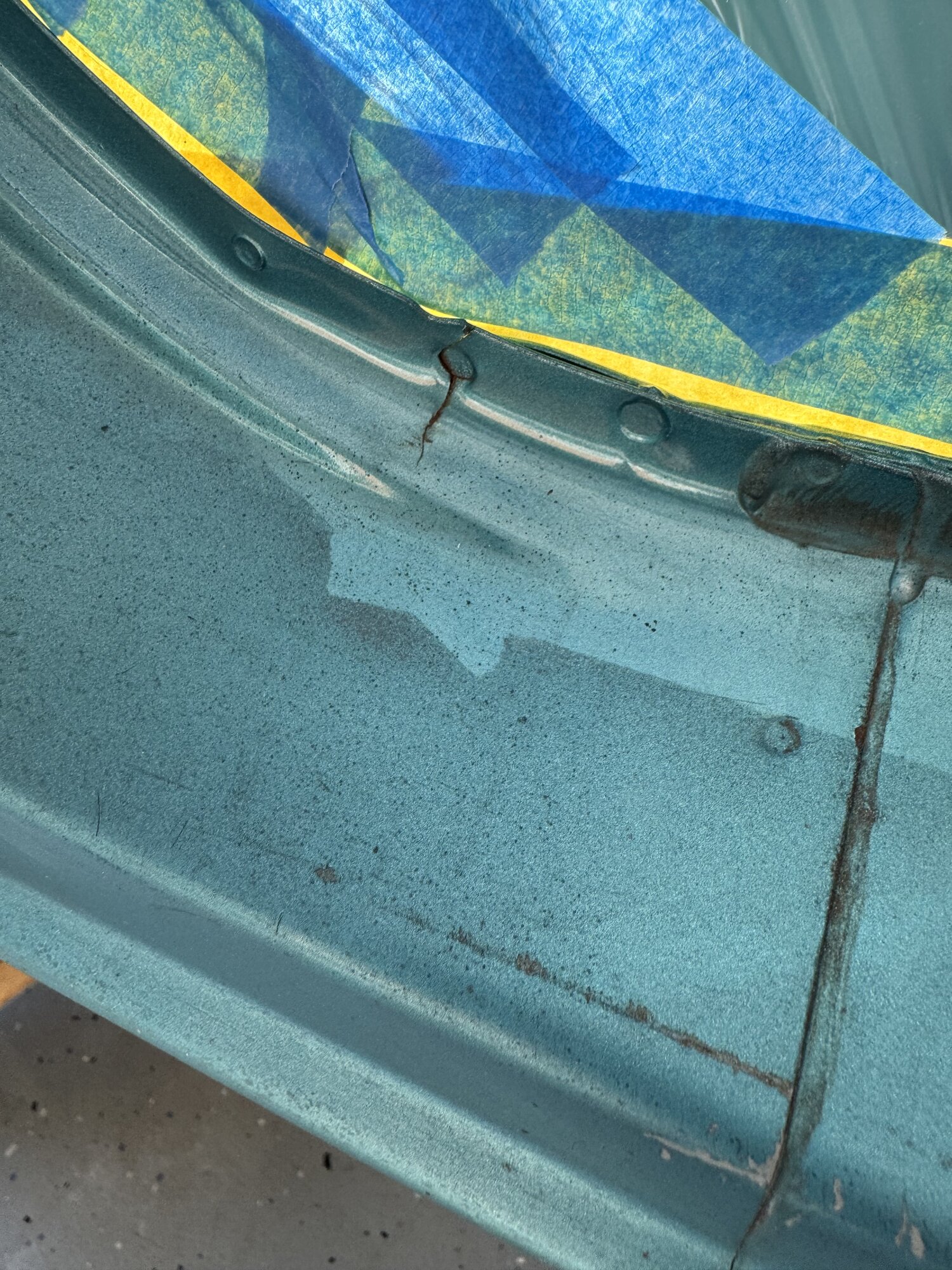

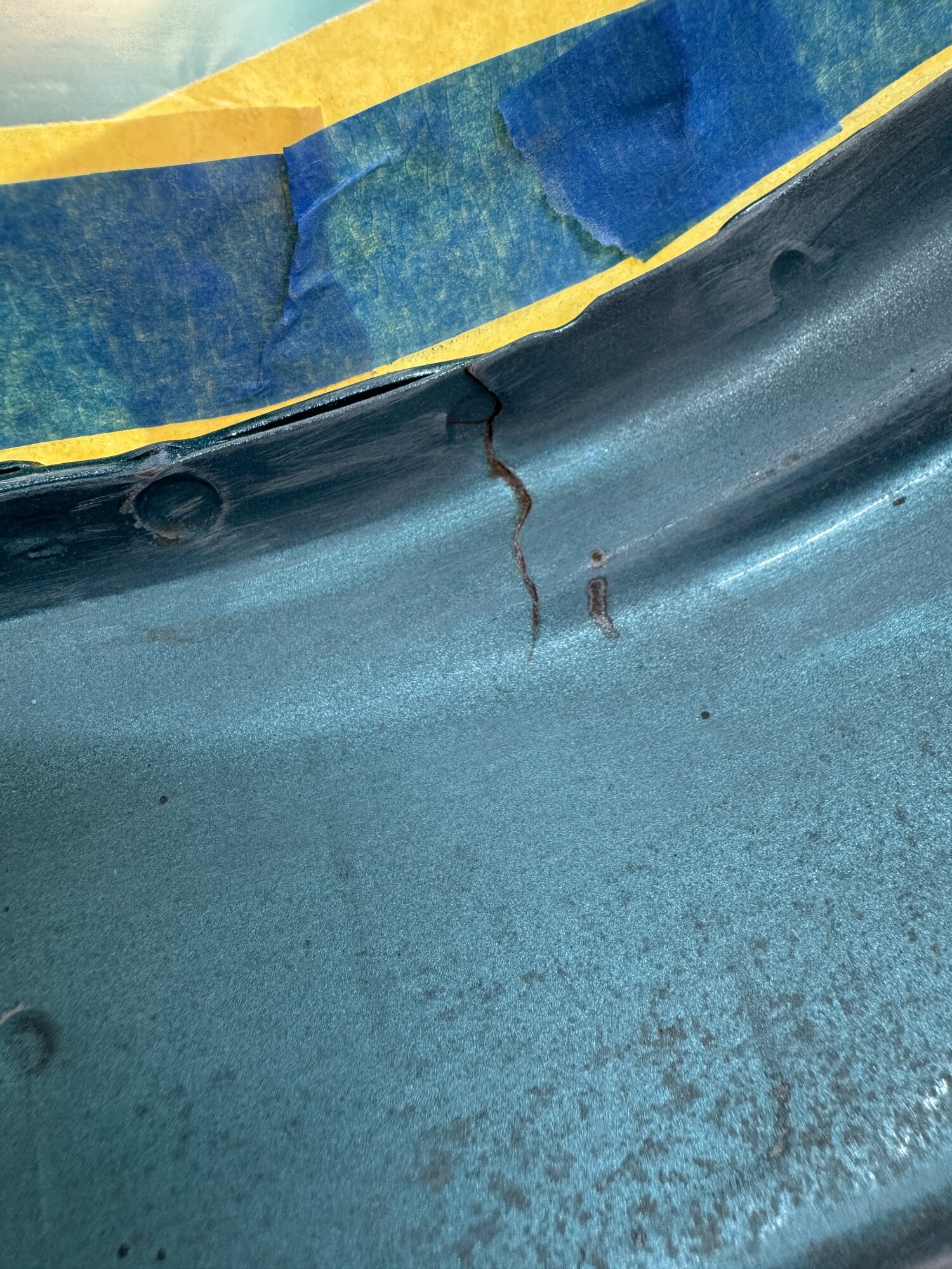

So I finally got a few hours to get to work on Eris, mostly prepping for paint around the hatch wells and door jambs. Then found two cracks in the jambs in identical spots on both sides. No idea how I haven’t seen these before. Looks like I’m going to have to practice with my little welder. Anyone else have these cracks? I’ve never welded before and was hoping to have much more practice on scrap metal before I needed to implement skill on the car. 🙄 Anyone have any advice on how to tackle this type of repair?

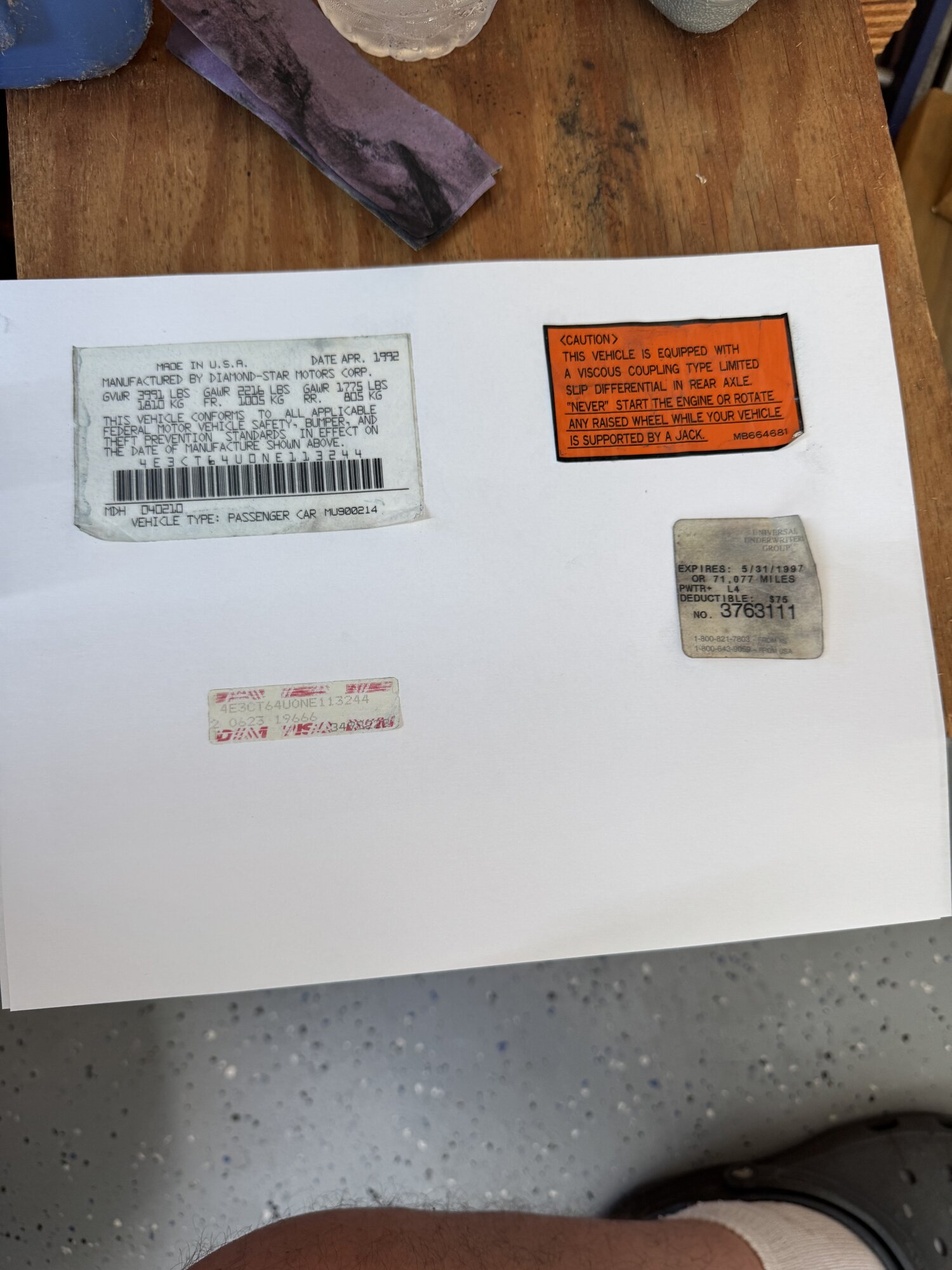

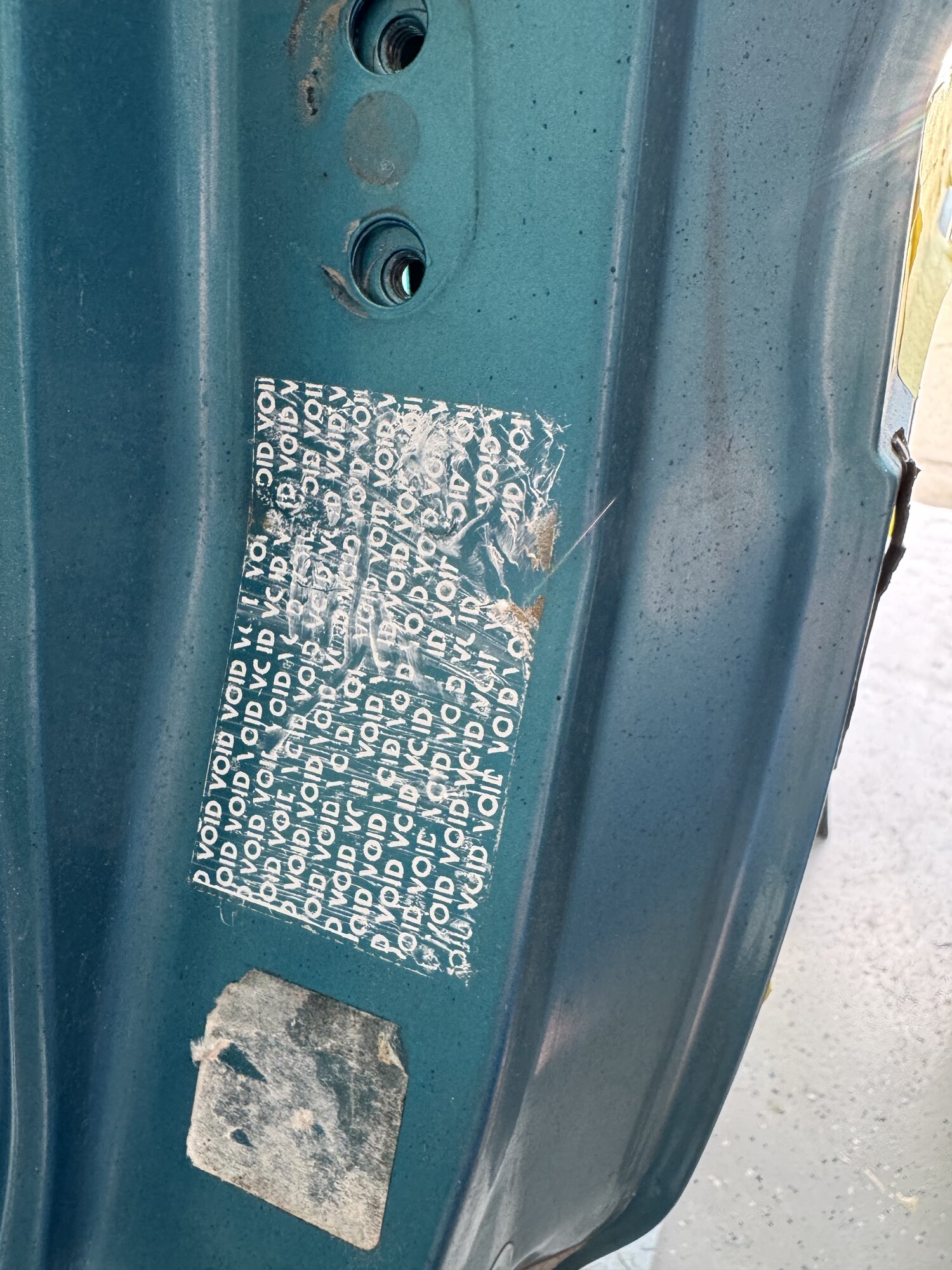

Also while removing the jamb stickers a “void” pattern appears while removing the car info sticker. Thought that was kind of neat never removed one before. Going to see if my printer can duplicate some for me to put back after paint, without the void checkerboard of course.
Mine did that same thing trying to get it off, it was already destroyed by previous owner so I just tore it the rest of the way off. As for those cracks mine decided to do it on the strut towers which I have no idea why. Glad to see you putting in work, we are dying to drive these things again!
Your car must have had a guest appearance on Dukes of Hazzard.
That's weird. At first I thought it was from having it on a rotisserie but that looks older.
Yah I think I had the weatherstripping still covering them until later on so just never noticed. And never left the car on the rotisserie longer than it took to do the work for the day/weekend. They’re pretty stout even in the air.

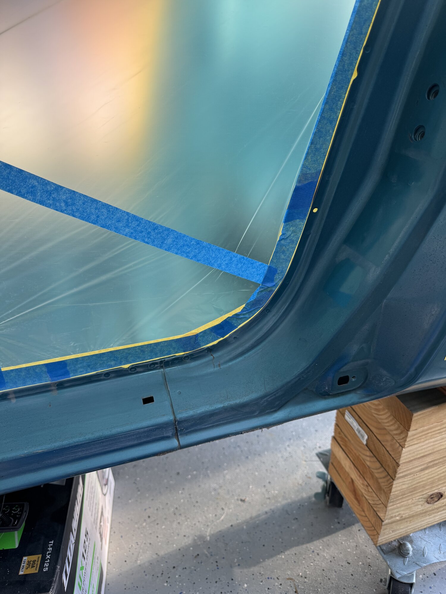

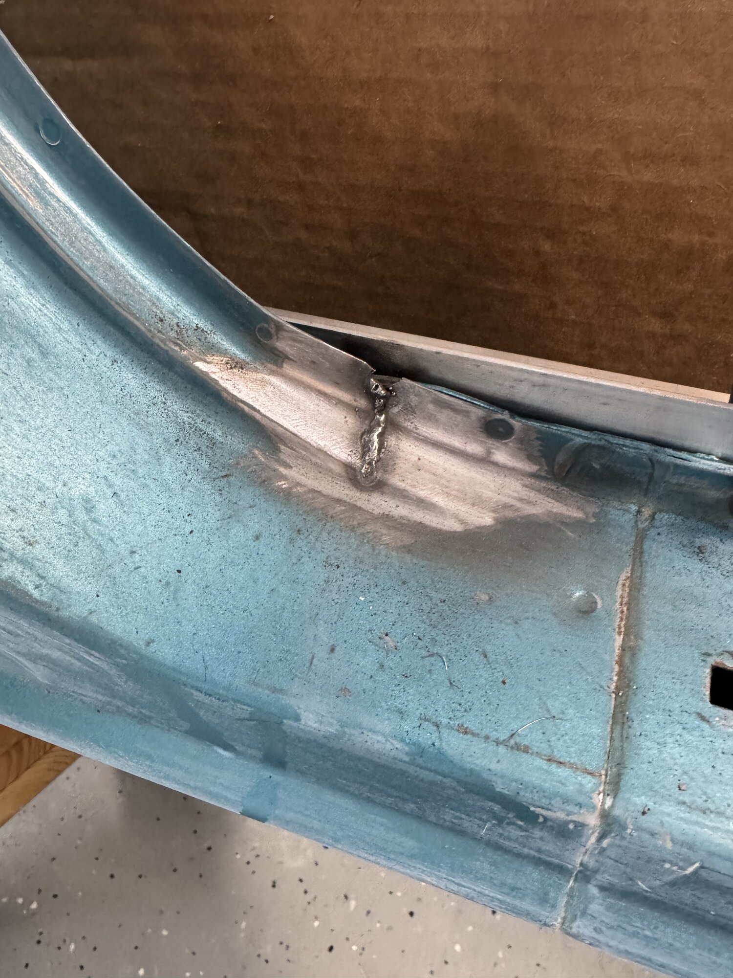

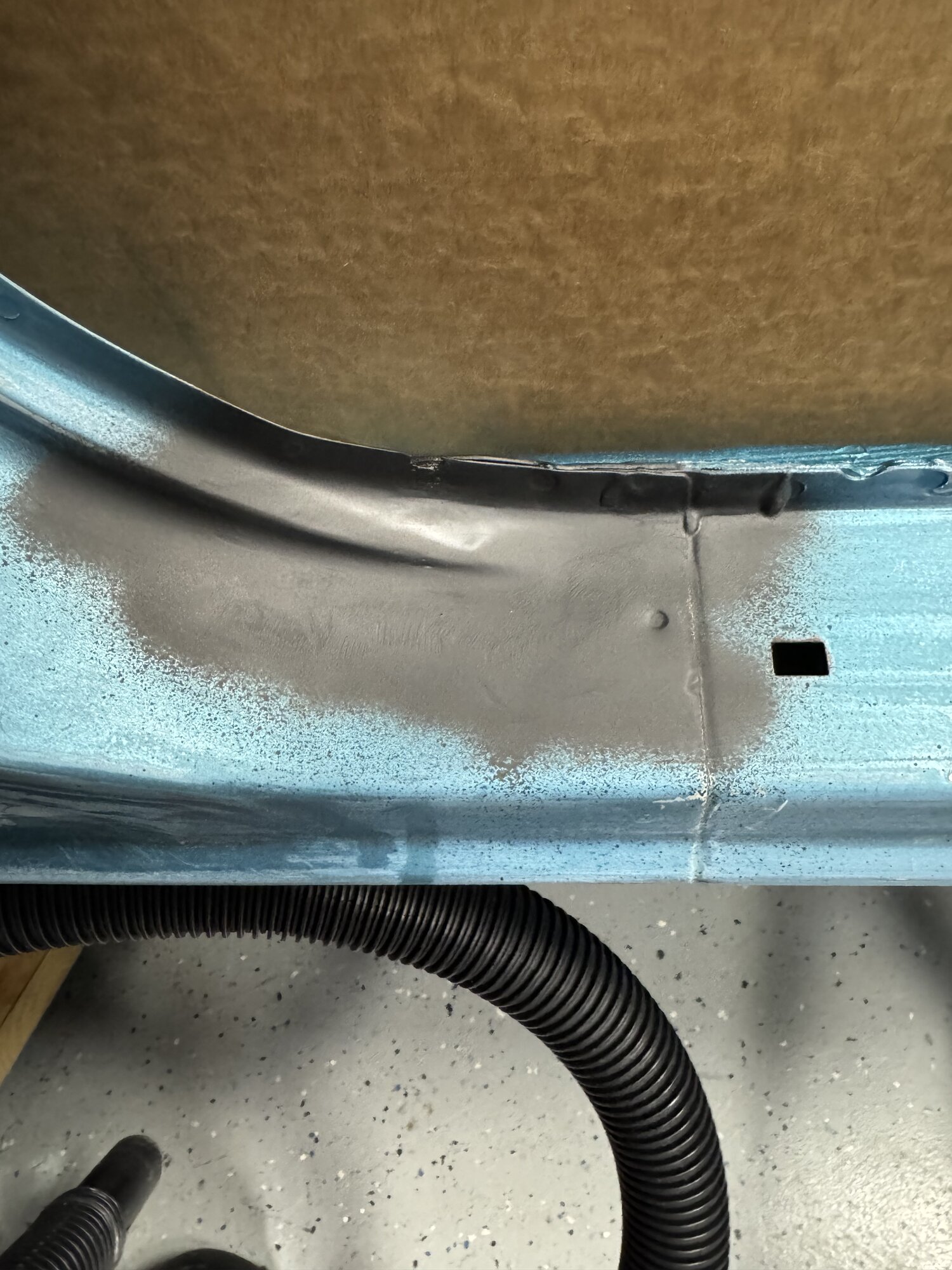

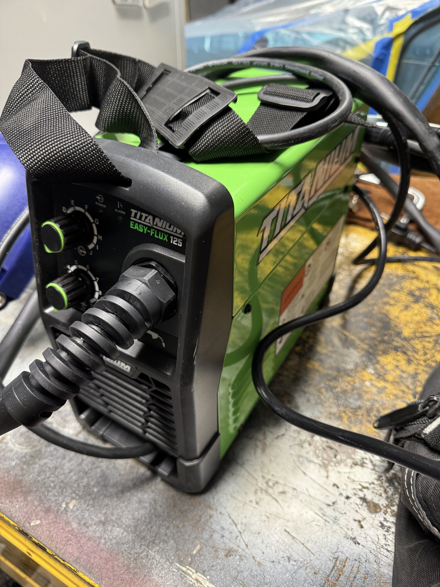

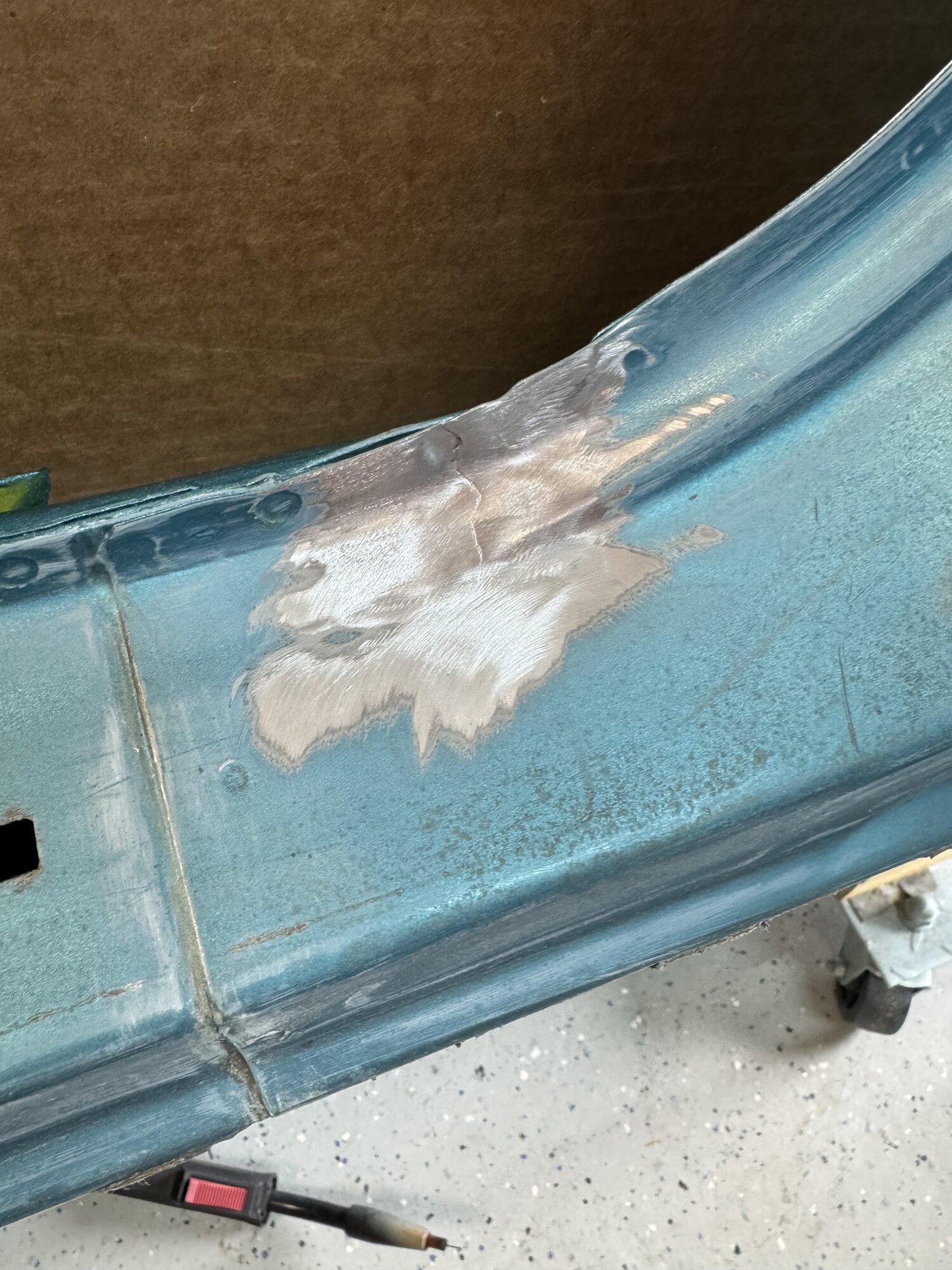

So I tried my hand at welding for the first time ever. Practiced on a few scrap pieces of different gauges and the went to town. Not the greatest but I tried. The metal thins out so much on these corners it’s crazy. Lowest setting on my little 120v flux core machine and still wanted to blow right through instantly.
I have that same welder and it does good for what it Is. You really can't go wrong for the price.
Turned out great in my opinion.
Thanks man. Was definitely harder than I expected. Good learning experience though.
It really does well with thicker metal but either way whatever a guy welds in just grind it smooth and it'll look great. It's tough to weld real thin stuff with that welder but it can definitely be done.
Even when I use expensive welders most of what I weld gets the flap disk to make it look nice like the strut towers and what not.

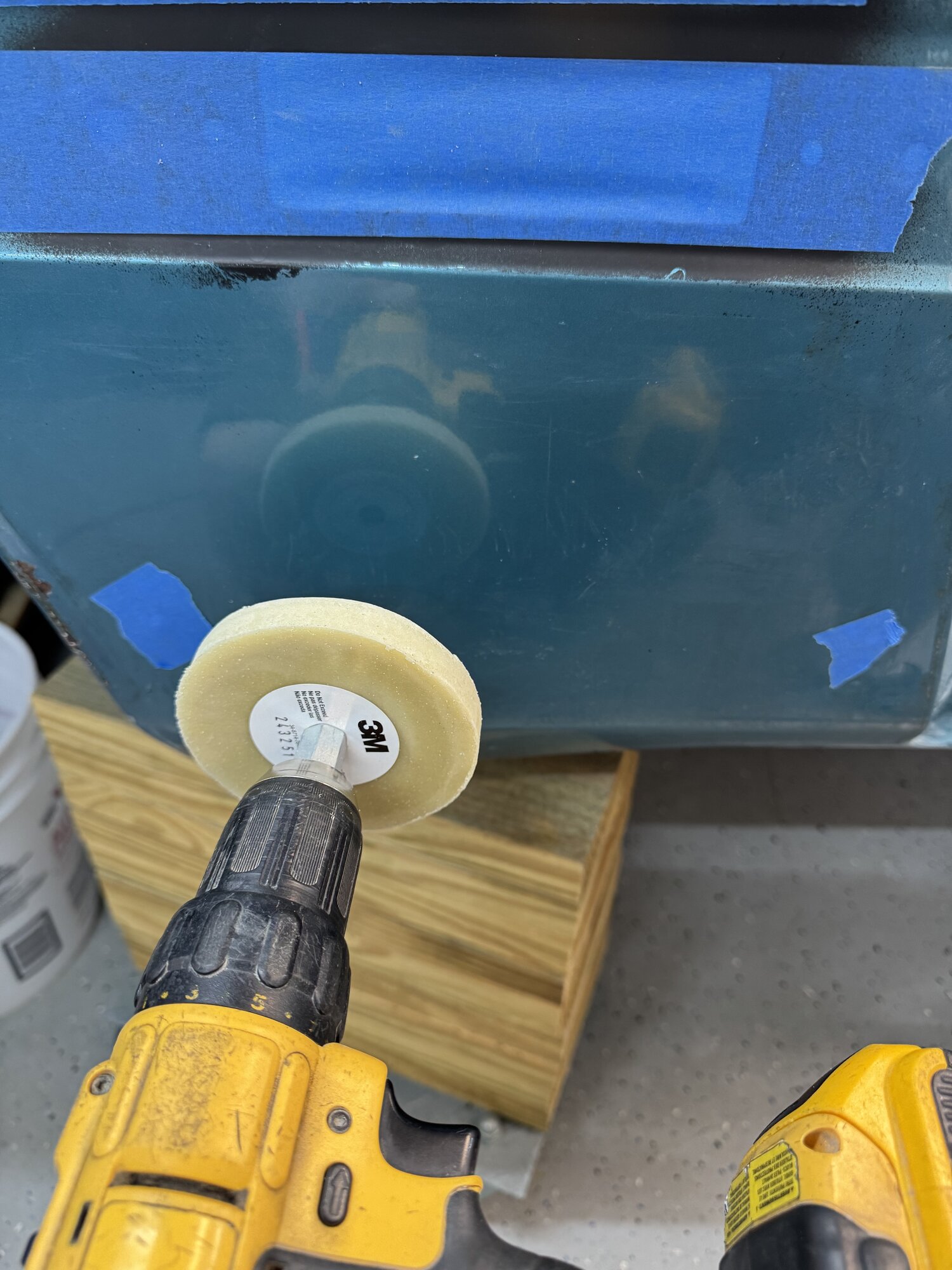

One thing I’ve been plucking away at was removing the old moulding tapes, some would come off with enough convincing, some wanted to live there. Tried about every type of solvent I could think of. The stubborn ones wouldn’t give up the ghost. Finally got smart and got the proper tool for the job. Holy crap does this thing work good!

I have one of them and they work amazing. They make quick work of any hard jobs like that. Just gotta be careful not to get too greedy or you can burn thru clear.
Yah I could see that. Repainting everything so luckily I don’t have to worry about that part.
