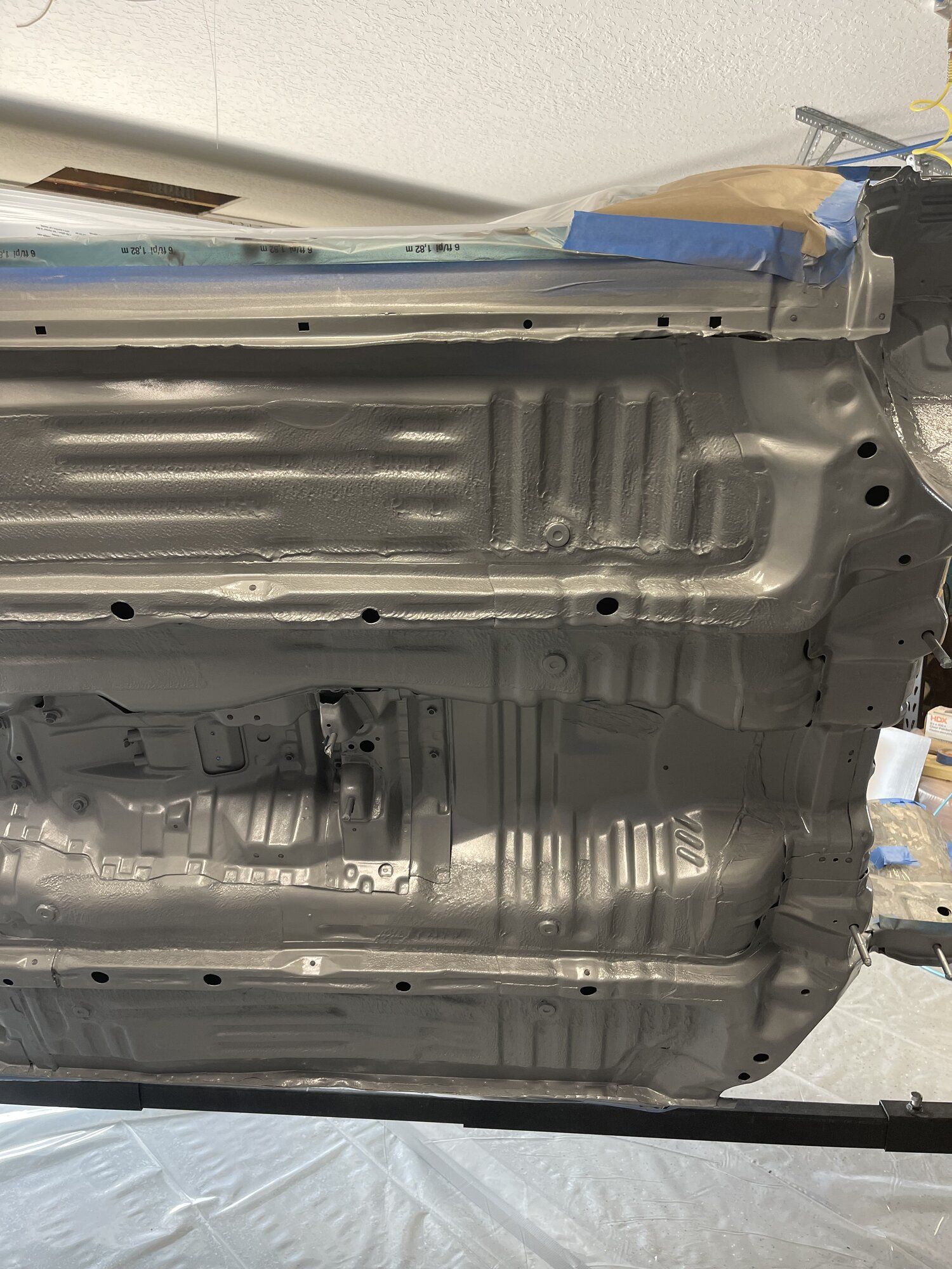

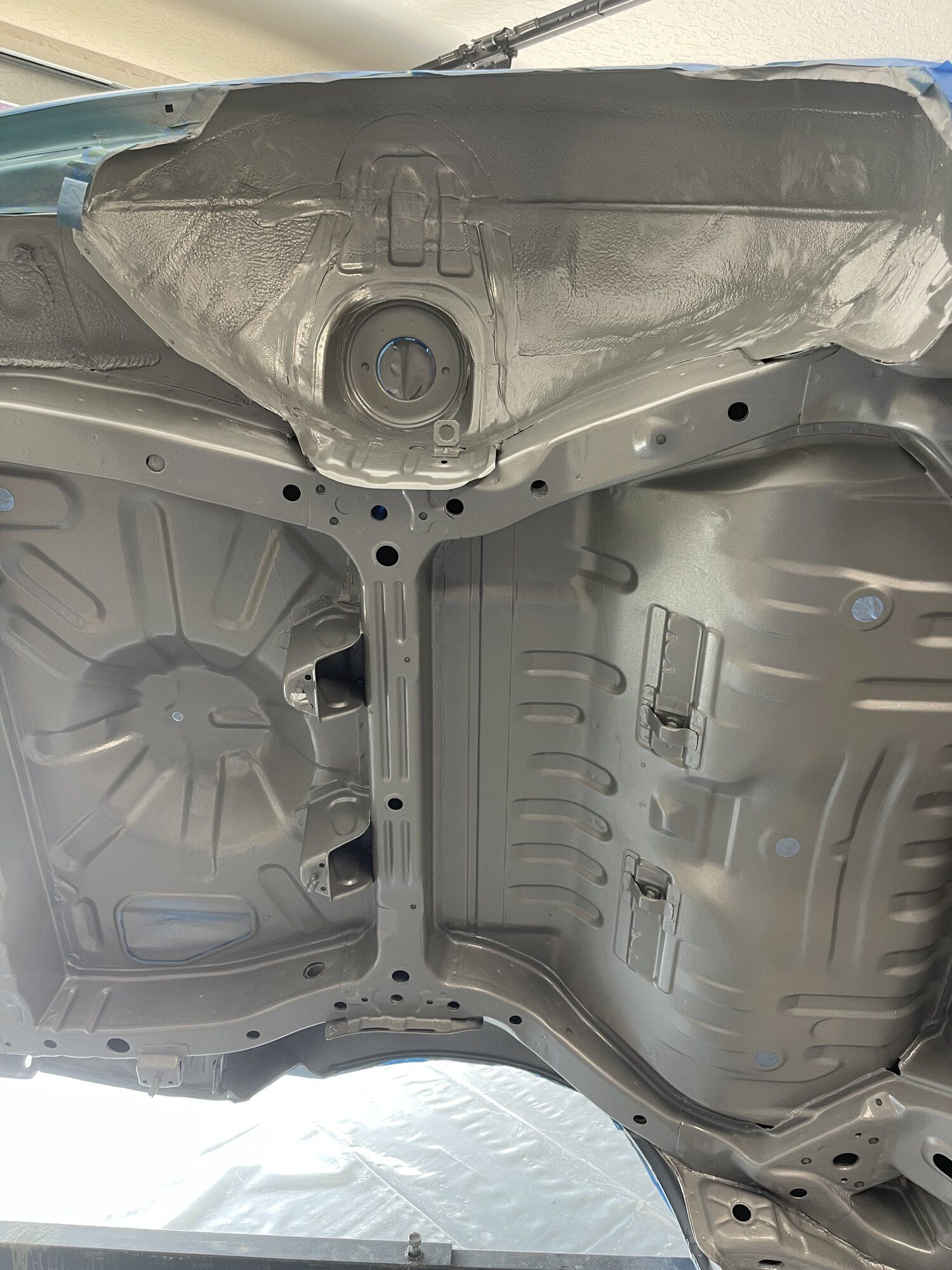

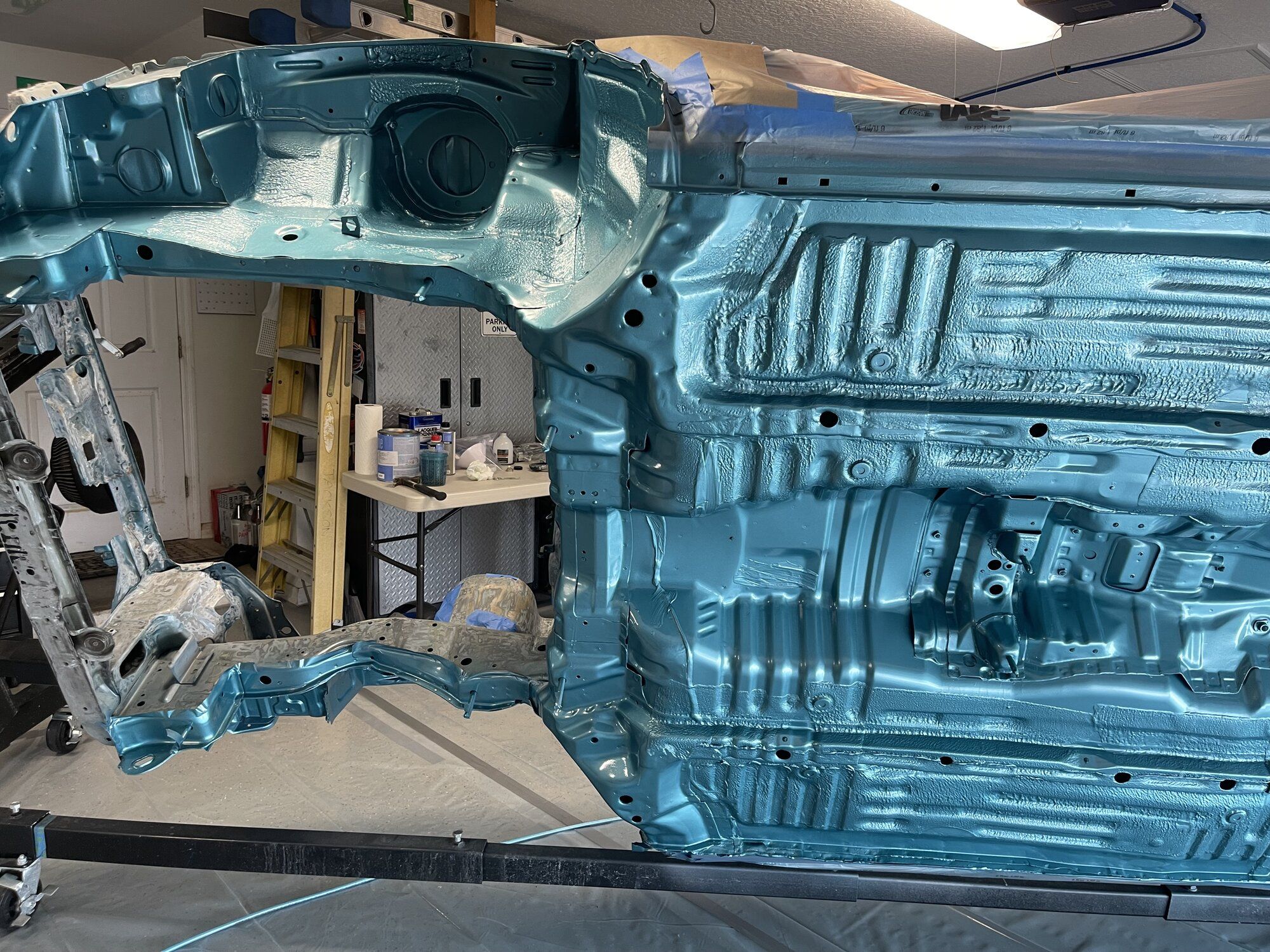

100% stock, un-wrenched 1g. Been sitting on it for over 20 years waiting for my chance to build. Diamond in the rough at this point?

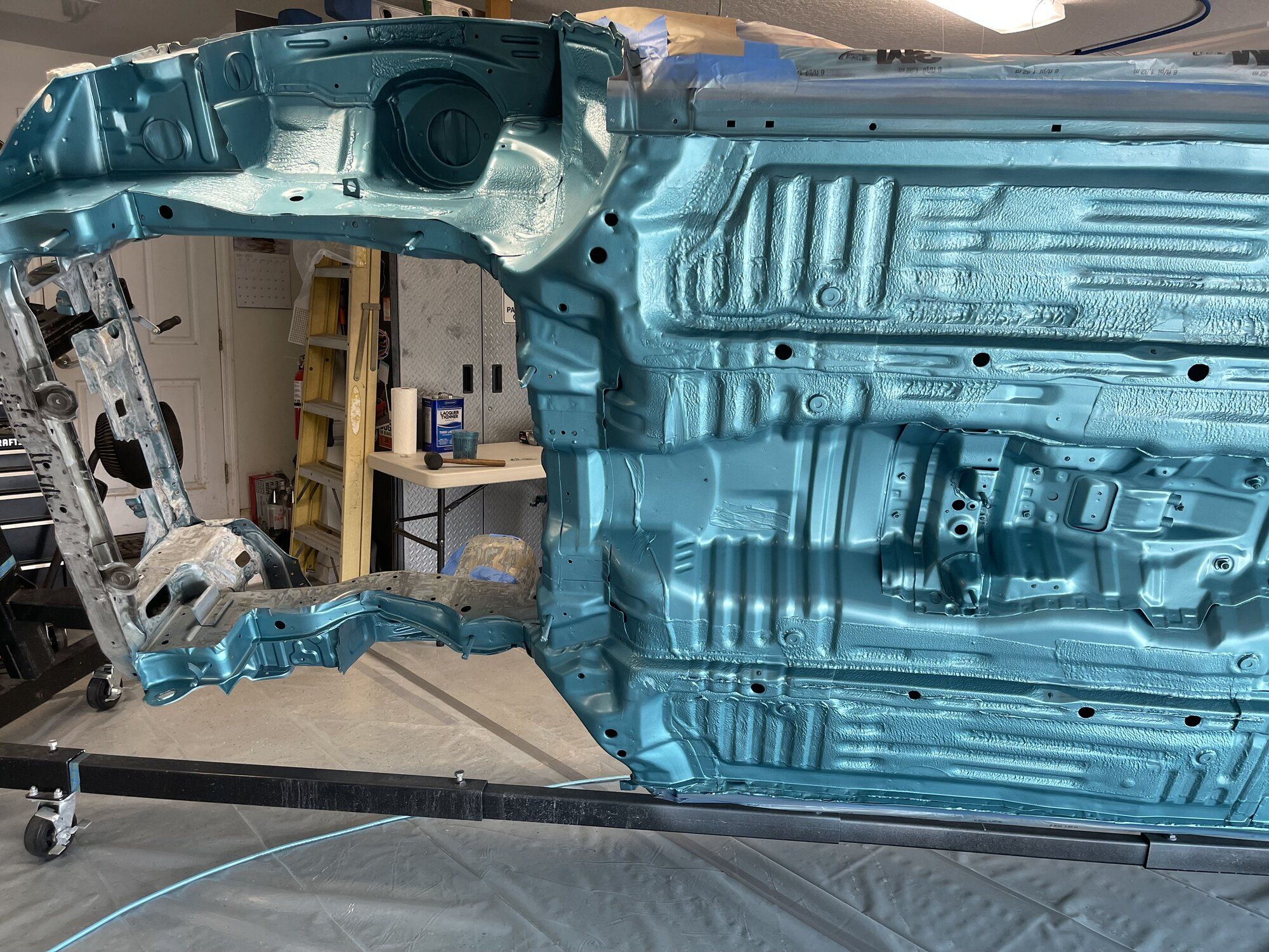

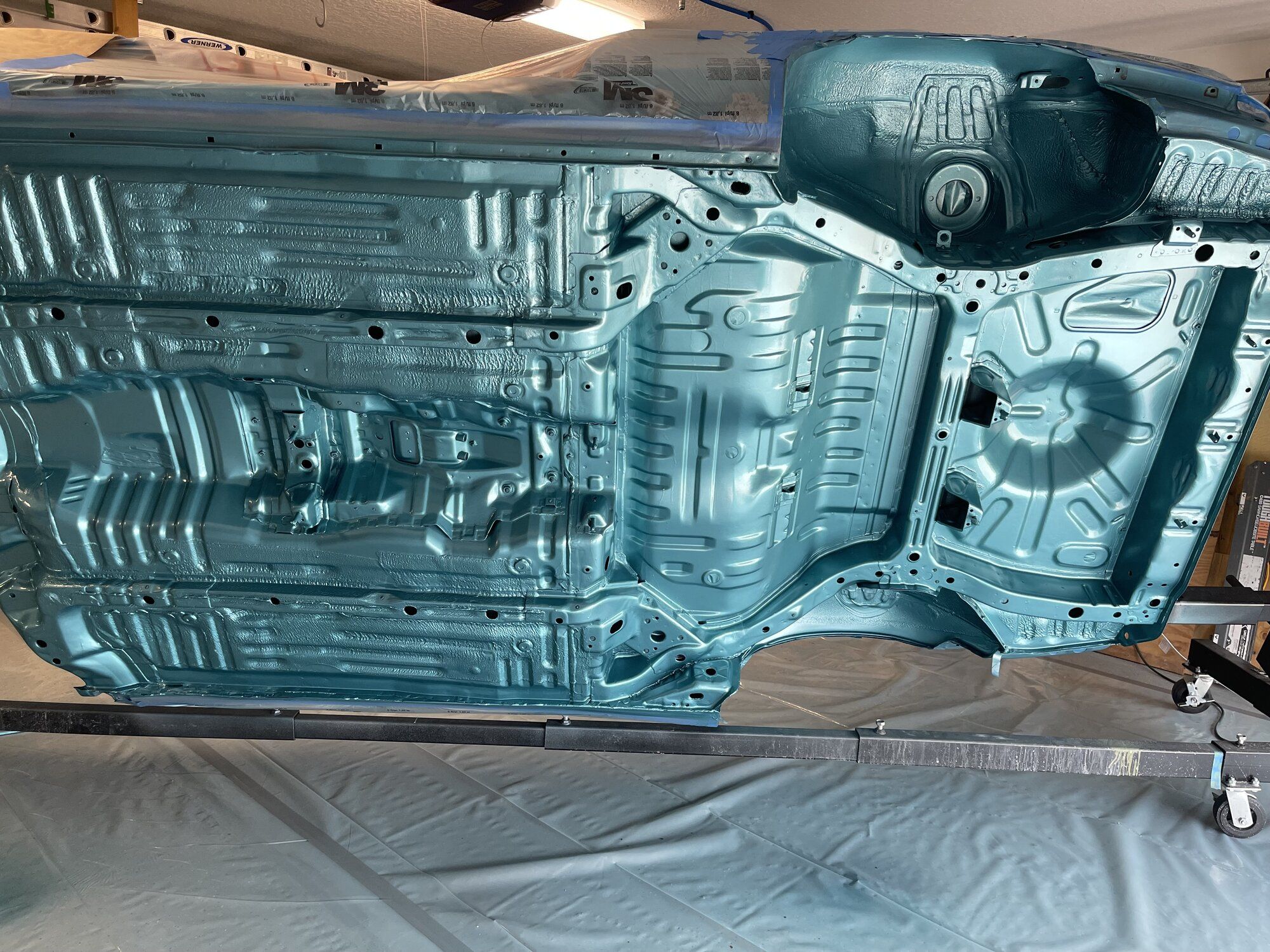

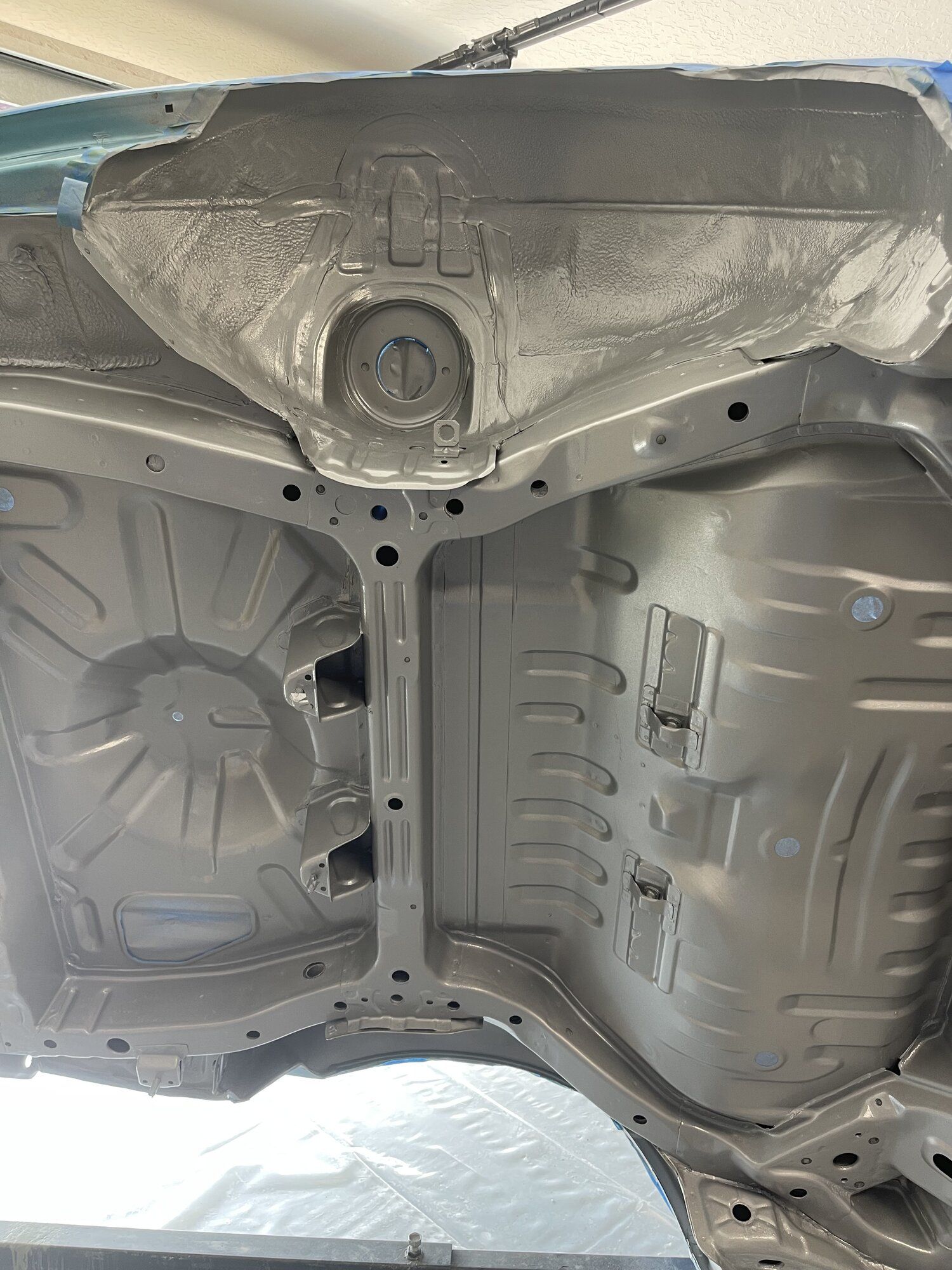

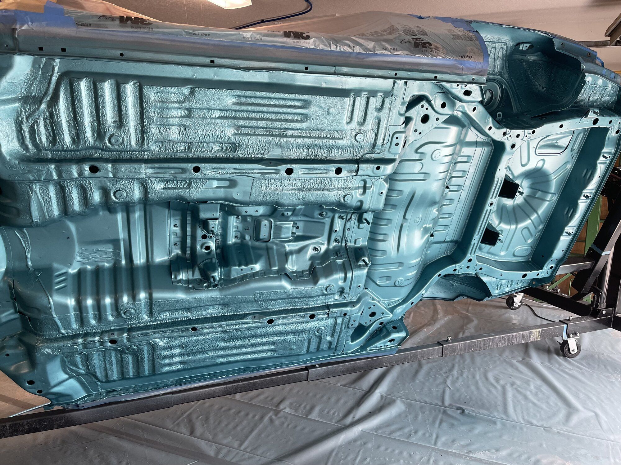

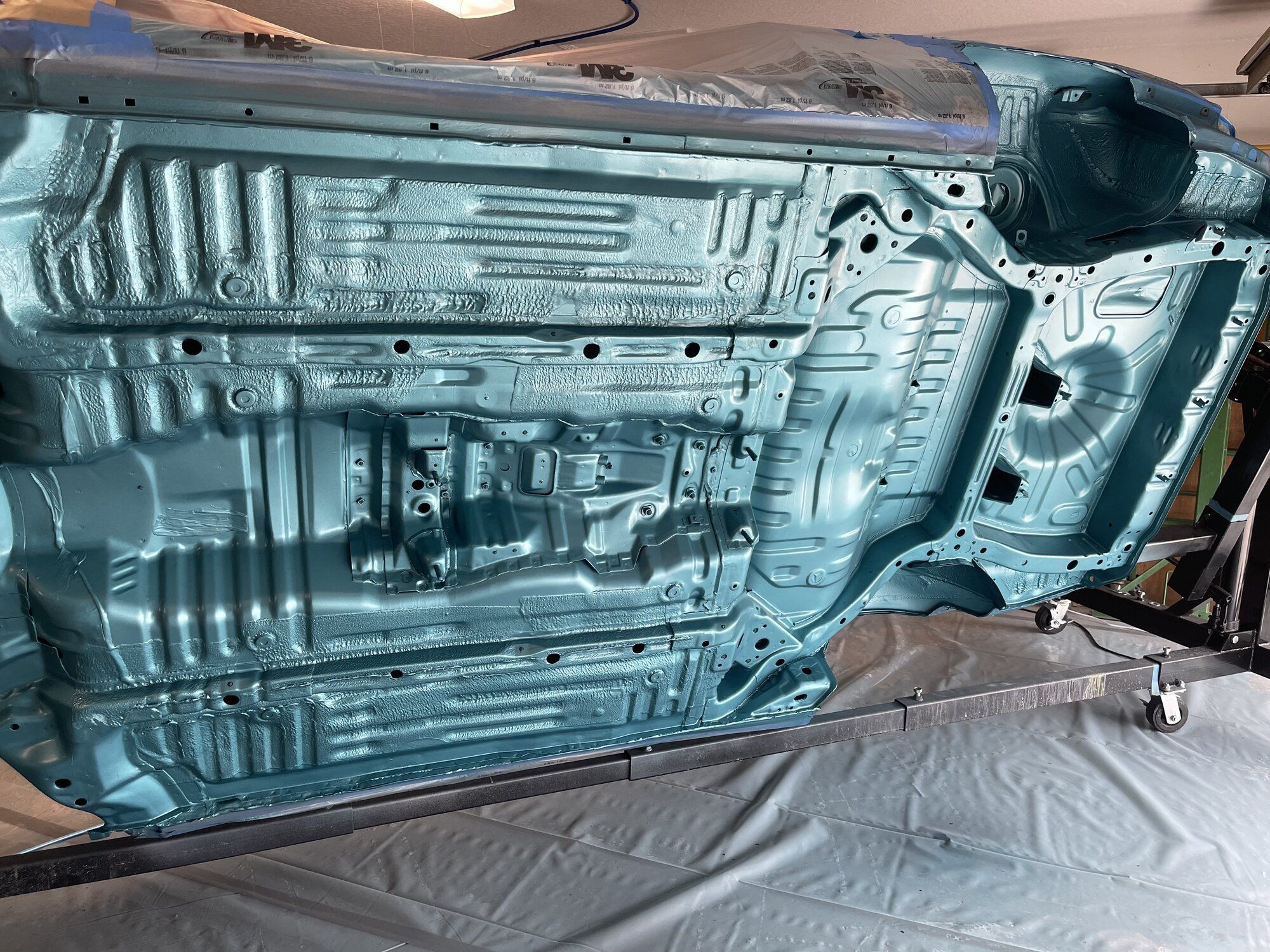

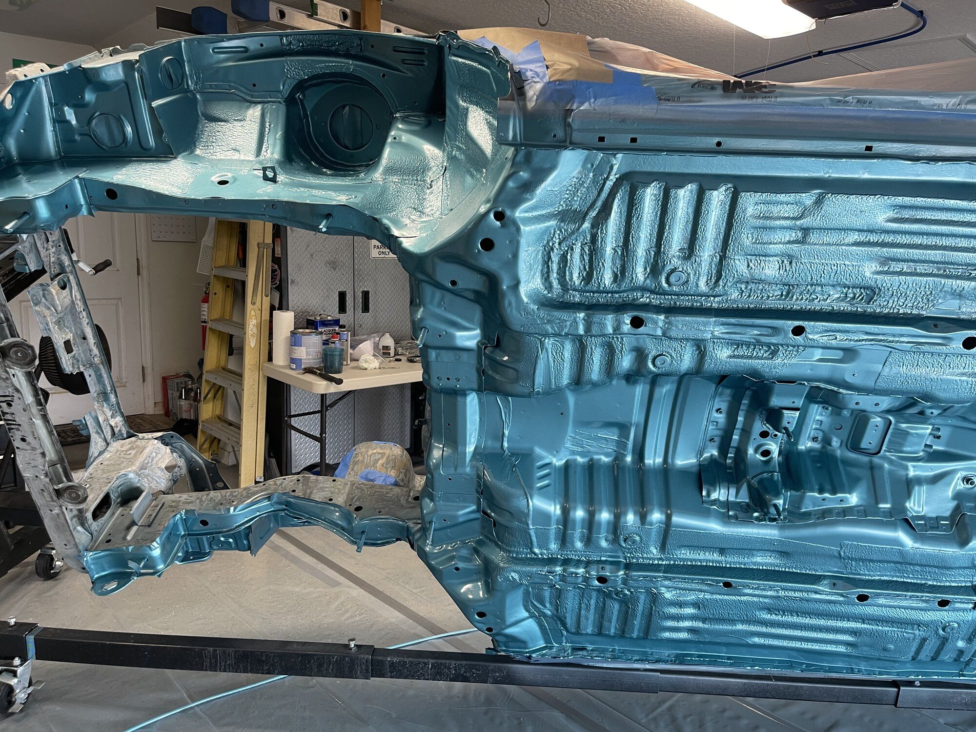

Well after some setbacks trying to get this done the last few weeks we finally made it happen.
Countless hours of prep. Lots of sweat and cussing, then all worth it.
Sanded/wheeled/etc.

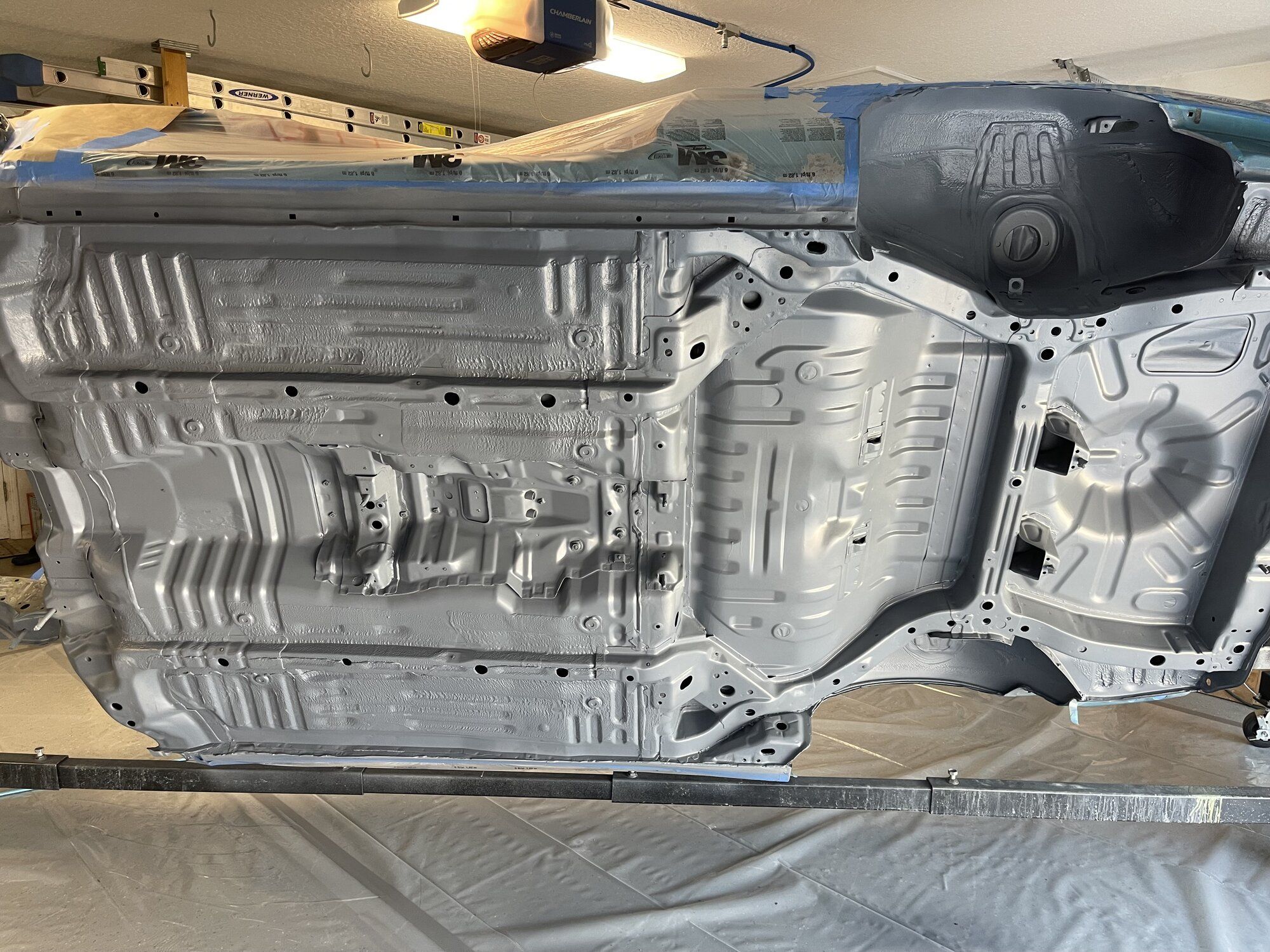

Internal frame coatings
Cleaned with “Pre painting prep” from Eastwood.
Doused in 70% isopropyl
Rust Encapsulator Platinum sprayed..
Epoxy Primer spayed..

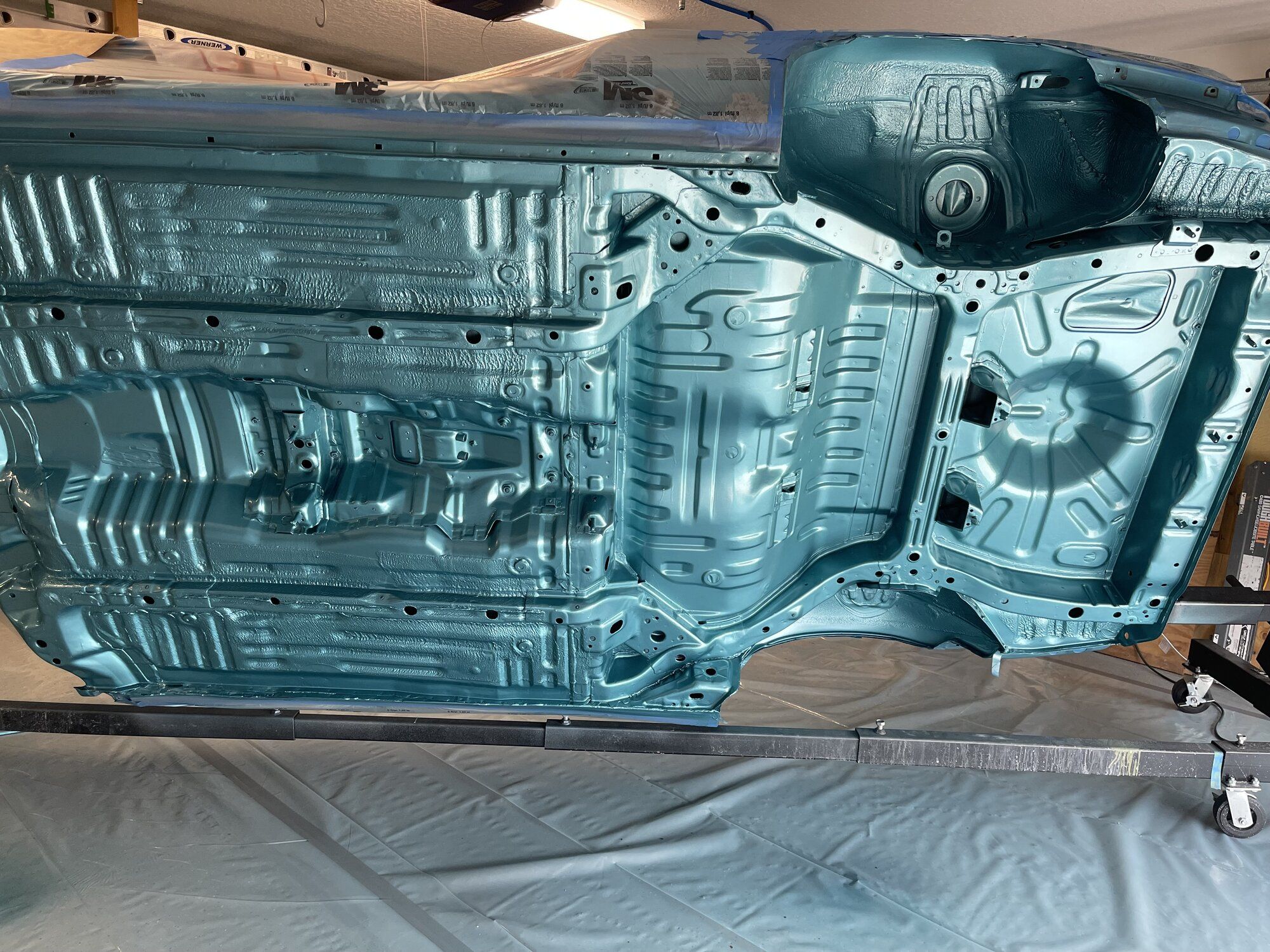

Single stage OEM color sprayed 3 coats..
2K clear sprayed..pics don’t show much of a difference but the added protection is there.
Rolled both directions each coat to ensure coverage. The rotisserie was great for this.
Looks awesome! 😍
Thank you sir
I had hoped to get this done any time other than summer but just didn’t work out that way. Needless to say this heat here is taken to a whole other level when suffocating behind a respirator too. I almost passed out a few times, gonna take a couple days to do nothing now! :cool:
Apparently I didn’t get any pics of the seam sealer I added or repaired somehow. :banghead:

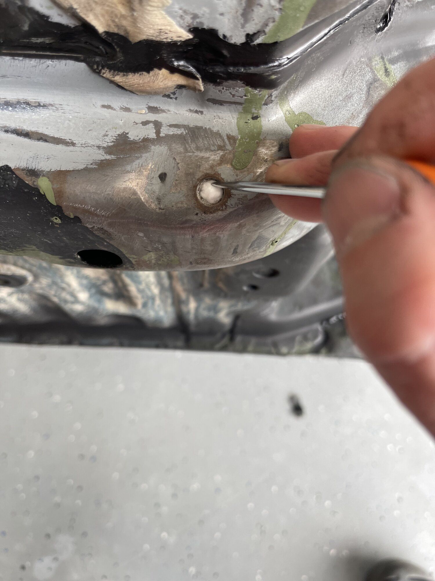

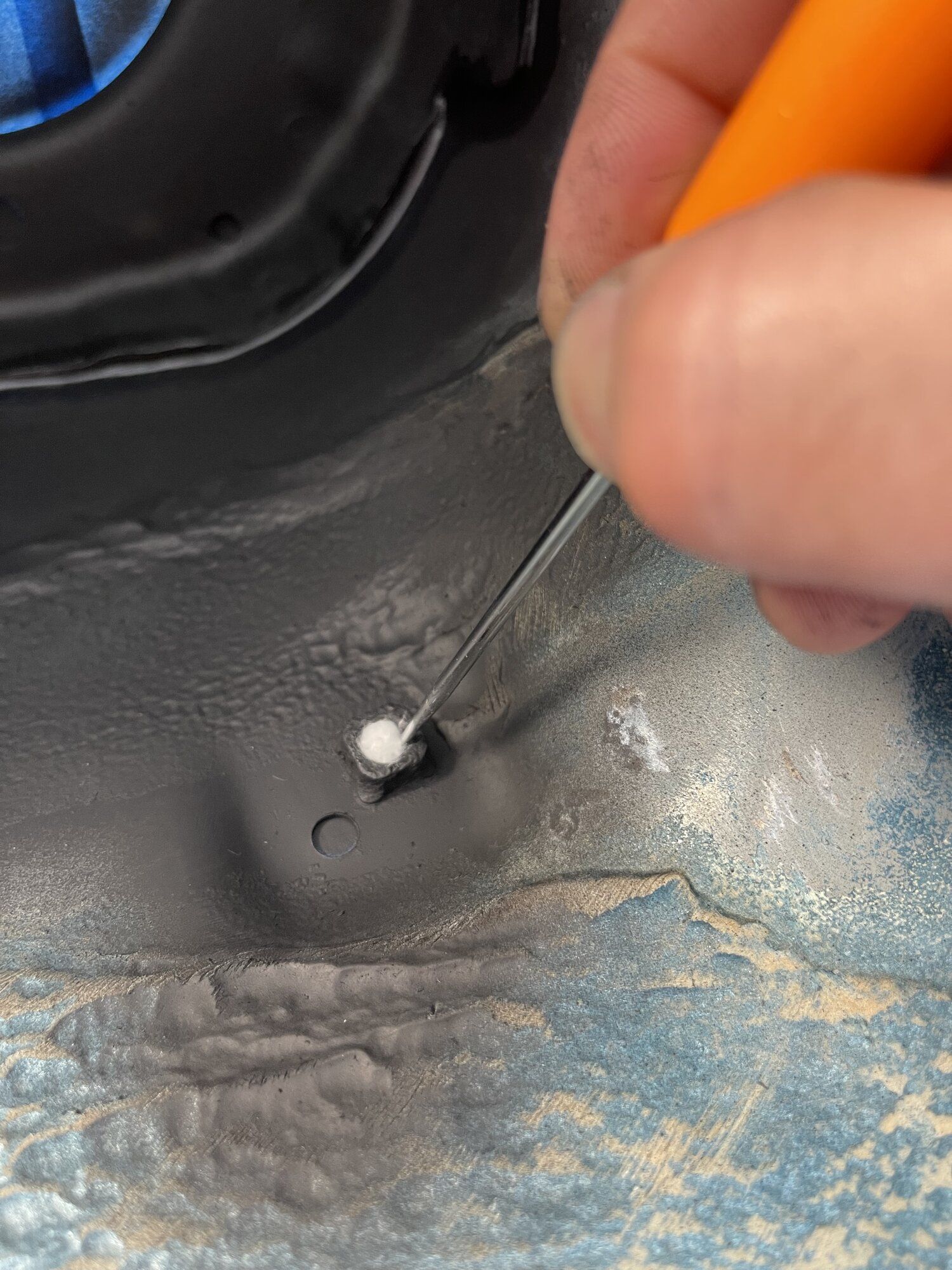

This is how I protected the internal threads of all the holes though while still allowing maximum coverage. It’s what I came up with anyways. Think it worked pretty well.

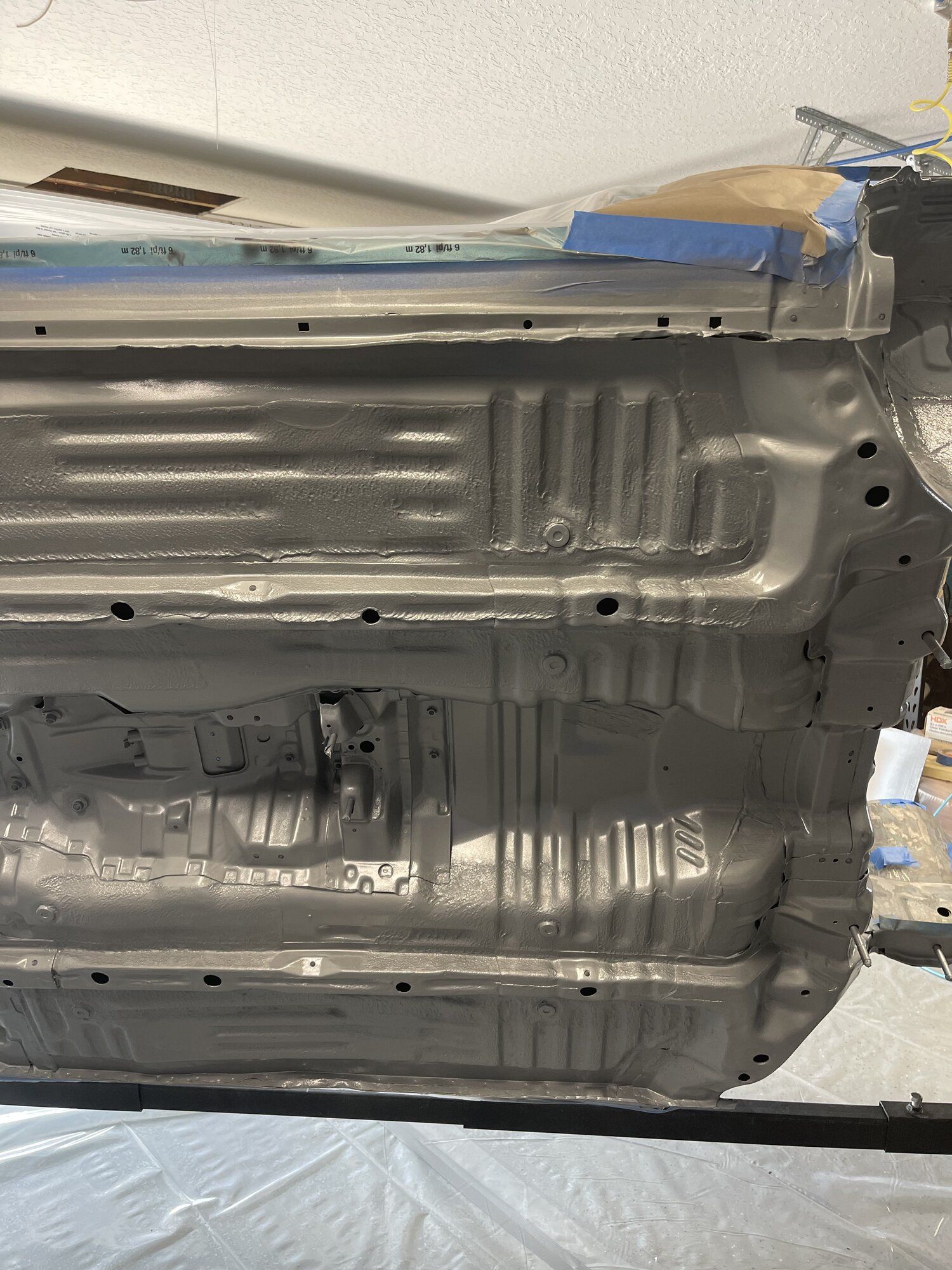

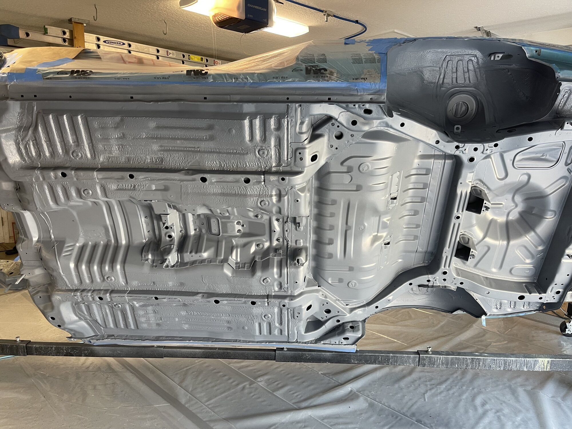

Sanded/wheeled/etc.
View attachment 700831View attachment 700832

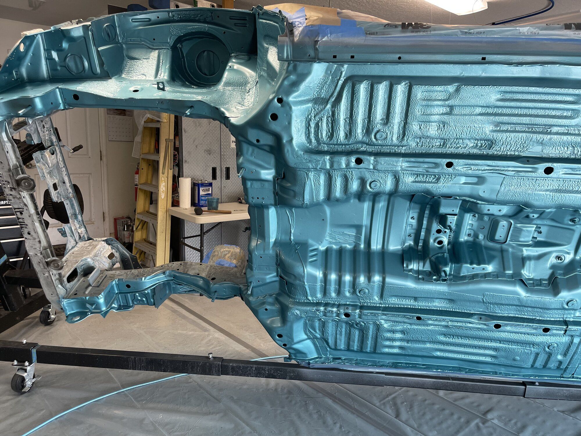

View attachment 700834View attachment 700835

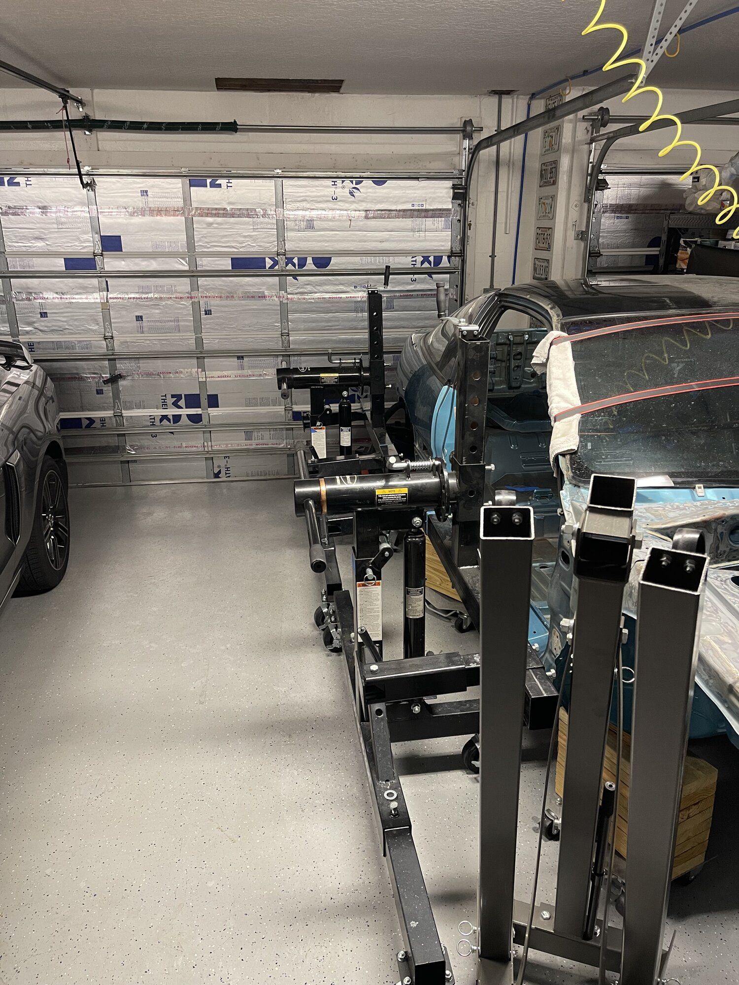

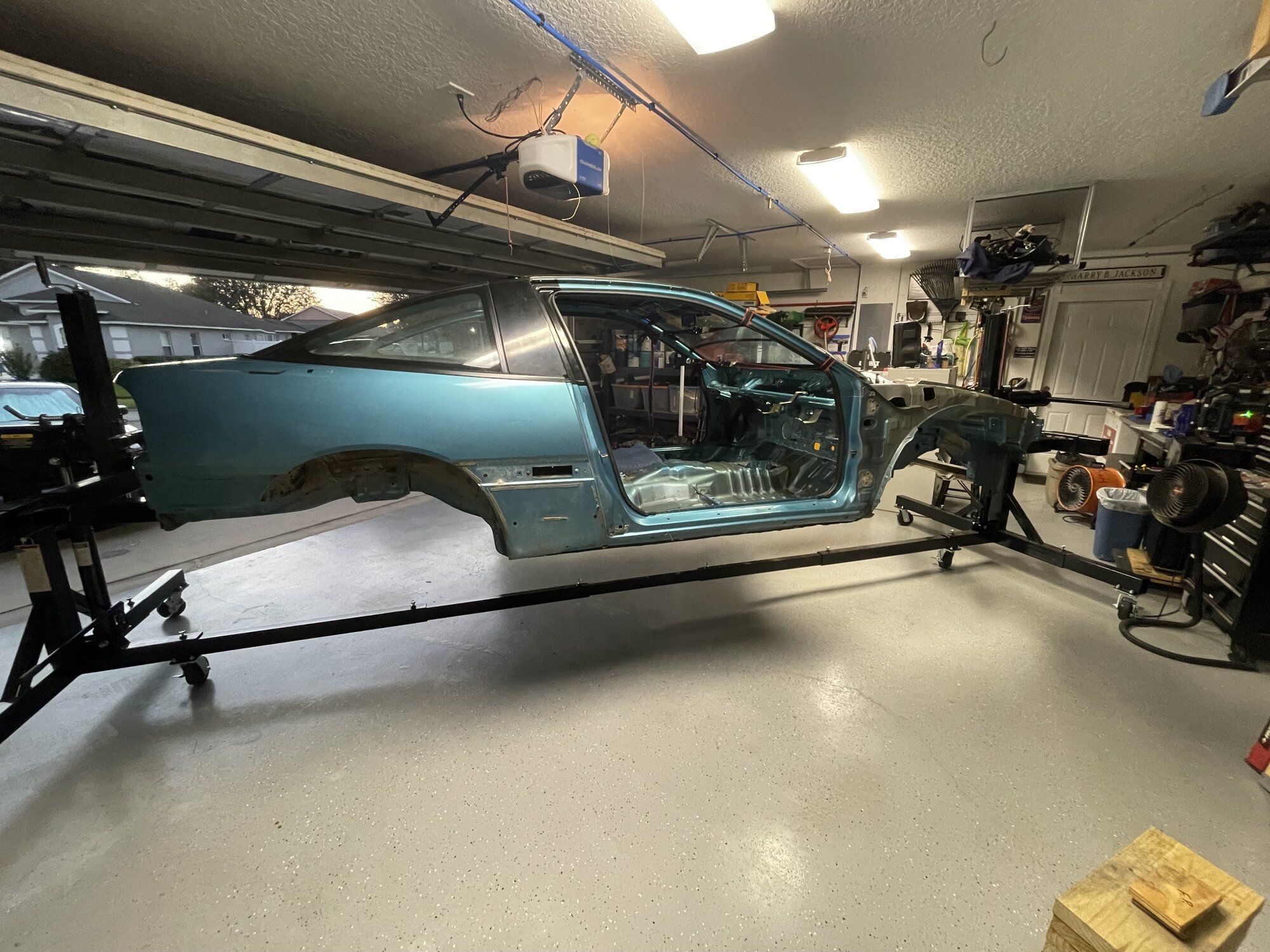

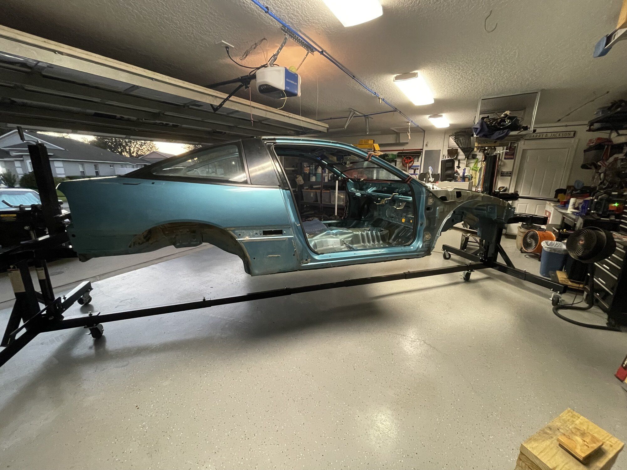

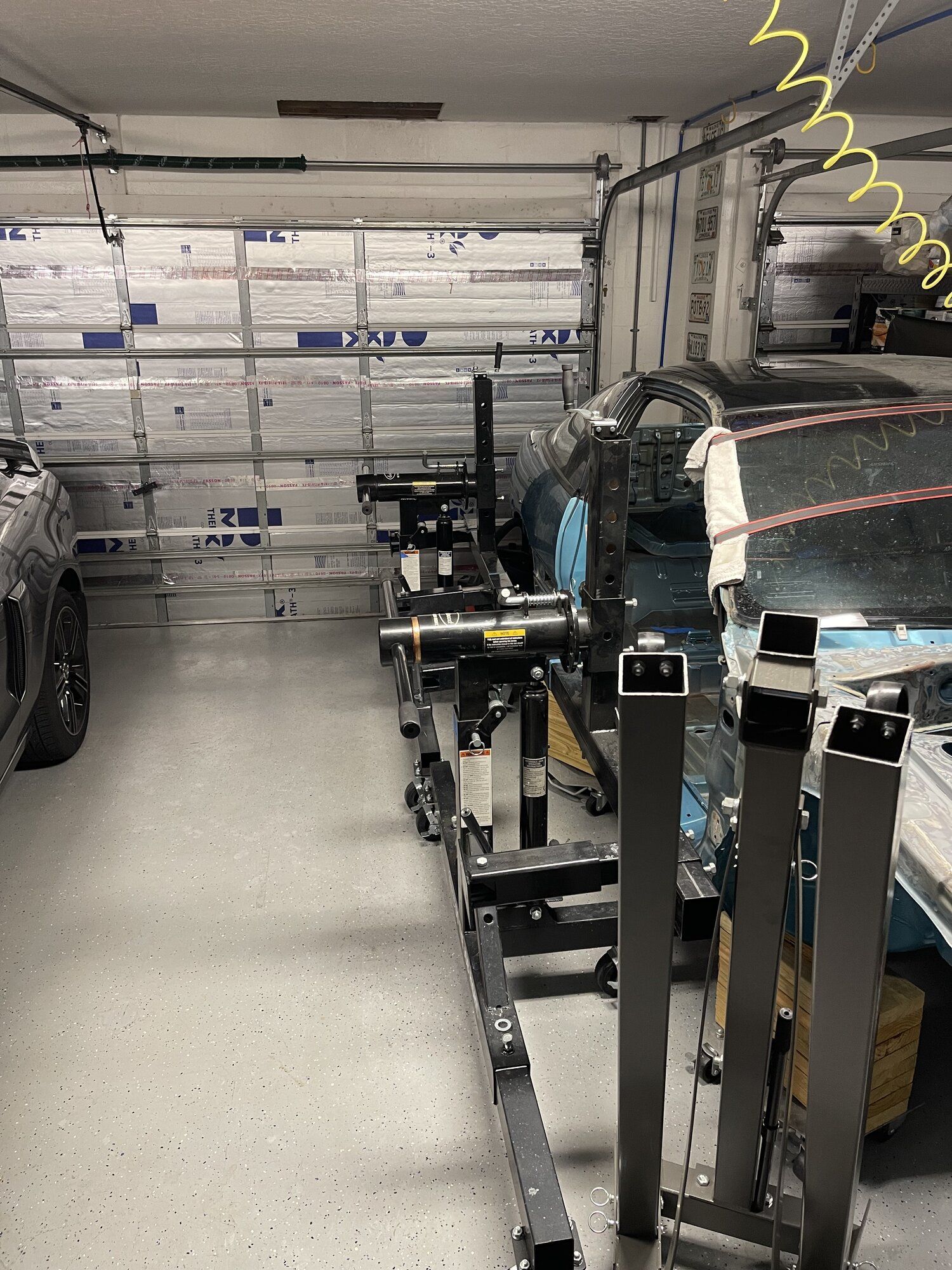

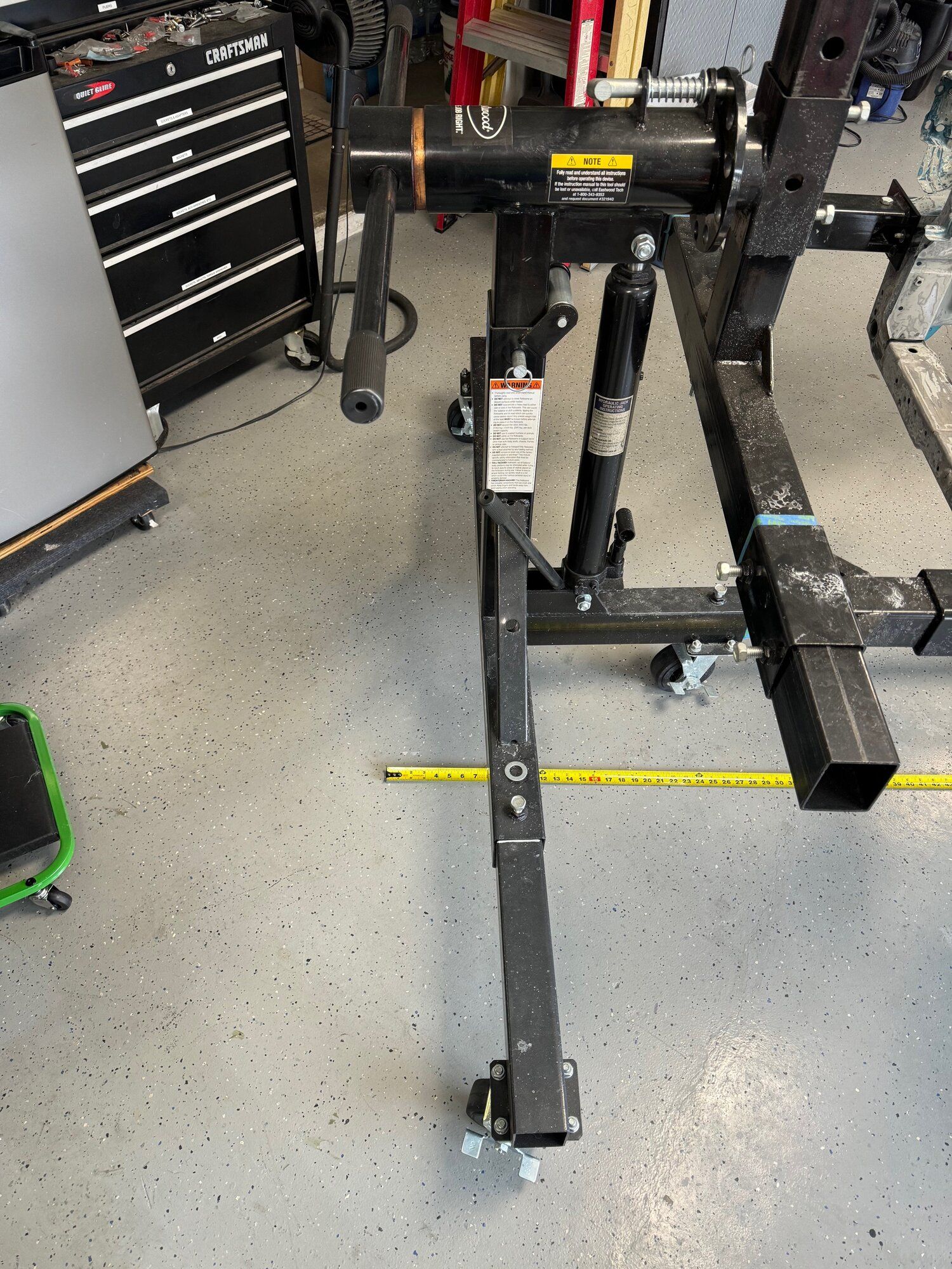

Now I want to get a rotisserie. Question for you. How much space is it taking up in your garage?
So I turn the adapter brackets I made around and slide the center connecting rails under the car. I would say allow 3-4 feet on the side of the car this way and you’re good. Bigger challenge is jockeying things around to get car on angle and attaching ends on car as center rail sticking out likes to run into things. Here’s mine stored when not it use. Set up with car on angle takes up every bit of a 2 bay.

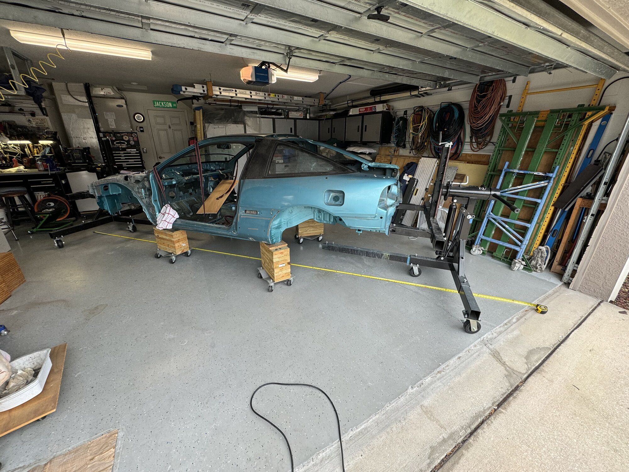

So you don't leave the car on the rotisserie and only put it up when working on it? Definitely doable that way. I am wondering how much space is needed in front and rear of car when everything is assembled. I have about 6.5 feet of space in the garage total in front and rear of my car so I'm trying to see if I can manage without having to place it diagonally.
Yes I put it up and take it down every time I use it, only way to fit Mustang in garage. This adds an hour or more to working time each day. I would doubt that’s enough room, mine stick out probably 3.5ft on each end when set up, it’s quite the footprint. I haven’t measured the total length when set up but could next time I do. Here’s another view set up.
Thank you. I figured it was gonna be tight but I think I can make it work. If you do get a chance to get a measurement I'd appreciate it but don't go out of your way.

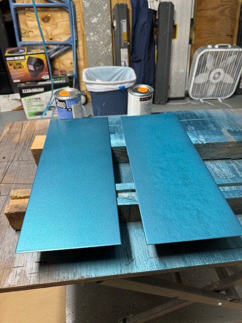

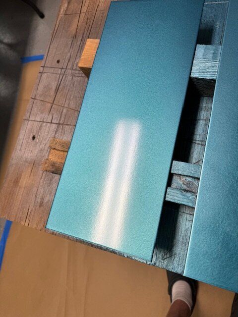

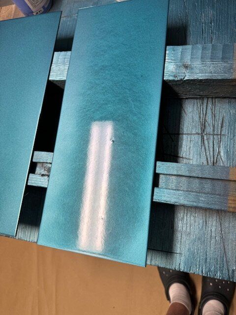

Was planning to use the same single stage in the engine bay that I did underneath but after spraying, determined, it was not high-quality enough. Fine for underneath the car but want the engine bay to look more like a showpiece I guess. Sprayed some samples of base coats tonight provided by local PPG dealer. The JB came out great, the Deltron, which is four times the amount of money did not. Not sure what happened going to have to go back to the store and get some advice/answers.

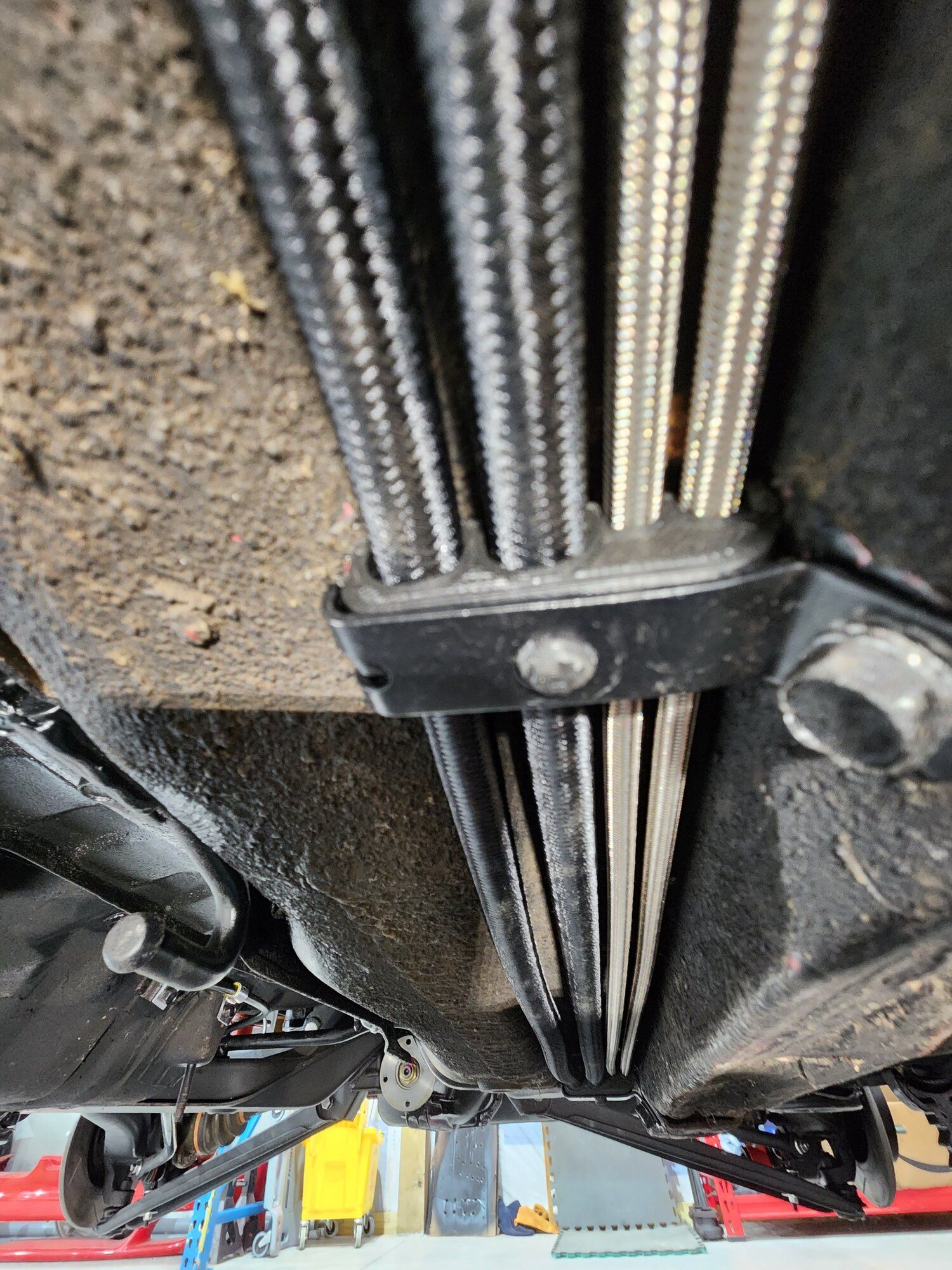

Just wanted to give a shout out here to @Kai Hefner. I had originally ordered his fuel/brake line holders ( -8an, -6an, 3/16") but after following @92Turbski 's build decided I wanted to go with the -3an SS brake lines all around as well. After probably annoying the crap out of Paul and Ziggy from RTM with questions I got all the lines I needed and ordered the new holders from HEF. I sent specs for the SS brake lines along with sizing and pics with a caliper measuring OD for fitment. Unfortunately when I got the new holders the brake lines would not fit in the openings they were just too small. When I informed Kai of this he immediately insisted on correcting it and sending new ones. I felt kinda bad as this is not a big item and shipping cost involved etc etc. Just wanted to say how happy I am with his customer service and everyone should feel very comfortable ordering from him. Thanks again man! :talon:
It's no problem at all man. If someone orders holders, they're getting holders that work. Custom sizing is always tough to do over the internet with varying tolerance in fuel line sizes. If the custom sizing doesn't end up fitting, I didn't do my job! I'm here to support the community first, the shipping/replacement cost is not an important factor to me.

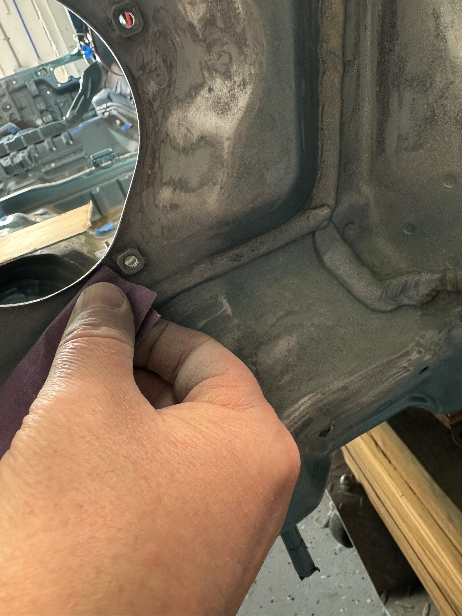

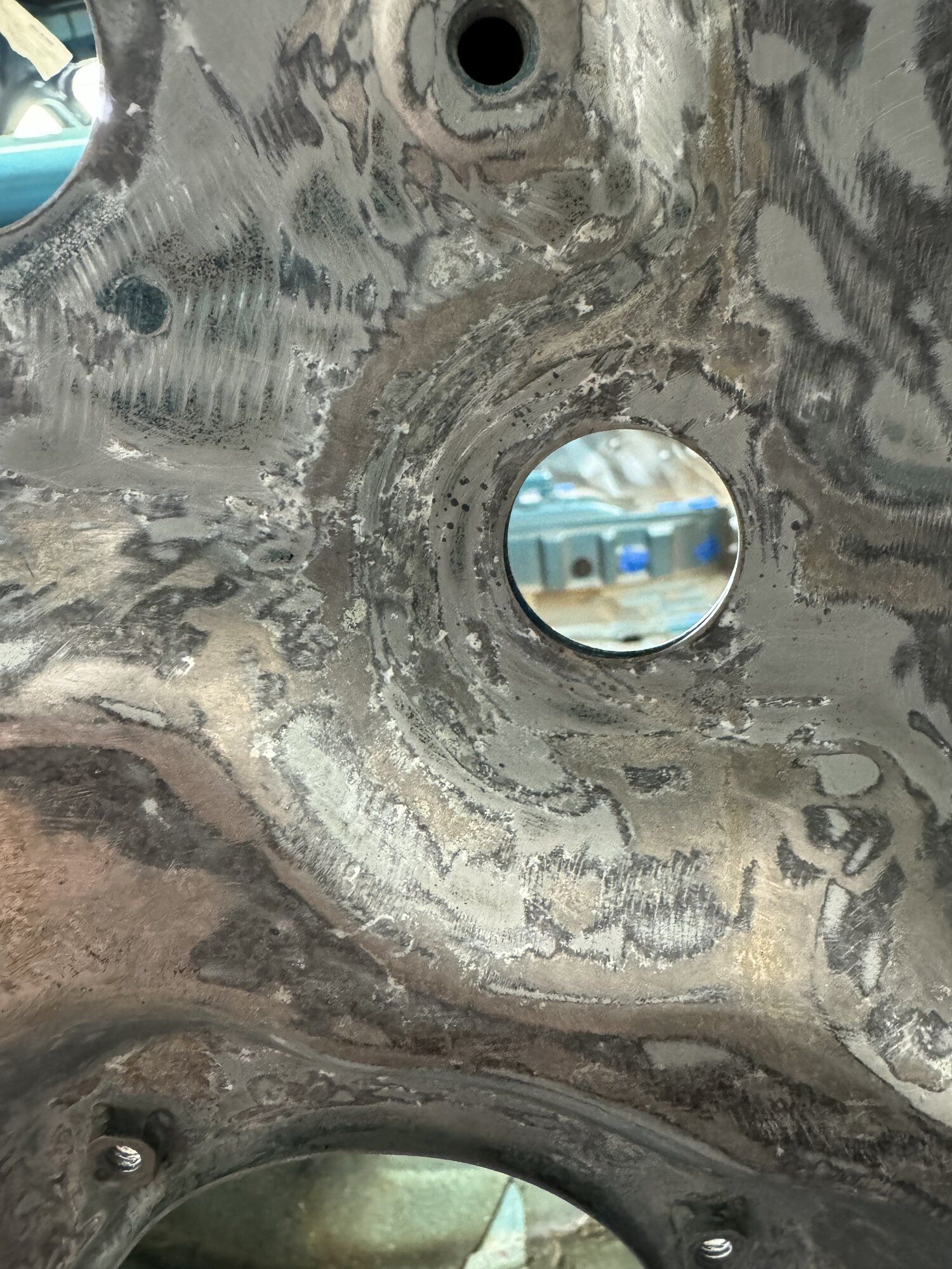

Haven’t been able to work on her in a minute now. Weather is finally great, and found a couple hours today. Started hand sanding the engine bay. As close as I thought I had it, it just isn’t good enough for a nice finish. Texture wasn’t smooth to the hand the the ospho had left behind some white crusties. So giving it a 220, 320, 400 grit by hand. Every nook and cranny. So much fun! :rolleyes:

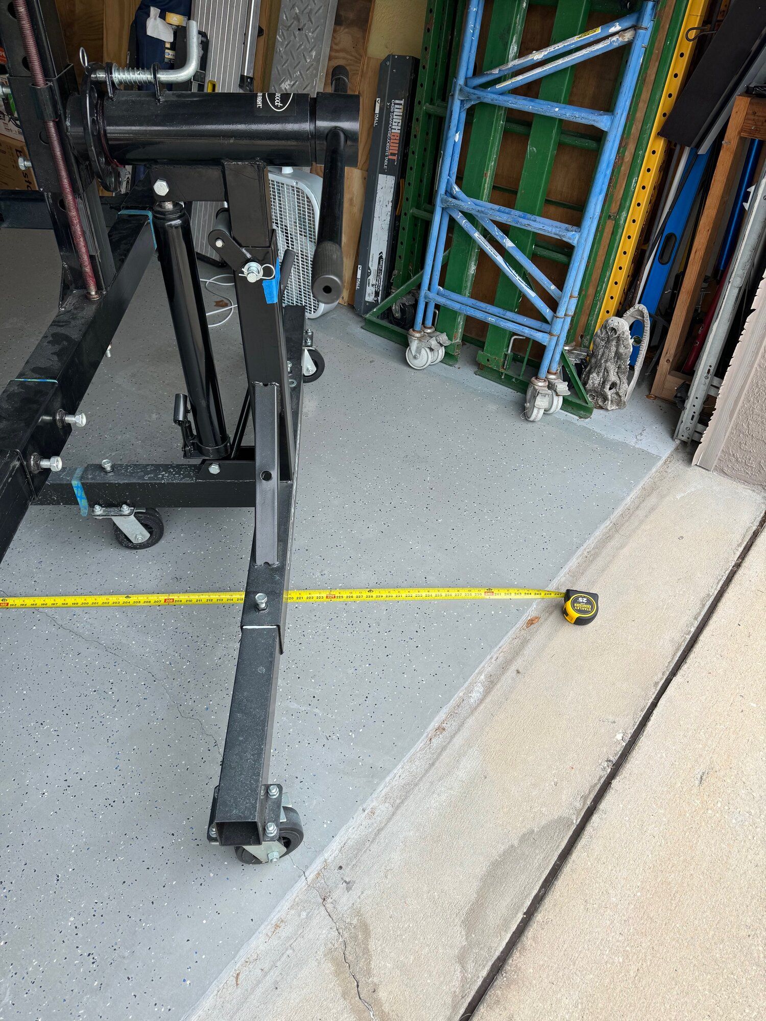

Sorry this took so long @fourgsixty3. There will be some variables obviously but with my rotisserie, brackets I made, etc. I’m measuring right at 19’. You need at least 2-3 feet on each end to work the monstrosity as well!
