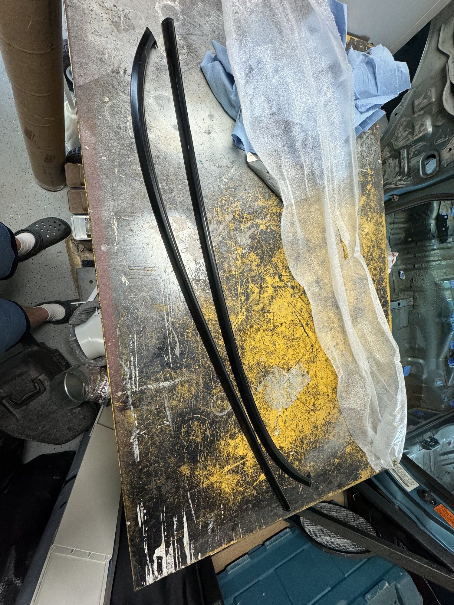

you taking the glass / windows out with the trim pieces?
I’ve been going back-and-forth about that. I would really like to to do it as complete as possible. I think I’ve convinced myself to definitely pull the windshield as I have a new one ready to go in, but was kind of hoping to save that for future, the rear quarter windows are concerning me I’m afraid of damaging the moldings trying to get them out. Still on the fence.
Hoping someone like you starts making some new ones LOL.
I think @MacMarty15221 was able to get some off intact. Either way if I pull them they would not be good enough to go back on so…waiting on you Bobby! ;) I’m more concerned with the actual mouldings getting fubared.
I just hate the idea of having to tape anything on this paint job. Want it as complete as possible.

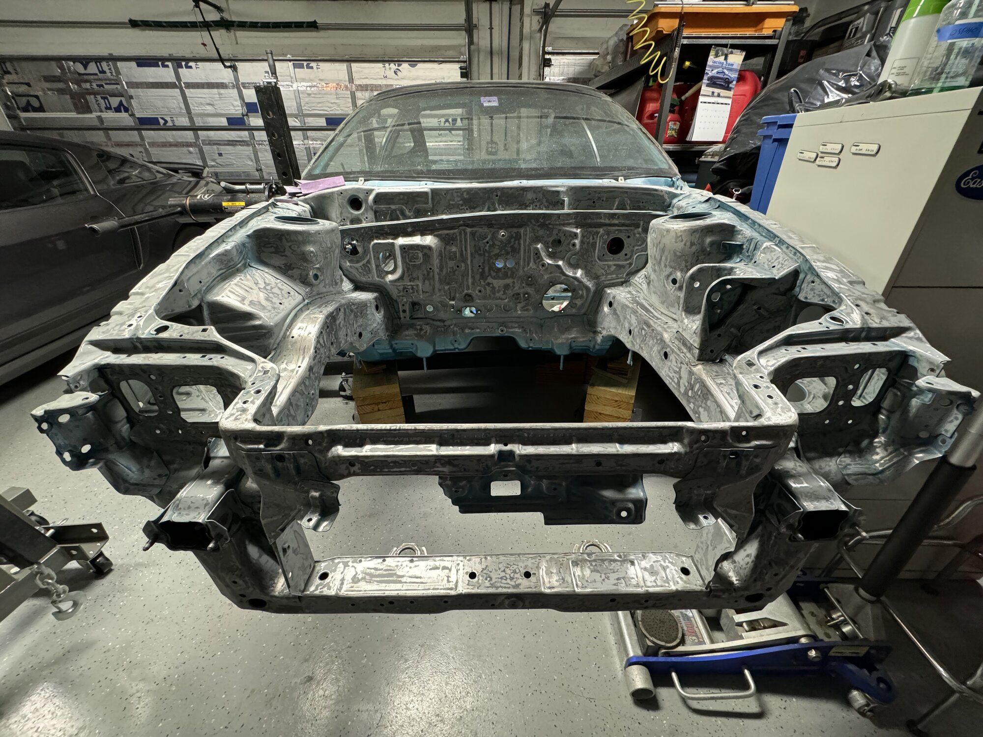

Bought another 800 bucks worth of paint and clear today. I swear I’m almost ready to spray the bay. Needs a final pass with 400 in the bigger areas, and time to do it. And I guess need to pull the windshield…

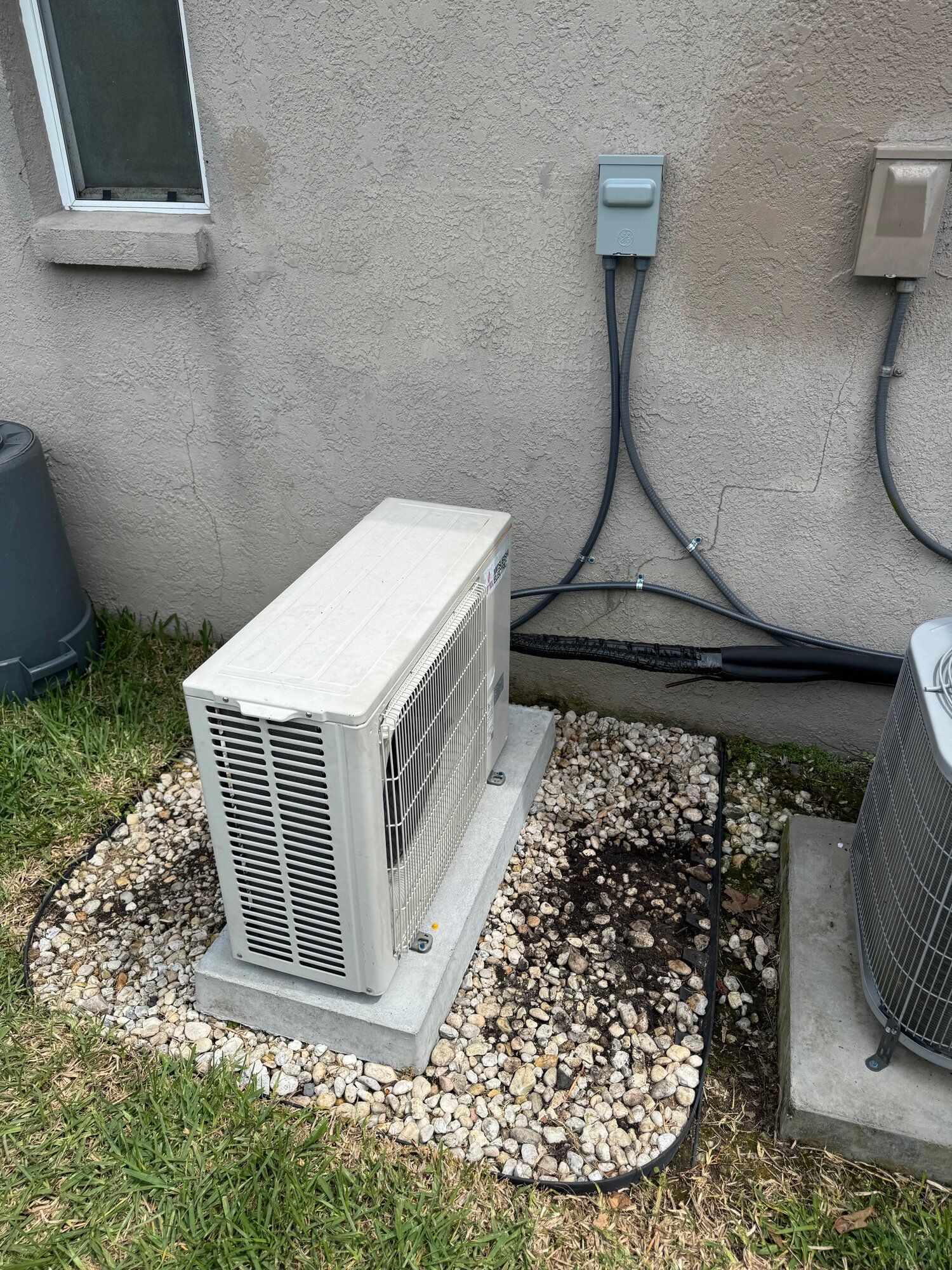

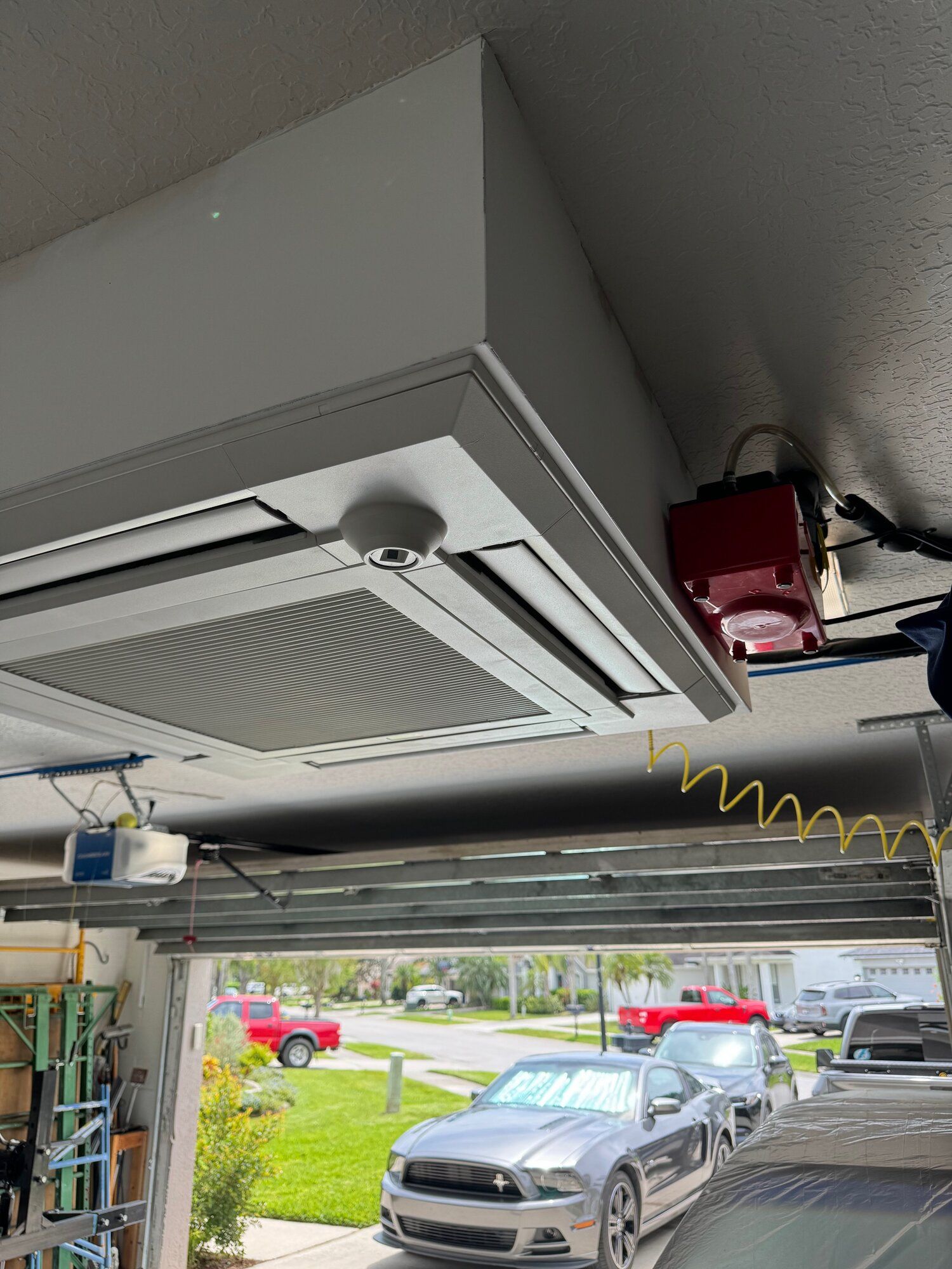

So it took a little bit more than anticipated like everything does but: Line set ran through attic to outdoor unit, Box built around head, (still need to sand, texture and paint it to match ceiling), new electric run from inside panel, nitrogen purged lines, vacuumed to 600 microns, charged up and rocking. Did ok I guess it didn’t even need any more juice after extending line set about 4’. This thing is gangster! Just need to get the paint crap done on the engine bay and what not and can start bolting parts in finally, in the AC, F@ck you Florida summer heat! I’ll attached photos when I can get this piece to accept them. So tired of this file size too big crap. Makes mobile use impossible! ~cough talking to you again Chris. ;)
