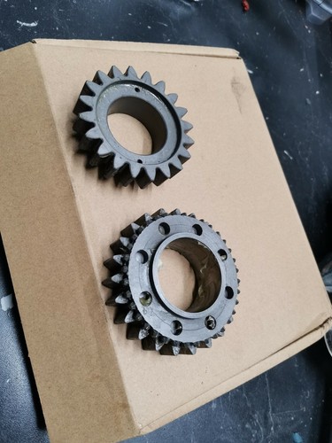

I know there have been many conversations of a gearset stronger than stock that's not a dog box. Not trying to go there.
But every so often i search to see if someone has remade the stock gears in billet steel or something. I ran across these, any info? I sent the seller an email to see who is behind him.
No, that's a custom 4th made in Europe, not a PAR kit. The seller has been around Evo 123s for a very long time.
interesting. I wonder if he can make a 2nd - 4th that will fit in a stock AWD box. Then again might as well buy the Par kit if that happens.
You are better off just getting a reliable and more durable PPG gearset.
The hub and slider needed for using these gears have been discontinued for years.
I have had experience with Matthias' gears on Jason Tanin's LilEvo, and they lasted literally a few hundred miles before they failed. I have plenty of pics from the failure. Sent them to Matthias, never received a response. Went with a PPG in the customer car, never an issue again. I had Matthias' set modified with Liberty face plates to have a more durable 3rd/4th hub and slider option as well.
Looks to me that the root of the PPG is much more stout and has a much nicer profile than those gears and who knows about the actual material contents and after treatment of the gears.
@twicks69 are you saying your experience says don't get the par synchro box? Spend a little extra to get the ppg dogbox?
I really want the stronger synchro box and have read one good thread on the set. Dogbox just seems unnecessary for a weekend car, but if the par synchro gears won't last I don't need them.

The PPG was being compared to a set of gears made by an individual in Europe in this case, not the PAR kit. The European gears are a straight-cut gear from unknown material or treatment and of a smaller tooth profile, to which original synchronizers are welded. In this case, dog engagement teeth were welded to the European gear. Some failures of these European gears have become known.
