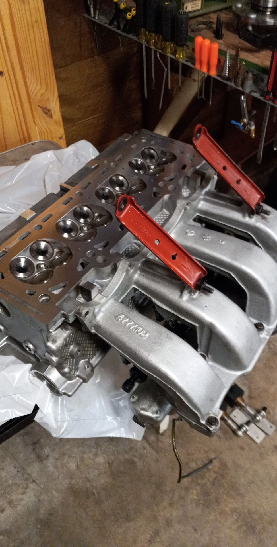

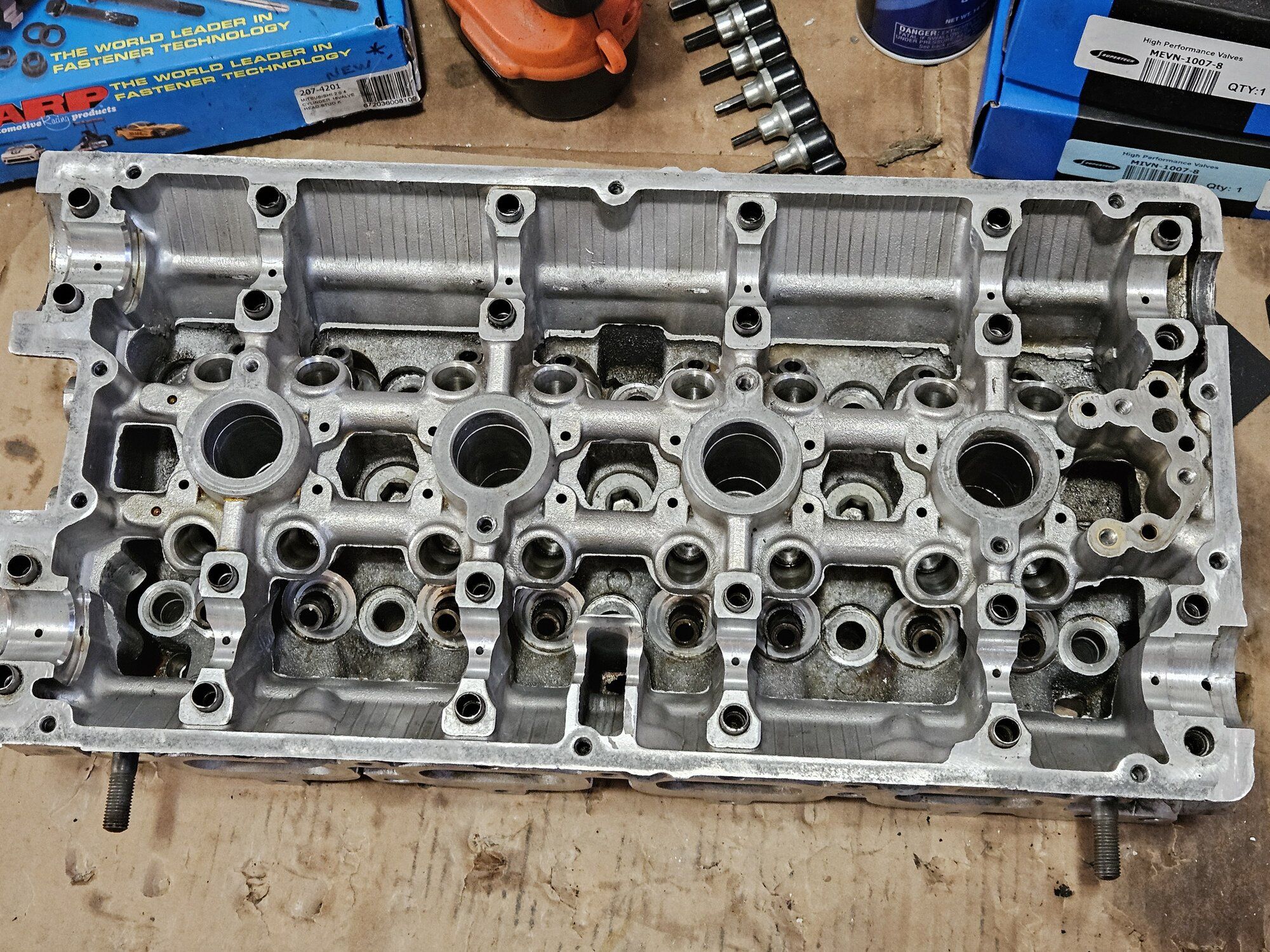

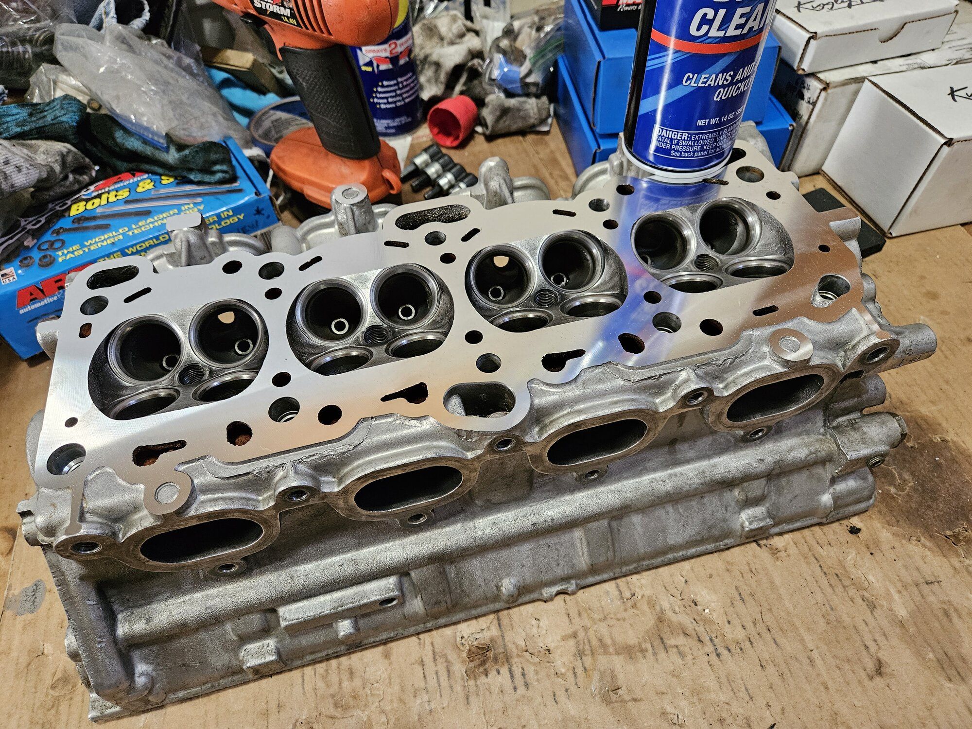

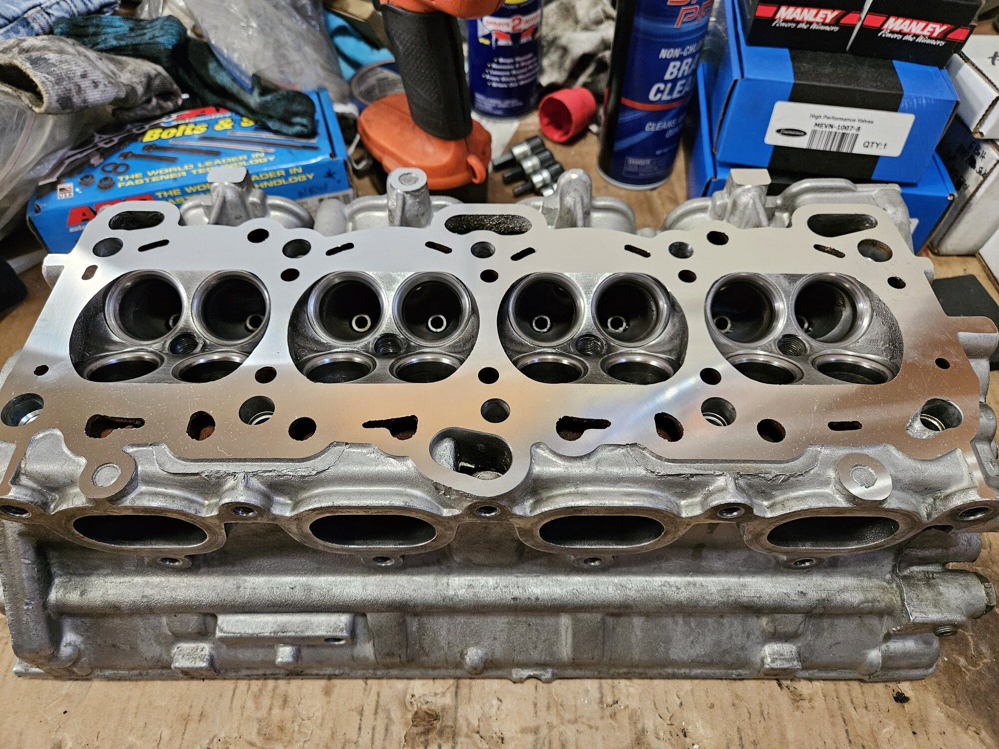

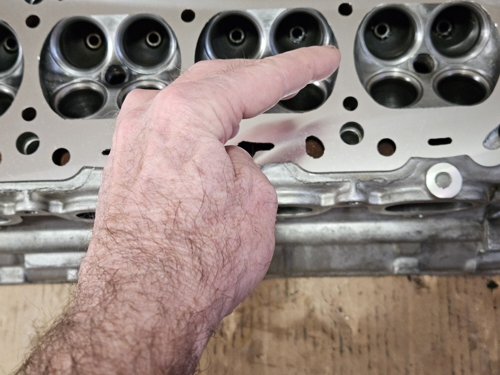

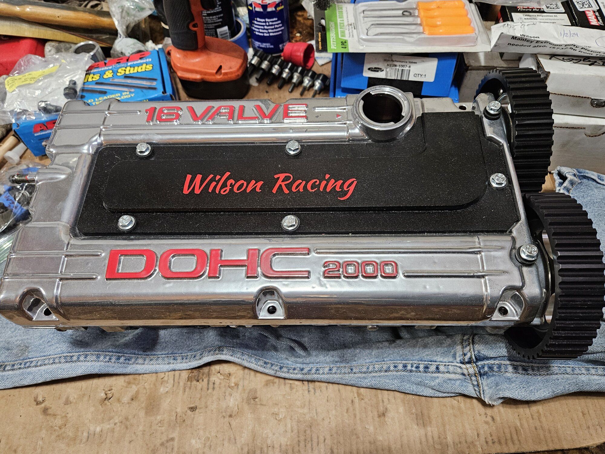

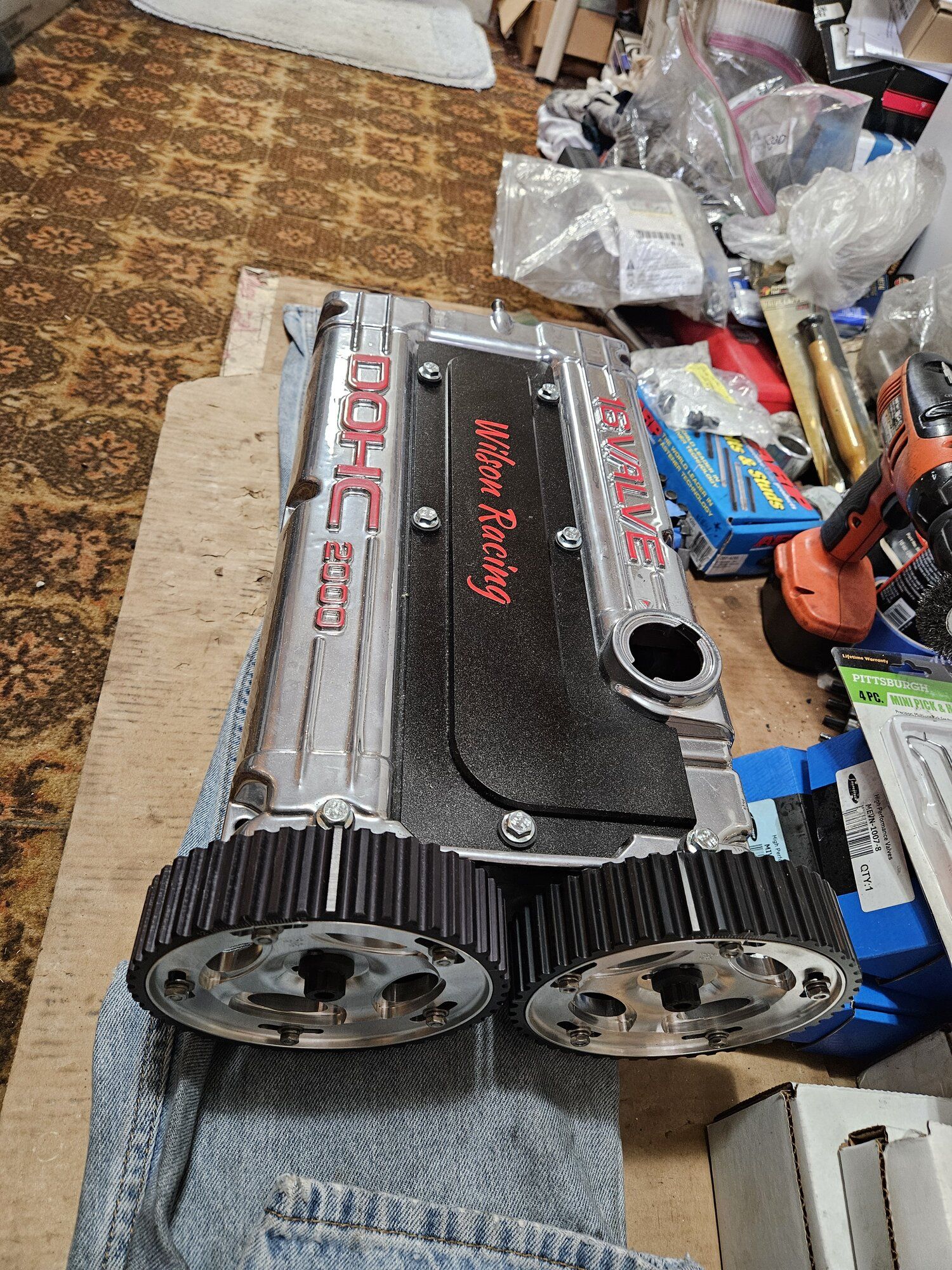

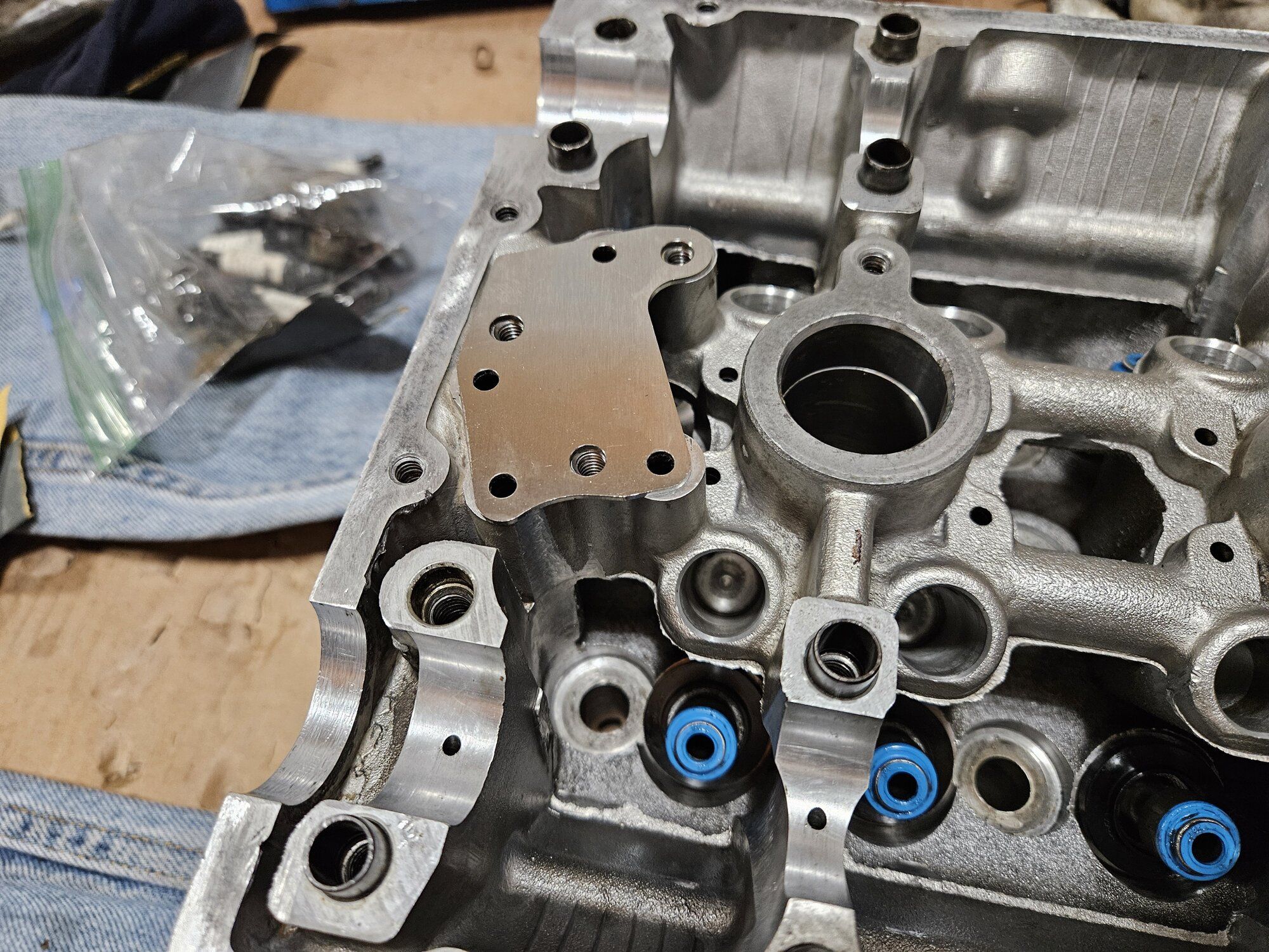

Well I got the head back today from my machinist (thank you Larry) at a very reasonable cost. Very nice finish for the MLS head gasket. I need to give her a compressed air blow for the little bits of aluminum that you always find after a surfacing, then a bath and I can start the reassembly process! It really looks nice!

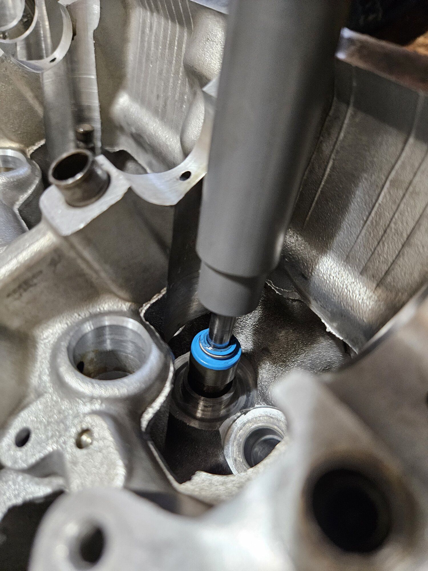

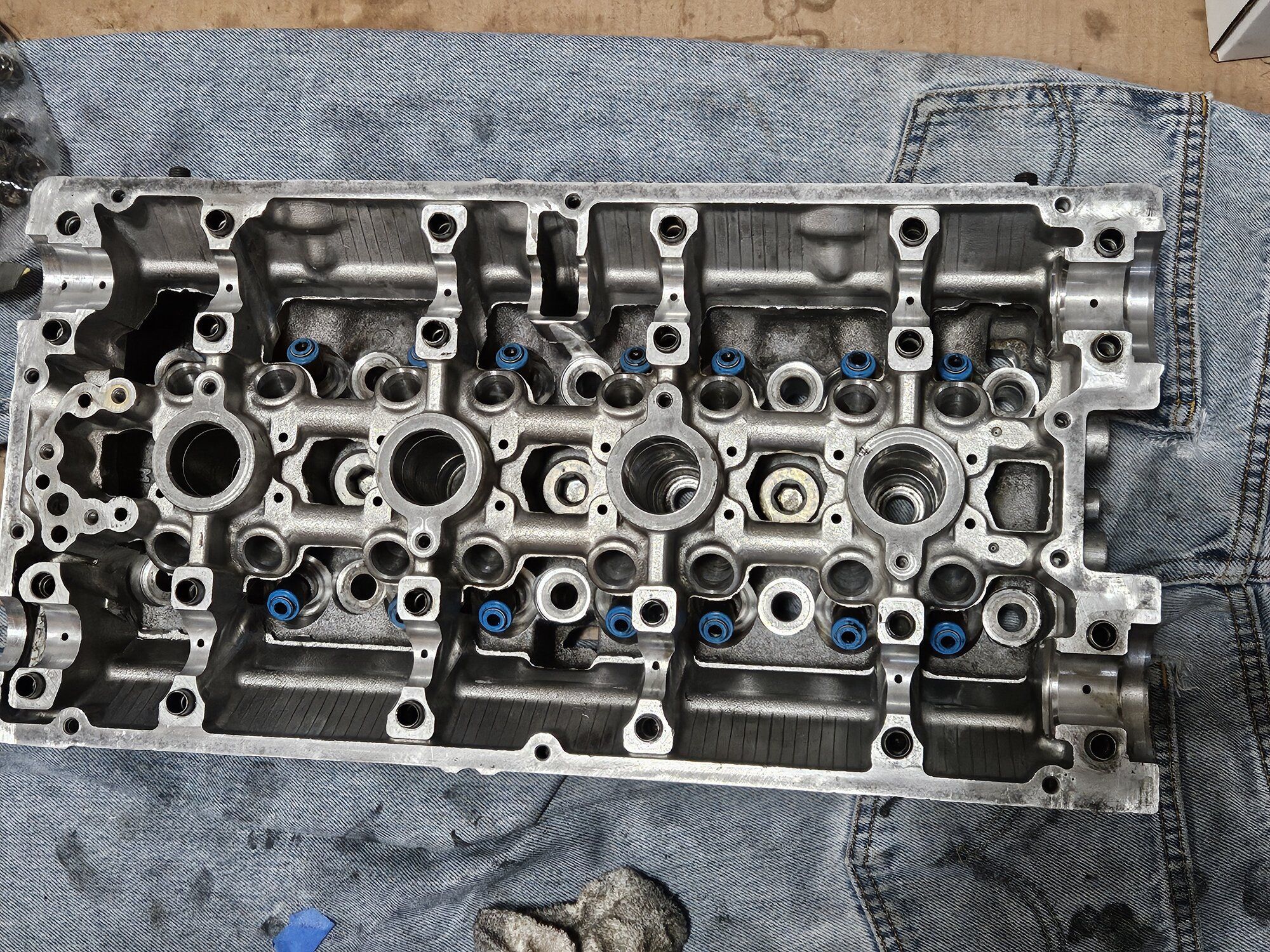

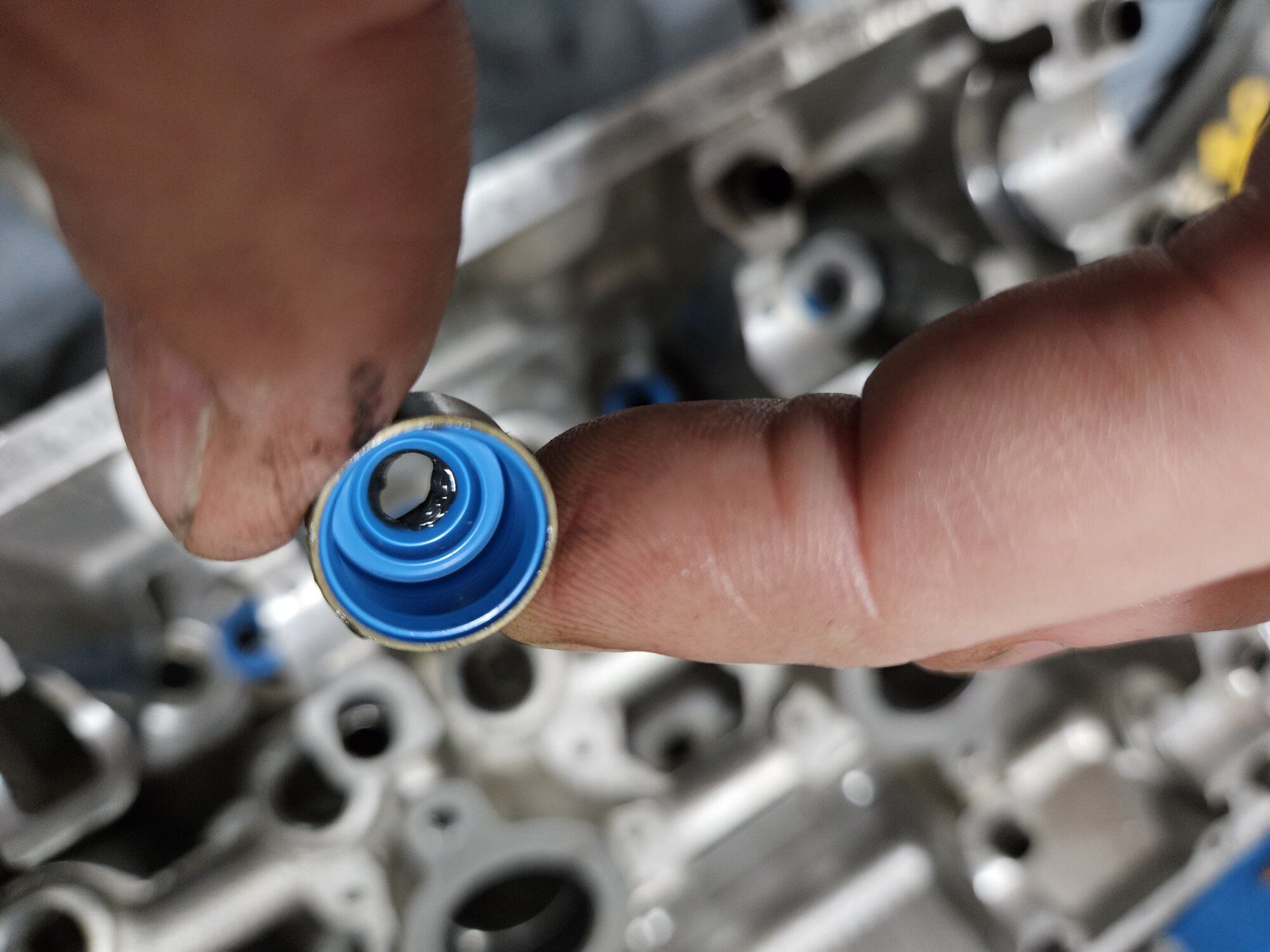

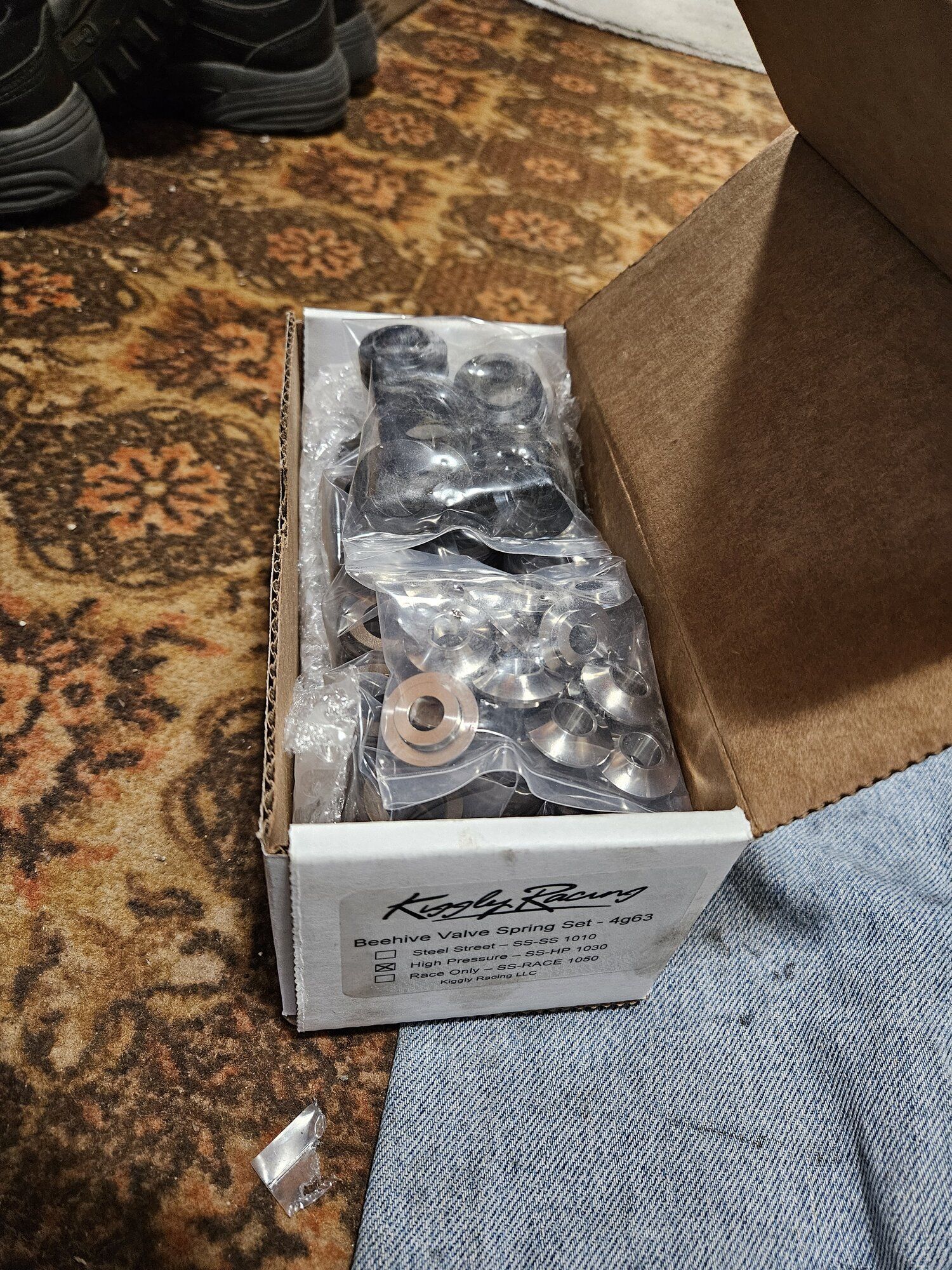

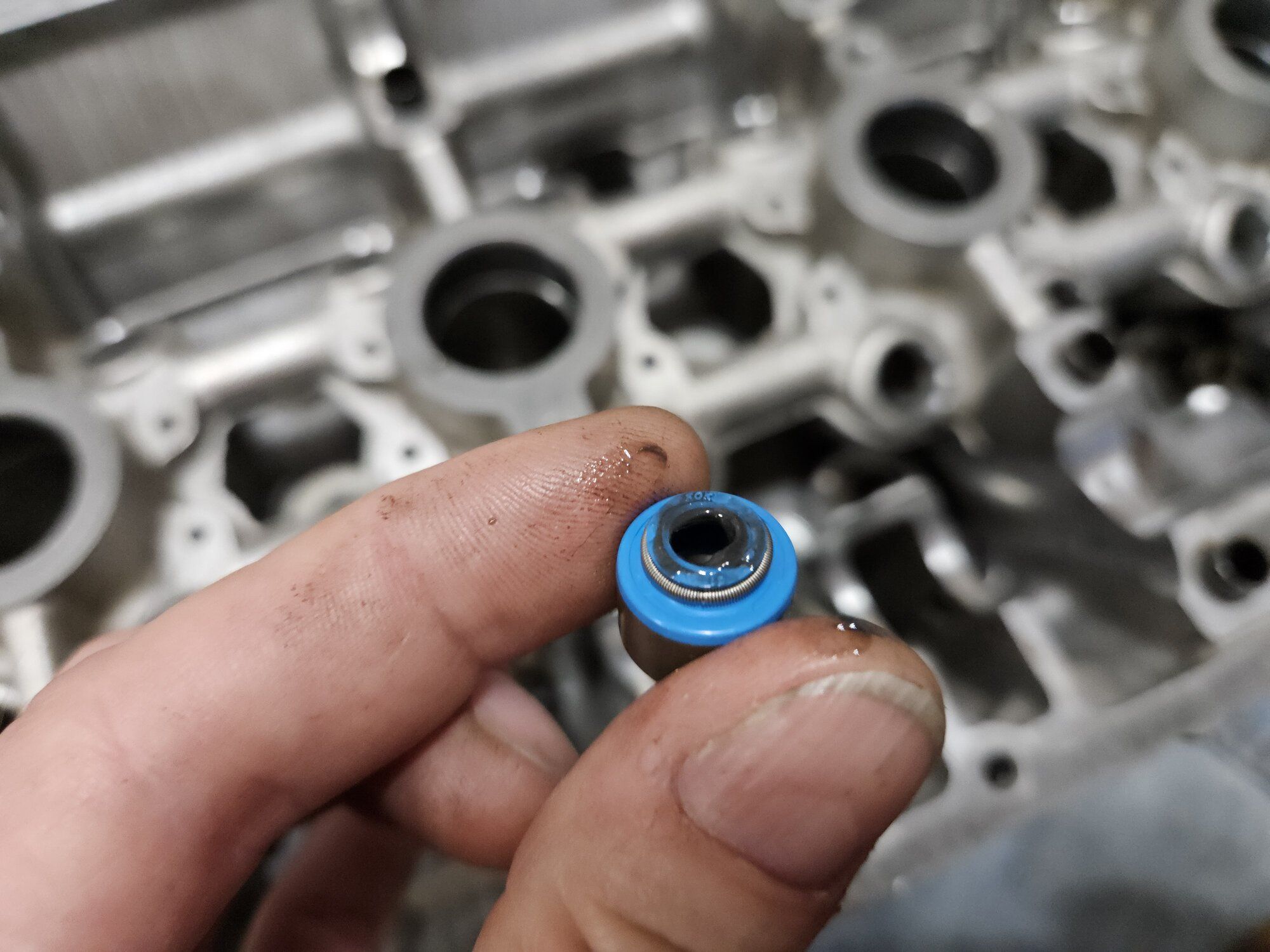

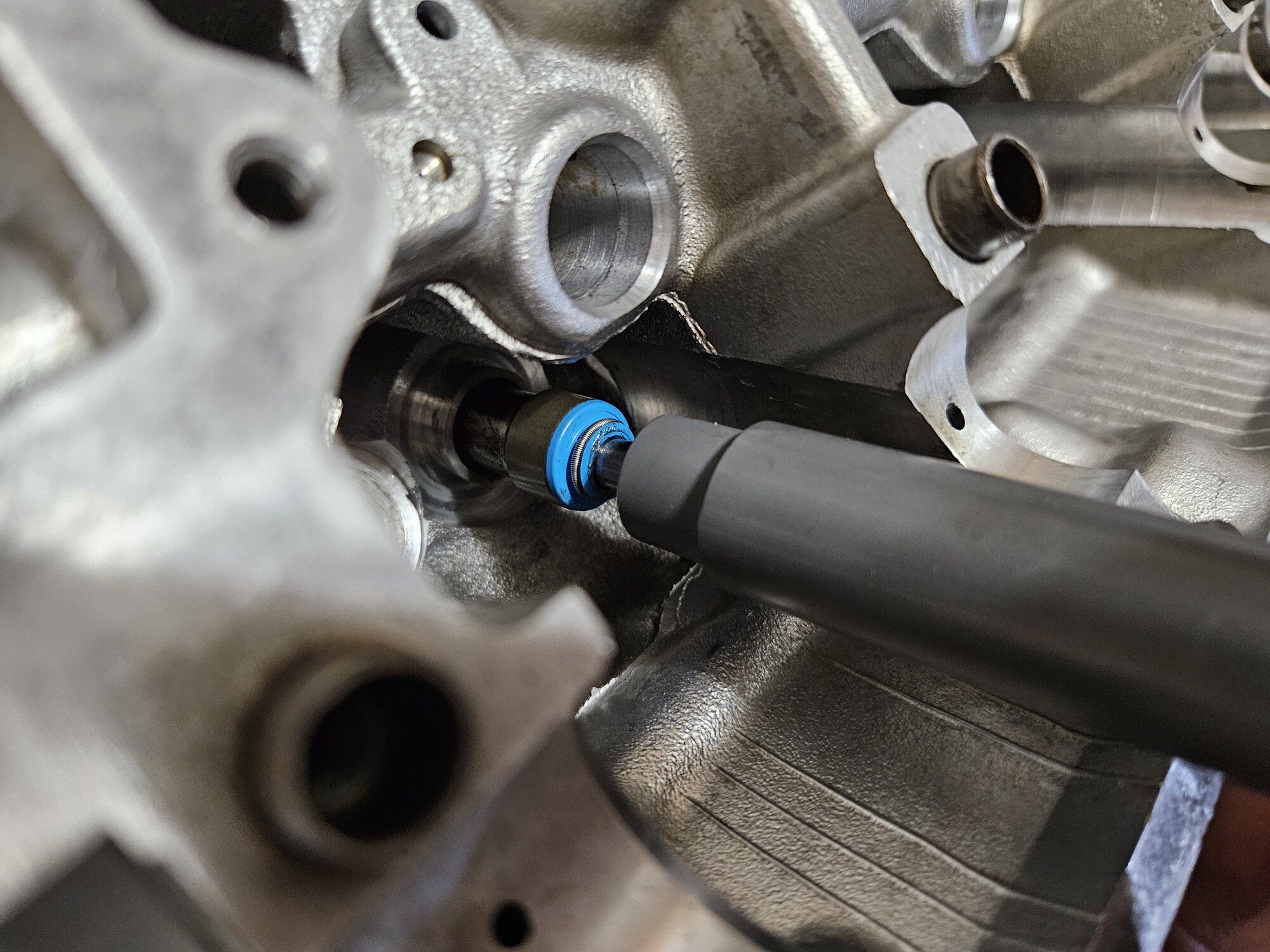

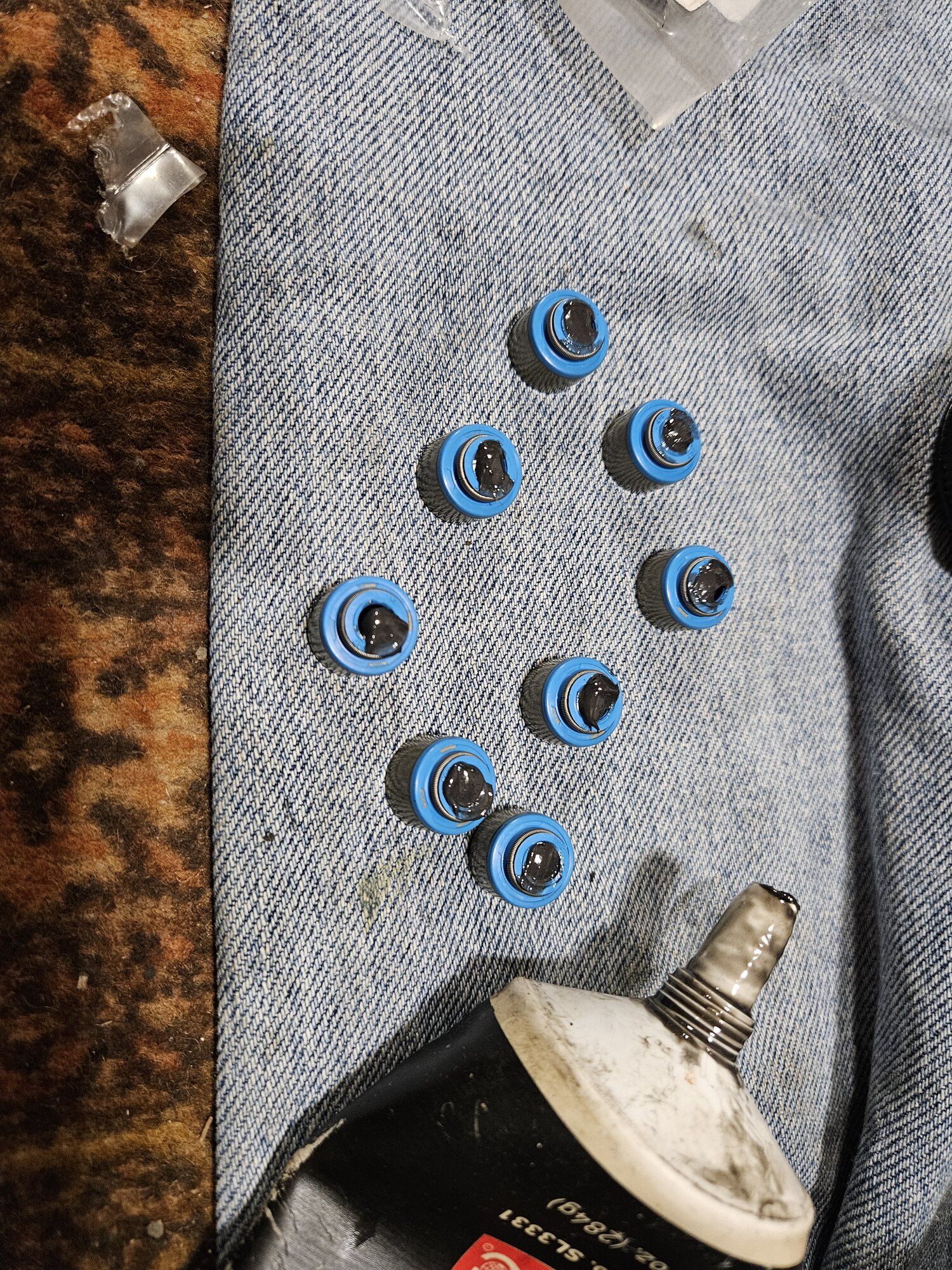

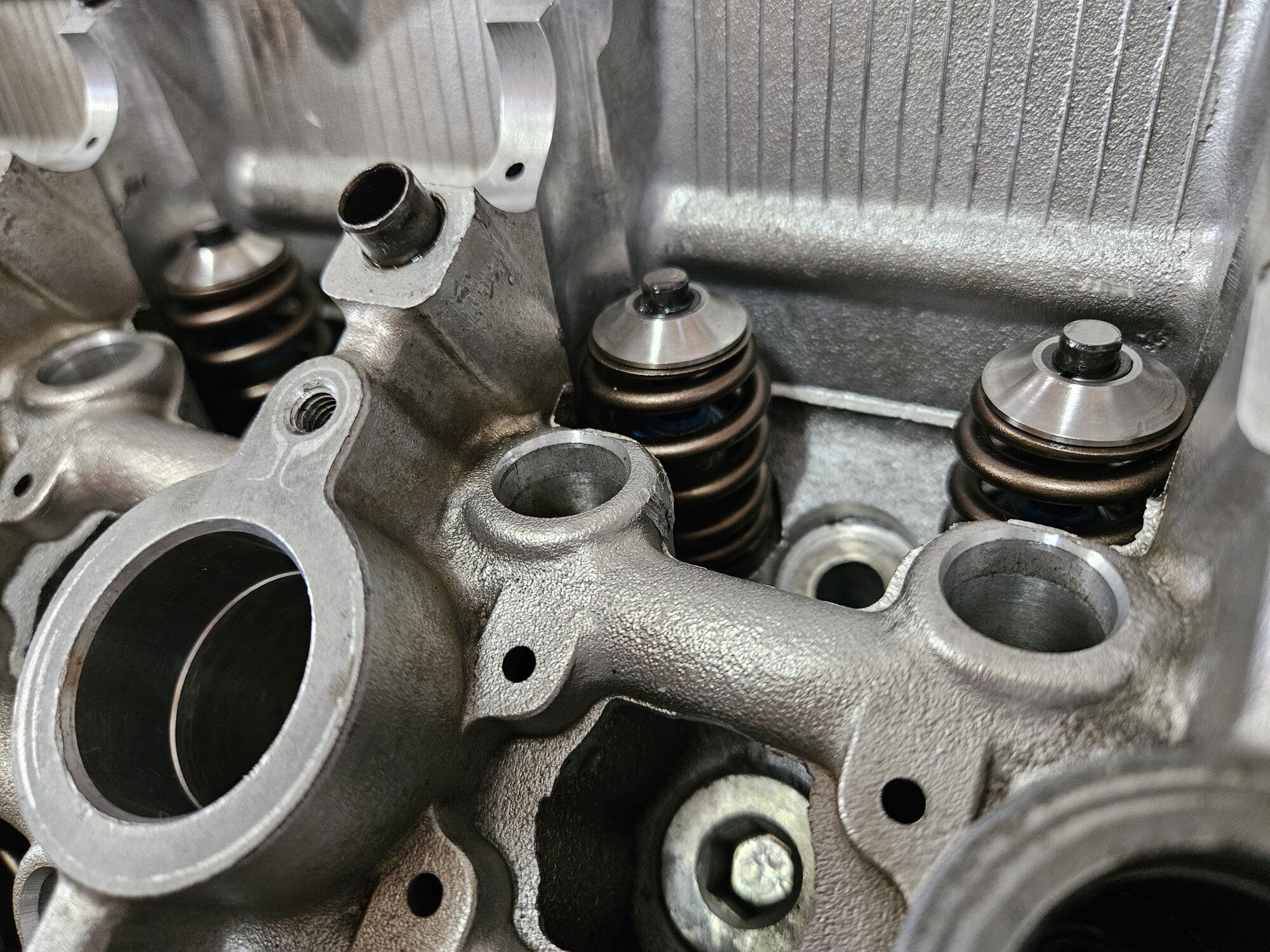

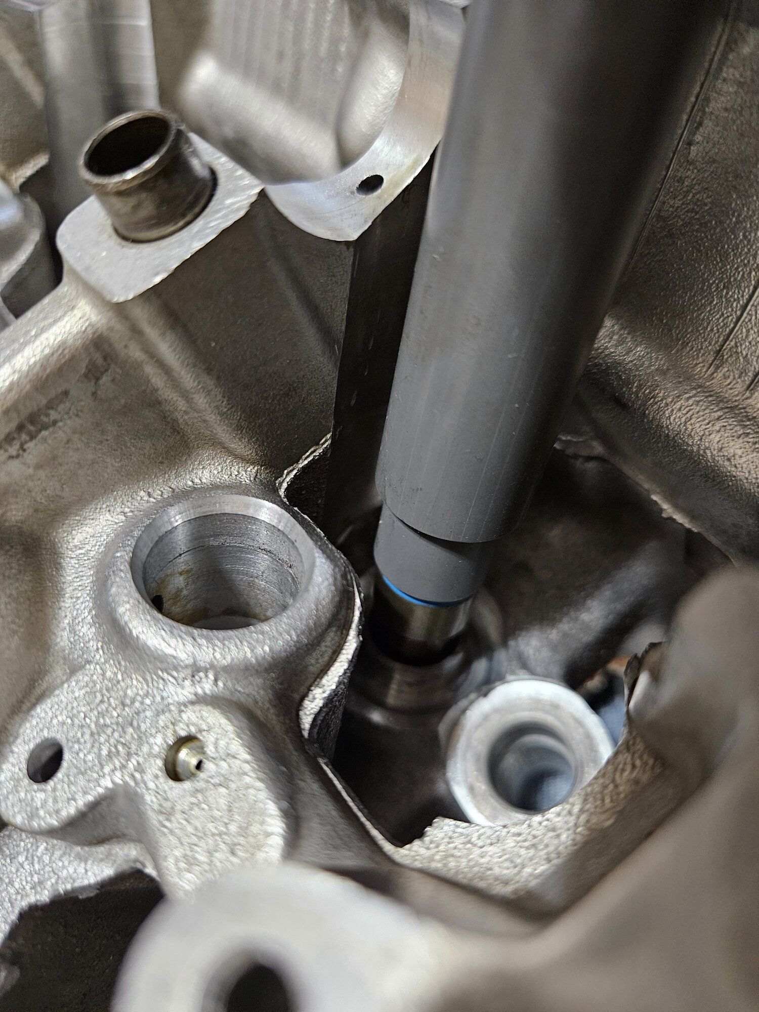

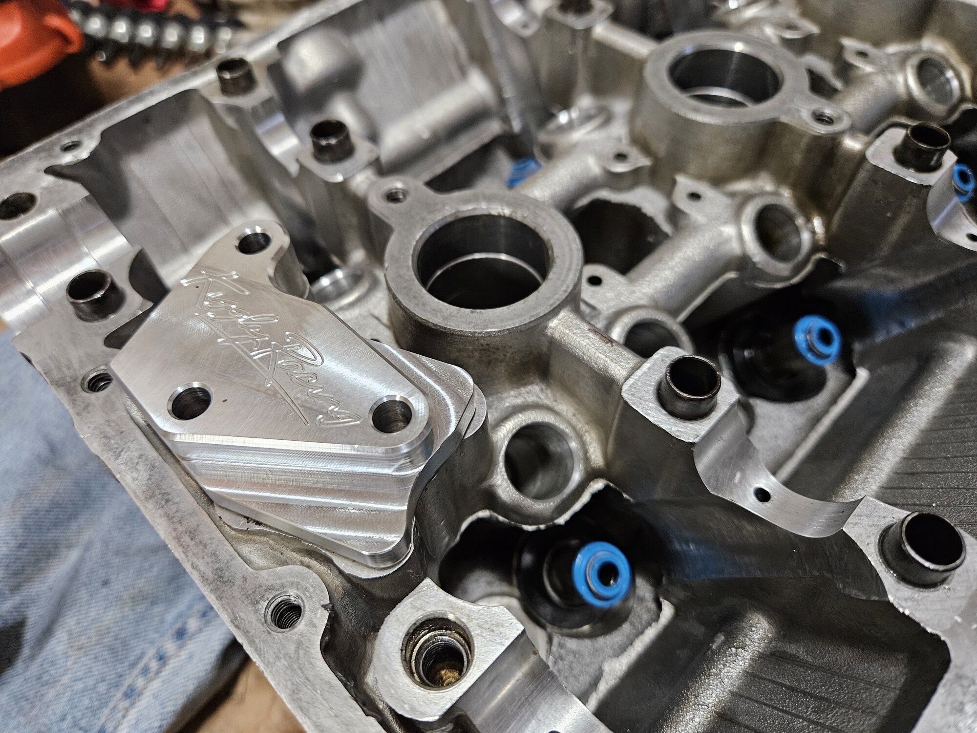

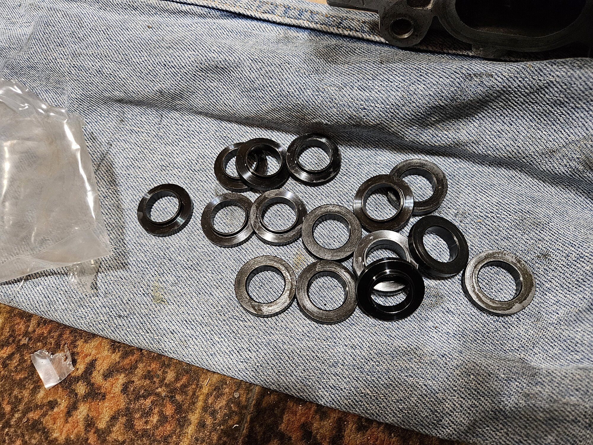

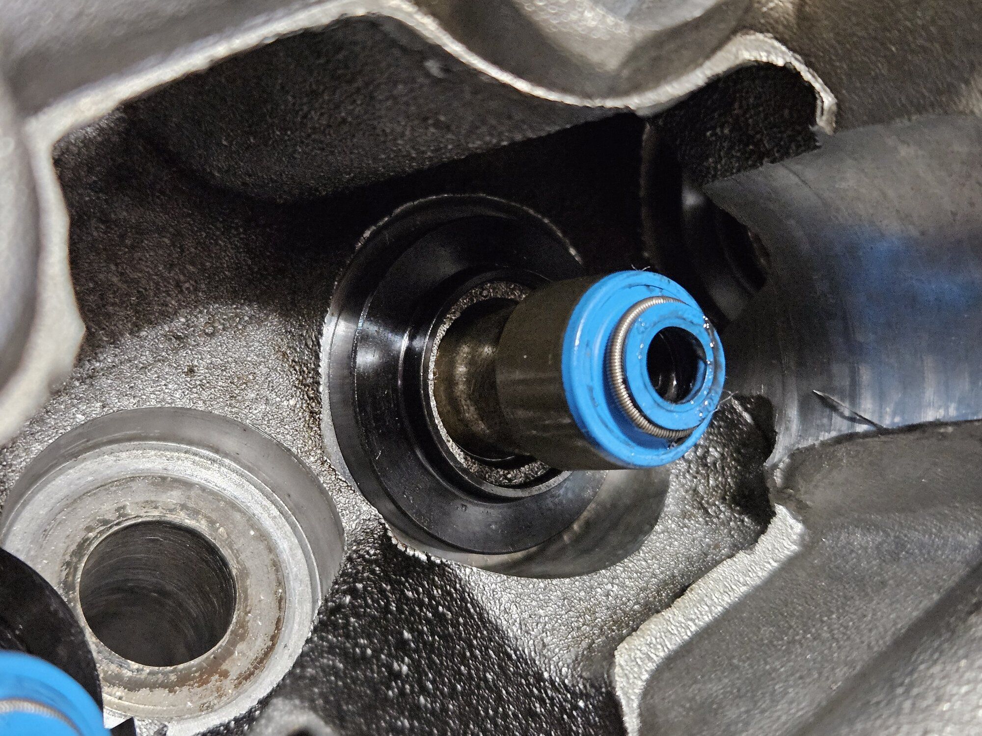

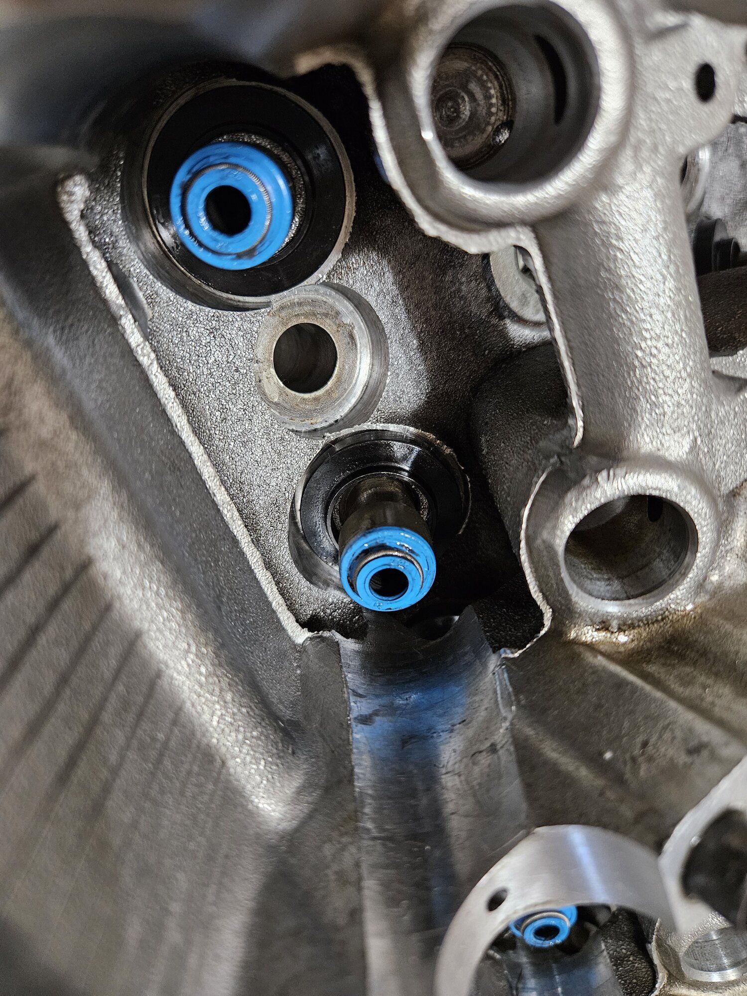

Since I got the cylinder head back, I am trying to do a little at a time of cleaning and recleaning then, before I knew it, it was time to install the new valve seals, so I did and put the Kiggly race springs seats in. Boy I had forgot how much beefier they were!
NICE!!!

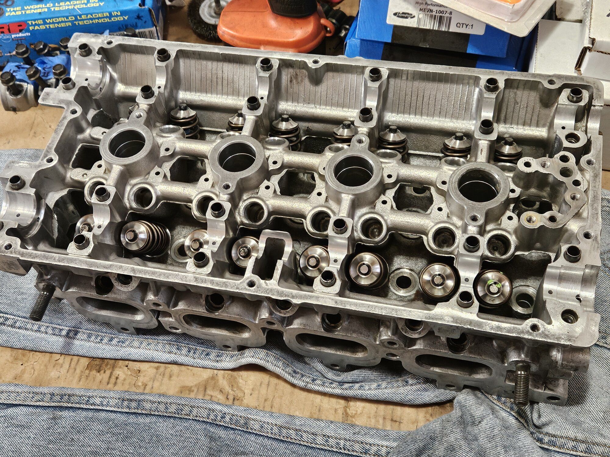

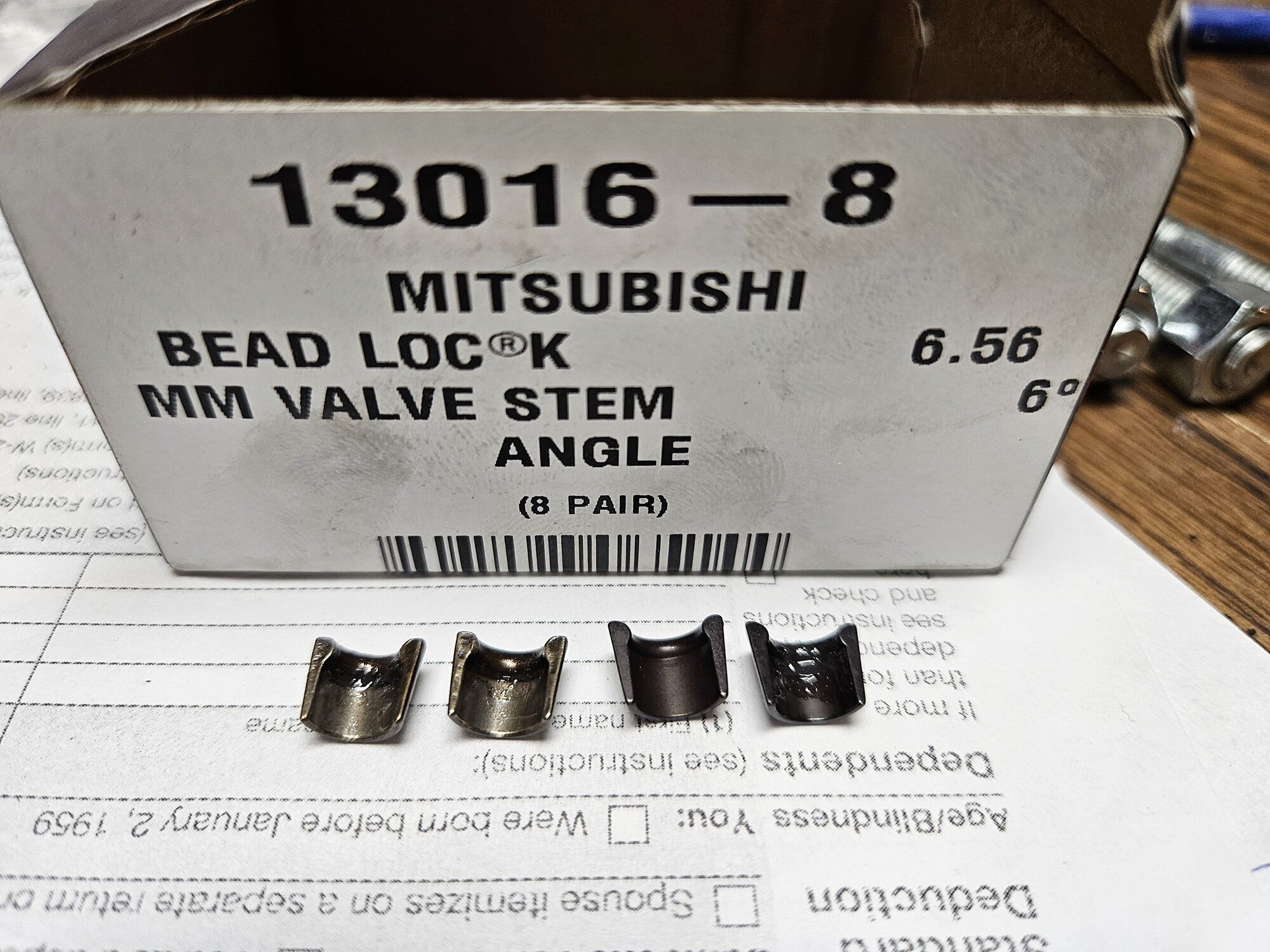

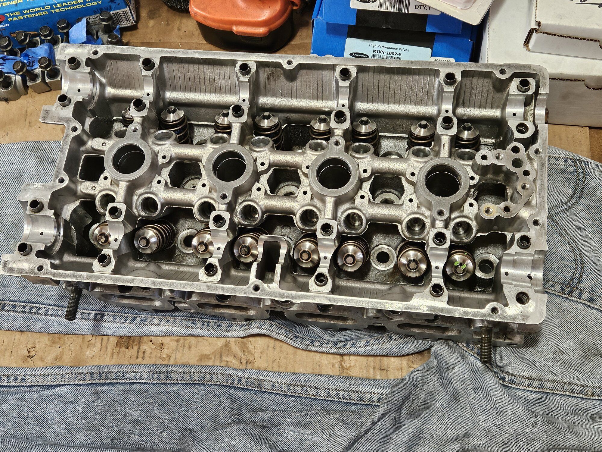

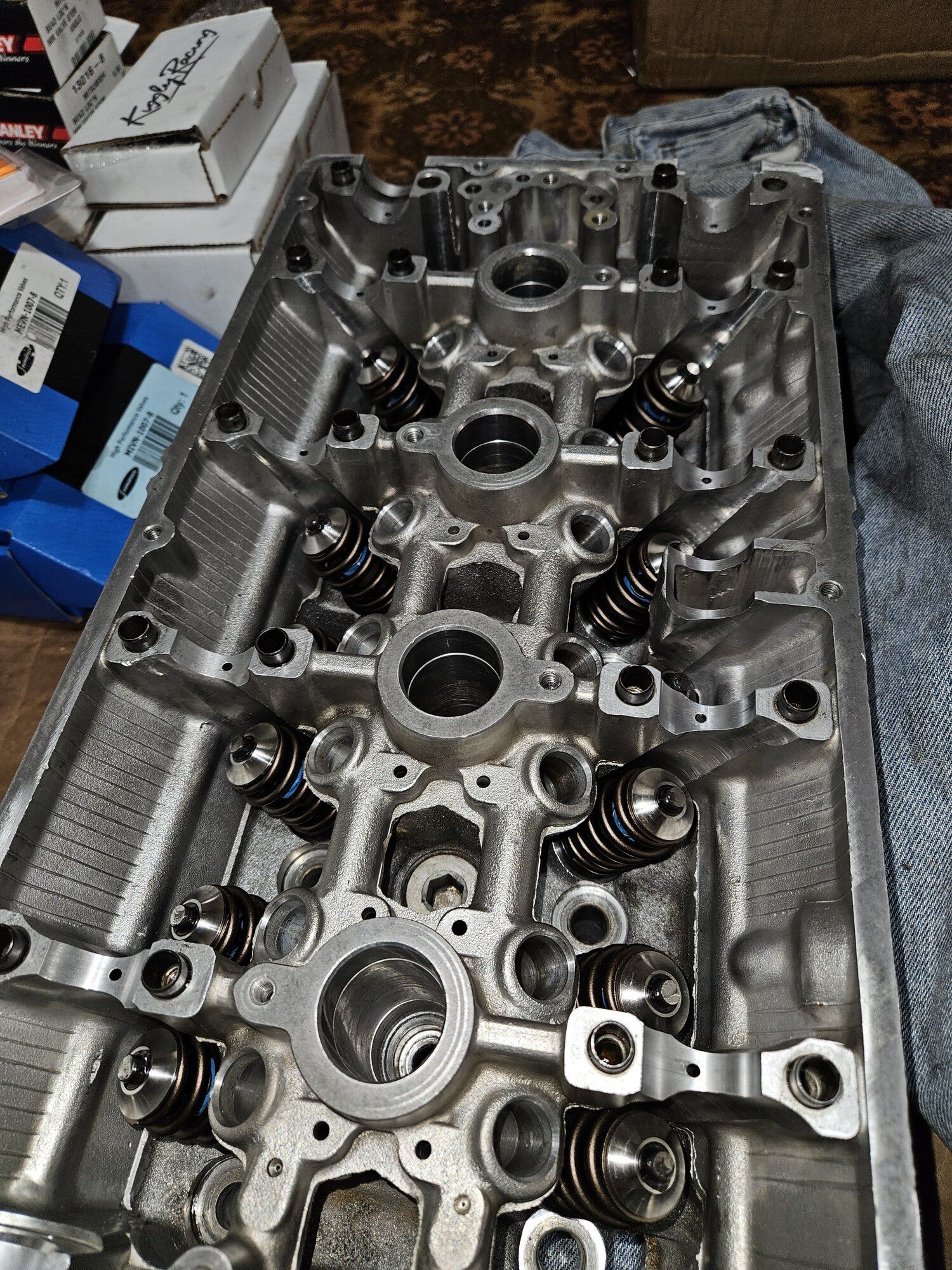

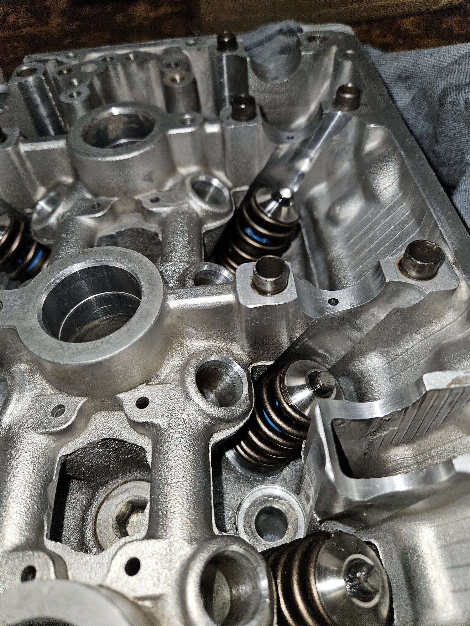

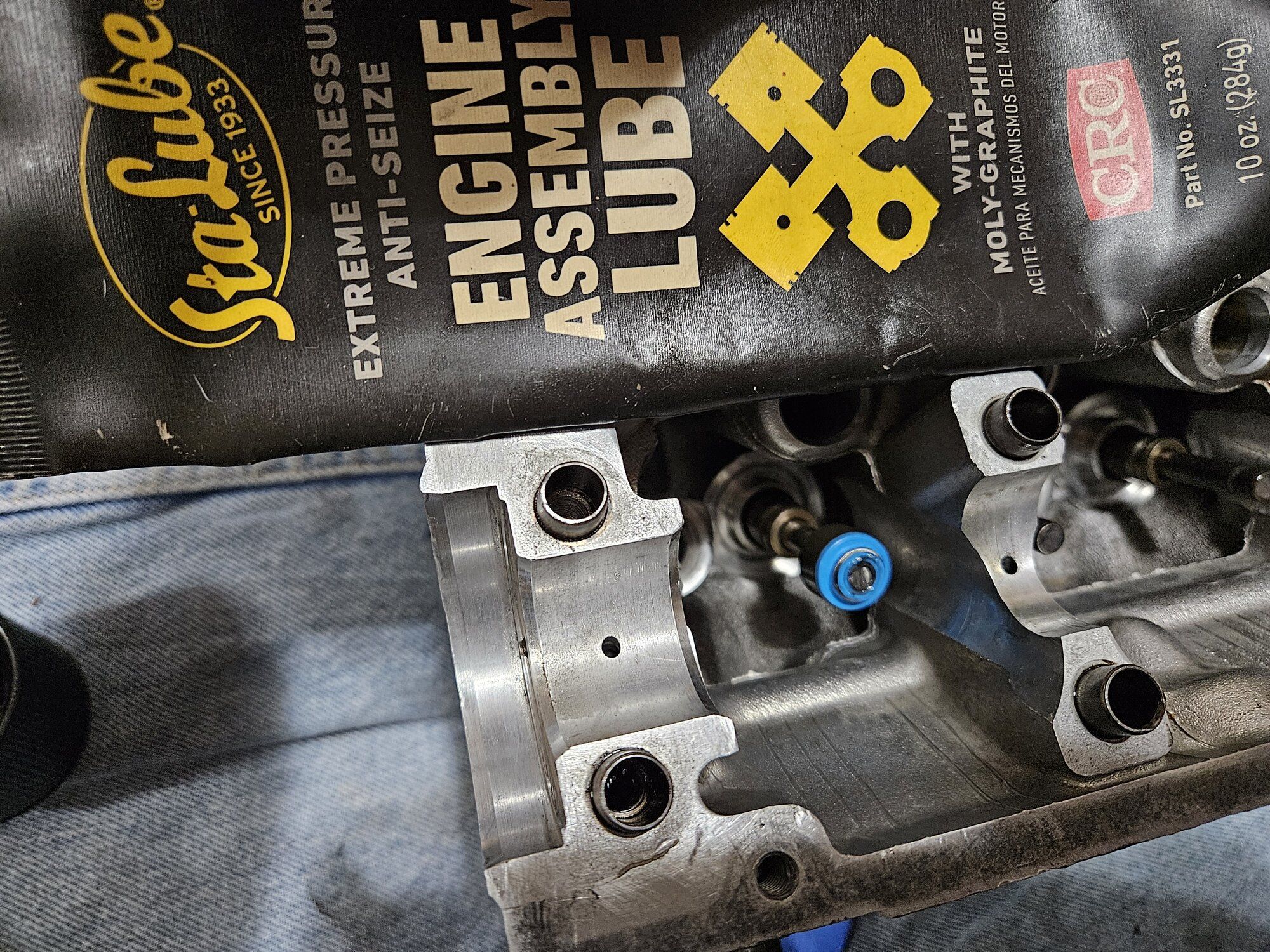

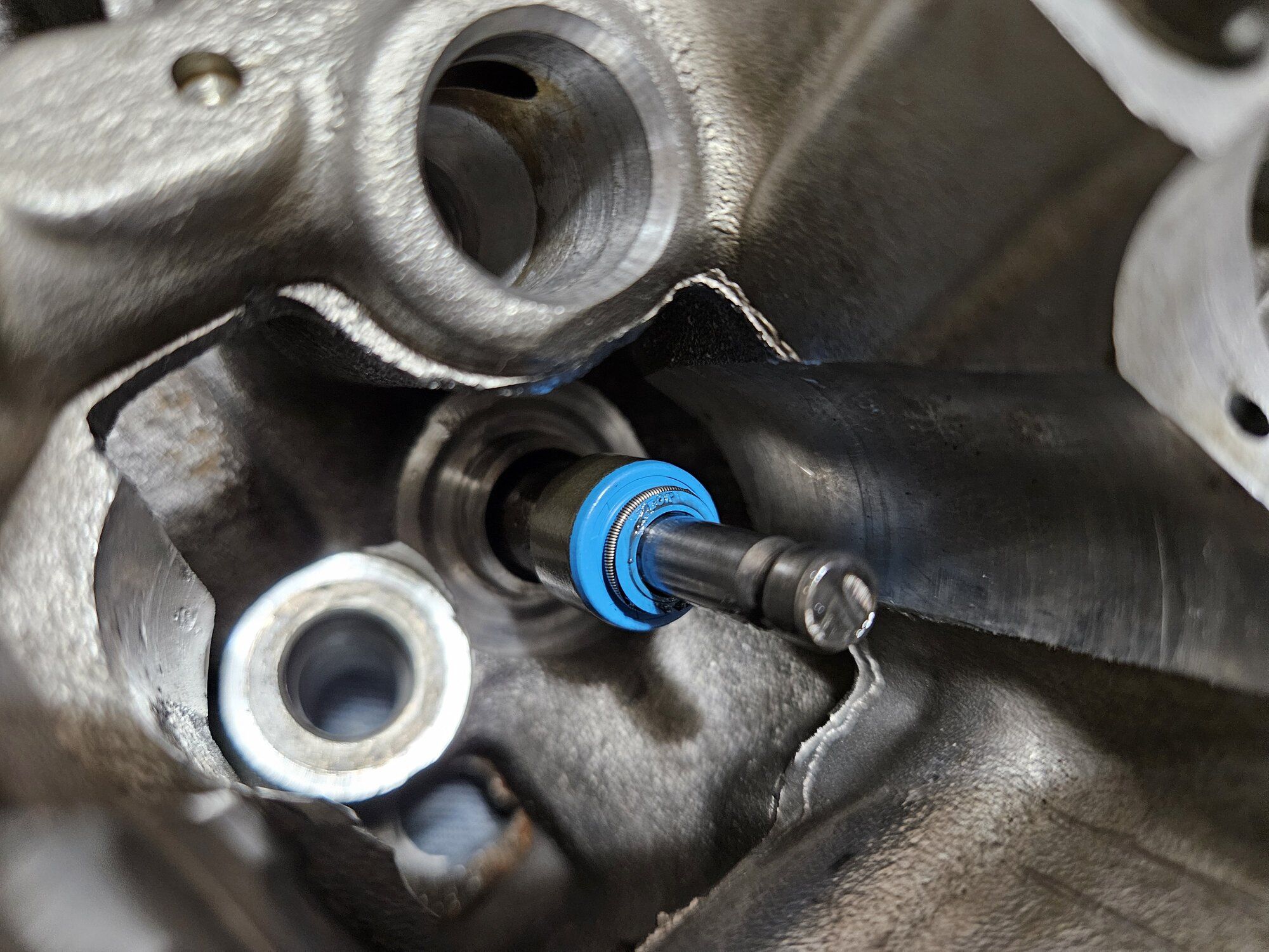

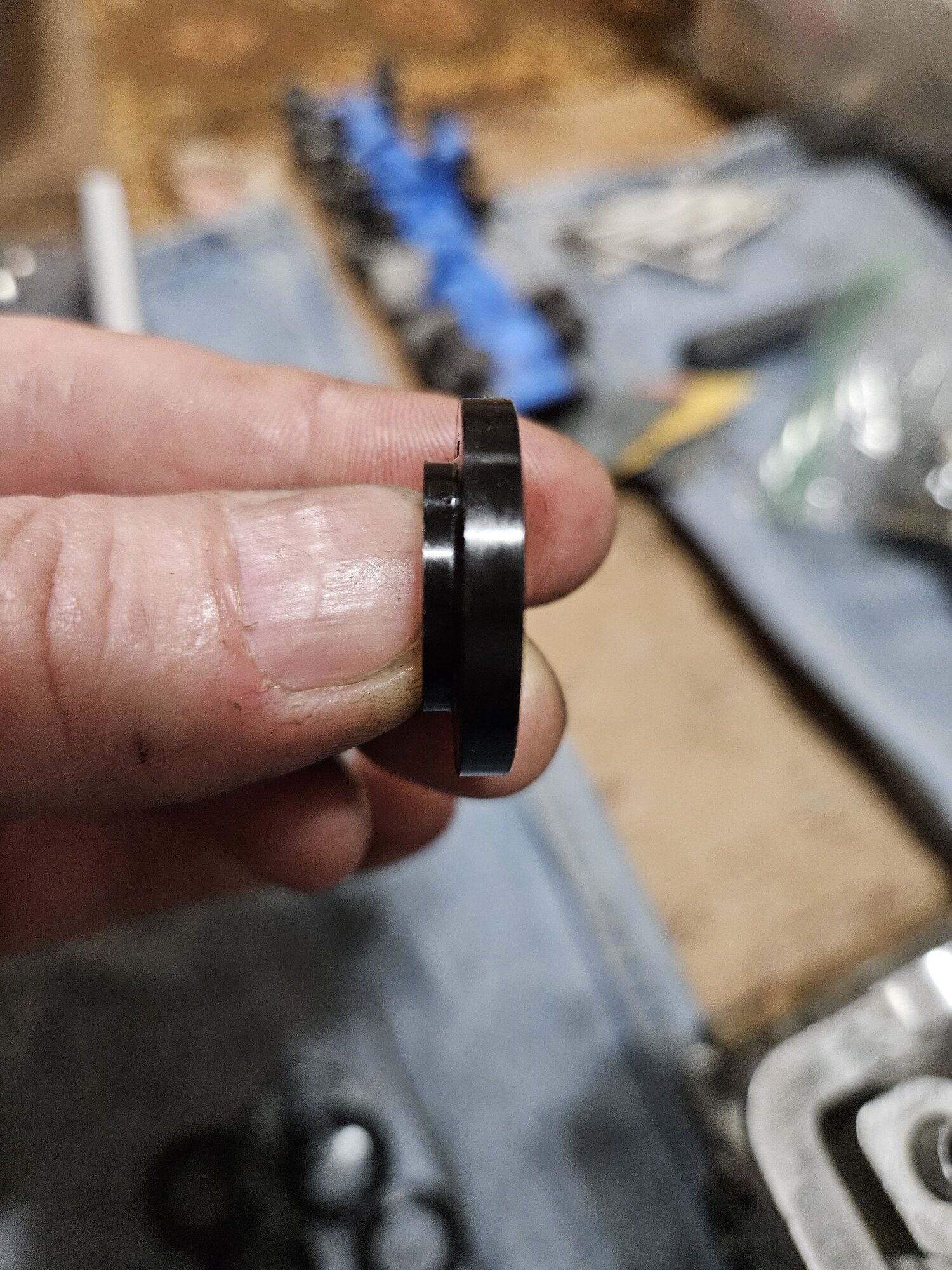

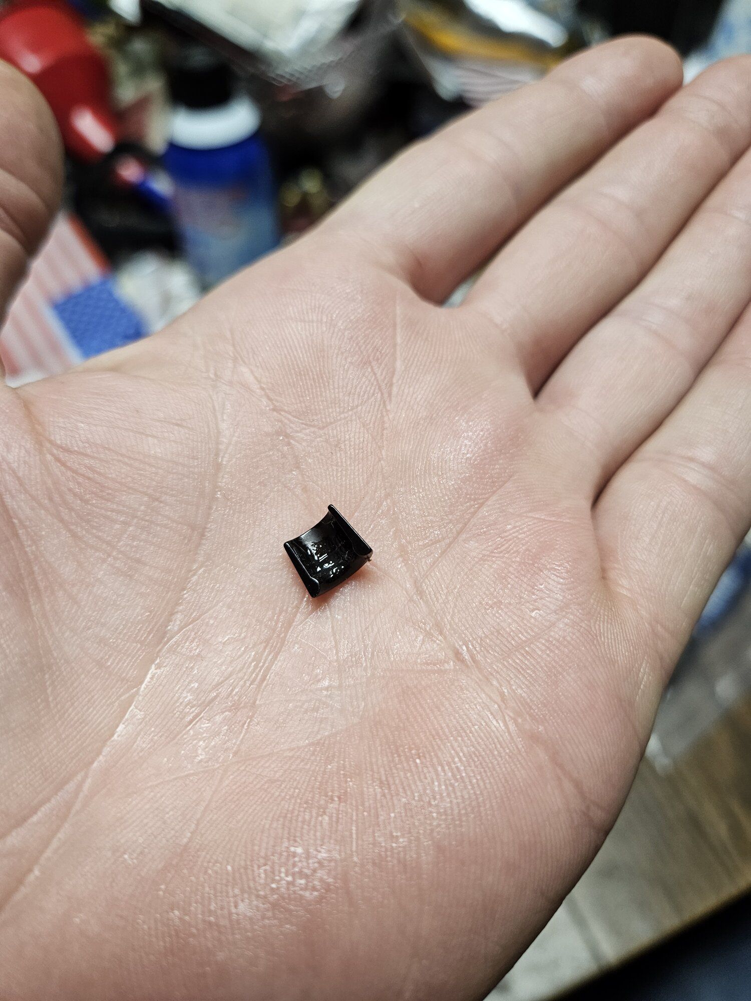

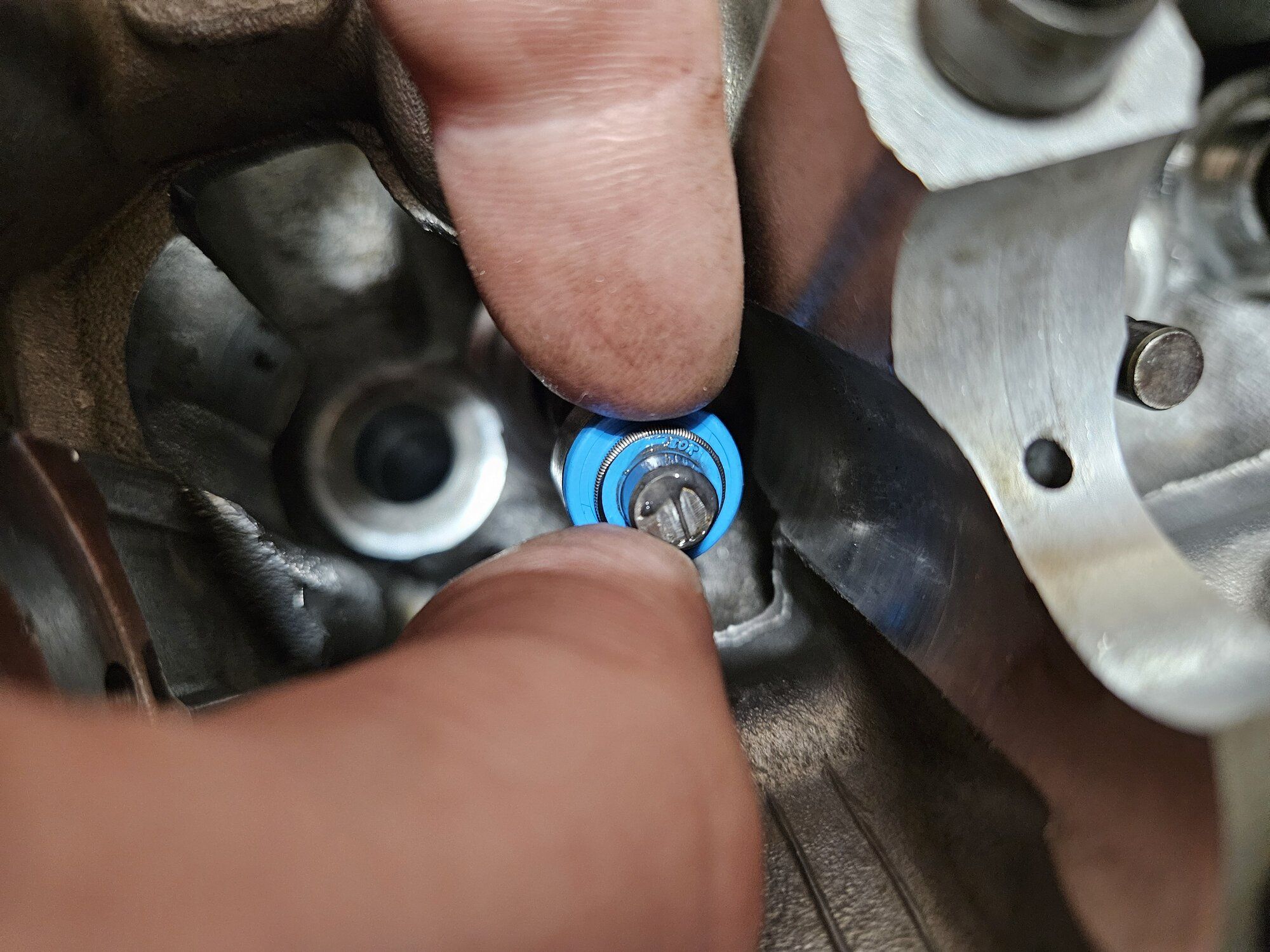

Well, I decided to put the Kiggly Springs on and during test fitting, I had 1 Manley keeper go "ting" and it went and hung out with the 10mm sockets......I tore the whole head back down looking for it, No Bueno so I ordered up a whole dam set of 16. Pisses me off more that I can't FIND the dam thing than anything else (well except the fact that I can't just buy ONE). I will be keeping an eye out but so far, fk me. Everything else turned out just fine, I'm just ticked off. I got some pictures. The spring with the green dots has stock keepers so I know which one to change out. It is probably just fine but I hate mismatched parts, so it is what it is. 🤷
I'll put 2 Manley locks on when the extra set shows up this next week. :banghead:

That's so dam true Pat! My son assisted me in the "search" and also on the complete tear down looking. He said if I ordered another, I would find that one after they came in and, you know, that would be a relief on my mind. We tore it all apart, turned it upside down, ran a magnet over EVERYTHING and it's still hiding. I am upset that I didn't put a rag over the spring tool cup to contain any "mishaps". Stupid silly shit pisses me off. Major stuff, I get and deal with.
I would turn the world upside down to find it. At the very least I'd make sure it wasn't in the head somewhere like in one of the springs.
I had every valve/spring/spring seat out. The only thing I didn't take apart was the valve seals. I DO feel like you just said. :idontknow:
My son grabbed a flashlight and we looked thru every spring but I didn't look UNDER the seal, between it and the guide (but did have my magnet all over that area and every other spot). I WILL take take spring back off and quadruple check it. I just don't want parts floating around this expensive motor.
UPDATE

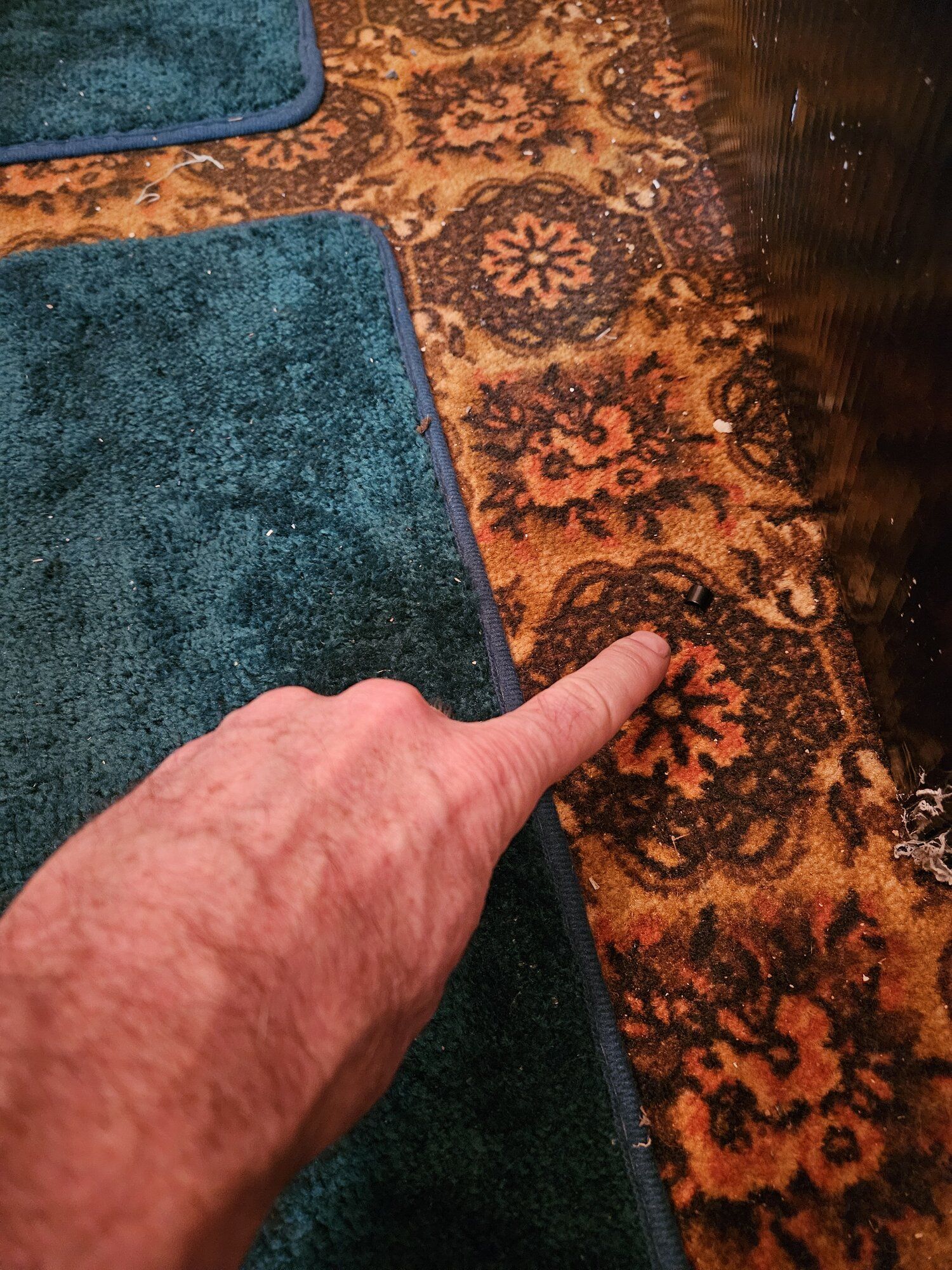

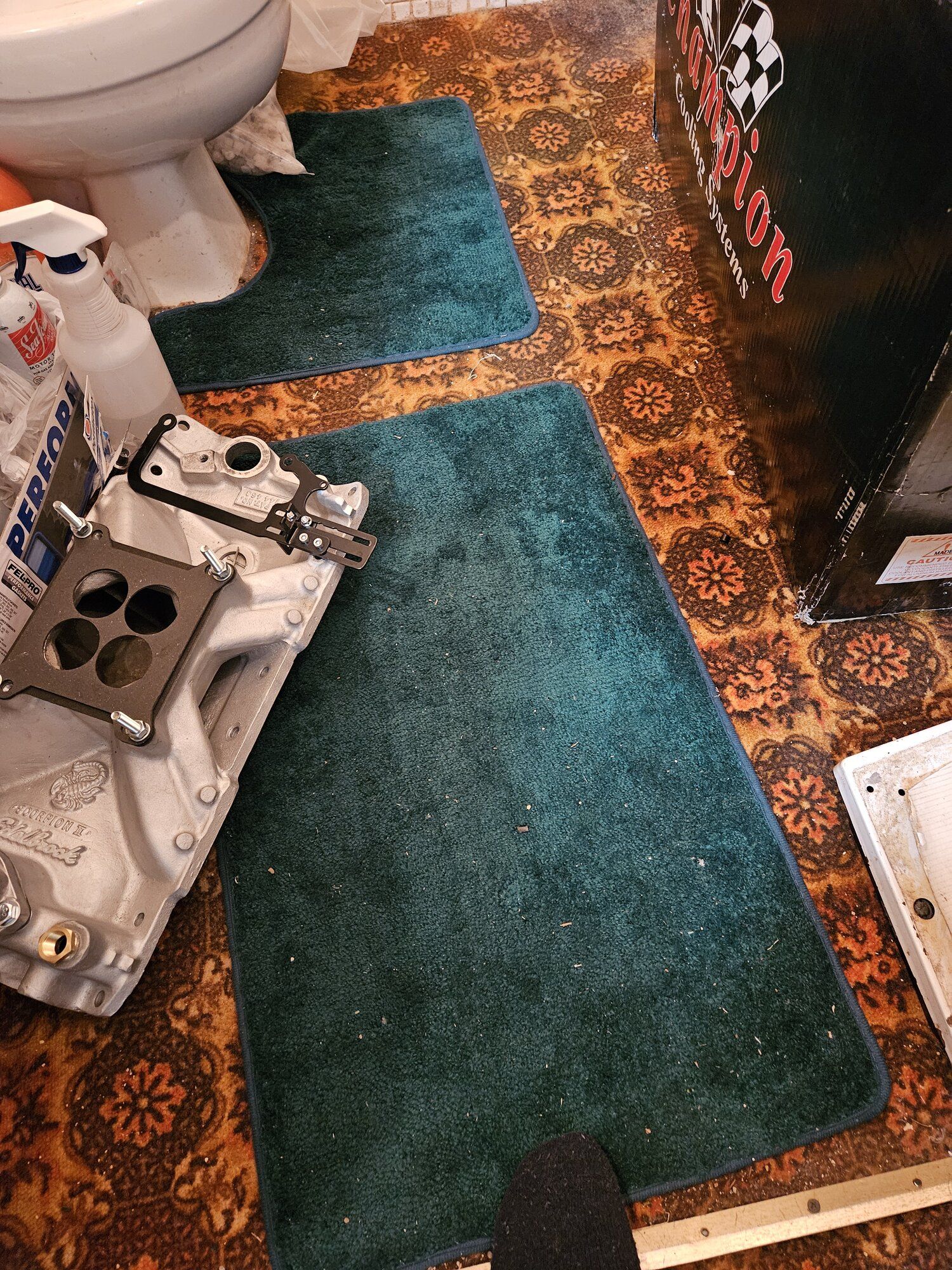

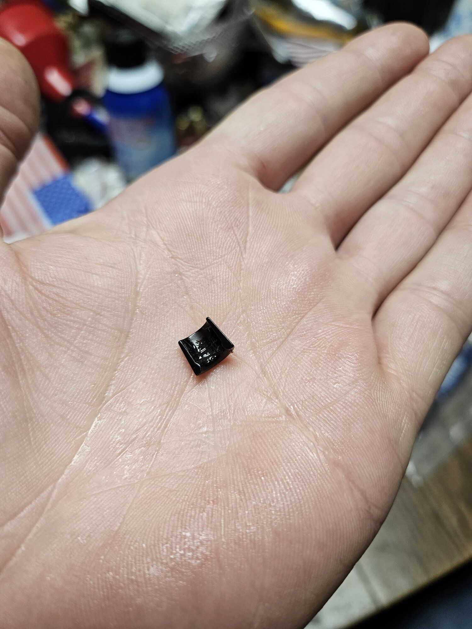

After another EXTENSIVE search of the assembly room.....I spotted it more than 4 feet away, in the bathroom, can you see it????:cool: ;) :thumb:
I am trying to cancel my order of 16 more, but I feel so much better that IDC if they ship or not.
It ISN'T hiding with the 10mm sockets tho... :idontknow::hmm:
Marty

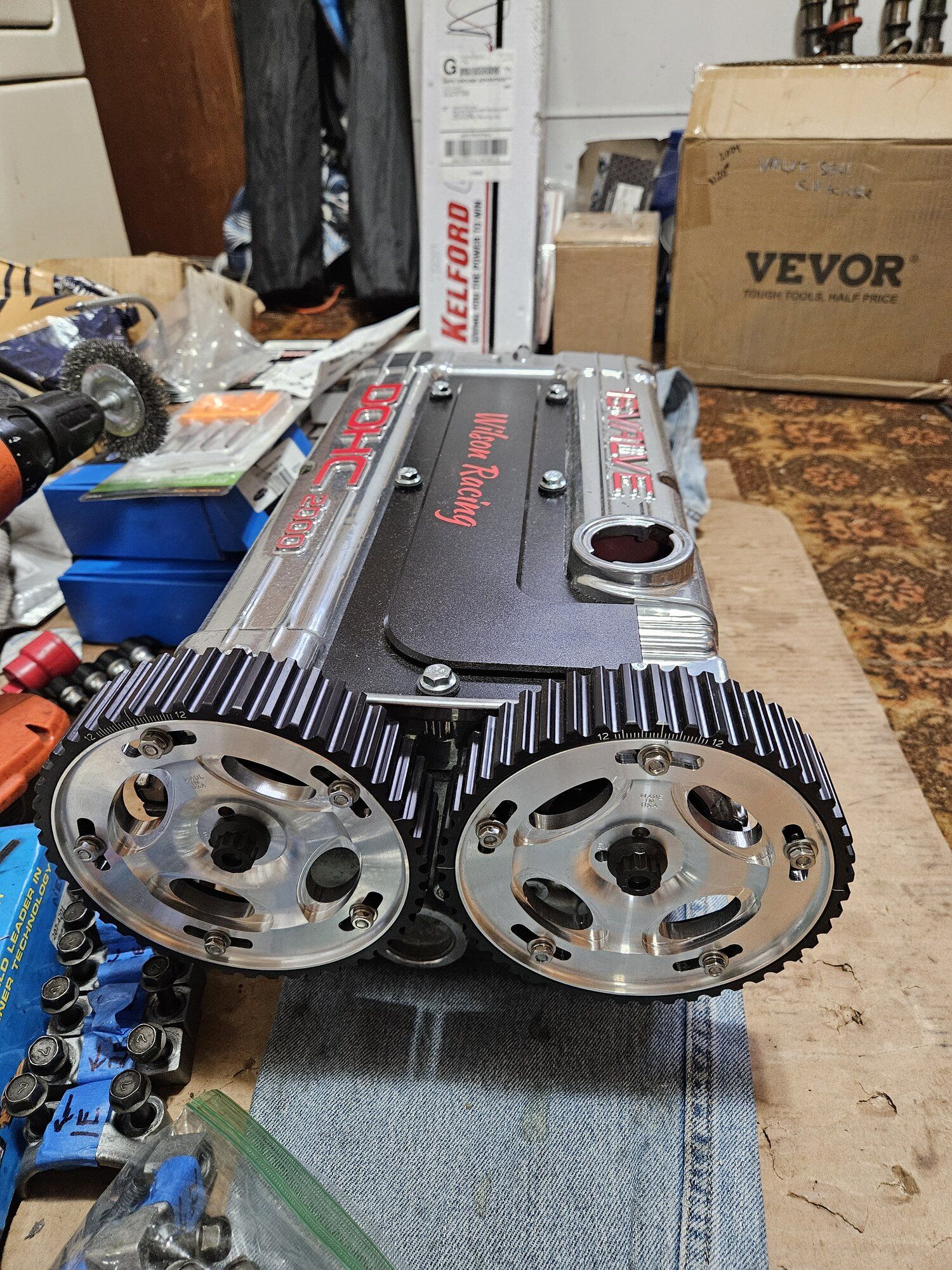

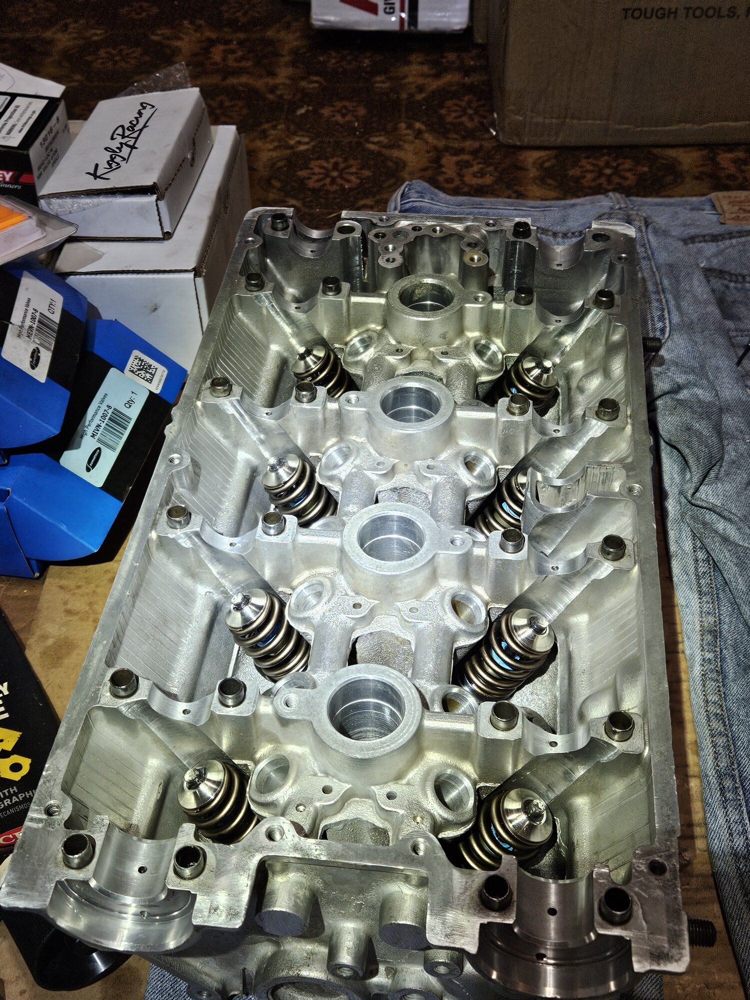

All good now. Final shots. I am only using Manley keepers for peace of mind. :thumb:
It was BUGGING the shit outta me, obviously. I am "relieved" that it was finally recovered. I heard it go "ting" as it exited, but never heard it hit anything. My son was working on an SBC intake and didn't hear it at all. Pretty sure the lesson learned here is to cover the opening on the Euro tool head to prevent this issue. :cool:
This all happened while we were trying to film the difference in vacuum on the valves before and after springs were installed. That video timed out so I can just tell you all that YES they seal super good with springs on. The exhaust side is bleeding down slowly, but after a few hundred smacks on the seats, they will be fine. That would be about 15-20 seconds running at 1000 rpms and I am very happy with the home work results. The machine shop only did the resurface for $50 so I am sure I saved some money and know all the specs on the head like I do on the block. Now I need to record all the stuff I know for future reference.
