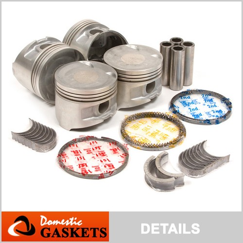

I don't know what brand of bearings they supply with this "kit" but it is a very good deal.......
when compared to https://www.ebay.com/itm/283799137415?var=585222025055&_trkparms=amclksrc=ITM&aid=1110006&algo=HOMESPLICE.SIM&ao=1&asc=20201210111314&meid=9af9b3c684044849a47f8f8fdb917ba5&pid=101195&rk=7&rkt=12&sd=261403347018&itm=585222025055&pmt=1&noa=0&pg=2047675&algv=SimplAMLv11WebTrimmedV3MskuAspectsV202110NoVariantSeedKnnRecallV1&brand=Aftermarket+Products&_trksid=p2047675.c101195.m1851&amdata=cksum:2837991374159af9b3c684044849a47f8f8fdb917ba5|enc:AQAHAAABMMFr2e4EmAnM%2ByHZkULYKDIJ4L66fOjNL0iupgt%2BzO1%2F3AE1t3mNirUYB96NktMCicMagiS6mbeTl0xquGODv9l6x8uv7qfA1F2ncRWxzNNDsY9N%2FIOnTjtG5Q3uH%2FvaoFsa%2BXrvo9dcOsCyIEr0Ug7nIuqWYcGR8LLeyG%2FzRTiYHA9mCbGvCEf2DdkKSfMWBQx48KJ2Pf%2B0PPHfv79UAjK%2FUD%2F%2FFgaSGfL4olvu9s929JNhhB2gheuba0ZoPhE8nEJhq17aFgzCHNtuH5pXJ46OoJyohAejRNeXFz7ArjD2nynNJhMoW0eW3SFw9uYOXd4U1TIwyk42qkxchMWUG%2FqxQ7xYr%2BOQ371ZNYA6vU8nRWCgYbwpXsCb6yLEwUL9x%2BKqVYxg11TmkxUGQDys96s%3D|ampid:pL_CLK|clp:2047675
I have a motor that I am using NPR pistons and rings in and they fit great. I am sure they will be just fine. We will find out over the winter if my son and I get the chance to swap out motors in the 90 GSX I have due to low oil pressure. I don't want to ruin a motor so I would rather pull it now and rebuild it, then wait for a rod to start knocking. Preventive maintenance is all.
Marty, I bought a kit from them a couple months ago. I didn’t get pistons but full gasket, rings and bearings. Both the rings and bearings were a brand called Evergreen I’m pretty certain, I can check when I get home and confirm.

I've recently rebuilt my 6 bolt with stock internals. Found Nippon 2g 85.5mm pistons and NPR rings on ebay ($170). Machine work to bore +.20 and hone, clean, deck the block and head, polish crank, and inspect the align hone ended up costing me north of $800 (and about 10-12 weeks). Another $230 or so to machine 1g rods and fit 2g pistons. So we're at $1200 just for the basics. Include a set of valves, bearings, complete seal kit, front case/oil pump, timing belt components, tools, etc. etc. and I probably put close to $3k into it. This was mostly a budget build and I didn't splurge on any go-fast parts yet. Granted I also didn't go with the cheapest machine shop. Besides the machine work, there was no mechanic/engine builder costs. YMMV
Thanks for these link! I already bought acl race bearings to be sure on the bearing side. But if im not over sizing ill get this for the pistons.
