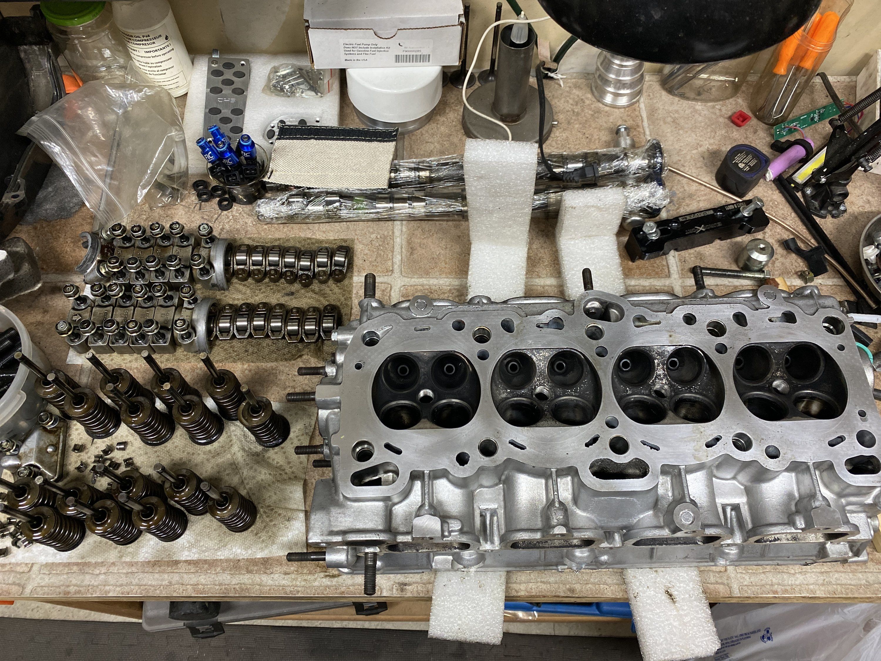

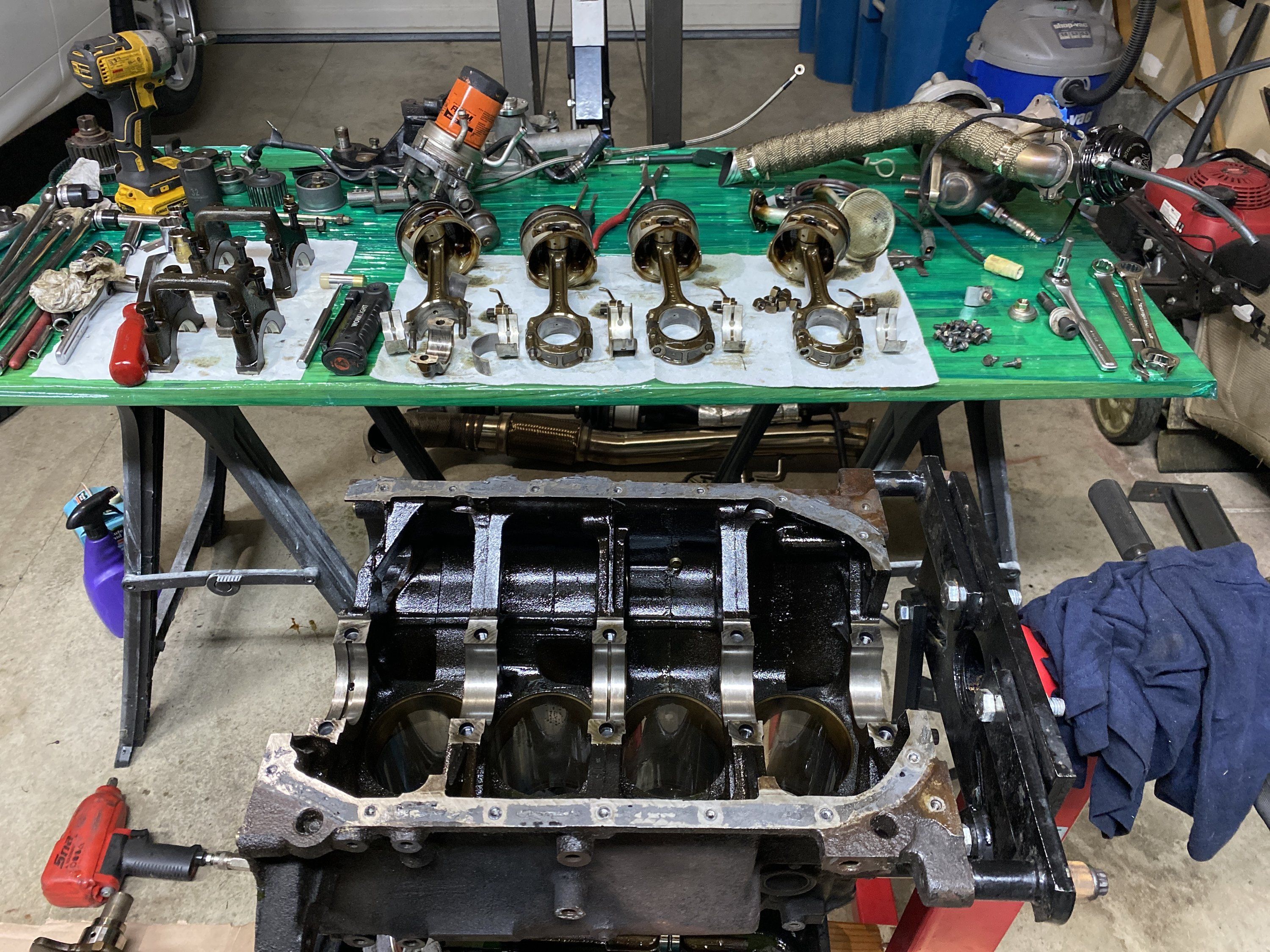

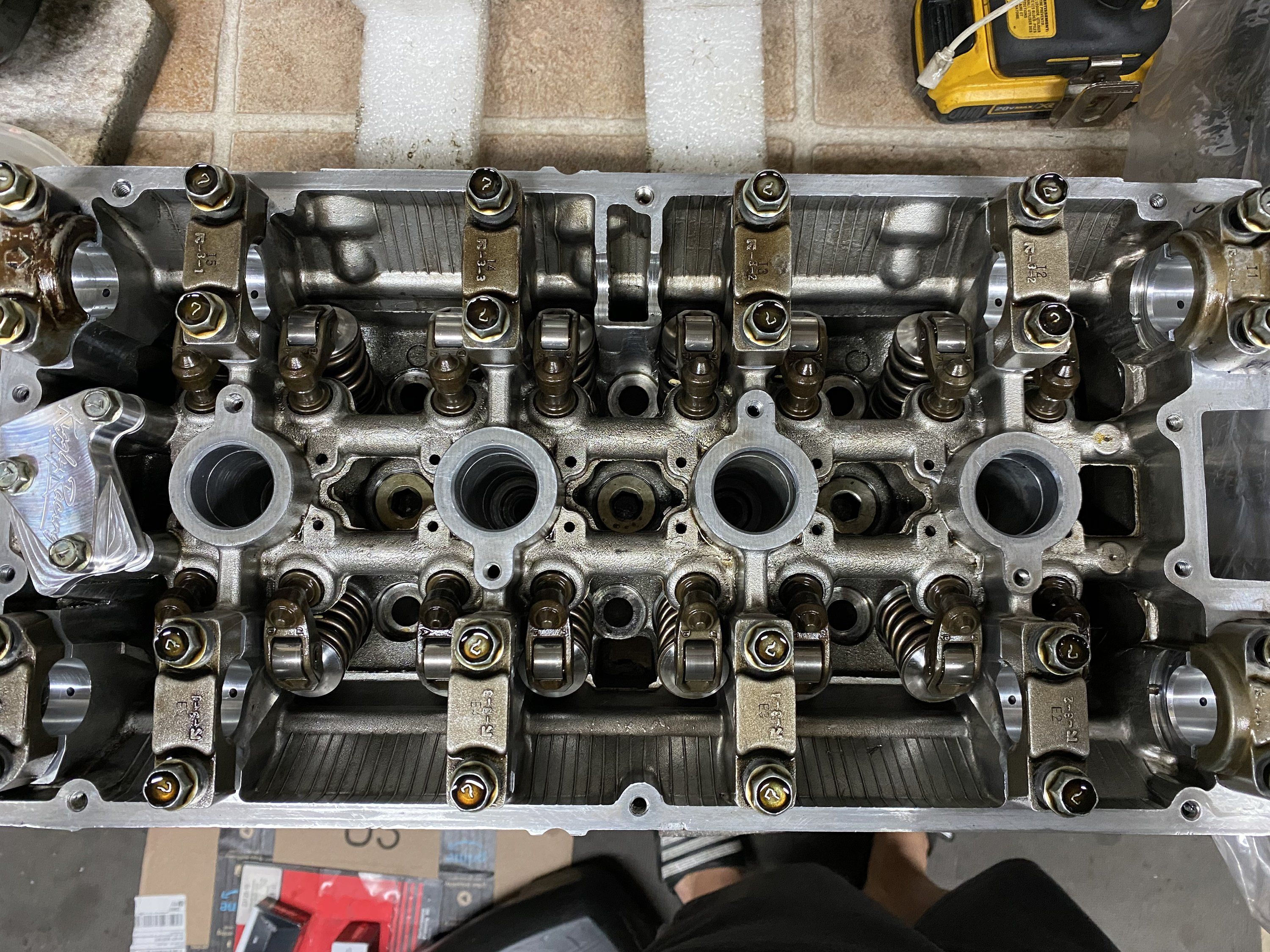

Thanks buddy! Can't be any further from the truth. Pulling the head off tonight/tomorrow. Plan was to build the bottom end this winter but it maybe sooner now.

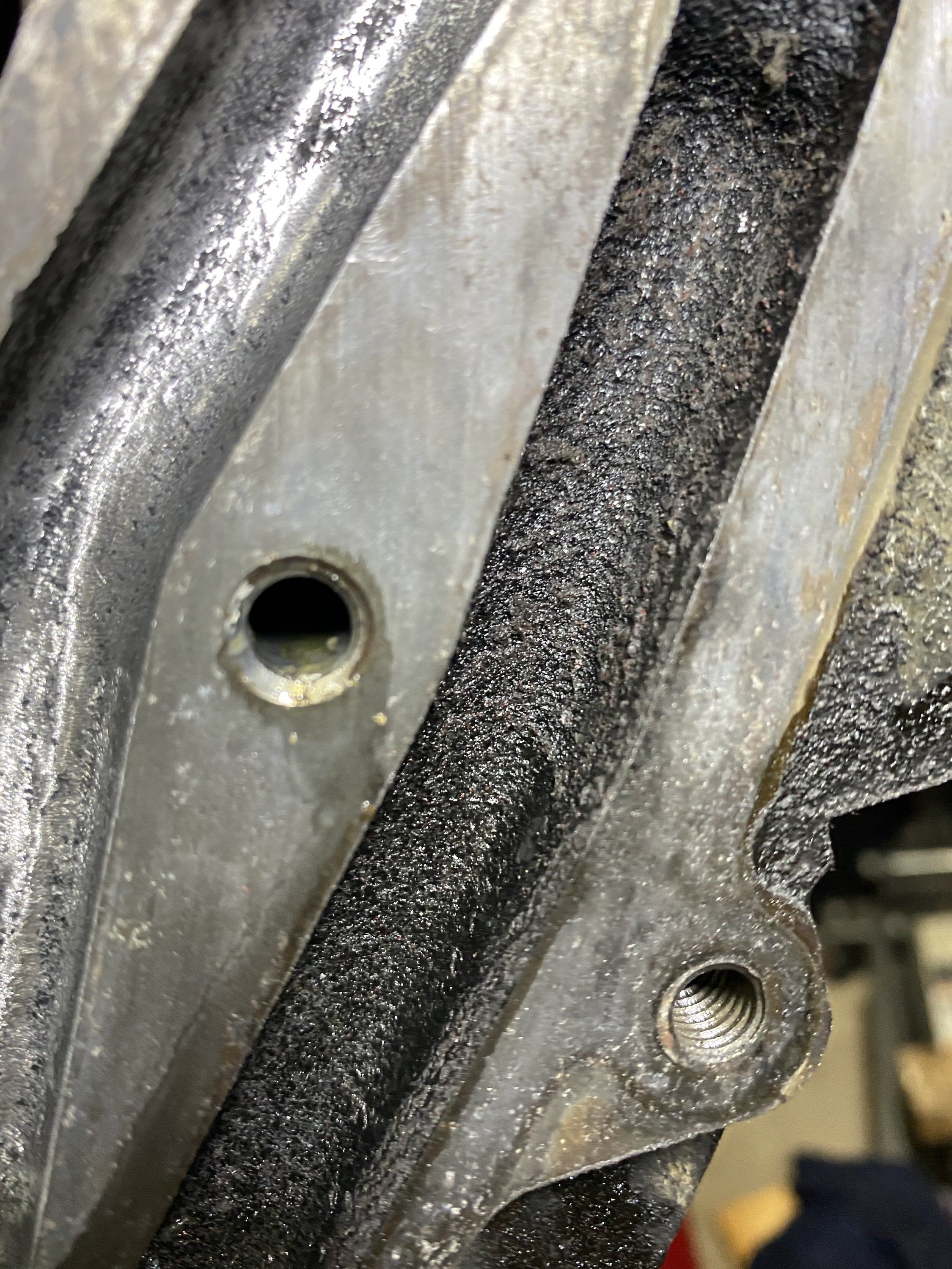

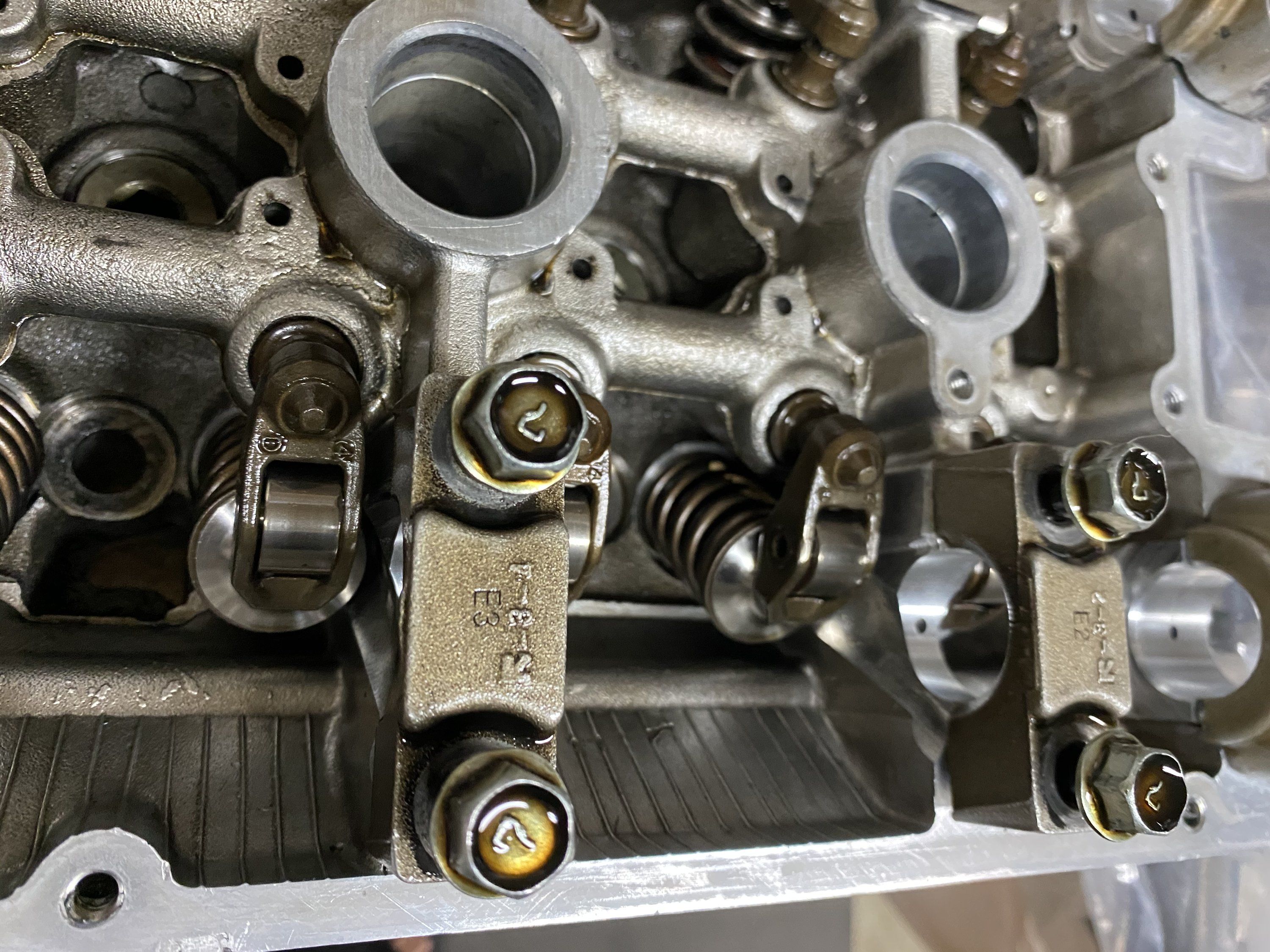

Any idea what that rogue piece is???
Uggg......:cry:

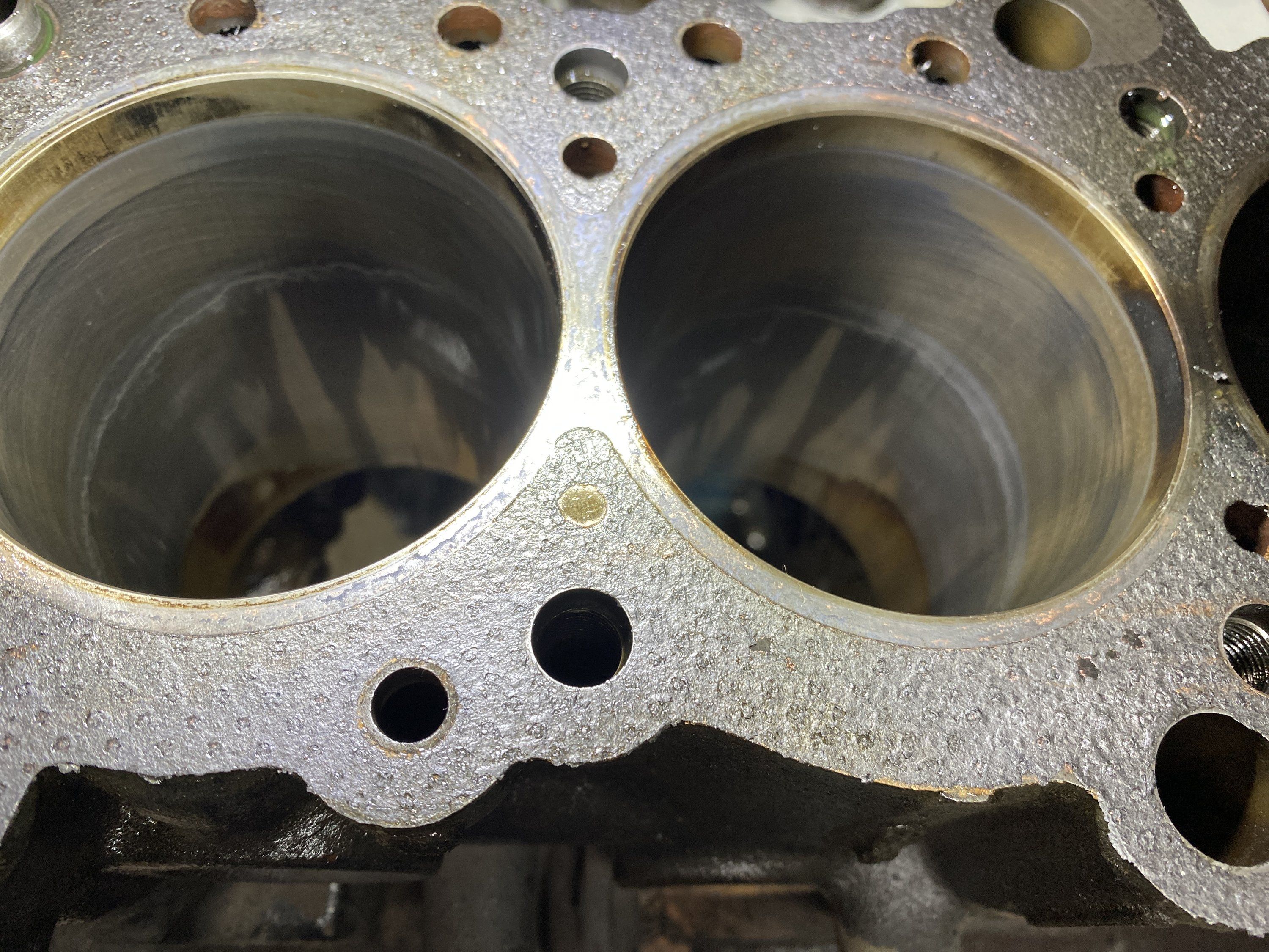

Crossing Fingers Tony! Everyone says that the composite HG will save the rest of the motor, so there is hope!!!

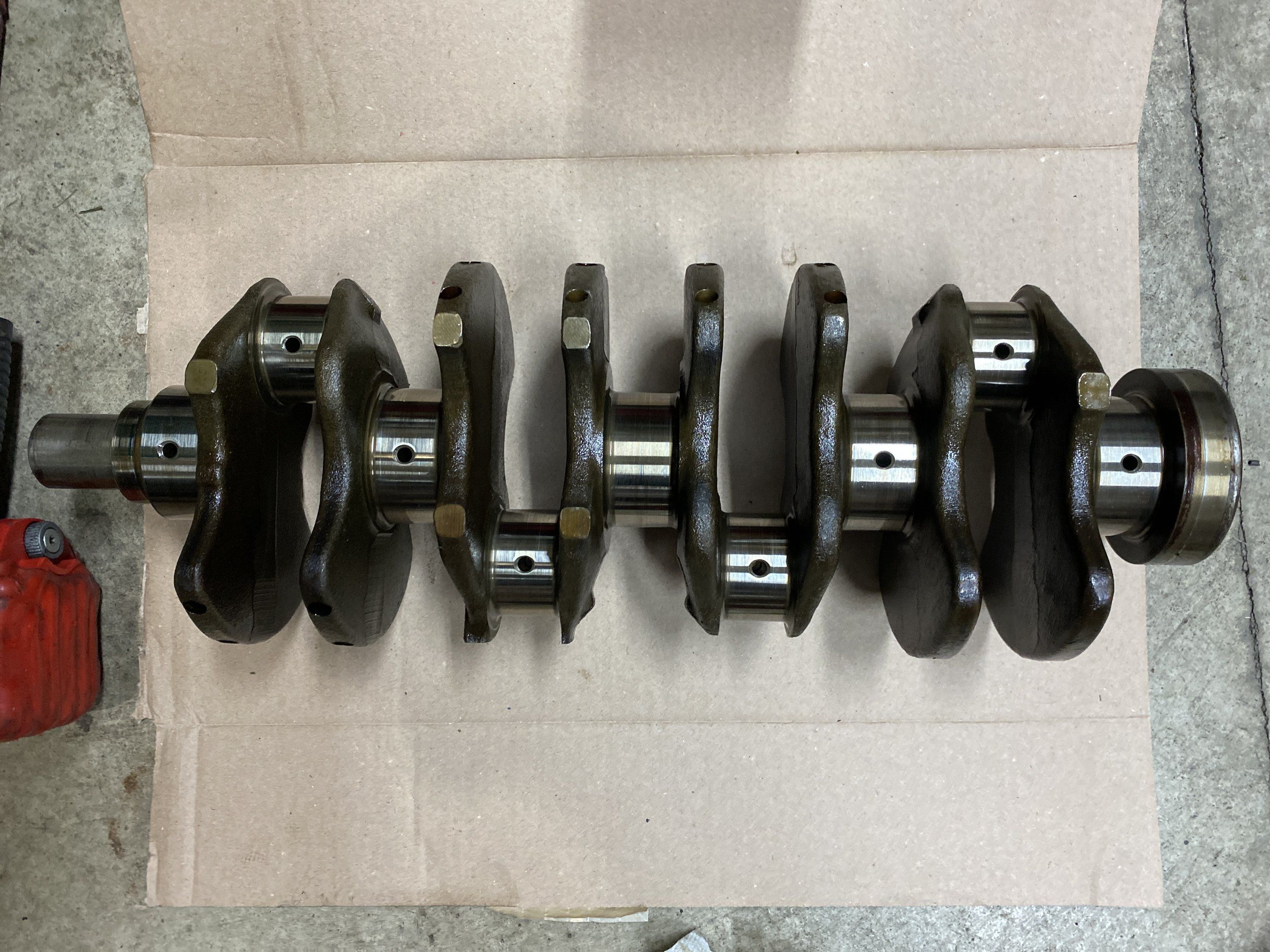

Wow, 150K?, bearing and journals looks amazing :applause:
130 but who’s counting LOL.

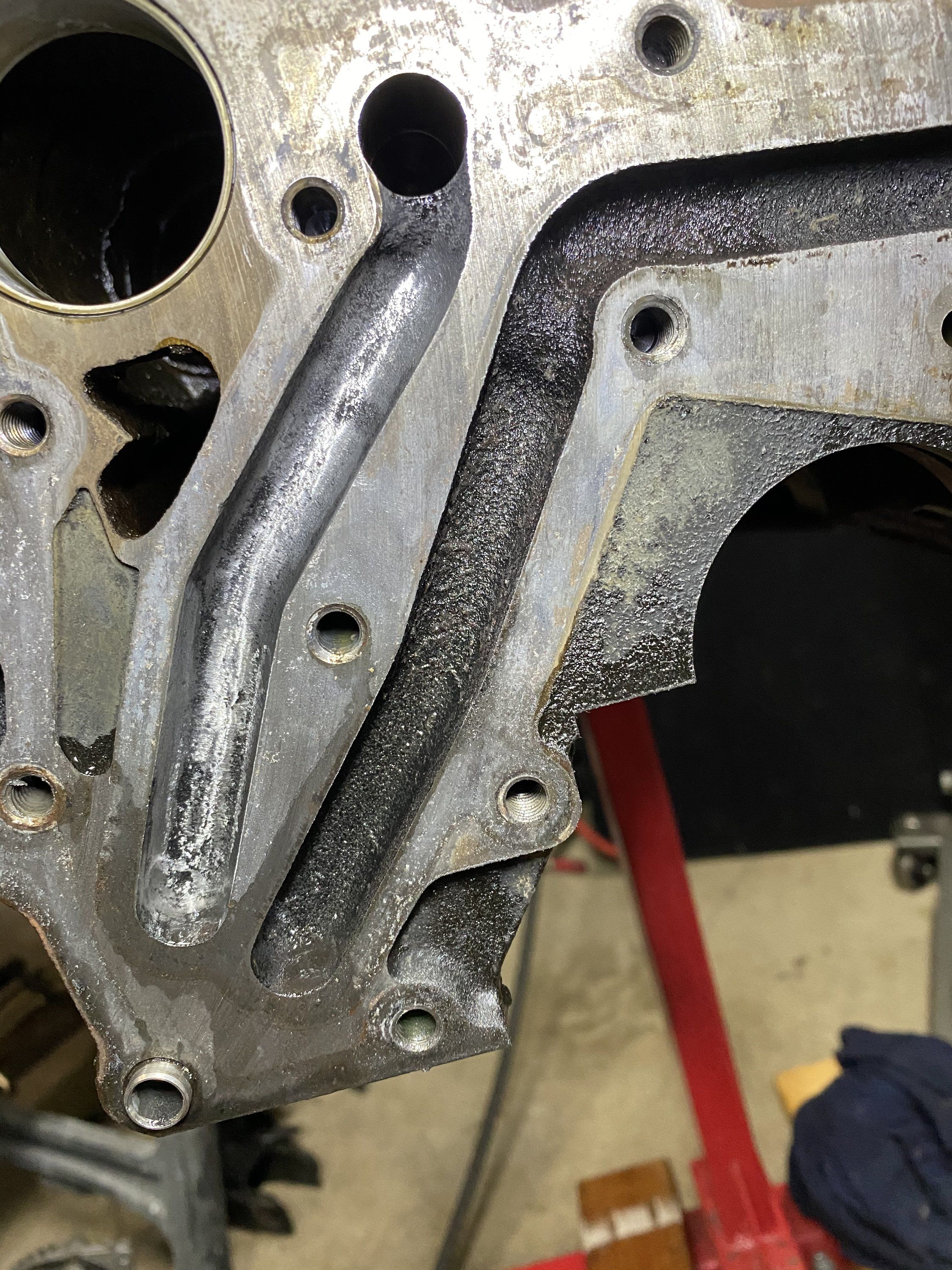

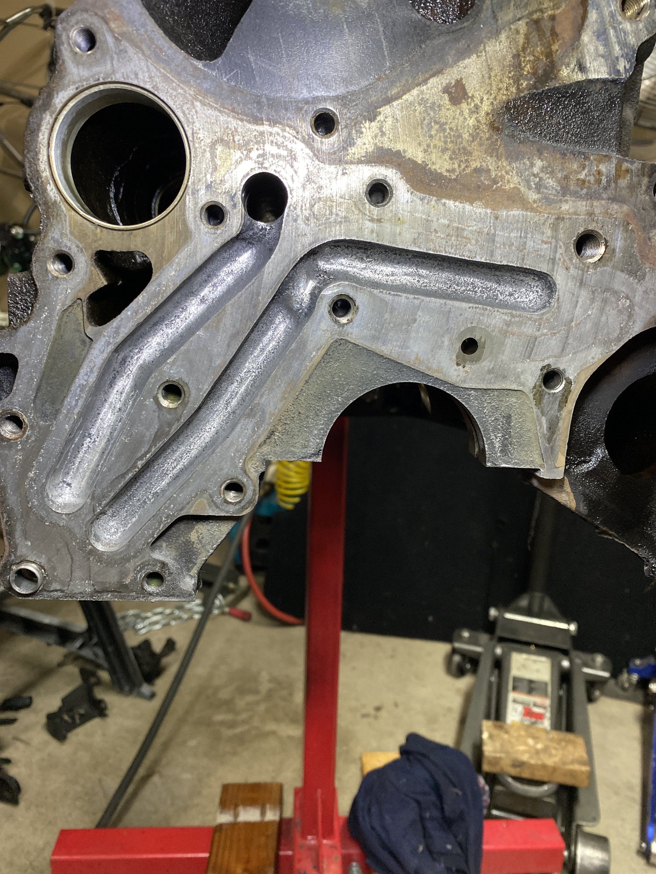

The oil passage is complete garbage on our blocks. Not winning any porting competition but this has to be more efficient. Big thanks to Jafro!!

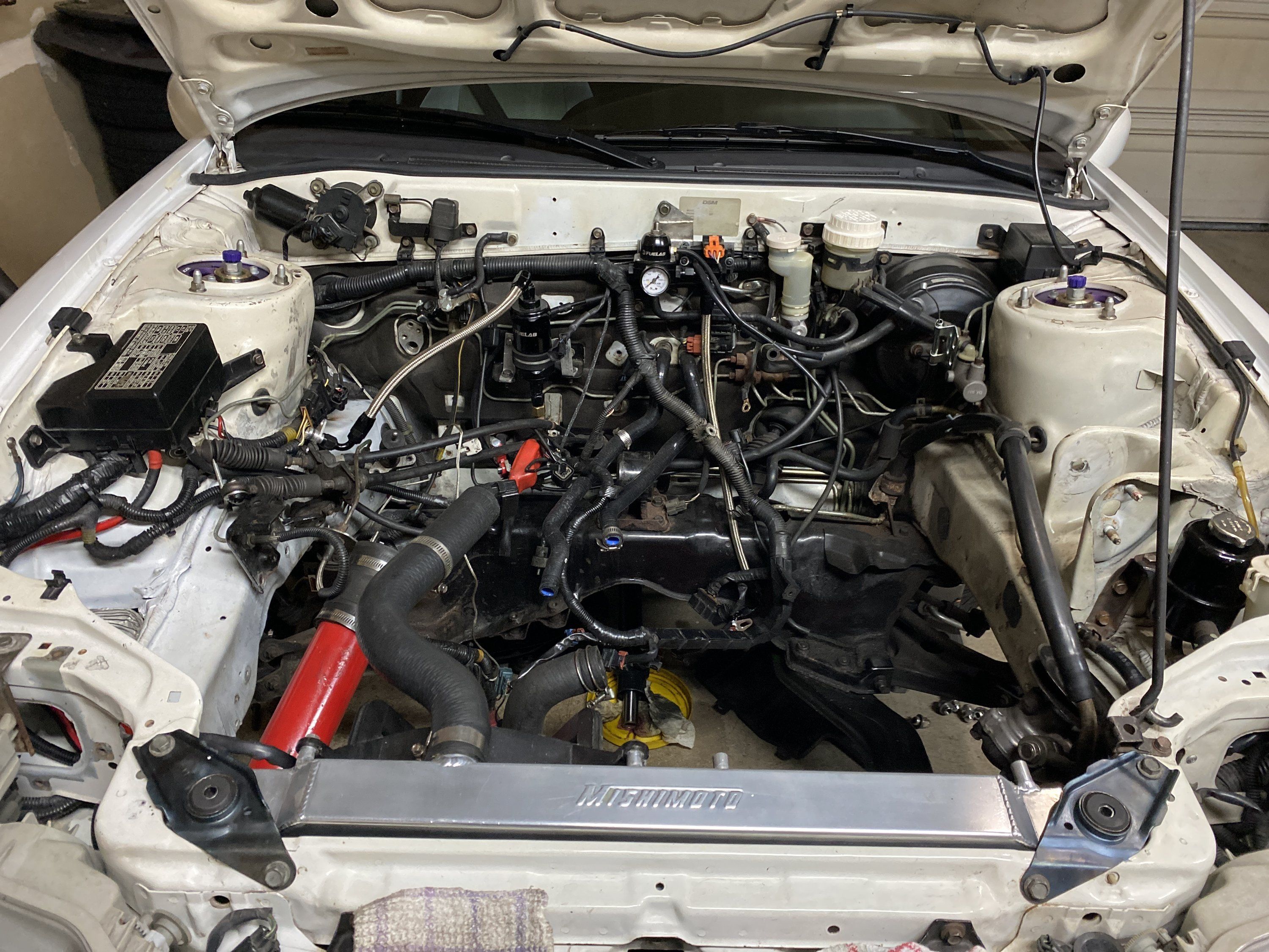

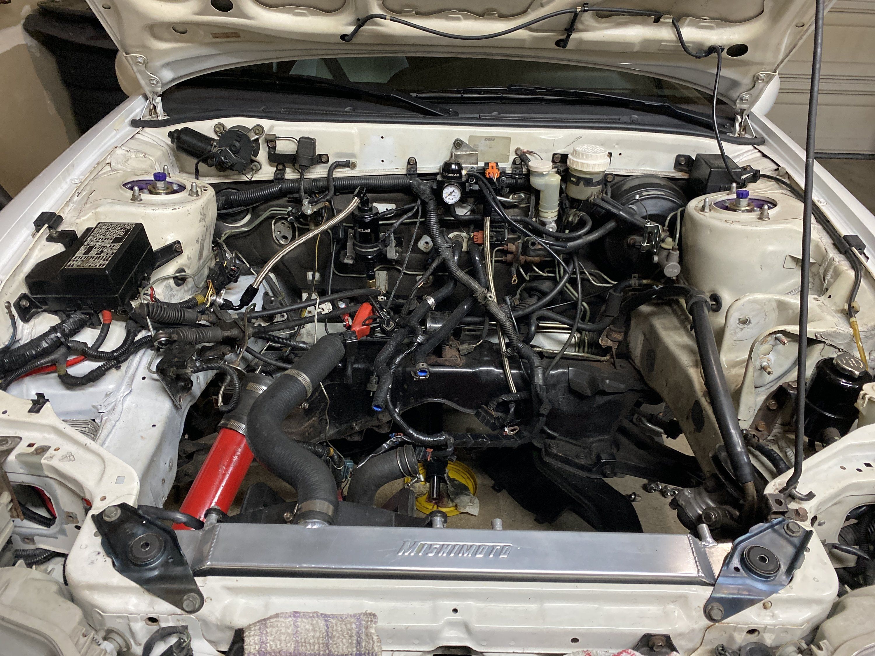

To paint or not to paint the bay...that is the question. I know it’s a lot of work...ughhh
Damn- sucks to see you going through this man.
Paint? Now is the time..........if not now, than when?
You will be so glad you did it once your done........its not that bad of a process. Most make it way more work than it needs to be from what Ive seen. Seems that you make good decisions.........so youll be good. Plus, from the looks of things, you will be waiting for certain things here and there anyway so it will keep ya busy.
I know now is the time if I want to paint the bay. Machine shop will have my block done in a week or two at the latest. Honestly not wanting to rush anything at this point so we’ll see how thing go but most likely she’s getting some paint

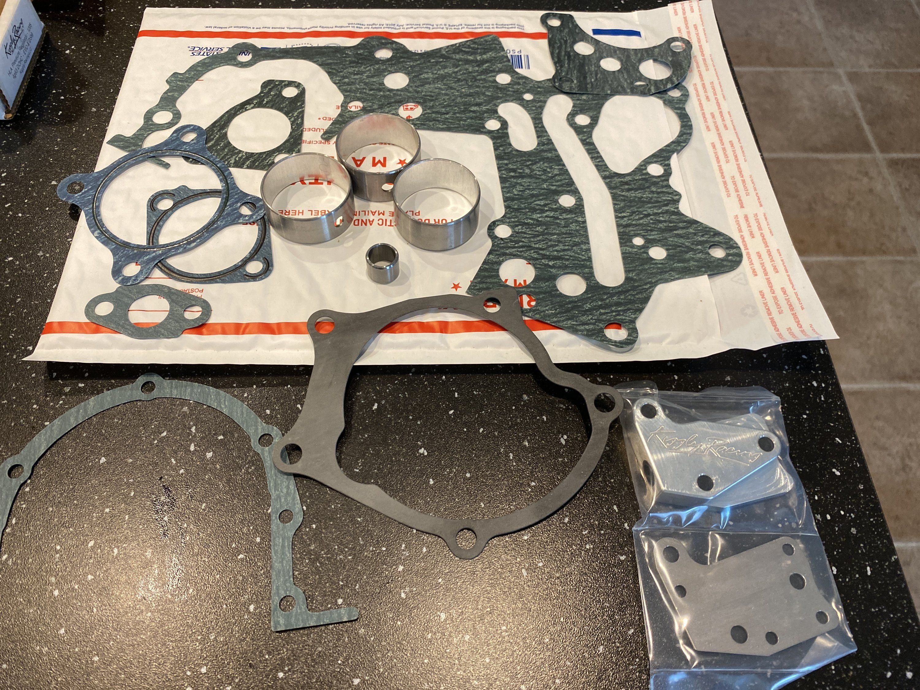

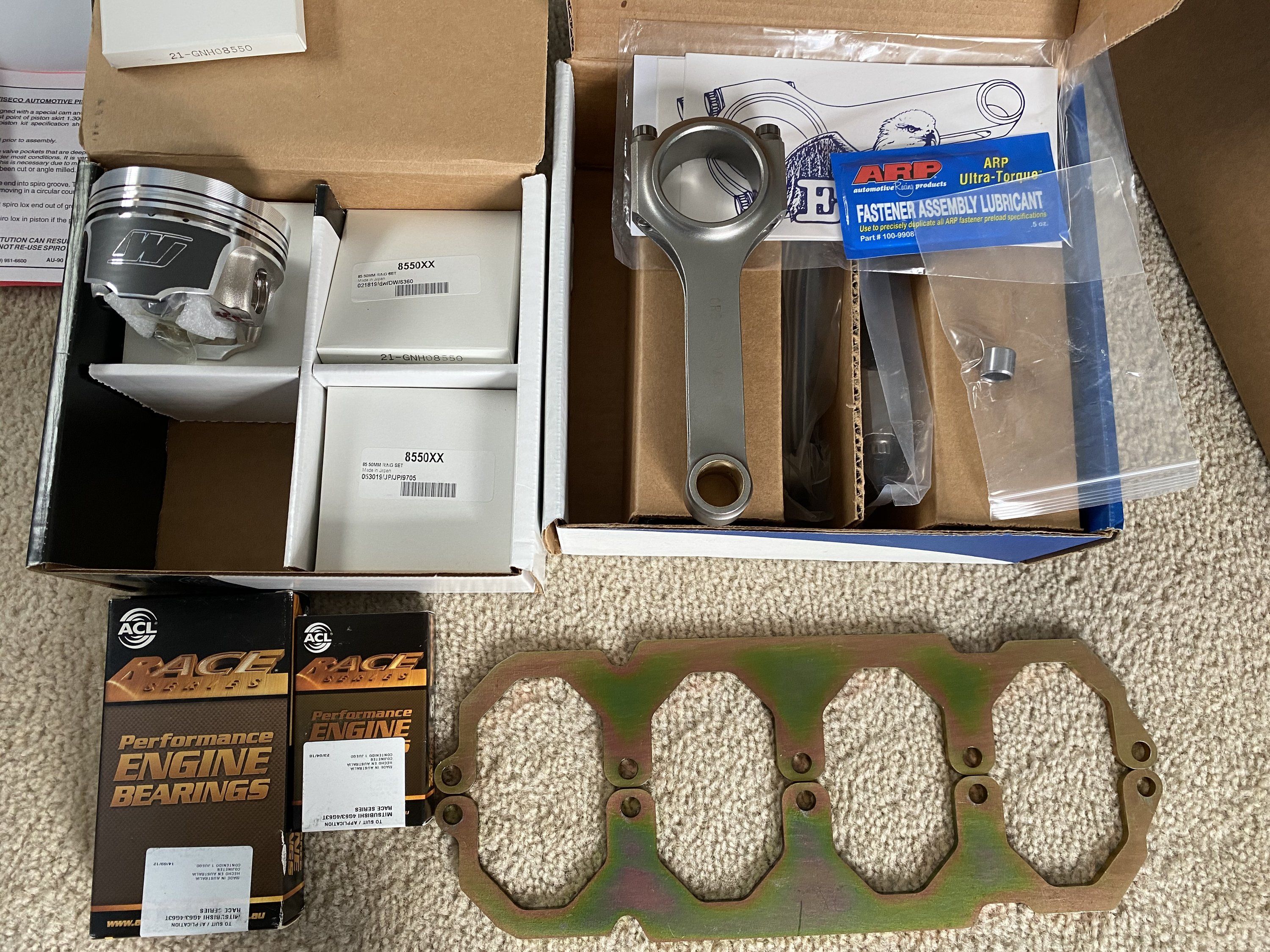

Some goodies for the rebuild. Only order one dowel pin by accident. I’ll order the other when I order rings and bearings after I get parts back from machine shop. Dropping off balance shaft bearing to machine shop tomorrow. Should have everything back early next week. Guess I’ll mow the grass in the meantime :cry:
If I had a spare set I'd send em but I used them on the stock 90 rebuild with my son (not as stock now).
Sorry Tony.
Parts look fantastic!!!
Sorry Tony.
Appreciate it pops! Hopefully STM will ship soon or at least lmk if they’re out of stock.

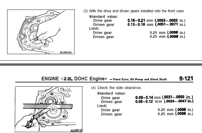

Since there’s nothing else I can do at the moment, I checked oil pump gear clearance and we’re within spec. Gears both look great and .004” for both gears so I’m happy to save a few benjis here.
