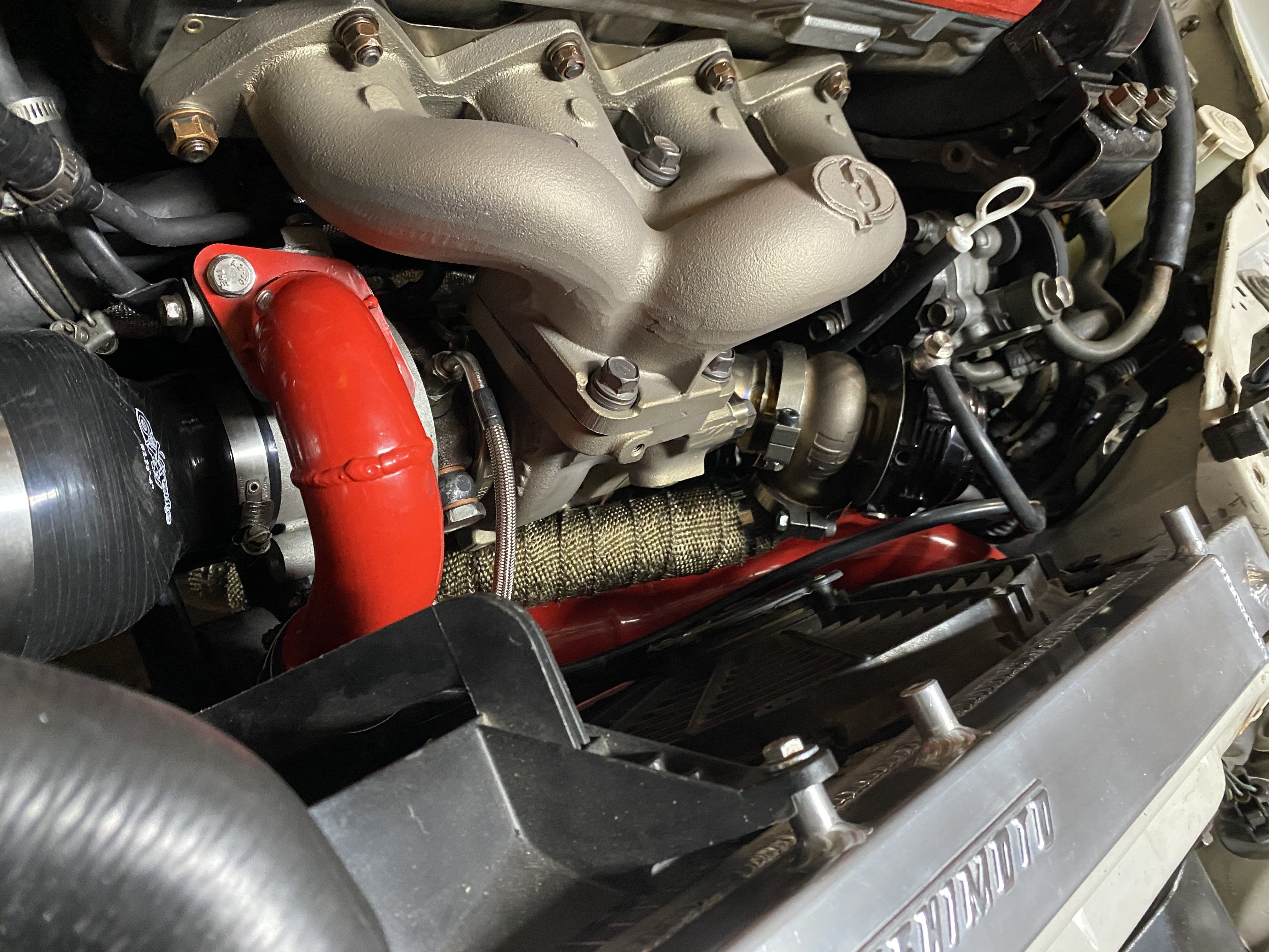

Got everything bolted up and washed. Took it for a spin and still only hitting 16psi. My laptop battery took a dump a few days ago so couldn’t log. Came back home and boom, amazon delivered my battery. :applause: 16psi...weak sauce. I’m glad it’s back to open dump:hellyeah:

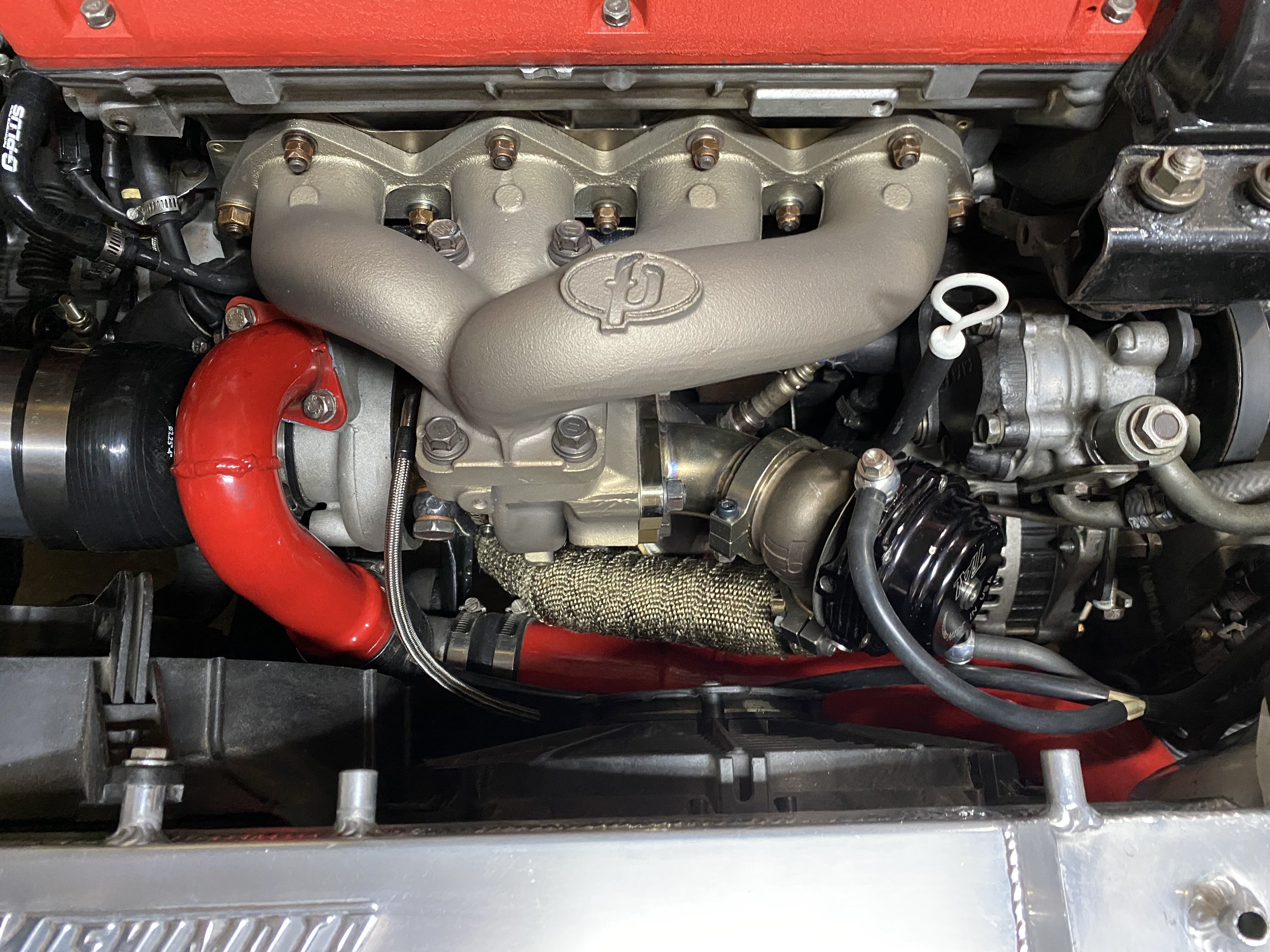

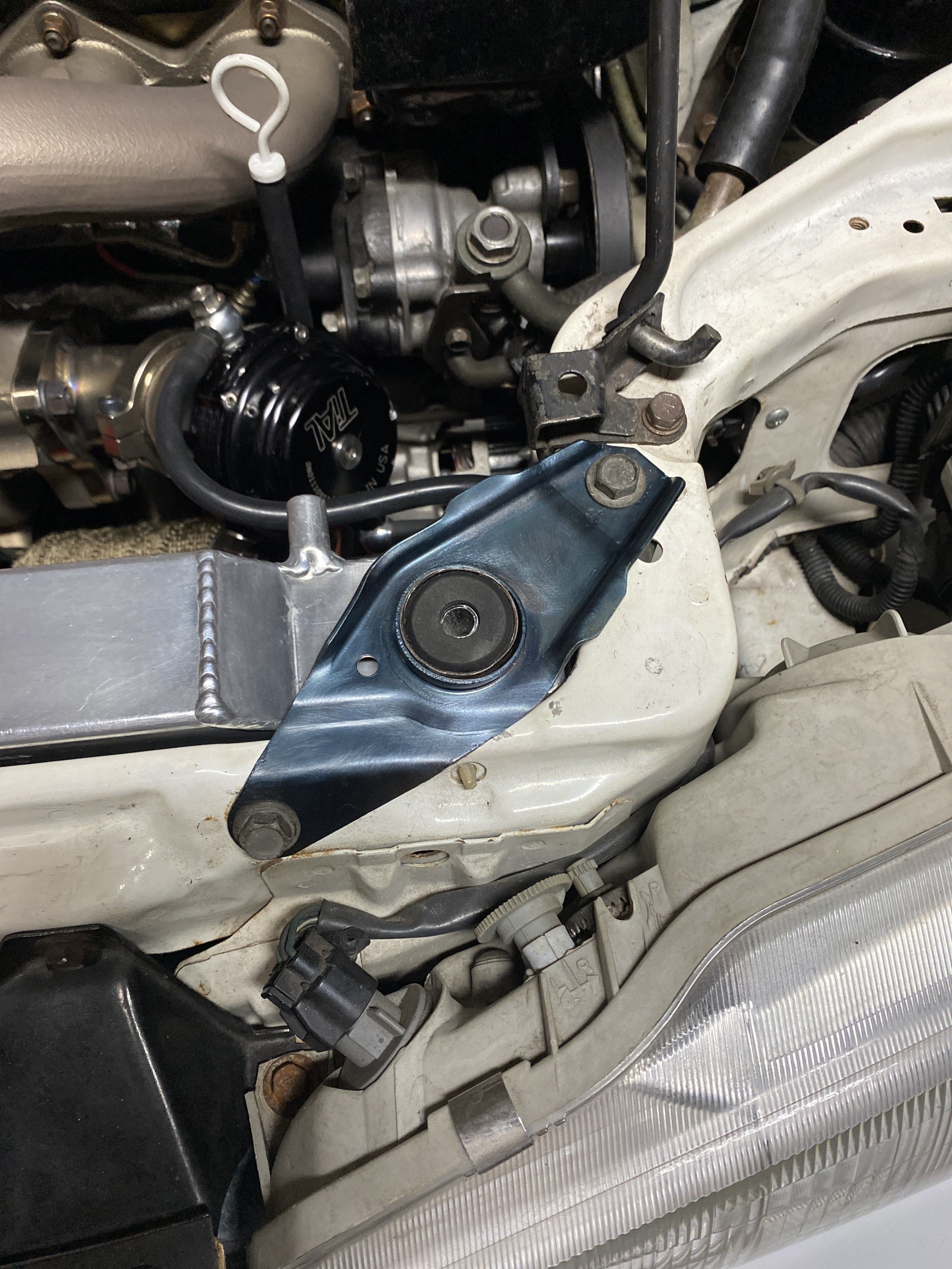

Hate looking at rust. Tried hot bluing the radiator bracket. Problem was I couldn’t get it evenly hot enough with a map torch. Not too terrible imo. Maybe get all these small brackets powder coated in the future

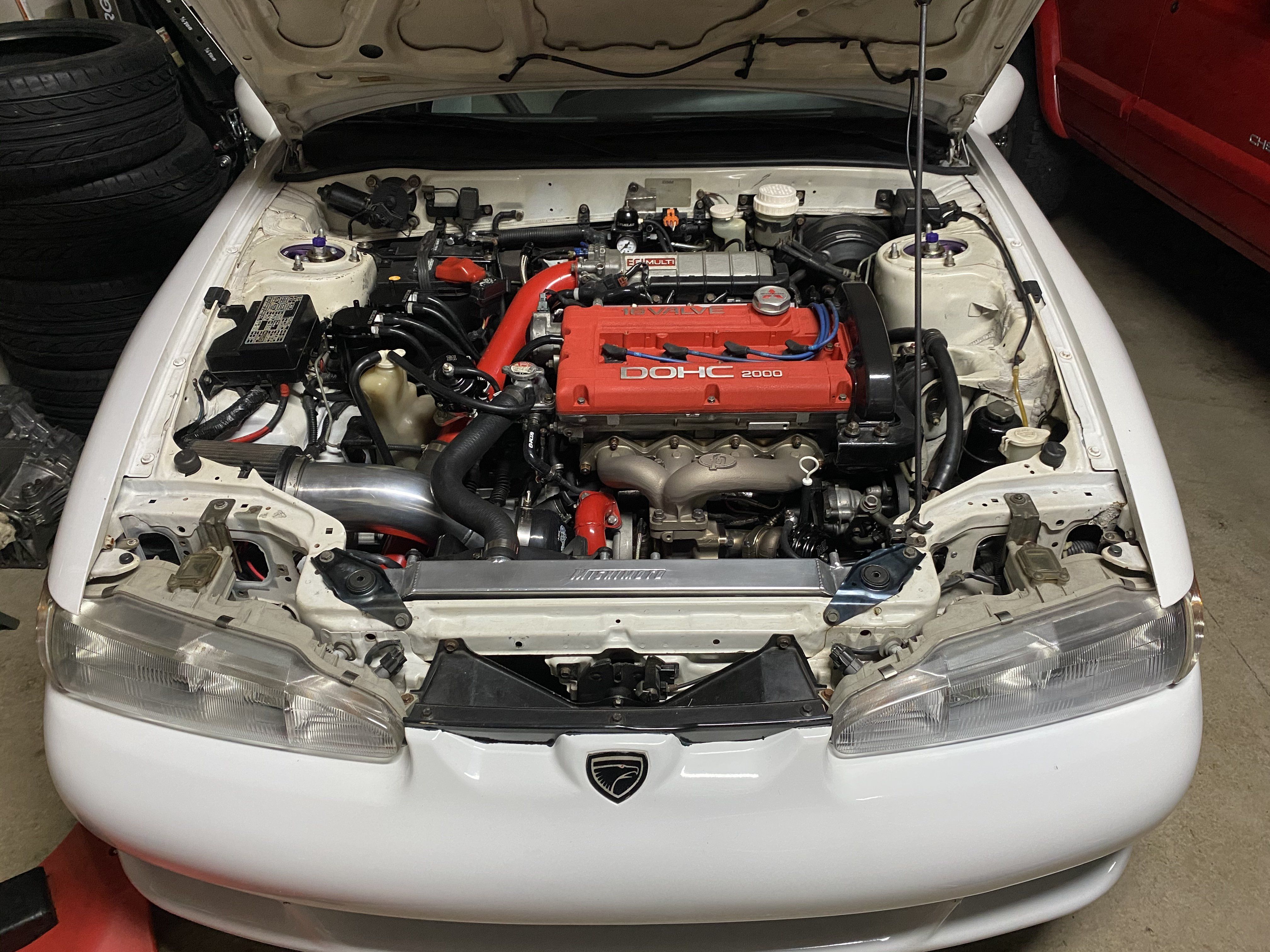

Took it for a lunch hit and blew off source line to boost controller. Slight coolant leak at the upper hose but she feels amazing. Predicting easy mid to low 11 with some timing. AFR's and wg solenoid needs fine tuned though.
Frustrating to say the least when ever I take it now, there's always something. Temp gauge quit working, have to change upper coolant hose back to gpro, and think I need a new battery....ughhh. Good news is she's a ripper. Still needs fine tuning

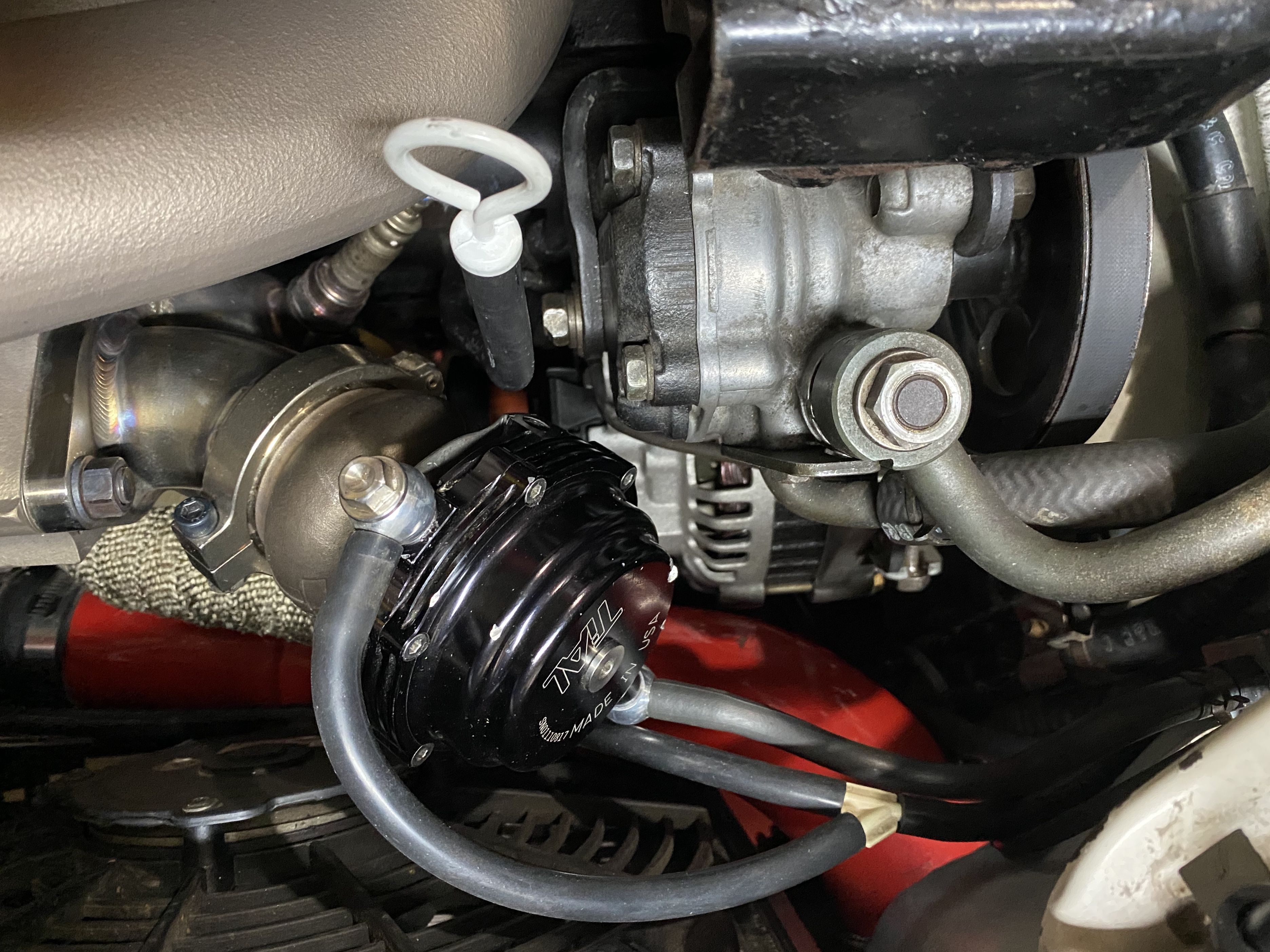

I've had a wastgate line come off the nipple because it didn't have a clamp and I was running a ton of boost. Just an fyi.
I ran 26psi for a little while on the same set up and it never came off. Zip tied all of them sob’s yesterday and it held. Increase boost/hp, find the weak link, fix...rinse and repeat.

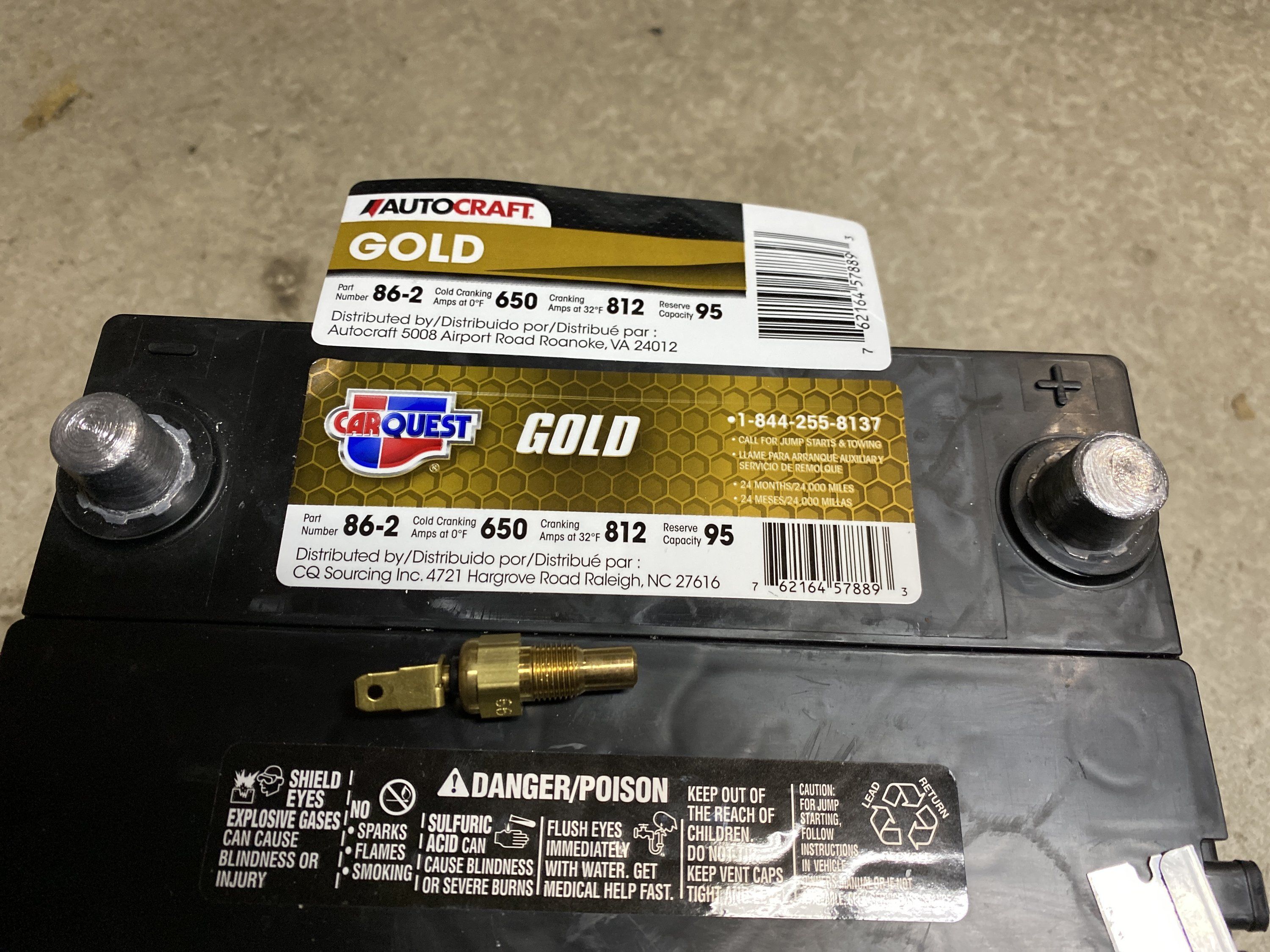

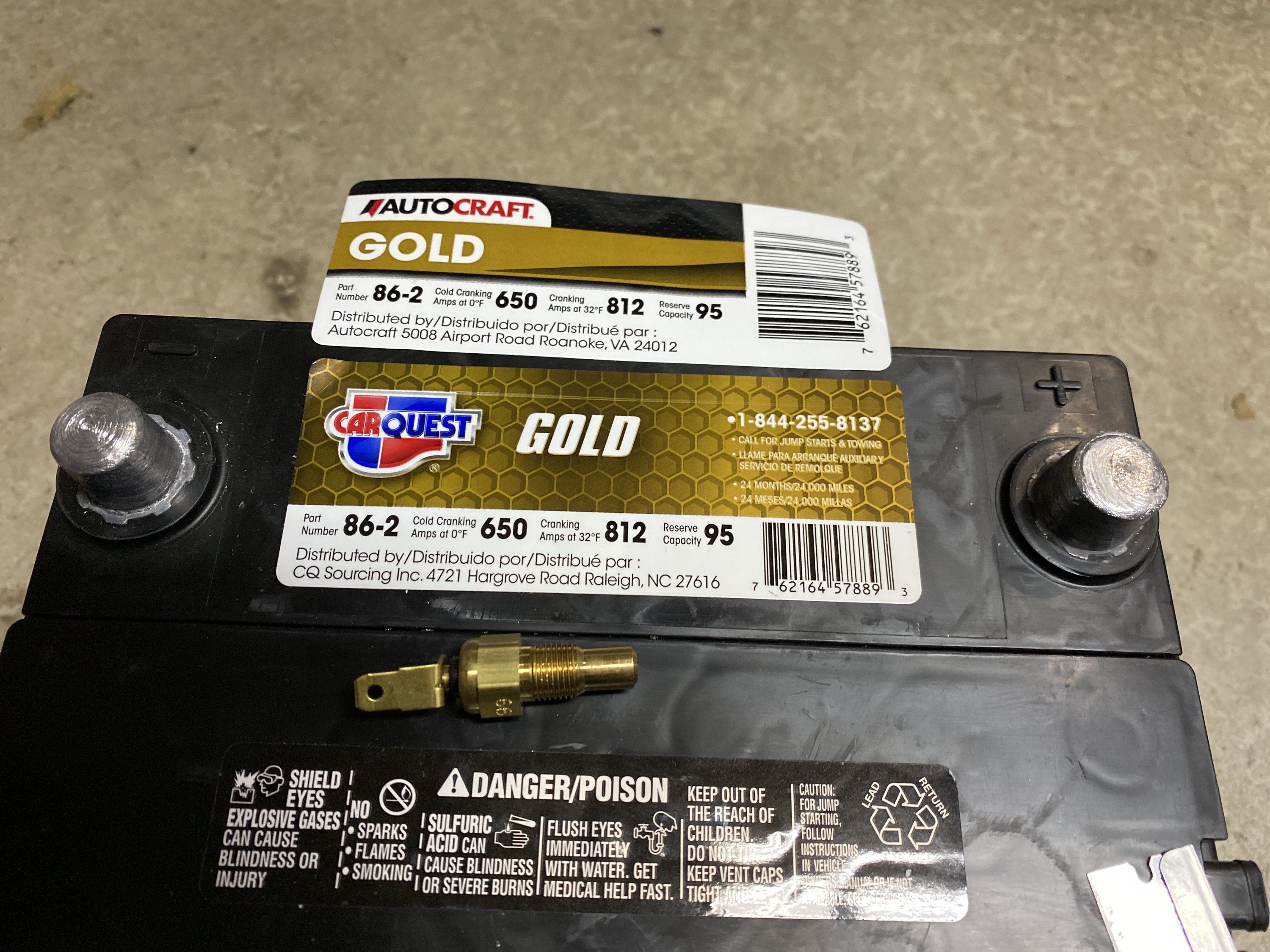

Learned something new today. They placed their sticker over the competitors. Is this fraud? Lol
Advance Auto Parts purchased CarQuest a few years back. Napa, car dealerships, and other parts stores all get their batteries from Interstate Batteries here in town. They do the labeling. So if they mess up, easier to just slap another sticker on top to fix it.
I see. I removed all the stickers. haha

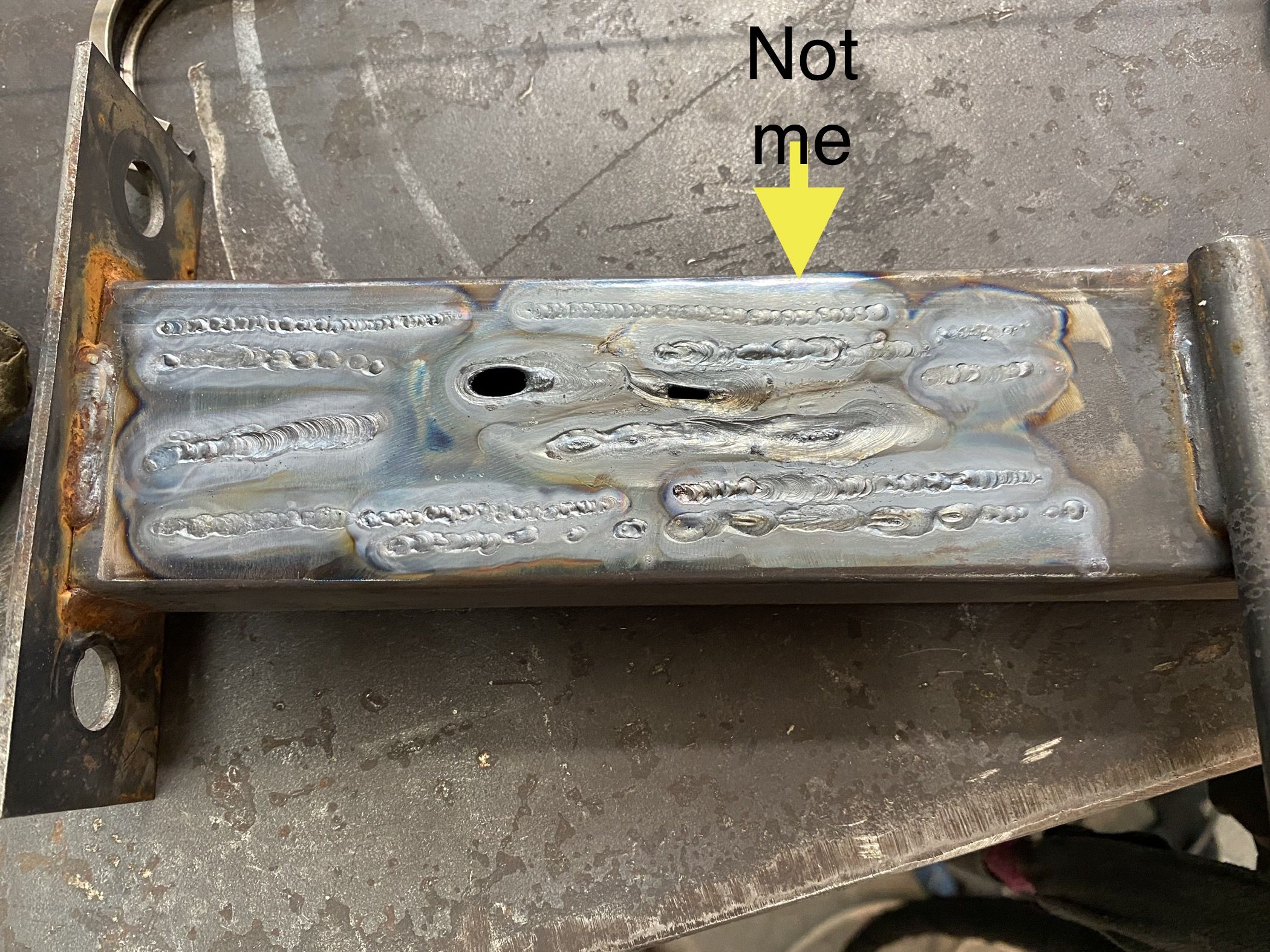

Don’t judge me LOL. First time with the welder making some practice passes. It’s something I’d like to get better at but not sure if I’d want to invest in a welder s considering garage space and cost.
To be a learner :hmm: , Not bad, I have practice and practice and practice and more practice and I barely make that kind of bead you just did:beatentodeath:,
Now with the off time I have had, I being watching YouTube so much and I have learned how things are, it explains and makes sense why I have doing it wrong, but we’ll it’s just practice and learn.
Keep practicing.
Keep practicing.
haha thanks man. Yeah the last couple were “decent”. I’ve been watching The Fabrication Series on YT and he really does a great job explaining. 100 on practice practice practice.
After waiting a week and a half for the new thermostat outlet pipe, finally I have no drips of coolant and system is completely sealed. Did some WOT and idle tuning yesterday. VE table needs a little more tweaking but the idle and fuel trims are perfect. I was seriously contemplating ditching these Bosch 2200 injectors but it's working out and cruise felt good as well. Turned WG duty down a touch but man did 34psi feel amazing.

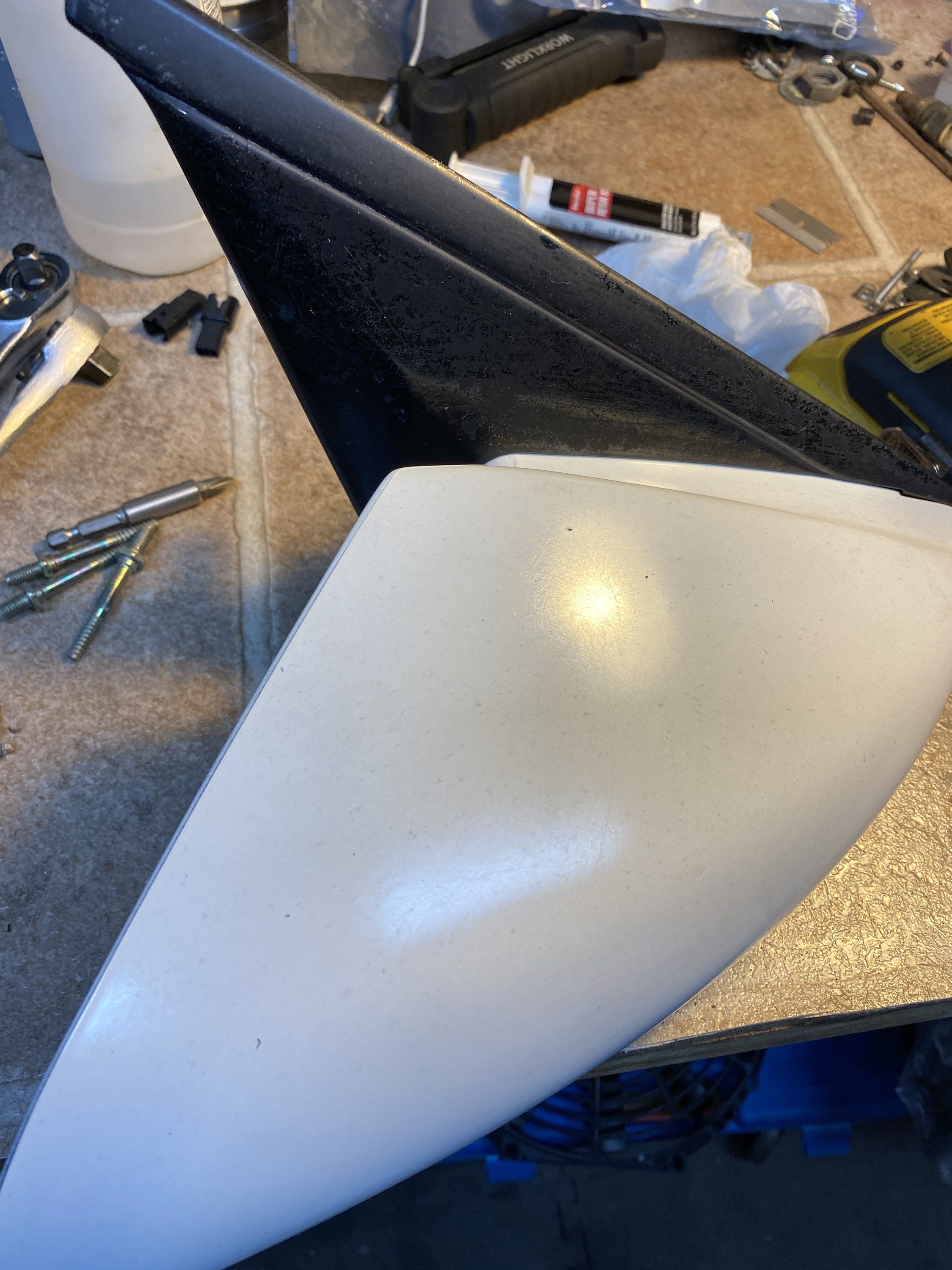

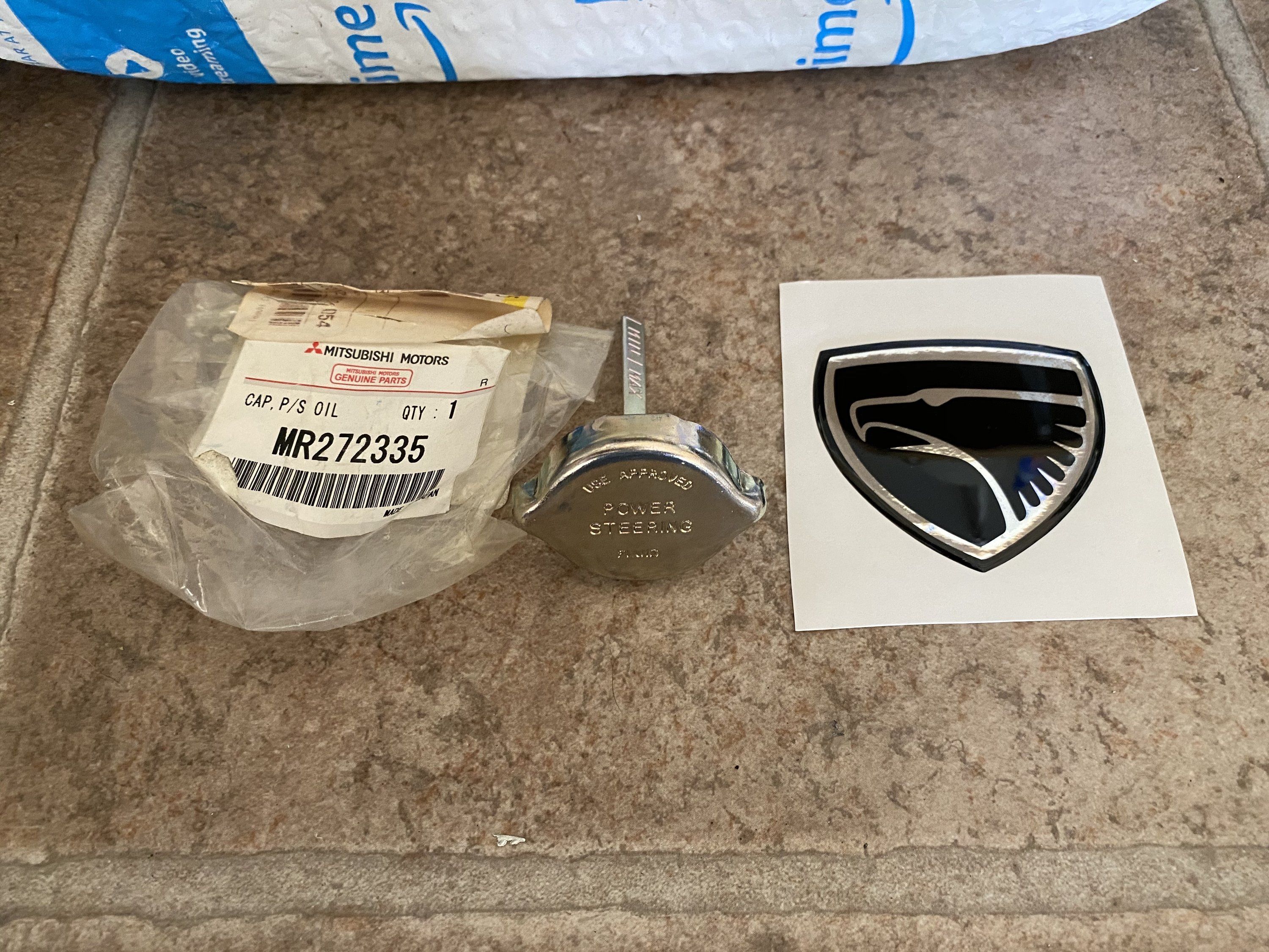

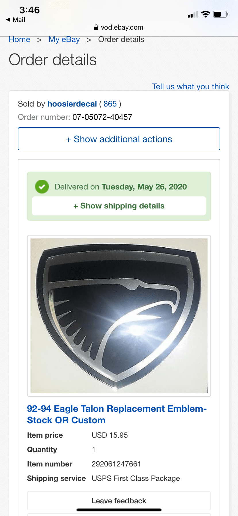

Got new power steering reservoir cap and a new emblem for the front. Can you see what’s wrong?
This is what’s advertised. Why are people so incompetent? Prove to myself again to stay away from eBay.
Holly cow, it has only half of the background black, it’s like if the black paint color is fading.
It’s being years that I haven’t shop on eBay,
I usually don't unless it's oem stuff...except this emblem. Emailed the guy and he's sending me the right one.
I was thinking you recieved a mirror image of what you ordered.
Cars looking good!
Thanks, Henry!! haha right. I’m glad I don’t have to run to the post office to send this back so not a big deal...BUT C’mon man.
