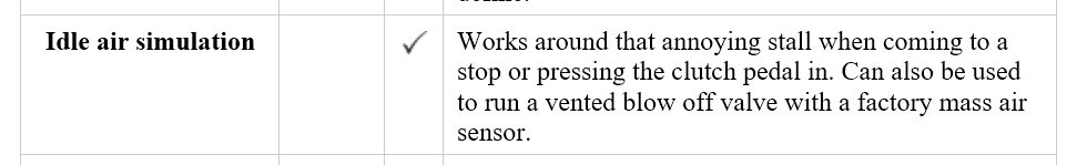

We aren't getting ISC Position in the logs. I think we determined before that this just isn't in V3Lite. But look for it in Edit, Captured Values.
And look at this, from the V3Lite to V3 comparison table:
Idle Air Simulation - shot from the V3 to V3Lite comparison table -  Works around that annoyin...PNG
This says that V3Lite doesn't have the "Idle air simulation" feature.
I've never used it and I don't know if it would help, but it's there in V3, just not in V3Lite.

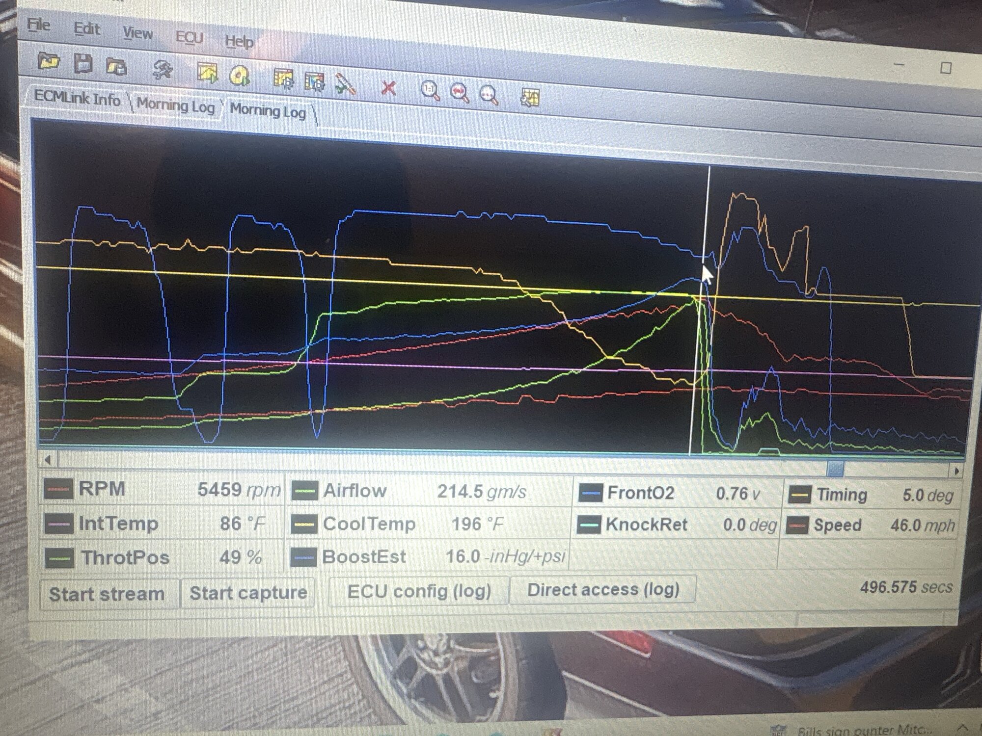

While looking at your Sept 28 log I noticed that you do have one pull that goes all the way up to 105% injector duty cycle! Sheesh missed that before. That's at 496.5 seconds.
So there, injectors are maxed out.
MAF is close to maxed out (around 2000 Hz) but we don't really know how far we can use the MAF yet because it seems to be flowing a little more than stock due to the 2 little hacks that it has. But stock the limit is around 2000 Hz.
Load Factor hit 2.0 at 5490 rpm. Did you happen to notice what the boost gauge went up to there?
And there was no knock on that pull. Yay. Coolant temp was 196 which helps, that's not high.
You were only on about 55% throttle.
So, it's rarin' to go, it's just running out of some things.
It's going to need better boost control at some point.
As it is, you can't push it any harder than you did on that pull, because it will start to go lean and probably then knock.

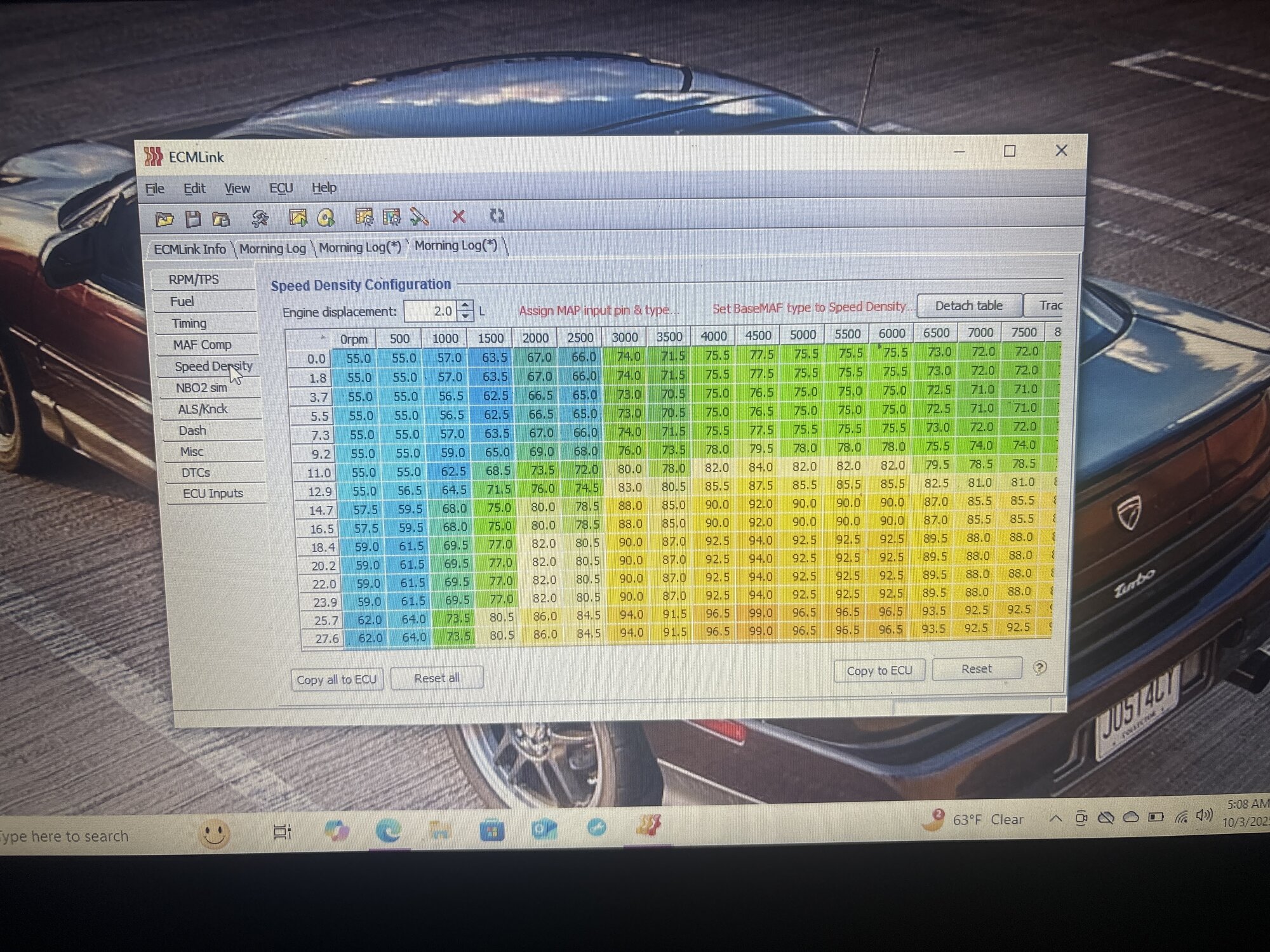

Okay so something like this to replace the MAF and order the Walbro 190 and throw all them in? Also I have been at it for over a hour, HOW THE HELL DO I UPGRADE TO V3 LOL! I Noticed and I was on the wrong download and just updated it to the 3.26.35 latest firmware if that helps anything. And yes like I said I want the car to be fun but reliable also, I’m not looking for a race car more of a daily with enough power to have fun without hurting anything. And would you recommend me staying MAF for now or just switching also?
I’m assuming this is what we will be using when time comes for the speed density?
Yes. Although we'd take a look at Justin Dubois table which goes to 100 and maybe use his instead of the one in your pic. If you have 2 logs sitting side by side on your screen, both open to that Speed Density page, it's easy to copy and paste the entire table from one log to the other and save it.
Well, I wouldn't get that ebay sensor kit. I mean it's got the right type of sensors in it but they are mystery sensors as far as the brand and so-forth. I've been helping a guy in PMs who was trying to use an ebay sensor for fuel pressure. Burned up a lot of time trying to get it to work. It never did. He finally bought a regular known sensor. None of this mystery stuff. When it comes to the MAP sensor, even one of the "known" ones has been getting a bad rep lately. So that's a whole subject. I think don't buy those speed density sensors yet until you've delved into the sensor issues a little bit first.
The Omni-Power 4-bar is the one that has recently been questionable, which is too bad since it was a mainstay item for years and it only costs about $100 and it is the one in the SD kit offered by ECMtuning.
The AEM 3.5 bar stainless MAP sensor (AEM part # 30-2130-50) seems to be the most reliable one for anyone who isn't going to go over about 34 psi of boost. They cost $168 to $189 depending on where you buy it from. I actually bought mine from the AEM Store on Amazon where it is $168 at the moment. You can also buy them straight from AEM where they are $189 at the moment.
Mounting the AEM is a little more work because it's not just some flat thing that you can attach with screws. It needs a bracket with a hole that you put the AEM nose through basically. I show how I mounted mine with a photo in my build thread on page 2. That photo doesn't show it very well. On page 3 I have pics of the oil pressure sensor which is mounted the same way, same type of sensor. My MAP on page 2 was a 5-bar AEM, but I've replaced that with the 3.5 bar AEM.
