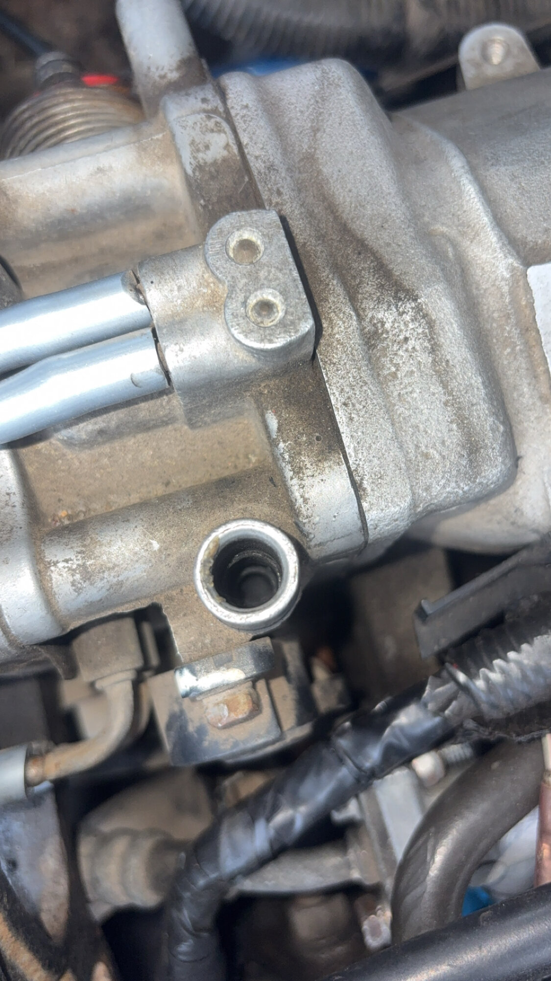

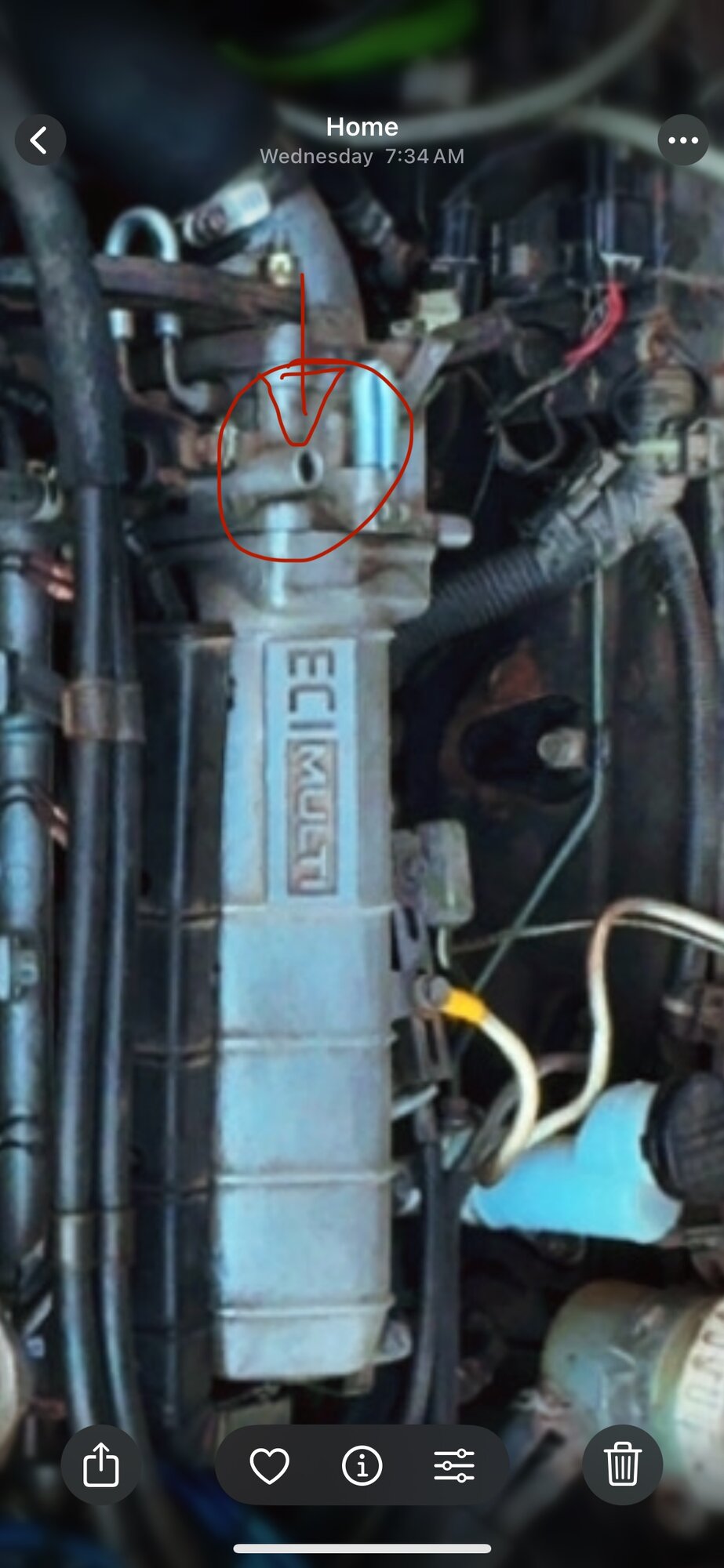

Question what’s ideal idle for the car? Currently it’s sitting at 2k and I personally think that’s a little too high. Is there a way to change it without doing a bunch of crazy work LOL?
Yeah 2000 is too high.
I don't know why it's idling high now! The last log we got was from June 15. The idle seemed ok there, it was around 1000 rpm.
With stock cams and stock injectors like this, an idle of 800 or 900 is about right. 1000 is ok. Nick has the Target Idle in ECMlink set to 850. So if everything else is working ok it should be idling around 850.
The easiest thing to do is check the BISS screw. It's just a screw with a little air valve on the other end of it. Turning it clockwise should slow the idle down, turning it CC should speed idle up. So that's the easiest thing to try. It will act funny because of the ISC (that's another air valve that is run automatically with a little stepper motor). The ISC will try to make it run at the Target Idle. I don't think we ever delved into the ISC (idle speed control) yet on this car. We got as far as figuring out that V3 Lite won't log ISC Position. Which is too bad. Since it's a stepper motor, that position can be given by a number from 0 to, well, 120 is the highest number I've ever seen, so I guess that is the max. Looking at a log of ISCPosition is pretty much the first thing you do when trying to figure out if there is something wrong with it.

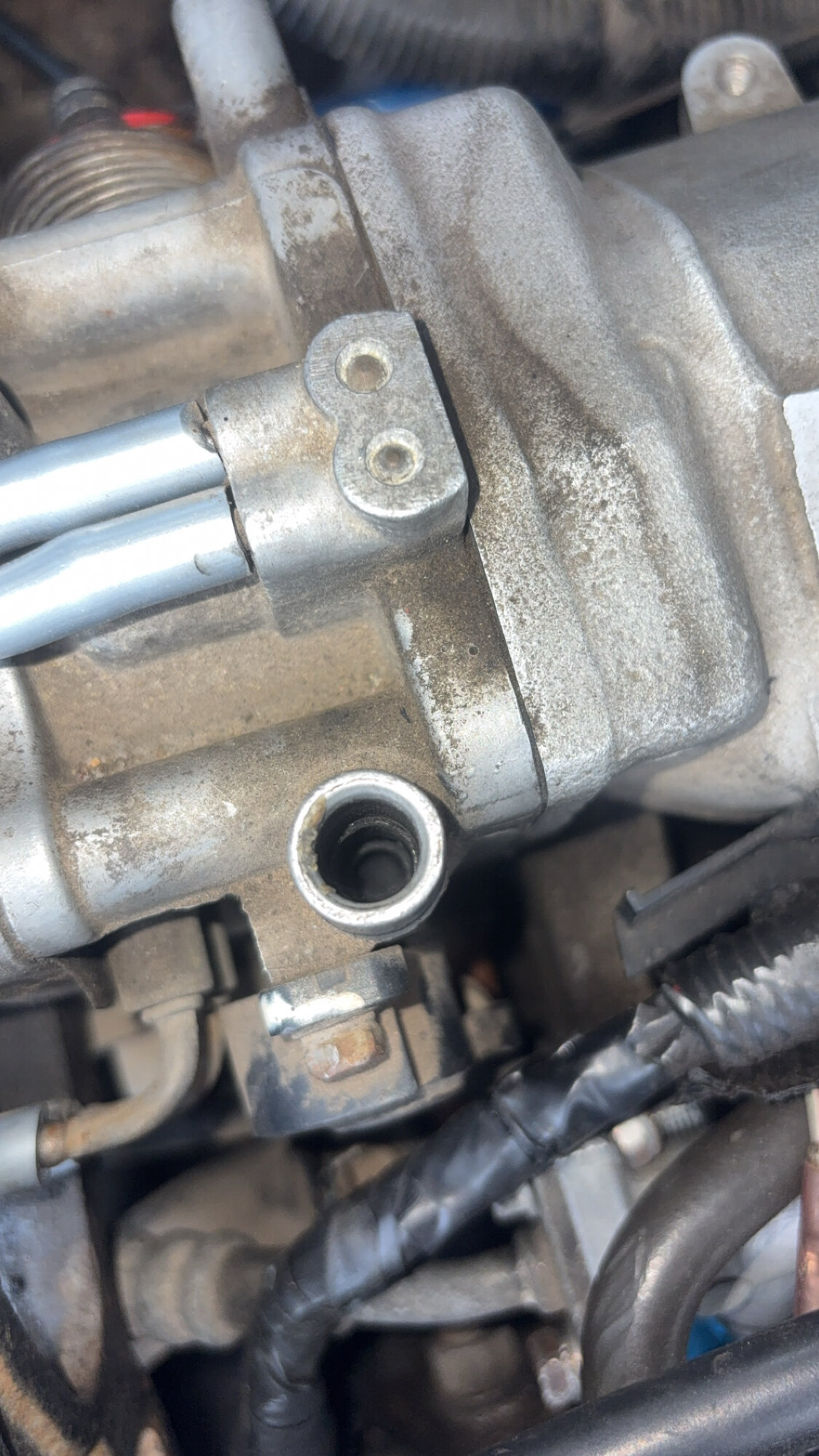

Also is there supposed to be a cap or anything over this? I noticed when it’s open like in the pictures the car kinda runs what seems rough but when you cap it off the car runs perfectly fine. Just want to make sure before I make any impulse decisions LOL.
Yes by golly there is supposed to be a cap there. I never had a cap on my car, but, take a look at this from the DSM vfaq:
If covering it makes a difference, then I think that means air is leaking around the screw and messing up AFR and idle speed probably.
In that paragraph next to the lower picture, it gives the size of the o-ring in there. That o-ring is probably shot and that would be the air leak.
So you could buy an o-ring the size he says there, take the screw out, and put it back in with the new o-ring.
Be sure to smear the new o-ring with either motor oil or some kind of o-ring lube like Molykote 111 compound or Permatex 81101 before you put it on the screw.
The size he says is a little suspicious but it probably works or he wouldn't have stated it. I would suspect it is actually a metric o-ring, like every other o-ring I've found in my car.
Cap isn't what holds air. If idle changes if you cap it the oring on the BISS screw is bad. Cap is cosmetic only.

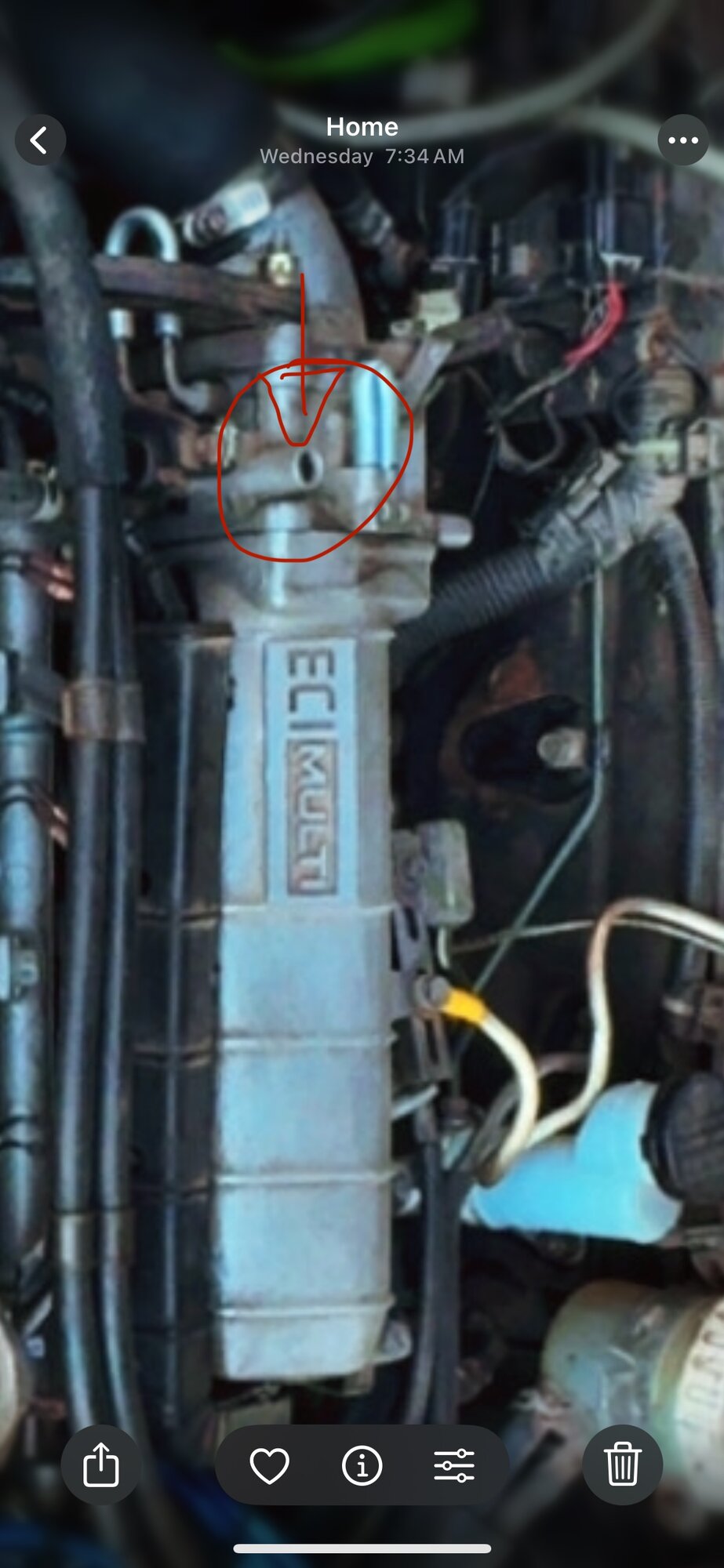

Update Guys! So that BISS Screw is just completely missing???? So looks like I will absolutely be ordering that new set you posted for 28$ I guess we found the reason for the high idle LOL. But it’s making me wonder were the screw even went!???
Awesome! Love it when there is an easy fix.
Should clean out that hole a bit. The threads, the valve area, and the o-ring will all be better if they are going into something fairly clean.

Well....the biss is under boost too. If its loose it can get blown out.
Just an update guys, got the BISS screw in and it’s idling way better about 1k, Wednesday I’ll be getting a new Trans and new struts for the car! Also I have downloaded and finally figured out how to use ECMLink so tomorrow when I go to work I will be recording a log for you Gary since it been sometime since you even seen a log on this LOL I should say also it is being driven everyday.

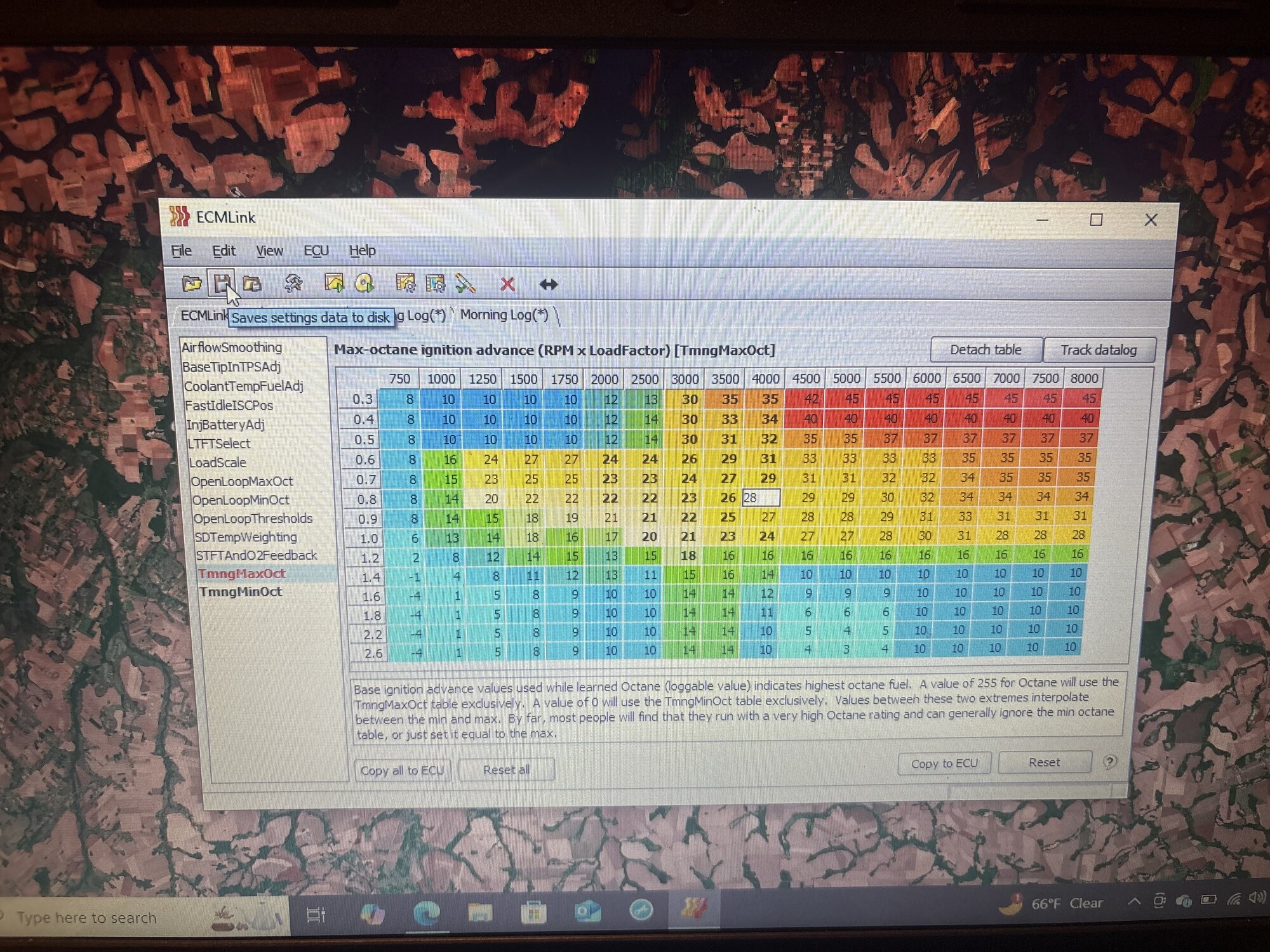

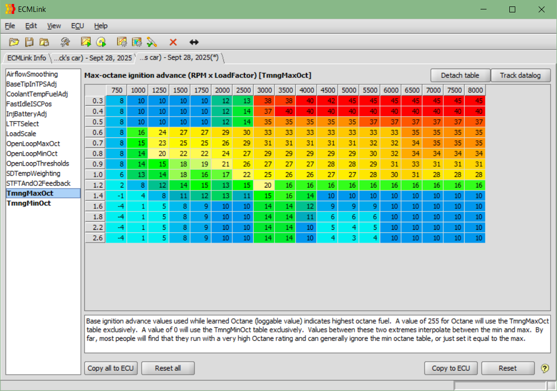

And also how do I adjust the Ignition Timing Table? Sorry once again new to ECMLink and have been trying to educate myself on it. I really don’t want to mess anything up
Right! Just take a look at doing this first, dry-run, by looking at your latest log on your laptop or a desktop if you have one. That way you are not connected to your car yet so you can fiddle around with stuff and it won't change anything. You can even pick "Copy to ECU" and it will just give you an error message because it's not connected to your car.
So for the dry-run, open up the log, and at the top pick View, ECU direct access (from log). That will give you another tab with a column of choices on the left. Pick "TmngMaxOct" from that column.
Then you'll see it looking like this:
And that is your current timing table.
Then just pick a cell and key a different number into it.
Do that to a few cells.
When you key in a number you can either hit the enter key or just pick another cell and it will enter the one you changed.
Then when you are "done" you pick the button on the lower right that says "Copy to ECU" and since this is a dry run not connected to the car, it will just give you an error message.
You can pick the red X at the top of the page and it will close the tab you are on. Then when you open it back up again you'll see it with the same old numbers that it had before, because you aren't changing anything when it's not connected to the car.
So you can play around with stuff in the software like that.

The way I know is like this:
When you want to do it for real:
Put the laptop in the car.
Plug the cable into it and start the laptop.
Start the ECMlink software.
Turn the key to ON but don't start the engine. You do this whole thing with engine not running.
Pick Connect.
Then pick ECU, ECU direct access (Live).
Continue.
Pick TmngMaxOct from the left column.
Make your changes in the timing table.
Pick "Save to ECU".
Continue.
Now it takes about 10 seconds and it shows you a status bar.
Then a message says "Reprogramming completed successfully!"
And that's it, you can red X that tab off.
Then to check it you should make a short log the regular way by clicking the disk icon, just 10 seconds or so with the car still not running.
When you close that log and it saves to disk, you can "Disconnect" if you want to and turn the ignition off.
Then open the log you just made and look at the timing table in it to make sure your new numbers are really in there for real. fr!
