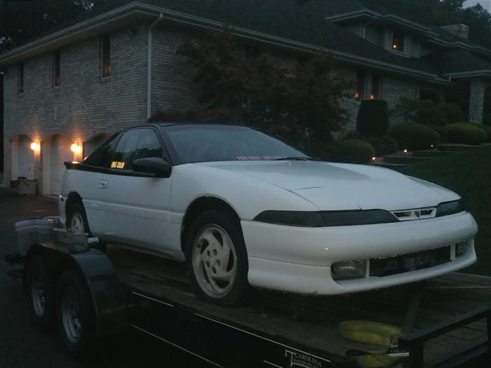

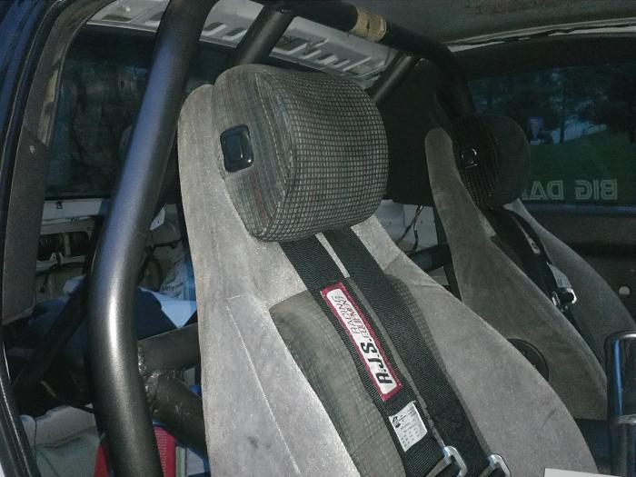

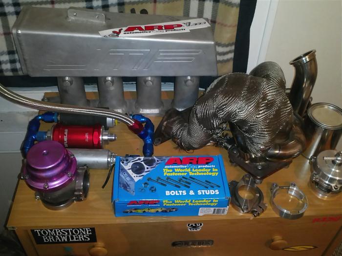

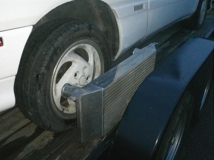

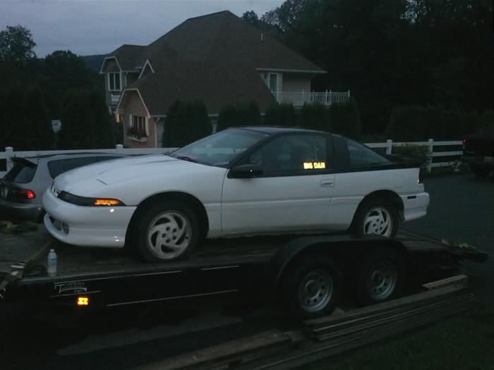

Now for the pictures :)
Will post more pictures of the stuff i have so far, but my phone just died, so ill do it later!

Some of the stuff i have so far. AEM v1, the 35r, and so on came with the car, and is currently sitting in the car. Like i said, plenty more pictures to come!

Pretty big houses for poor people
That's at my friends who i got it from. And even if it was mine LOL, just because my parents would have money doesn't mean i get any of it. I have to work for everything i have, it blows. But my parents say it builds character haha. So i guess we'll see.

I totally wanted to buy this shell. I ended up getting another panda and putting a 10 point in it, but yours is definitly one of the cleanest around. A lot of the parts he had for sale along with the shell, looks like were bought by yourself as well. It's funny cause our 1G's are going to be pretty much identical. Both 1G panda's, both tinted lights, both in MD, both 35R setup's, both badass.. I'm shooting for low.......low....10's with this setup. How far are you from Balitmore?
