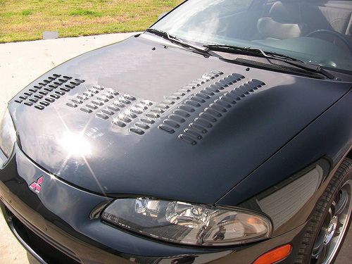

I watch those rod & custom shows on Velocity and I saw a guy who specialized in putting louvers like that in metal, definitely original. Here's another 2g with a louvered hood, how do you wash, wax, or buff the hood with those louvers Nic?

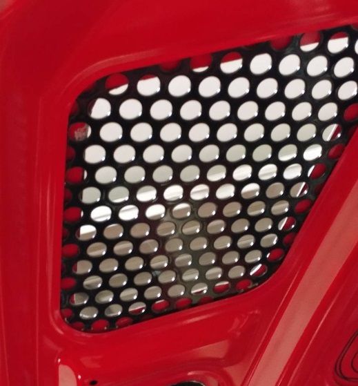

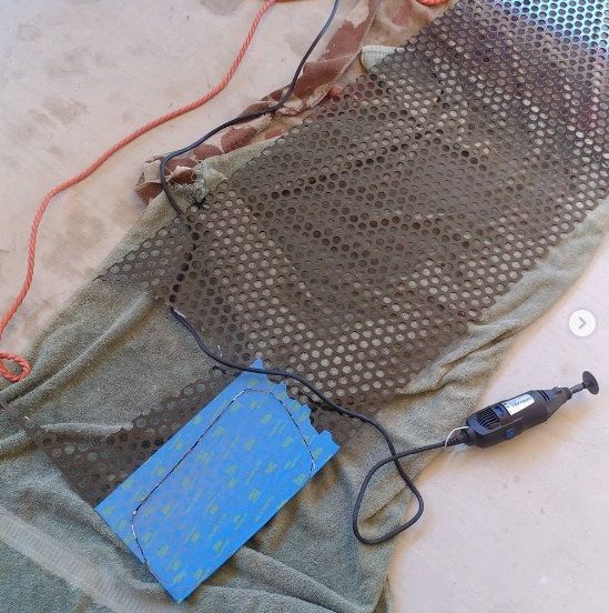

Someone I follow on IG did something to vent their hood that I had never seen before and it came out pretty clean, using the skeleton of the hood underneath to hold the mesh. Simple idea but easy enough to make things look symmetrical without a bunch of hardware to hold the mesh in place.

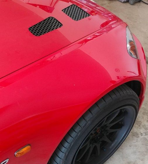

Posted as thumbnails so this S2K doesn't take over your build thread. Something to consider doing to a DSM hood though?

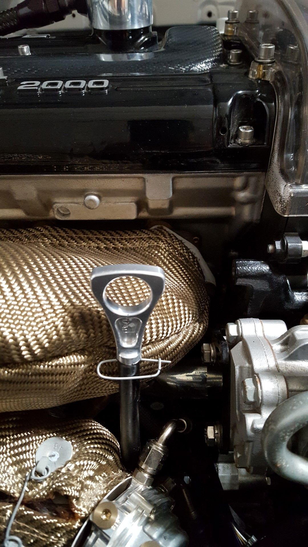

I had PTFE lines, that is what is pictured. I was thinking along the same lines as you for all metal lines - I just haven't found the right part yet.
You consider putting a heat blanket on the entire length of the your SS lines going to the EWG? Something like the DEI Heat Sheath Gold to put over the line that looks like it's touching the exhaust mani blanket?
All four lines are wrapped in Techflex Insultherm rated to 1200F continuous exposure. I'm almost positive they're melting from the inside out.

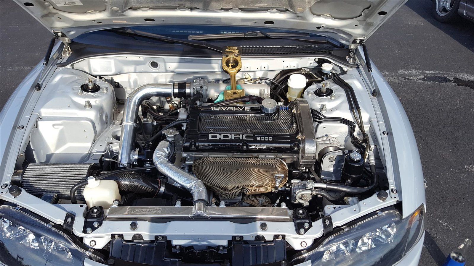

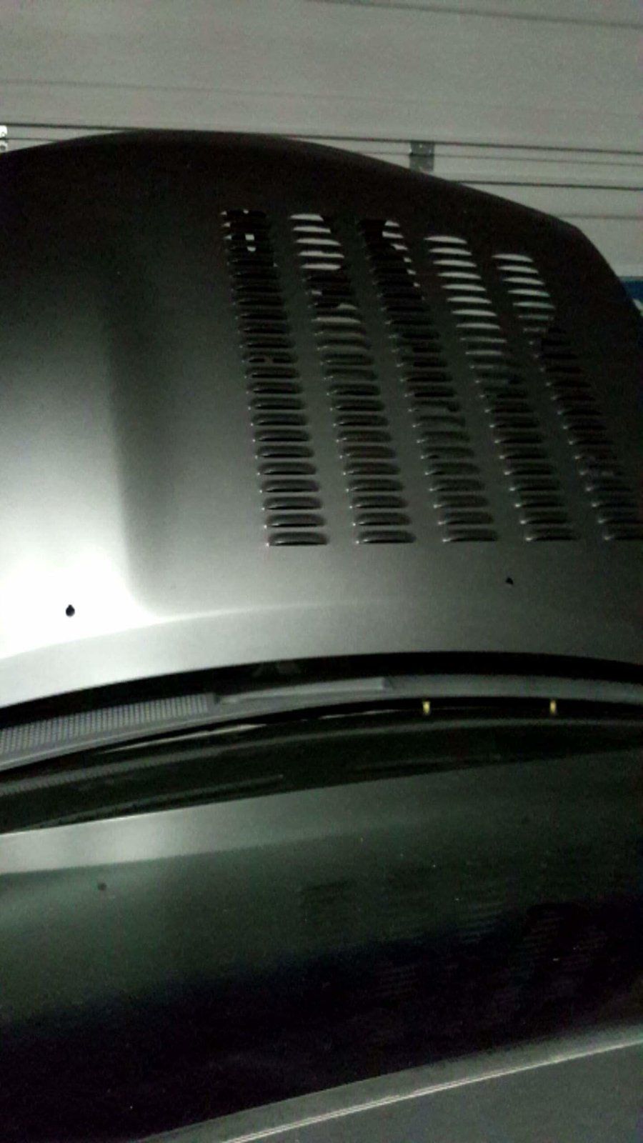

Just wanted to give you some motivation on the hood louvers. I have never seen another hood like mine and also never had any heating issues with it. I run a pretty big DVDT FMIC, A/C condenser and aluminum radiator. I will say that the cost to have it done is pricey. I've asked a few companies to replicate it and been quoted a nice price tag.View attachment 340181 View attachment 340182
I've seen that posted here before. Definitely unique and well executed! I'm trying to find a spare stock hood so I could just put on a Carbontrix vent I have, but the eventual plan is to get a Carbonetics AB hood.
Corey, the washing part is a pain; as expected. I have a thick mat I lay over the engine so water doesn't pool on the VC or sit on the mani. The waxing is a bit different. They angle of the louvers aren't so extreme of an angle you cant get the pad in there, but you do have to do it backwards if that makes sense (as if your waxing the hood while sitting on the windshield LOL).
Eric, ya I bought the car from a guy that used to be on here back in 2005-ish. The car in my avatar was the original way that I had bought it and has definitely changed since then; just haven't taken a better pick. I called Carbonetics to see if they could do a one off hood for me...and they looked at my hood and said "nope." Lol. Sad day. I can only imagine the hours needed to do each louver.
It does set the car apart though. That pic Corey posted was the first I've seen besides mine.

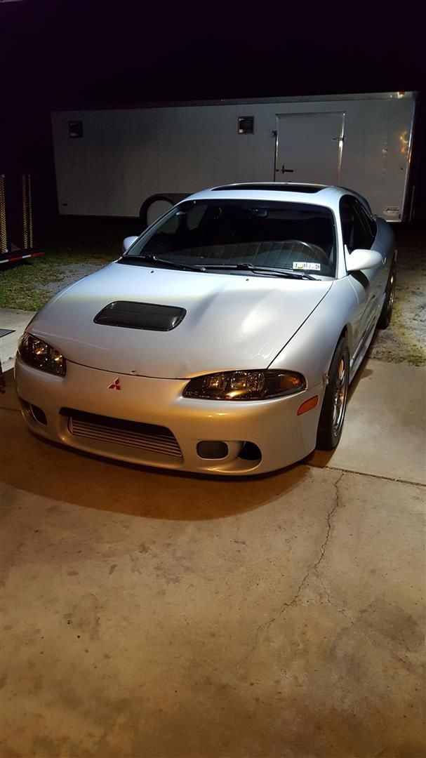

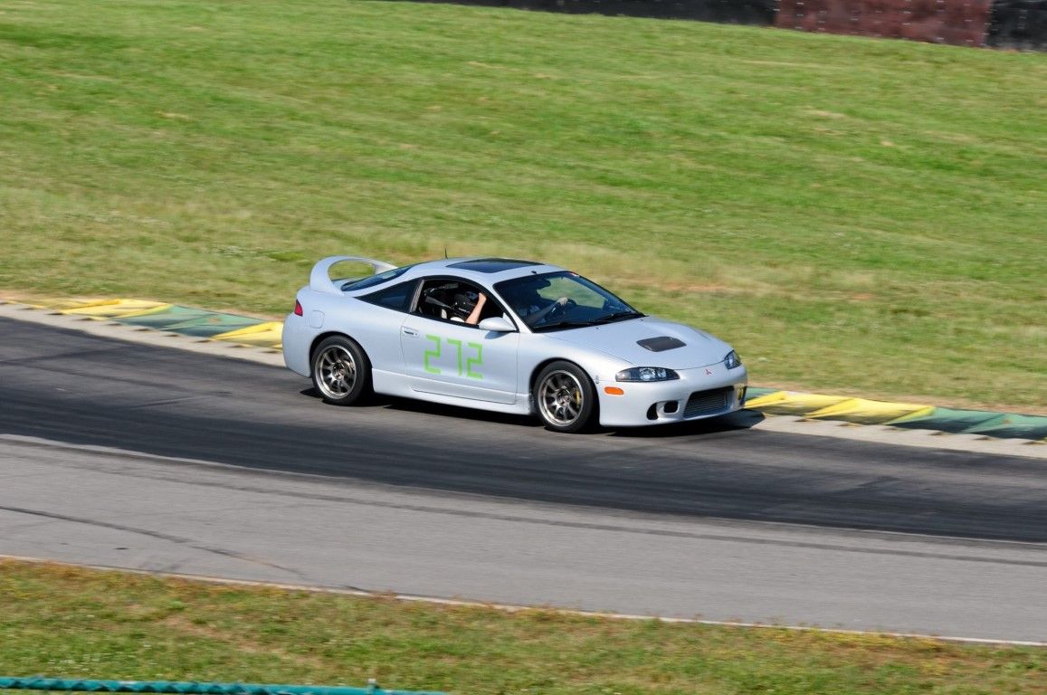

I picked up a beat-up spare hood for $20 and put in a carbon fiber 18" Carbontrix vent yesterday. I'm heading to Summit Point Main Circuit this weekend with some friends so we'll see if this helps.
Saturday at Summit Point went well! I went with my brother @snowborder714 and our two friends (also brothers) with an Evo and a Focus ST.
It was a cooler day out, but I had absolutely no issues with the car so I'm stoked about that. My coolant temps never got above 204* so I know the vented hood is helping. I'll inspect the wastegate diaphragm over the winter to see if water-cooling it helped. I felt that my instructor for the two morning sessions held me back quite a bit, but I had much more fun in the afternoon after I went solo. We had some issues with Brian's car that prevented him from running full afternoon sessions. The ST had a minor brake caliper issue in the first session so he couldn't drive two of the four sessions while he sourced a replacement. But we all had a ton of fun and the weather was perfect!
This ACR Viper was in the Novice class with both my friends and they were both passing him. He had the same instructor I did so we suspect he was being held back quite a bit as well...

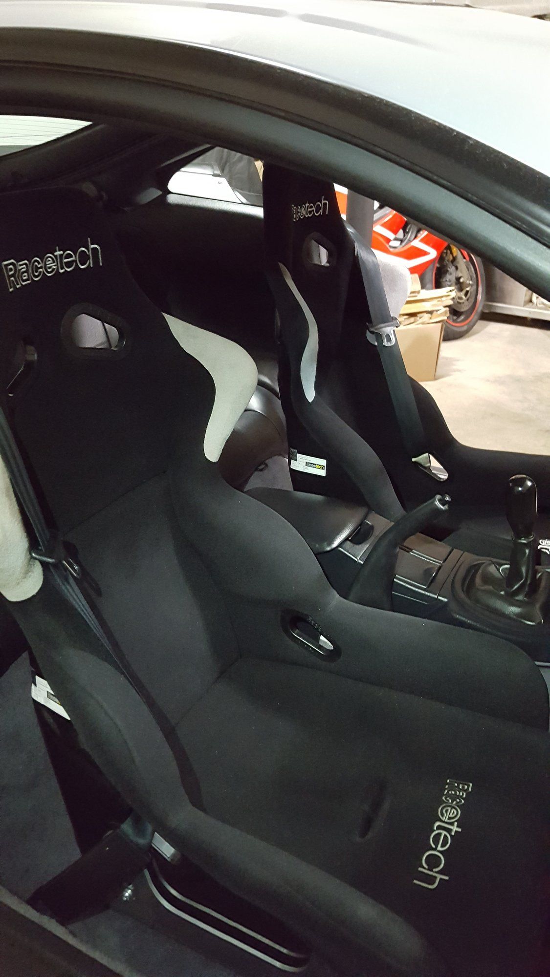

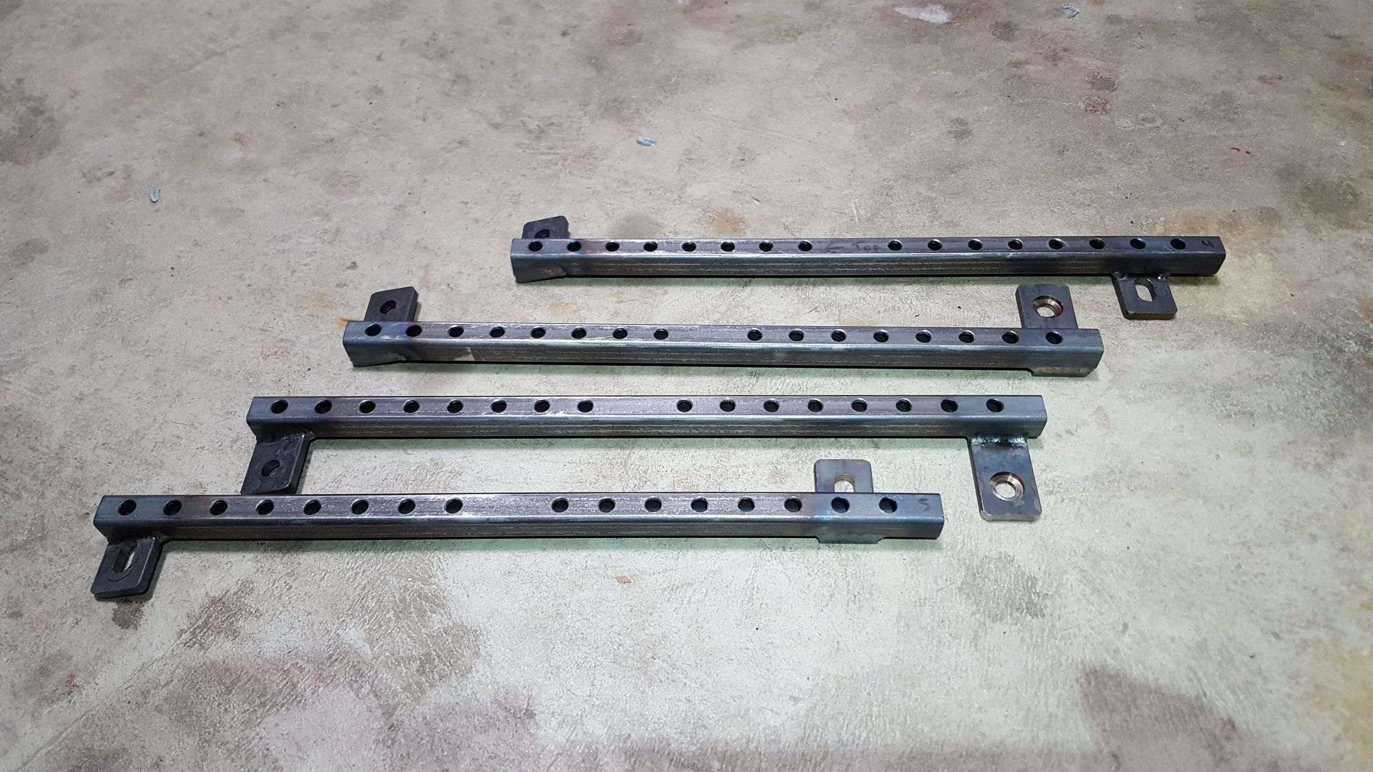

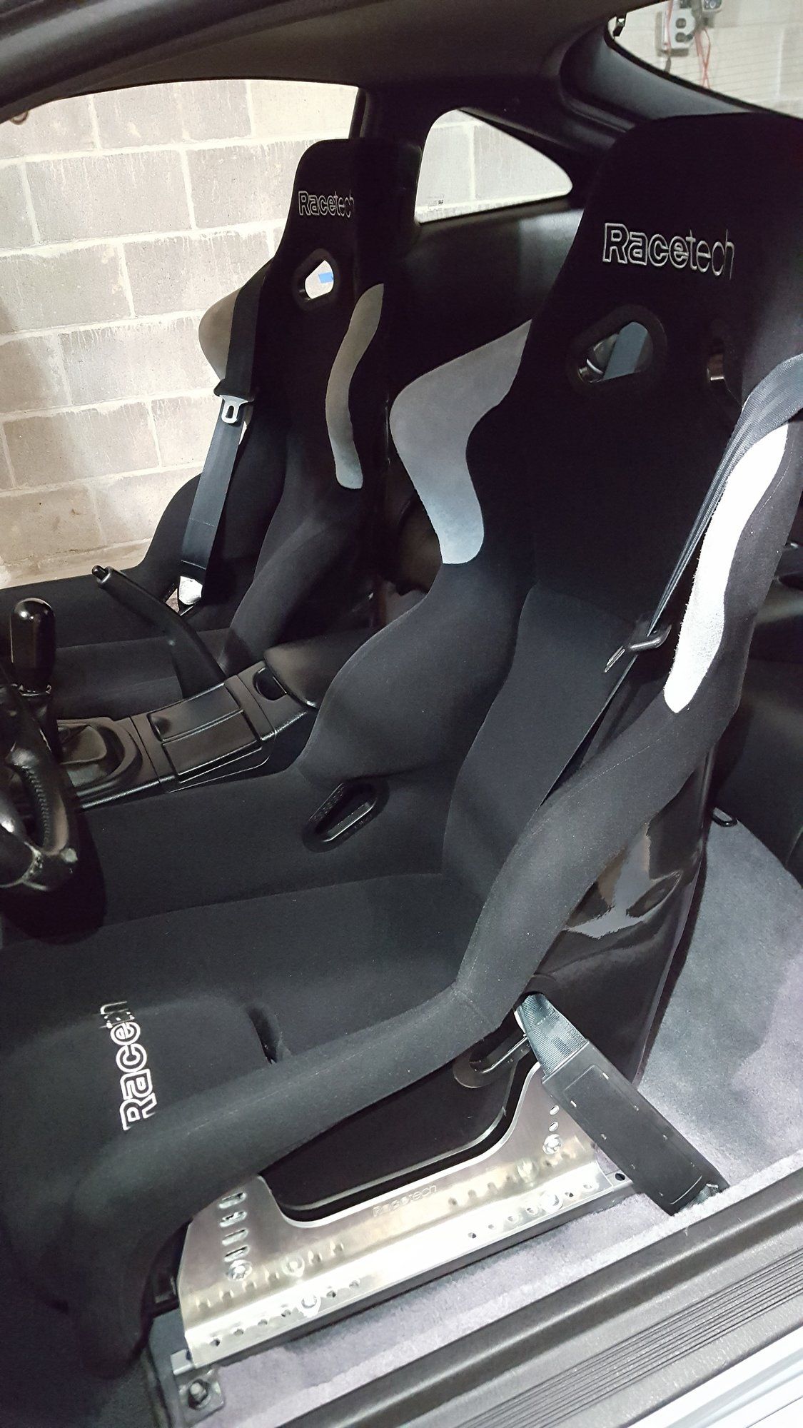

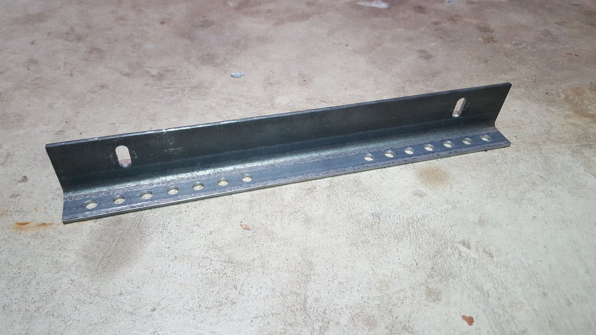

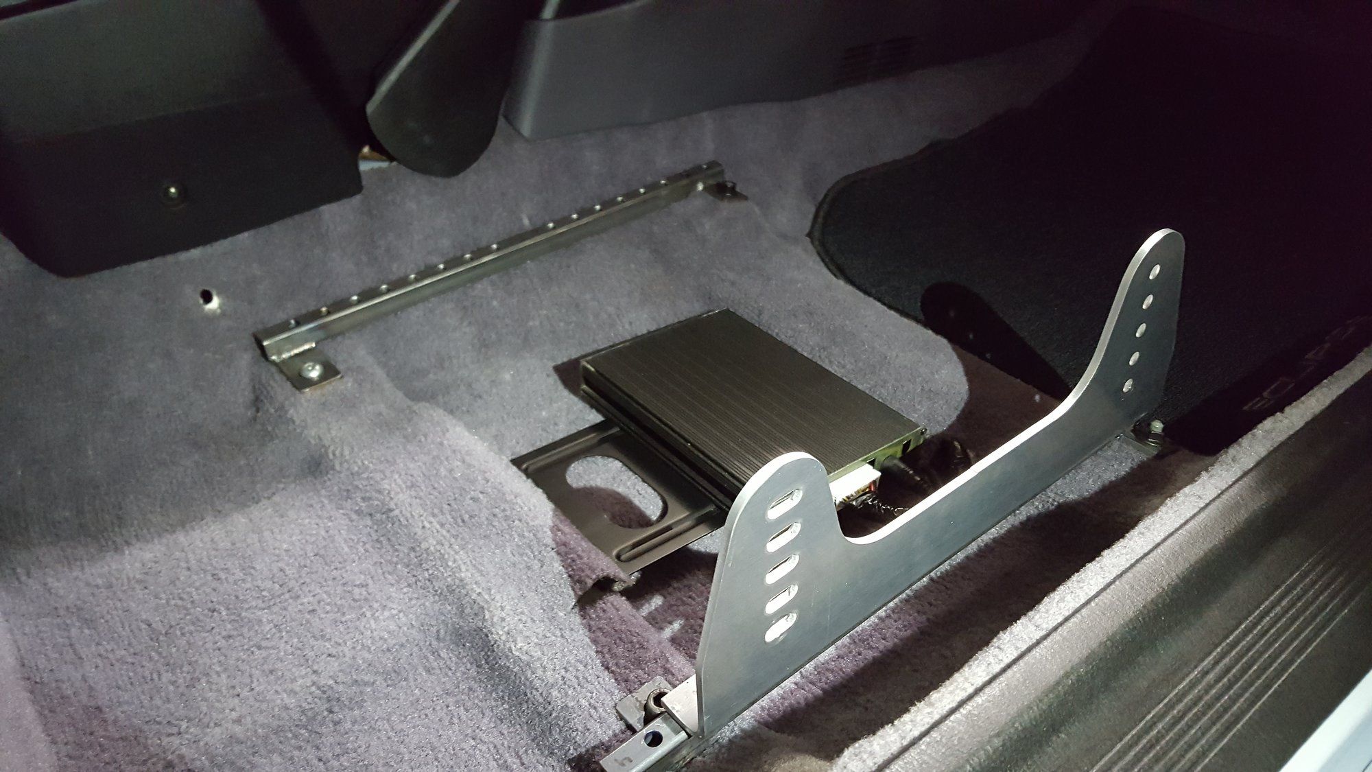

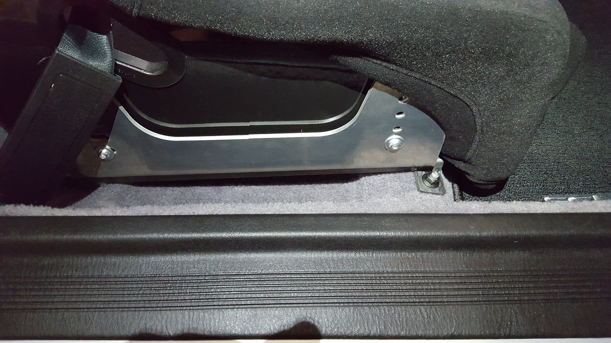

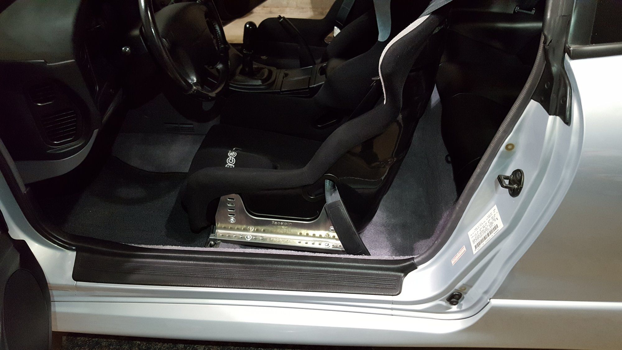

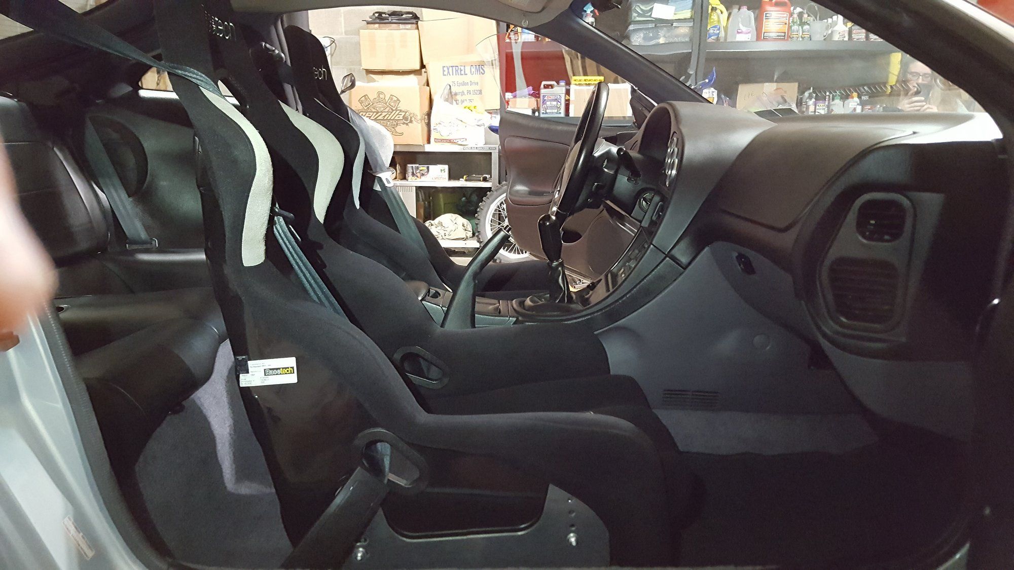

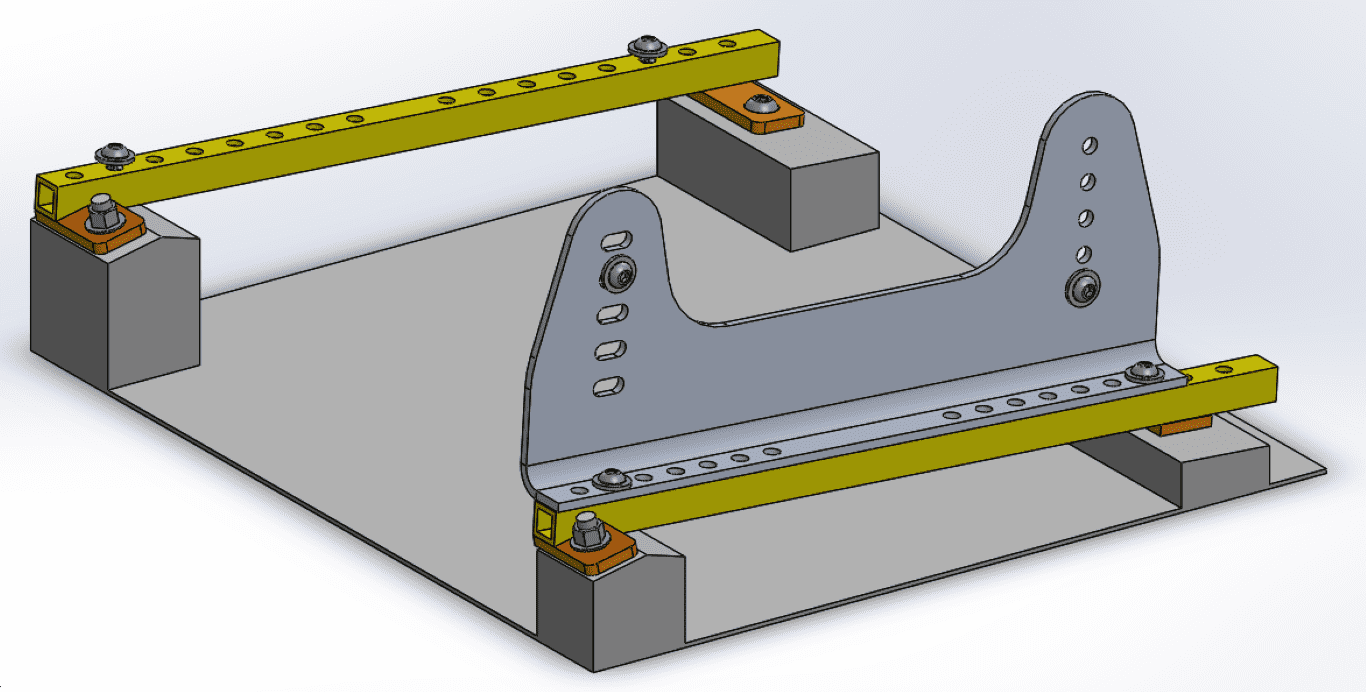

I purchased two Racetech seats: 4009 for the driver and 4009W (wide) for the passenger. I originally purchased Planted seat bases but they sat me way too high. I'm 5'10" but even with the stock seats and a sunroof my helmet would hit the headliner.

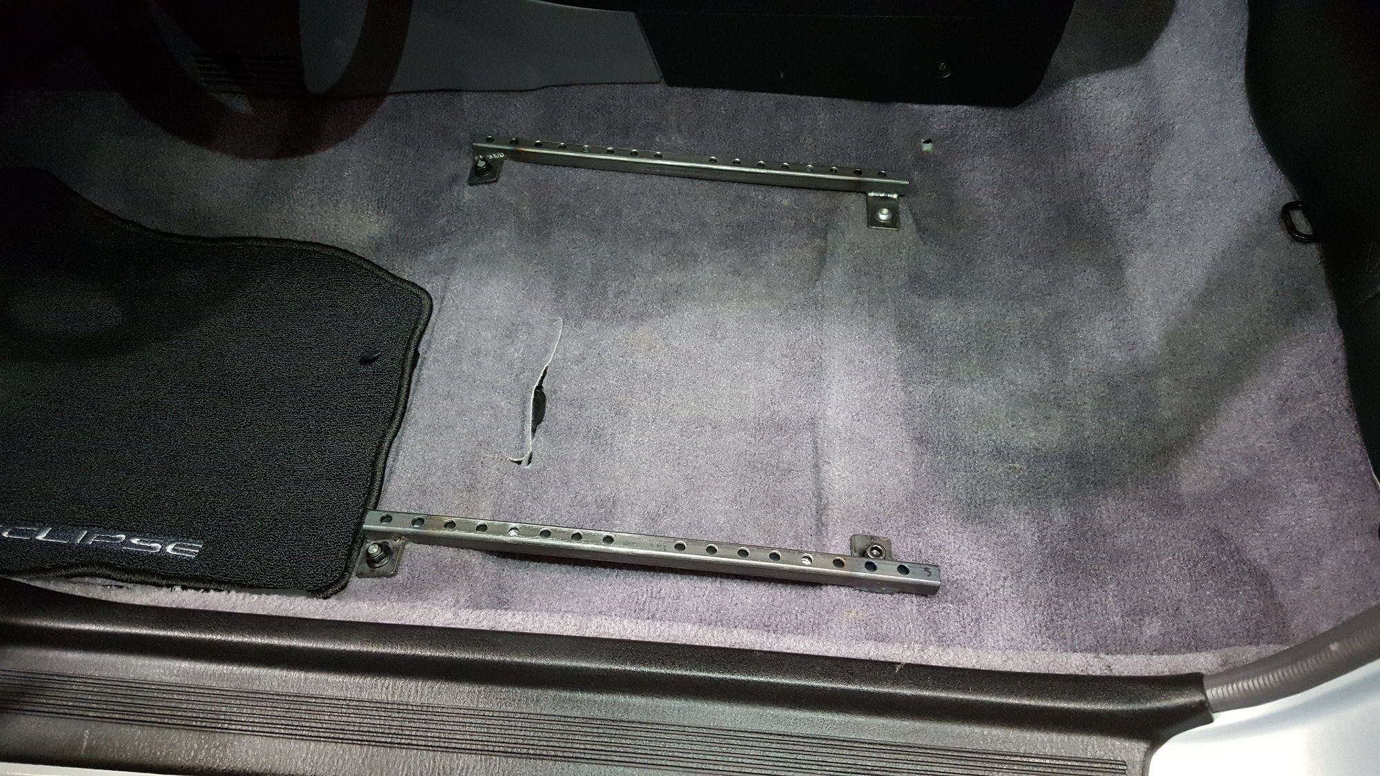

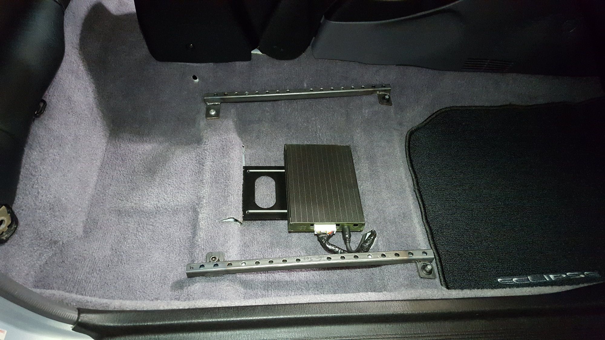

I tossed around a LOT of ideas how to mount these and this is what I ended up with. With the new seat mounts, I have about 0.5" or so of clearance, plus I have the option to purchase a different seat cushion to get up to 30mm lower if I need to. I did all of the work on these from modeling in SolidWorks to the machining and tack welding, then had a shop do the final welding.

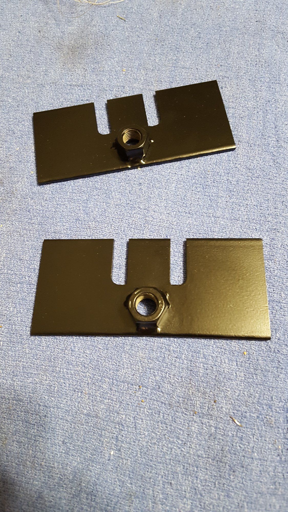

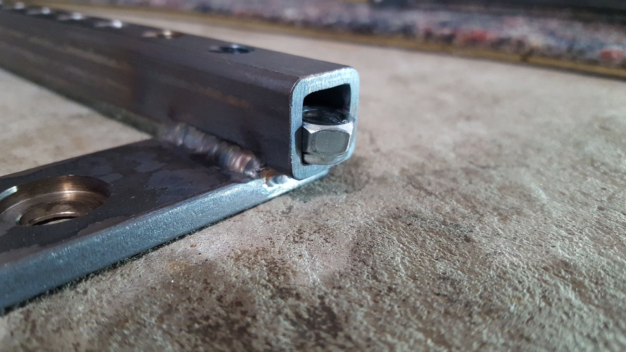

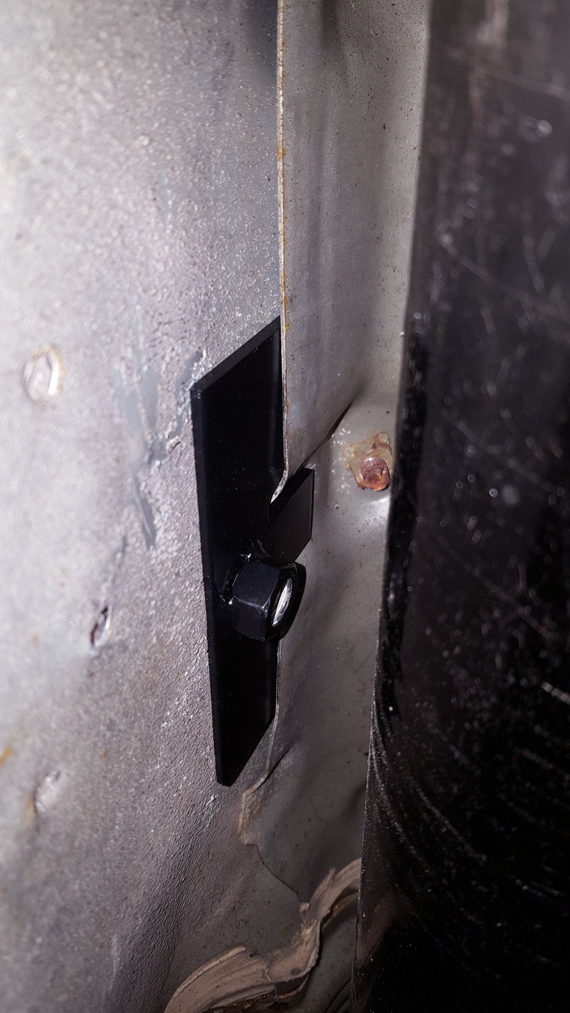

The base tubes are made from 3/4" x 11ga. square steel tube, and the brackets welded to them are 1/4" steel. The inner diameter of the tubes is perfect to fit an M8 nut inside. I used Racetech 5mm aluminum brackets on the outsides and made my own inner brackets from 1/8" thick angle steel. The holes in the tubes are spaced appropriately so I have 5mm resolution fore and aft. I originally intended to use Racetech brackets on both sides so I would have height adjustment as well, but the way things worked out I need to be all the way down to fit and couldn't use the Racetech bracket on the inside without modification. The seat literally sits on the inside fasteners to the chassis and I actually had to cut the front inner stud down to remove the non-threaded portion. The chassis was clearanced to allow the seats to sit as far inboard so the driver is centered to the steering wheel and so the passenger seat does not hit the door panel.

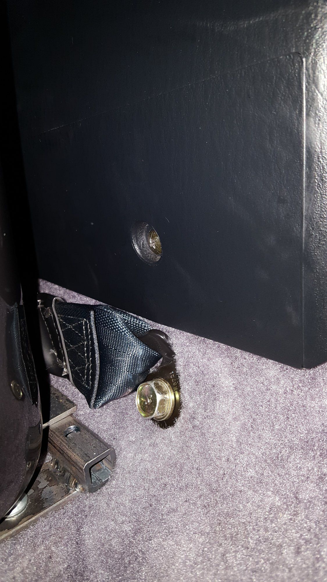

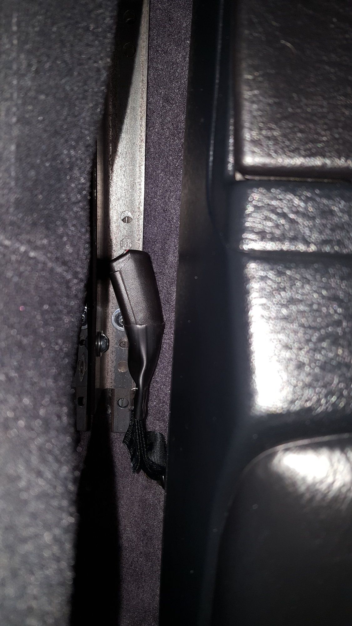

I decided to mount the seat belt clips to the tunnel since it was easier and safer than trying to mount them to the seat brackets. Plus, if I ever get harnesses I'll be ready for them. I made my own harness backing plates from 1/8" steel. These fit in between layers of sheet metal under the car to hold them in place. The rear seat belt clips were used. I still need to powdercoat everything but I'm looking forward to driving the car soon after a loooong winter.

Right, if you do go down this route be ready to hit your helmet. As your height vs mounting point you essentually could be around the height of the cage and hit.
I recently dropped my bracket down more and now i only just sit nice with cage and padding. But its still tight and touches, you being higher and shorter might make it tight also. Just food for thought incase, if notjust a 4 point main hoop back as you say helps, or a good strong harness bar if you dont want a cage

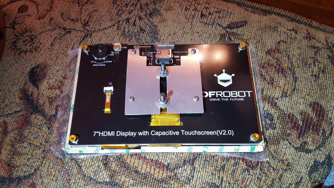

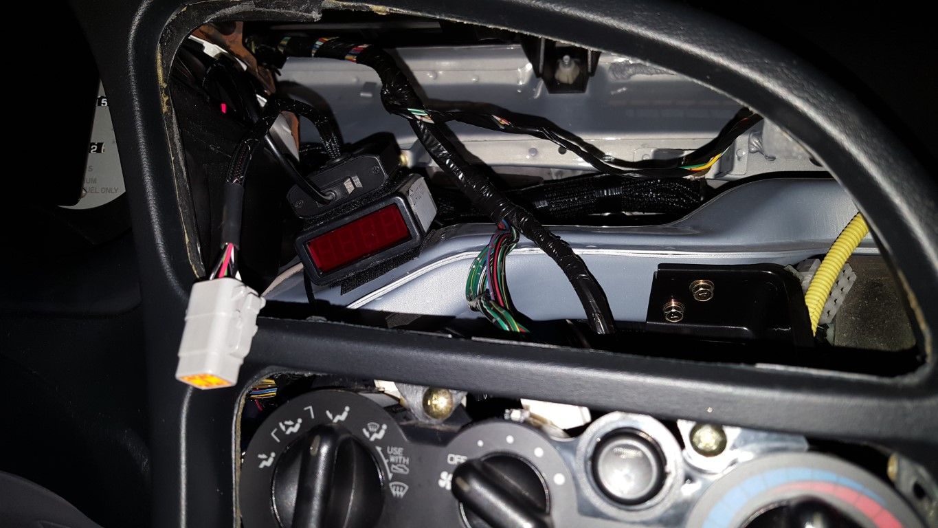

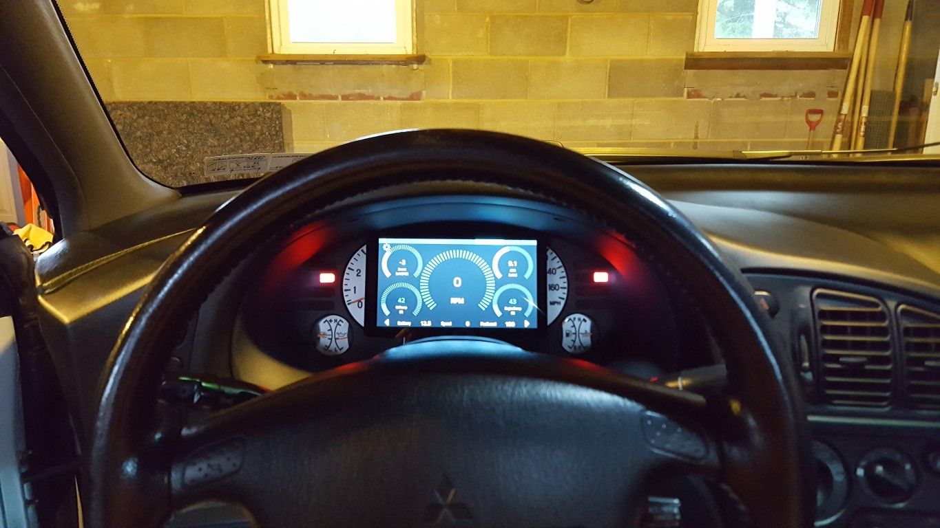

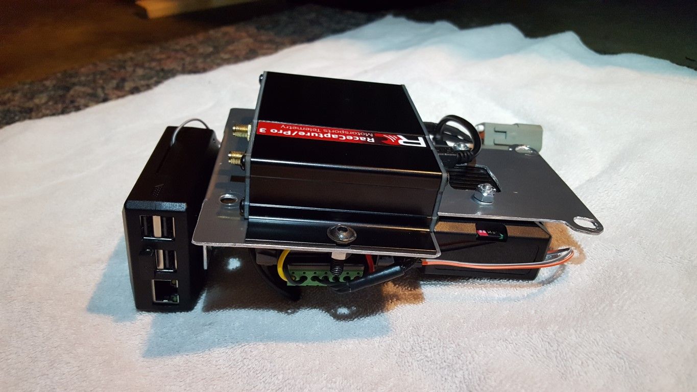

Here's what I've been working on the past couple months. @TSiAWD666 turned me onto RaceCapture so I picked up a Pro MK3 with telemetry. I also used Autosport Lab's AnalogX and SensorX to aid in the install, along with an HDMI switch, 7" screen, and two Raspberry Pi's with power supplies.

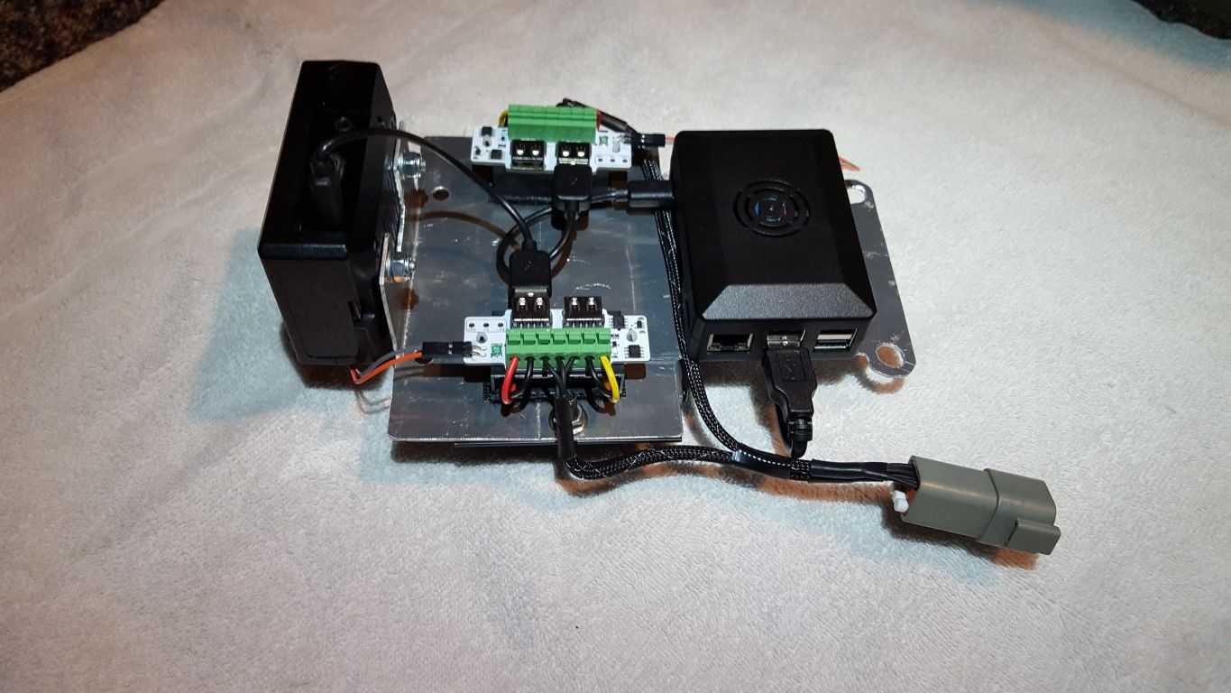

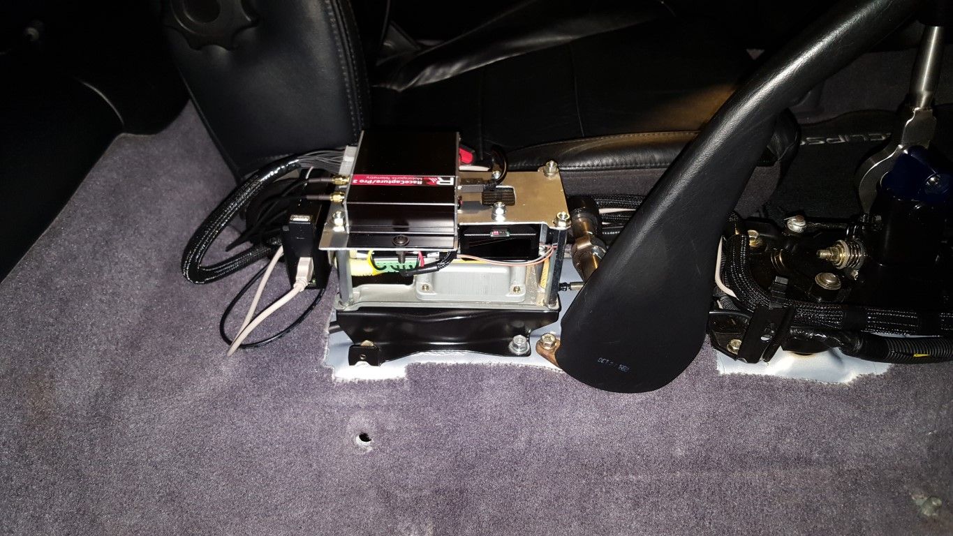

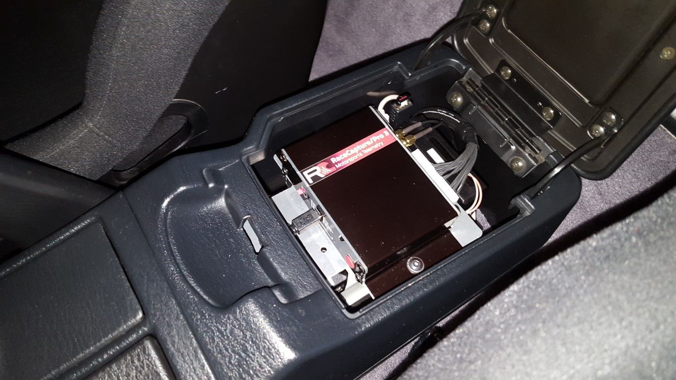

To mount the MK3 and the Pi's, I removed the pocket from the center console and fabricated an aluminum bracket. This whole assembly can be removed without taking out the center console, plus I can reach all of the micro SD cards and most of the connectors. I replaced the SRS ECU nuts with threaded standoffs.

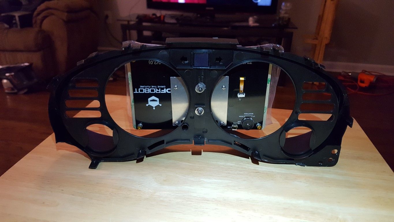

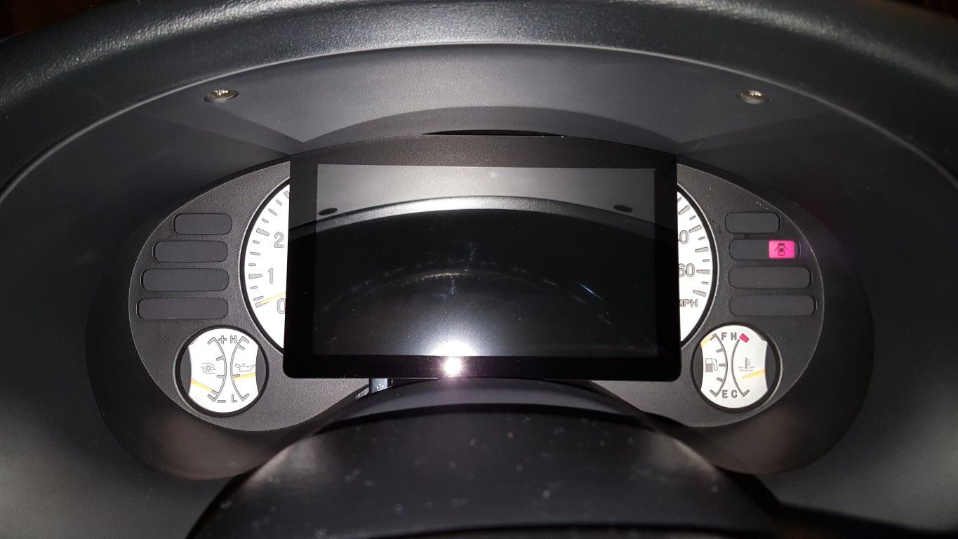

I made another aluminum bracket to mount the screen to the gauge cluster. I had to ditch the clear plastic over the cluster and the rod for resetting the tripometer.

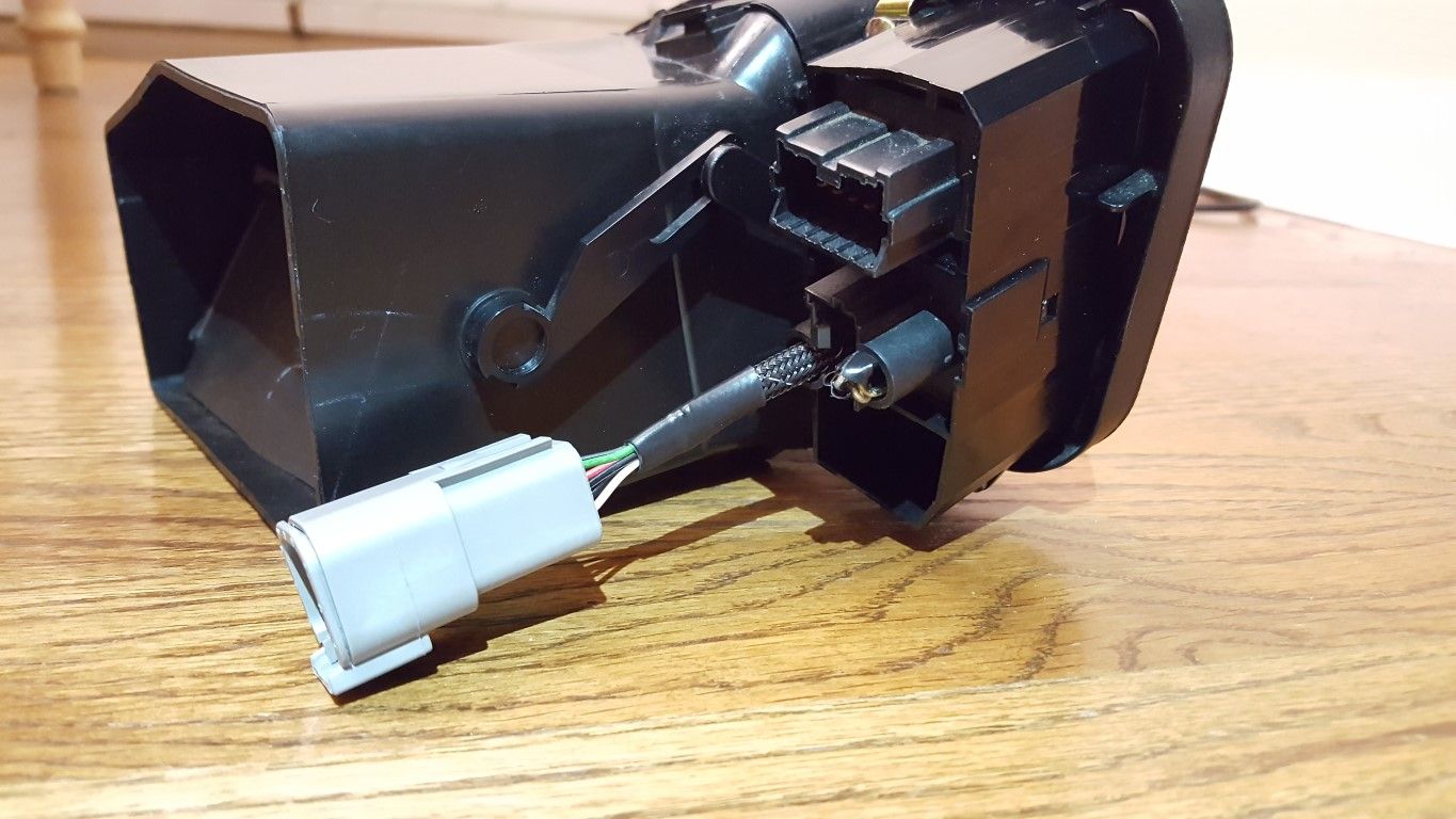

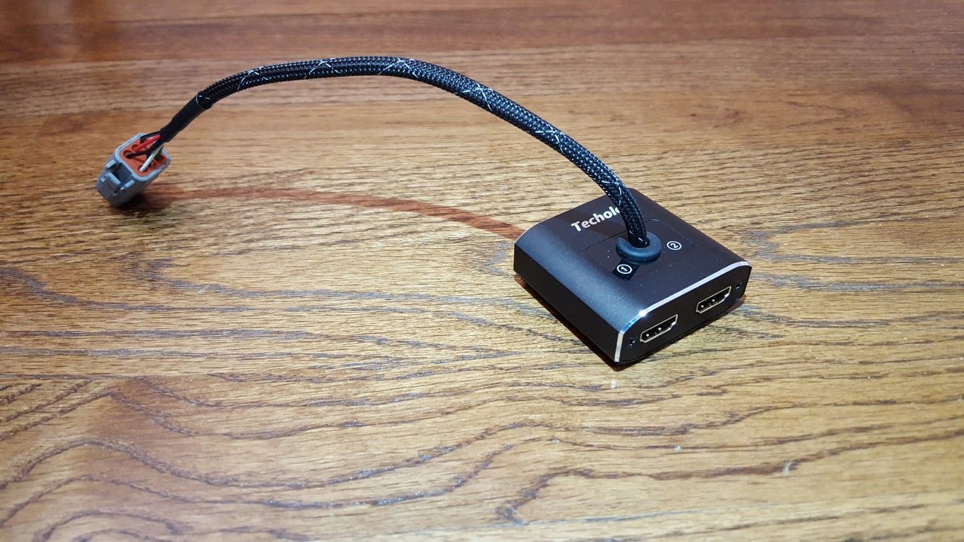

I disassembled the HDMI switch and moved the actual switch into the factory rear defroster switch. This lets me switch between ECMLink and RaceCapture.
