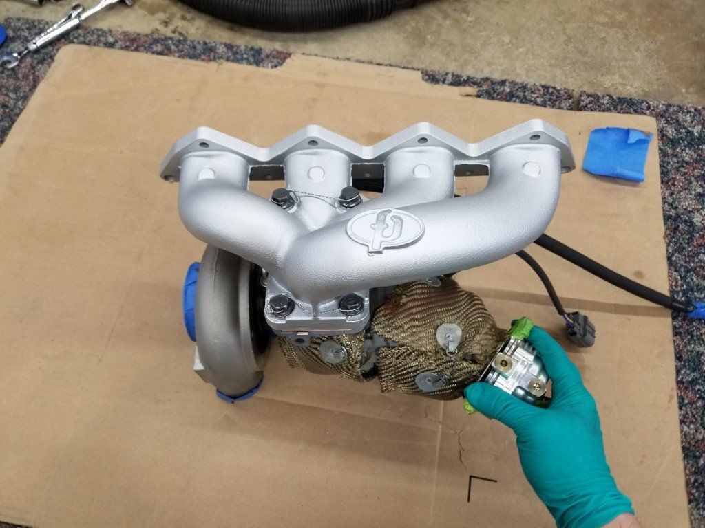

I got the manifold back from Detective Coating and it looks great! Everything went back on the car without too much fuss and it passed the boost leak test. I also got the sway bar bushings changed out, but most of my to-do list is on hold until I'm ready to prep for a track day.

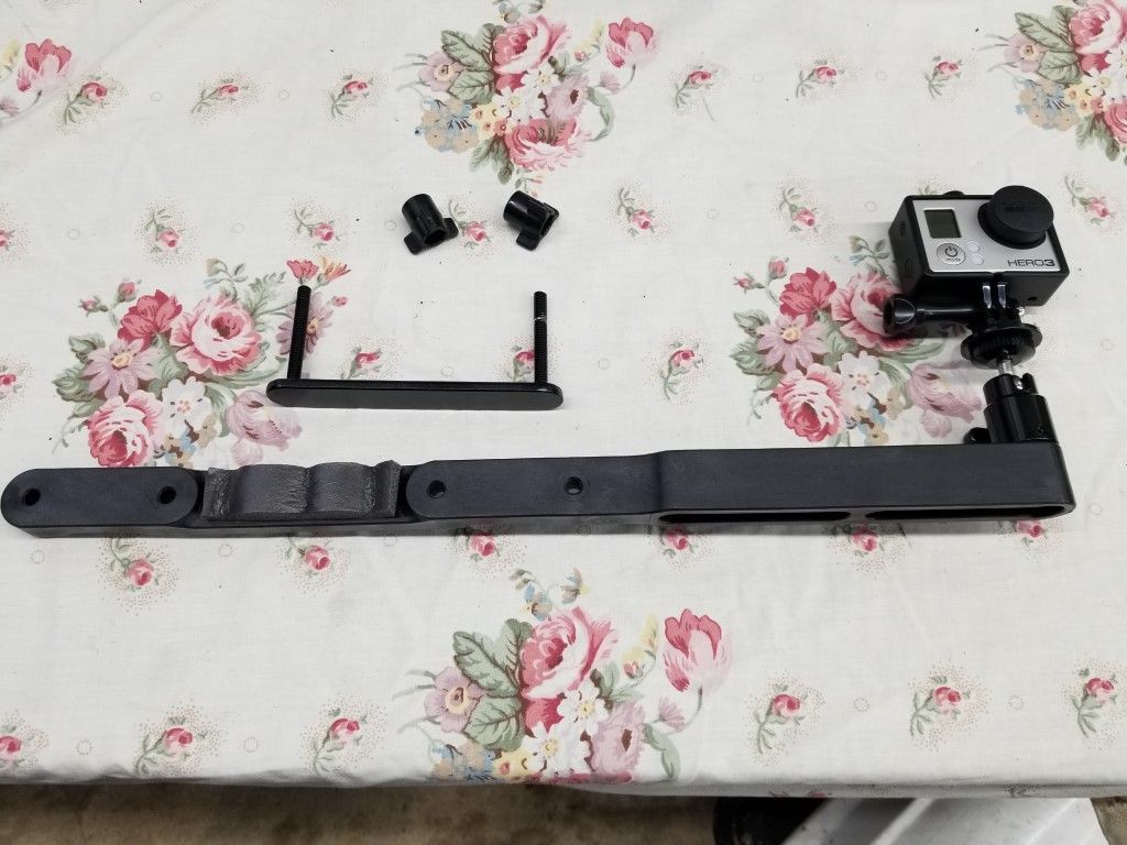

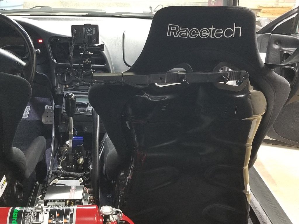

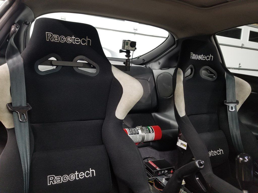

I got a new GoPro mount that should give a nicer view. I also wired in an external microphone near the firewall so the sound is way better. I used a battery eliminator so it gets power when the key is on and I won't have to change batteries anymore. And finally, I used one of the RPi's to turn the GoPro on when it does, so I won't have to even turn it on manually. The RaceCapture takes care of the wifi signal to start/stop recording, so I literally won't have to touch the GoPro at all except when I remove the SD card to snag the videos from it. This will help reduce some effort and stress during track days for sure! HUGE thanks to John (@TSiAWD666) for walking me through this since he went through the same process.

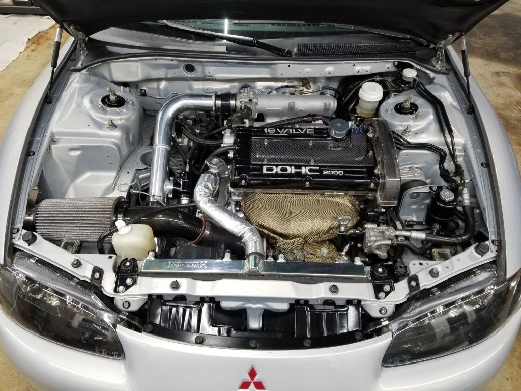

Guess I might as well post my vacuum block setup here for reference.
-10 bung welded to manifold
Earl's Prolite hose and fittings
Golden Eagle vacuum block
Stock bov and fpr nipples removed, plugged with 1/16" SS NPT set screws
Stock pcv nipple removed, tapped for 1/8" NPT, used a 90* fitting for easier hose routing towards the passenger side
Boost gauge, brake booster, fpr, bov, and mbc are fed from the block, pcv and map are in the intake manifold (map is where brake booster used to be for quick response).
The block mounting points happened to be the perfect spacing to use the bosses on the manifold that used to hold the support bracket. I put two bolts in those bosses, then drilled/tapped through the middle of the head down the length of the bolt, then the little bolts for the block thread into the big bolts. I did this to clean up and hide some hoses, but more importantly so I could eliminate any T's and so my map sensor could be directly threaded into the intake manifold. As you can see in the pictures above, the whole setup is basically unnoticeable. At the NE DSM meet, only one person actually noticed the line off the intake manifold.
(You can also see my IAT placement for speed density).

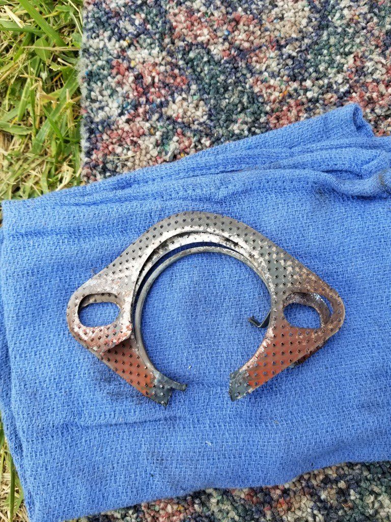

We had a track weekend at Summit Point Main on the 4th/5th. It didn't go that well, I'm having a bit of bad luck lately.
The first couple sessions were OK, then I took Brian for a ride on the third session. We hard a loud clunk on the straight and thought it was just a decent sized rock that I kicked up and continued to run the remaining 20 minutes or so in the session without issue. Turns it out was one of my downpipe bolts. The Nordlock washers didn't work for shit. It didn't melt stuff like last time - this time it melted my timing covers instead. It's hard to see from the pictures but they're melted and started conforming to the water pump pulley. We cut back as much of the cover as we could and replaced the bolt but missed the open session at the end of the day Saturday.

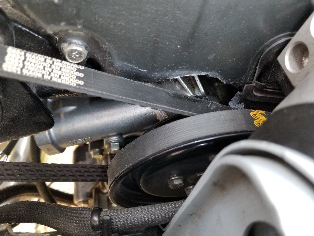

On Sunday I decided to check the bolts after every session just to make sure they were still there and tight. They did loosen up a bit, but stayed on. Unfortunately, in the second session, I ran into some issues. I'm not exactly sure what was the cause and result, but the alternator belt threw, the alternator fan got ripped off the alternator and broken in half (later found this half hiding in my subframe, not sure where the rest is), and my power steering belt flipped upside down. I heard a loud bang, immediately noticed the steering got hard...kind of, and shortly after my low voltage warning on my RaceCapture came on. The water temp was still fine so I knew I had that belt, but I couldn't figure out the power steering since it got hard at some points but not all the time like it would be if the belt was gone. So that one took me by surprise to see it upside down.

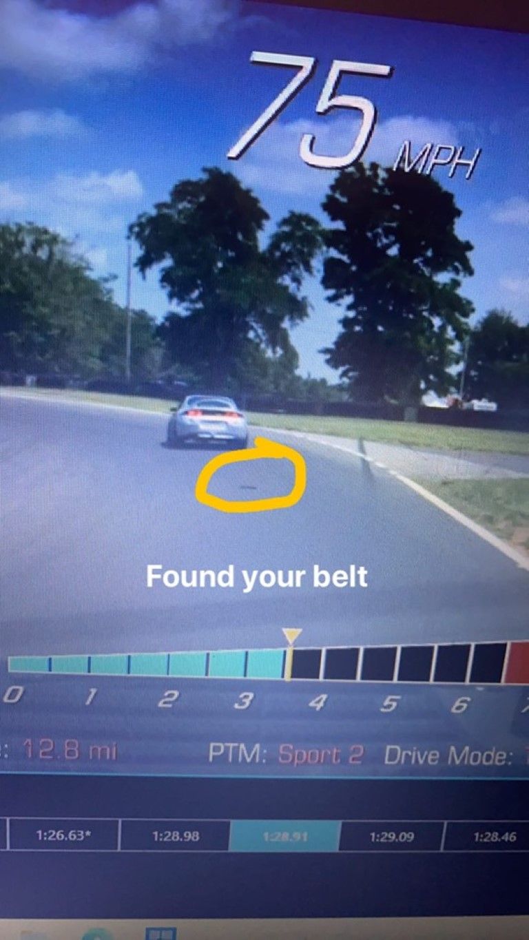

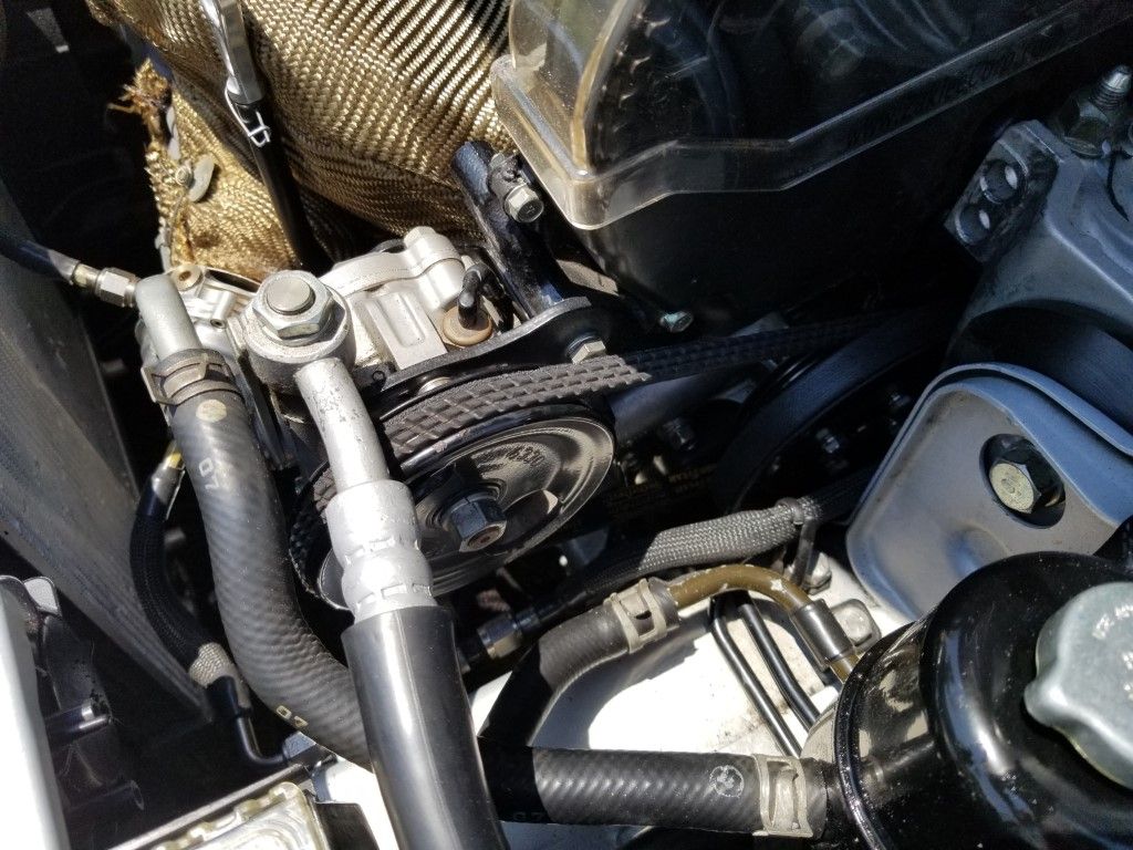

I had spare belts so we got those swapped just in time to make the third session (they were rolling out of the grid as I was pulling in). I made five laps (one of which was my best time of the weekend, 1:28.10) and then started hearing a weird vibration type noise. The car makes all kinds of fun noises but this one I knew was weird, so I pulled in. We couldn't identify where the noise was coming from, but it still made it even after I got home pulling the car out of the trailer.
I ripped the timing covers, alternator, etc. off the car last week and the noise isn't there anymore. So I'm not sure what it was, but I don't think it's anything serious. Maybe the alternator being out of balance or something, who knows. I have new timing covers to put in, new belts, the alternator is at Powermaster being repaired (FANTASTIC customer service, by the way), and we should be good to go for Shenandoah August 1. I still need to figure out how I want to solve the dowpipe issue since I don't want to rip everything off this season to v-band it.
The GoPro setup worked great Saturday but didn't record anything Sunday. I think there's a bug in the RaceCapture software and I pissed it off when I tried to change the trigger speed. I'll get that sorted out before the next track day.

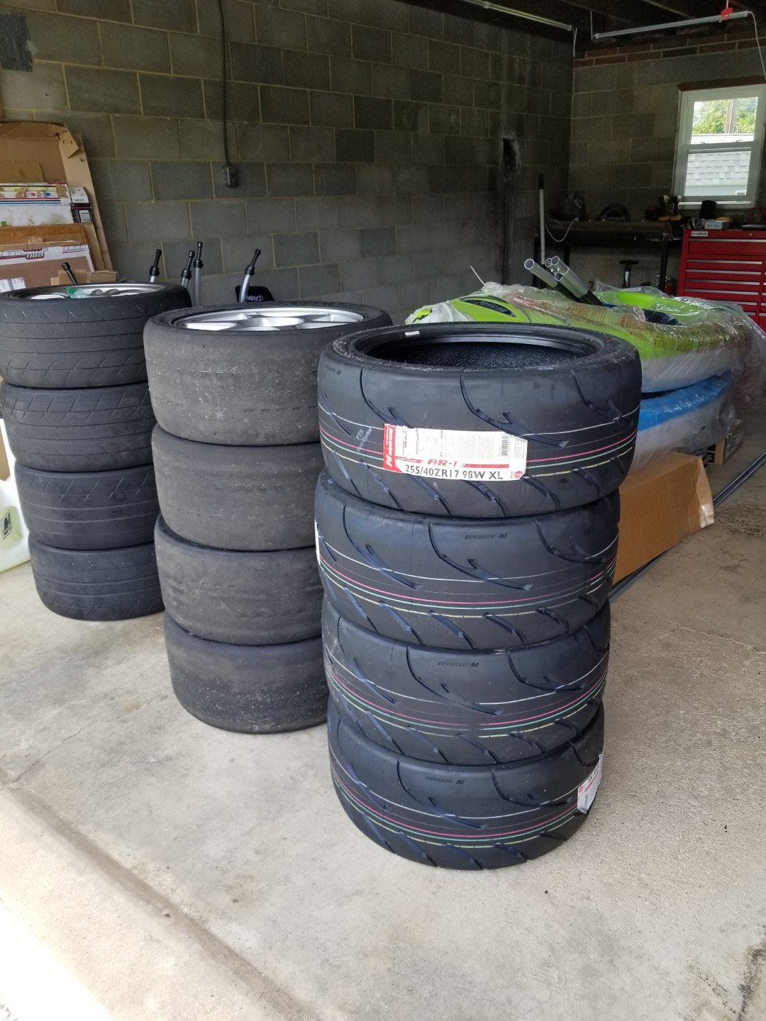

These just showed up today and I'm hoping will help chip away a little at the delta. Nankang AR-1 255/40-17 heat cycled by PTS. I'm really exited to try these out since all of my track experience has been on RS3's and RS4's.
The slicks in the picture are Brian's A7's. Between the two of us, we will have four sets of wheels with good tires: true 200tw (RS4), cheater 200tw (RE-71r), 100tw (AR-1) and 40tw (A7) - should be fun comparing them!

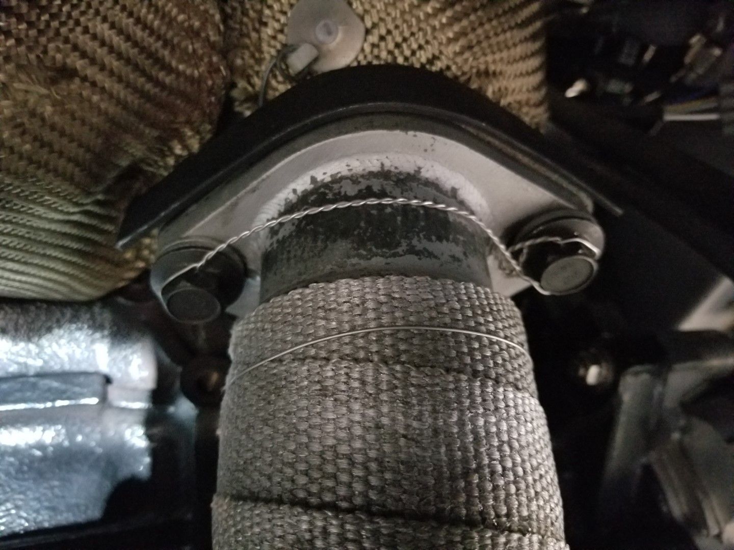

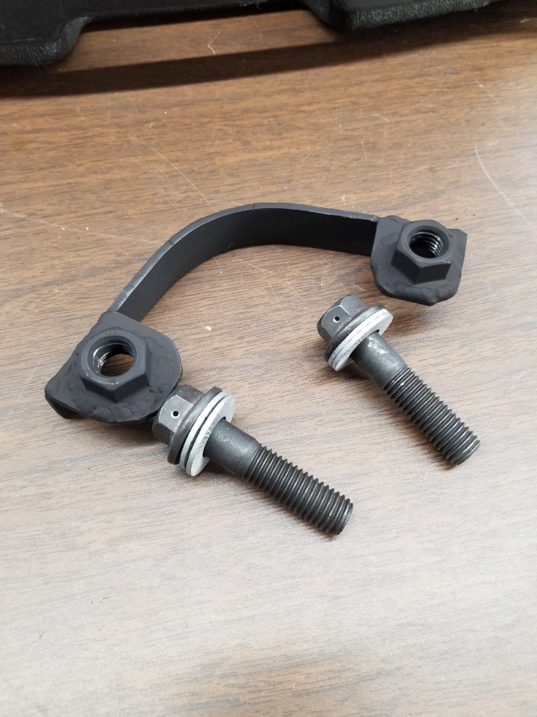

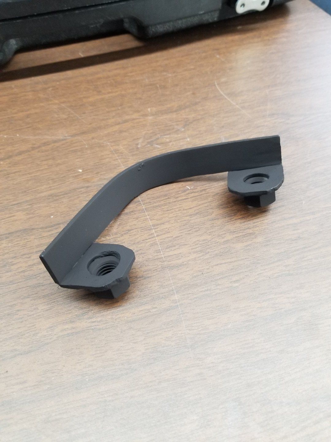

I made this nut plate for my downpipe. So the nuts aren't going anywhere now, and the bolts are safety wired plus Nordlocks. I'm hoping this finally fixes the issue of the bolts backing out. While reassembling everything, I did notice the one bolt was about a thread too long and bottoming out, so I believe that was the real culprit :rolleyes:. I cut a few threads off both bolts to fix that. But either way, this should be a better setup and makes the downpipe ten times easier to install since I don't have to get a wrench up top on the nuts.

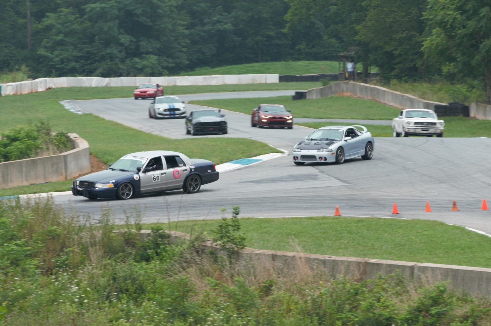

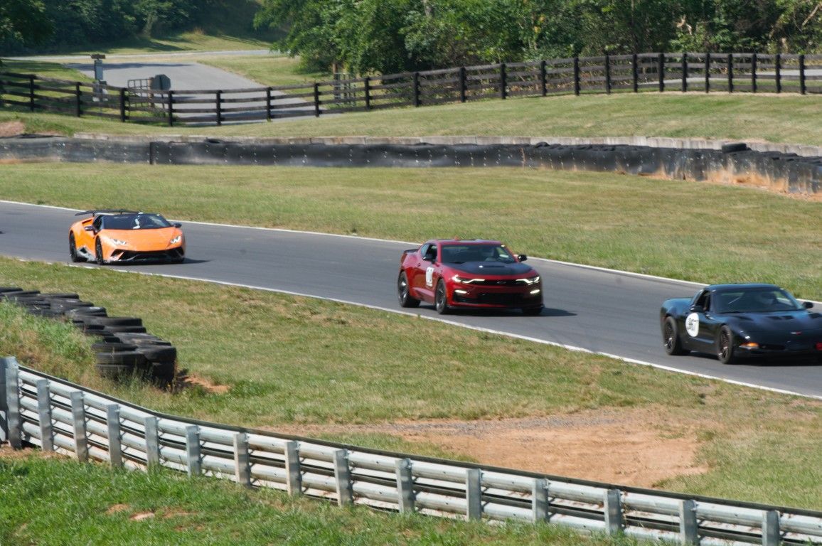

My Camaro friend and I went to Shenandoah on Saturday. This was my first day out with the new tires and they did not disappoint!

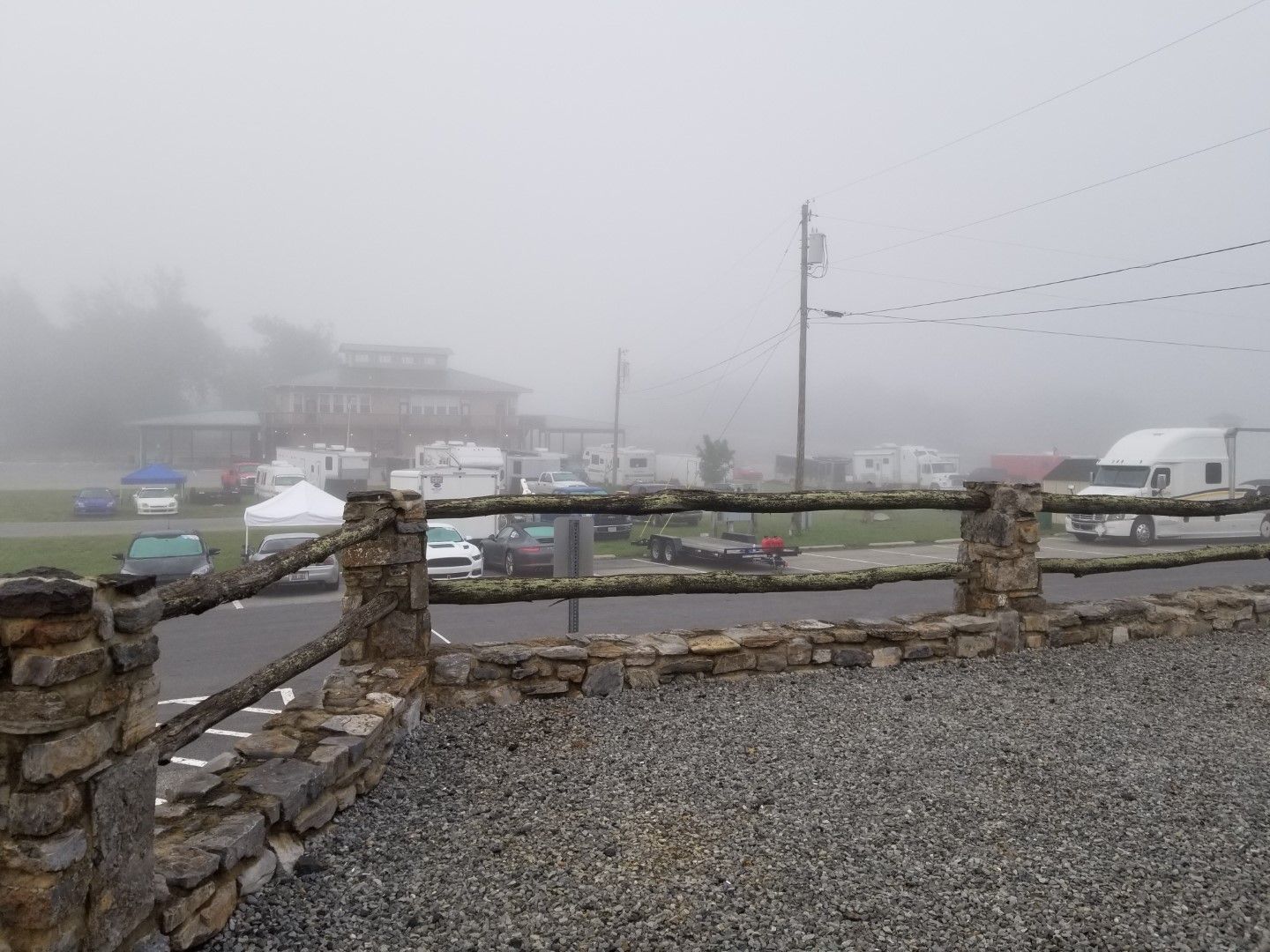

The day started off really foggy and the weather forecast calling for scattered thunderstorms. I brought along the RE71r's just in case I needed a rain tire. We got lucky and the fog mostly cleared up before we started and we only got a light rain shower in the middle of the day so one session was just a bit damp.
The first session out was...interesting. Only half of the group had been on Shenandoah before and it's a tricky track to learn, so there was a lot of dumb stuff going on. I had a GTR in front of me that damn near came to a stop on the track while he was figuring out if he should be going left or right! But I immediately beat my previous best time of 1:46.06 by three seconds without really trying, so that was awesome.
All of the sessions continued to go well. We were always lining up at the front of the grid, so we would get a few clean laps in before we caught up to traffic. I ended up shaving six seconds off my lap record and am now at 1:40.70. When you watch the video you'll see I definitely left some time out there - next time I'll focus on putting down some good hot laps since once you're in traffic it's impossible. The Camaro beat me by 0.03 seconds still! I'm ready for our rematch at Pitt Race in a month. All in all it was a super fun day!

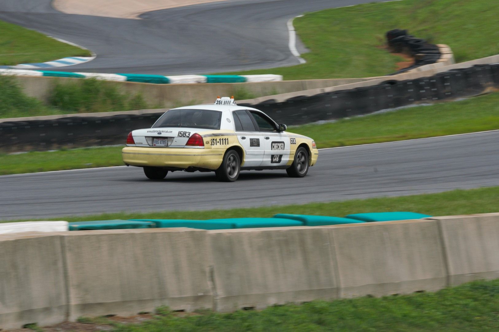

This taxi was awesome. The amount of body roll it had and the stench of brakes was amazing haha.

This taxi was awesome. The amount of body roll it had and the stench of brakes was amazing haha. View attachment 607630 View attachment 607631
