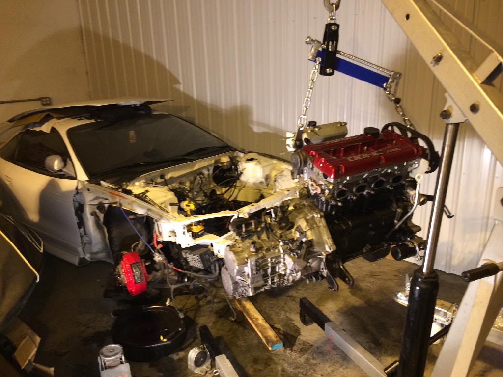

Installed holset to check for clearances on the water pipe, dented that accordingly
Then I pulled the motor in preparation of doing all the above mentioned shiznit. I'm getting pretty good at doing this by myself LOL

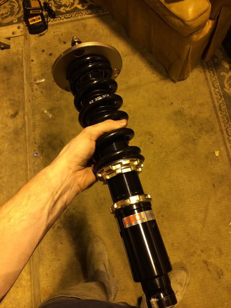

I cleaned up my coil overs while I had them off and they look brand new! But I guess they only have 10k or so on them.

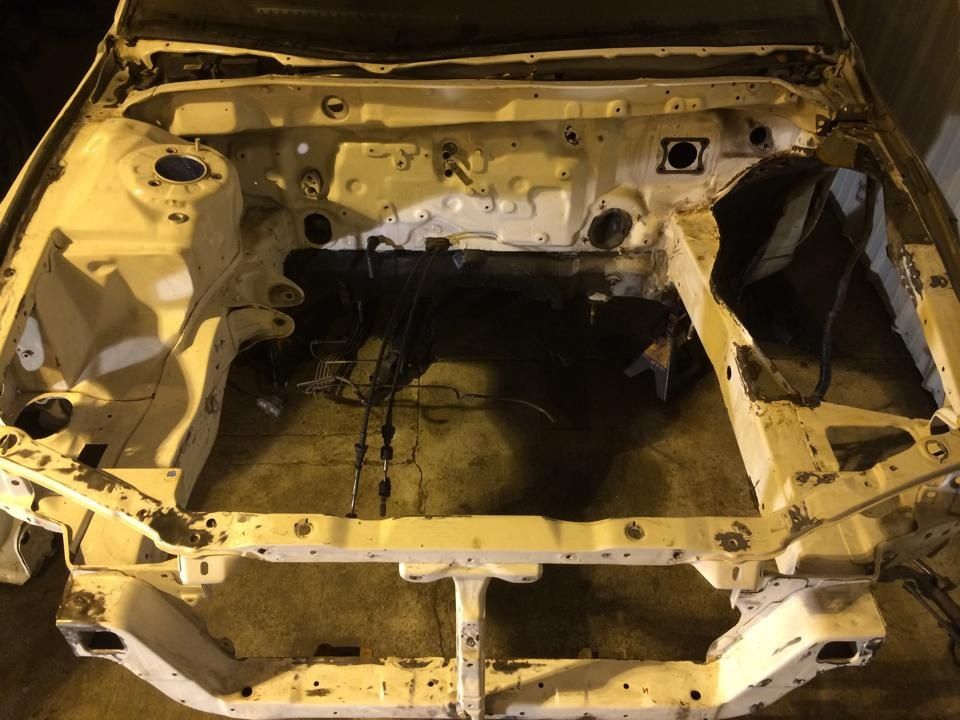

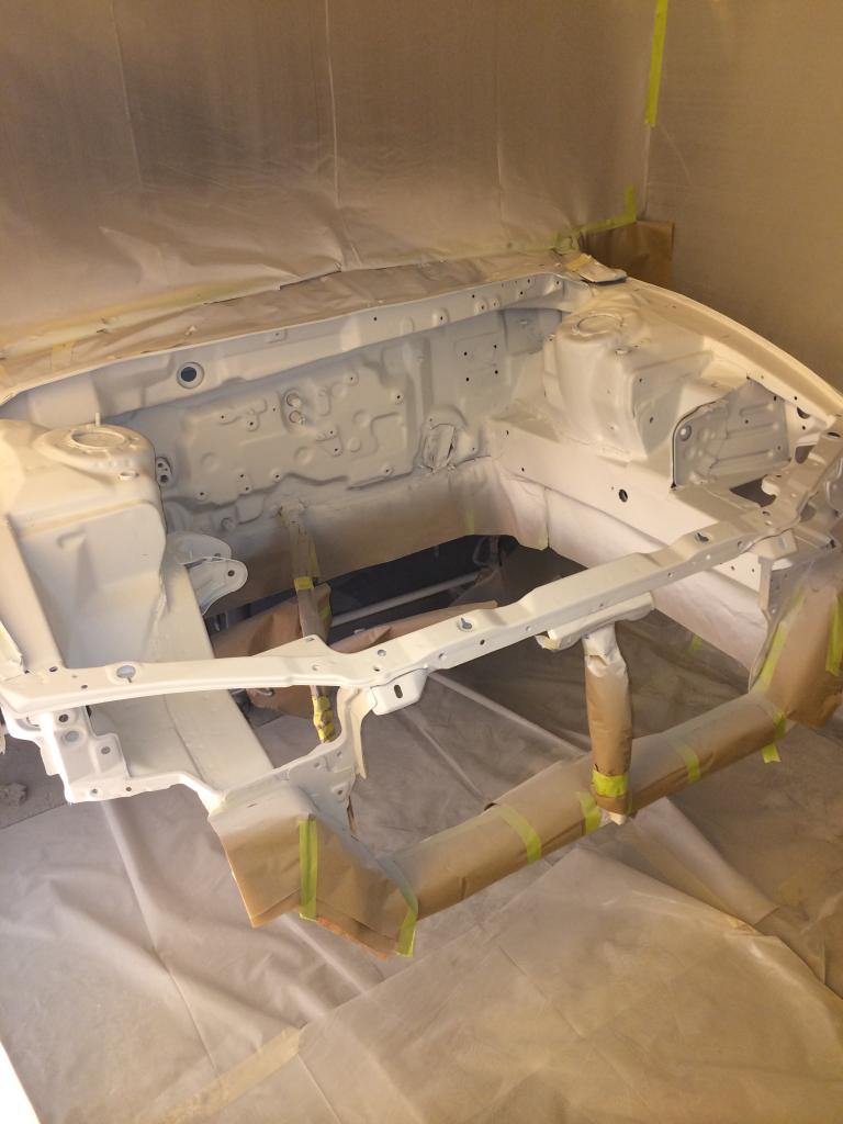

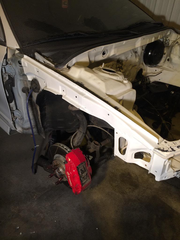

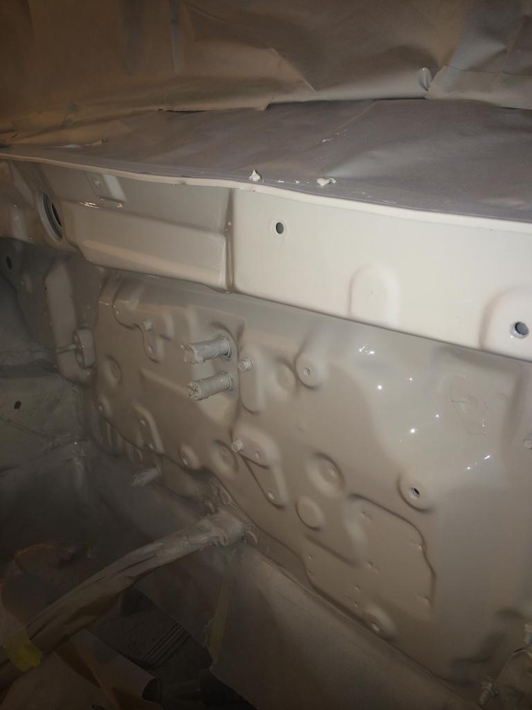

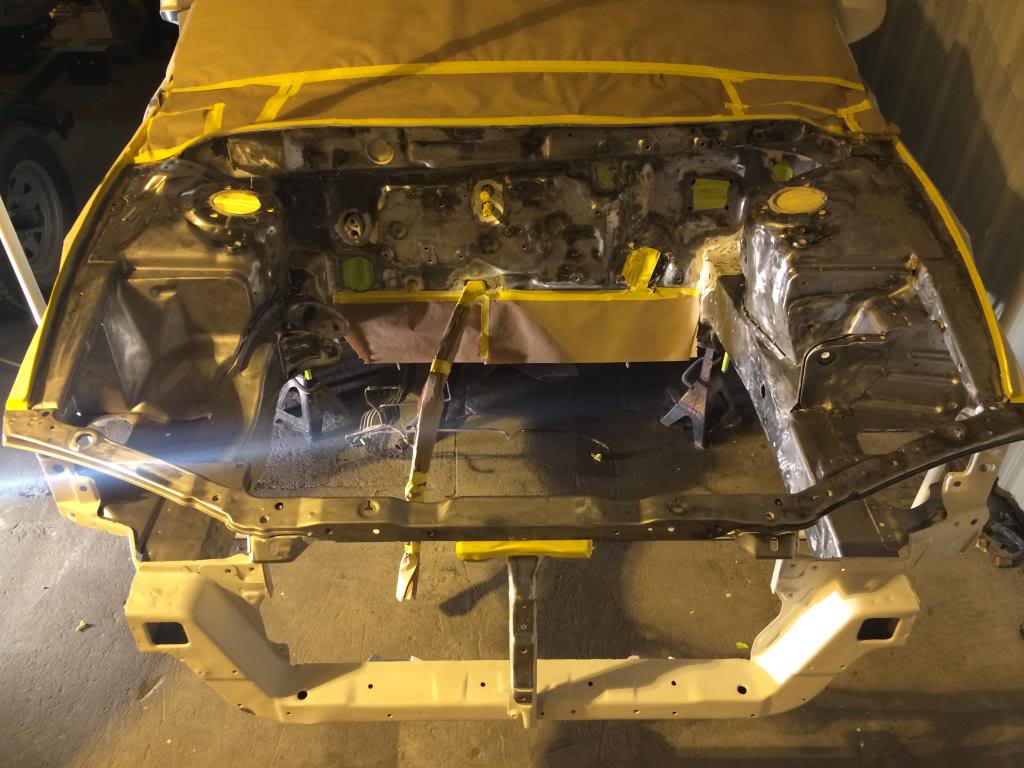

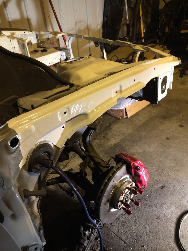

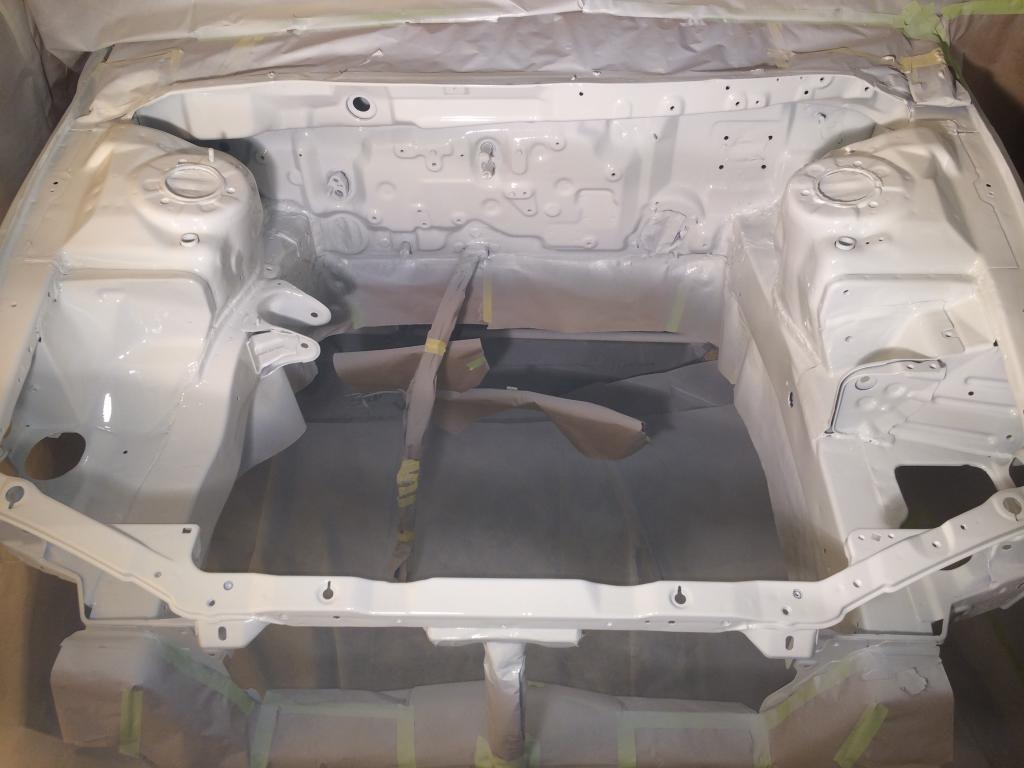

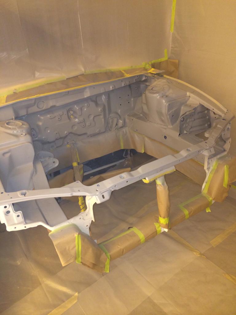

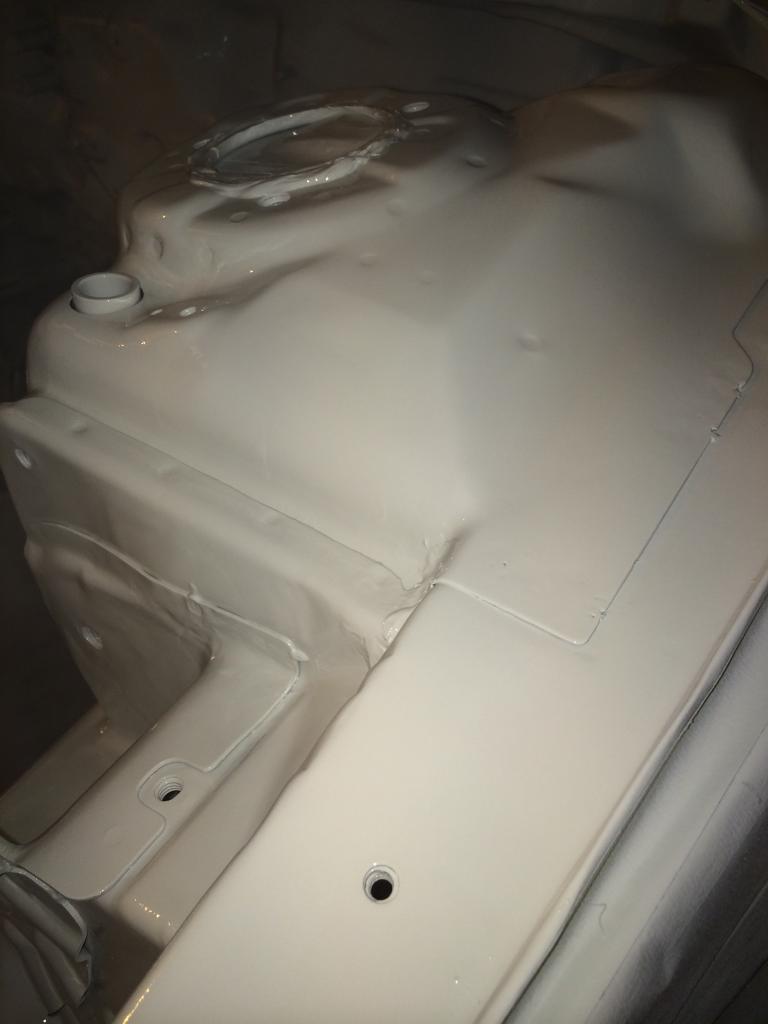

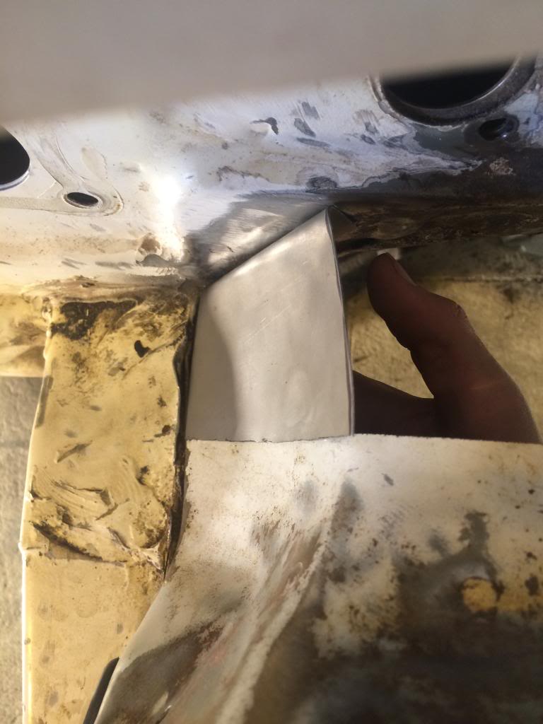

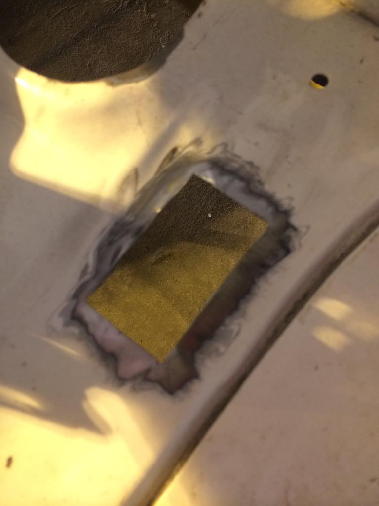

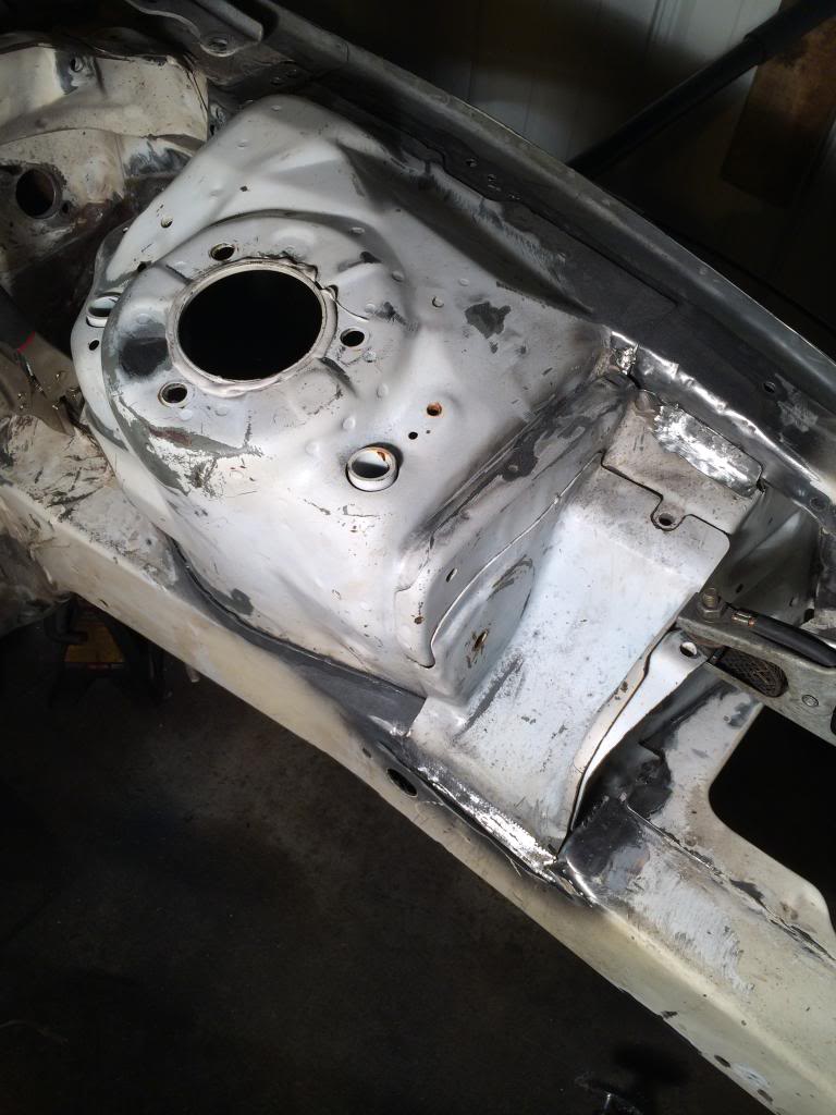

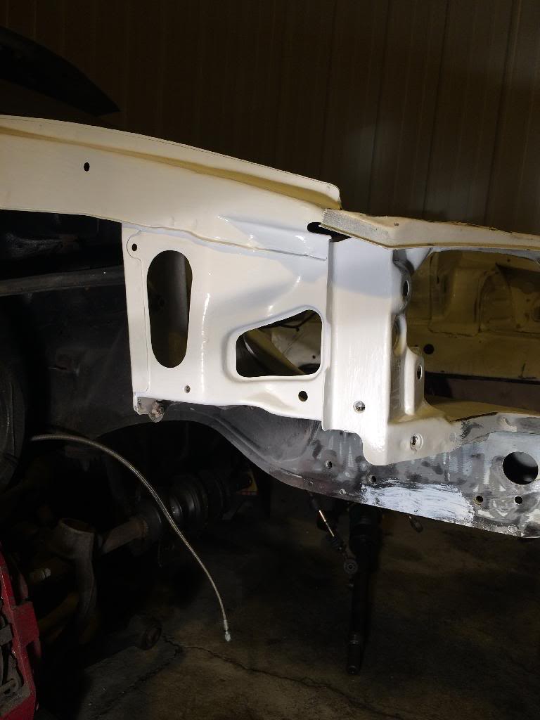

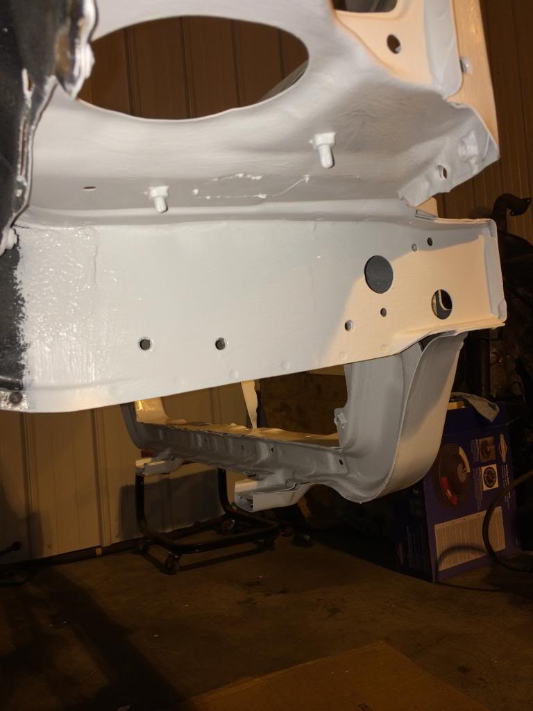

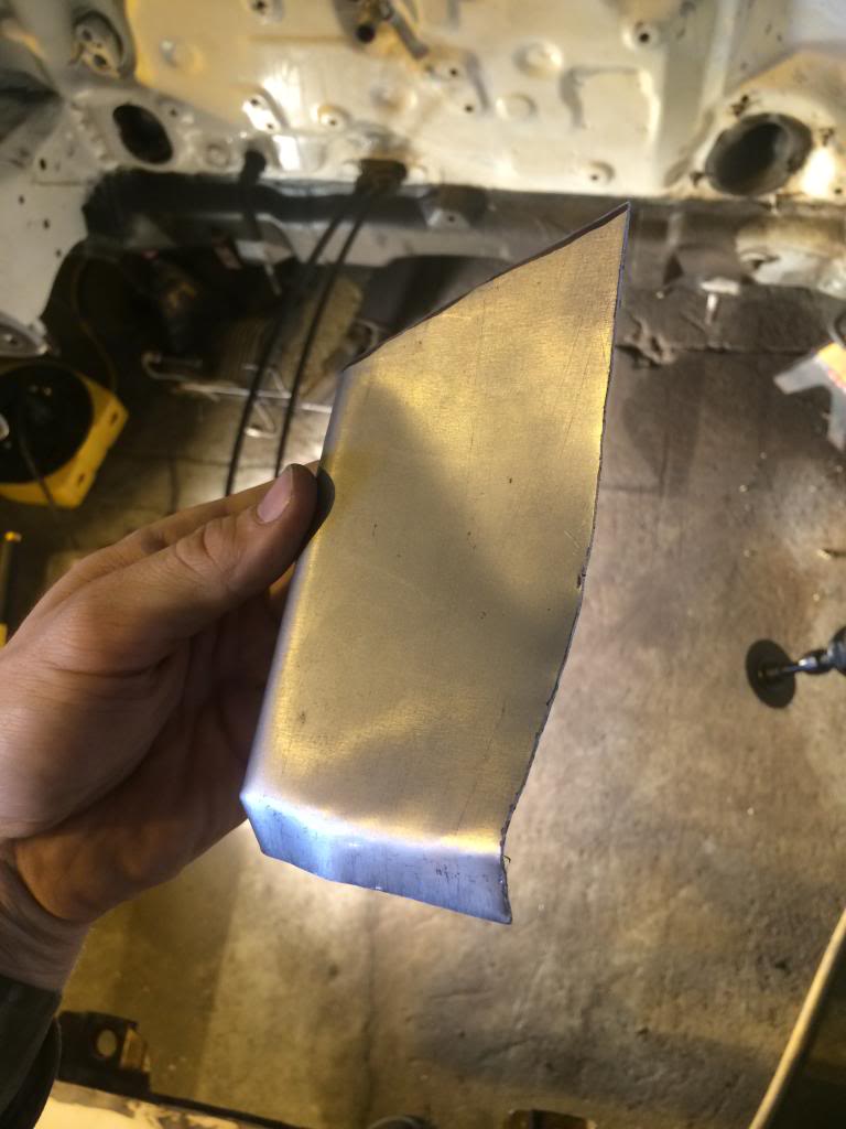

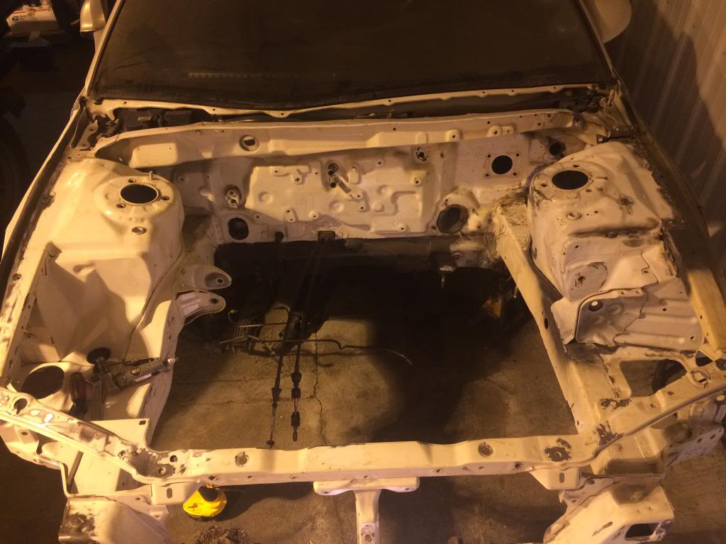

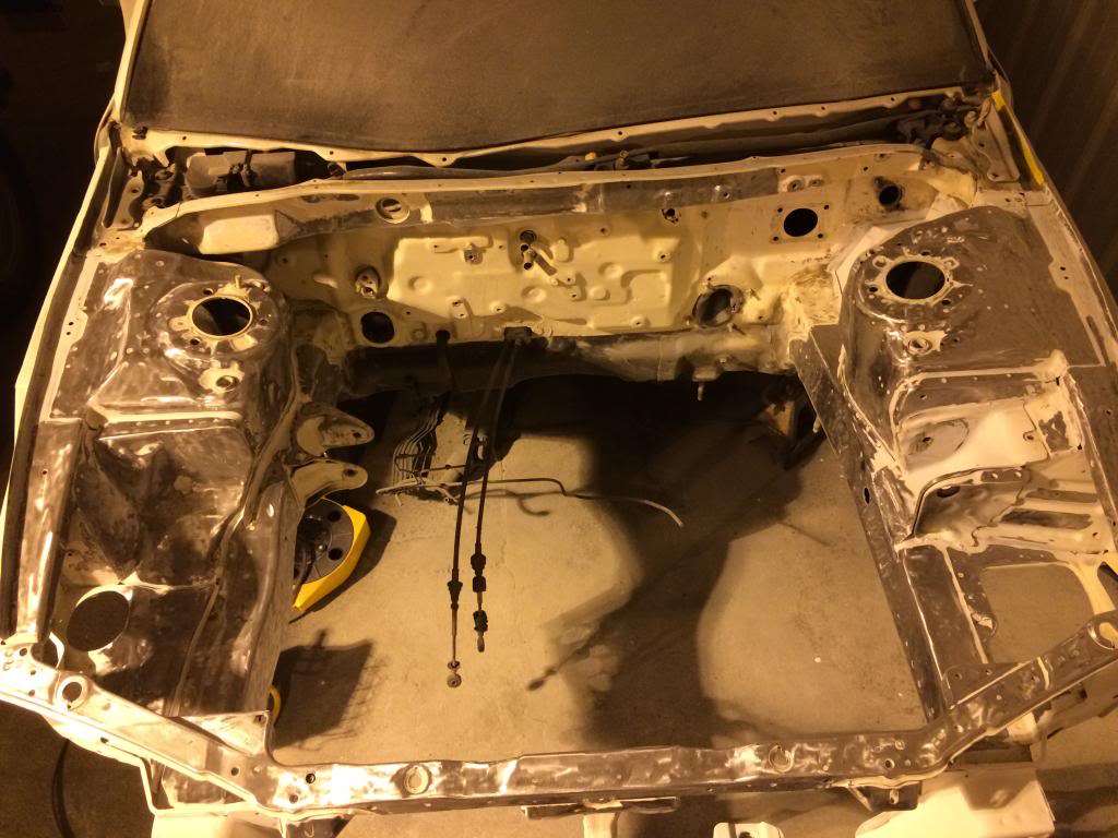

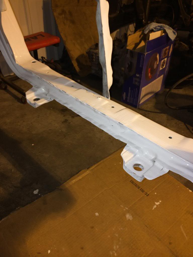

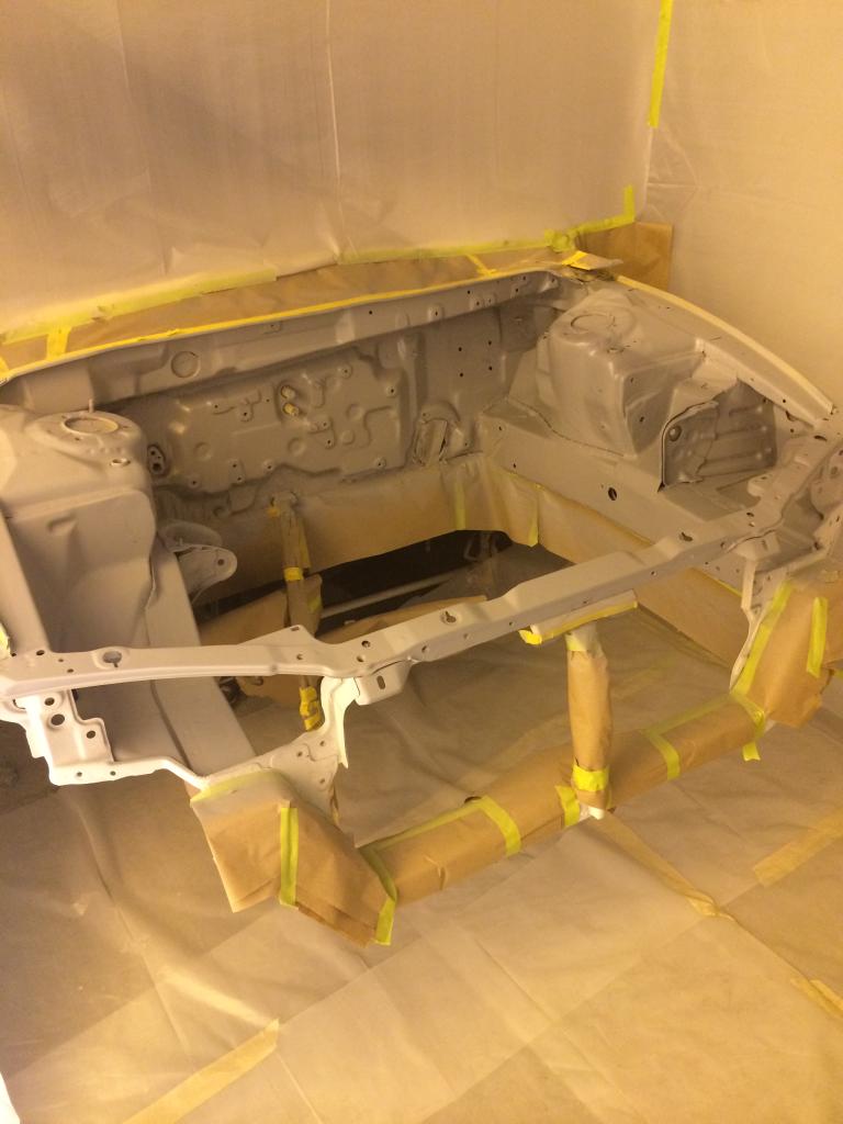

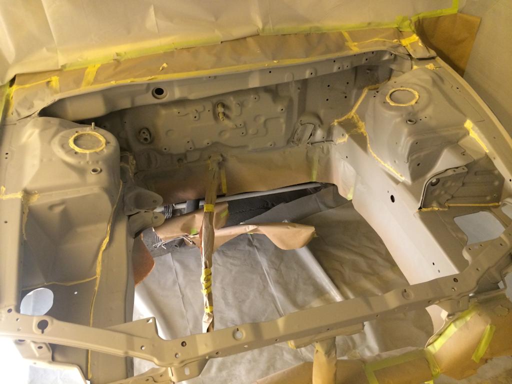

Okay, well, I've been home from school since May 10th and started at my internship so I have taken a little longer than planned to do some of my stuff but it is all coming along and I will update everyone on what has happened!

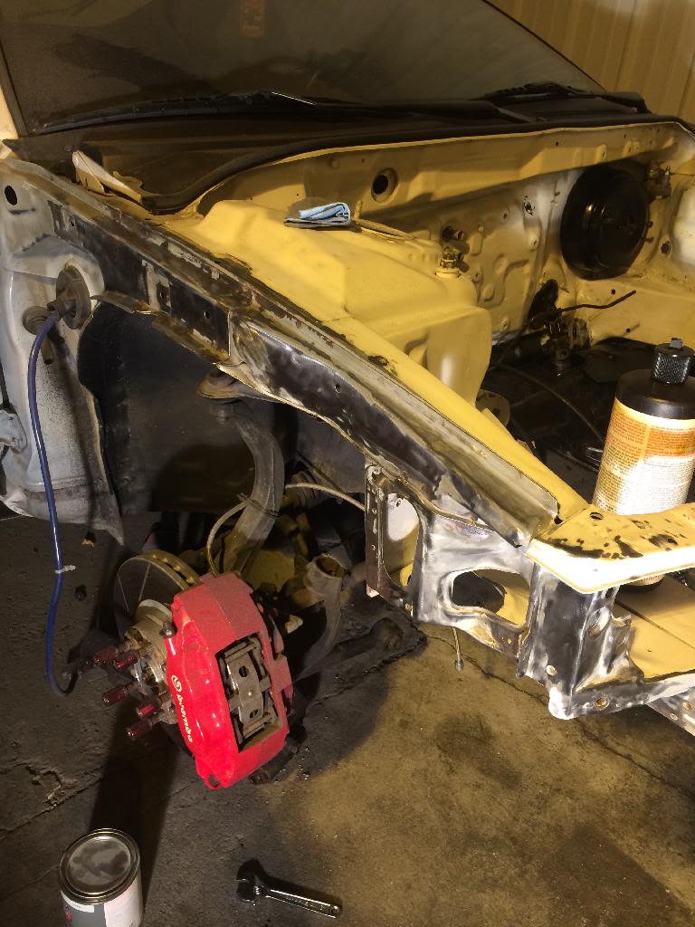

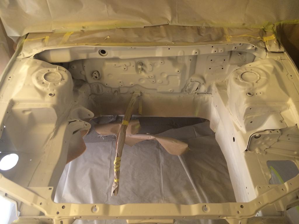

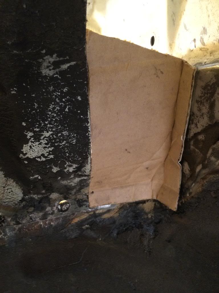

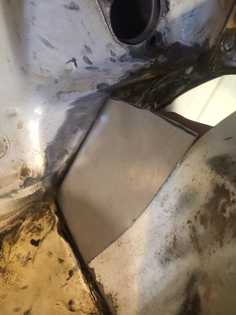

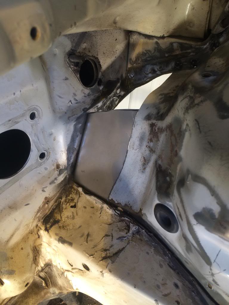

I got the new strut tower in, it looks great. It was obviously a pain in the ass to drill out all the spot welds on two different towers but it was necessary in order to do a quality repair job

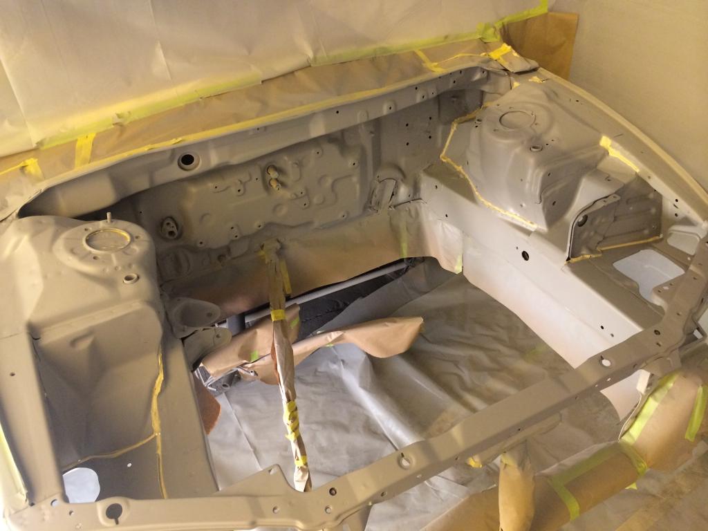

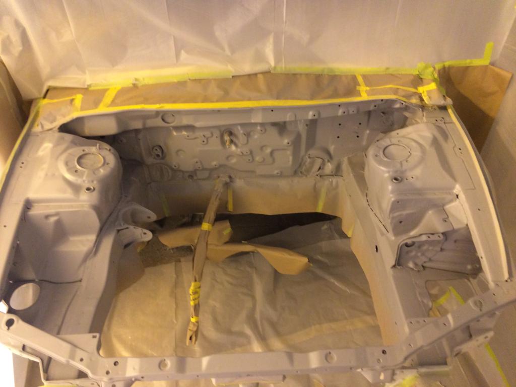

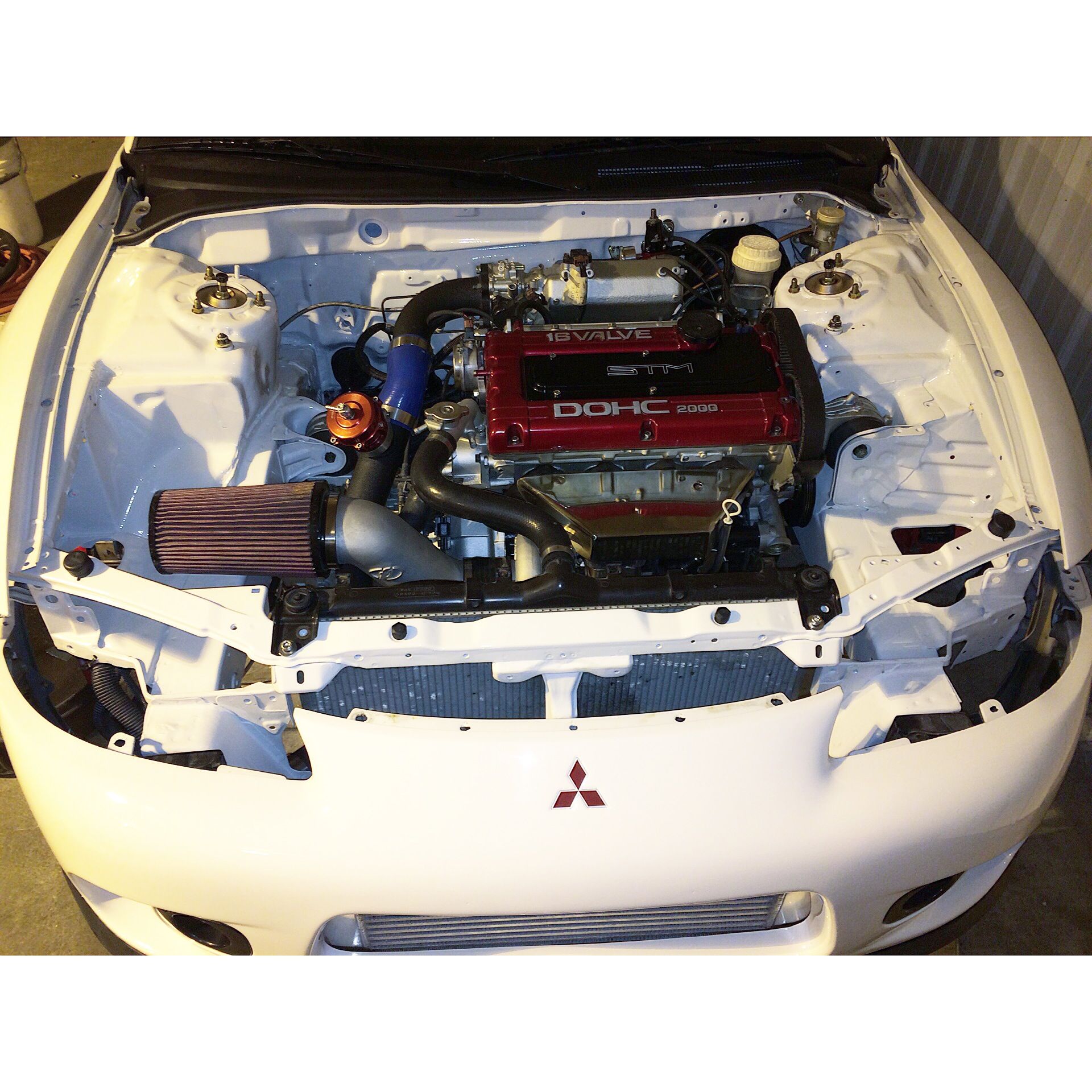

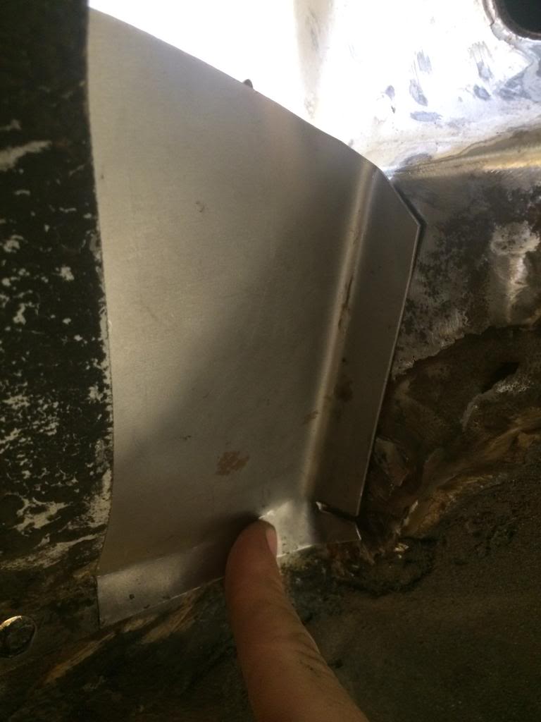

With a mixture of wire wheel/stripping discs/ media blasting, I got the engine bay down to bare metal and ready for paint.

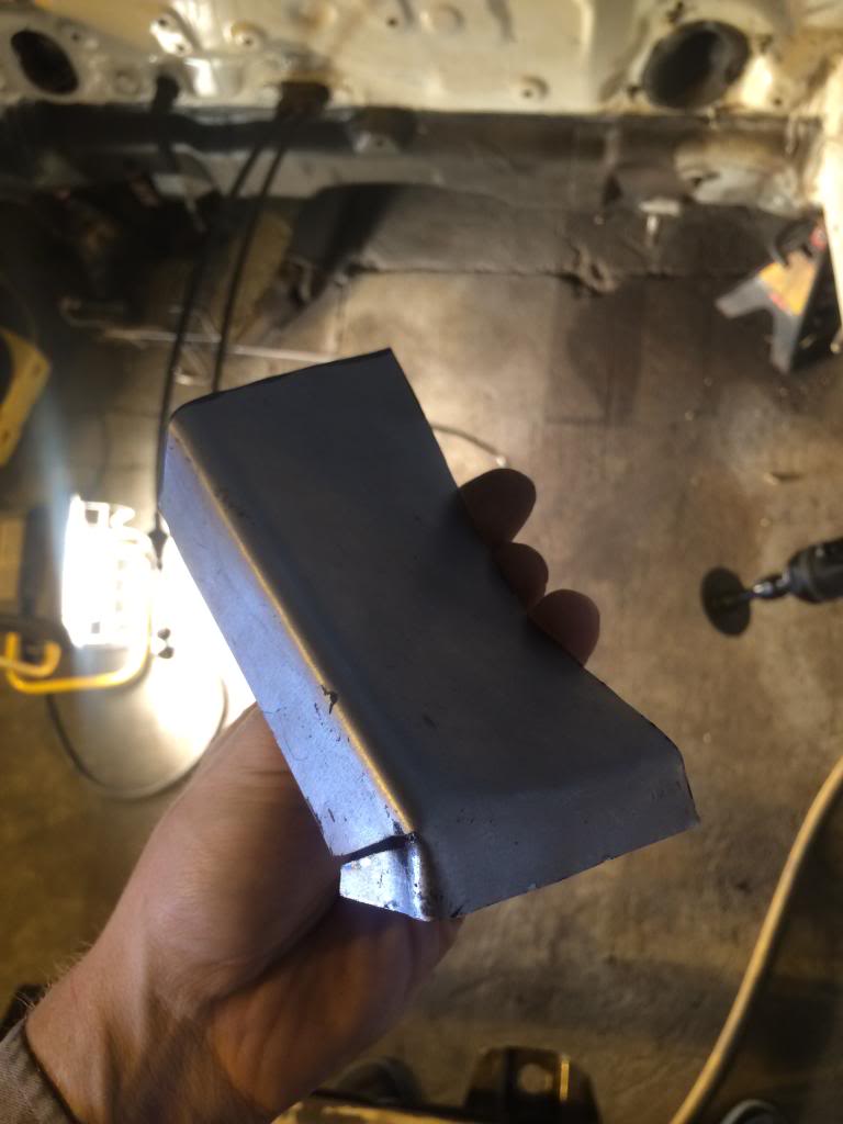

I had to make some patch panels and what not for some spots, you will see in the pictures.

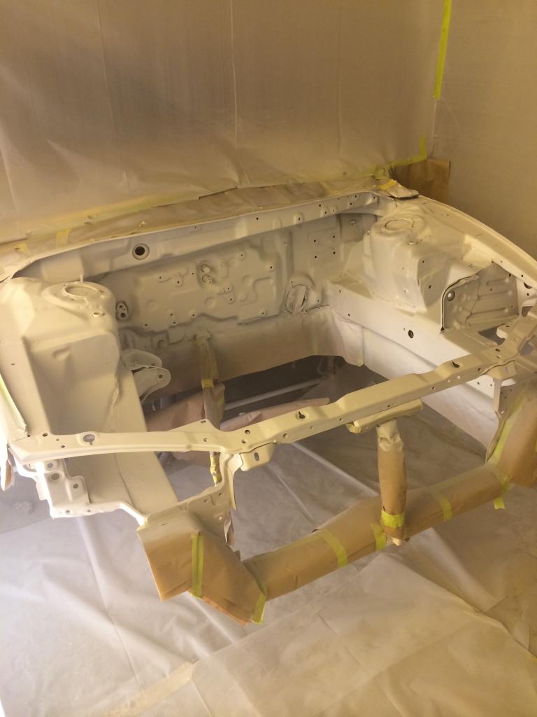

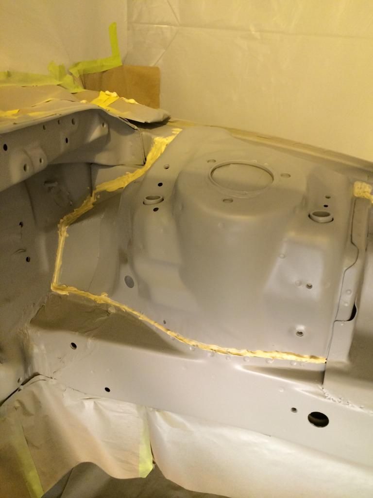

Painted by yours truly with a 70 dollar gun from home depot.
I never really liked when people talked to much in these so I will let all the pictures do the talking! Should have everything done by the end of the week and on the road!

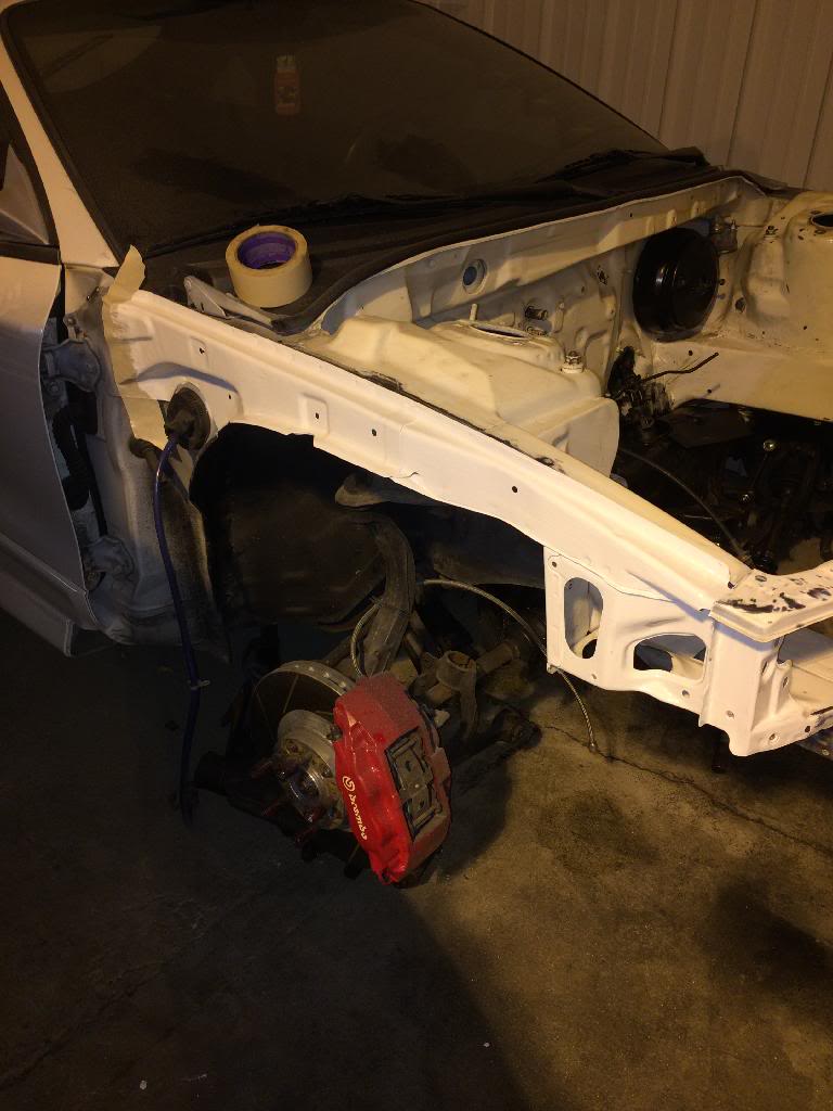

So I got some stuff done in the last two weeks.
Things got painted/ coated/ welded etc etc.

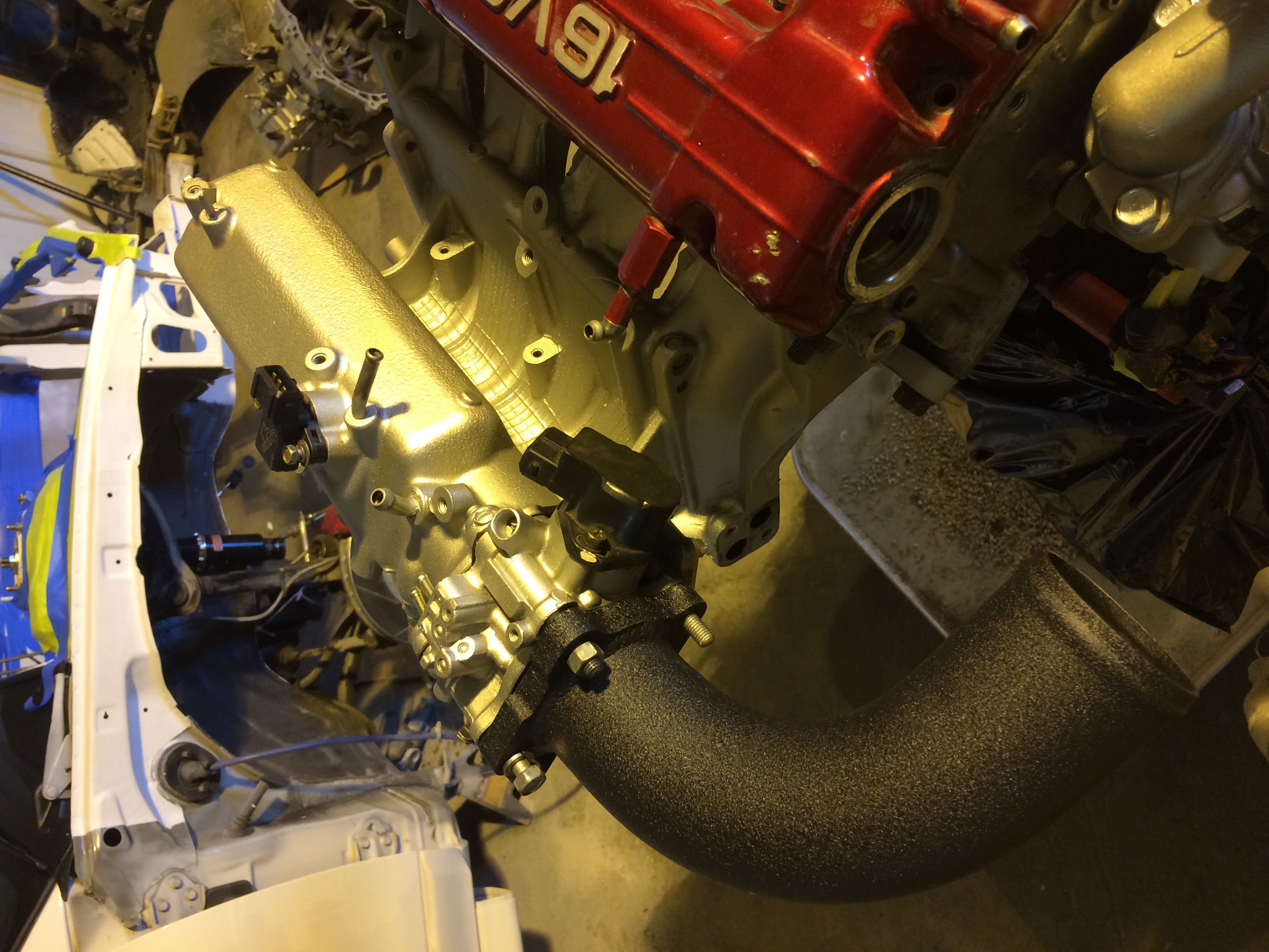

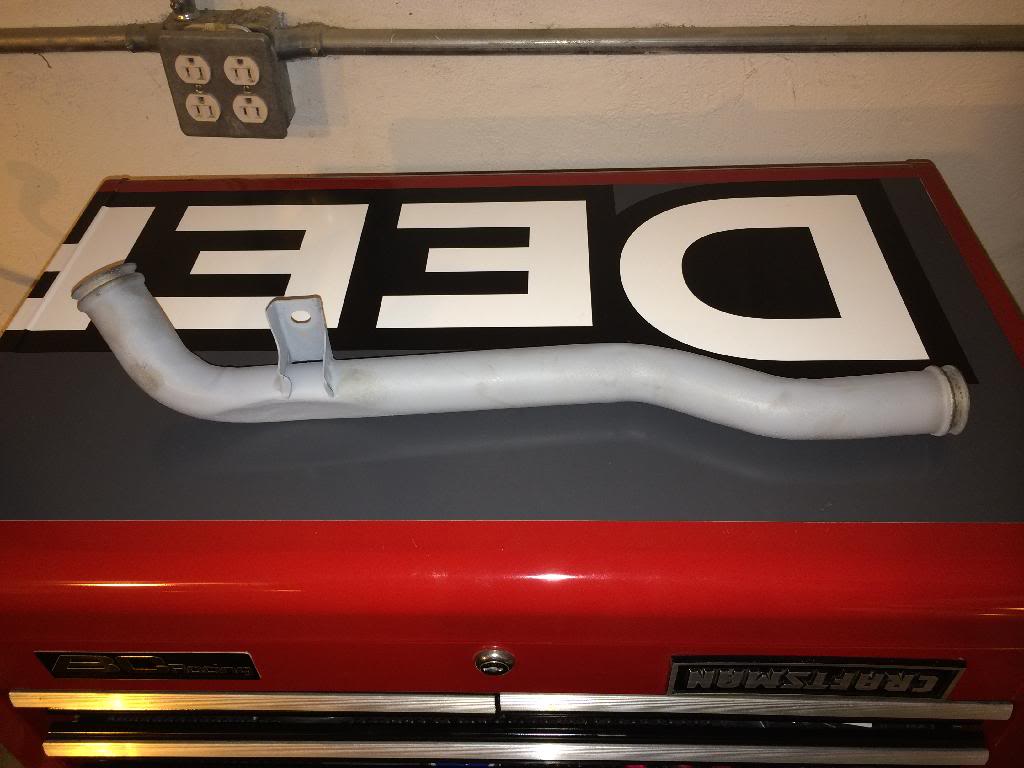

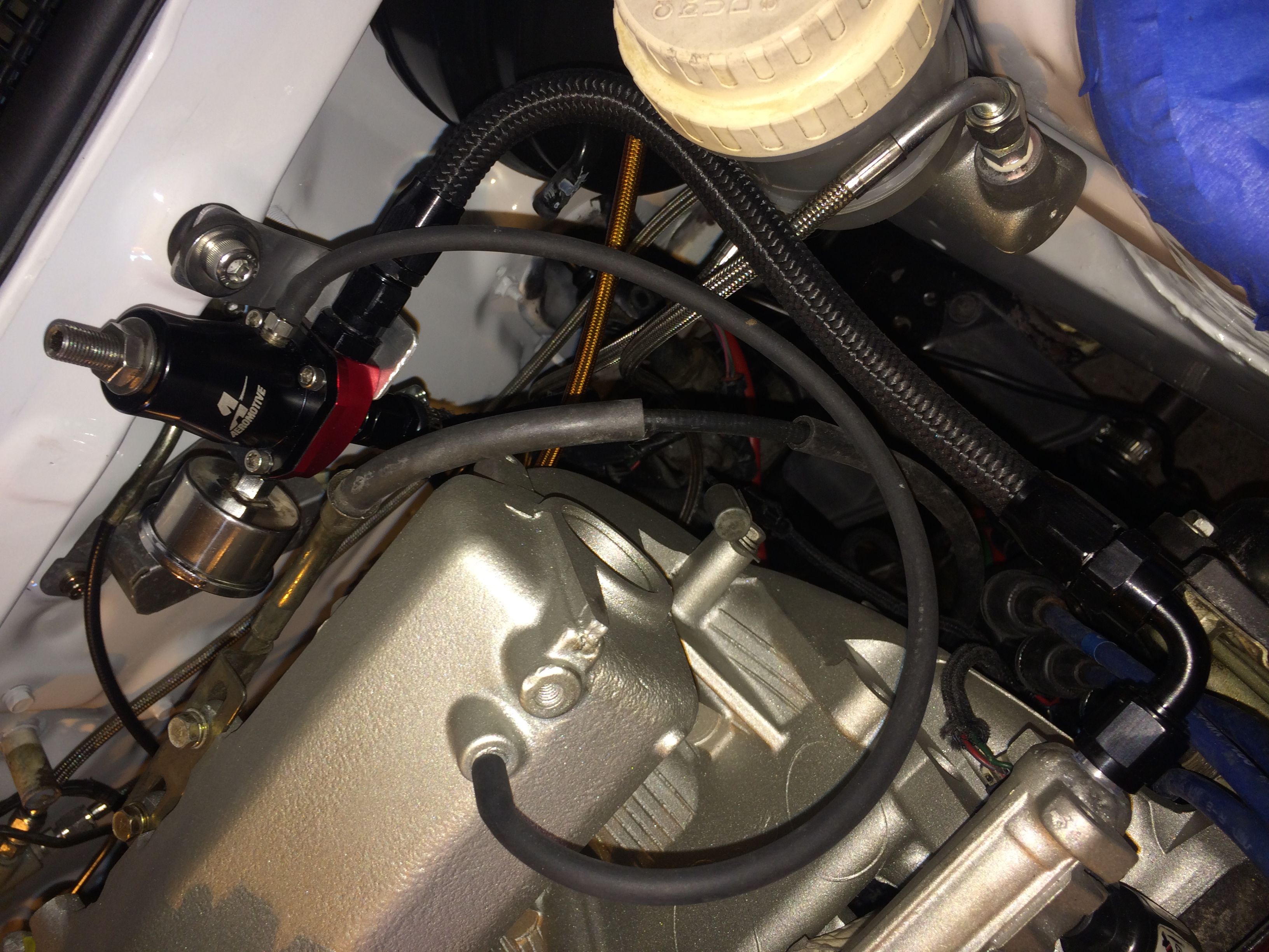

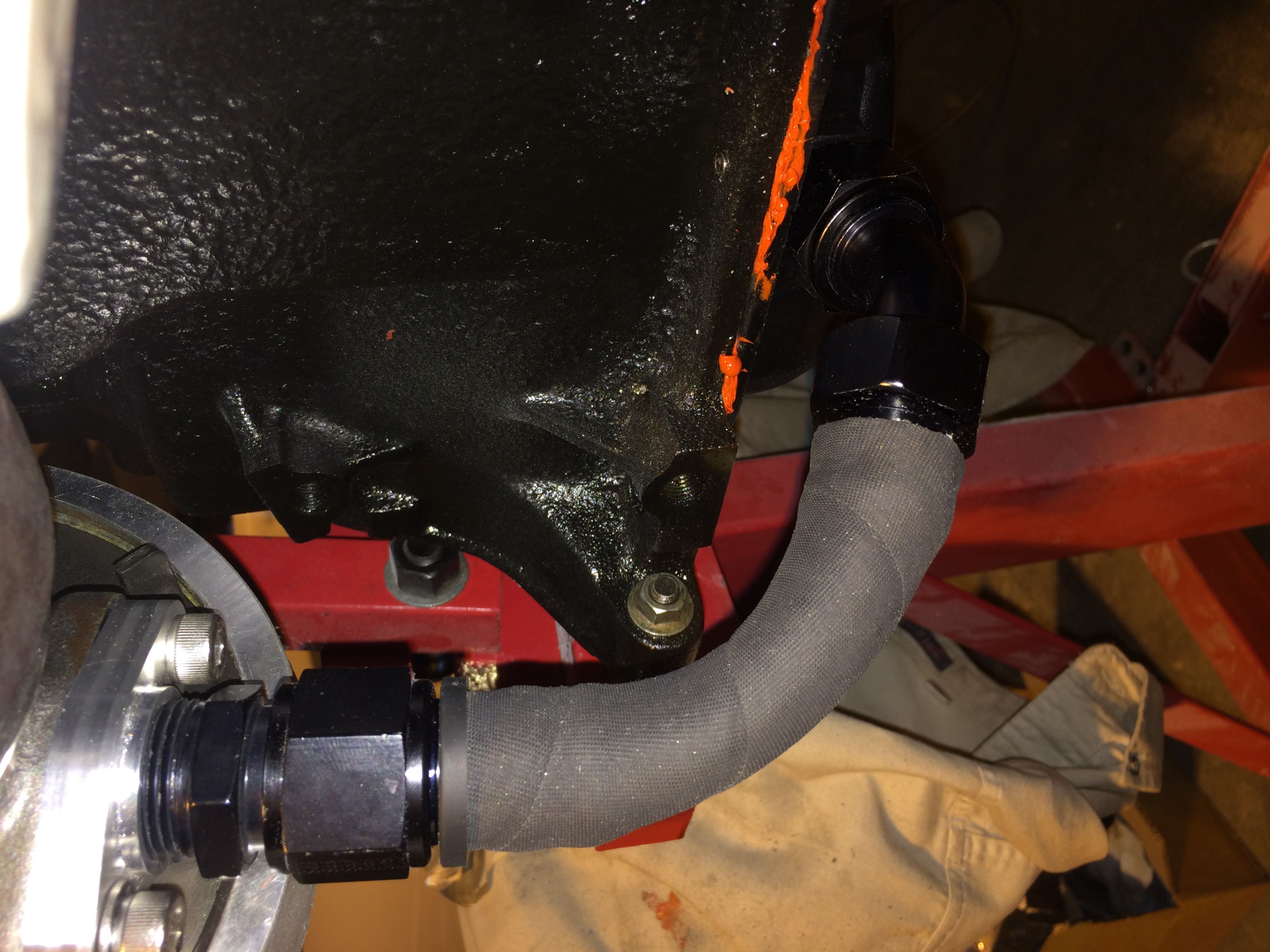

Installed fpr and made bracket for it, made drain line for holset, got new headlights.
I will be using ecuflash/evoscan for tuning.
HUGE shout out to Scott (CoxAbele) for spending hours on the phone walking me through the process. I owe you big time.
Here are some pics, enjoy! ( sorry for the sideways shots)

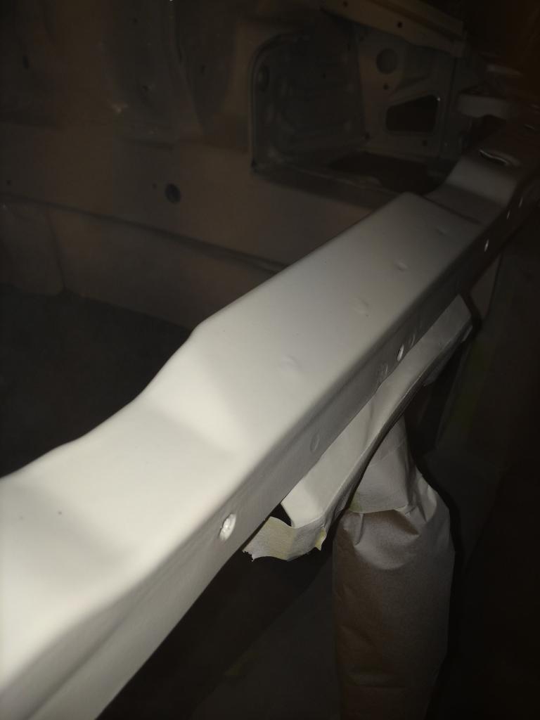

that white looks really good! have fun keeping it clean though haha.
also, why did you use seam sealer on the paint, and not on the bare metal (wouldn't that be stronger)?
The 3M seam sealer is meant to go straight over the primer or metal.
