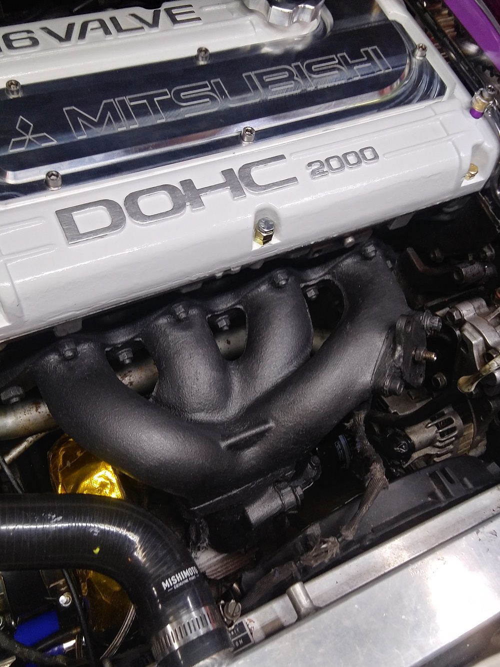

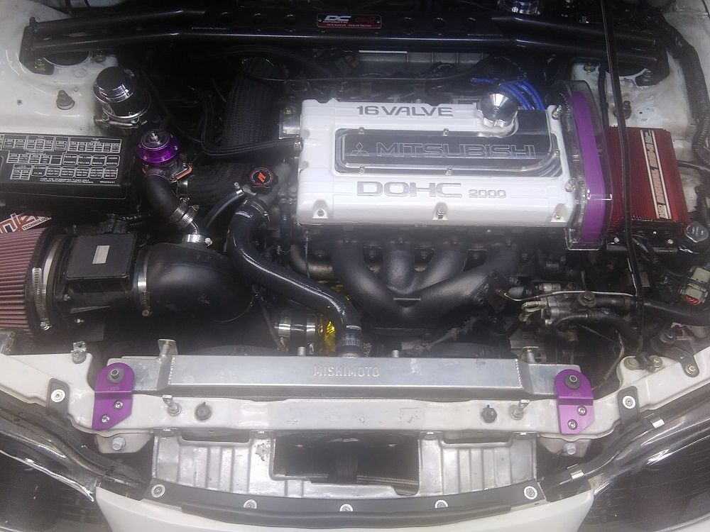

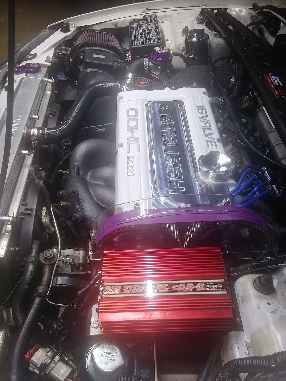

New pictures after assembly. Just waiting on some break in oil and I can fire it up. This has been such a drawn out difficult engine build and I am glad I did it, I got a lot of help here on the forum. Thank for all you guys who gave me advice.
Successful first start up! Too late to do the full cam break in 1200rpm for 20 minutes. No leaks idle is super consistent, no knock, ideal AFR, and superb oil pressure. Once the cams are prime I can do my first shake down. Fingers crossed i didn't miss anything.
Been driving the car alot today and everything is nearly perfect, each venture out i found something out of place. The air intake boot was sitting on cockeyed allowing un metered air in. The pipe off the turbo exit was bleeding a lb per second. Another was.t-clamp not tightened during reassembly:banghead:.
:cool:On a better note the motor idles better than ever. Even with the above issues the car still accelerated like a rocket .would post a video but for some reason i can't upload videos. Got about 950 more miles left on the break in oil.
Don’t think it’s necessary to break in the cams but no big deal. Glad it running good 👍
I kind of thought the same but i didn't want to mess up the head with all the new parts. My EGT gasket was leaking after a few cruises so I made a stainless 1/16 gasket at work the other day and been through 3 blt's so far LOL. I think that might be my worst issue is coupler leaks.
Been cruising the car a few times doing some shake downs with all the new upgrades and repairs done to the head. Found a coolant leak to in the loop line FIAV ports on the engine annoying due to me using the very expensive genuine mitsubishi long life coolant, those of you that use it too know exactly what I mean $$$. The charge system holds my boost setting with no bleed off. I ended up taring down the whole charge system and using light amounts of hair spray in the ID of the joiners which was a trick I used on my neon that never failed (god help you when you disassemble...)

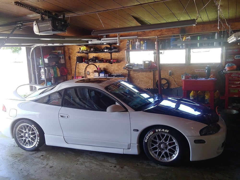

With the engine work done the next thing to do was to get the 4 months worth of garage dust cleaned off. So I called in the pro and future owner .

Gotta love your little helper Gal!!!!! I bet you are smiling from ear to ear now that the car is up and running! Good job and very rewarding feeling!!! :thumb:
Marty
Man it is always fun to help out others and see it thru to the end. For me, that part is rewarding. Never fear, if you have a question that I can help with, just hit me up!

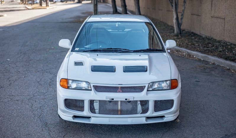

I do use Instagram only because I can control what I see, with Facebook its usually always crap, politics and everything hateful. I was apart of dsmtuners years ago when I had my 2 gsx's but stepped away for a while to try out other cars/bikes. It feels good to be home though LOL got me a Evo 3, 2 weeks ago and I'm in love 😍
thanks brother, but I too have a couple of "unofficial questionable fixes" too LOL.
Dude you have to upload some pics of the Evo 3 thats an incredible find!!!!
