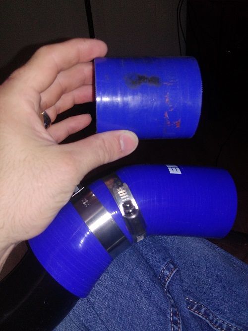

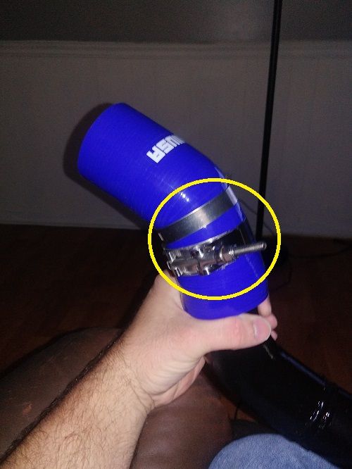

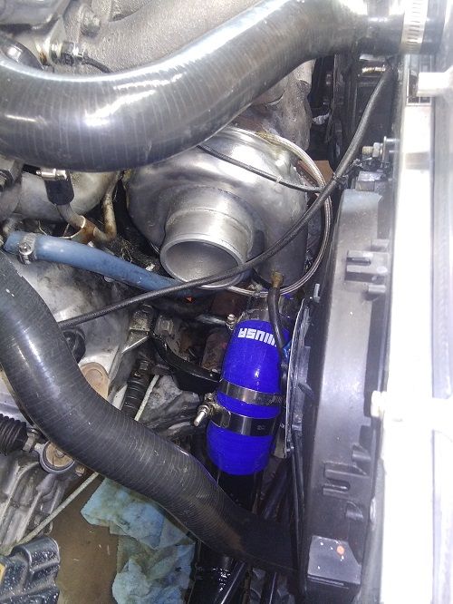

A few days back I mentioned fixing some problem areas in the IC plumbing. I cut the pipe to a better angle and welded thicker coupler cusps around the tips of the pipe and ran a long 45 instead of a straight coupler at the joint and doubled up on clamps for each end to insure no leaks will return in this area. I'm using 1 t-clamp paired with a stainless hose clamp on each end.
I'm trying out a new brand to see if they are any good. I'm only willing to buy couplers from them for now. They 4 layer with 3 rows of kevlar stitch. Already ran my BLT and everything sealed. Now to see if they can handle the heat and 21 psi.

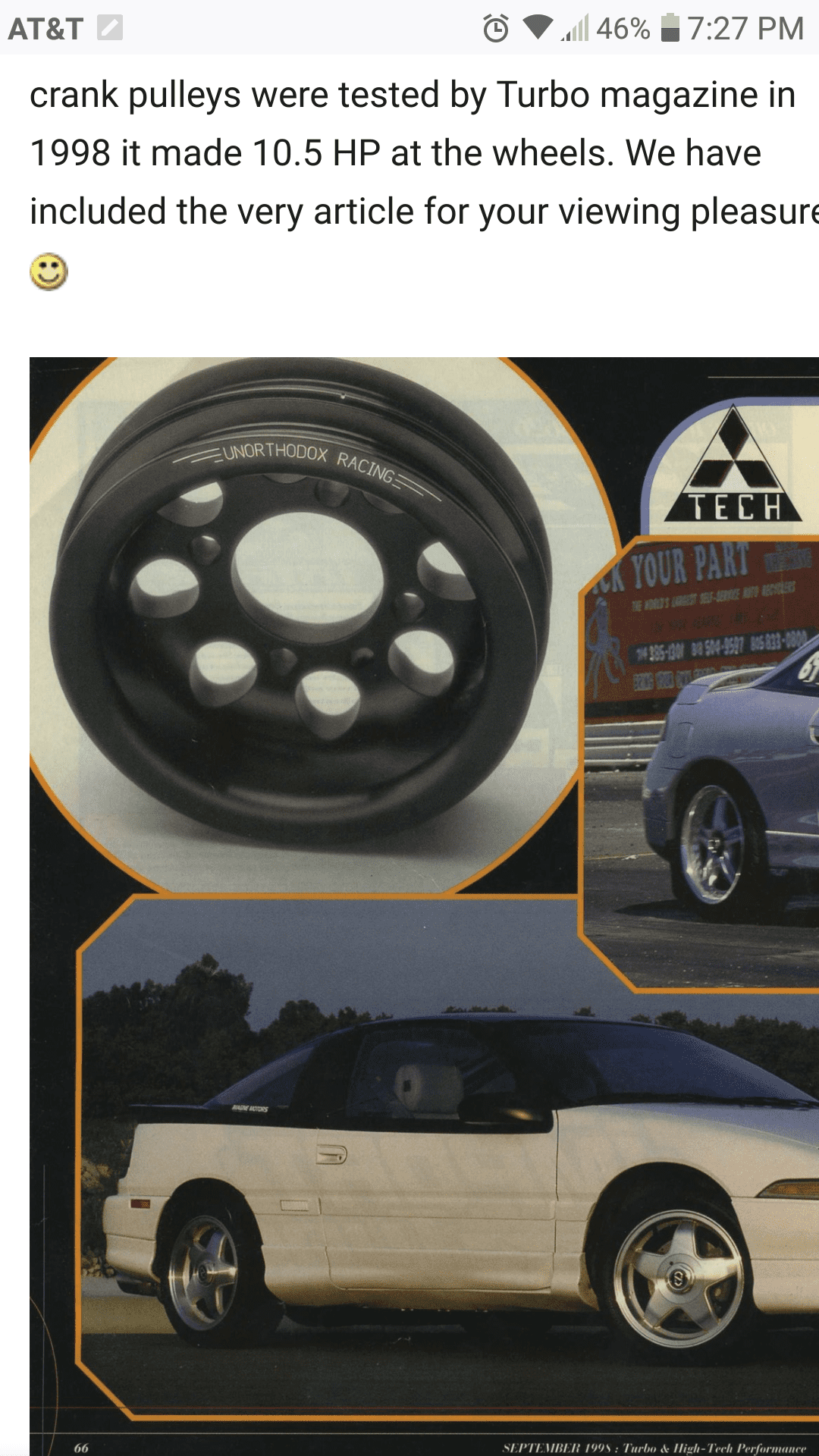

I found a bonus performance part i didn't know i have checking the timing yesterday. I noticed that the crank pulley was etched and never paid any mind and read it, turns out it is a very popular well made crank pulley by a company called Unorthodox Racing.

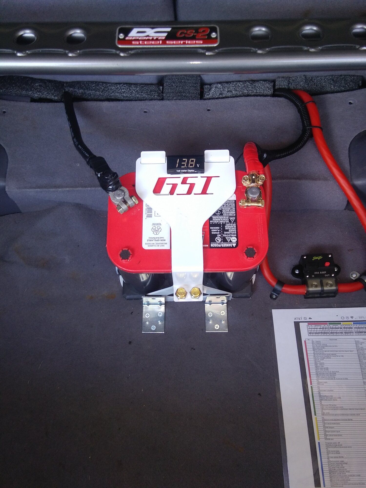

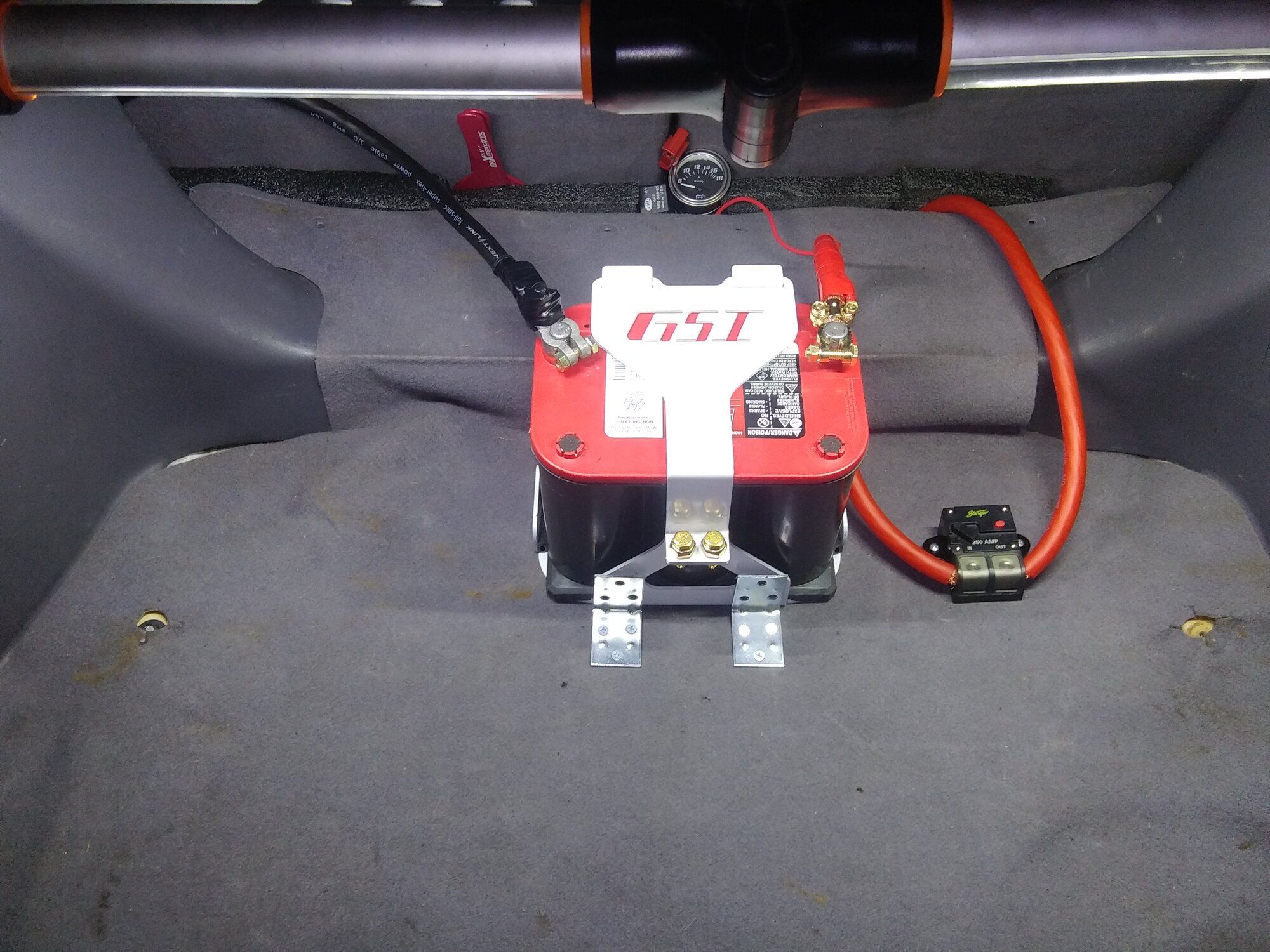

My battery tray unfortunately started to rust, i suppose i expected it due to it being cold roll material. I decided to wet sand it and put some paint on it. Seemed touch up bright white was the the appropriate choice to go with for the interior.

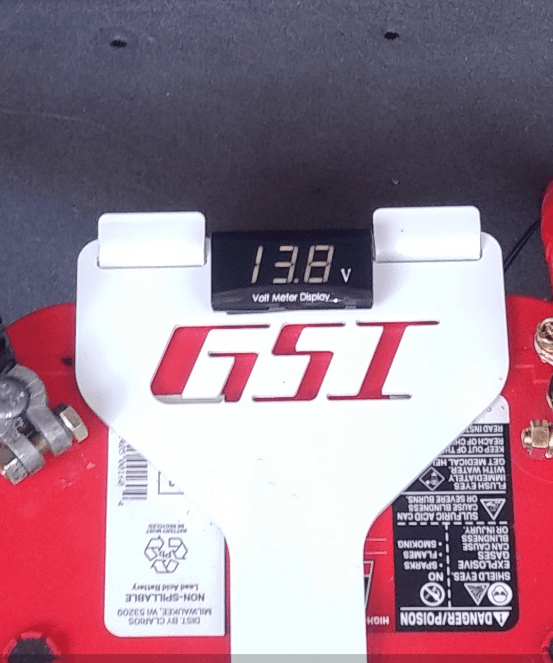

The odd guage behind the battery is direct volts going to the fuel pump. The 4 post relay for the fuel pump rewire is next to the gauge along with the inline fuse. Went with that guage because it was just laying around and seemed like a good idea to get a constant reading on the fuel pump current. Most likely will replace it with a small digital readout eventually to make it look a little more high speed LOL.

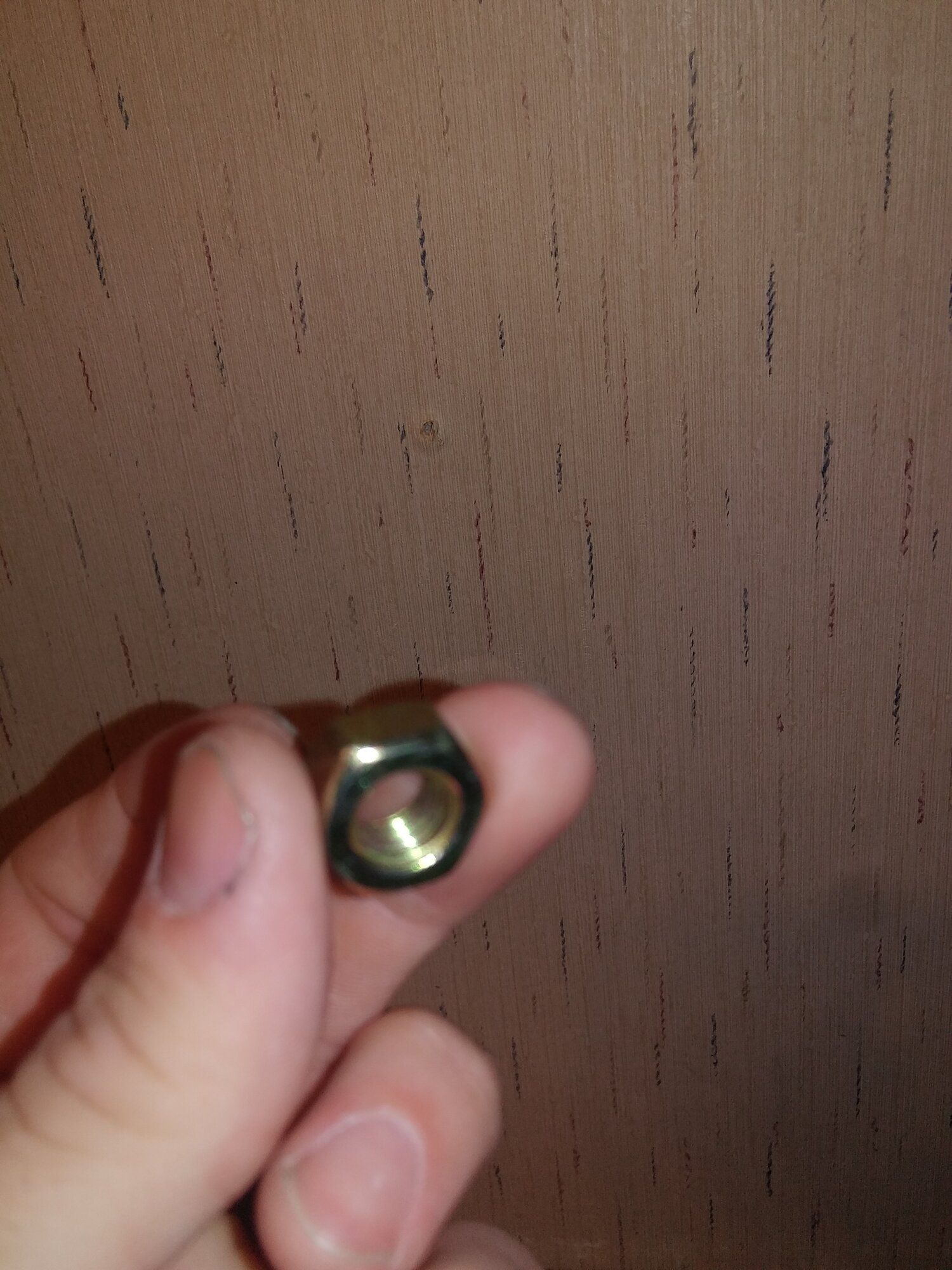

So the new update is just me making fun of myself. Been driving the car alot and started having slight grinds, and not able to get into second gear, same issue with 1st every now and then. I suspected the worst immediately. So upon checking the interior cable links i found something sort of embarrassing. When i replaced my boot and inspected the linkage a while back a nut fell into the shift assembly. Now im not scared of having to rebuild the trans again or put new cables and bushings in i got thw repair for free. I found this to be very funny and feel dumb all at once. It wasn't a small nut either.

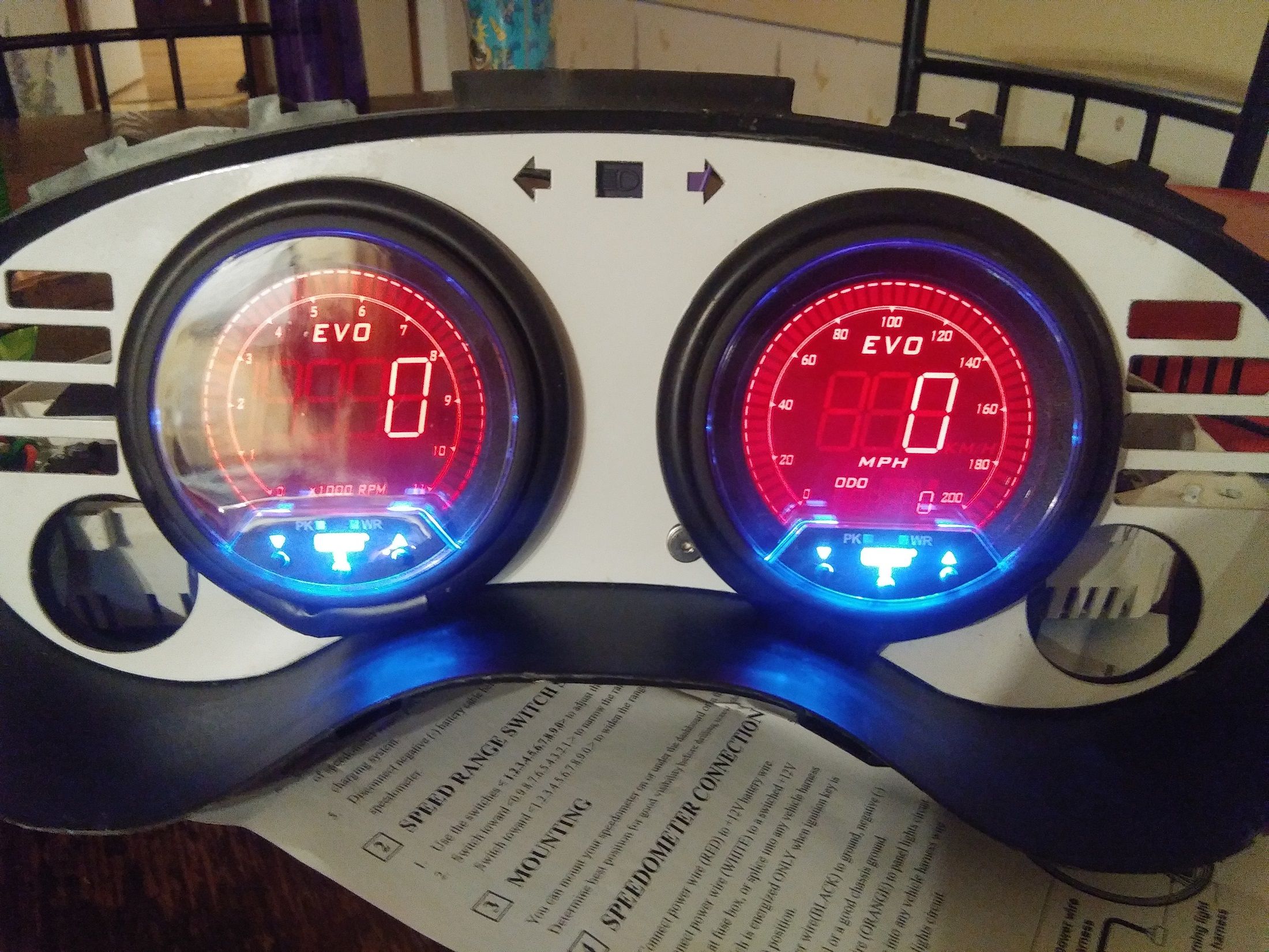

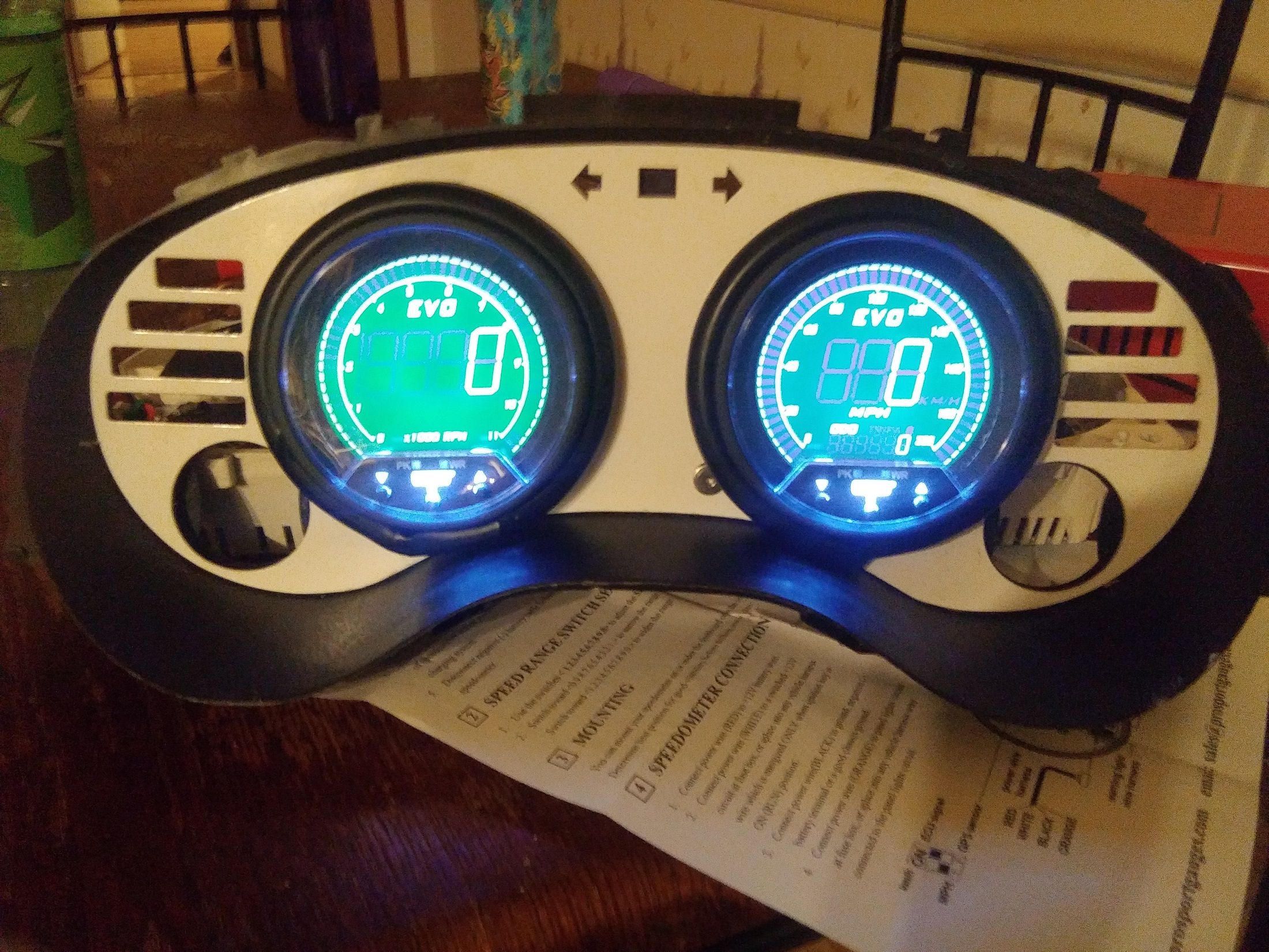

Where did you get THOSE???
I purchased them on the STM tuners website linked here on the forum. They are called the "Prosport Evo series" the speedometer is a fast signal GPS while the tach is just hooked up like a traditional tach. I made some mods to an extra instrument panel to fit the gauges inside there. They work really well hope this helps.
Here is a link to the speedometer. If you need the GPS sensor it is sold separate on the same site and the size is 85mm OD for both tach and speedometer.
