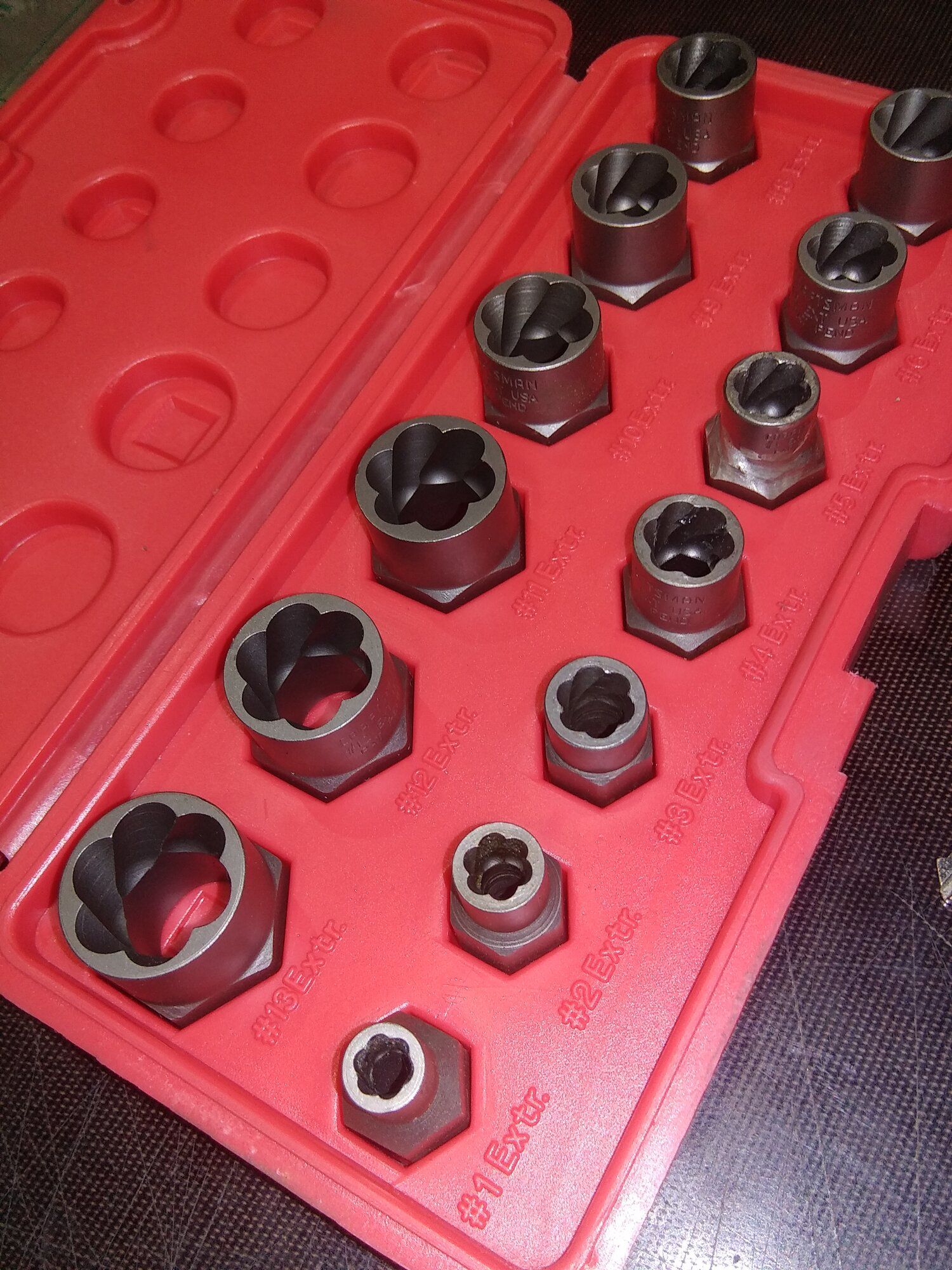

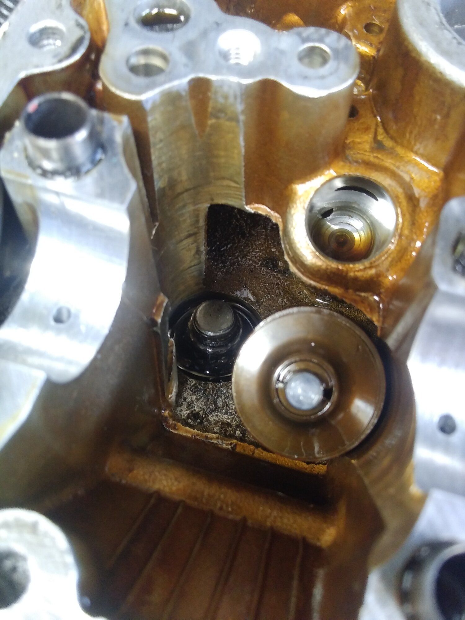

Ran into a snag damn ARP nut got slightly rounded. Used a cheap 12 point 13mm socket to save time so i didn't have to track down where i set my good one and now im paying for it. Need to get a turbo socket extractor to finish the job. Lesson to learn here, use the highest quality tools you have on the internals!!!LOL
On a better note
Yikes!! Didn’t know the 2g’s use 13mm nuts. Good luck getting it out man. I’ll be praying to the dsm Gods 🙏
Thanks! All good man been down this road 1 other time but i wasn't the idiot in that story LOL. I just will need a new ARP nut to replace the one im going to destroy with the extractor. On a better note im getting both surfaces decked for 80 bucks. Its good to have a machine shop buddy LOL
Dang it! I’d just go oem composite. Ran a copper hg on my 2g for a long time without any issues at 25-28psi.

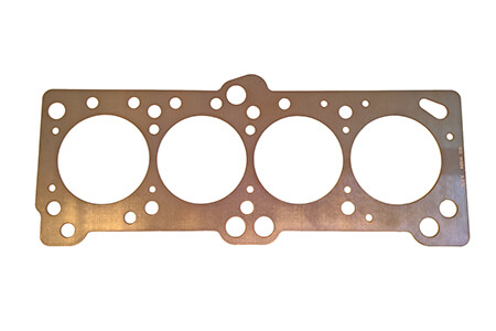

I found a copper gasket for 105$ is that good or is it too good to be true? I started researching copper hg's and they form to the surfaces really well I think I want to go that route. You used to drag your 2g and it held up well at 400whp with copper. Sounds like a winner.
Not sure which brand I was running because I had a shop do it back in the day, turbotrix. But yeah it held for more than 60k. It was my daily and drag strip’d almost every weekend.
Jeff, I don't recommend a copper gasket for street cars or unless you have the block or head SS o-ringed. Copper gaskets is very good to seal cylinders if you have the block/head SS o-ringed w/ groove. but generally it would give you more sealing issues than composite or MLS gaskets, especially on coolant and oil passages.
If the car would be used often on streets, it may bother you often.
Thank you Hiroshi that really helped a bunch. I will steer from copper as suggested. I dont really beat on the car but id really like to put this HG issue to bed for several years with a good dependable HG.

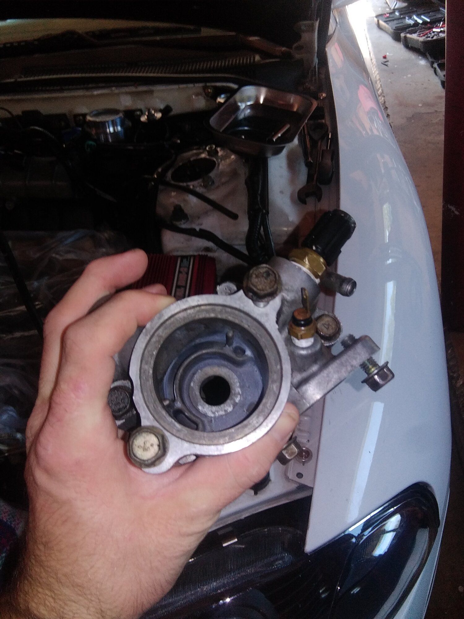

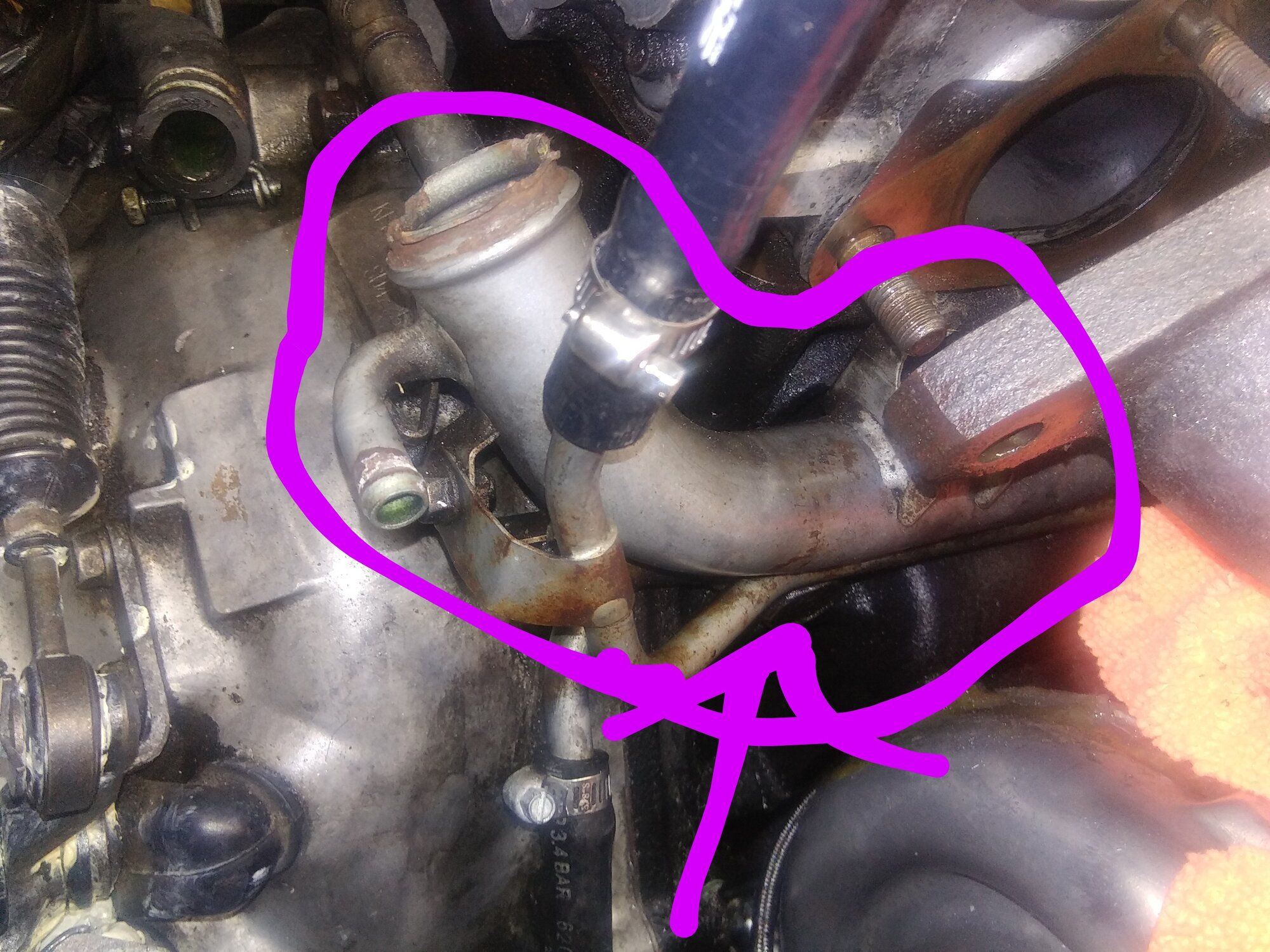

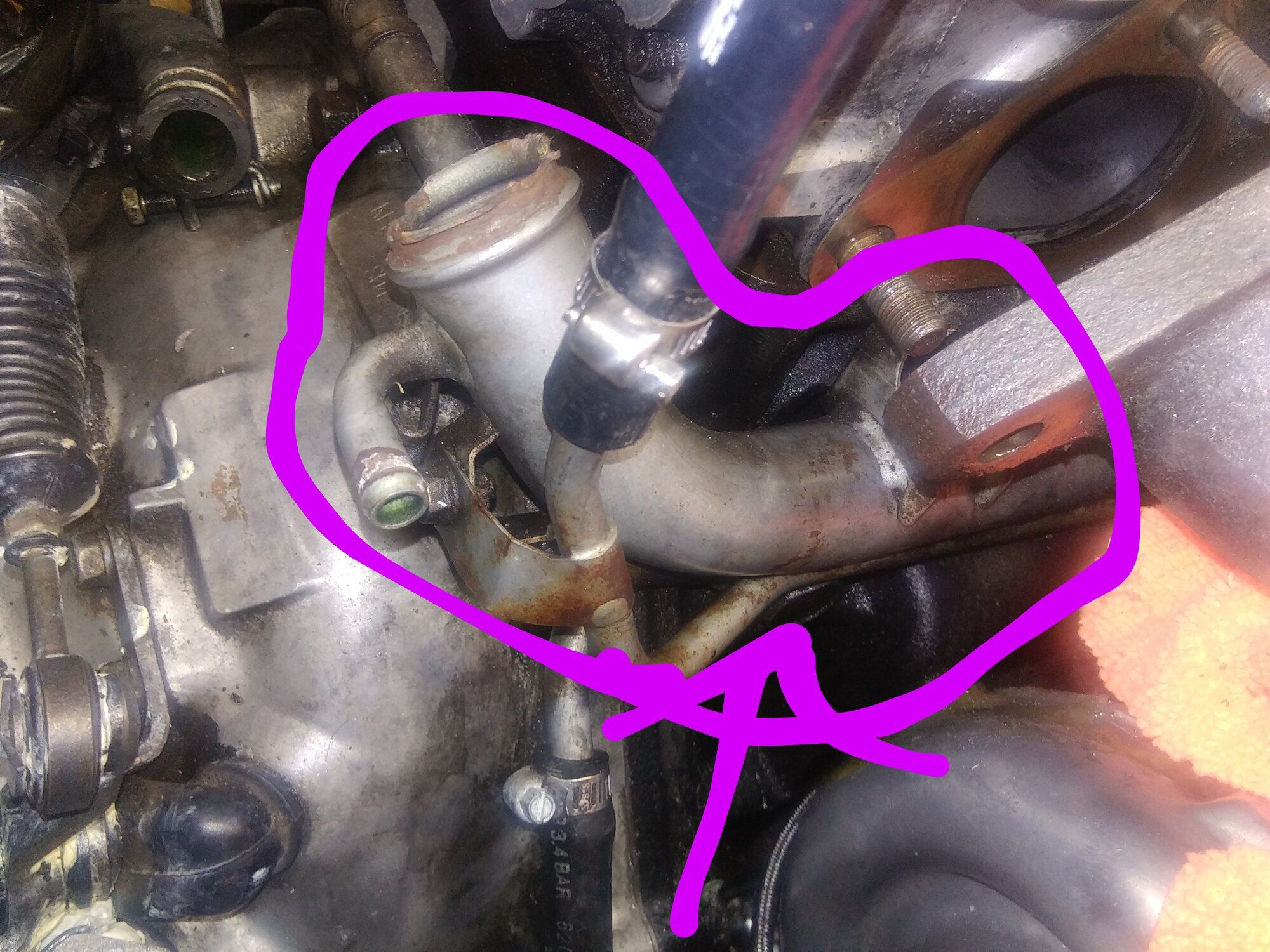

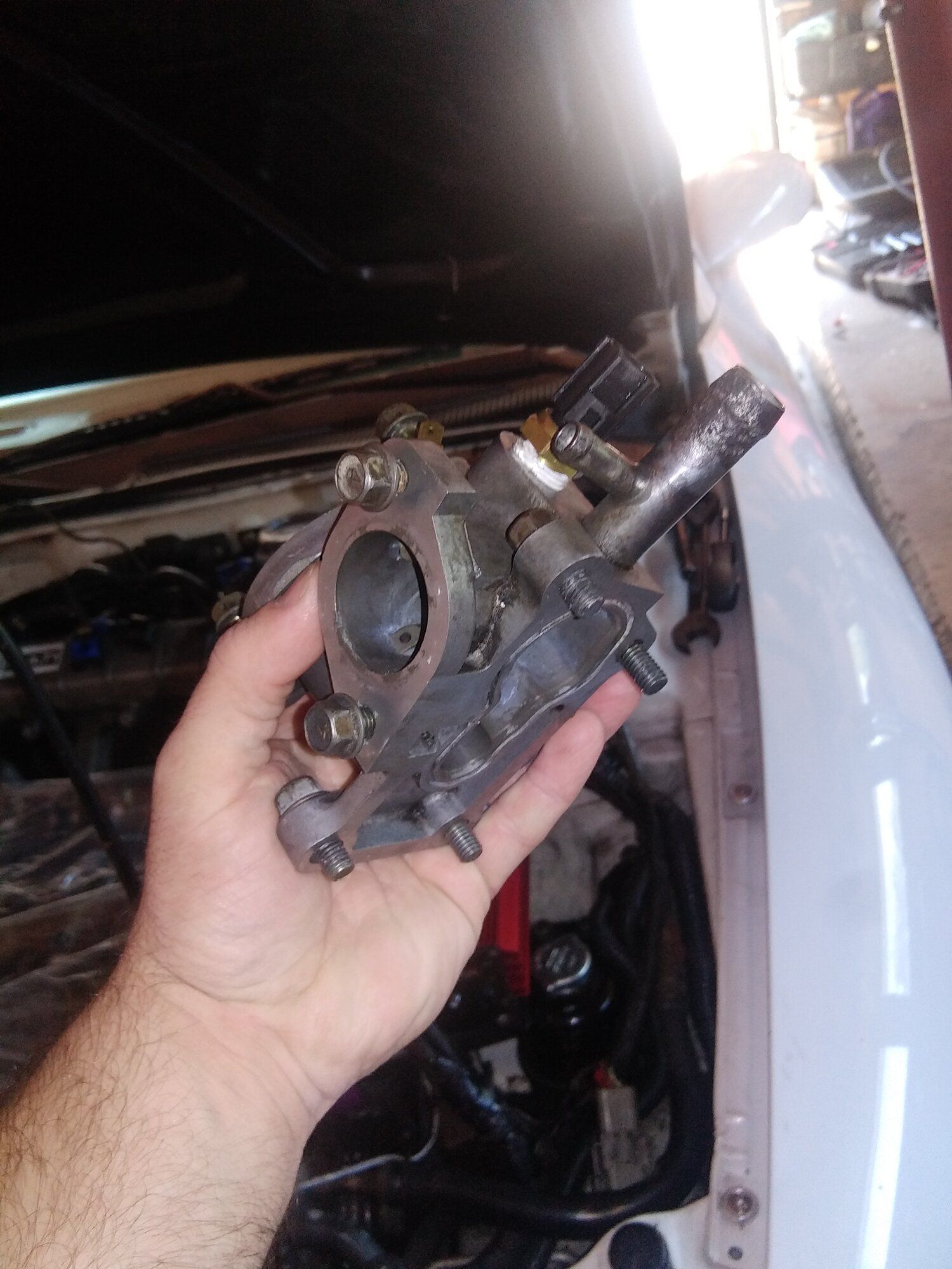

Having trouble finding this guy here. I think when the HG went and or the head gapped, boost went into the cooling system and blew out a weak spot on the male end that plugs into the therm housing plumbing. The flange section seems to have rotted away and the gasket on it was beyond destroyed.
Having trouble finding this guy here. I think when the HG went and or the head gapped, boost went into the cooling system and blew out a weak spot on the male end that plugs into the therm housing plumbing. The flange section seems to have rotted away and the gasket on it was beyond destroyed.View attachment 638935
Yeah I’d source a new/used one. See if performance part out has one.
