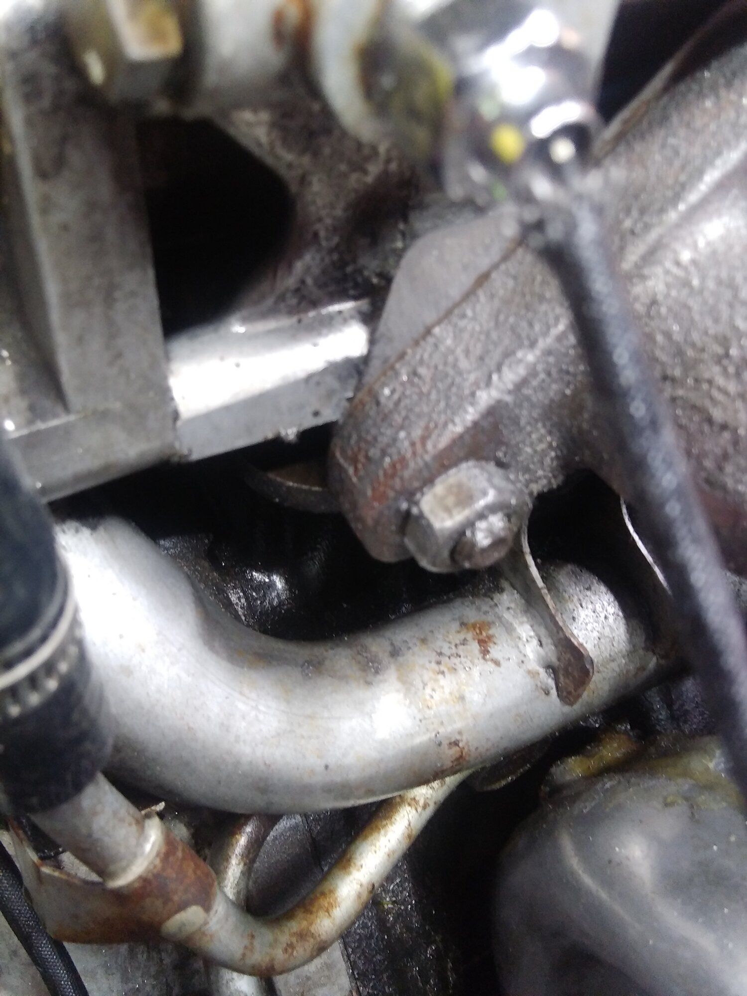

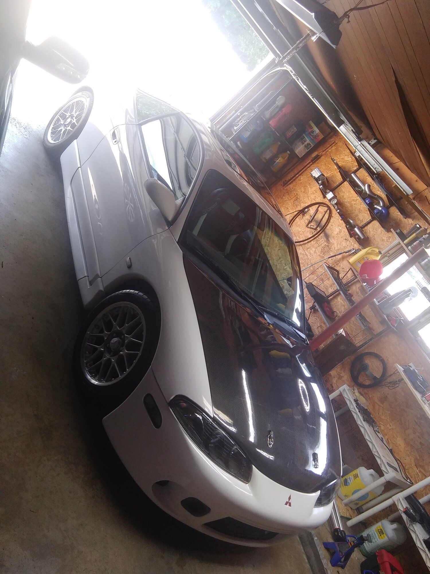

Cracked into the car today to do some touch up maintenance. Did a shift cable inspection greased all the necessary components with super white lithium grease. Got a little vac gremlin im chasing.

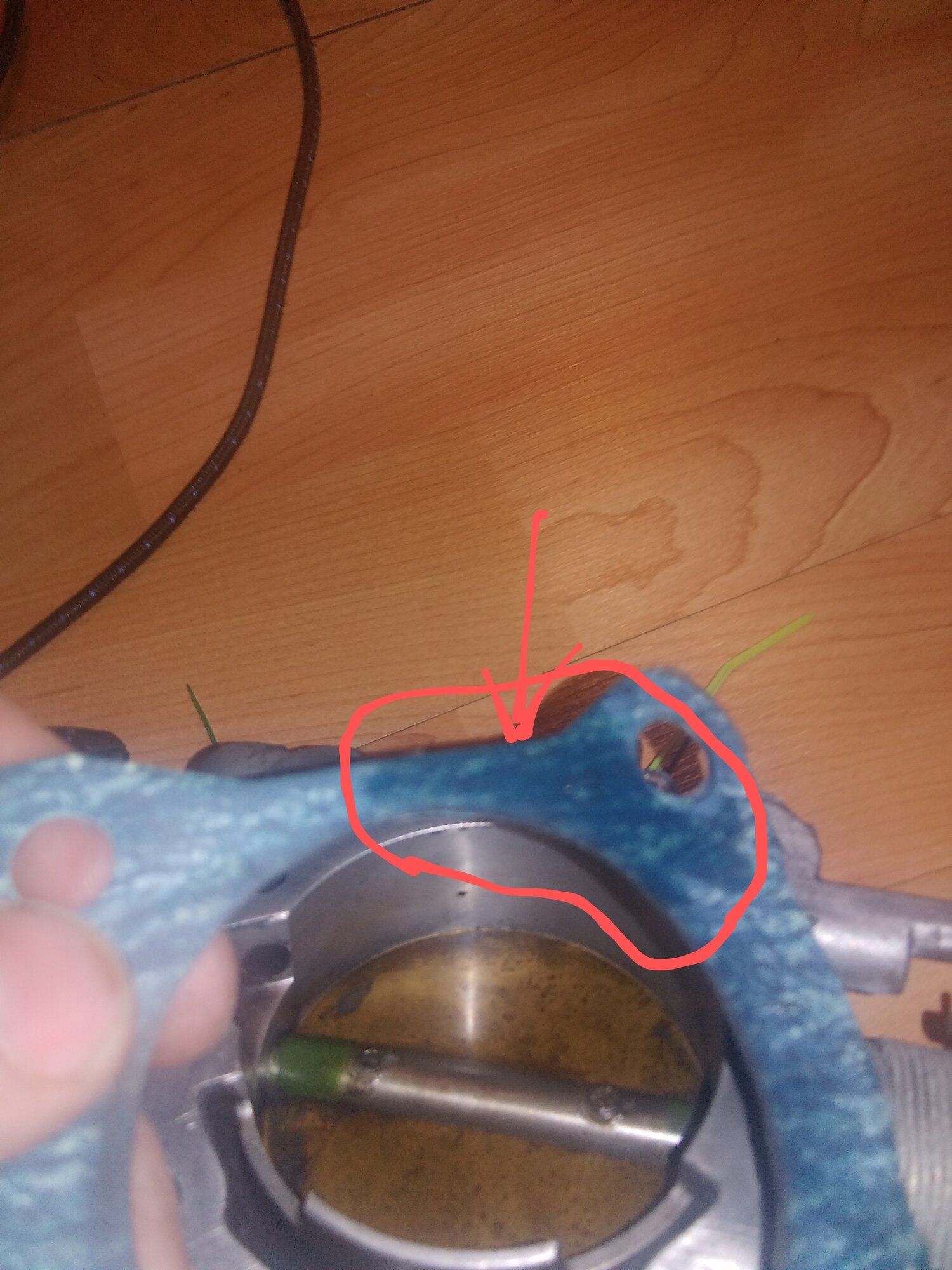

Got curious and upped my boost to 21 psi with my profec made the car feel like a rocket but short lived cuz it induced a vac leak somewhere. In terms of air lines i use Vinrant brand hoses which i believe to be good quality. On inspection there are to damaged hoses so i think the TB housing might be leaking.

Just fixed another vac leak. I put air tool oil in the compressor and the oil shot out of the the leaky spot making it wet. Added some rtv to the gasket front and back to hopefully seal it. The vac gauge was jumping all over the place at idle. Looks like about 20% of the surface was leaking on one side. My slow boost build and loss of power in all rpm ranges makes sense now.

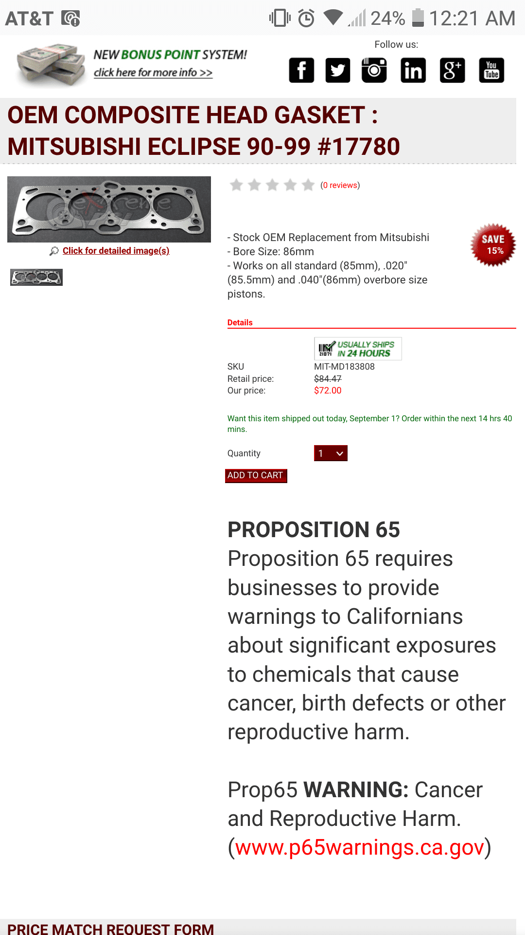

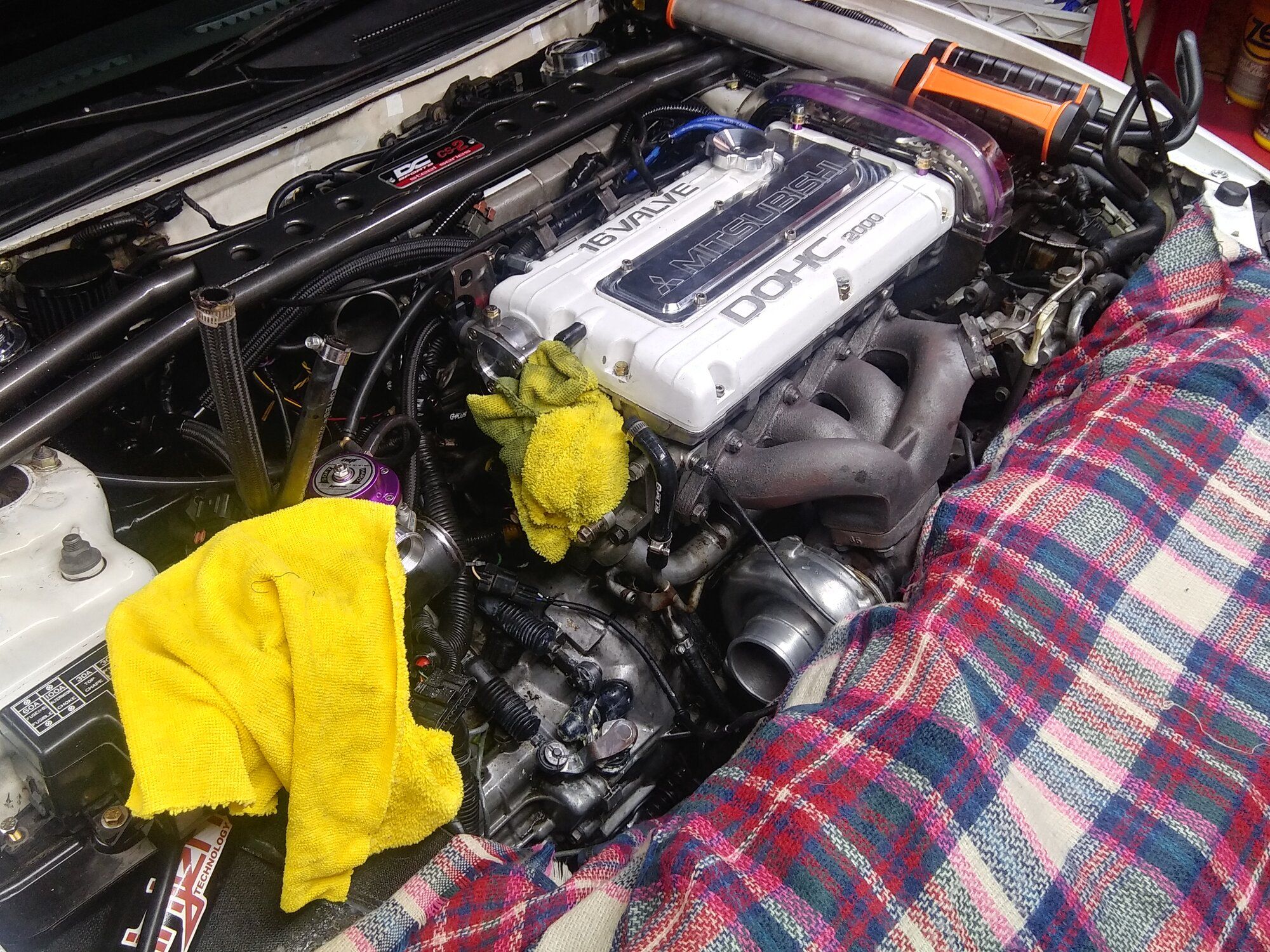

I used aftermarket the past time now im going to just use OEM. The output is slightly under 400hp but i hear the stock gasket is one of the the best if not the best choice. Any thoughts or advice on HG choice or opinion is very welcomed id love to know anyone's opinion on the subject who has experienced premature HG failure. Coolant is drained and most of the passanger side is disassembled and will continue early in the morning.
