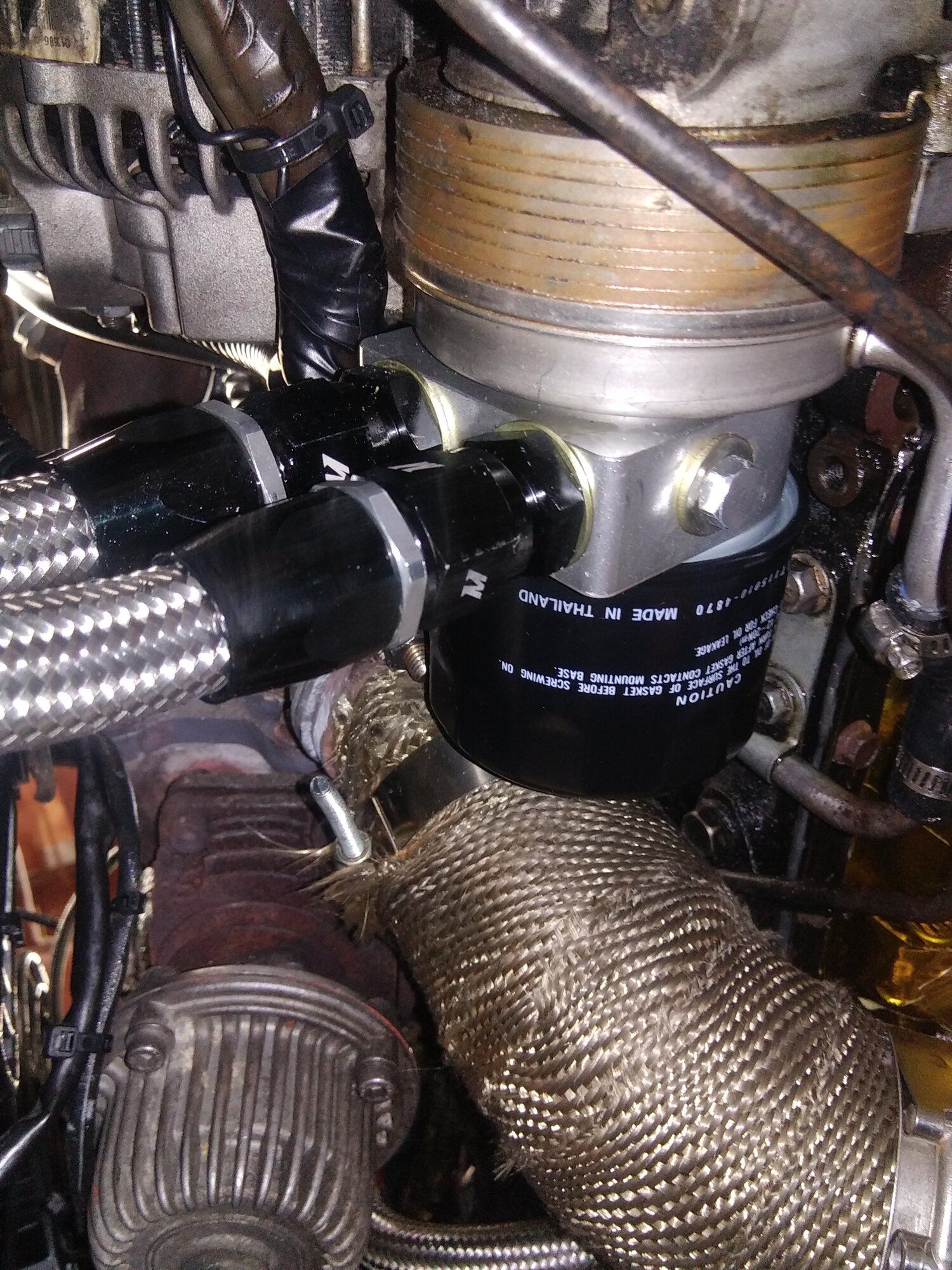

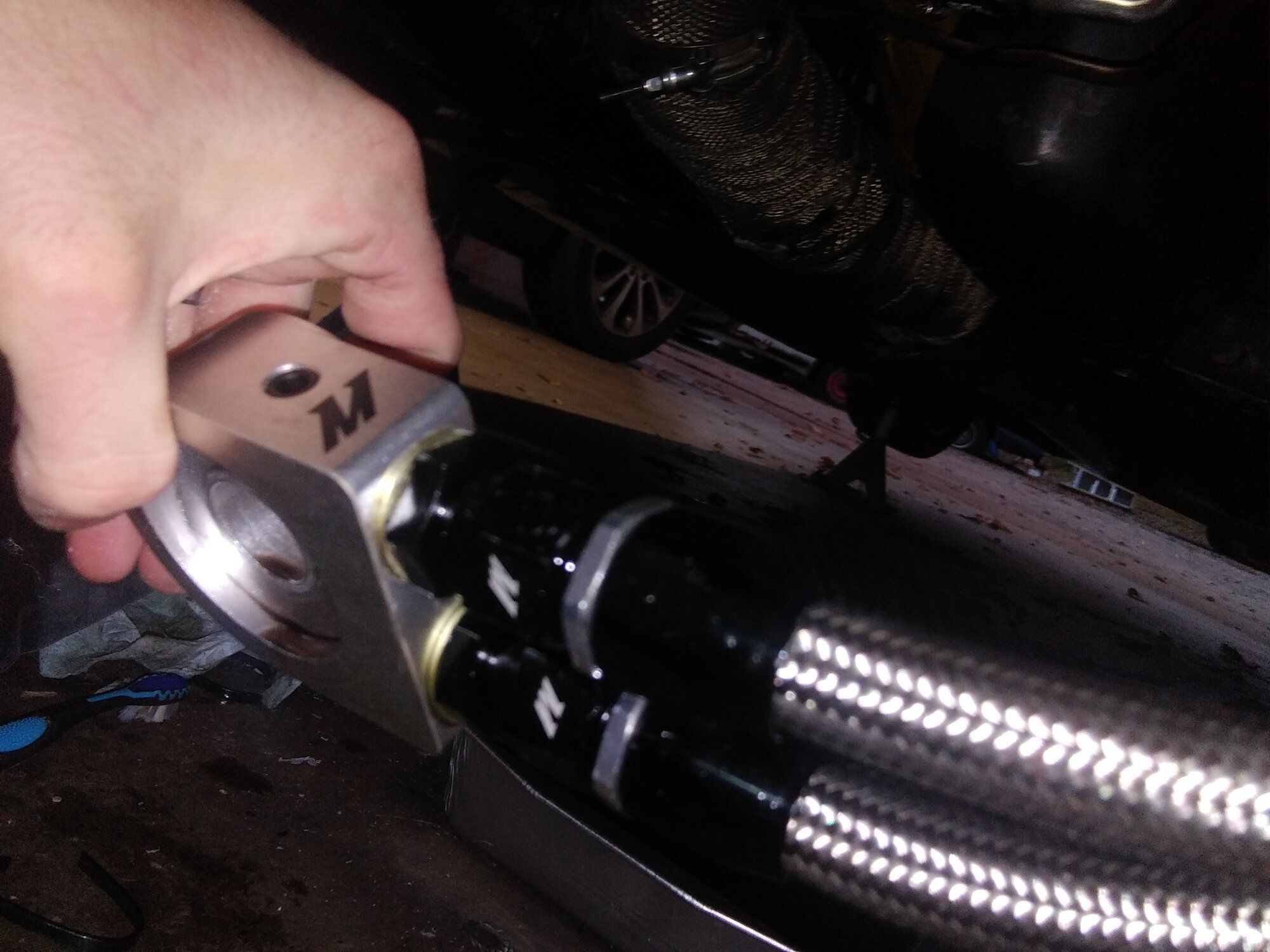

have some stuff going on with an oil cooling system that im sorting out but got the means to make the Mishimoto sandwich plate fit for the application and will make another post on the subject after the charge system is fixed.

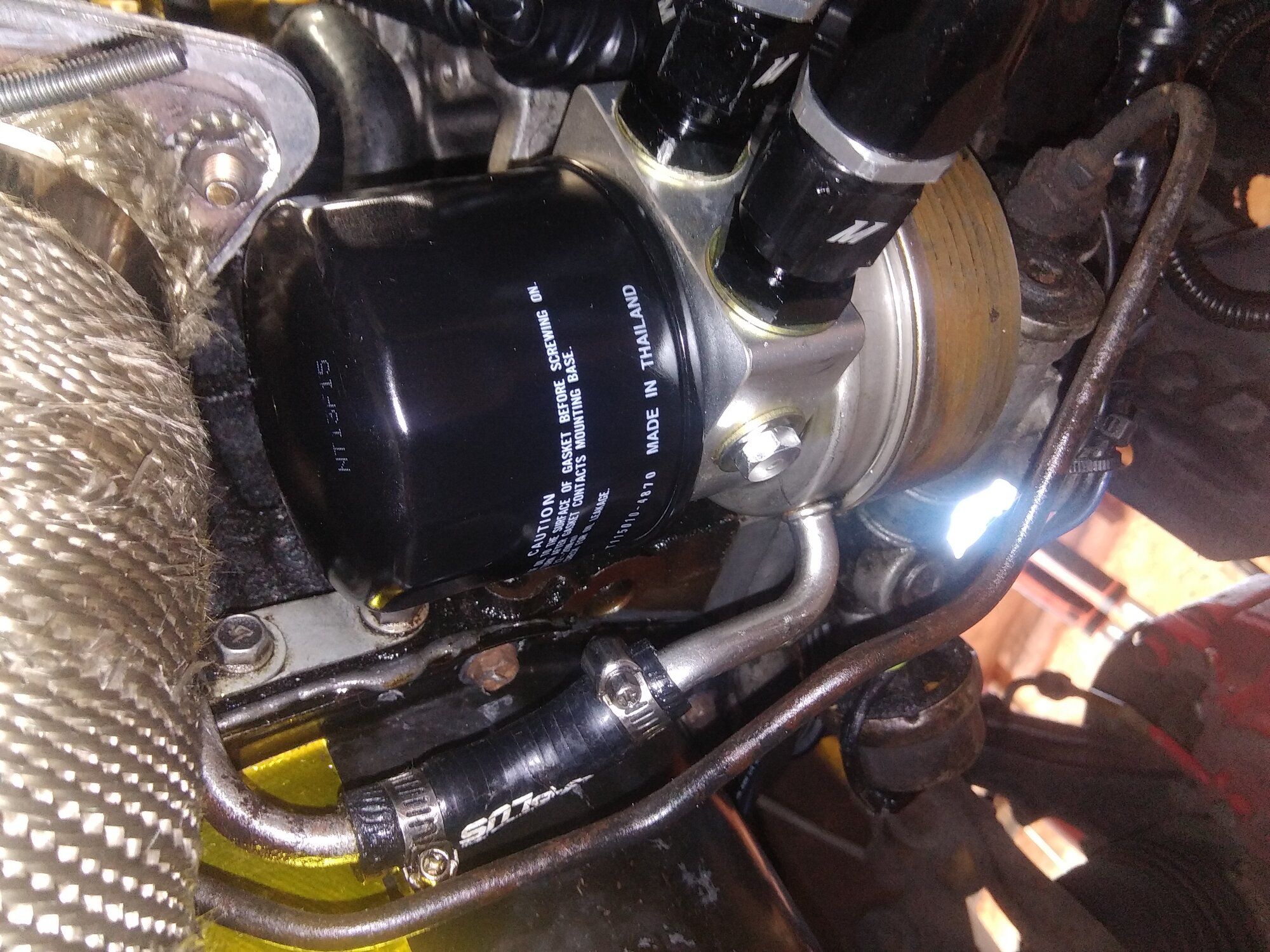

Can't get a good pic of the oil cooler its tucked up in the passanger side fender. And im running these lines across the front so it has plenty of time to cool down before it returns to the housing. I just have to install the adapter plug and put on the filter but I think i will sit and watch a movie with the kids first LOL
You can fit that adaptor? I just remember my 2g had no room between the oil filter and the downpipe. Always had to use wix iirc.
Cut the down pipe and changed the angle slightly. Got a 1/4 to put the filter on and about 5/8 from exhaust bolt when the filter is tight. The down pipe is wrapped with Tomei wrap. IMO they make the best quality wrap. One other thing i did was use the 3000gt oil filter. It's shorter and fatter. It would definitely be impossible with the oem 7bolt filter on there.
