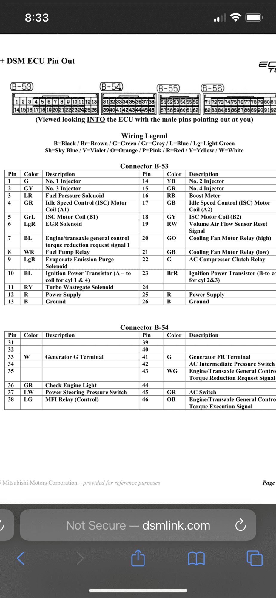

Lol. Here’s the entire pin out if you need it.

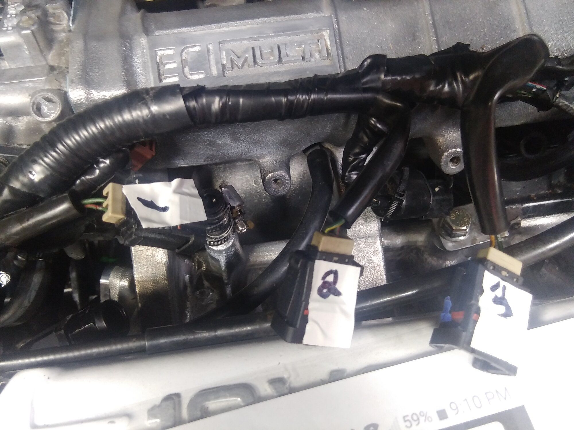

I’m thinking that I too swapped 2&3 instead of 3&4 when I put my engine back together. I didn’t drive it but idle was fine, just had a longer crank. Think it’s because there’s fuel behind the closed valve so it sucks it in during the intake stroke. I’d imagine that driving it would be rough though.

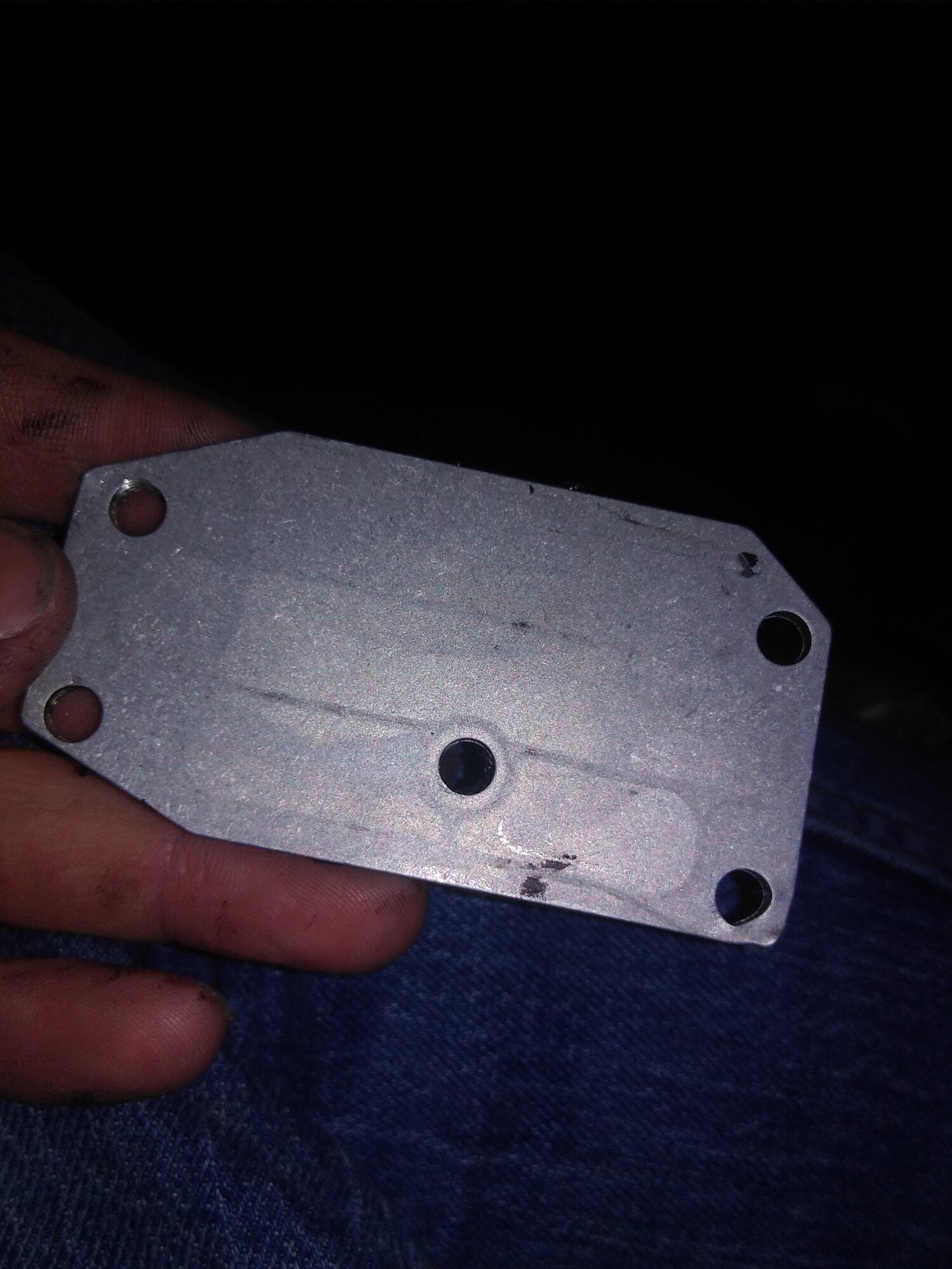

I pride myself on honesty and this one i feel i should post because is so if anyone else does this they know what will happen.
I have Both the FIAV block off plate and bypass plate. I bought the block plate by accident so i ordered the other. I rebuilt the TB again while rebuilding the head and decking the engine surfaces. I had the plates together in one area along with the hardware. I ended up installing the block off plate....
:banghead:
If you do this without compensation via tuning your car will not idle its just like deleting both ISC and FIAV. The bypass plate is now in and the idle is now normal and i cleared the cel. I need to stop working on stuff all the way to 4am on my projects. I have a lot of stamina but apparently my brain gets funky when i work for too long. I need to start taking breaks.

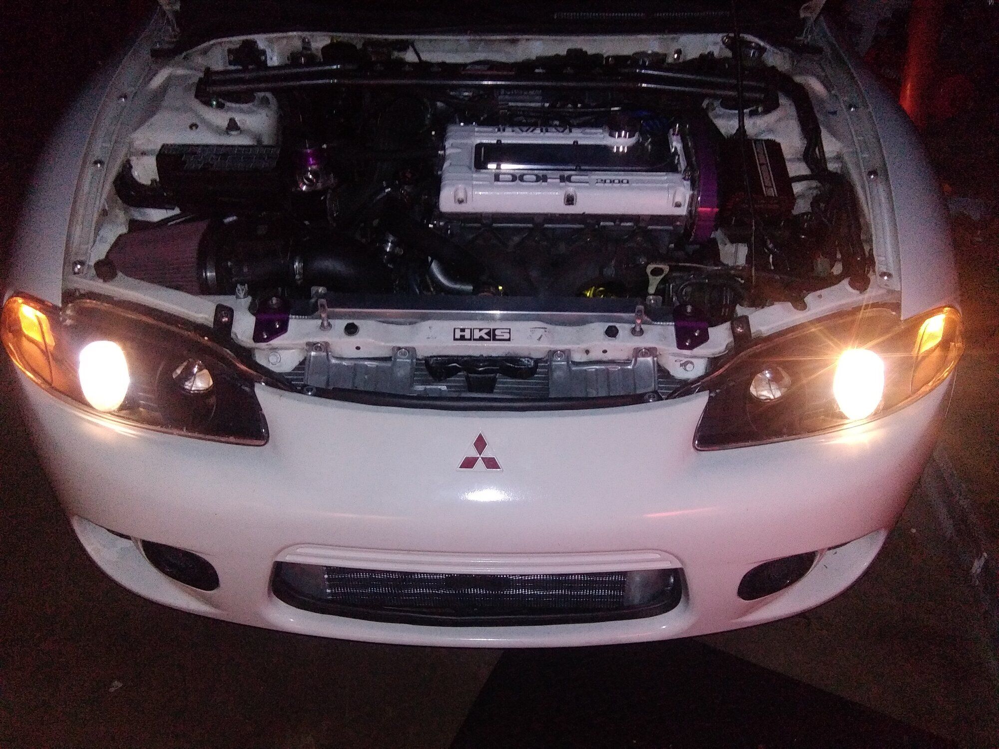

Doing some easy stuff. Had a dead headlight and grabbed a pair to throw in. They are just a standard halogen nothing fancy, I tend to save the big expenses for engine upgrades and general maintenance.
