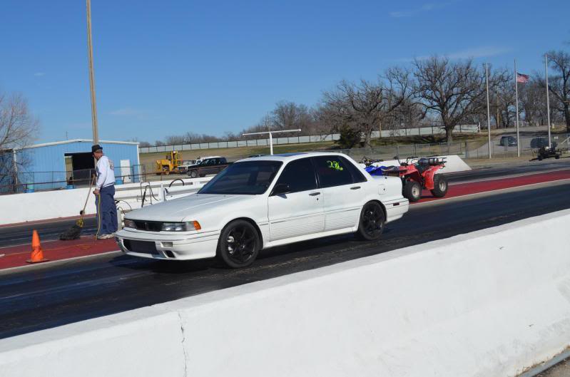

Finally got it lined out enough to see how it would do at the track. (i knew it wouldn't launch well)
(stay tuned for video)
but anyways, it only did a 12.5 at 125 because it 2.6 60 foot. Car only foot brakes to about 3k which only builds about a pound of boost. LOL.
SO im gonna but the bottle to IT :)
Smaller turbo/twin scroll setup would do wonders with the auto and wouldnt need nitrous. Awesome setup nevertheless!
trust me i have been thinking about it.... i wanna go bigger turbo anyways so i would need it.
but for now the NO2 will get my by.
here is the video from the trackday... man the 60' is painfully slow but it comes on hard and strolls out, just to little to late for any kind of decent ET

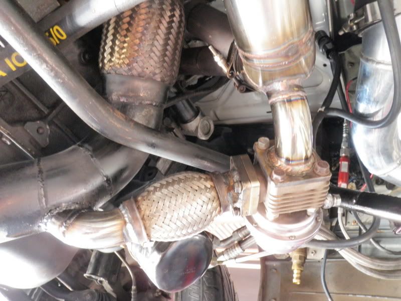

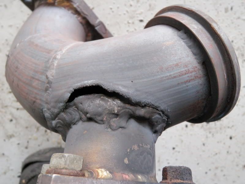

the old nasty exhaust manifold blew out...
got it all fixed up with some thick SS, even went a little larger pipe to help flow, also recirculated my wastegate while i was in there.

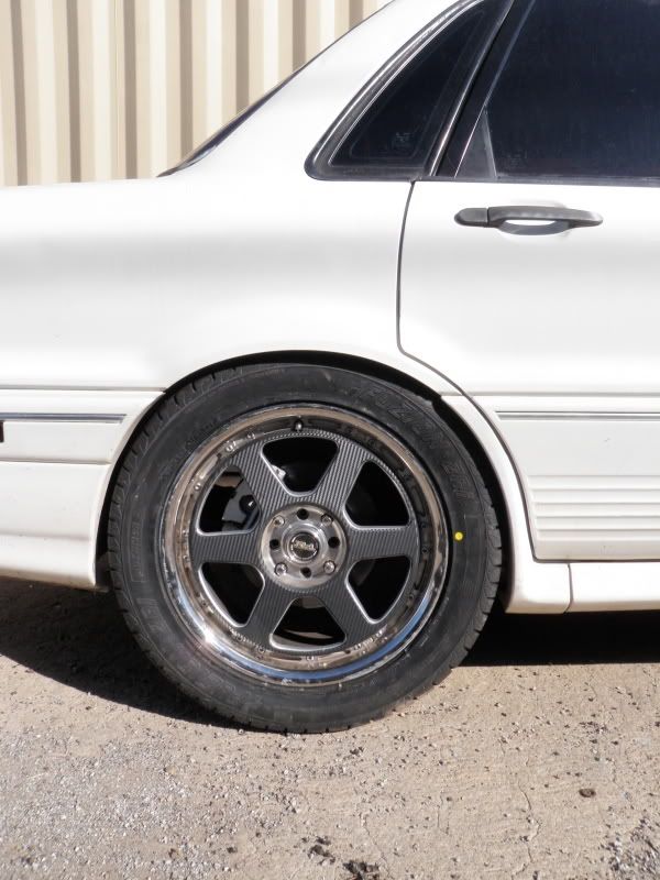

new tires. YES. old ones were 24.6, these are 26.1
needless to say it fills the fender opening quite adequately

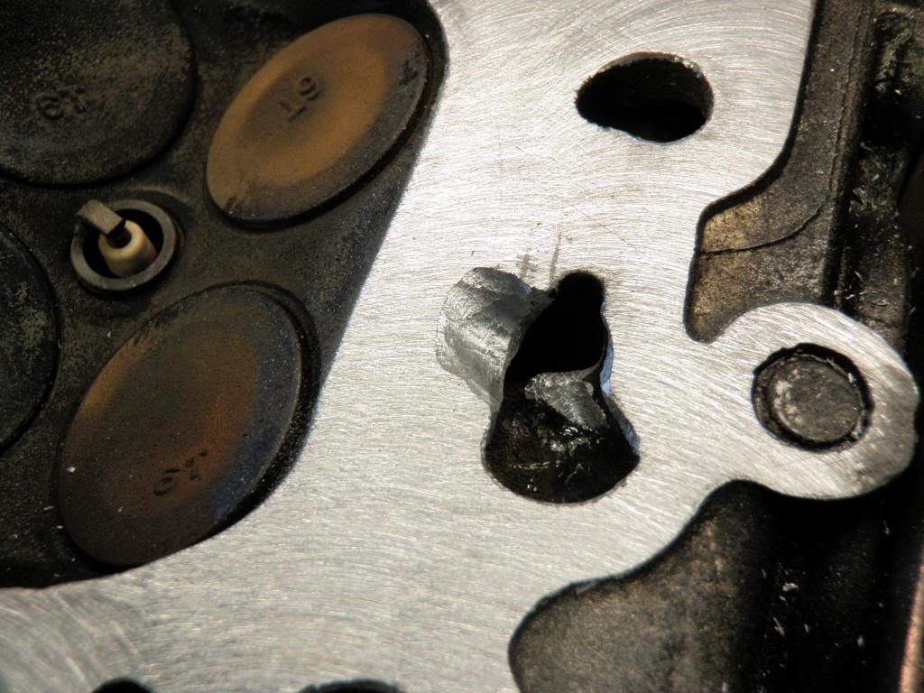

got it apart and man did i blow a gasket and torch the head in the process..
it wasn't that deep (forgot to take a before) this is cleaned out ready for welding.
Welded it back up thoroughly and re-decked it. Got a new expensive billy badass head gasket and did all the black magic tricks to all the stuff using all i have learned from the gurus to re-seal the head. I think its staying down this time.

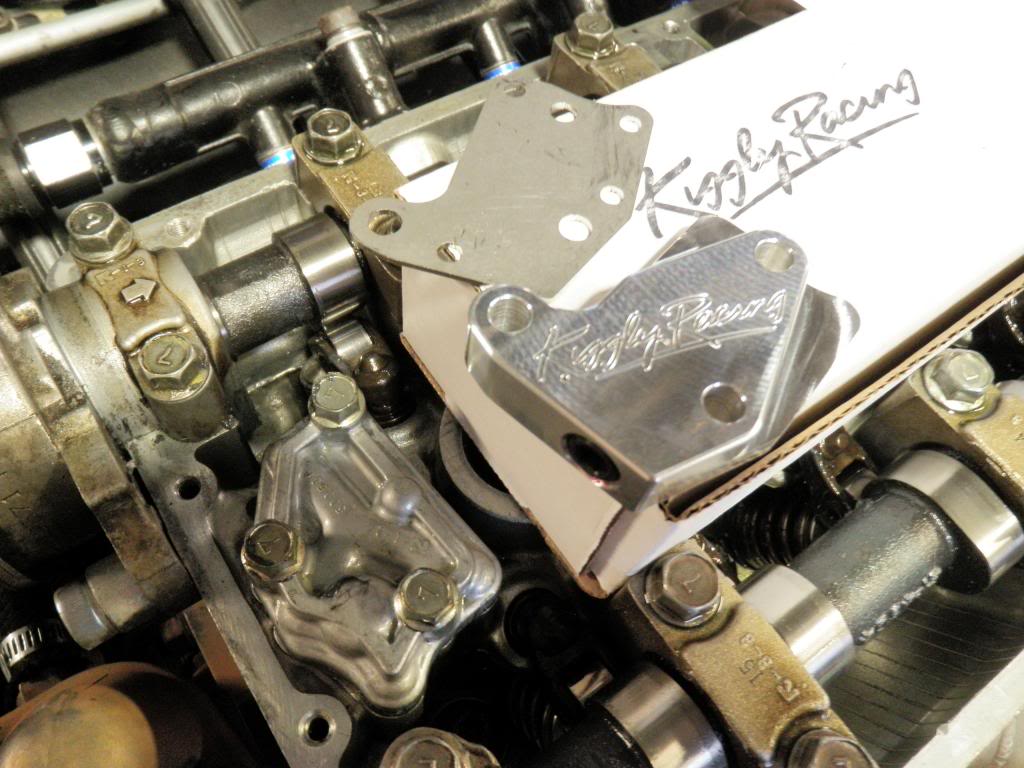

Put in a legit little kiggly part in the head, its expensive for what it is but its cool. It limits oil pressure to the head to 15 psi so that it keeps a lot more oil pressure in the bottom end.

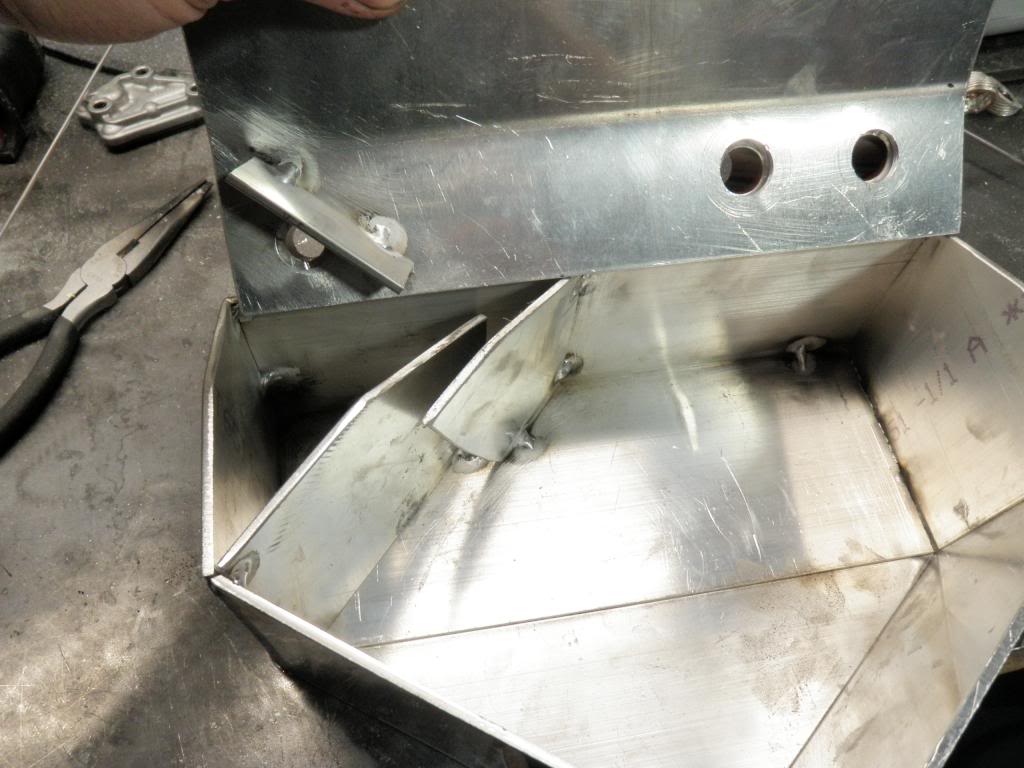

Anyways... rebuild my catch can set up and did it legit.

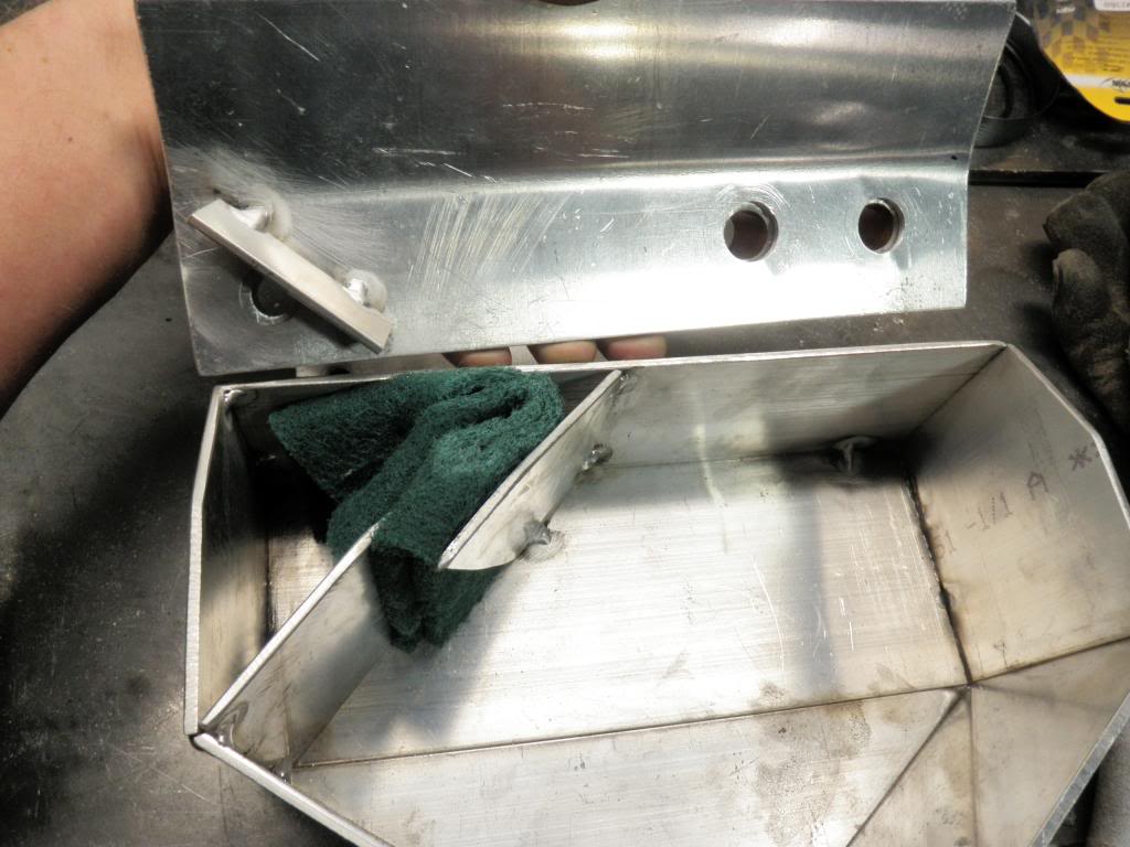

chopped off the old ones and added -12's to the valve cover, also added baffles on the inside
all welded up ready to be closed up, lots of baffles :)
stuffed some green scotchbrite in there and see how it works

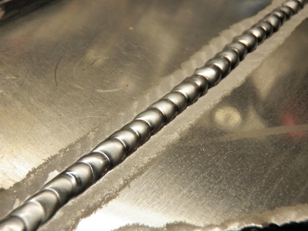

the old welding bead shot haha

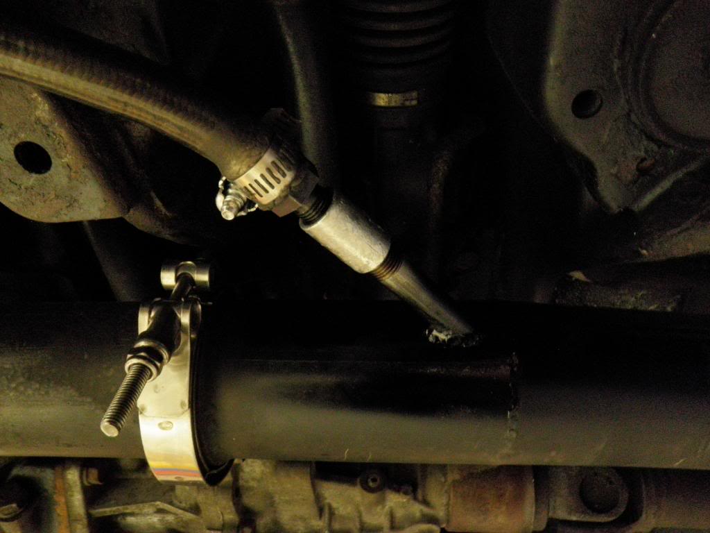

the far left -10 is actually a vacuum source using the exhaust. used a venturi pipe in the exhaust with a check valve. people see anywhere from 3" to 5" of vacuum using this system and since i have no intake to pull vac its a cool option.

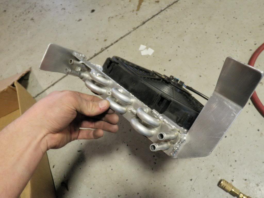

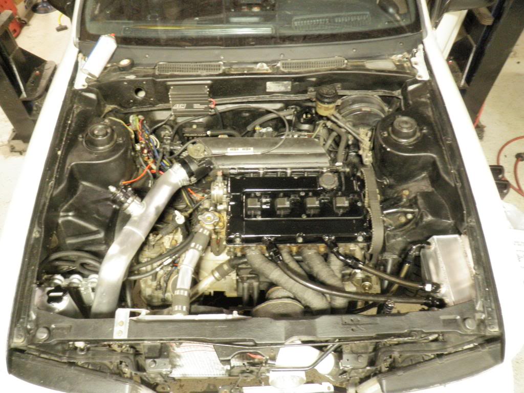

Moved my trany coolers around and stacked em, tacked em, and moved the fan over behind it so it would get good cooling.

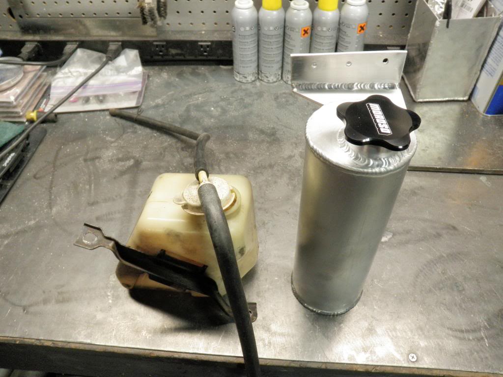

old vs new fabbed up radiator overflow tank.
heres an overview shot, you can also see i added a pegasus clamp to the throttle body to boost pipe.
