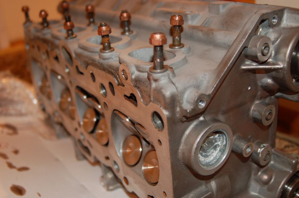

SIM Rebuilt Head
These guys are awesome, I highly recommend them to everyone, they are the easiest guys to work with, and their customer service and communication is amazing! I will be a lifetime customer from these guys.

ARPs ordered and a core head I had sitting around.

Strictly Import Motorsports did an awesome job on my head. I'm extremely happy with it. They have insane crazy prices, and do good work. They have excellent communication and I don't think I'd get a head rebuilt anywhere else.
You can check out the head rebuilds here!
DSM Race Heads
