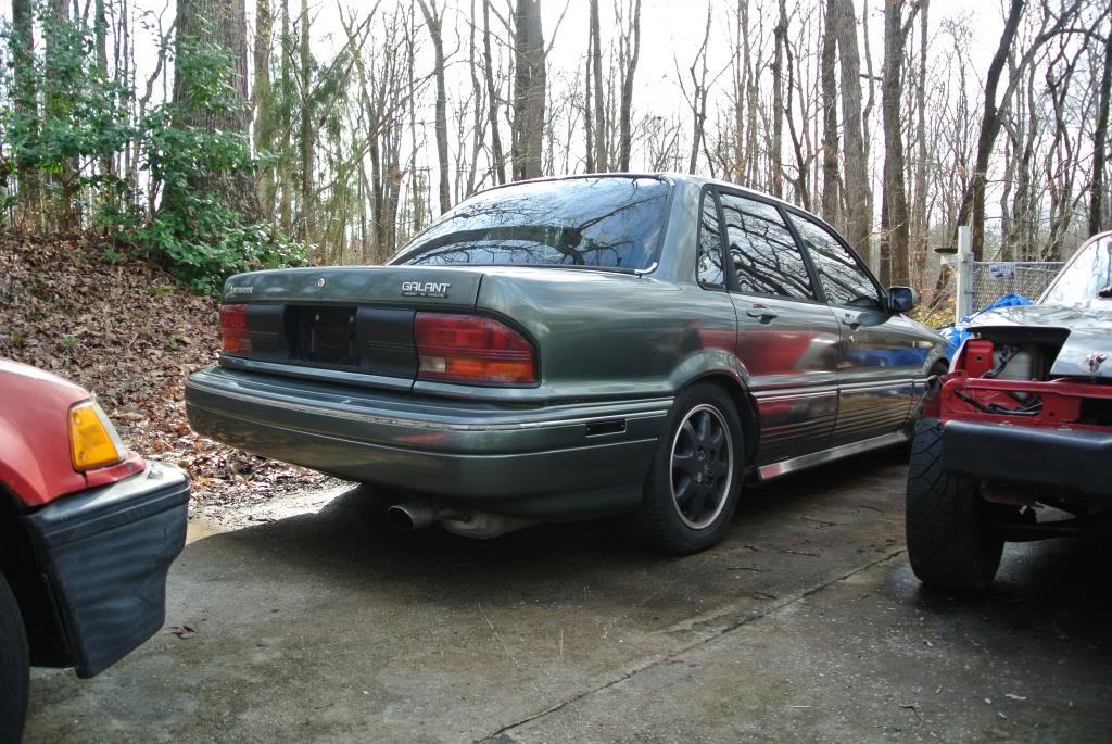

Work has finally began on #1027. The Photos below were taken the day she became mine. I traded a Garret GT2860rs with Tial goodies, Miata 6 speed trans and a Mishimoto radiator for her. Since I have gotten her I have picked up a replacement transmission for her and a V3 ECMLink with more to come.
Build Goals:
- 300 to 325 HP respectively
- Daily driver
- Simply clean build
- Personalization
- Fixing short cut mods that were done by PO's
- Paint (original color is belize green but Im kinda diggin the sea foam green) strip and re spray the sea foam green.

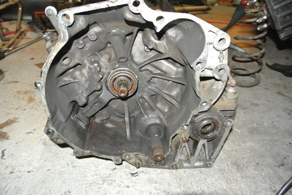

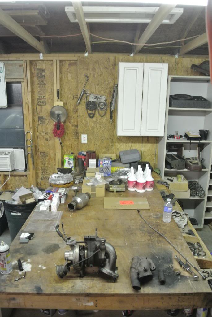

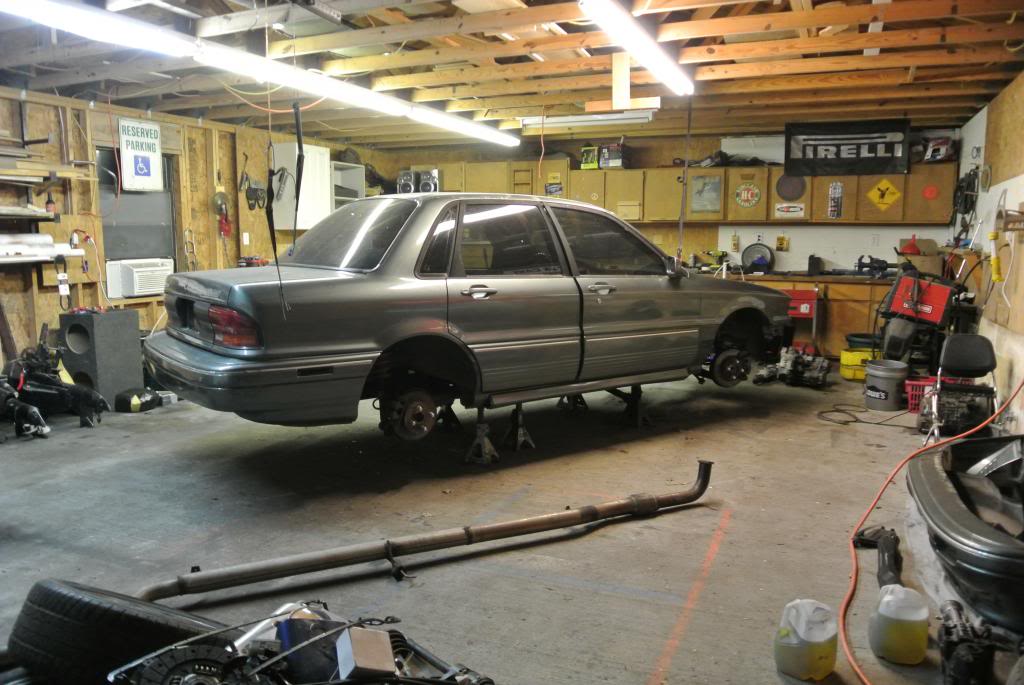

Pics from this weekends tear down in prep for installing the replacement transmission. Lots of labeling and taking photos to reference when I get to the point of putting everything back together.
Hand scrubbing this sucker and flushing it out in prep for the HD shockproof that will be going in it after its install ;)

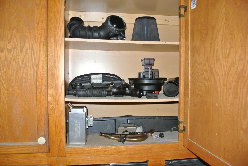

Take off parts
I love it man! I to picked up a gvr4.. 271/1k. And am doing just about the same to it. Complete overhaul. Was going to ask tho, what fluids are you using to flush the trans?
Keep us updated brother! Doing the same to mine, just picked up 1150/2k. I'll make a build thread as well once I officially get started :)
Right on, Give her the attention she deserves. I ran a couple gallons of diesel fuel through.

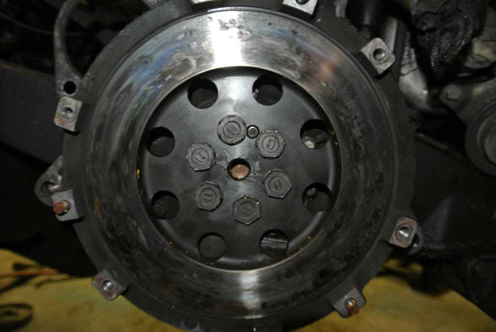

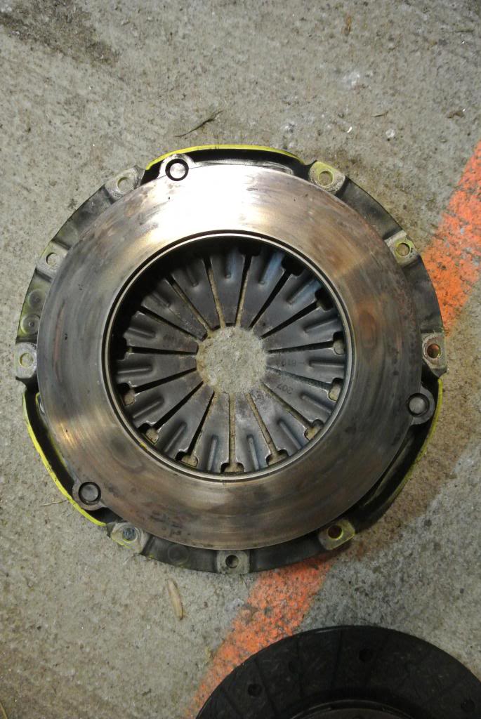

PO mistakes are a PITA! Thanks man, I just went back into the shop and pulled the ACT clutch a PP off, I was pleased to see a ACT Flywheel on there. SCORE!!! but will most likely need to be resurfaced. The clutch and pp are in horrible shape, very abused with loads of bluing and gouges in the PP as well as all the PP bolts having wear on one side of them. I had a duhfuq moment when inspecting them.

Awesome vr4 man!! Im jelous LOL. The only thing i can say is i wouldn't put HD shock proof in the trans, its good for the t case and rear diff though. I would stick with mt-90 or oem mitsu gear oil. Good luck with the build.:thumb:
i as well have a vr4. 975/1000 i would recommend diaqueen fluid for the trans. i noticed i shifted better with that than the mt90 i was running before.
Damn, and I just bought some...

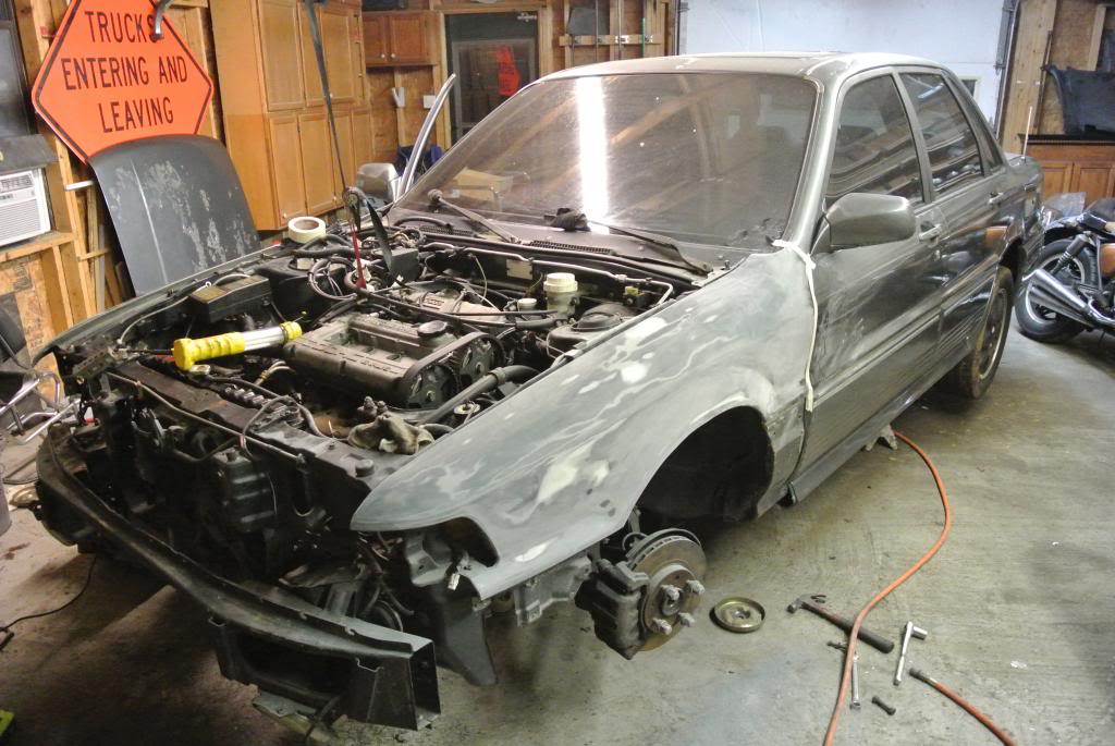

Got a little more tear down done but mostly just organized stuff. To my surprise when I went down to the shop I noticed some body work was started for me. A good friend of mine that does body work swang by to put some work in on it for me. I gave him a bunch of Miata parts in exchange for his help when I was ready to start work on her!

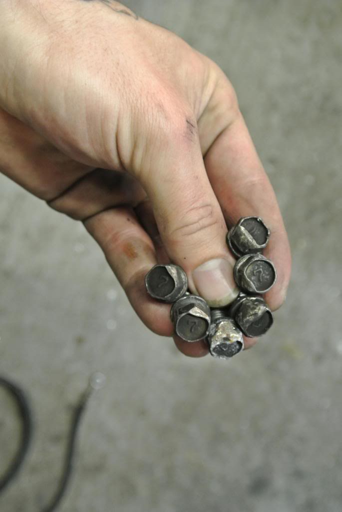

Some photos of the clutch that was in there, flywheel and the screwed up pressure plate bolts as well!

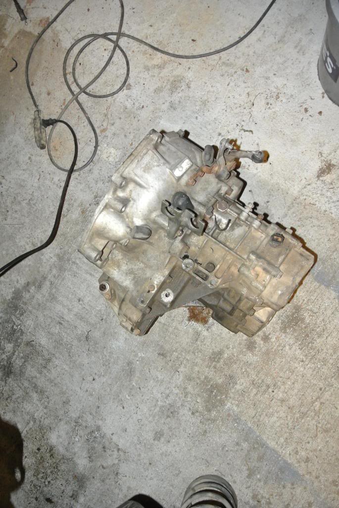

Old trans, will work on getting carnage photos

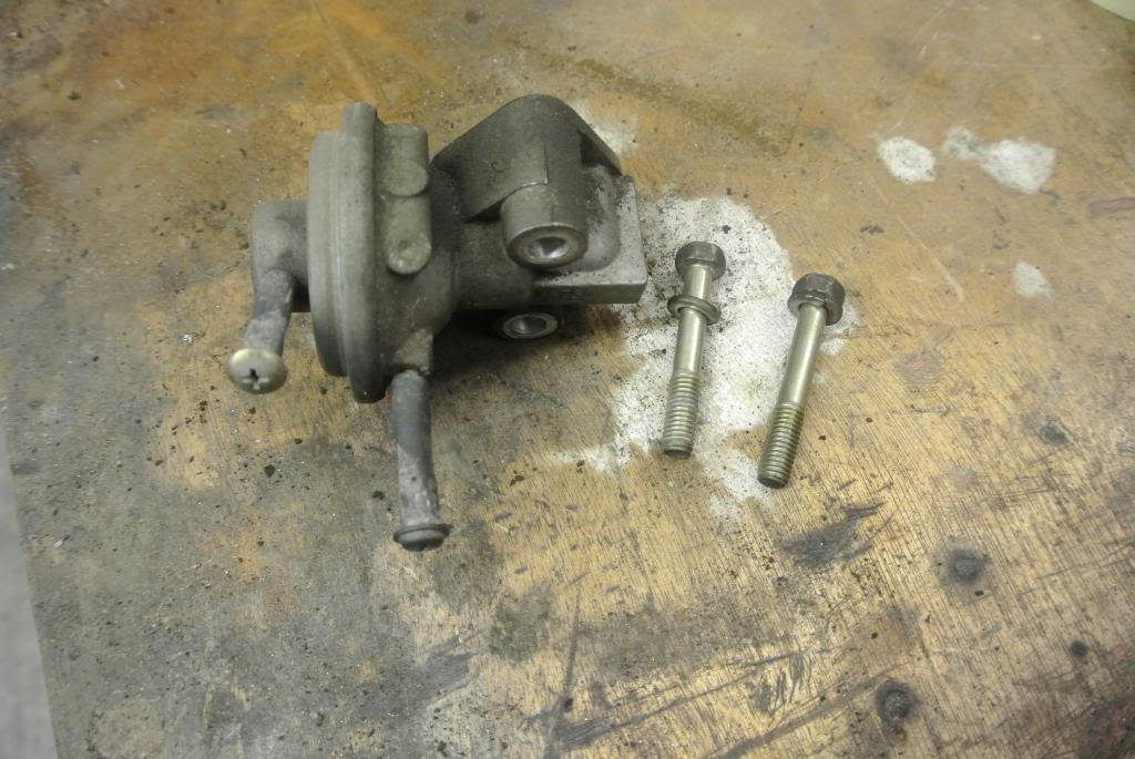

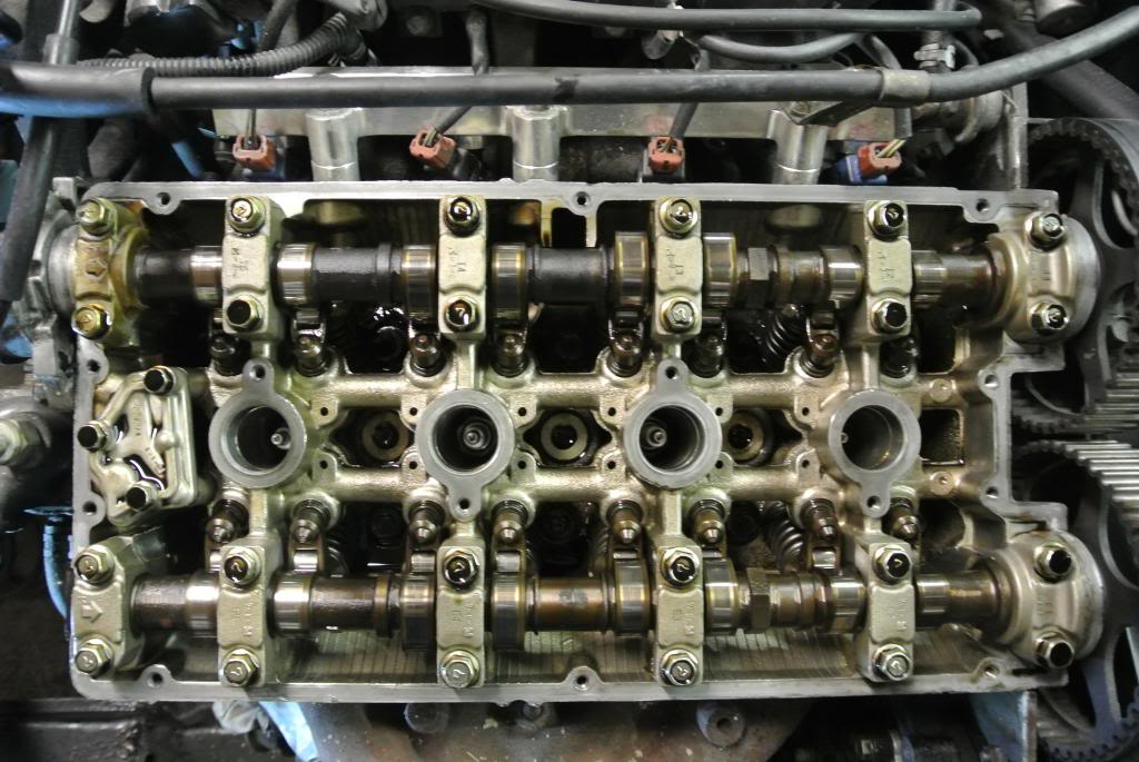

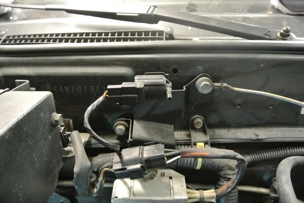

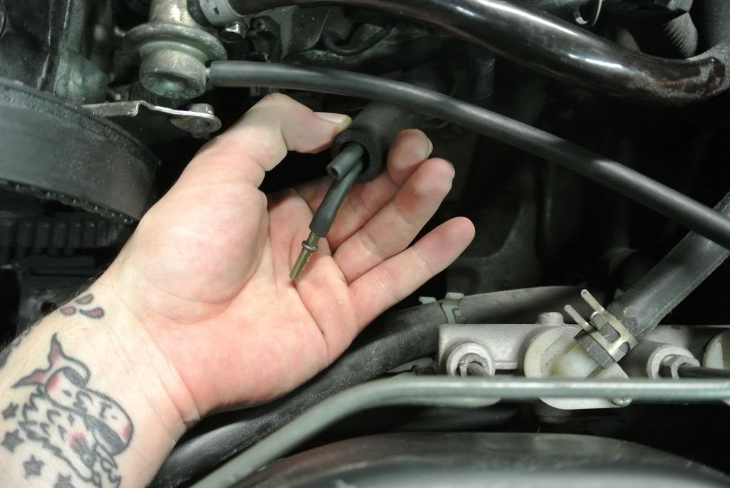

I removed the valve cover to get a peak at the head. Its not gunked up so thats a good sign! Cant really tell in this photo but the regulator and the line on the pass side (feed, return? I forget) going into the fuel rail and just popped in there. There are no provisions on the rail for the OE parts to bolt into! Sketch as fuq and unsafe. Going back to OE rail, but on a positive note there are FIC 650cc injectors in there. Another score!

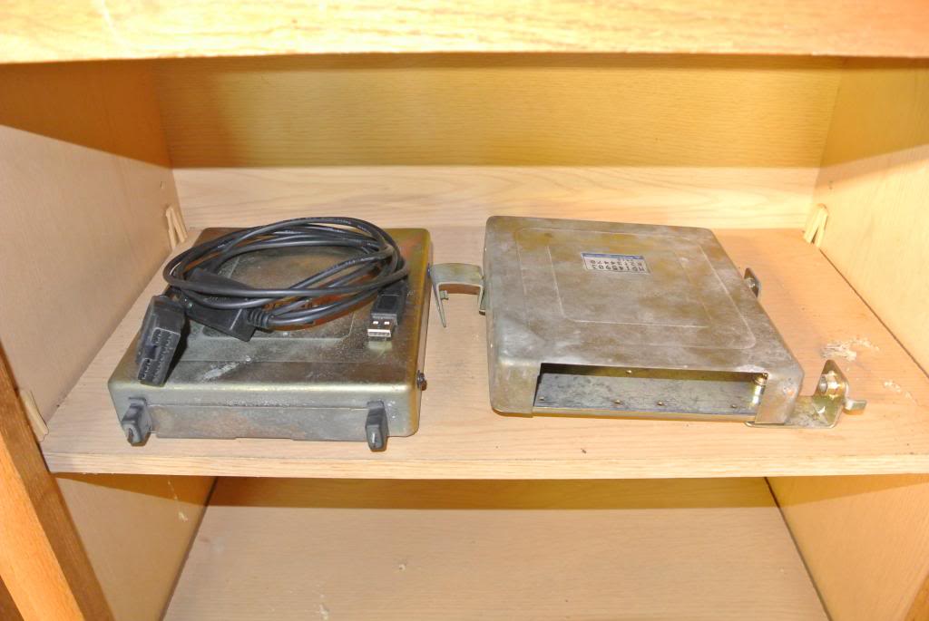

ECMlink Full V3

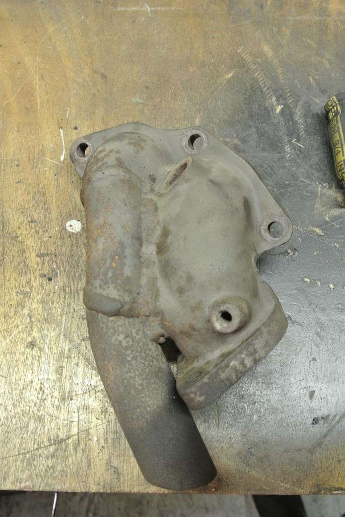

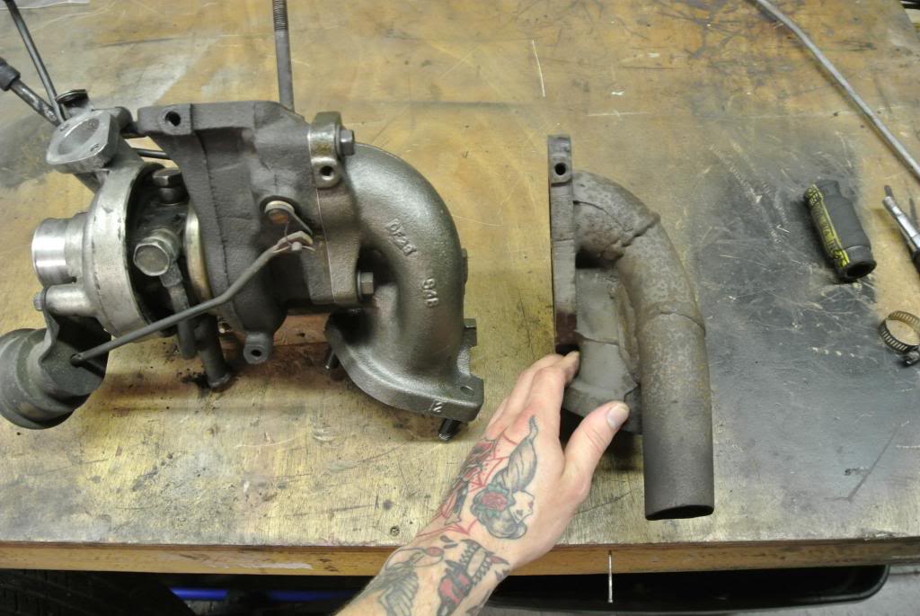

New EVOIII O2 housing and the modified stocker that was on there. It was pointing straight at the front cross member and ended 1/2 an inch above it.

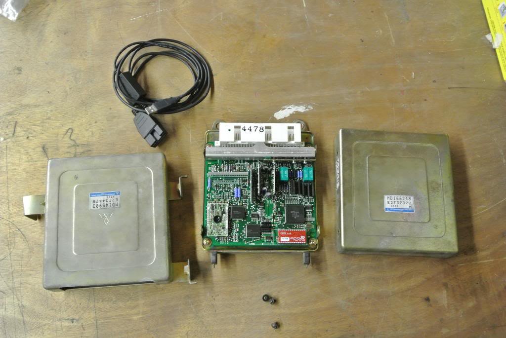

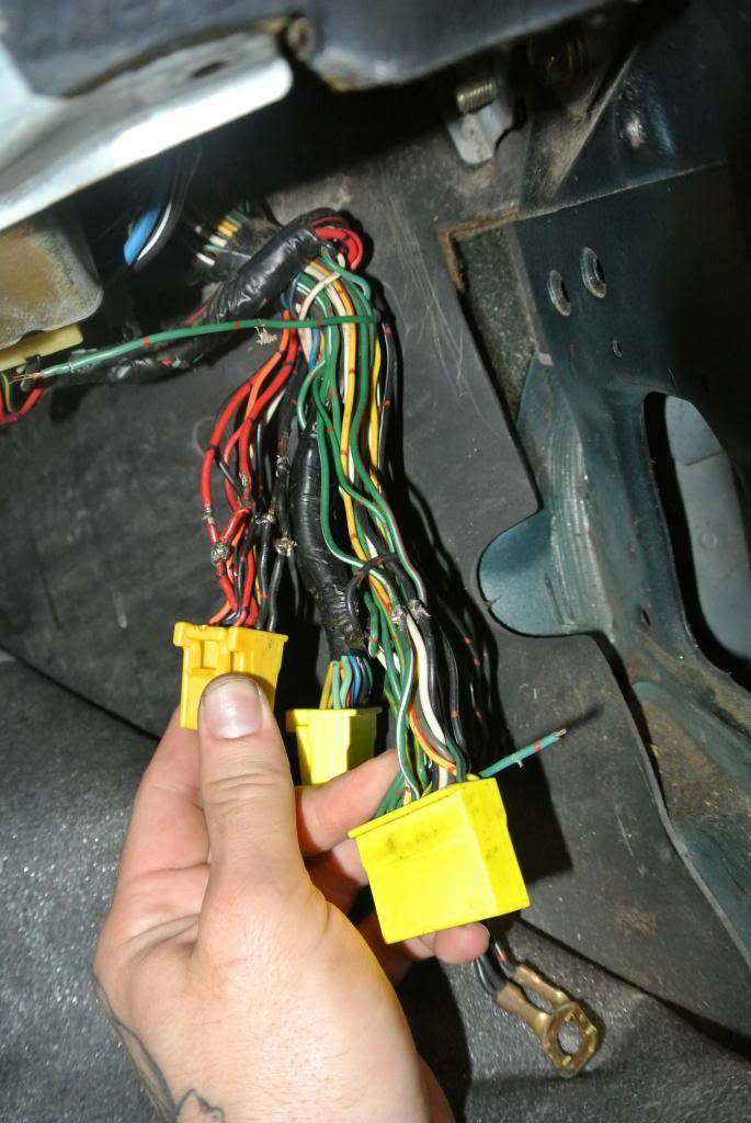

Progress is still slow, I did manage to get the replacement trans and transfer case in. Im doing my best to not get overwhelmed with all the short cuts that were made on this car by previous owners. Trying to take on one thing at a time. The wires at the ECU have been hacked up pretty good by whoever installed the APEXIneo. When I was removing it from the harness most of the wires just fell off their solder joints, currently deciding on how to go about that fix. Most of the vacuum lines and associated parts are either not present or not hooked up, working on searching for vacuum diagrams.
