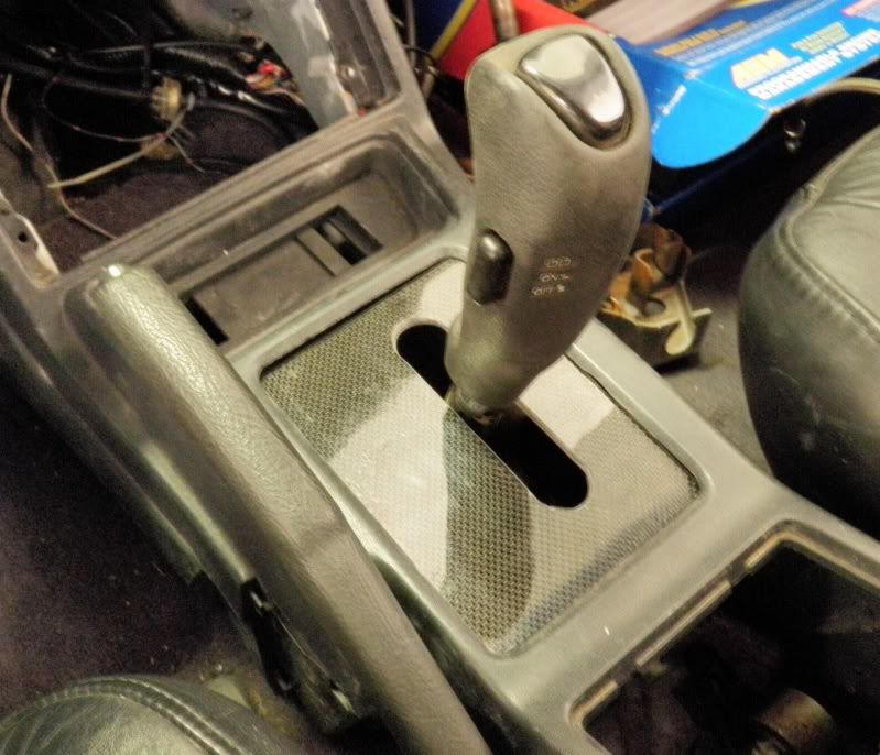

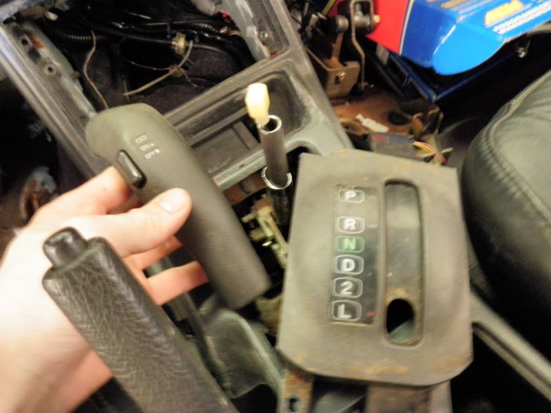

been trying to figure out what i wanna do with the shifter and got it figure out...

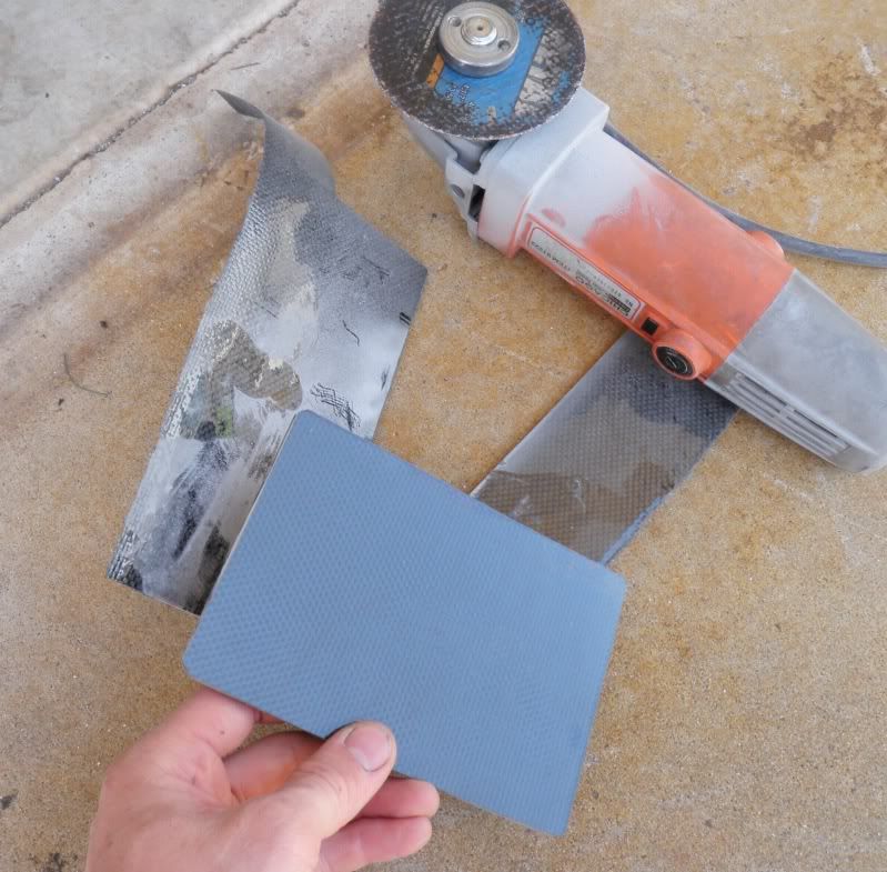

chopped out a nice CF plate from a piece i made
pulled apart the stock shifter...

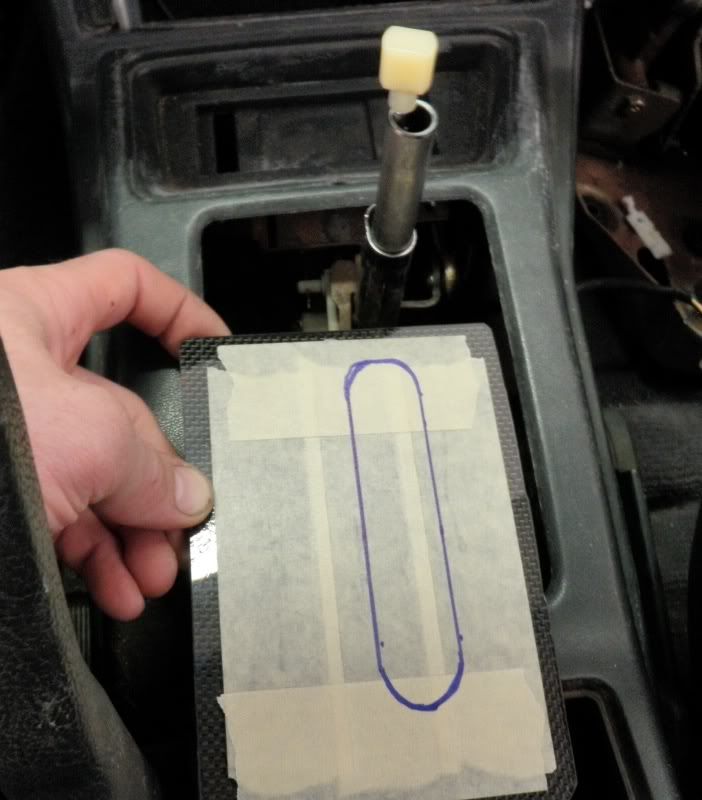

measured it out and marked it
chopped and installed.... not perfect but good enough

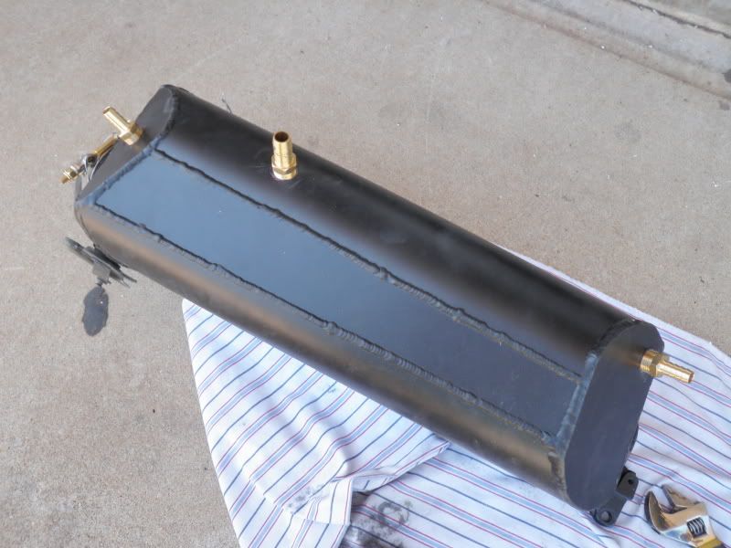

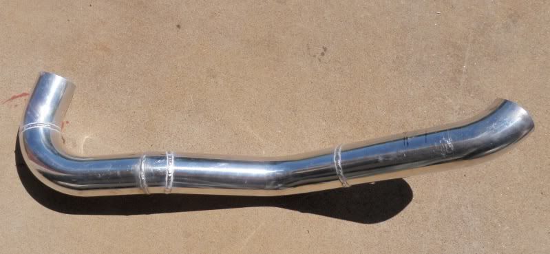

got the other boost pipe (intercooler to tb) done...
[image]
[/image]
all aftermarket manifolds put all the ports in the same spot. well one of the nice parts about doing it all yourself means i can put the right size port exactly in the spot that i want it...

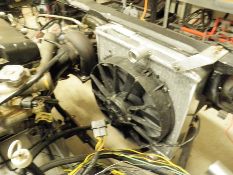

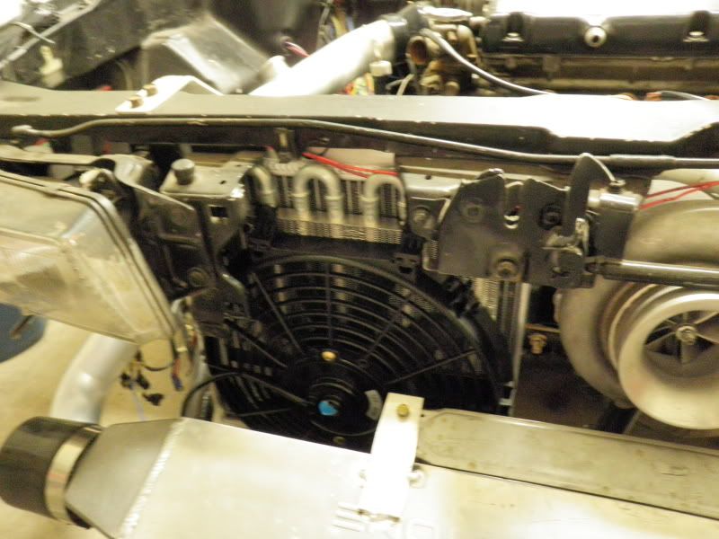

did a little sandwich stack with my tranny cooler and radiator, then bottom right is my oil cooler mounted to intercooler. So everything should stay nice and cool.

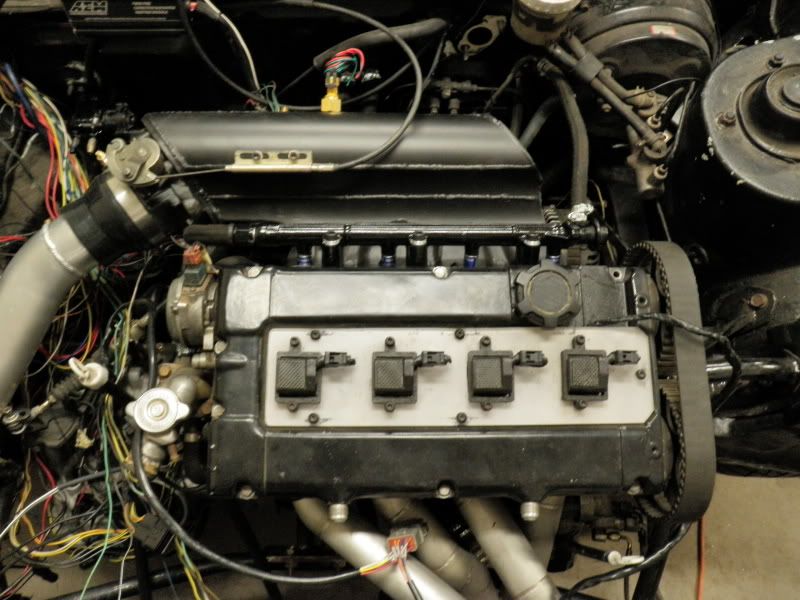

intakes done with all barbs and 5 bar map, fuel rail and inj back in and cleaned up. tb cable sorted...

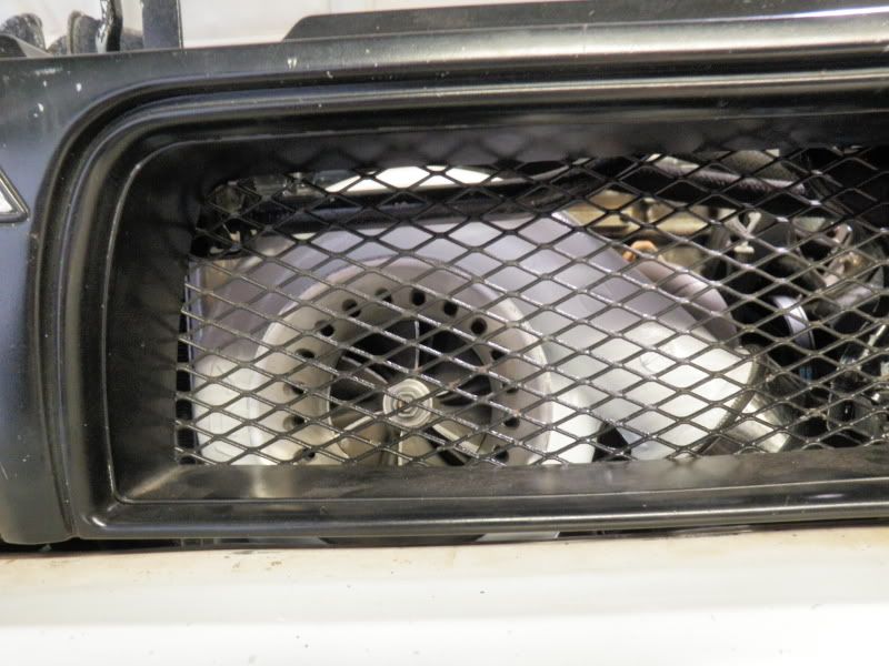

new filter set up :) JK

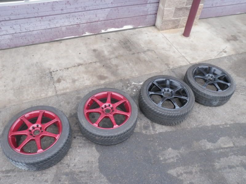

picked up some new wheels...

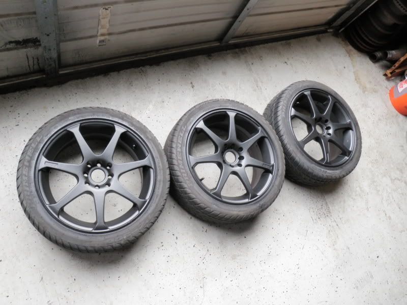

plasti-diped em for now

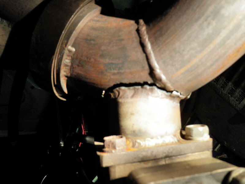

Cars so fast it decided to blow itself apart :)
[image]
[/image]
just welded it back up for now but plan on rebuilding that whole piece out of some heavier stainless.

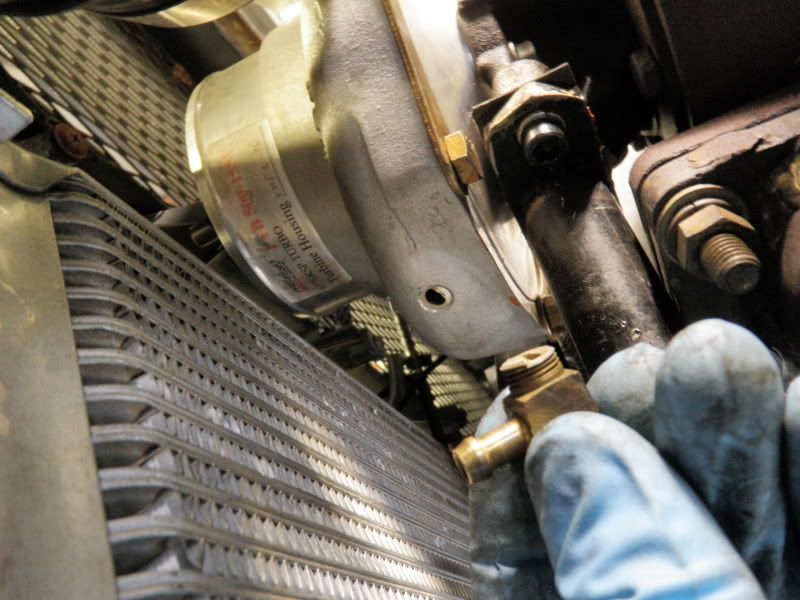

was messing with the boost controller and broke this fitting...
[image]
[/image]
so while the cold side housing was off fixing it i threw some paint at it to make it stand out :)
