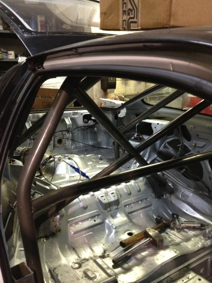

Forgot to add this pic the other day, My bad

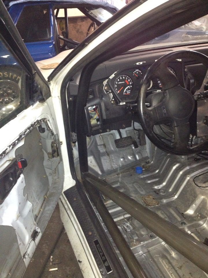

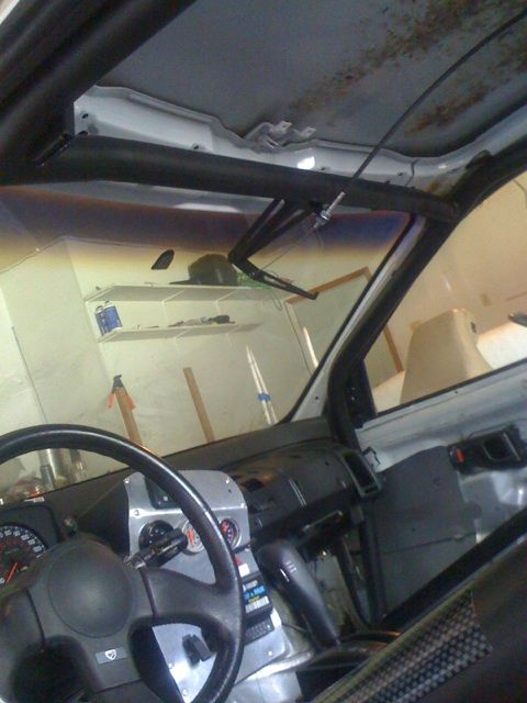

Kris I can't express how happy I am with the cage. Thanks again for the reference to Marc at MTK welding. Can't wait to pick it up tomorrow. :hellyeah::rocks:
Car is looking great! Looking forward to see it hit the track.

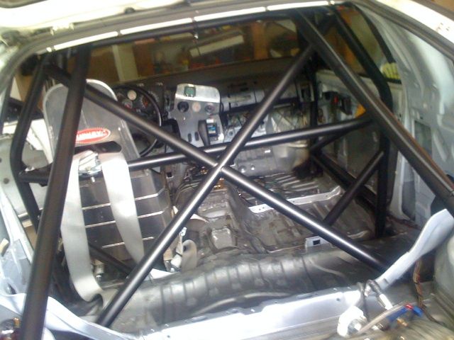

How much does a chromoly 10pt like that run fully installed and all up there? Just wanted to compare to quotes im getting down here
10 point fully installed would range anywhere from 3000-5500 depending on the shop.

Well what are you looking for ? window net, chute, front bars in the engine bay, x bar ????
$2500.00 for a CM 10 Point with a window net paint and $3200 with a Chute
No Probelm, Hope you guys are happy with everything

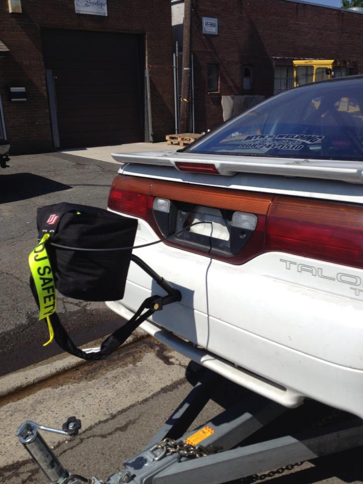

Is it me or is a 1 Gen with a Chute alittle sexy
Sure is! You need to see what this car looks like with the chute and 28" slicks. Lol Two different animals.

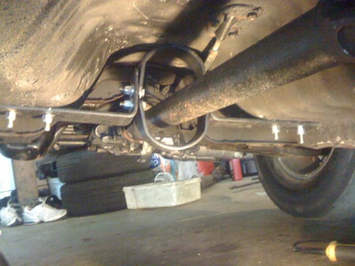

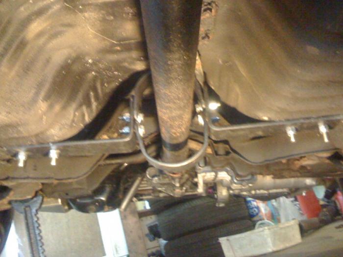

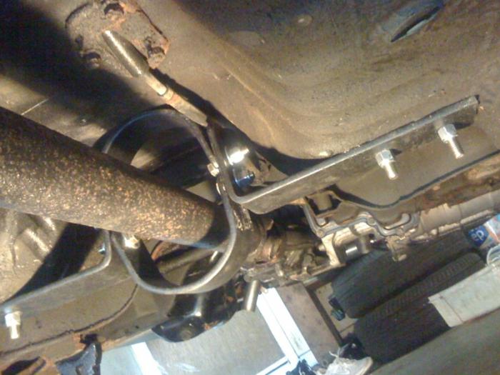

Well I'm just getting back from my vacation to Florida. Just installing my driveshaft loop and seatbelts and I will be taking the car to the track for testing this weekend weather permitting.

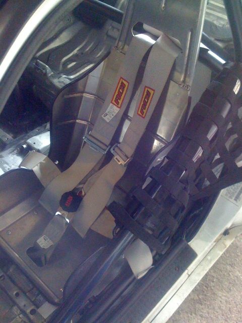

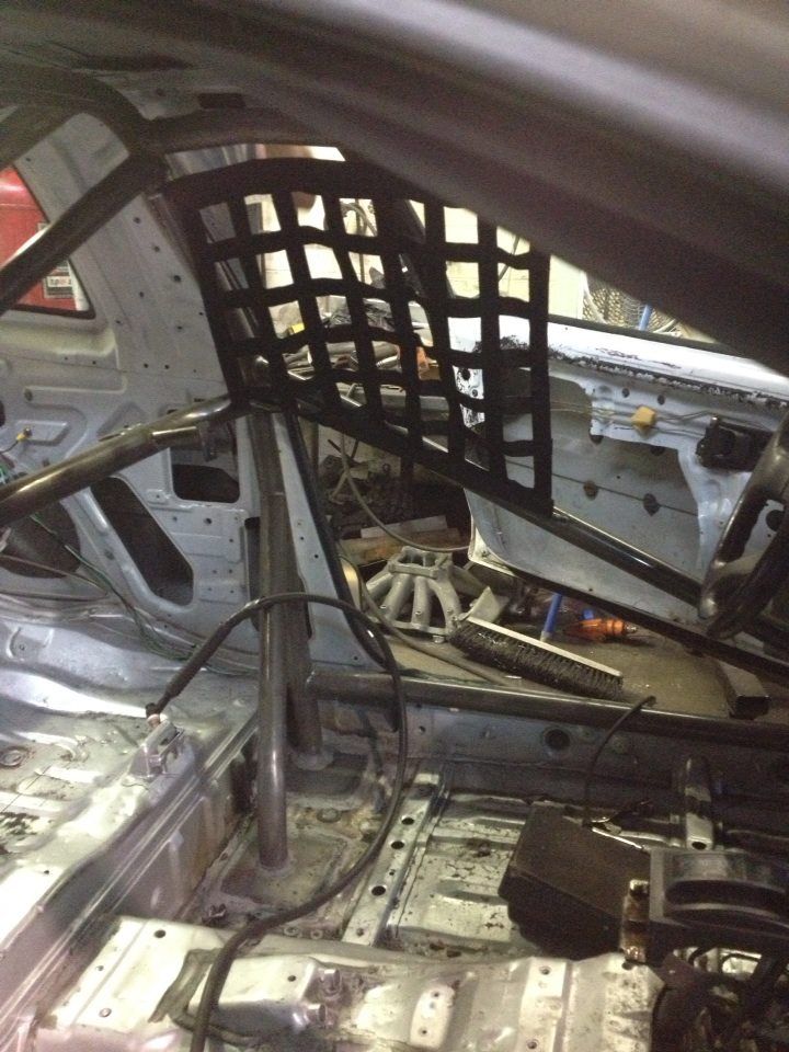

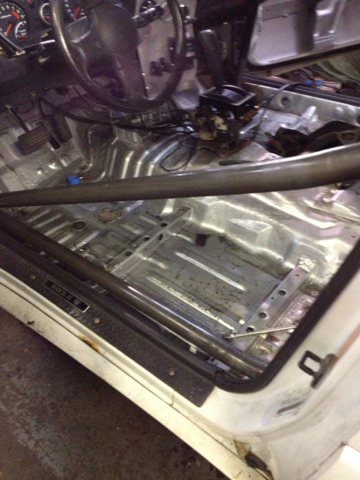

Finally got everything completely finished. Here is a few more pics of the cage. Everything is set for me to take the car out for testing Wednesday. Again I cant thank Marc at MTK welding enough for the top notch job on the cage.:hellyeah::thumb::applause:

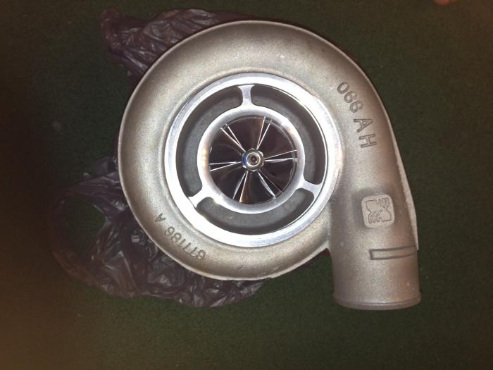

So guy just an update. We did take the car to the dyno and I can now be added to list of guys who found out the hard way why not to feed a journal bearing turbo from the head. Car made 630 and 480ft on a turbo that was good for nothing more than a babies rattle. Turbo is already off the car and sent to forced industries to be rebuilt and made bigger. As well as swapping to they're newest version of the upgraded bw compressor wheel. Should have it back in about 9 days and on the dyno again soon after. Can't wait to start getting some track time in to prep for Norwalk.
