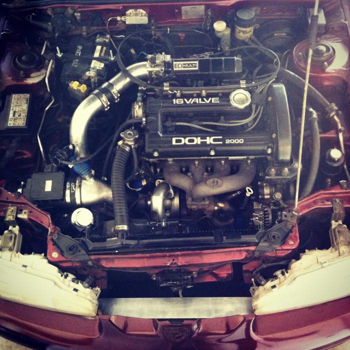

So i own a 1GB 1992 Eagle Talon Tsi Awd and I use it as a Daily Driver and my Track Car so it runs good on both the street and the track its is semi built and i am trying to achieve my goal of 350hp I have a couple of Mods on it and i still need a few more to get close to my goal like
Mods still on my list
Evo III 16g Turbo
Bolt-on Modifications:
14b Turbo 16PSI
FP Ceramic Coated Exhaust Manifold
3" Megan Racing Downpipe
3" Megan Racing Catback Exhaust (no Catalytic Converter)
Megan Racing o2 Housing
Cxracing Intercooler and 2.5 Piping
1g Intake Manifold
1g Throttle Body
Mishimoto Coolant Catch Can
Walbro 255 Fuel Pump and Rewire
560cc Evo 8 Injectors
Stock Fuel Rail
1g Bov
2g Maf
2g Intake Pipe
Gates Timing Belt and Water Pump
Engine Management:
Ecmlink V3 Ecu
Speed Density
Hallman Pro Boost Controller
Xtune Boost Gauge
AEM Wideband gauge
Engine Internals:
6 Bolt Block
6 Bolt Head
3g Lifters
Stock Cams and Valves and Springs
Drivetrain Modifications:
5 Speed
4 Bolt Rear End
Suspension Modifications:
2g Gsx Wheels
Arizonian Tires
Solid Prothane Mounts
Stock Struts and Springs

You might wanna step up your game on the Injectors if your going with link. It will give you some more wiggle room so your duty cycle isn't at 90% or so. Other then that its a pretty good set up. I think the evos are 560cc and the aftermarket companies list 550s. Look at a set of 680s or something like that. If your just going to throw a 2g maf on then 550/560s are fine.
Word of advice, those CXRacing intercoolers are straight up garbage!!! They look nice, but they dont cool at all, you can see right thru the core and the air doesnt thermally exchange. I was hitting 160 deg intake temps just from 20 psi on a b16g. My build thread would tell the whole story but thats the jist of it. Good luck on the build, you have the 6/4 combo so itll have the strength
thanks for the advice guys might look to getting bigger injectors if the 560s don't work out and yeah that intercooler is crap might get like a ets or vrsf intercooler that actually works

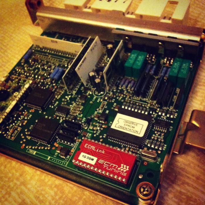

Finally got Ecmlink now its time to put in the injectors and start to tune still need to find a evo 3 16g turbo so i can reach my hp goal of 350hp
i know its the best thing i could have ever got for my car now i can tune it properly and have it running great
