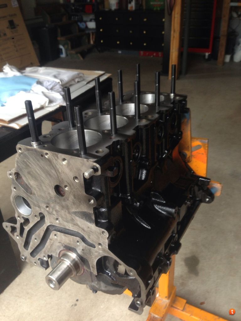

So it all started when I purchased an imported engine off a guy with approximately 60 000k on it as i got it for a great deal and he threw in a parts car LOL. The engine was fully rebuilt (7-bolt block and head). Honed cylinders, new rings, ported head, Polished and balanced crank, Balance shaft elimination kit, Fel-Pro head gasket set, ARP head studs.

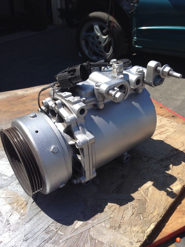

-Keep or delete A/C (leaning toward keep but compressor may be shot)

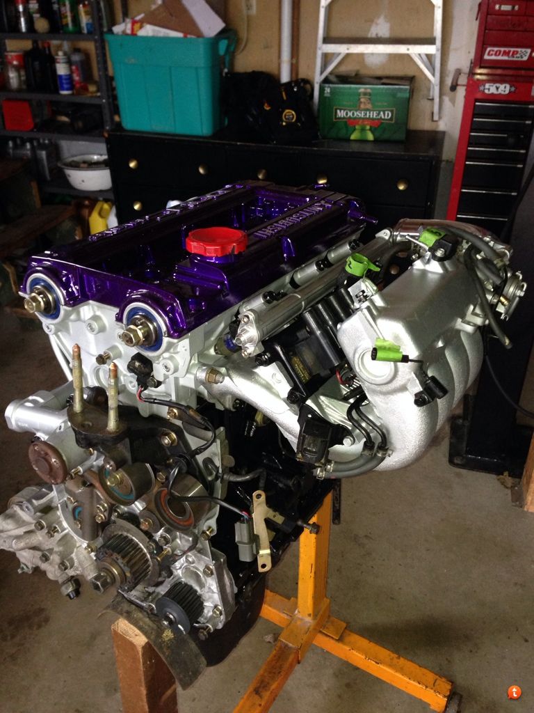

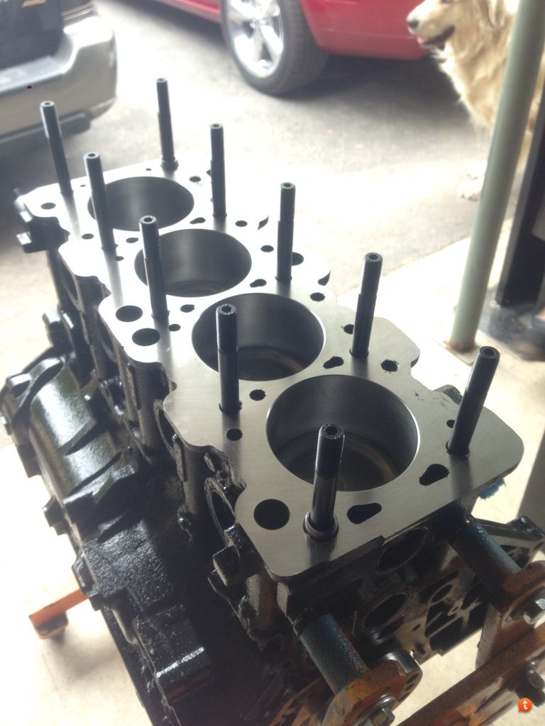

Rebuilt Engine Pics

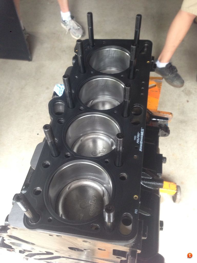

ARP Head Studs and Fel-Pro Head Gasket

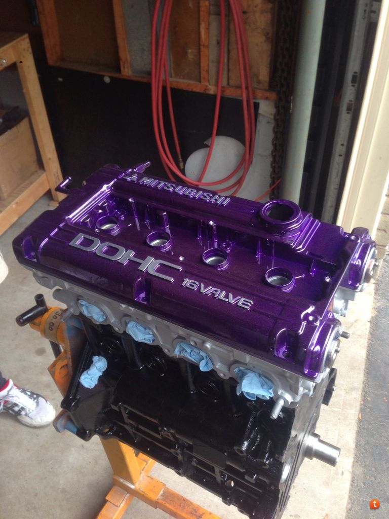

Starbright Purple with Silver Flake Valve Cover

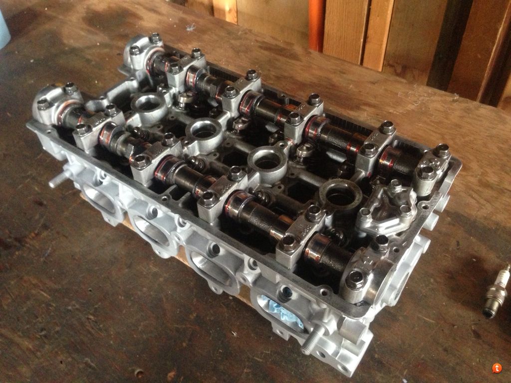

Head

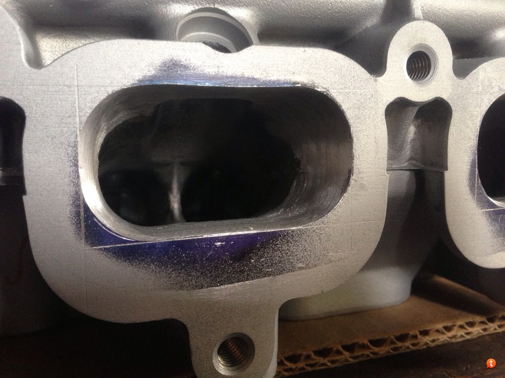

Intake and Exhaust sides ported

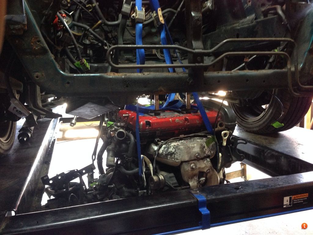

Old Engine Finally out (300 000 kms)

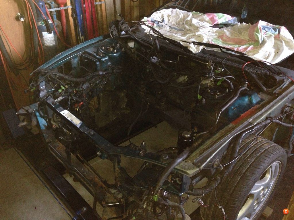

Time for Engine Bay Prep

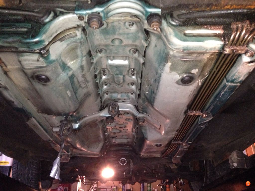

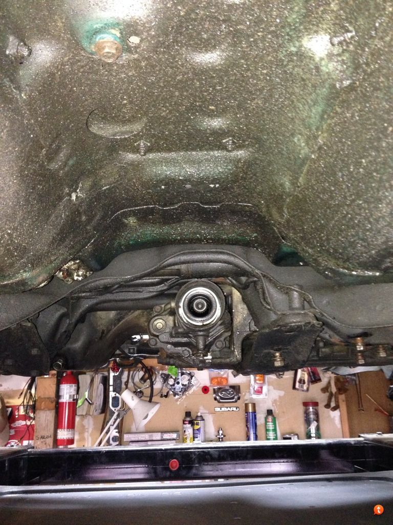

So most recently i have been cleaning the underbody and parts for the car as it was completely oil sprayed every year by previous owner and has led to grease build-up like crazy. Here is a shot of the underbody before and after

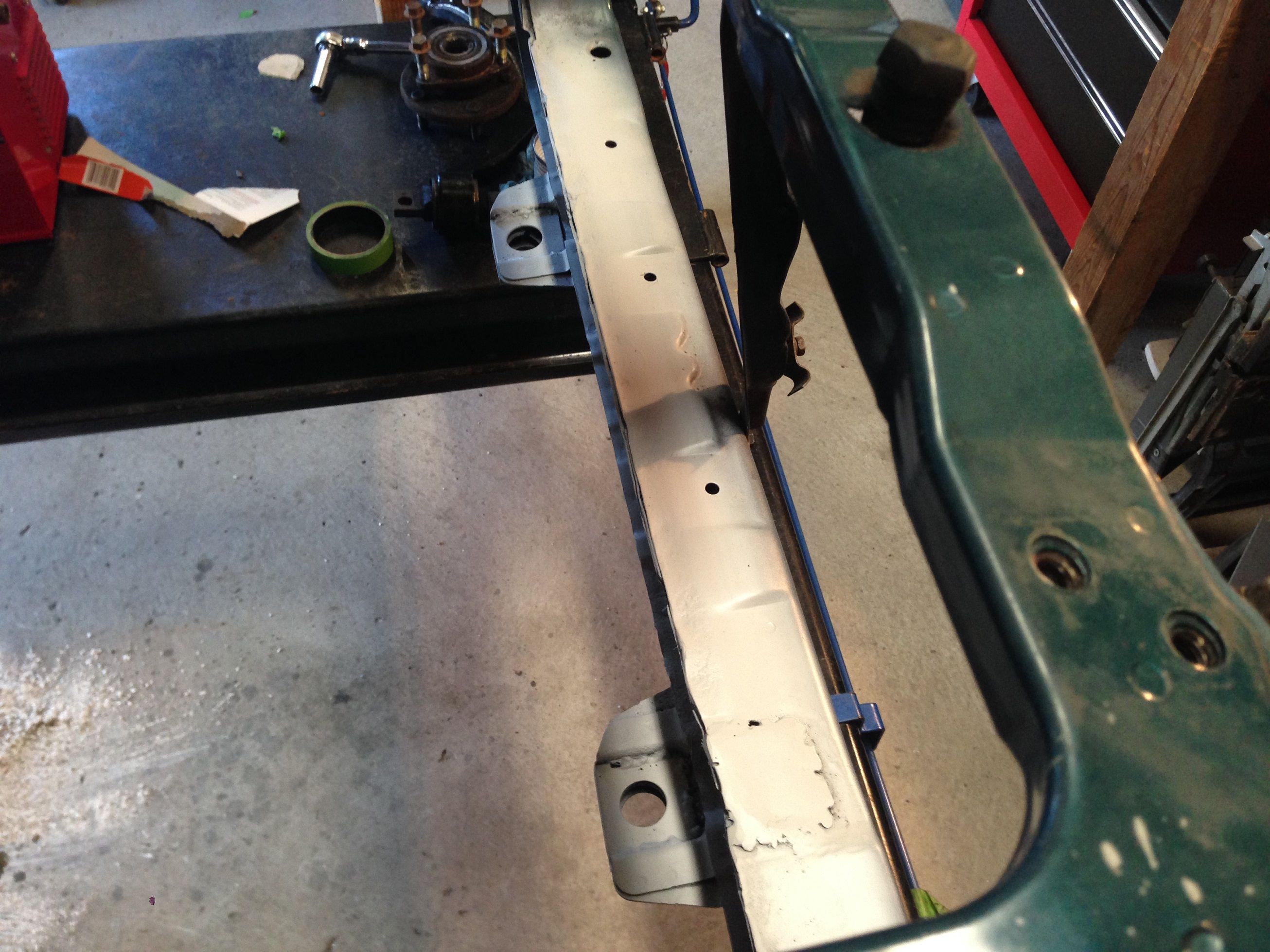

The oil spray however did save the car from rust which is awesome since its hard to find rust proofs in Canada. There was minor rust on rad support (common) and a tiny spot on one strut tower that will be repaired most likely tomorrow if weather complies. Dont know if i mentioned it but the car is only to be summer drivin for now on.
My dads lift to start which was a bonus. I used varsol, blue paper towels, and a scrapper. Was probably a 2 hour annoying process because it was everywhere. I then took the pressure washer to the engine bay and wheel wells to get the tough grease off all the suspension components and what not.

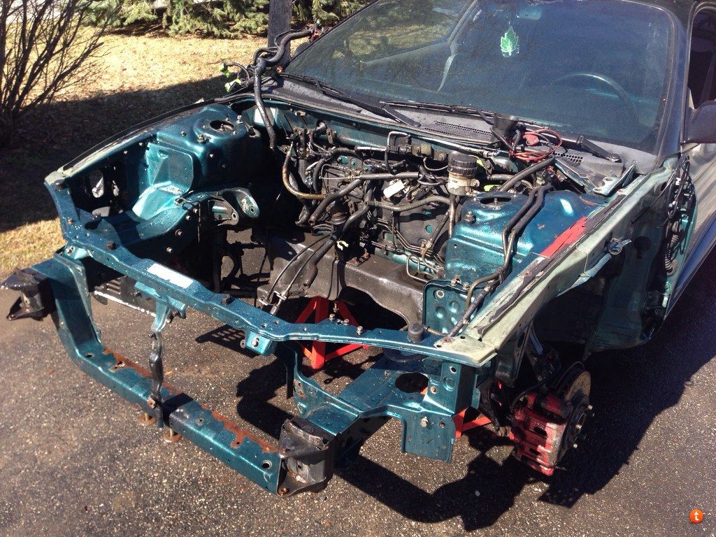

Engine Bay after a pressure wash blast. You can see the minor surface rust on rad support that will be fixed

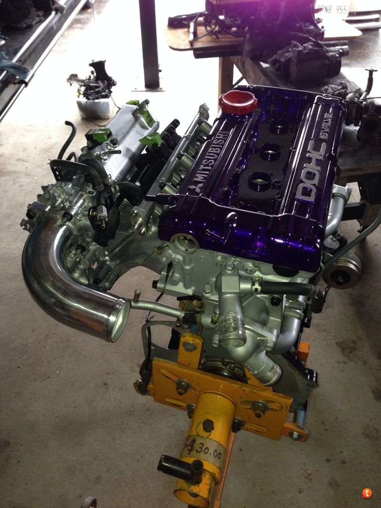

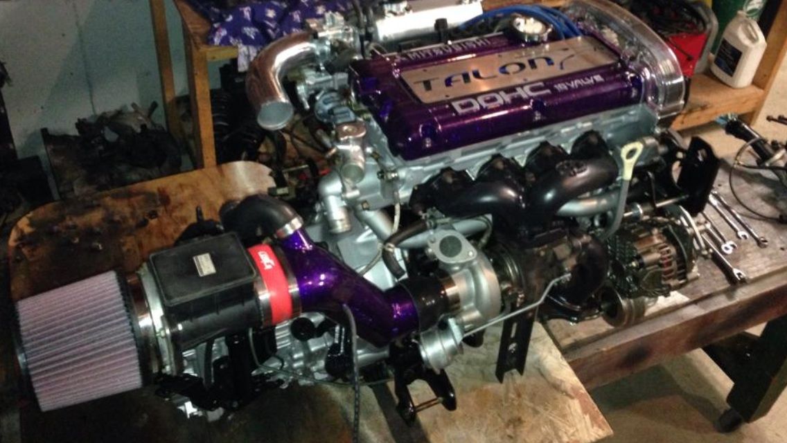

Just an update as of today. So i found out the intake manifold that came with the imported Japanese engine doesnt have an egr port and since in needs to pass emissions i am using my stock 2g mani. Cleaned it a up with my throttle body and installed in on the head along with my fuel rail and fic 650 injectors. Ps. That red oil cap is temp to keep dust out
I also got my HKS timing cover and am waiting for some good weather to anodize my cam gears (either red, black or silver). Also will be painting my exhaust and tranny when the sun comes out someday....

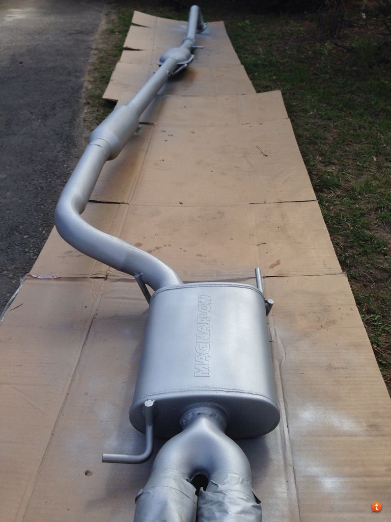

VHT's 2000 degree high hear paint for the Magnaflow. Hope it will hold up (4 coats)...

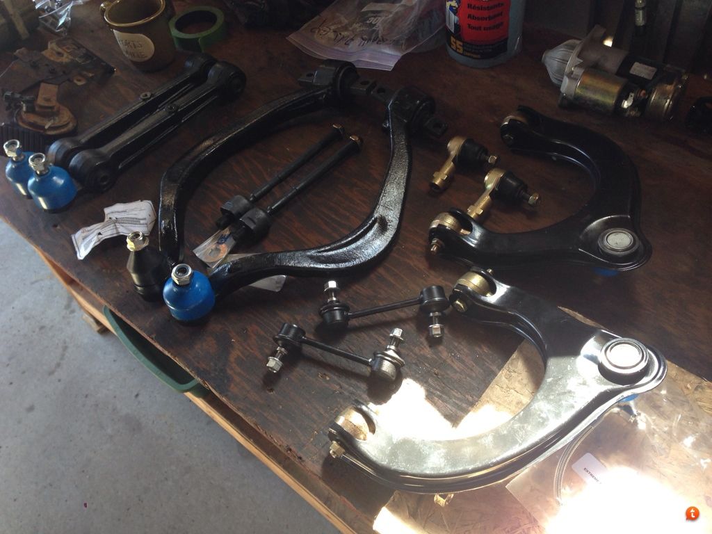

My new front suspension components arrived as well and will be installed soon

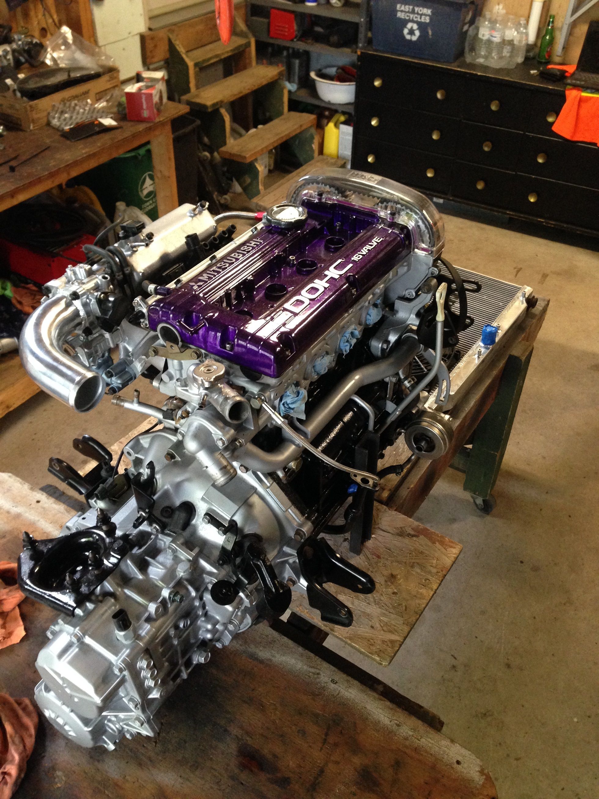

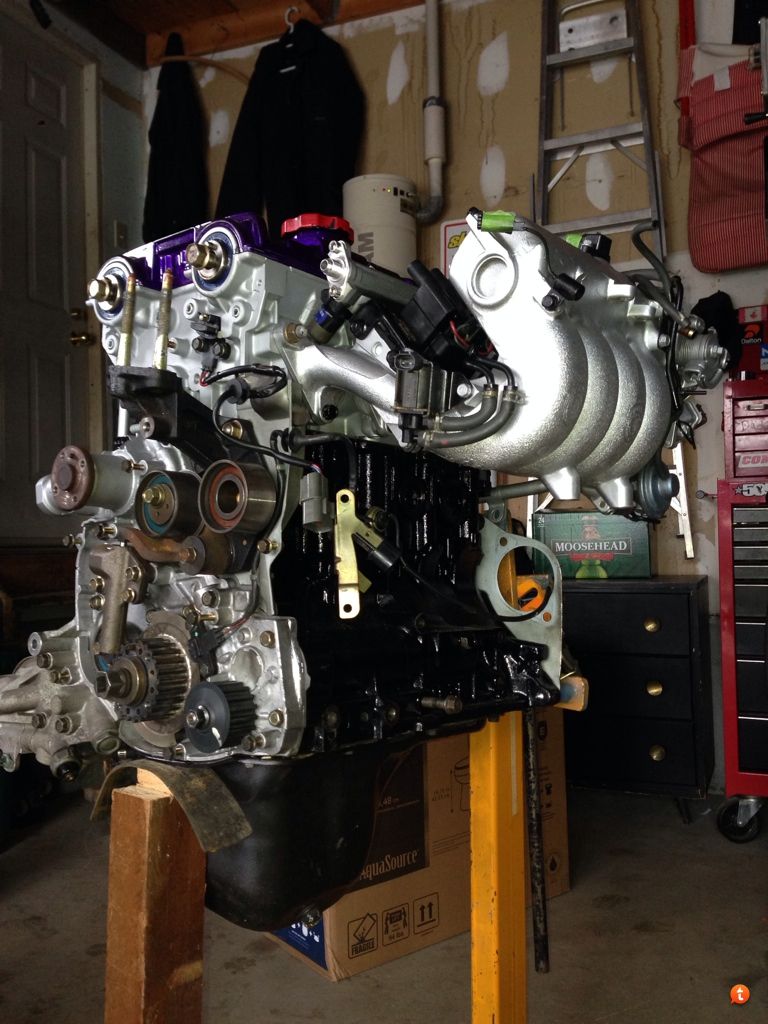

Think that is it but here is a few shots of the car and engine currently
Here descriptions to the pics i will upload eventually since i cant figure out this new format...
OEM Timing Belt on with new HKS cover

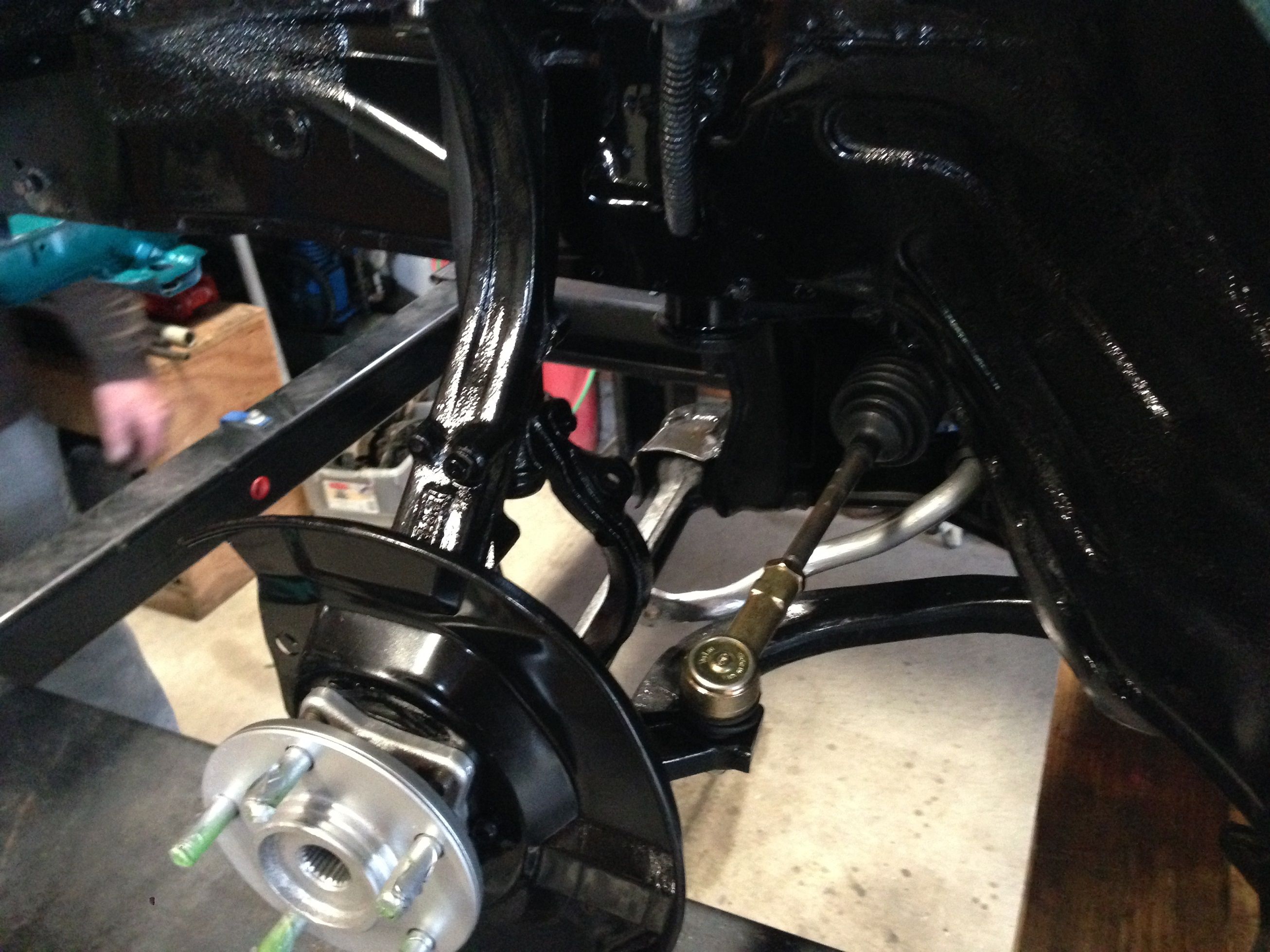

New control arms, joints, tie rods. Getting new OEM wheel bearings and axles

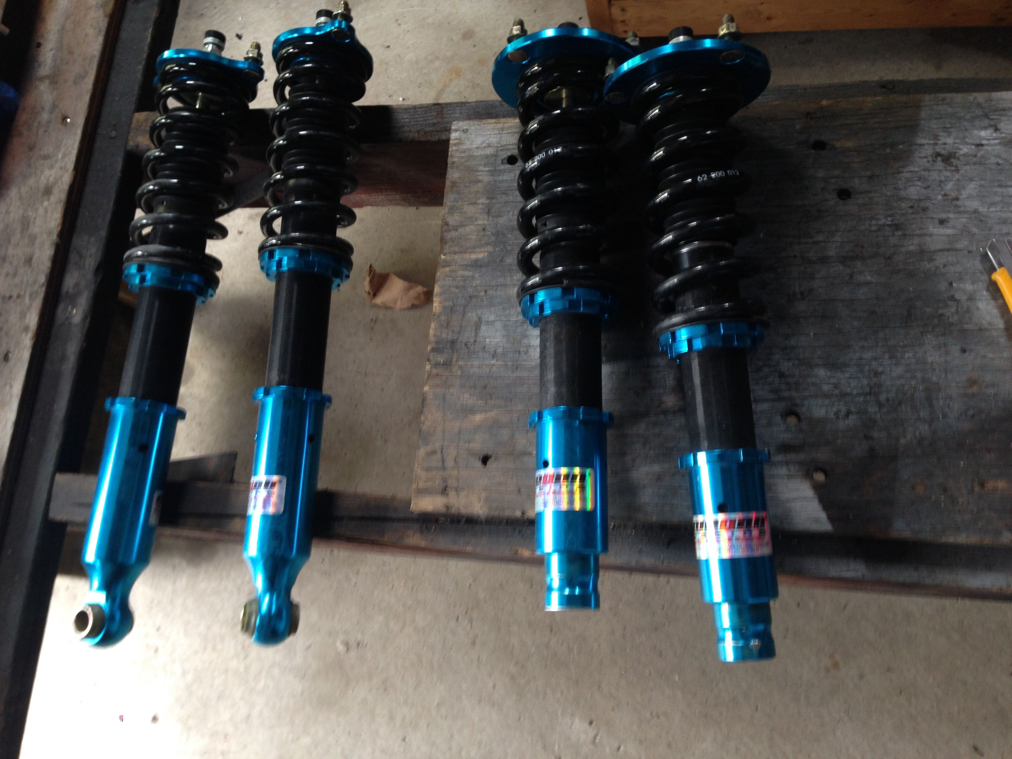

Megan EZ Street Coils

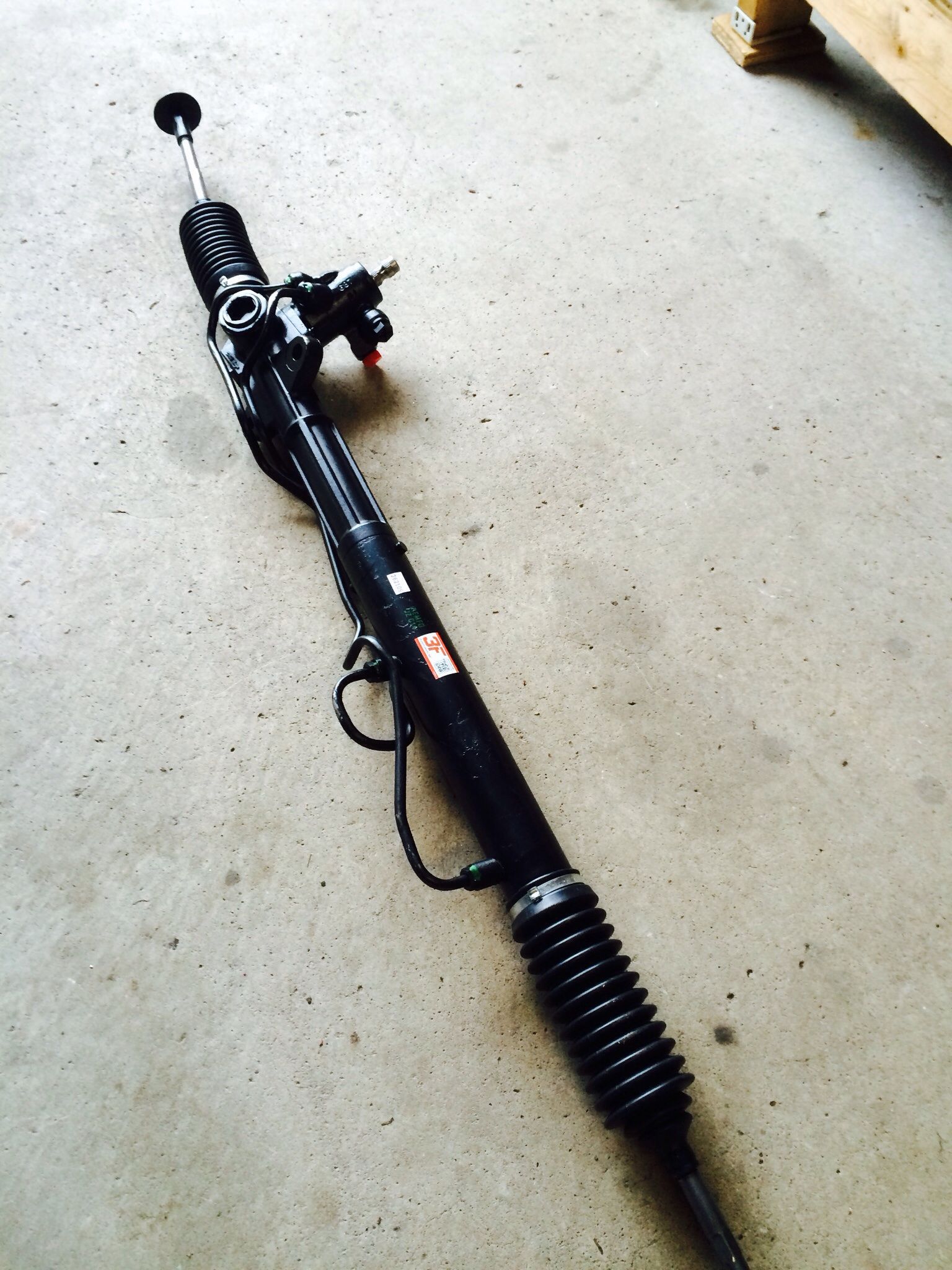

New power steering rack

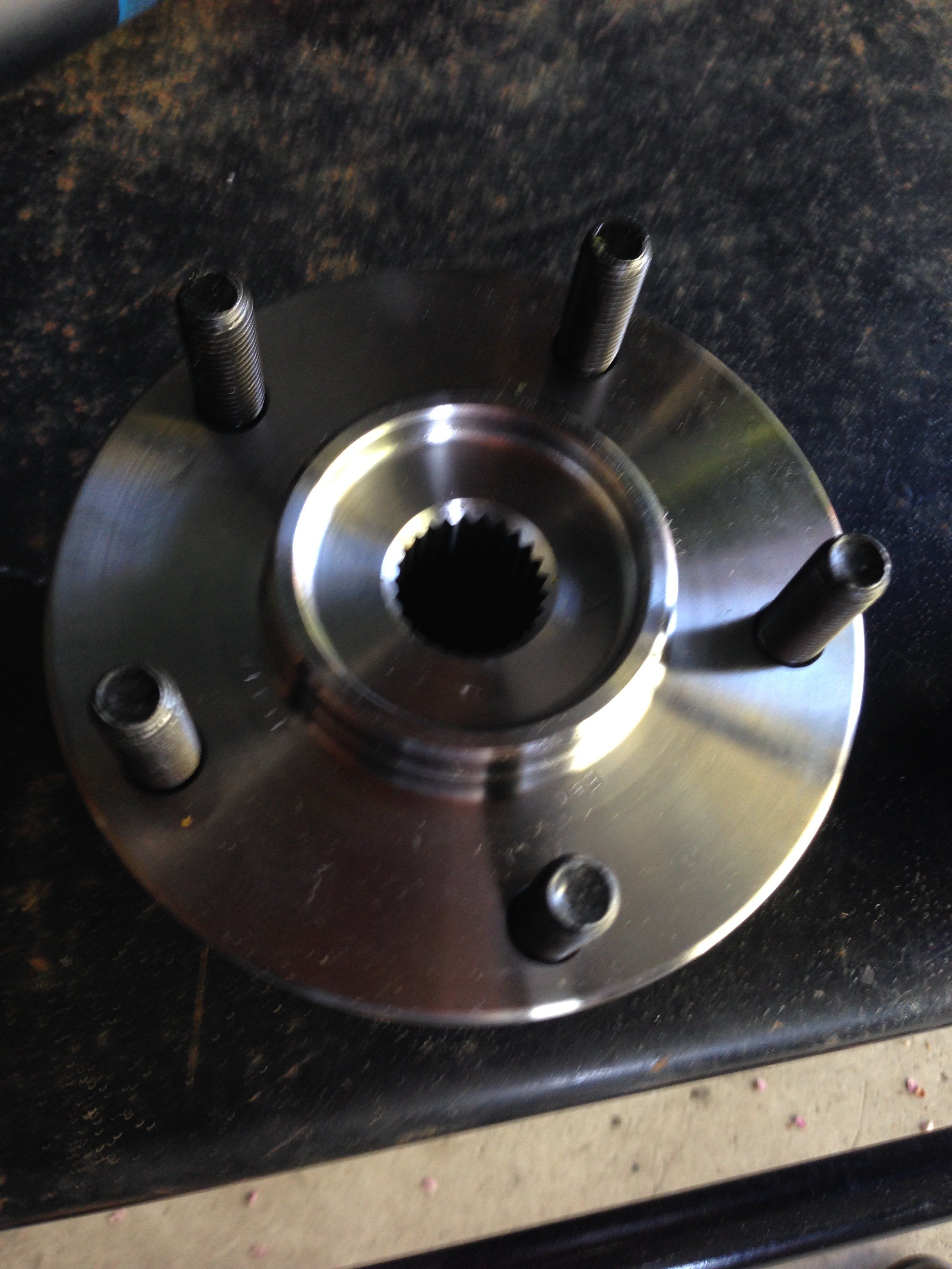

OEM Wheel Bearing (bought both sides)

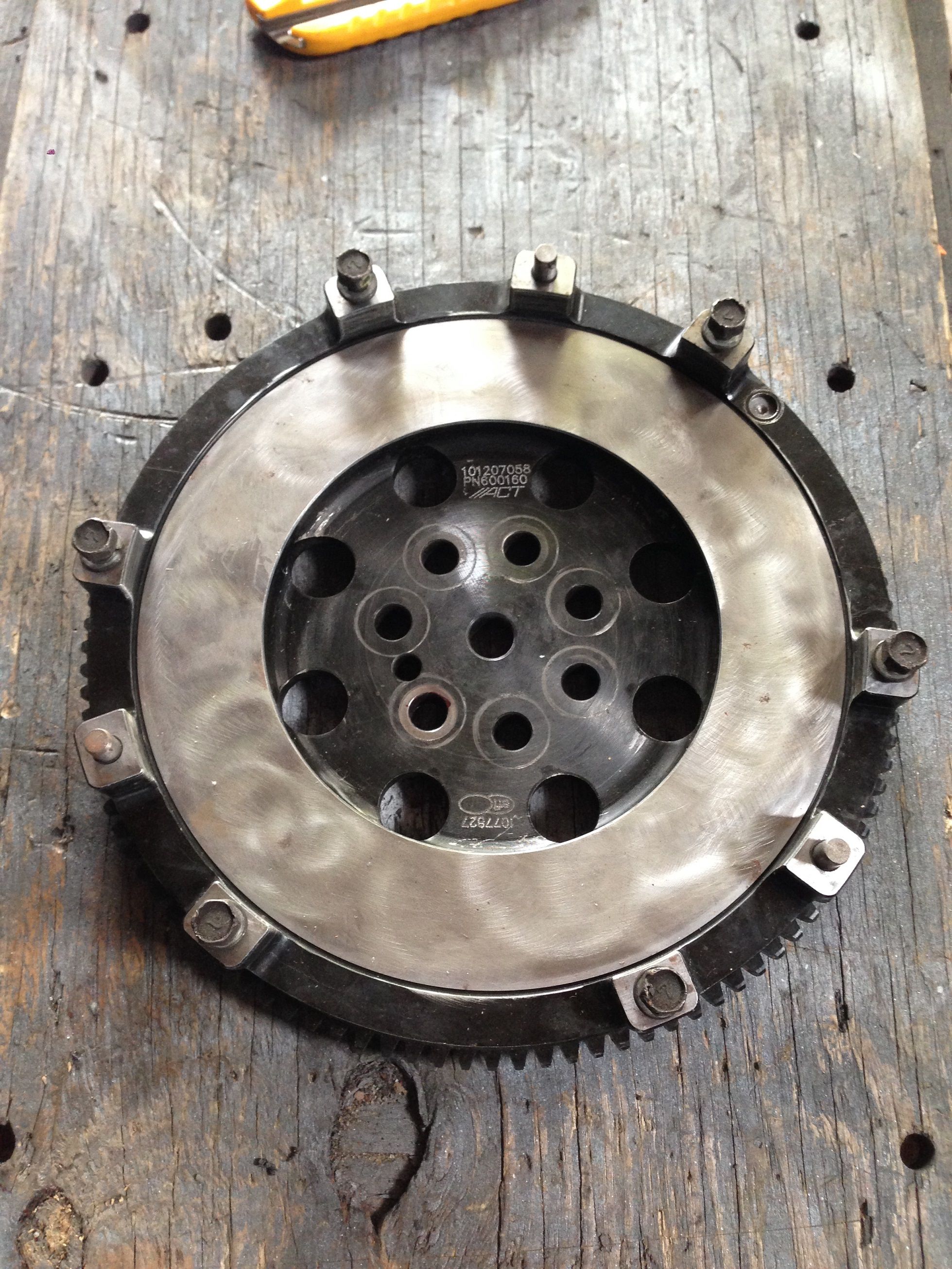

ACT 7 Bolt Lightweight Flywheel

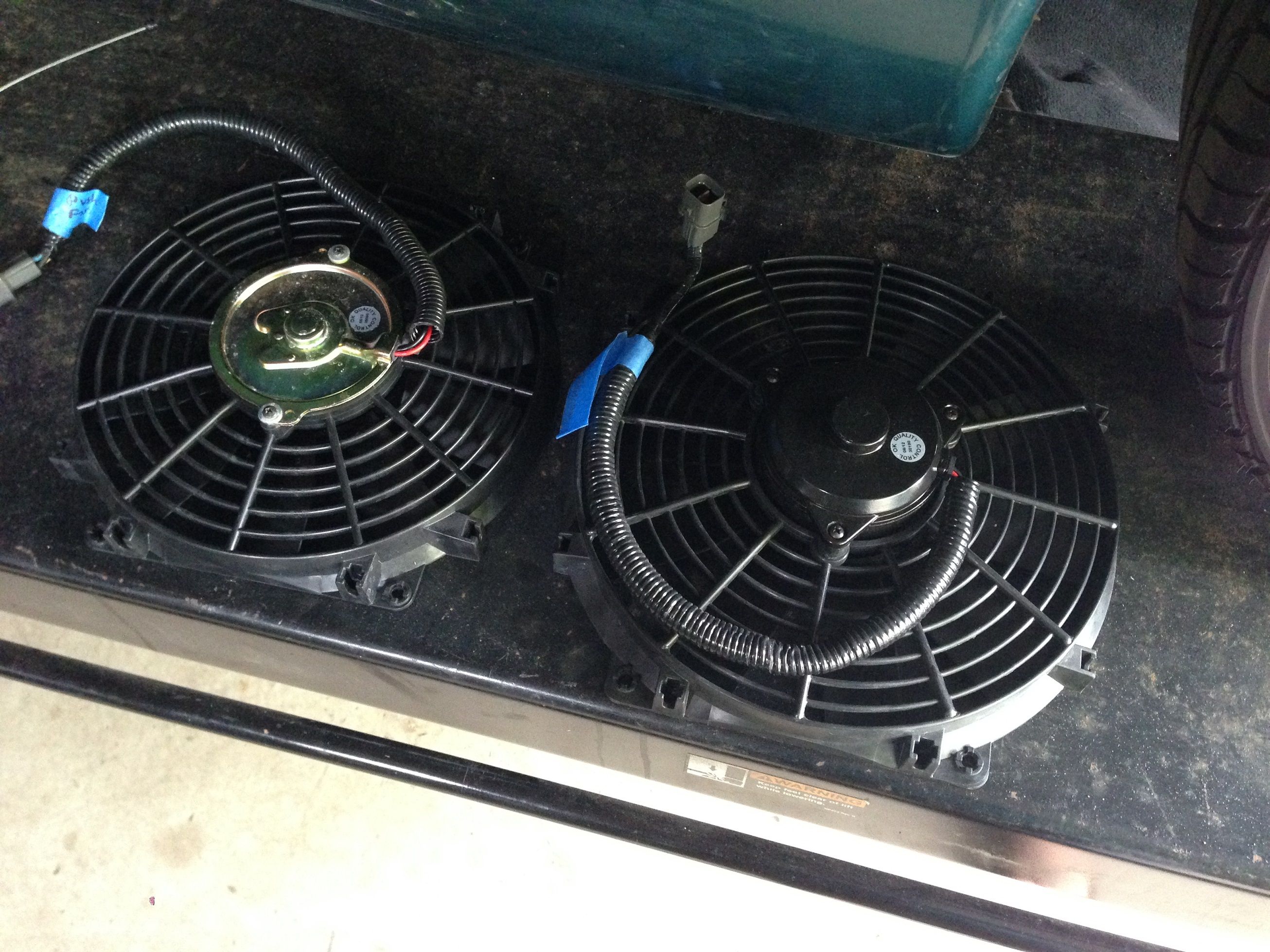

Slim Fans 10" and 12"

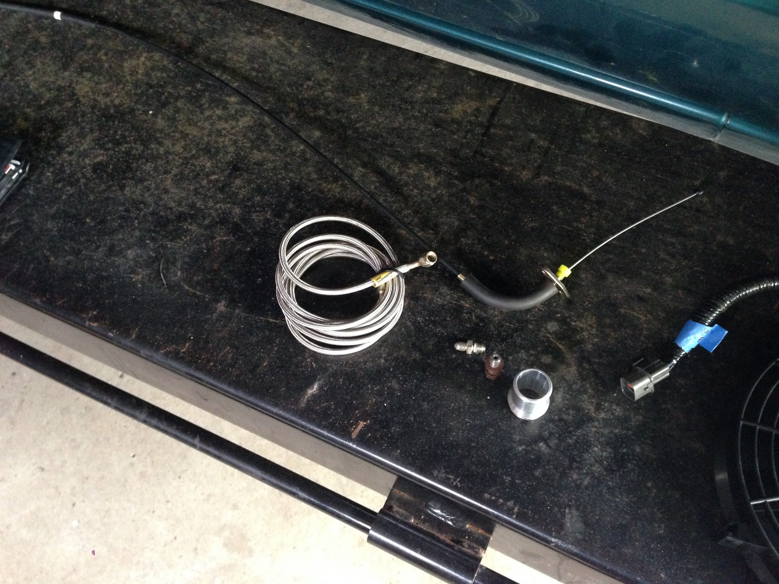

Non cruise Throttle Cable and Braided Clutch Line

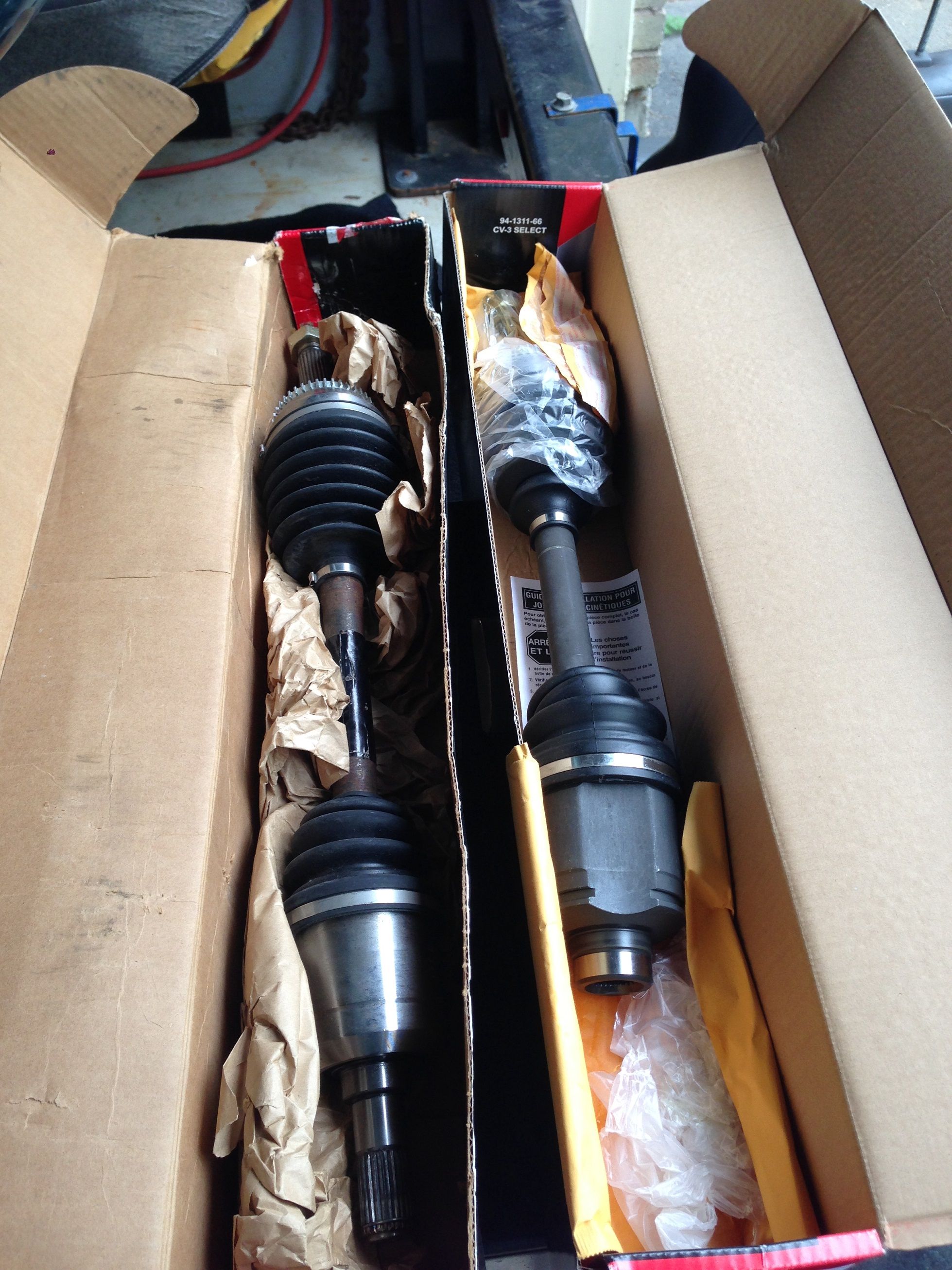

New Axles

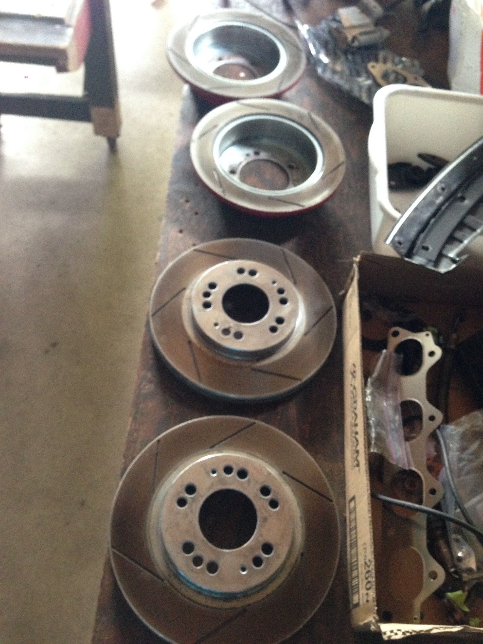

Slotted Rotars

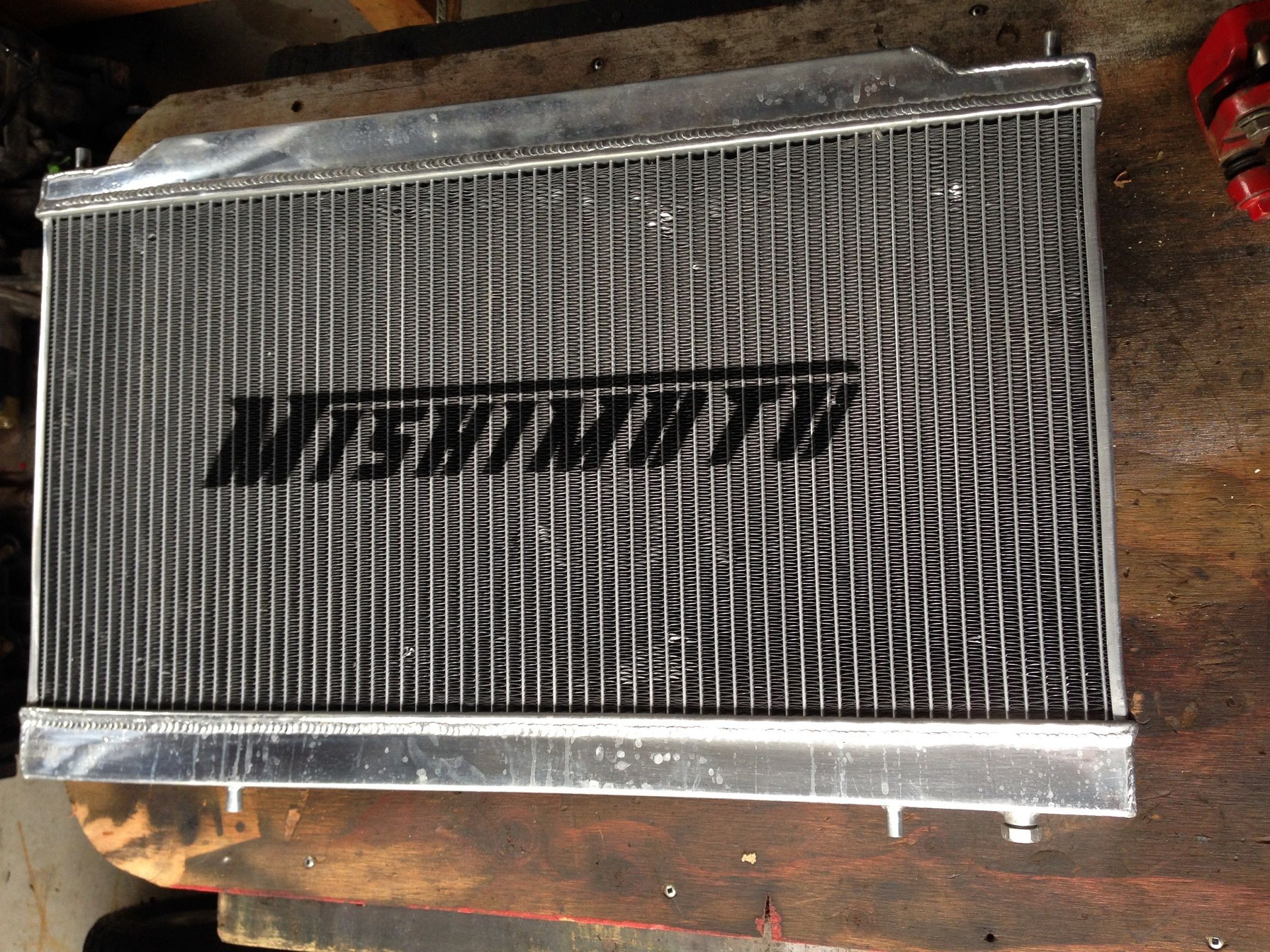

Mishimoto Aluminum Radiator

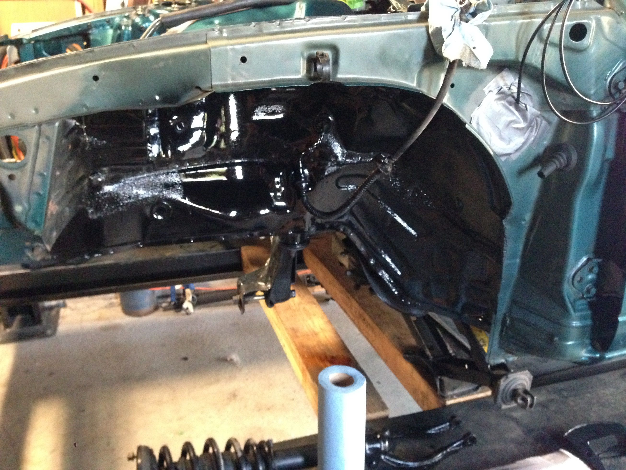

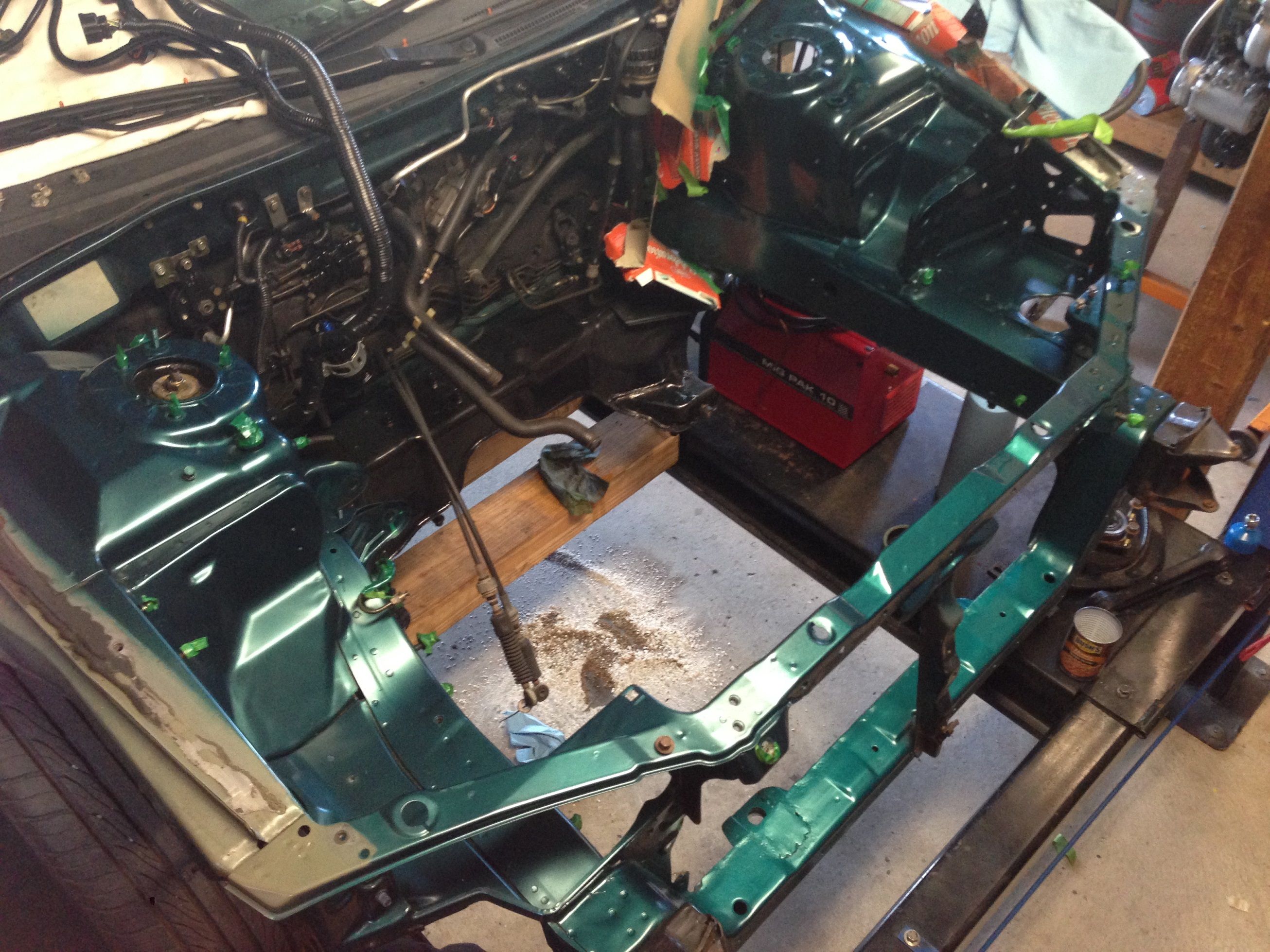

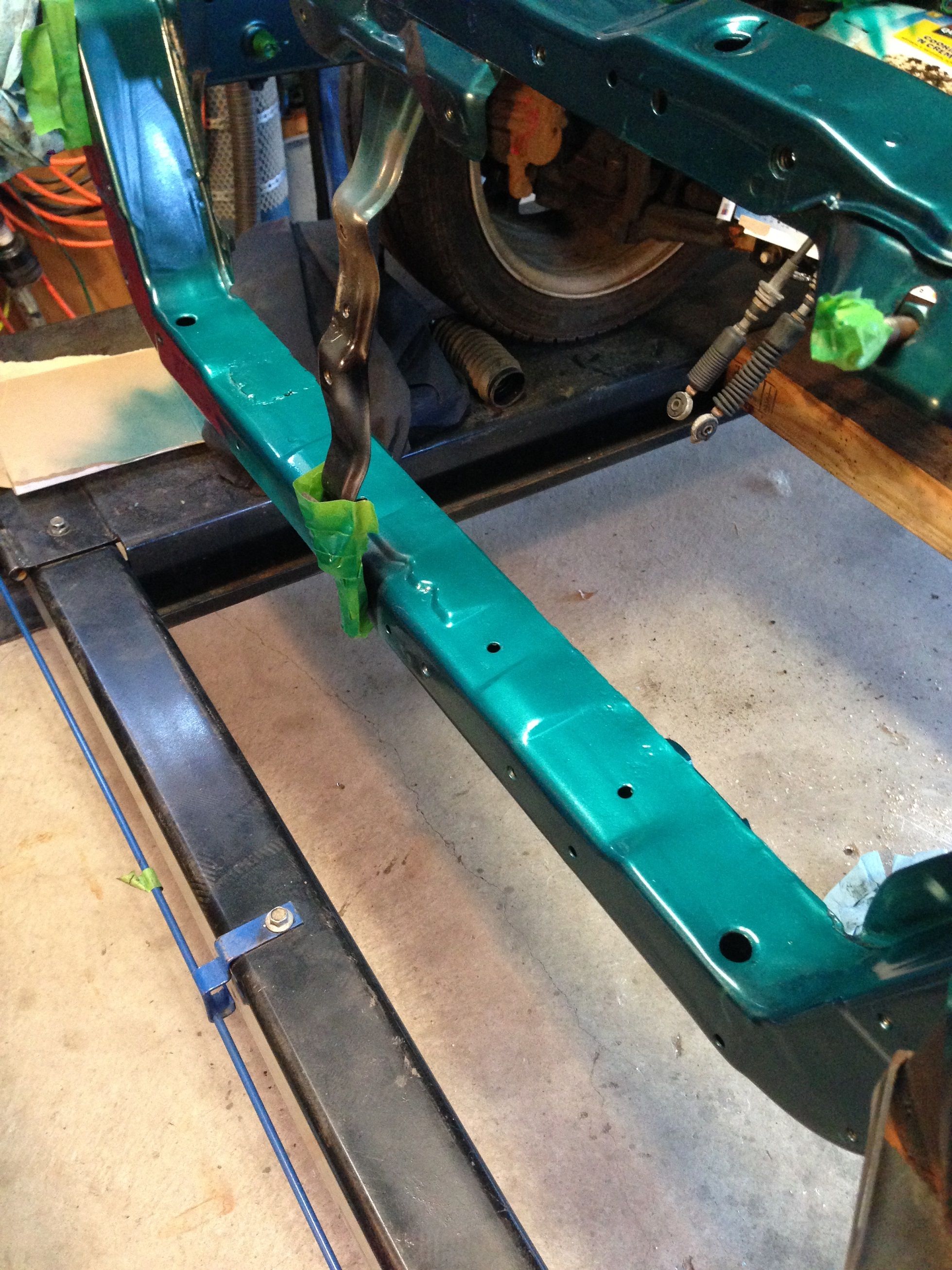

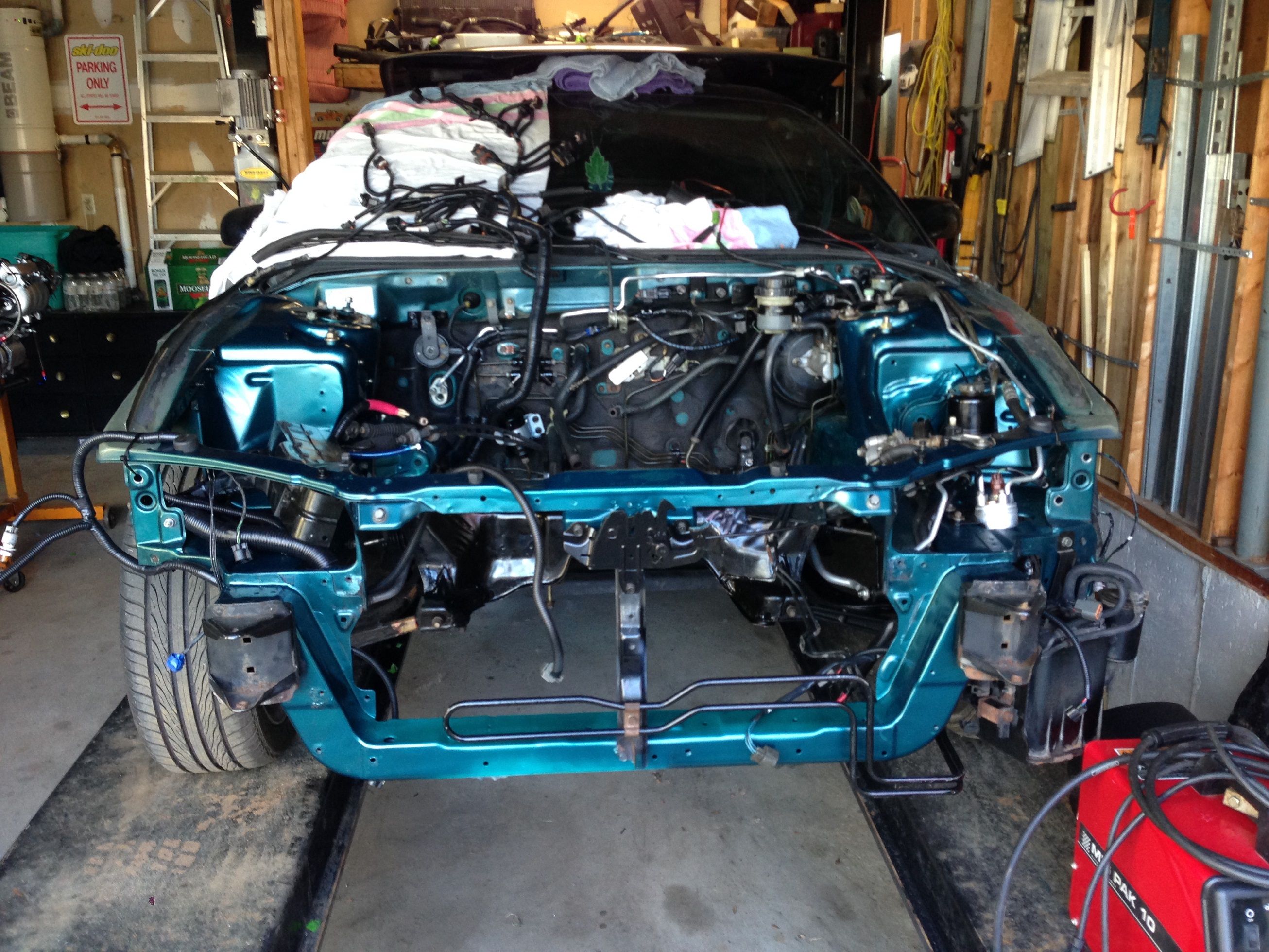

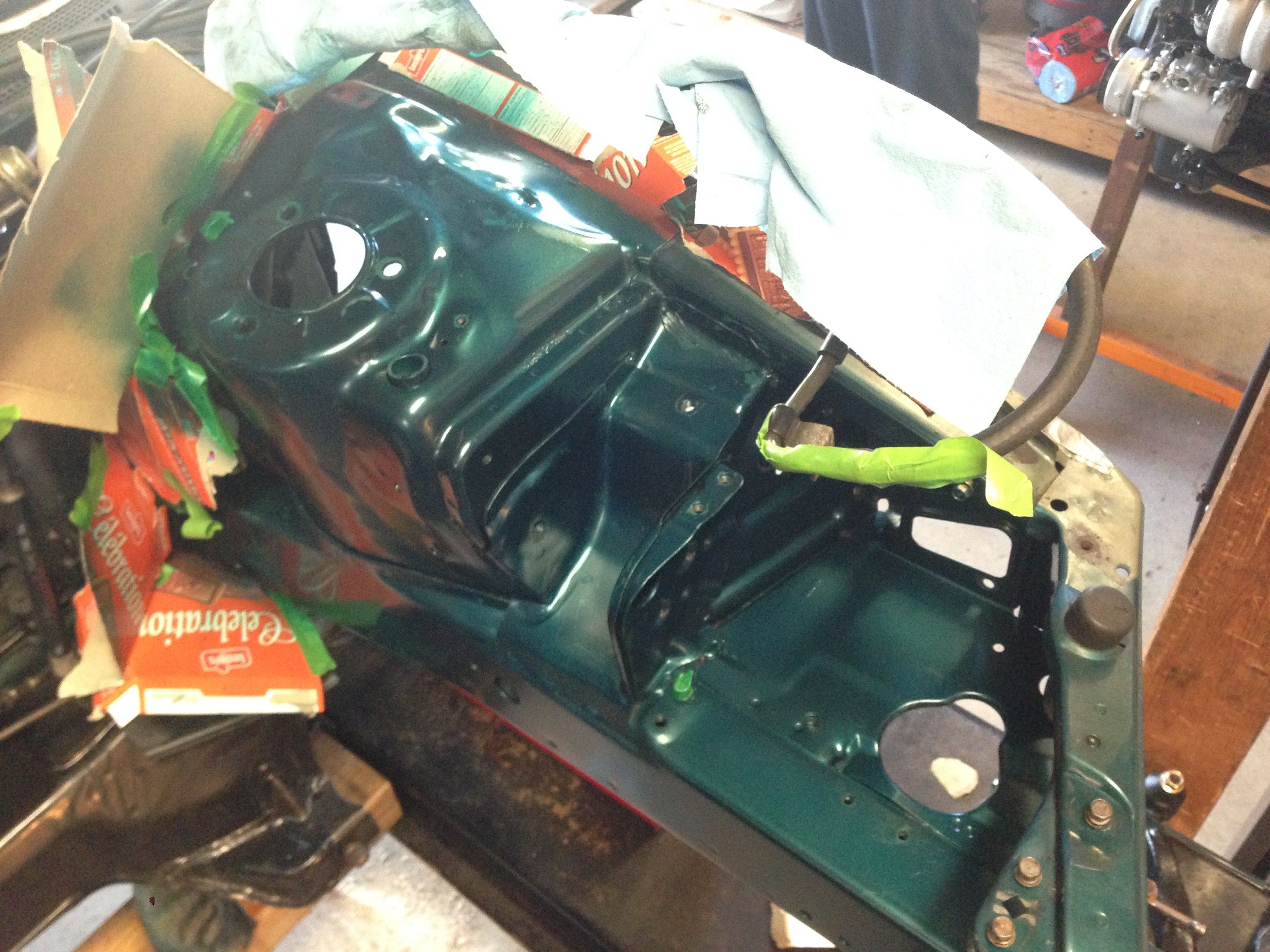

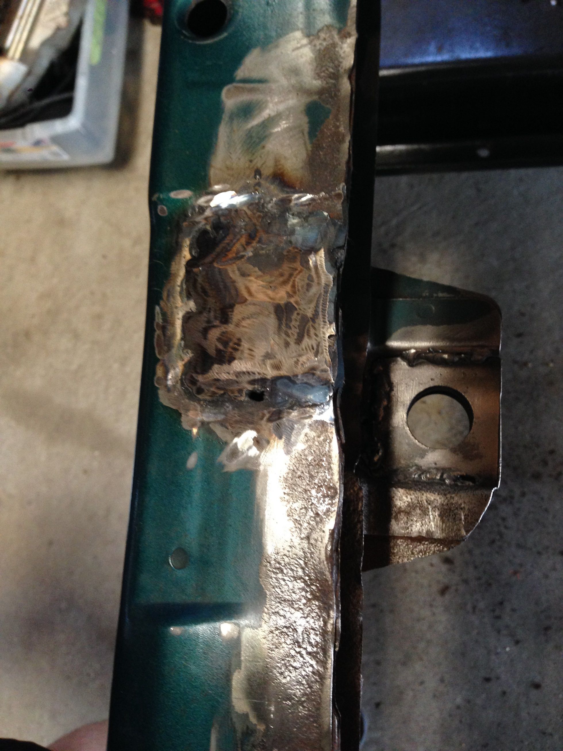

Here is the engine bay all ready for the Engine to be dropped in. Fixed the rust on the rad support and painted the bay with a Ford Duplicolor paint called Cayman Green and it was surprisingly almost 100% identical
New Suspension components in but this is my old wheel bearing not the new one and the coilovers weren't in this picture

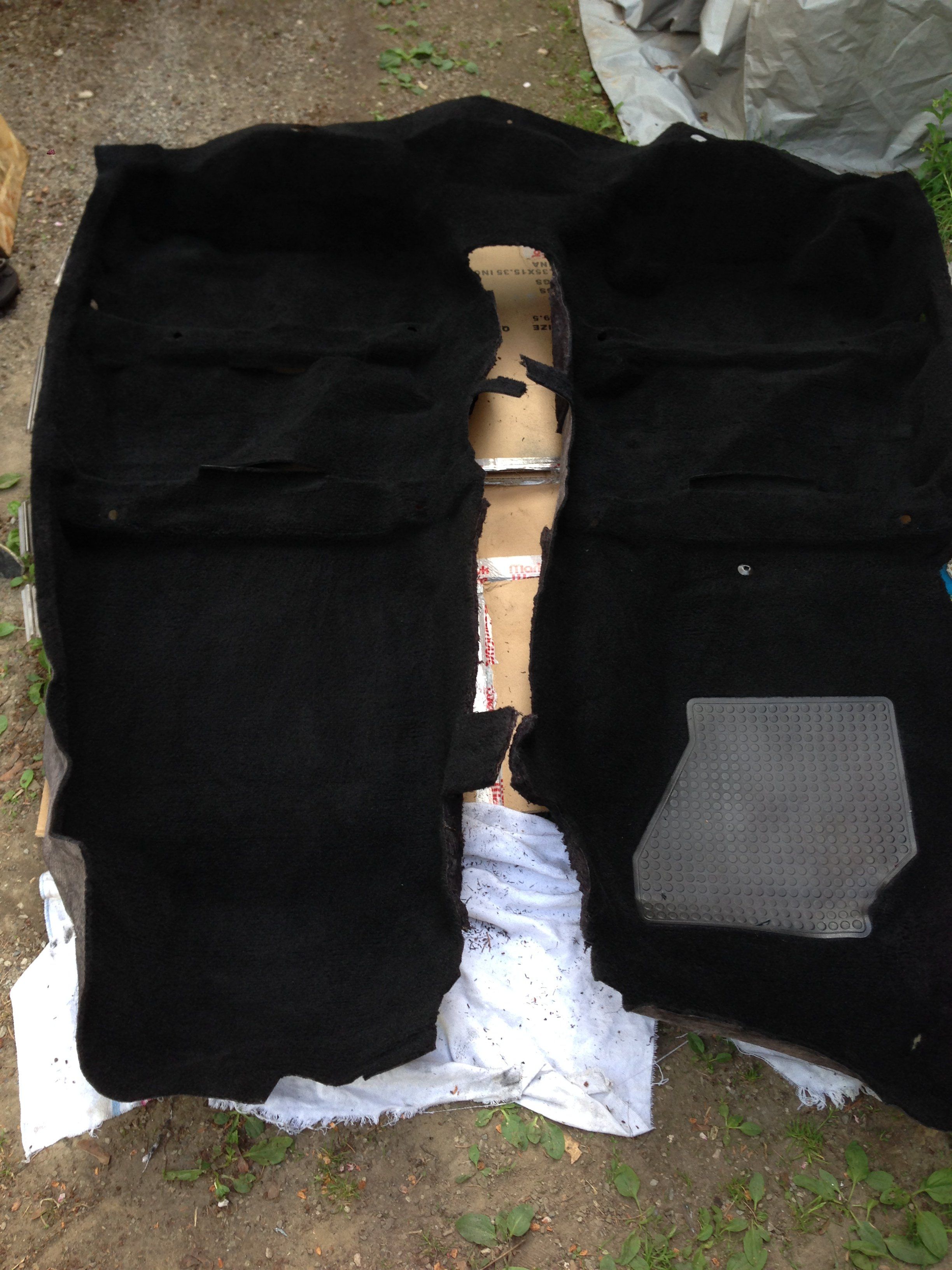

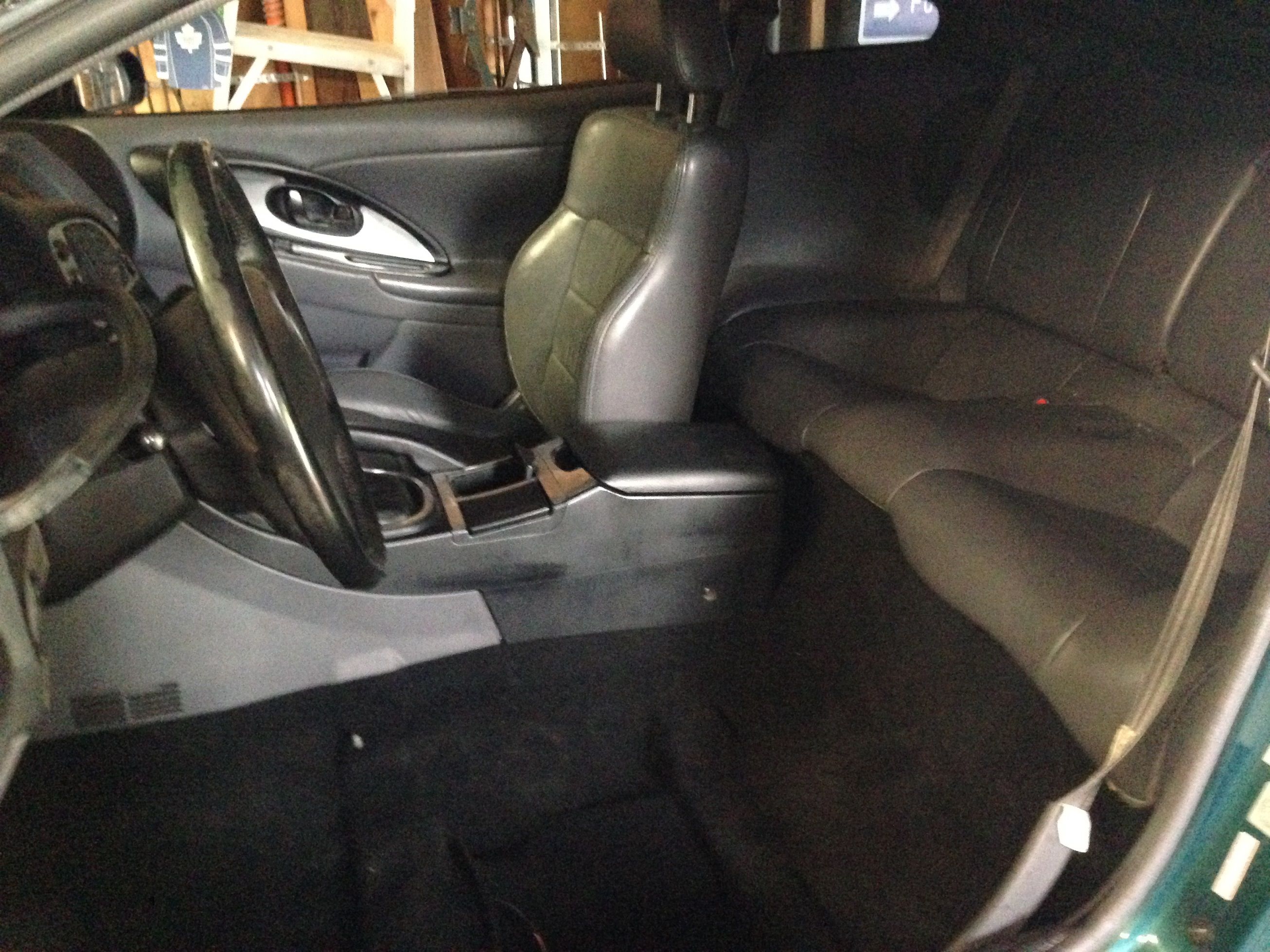

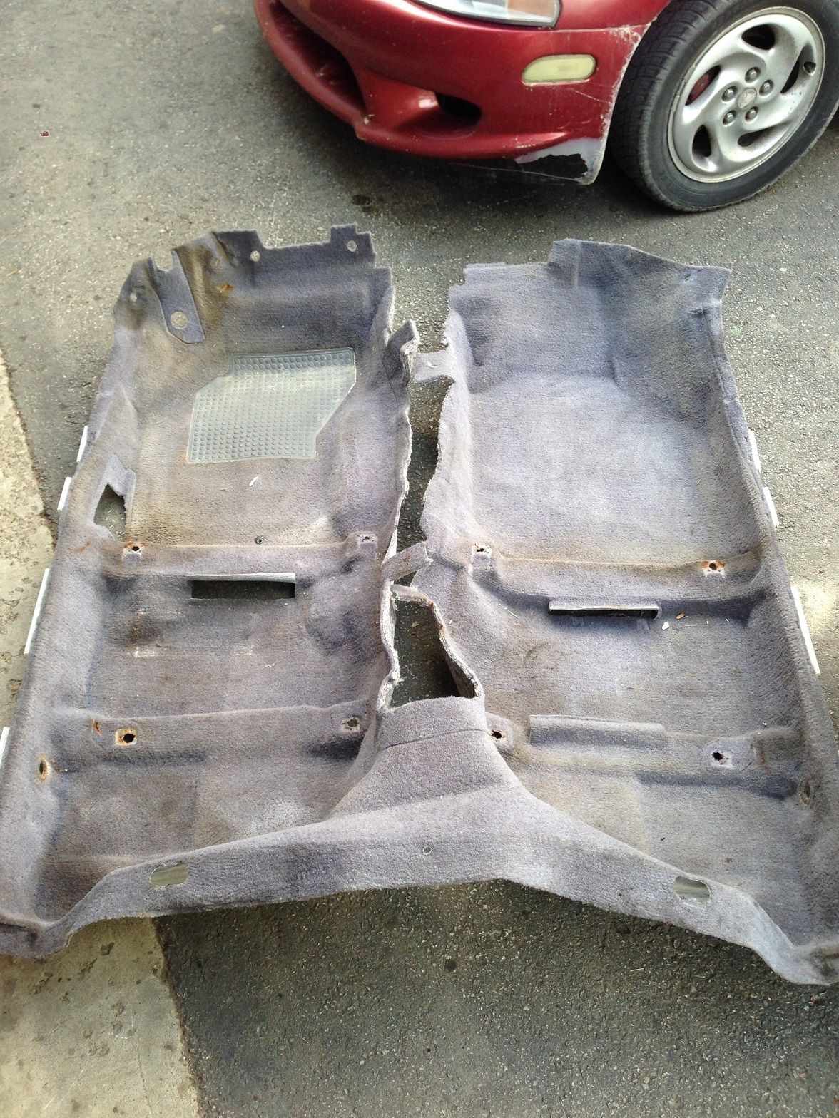

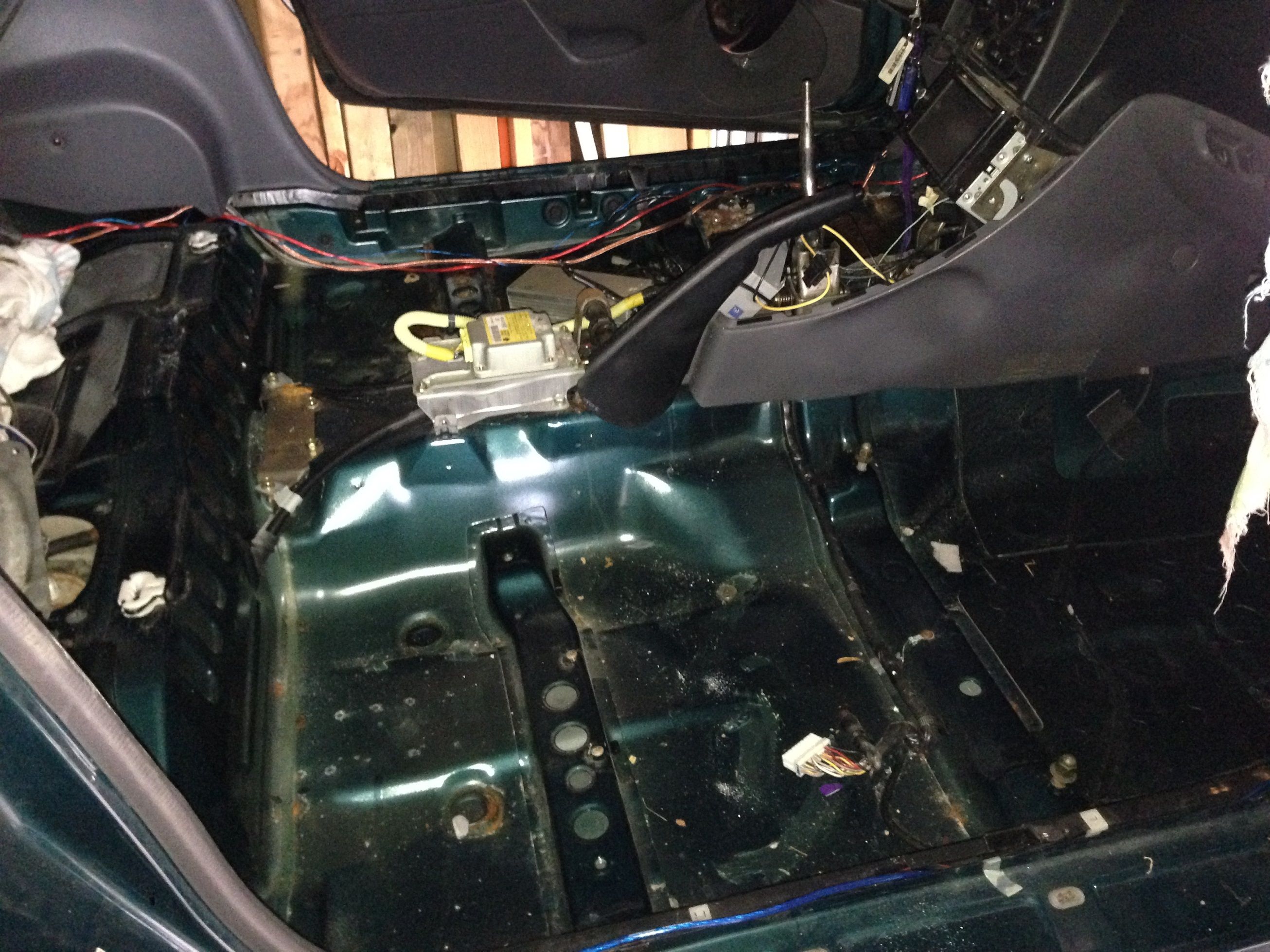

I decided to dye my carpet black while the car was apart and it turned out magnificent! (Rit Dye procedure and then touched up with duplicolor fabric)
Here is the carpet before btw LOL :ohdamn:

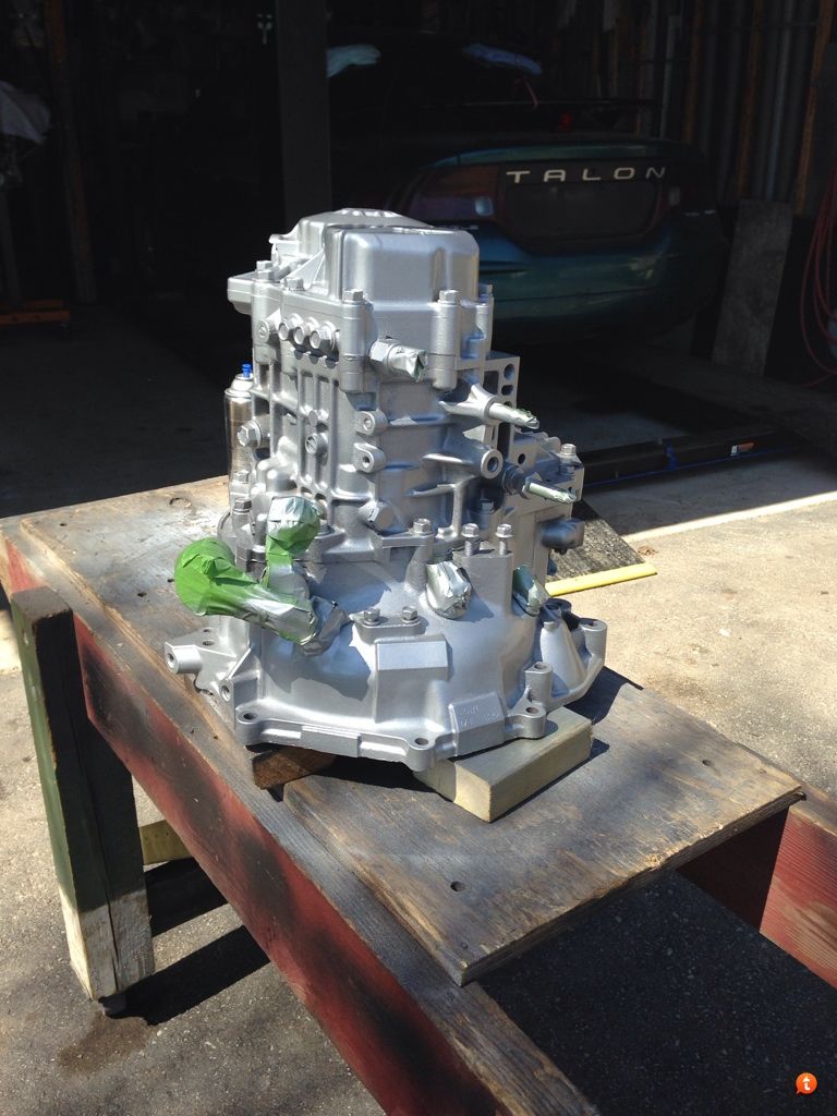

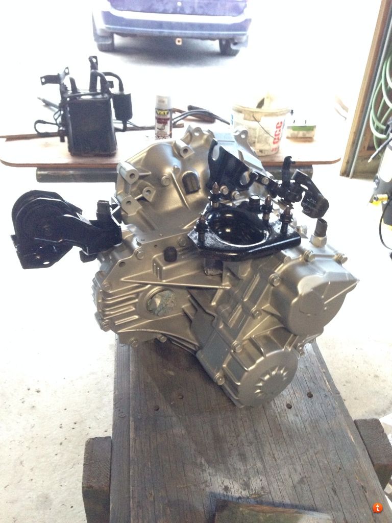

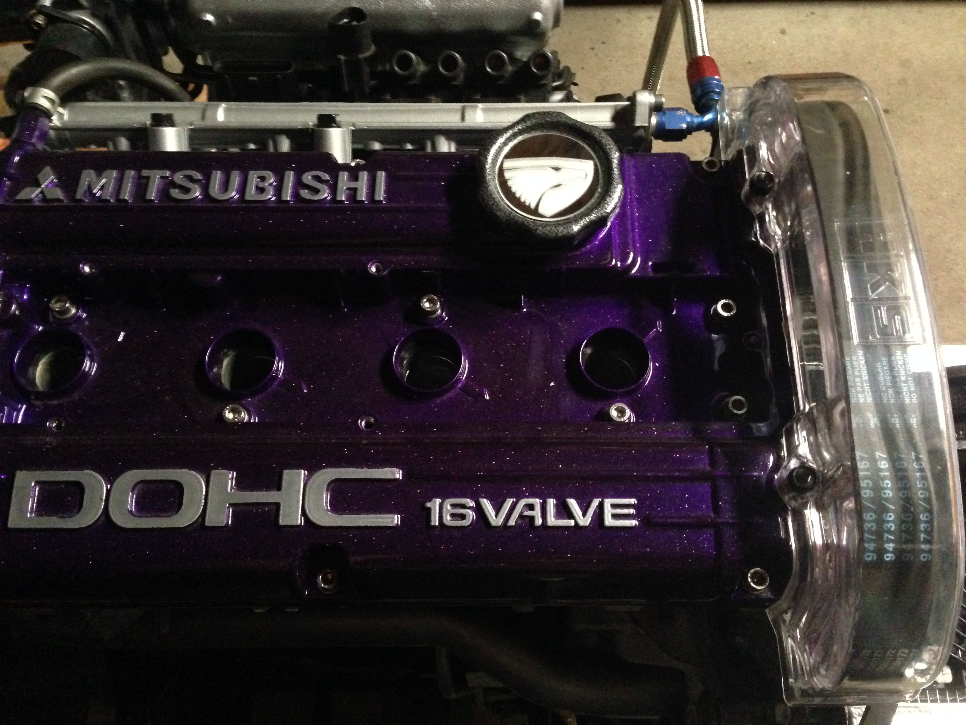

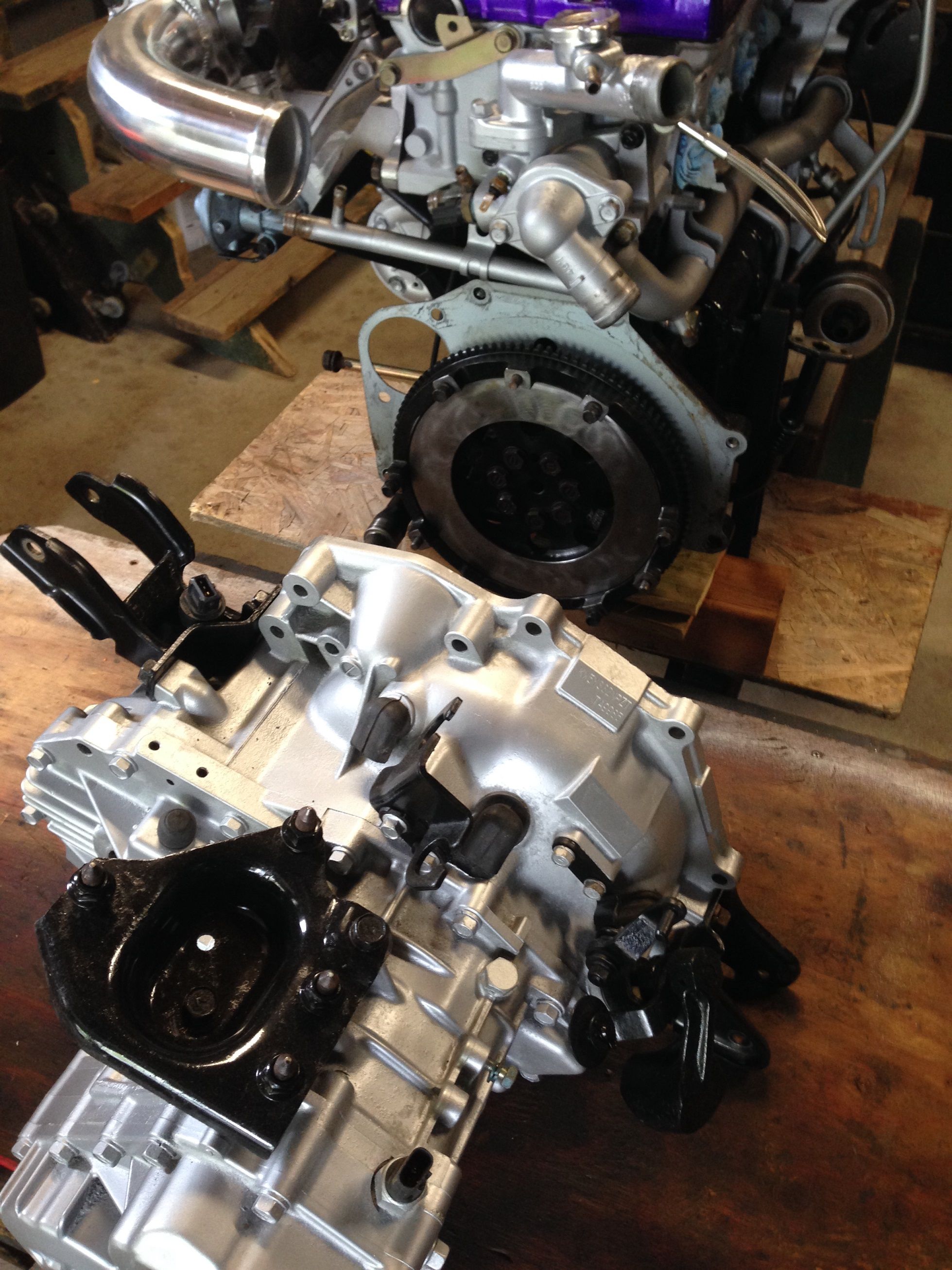

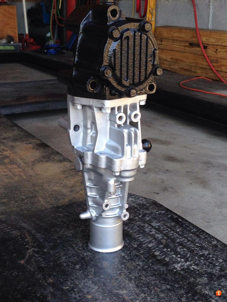

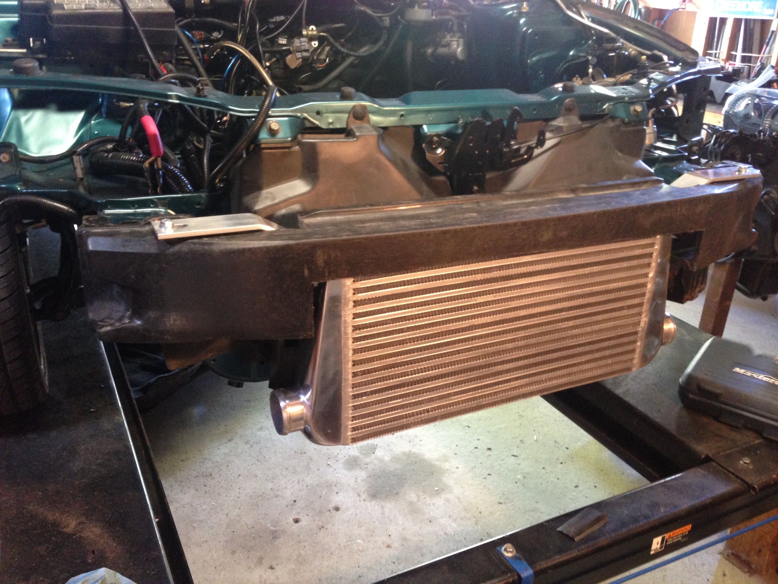

As for the rest of the day today I got the flywheel and clutch in and assembled the transmission and starter motor. Also was able to mount up the FMIC and i believe these are the first pictures of the timing belt on with the HKS cam cover and new oil cap:hellyeah:

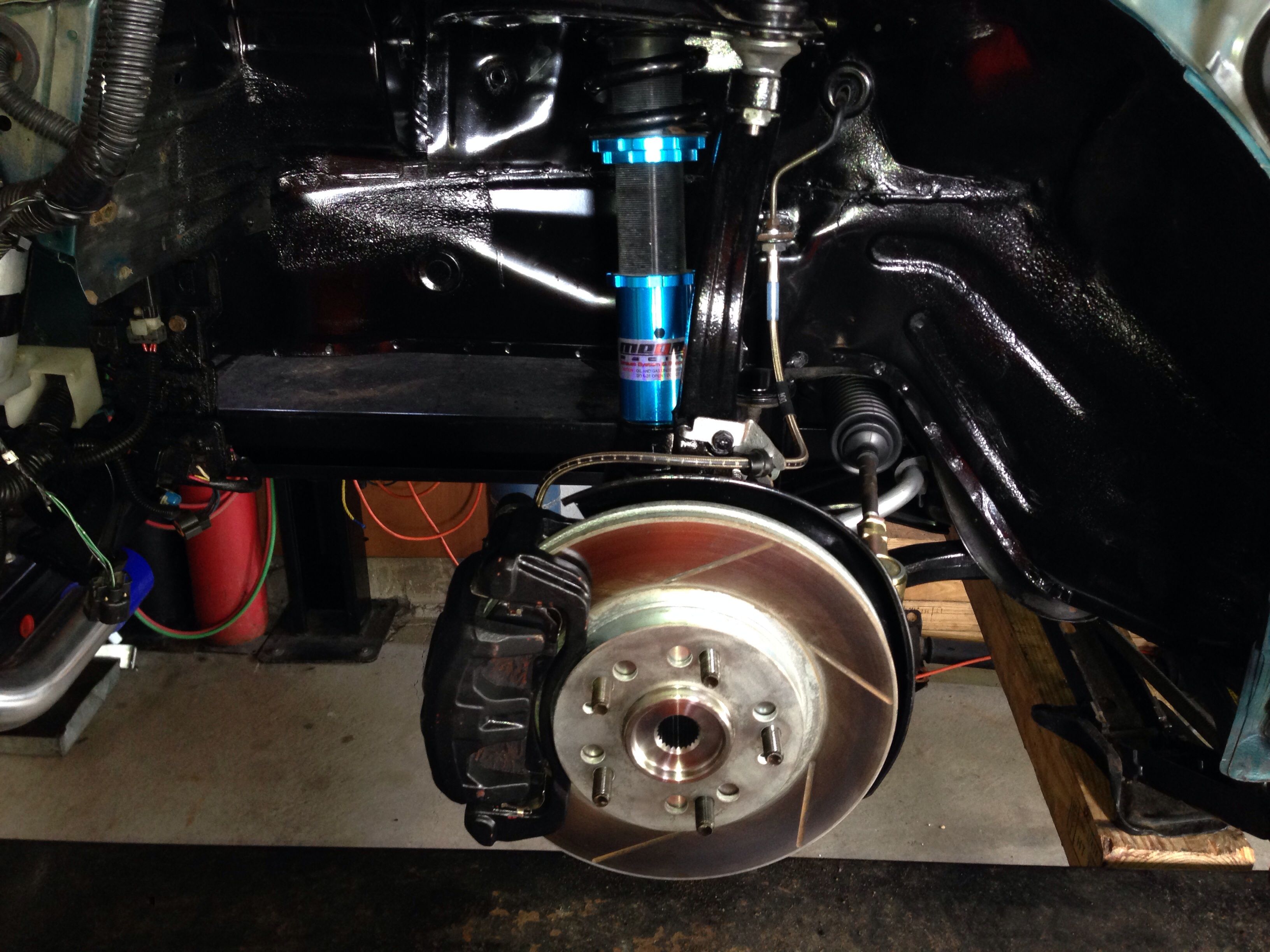

Coilovers and brakes picture. Cleaned up all wheel wells

A little underbody shot with PR FMIC installed

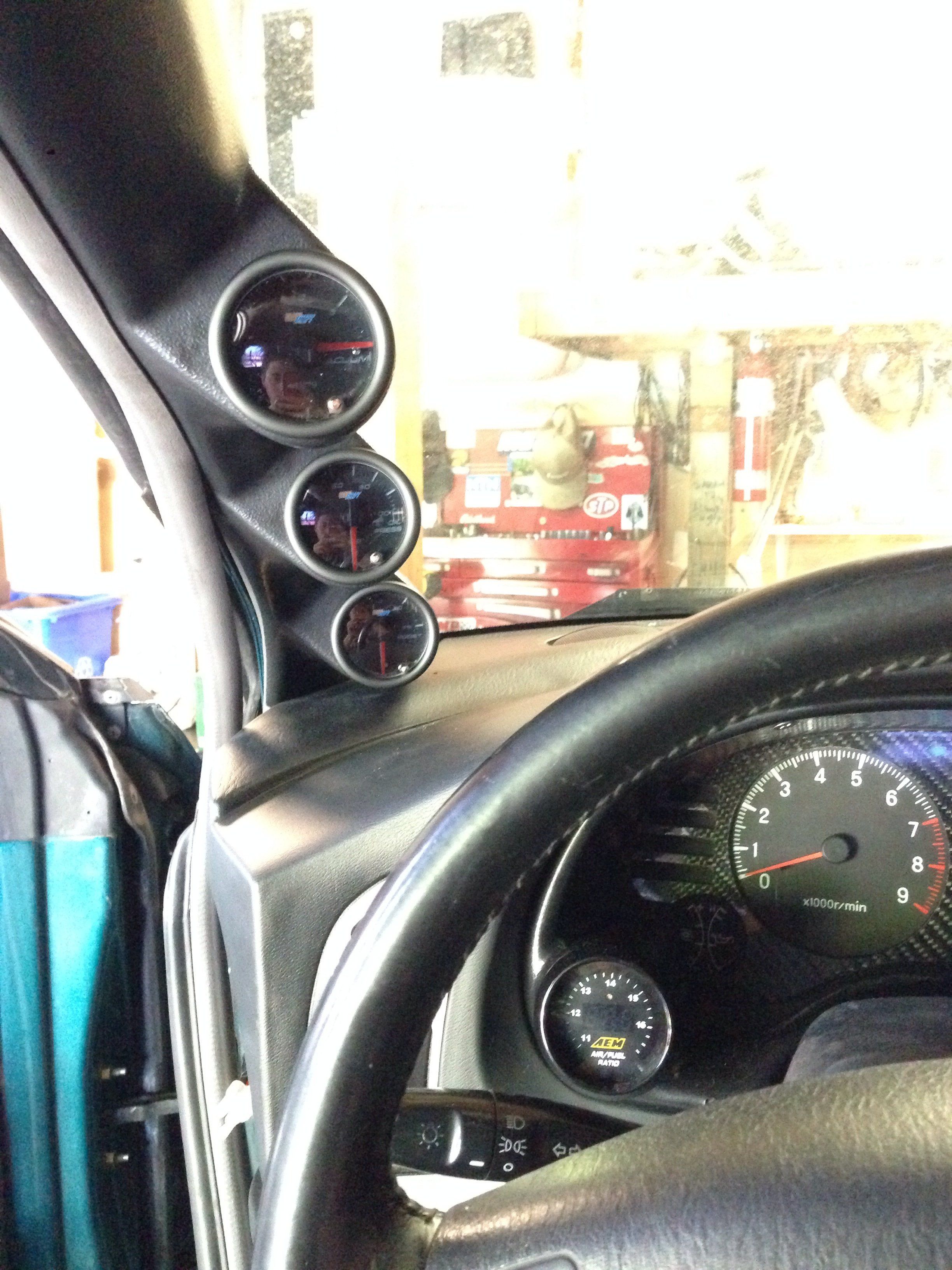

Gauges installed. Getting an aem volt gauge to match the aem wideband gauge for the right side of my new gauge cluster bezel
