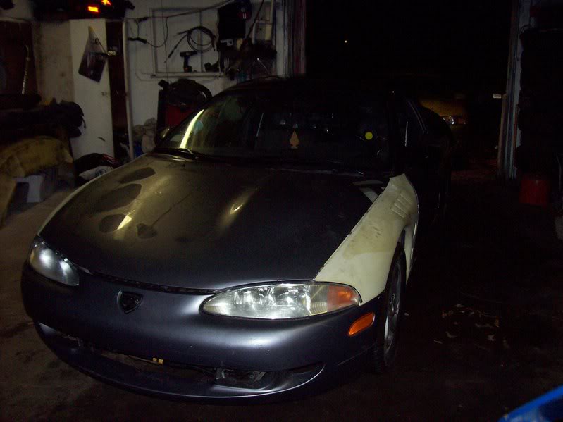

I have owned this car for a while now and in 2002 the car sat because of crank walk. Well she been siting ever since then, until currently,LOL. It's a 95 Eagle Talon AWD 5 speed with 57k original miles and this year she is getting everything done to her. I'm just tired of the car sitting in the back yard and I want her running this year again. Reason she sat so long was 1) at the time I was restoring flipping DSMs 2) juggling a wife and kids and 3) in and out of jobs trying to better myself.
Here is what she looked like now:

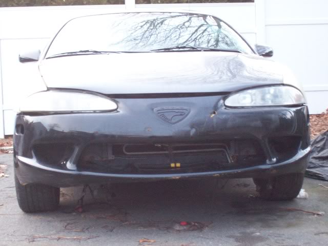

This is what I want it to look like when it's done:

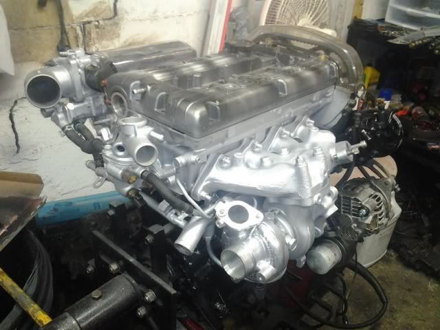

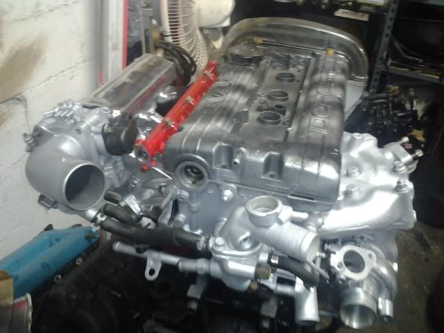

I pretty much have everything I need to put her together:
New Parts List:
*******ENGINE********
- 91 6 bolt engine
- Fresh rebuild head

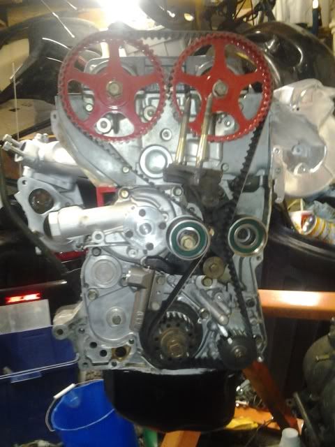

- 272 FFWD connection "DKS" cams
- BS removed
- Stock short block
- A new timing belt components
- New water pump
*******TURBO/INTERCOOLER SYSTEMS**********
- Brand new 38mm Tial wastegate
- Big 16g
- 12x28x3 universal FMIC
- Custom made for a 2g steel intercooler pipes w/ SBR J-pipe
- Hallman boost controller
*********EXHAUST SYSTEM*****************

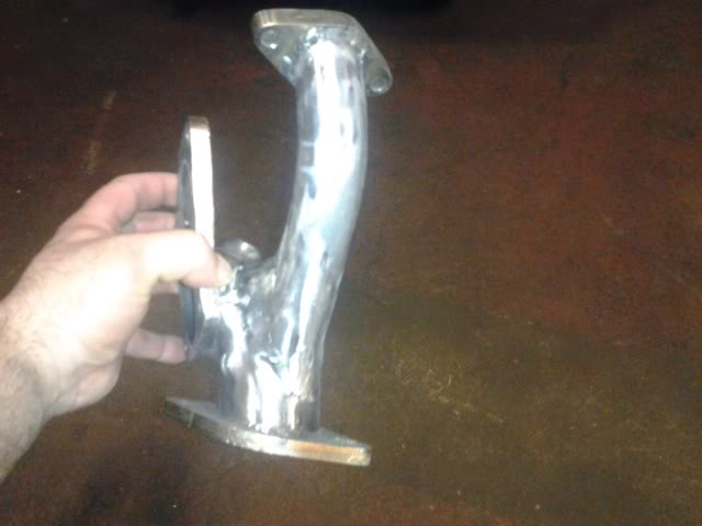

- EVO 3 ported manifold with external gate flange
- 2.5 punisher o2 housing w/ custom recirculate waste gate dump in the exhaust
- 3' inch DP (unknown company)
- 3' inch exhaust cat back w/ a cat ( unknown exhaust system)
********FUEL SYSTEMS & TUNING*************
- PTE 680ccs injectors
- FPR Aeromotive
- 95 ECU EProm running ECMTuning ECMLink Lite v3
- AEM wide band
- Autometer EGT gauge
- Walbro 255lph fuel pump
**********IGNITION*********
- stock coils
- 10mm wires
- NGK BR7ES spark plugs
- 93 CAS Black Top
- Custom spark plug cover
***********DRIVETRAIN*******
- stock transmission/t-case/drive shaft/ rear diff
- ACT 2100 clutch
- B&G syncro mesh
***********SUSPENSION & BRAKES SYSTEM ********
- H&R springs
- KYB struts
- Slotted rotors
- Ebc green stuff pads
*********** WHEELS & TIRES**********************
- 17'S Black and polish Nuclear Racing (for now until I get my 18s later)
- Falken's tires 205/45/17

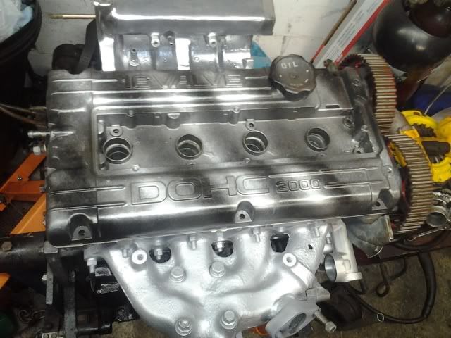

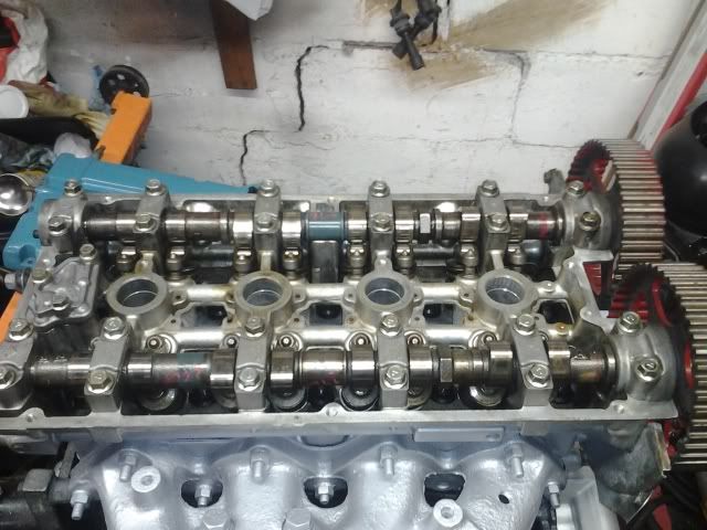

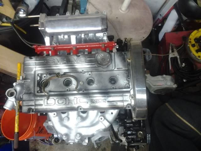

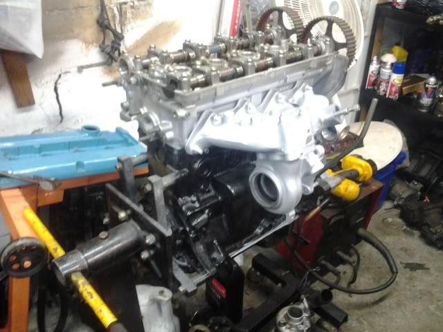

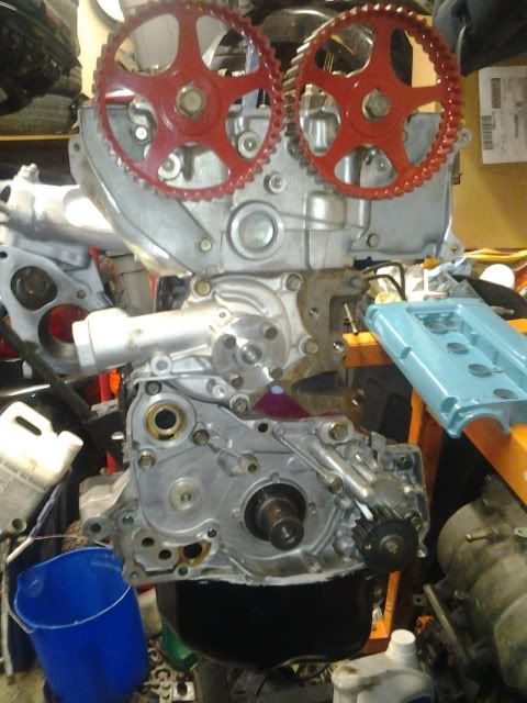

DKS 272 cams

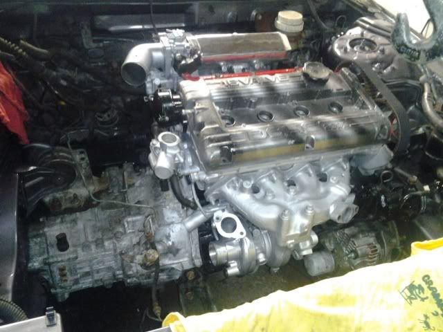

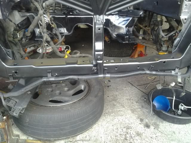

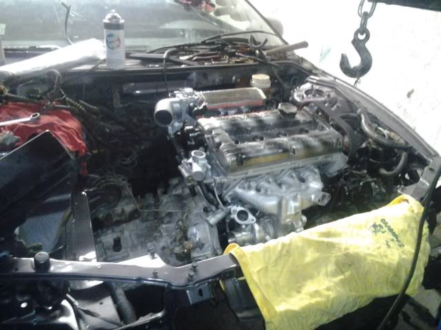

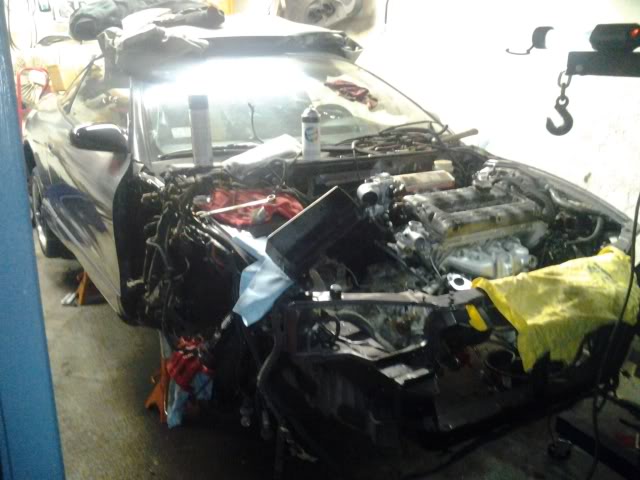

Put in some time with her today and man I'm so excited. I miss this car so bad and I know when I drive it again flash backs with reappear :wink:

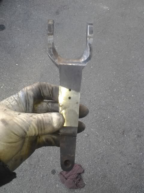

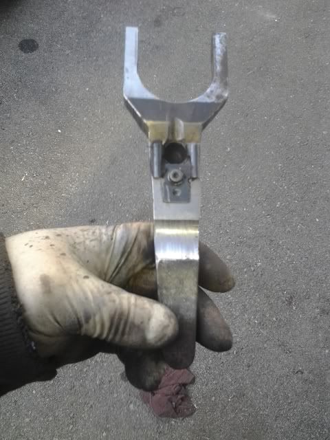

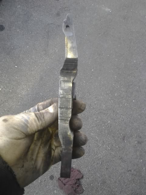

Custom made shift fork that was made for me years ago by a very skilled machine operator

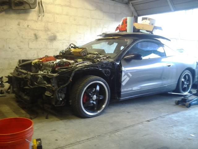

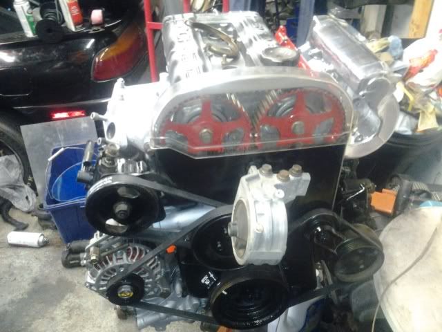

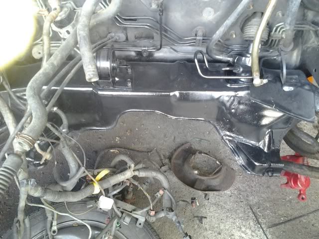

She is in!!!!
I can't wait to hear her purrr.....

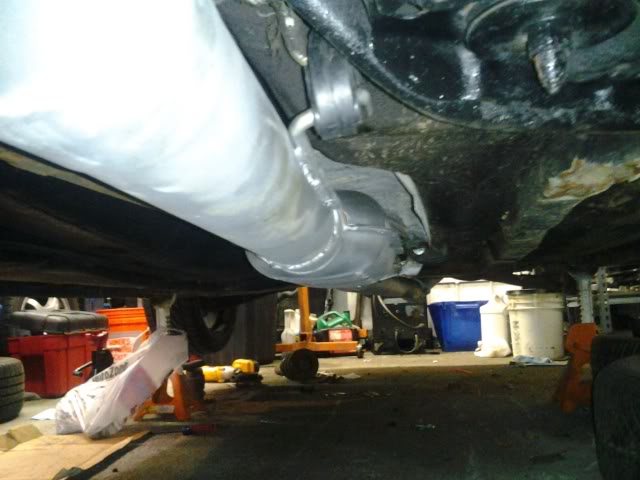

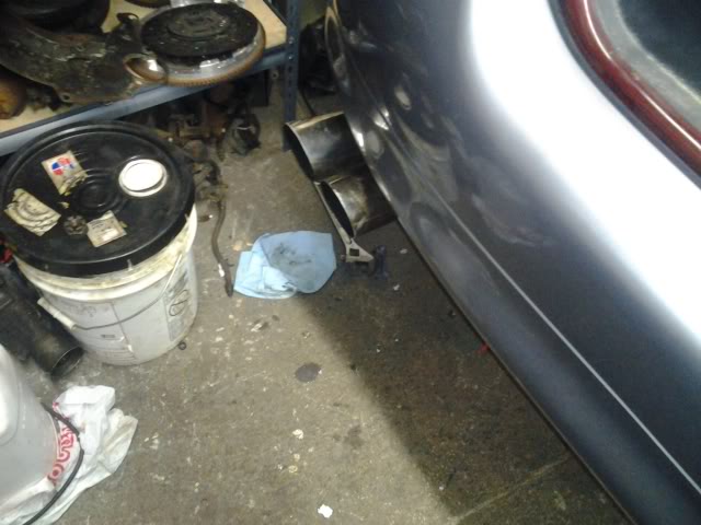

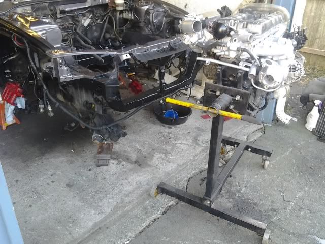

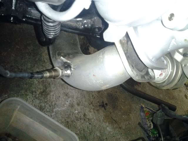

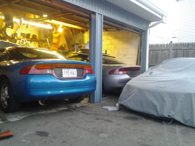

Update 5/3/13:

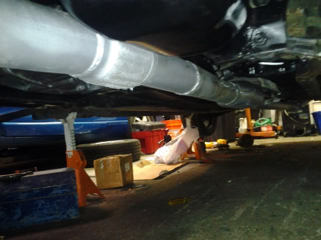

The exhaust is cut, welded and on the car.
She on the ground now, yes!!!
Garage looks good with 2 2gs :wink:
