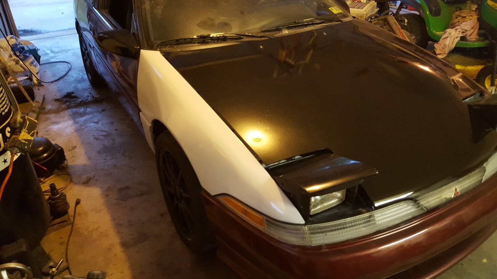

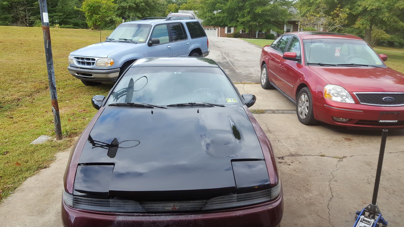

Here's a few cosmetic updates haven't done much mechanical other than driving it and loving it started on some of the painting got a lot of wet sanding and buffing to go

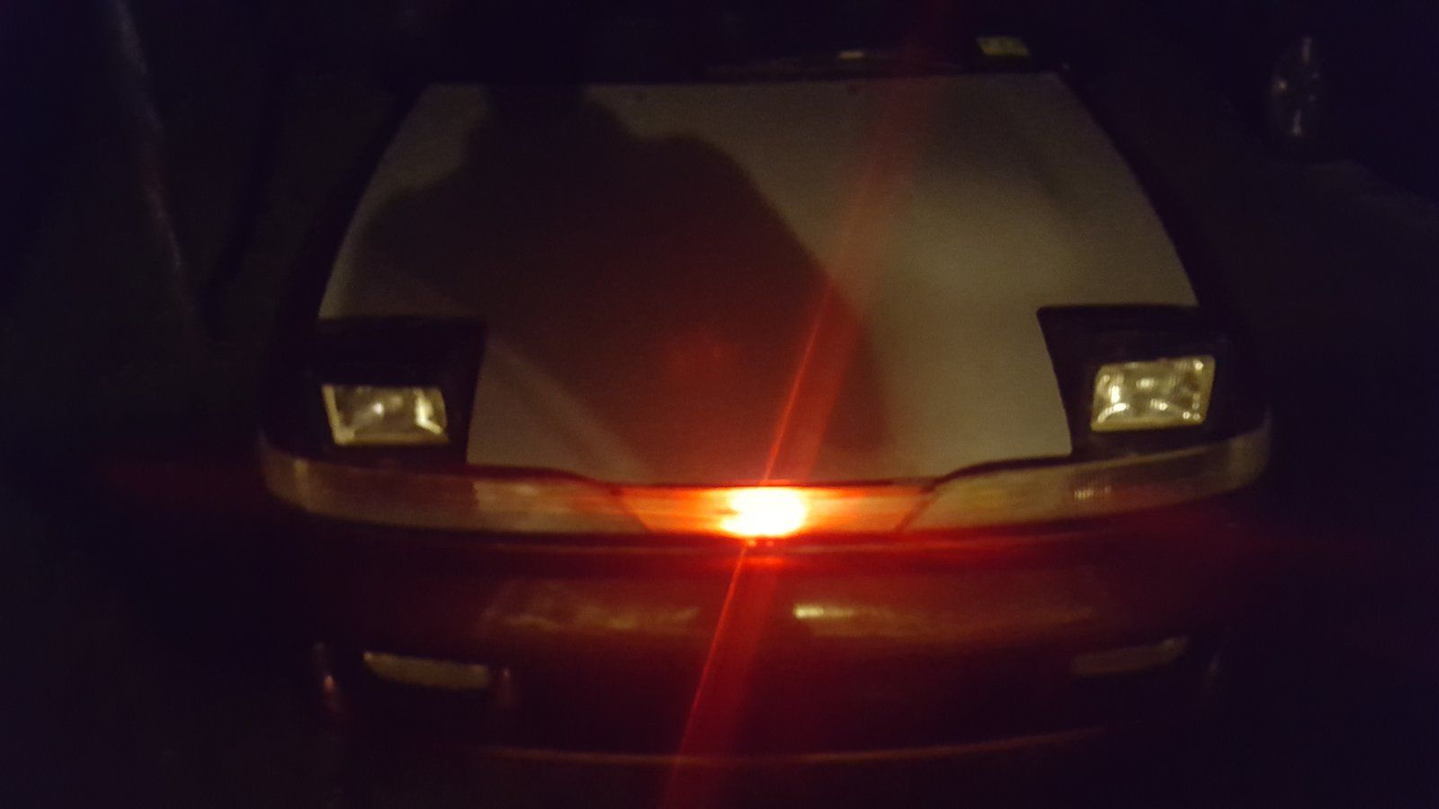

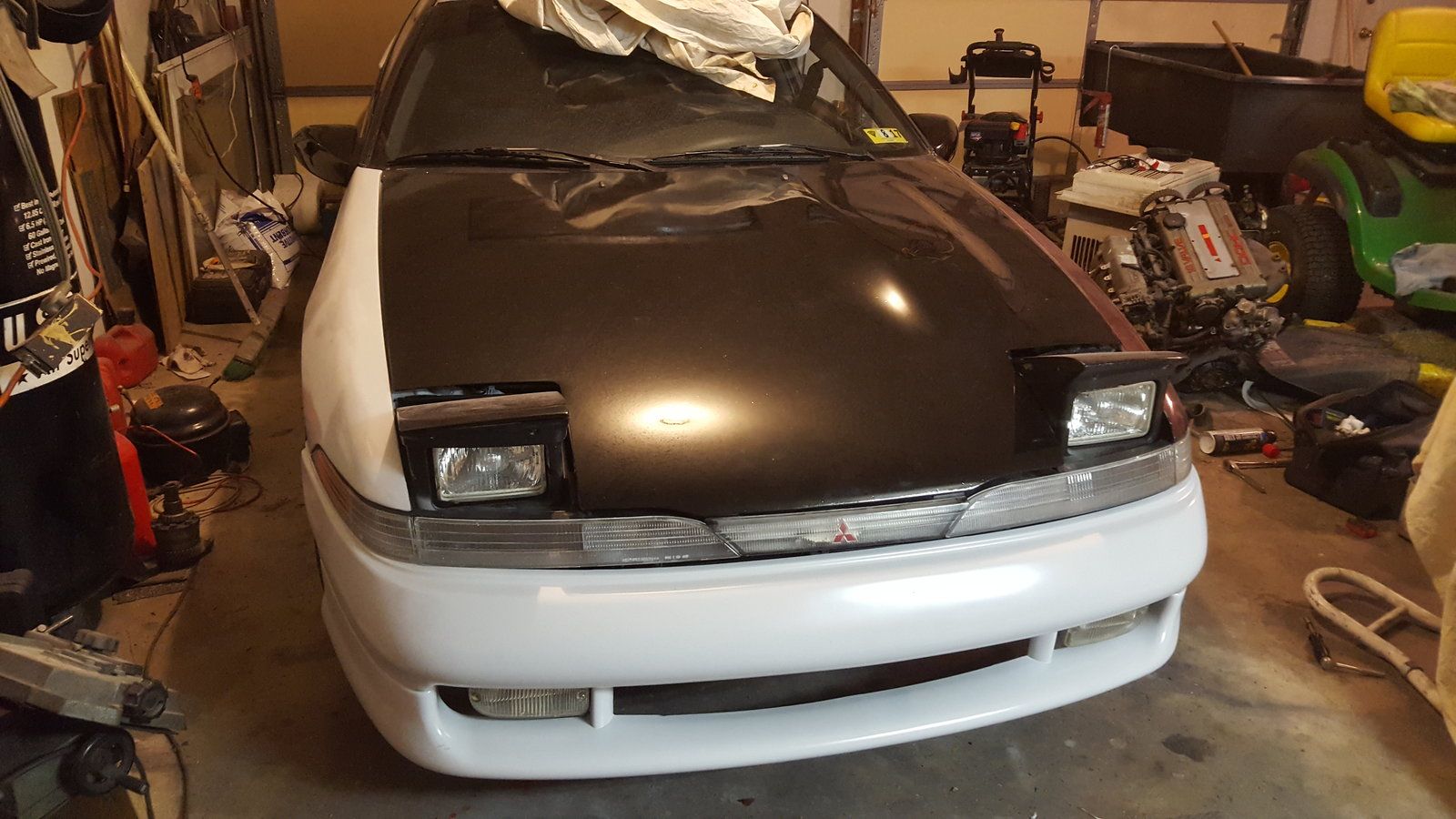

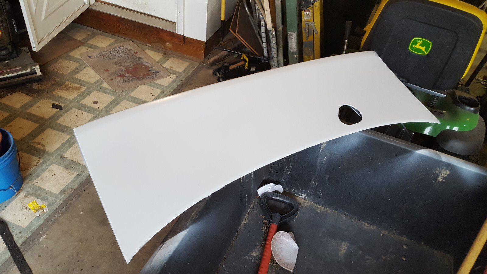

Here's a couple more pics from tonight getting things and sealer one by one and adding a few little lighted touches
The white is just a sealer to make the red a little extra bright that i plan to our on top, but the panda look is growing on me fast

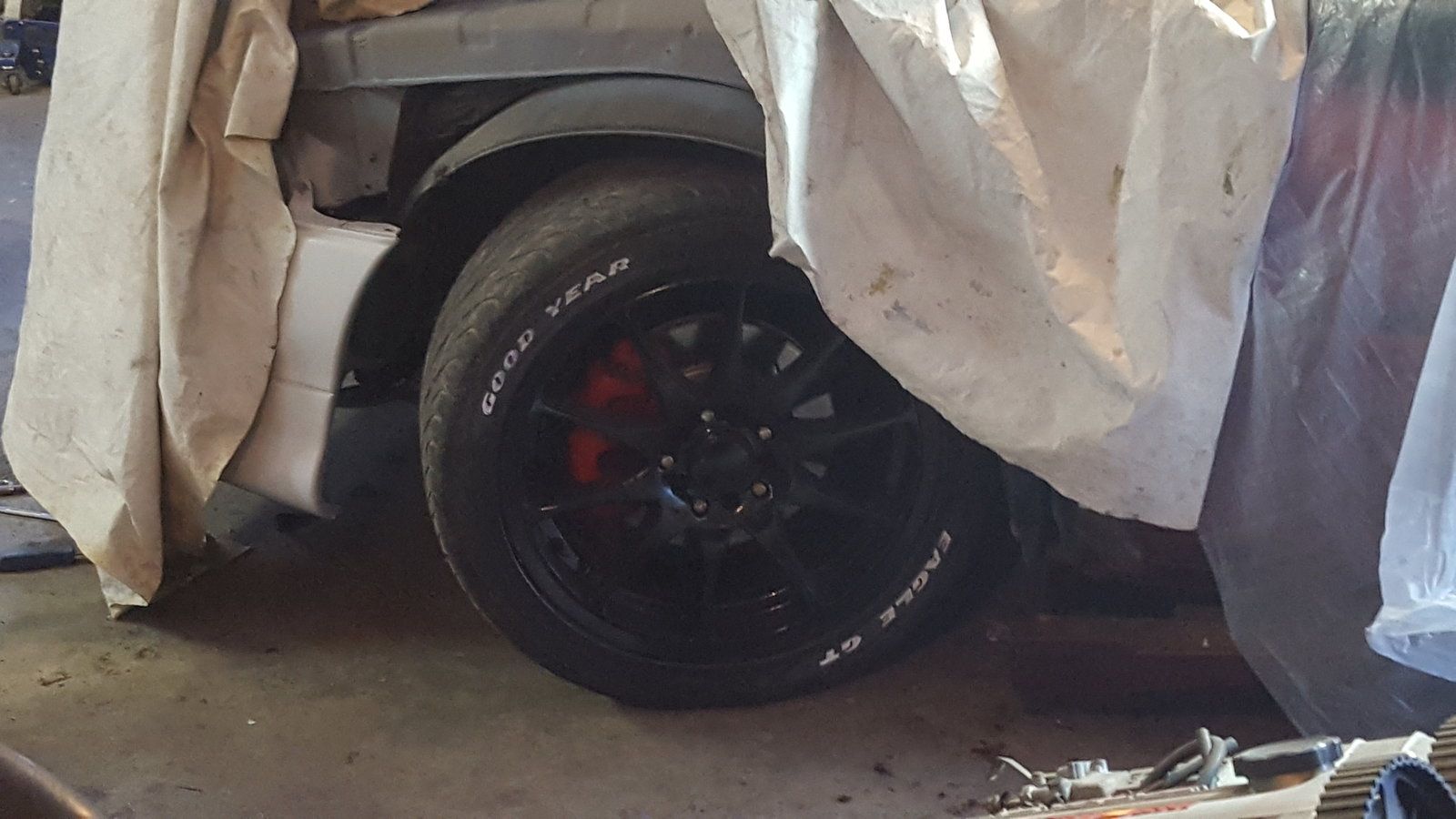

Couple more ... i think lettering the tires in with a little white paint really makes the wheel/tire combo look nice

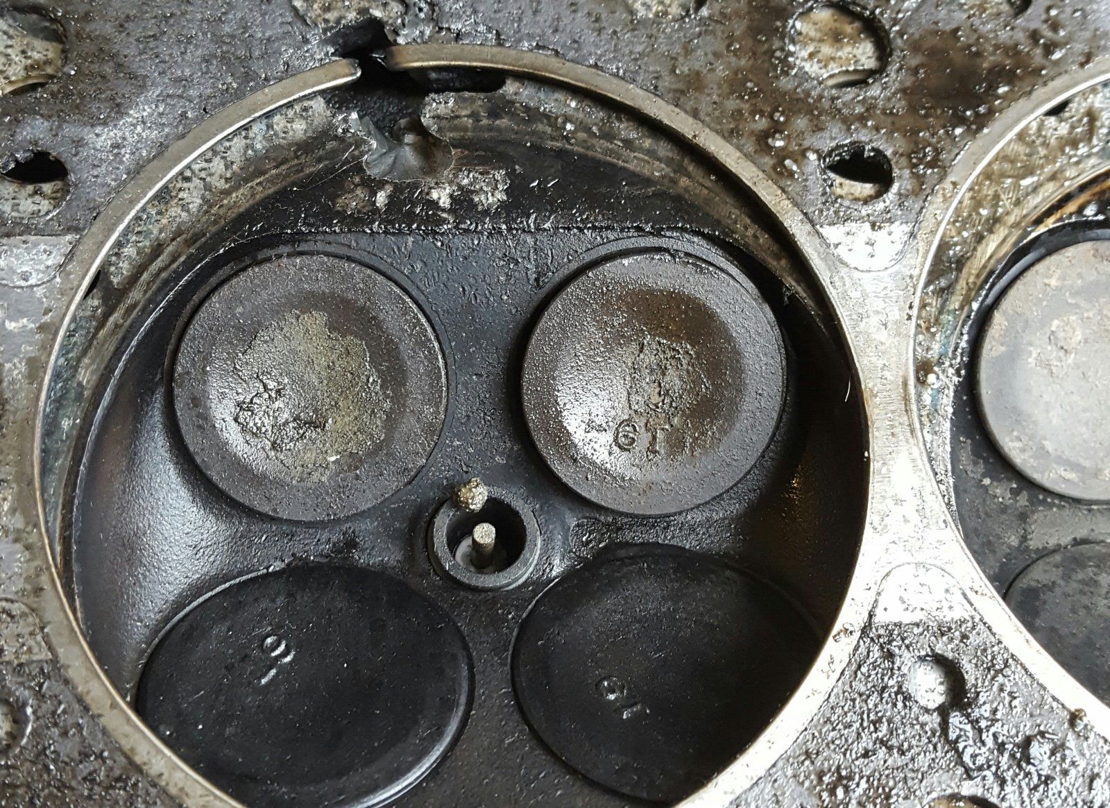

I'm a bit discouraged after the latest HG failure, as i can't even afford the 91 dollars i need for valve seals, head gasket, am oil change and set of plugs... i hate not working, i tried i move my business from a city of almost a half million (Omaha) to a town of 3200, (Ripley, WV) but had no idea of bet this slow/out of work after two years..(only had my garage/shop setup for a year though) but because of My disability and lack of jobs i can't even get regular work... (moved here because my health almost killed me in 2014 and this is where my family is at)
Plus I'm still trying to trade/find a FMIC core that will fit behind a1g bumper, the one i used on my 2g won't even fit of tilted and removing the front turn signals, bumper support, hood latch and center plastic piece wroth Mitsubishi emblem... even with all that is almost 2 inches lower than the rest of the car..ughhhh
And after this failure i refuse to start tuning again without one. I just think the methanol is too inconsistent to be reliable as the sole form of charge cooling on a daily driver (unless i were to spray it from way early in the load range which burns through a few gallons a day, and that's just not feasible)

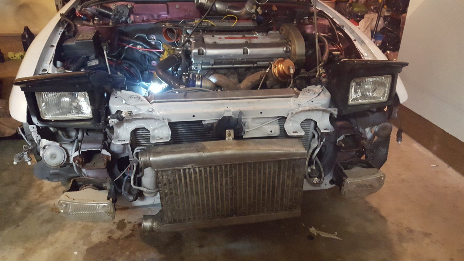

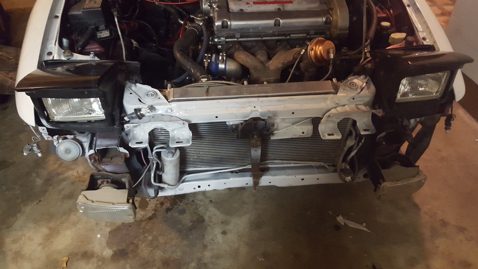

I know i haven't updated this in a long time, well tonight i got off my lazy ass and put in some work. Installed my greddy fmic that was meant for a supra. Had to cut the bumper into two little halves which really are only there to hold the bumper on, had a bit of a tight fit in the upper intercooler pipe to the turbo, but in the end, it fit.
Also replaced my UEGO sensor tonight add is been dieing for a while. For anyone that doesn't know, a direct plug in from the parts store to replace the AEM sensor is bosch #17018 ( 17014 also fits but the plug cam be plugged in backwards which won't hurt, it just won't work until it's corrected) these are cheaper than AEM replacements, i got a special discount fron a friends at Advanced and only paid 40.99 for mine.
It's late and i just finished, but you can bet tomorrow will bring data logs and boost pressure.
I'm really happy i was able to keep the fog lights, let's just hope i don't scrape the pipes of the core in the first week
