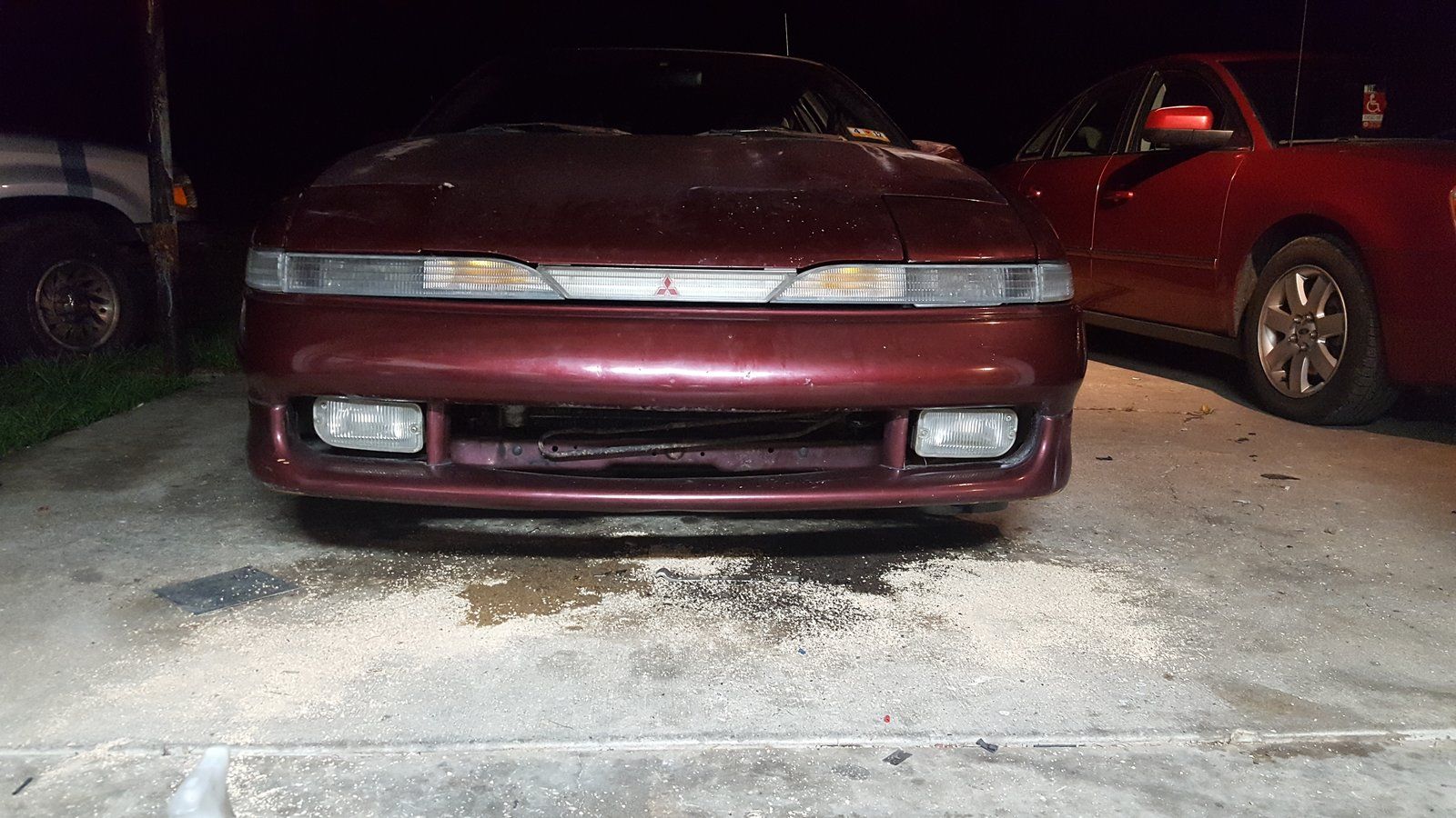

Here's pics of the old babyand the new second chnce shell for thedriveline....I call it the second chance panda because the first thingsi'm doing are ripping the engine trans out, tucking the engine bay, freshening up the non shifting trans and paintint it panda black and white (y favorite DSM's)
I just got it home tonight, will update daily

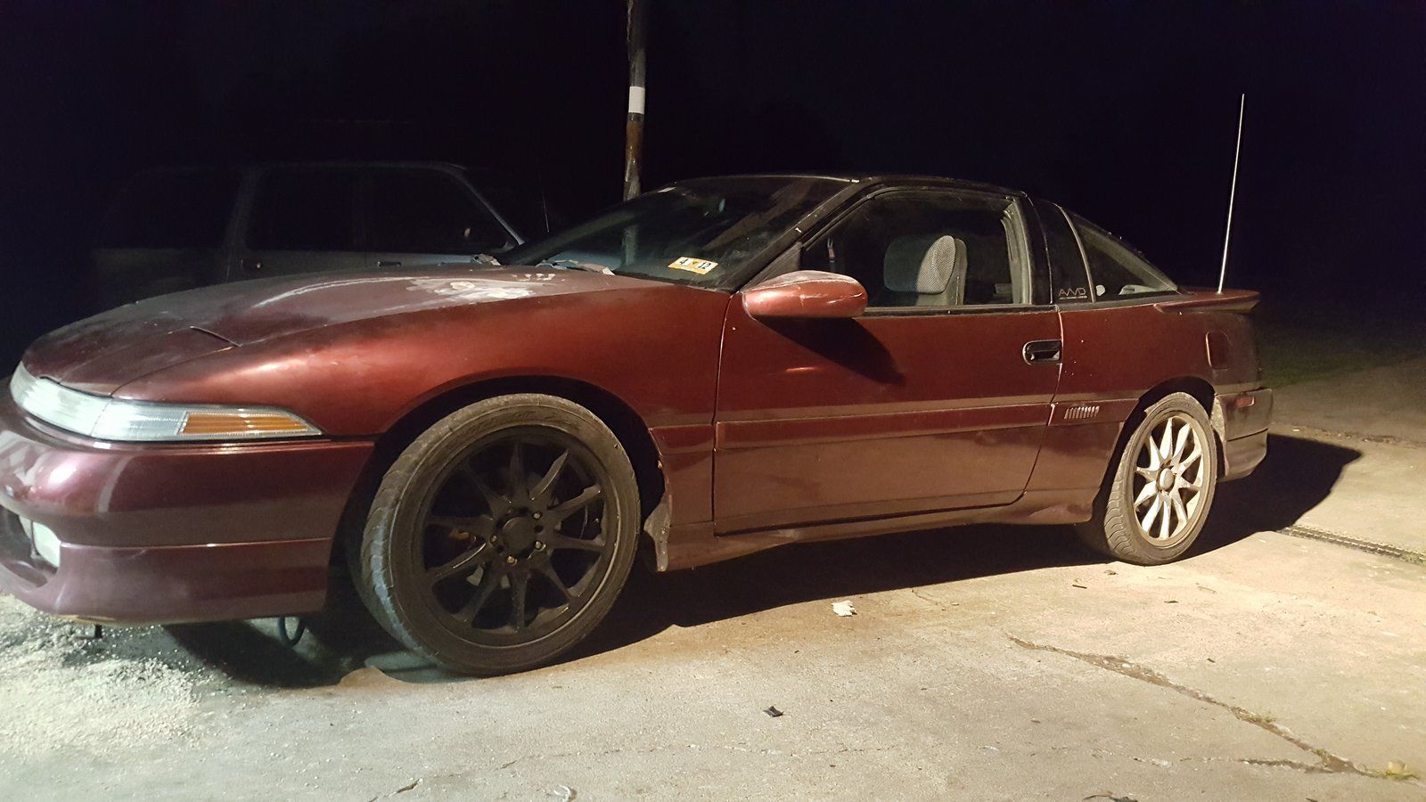

it's a 1991 GSX, although its a 3 bolt rear there's a sticker in the door stating that it is indeed a LSD differential ( I didn't know they had LSD in the 3 bolt variant)

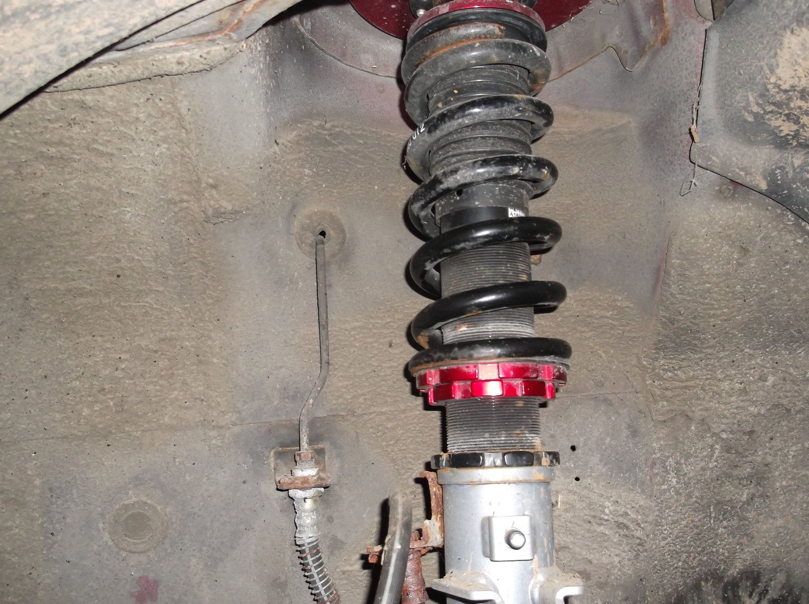

And although I know they aren't highly reg uarded here, it has fairly new Megan coil overs on it, as well as 2G GSX front calipers with slotted rotors and stainless steel brake lines installed. (the calipers and rotors are going to need treated to bead blasting and painting, as you can tell they've been sitting a LOOOng time LOL )
It also has an EIII 16G that's in great shape along with a Megan SS O2 housing (both os these are for sale as of m typing this if anyone want's them)

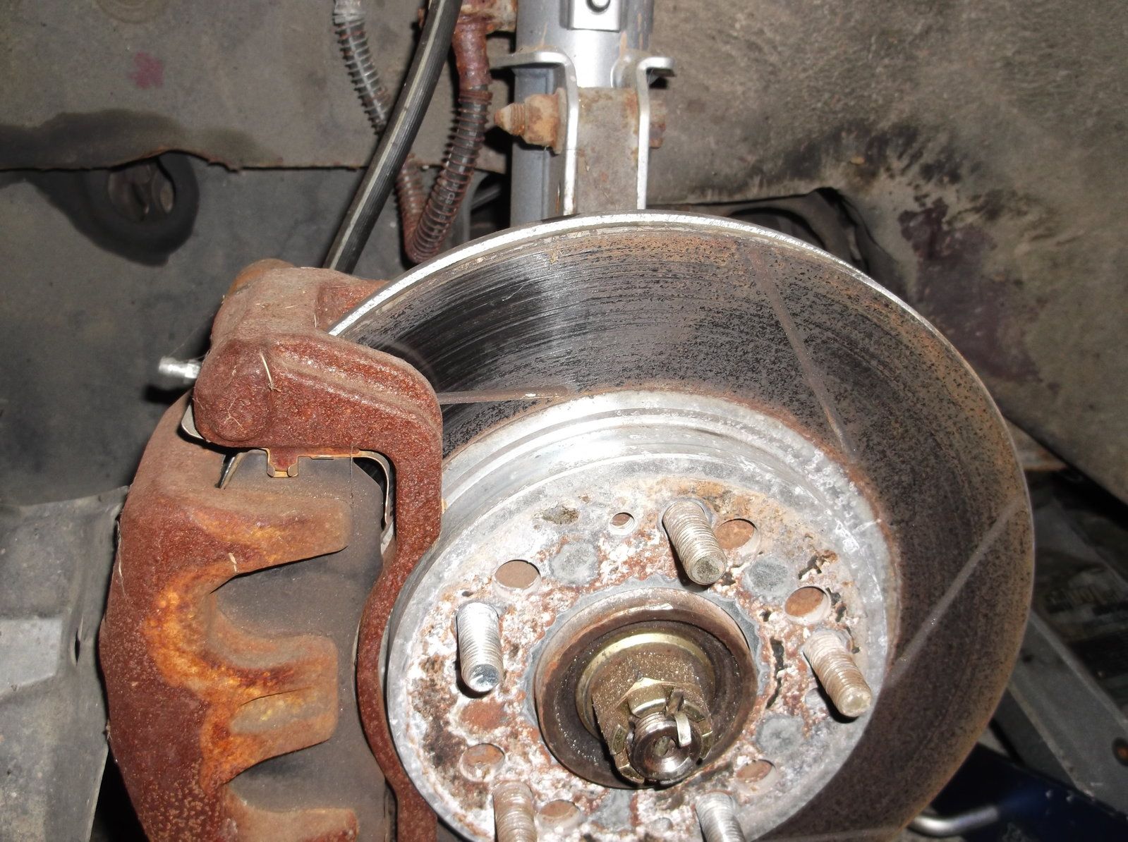

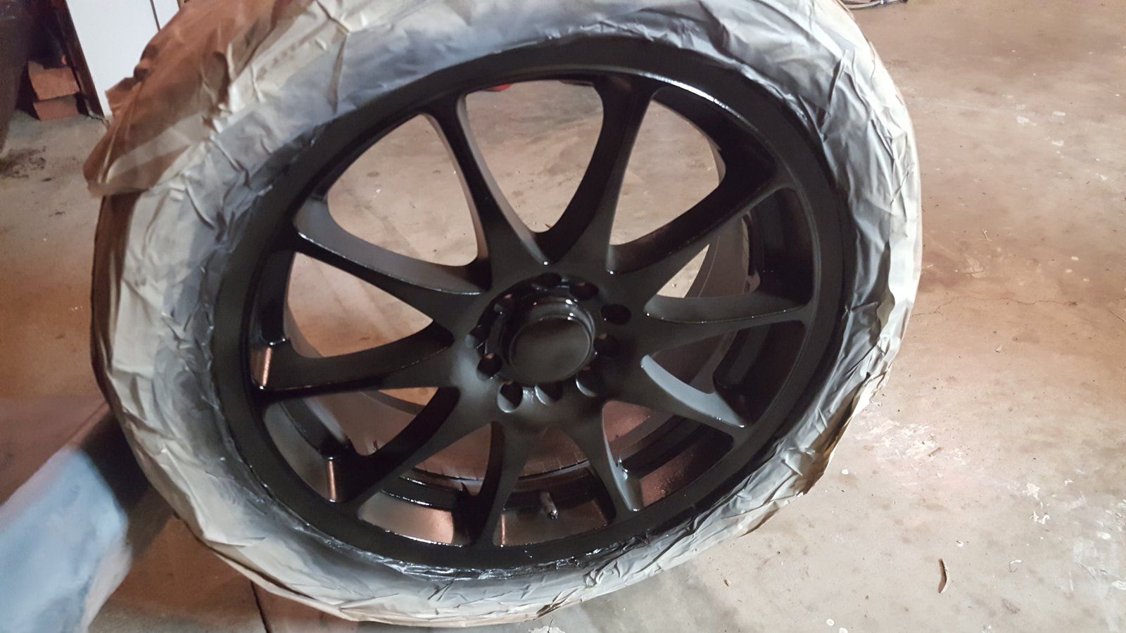

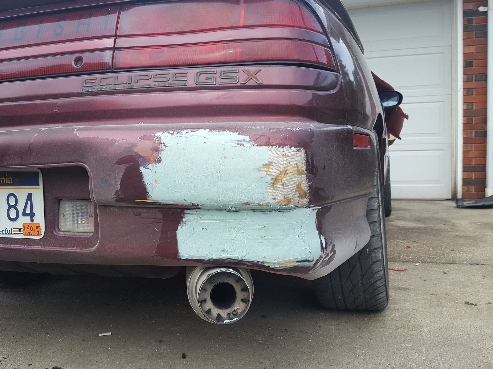

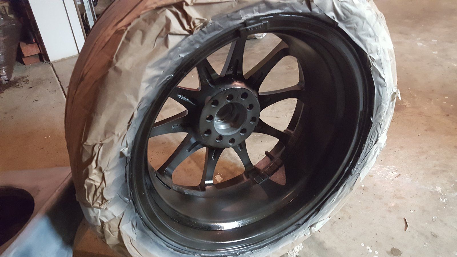

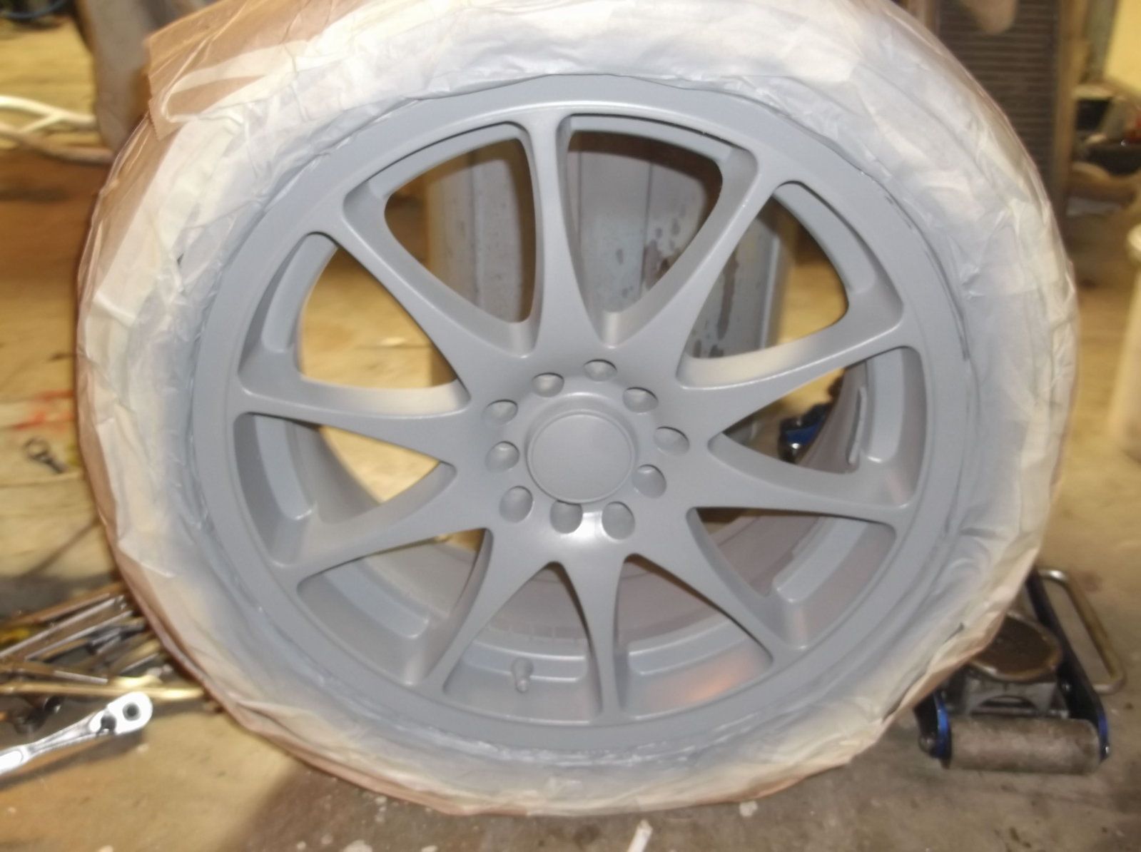

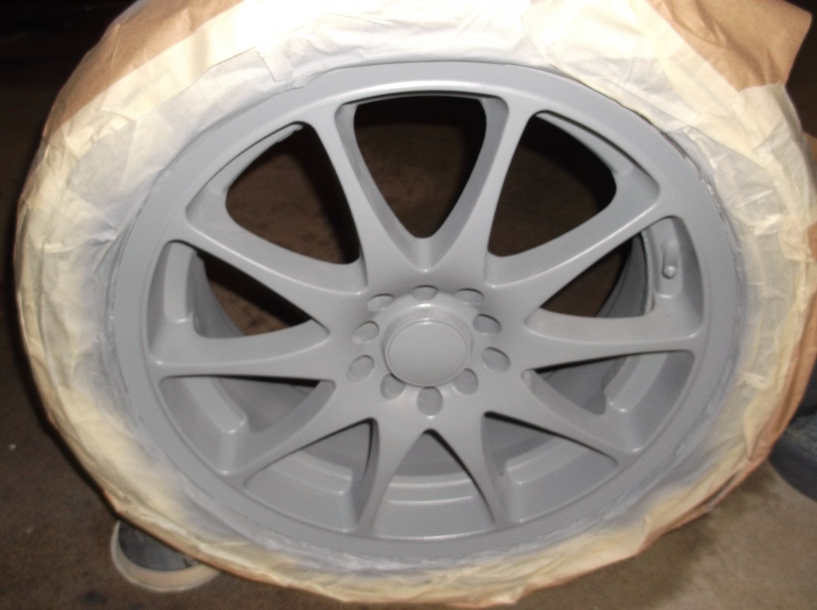

I started pulling, sanding and painting the wheels because I just couldn't hadlle rims looking as beat up as these were.
here's some pics

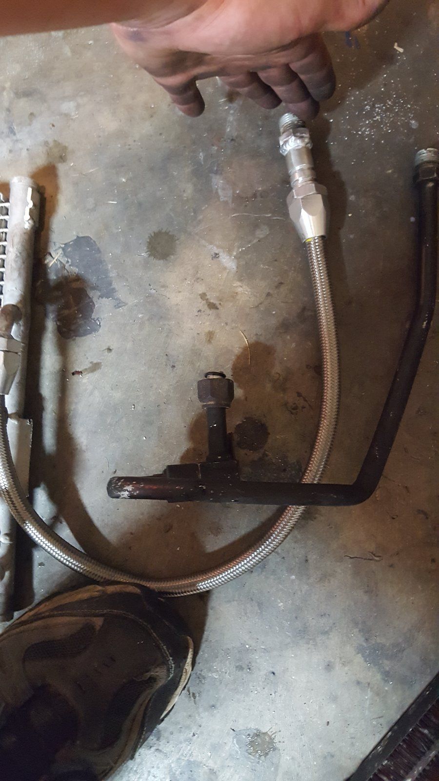

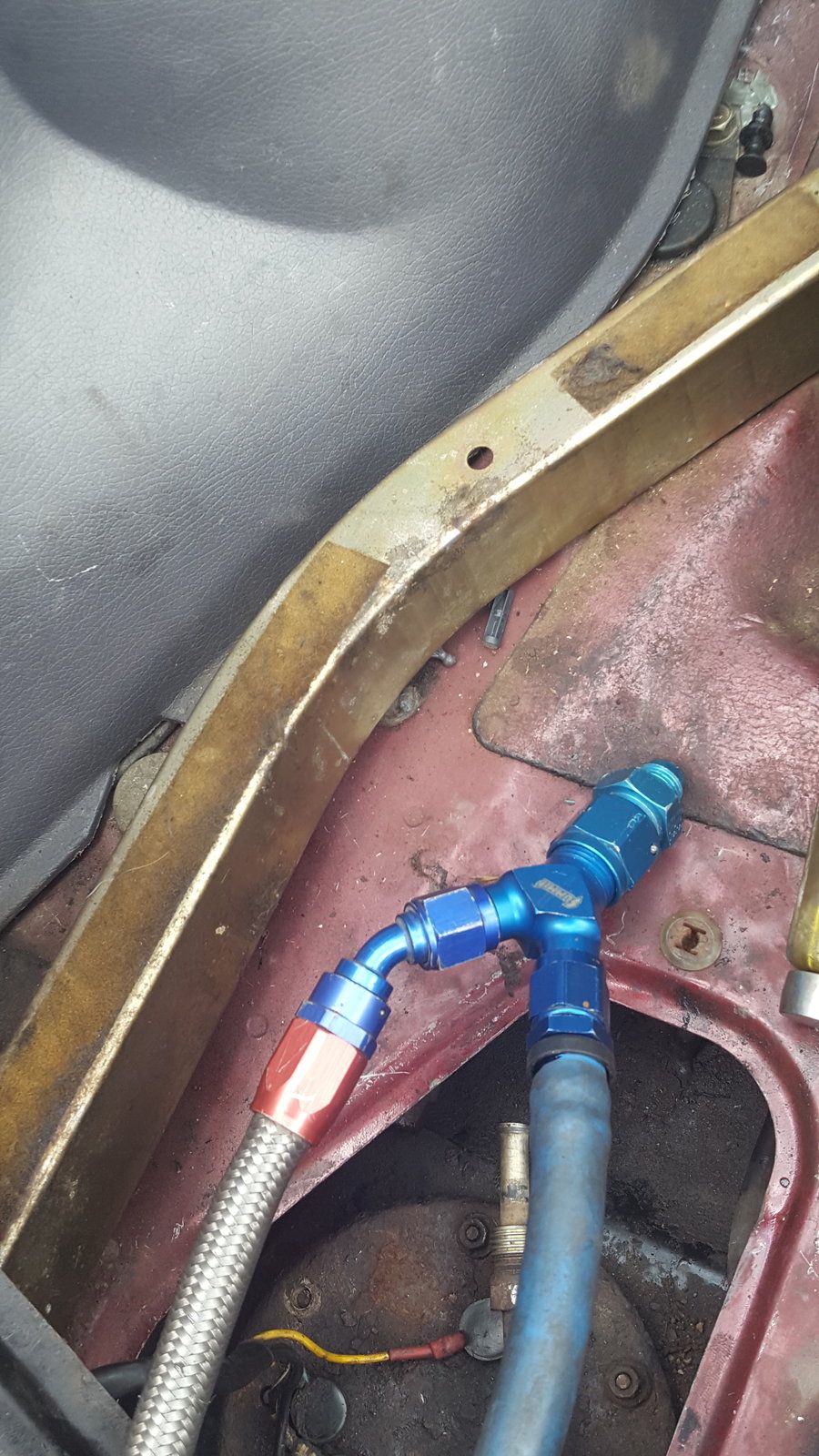

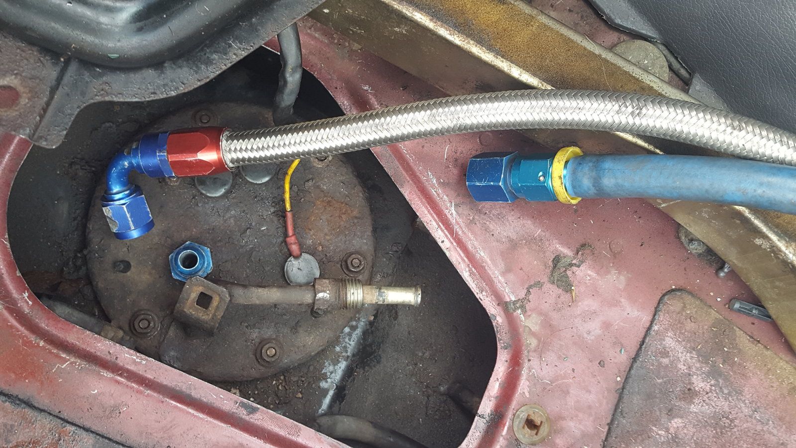

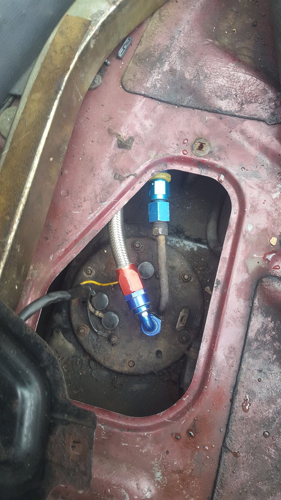

Best... bult a 2 x 255HP in tank setup that's two -6 feeds running from the pumps to out f the tank, they Y together after the lines turn down the front of the gas tank... one pumps unpowered for the moment and theone that's running I'm ng a -6 to metric flate fitting to tie into the OEM lines so I can move the car around to work onor get oter things in and out of the garage until I have the 2g shell gone and can pull the !g engine , gut and tuck the engine bay, install my fuel system, other goodies and my engine

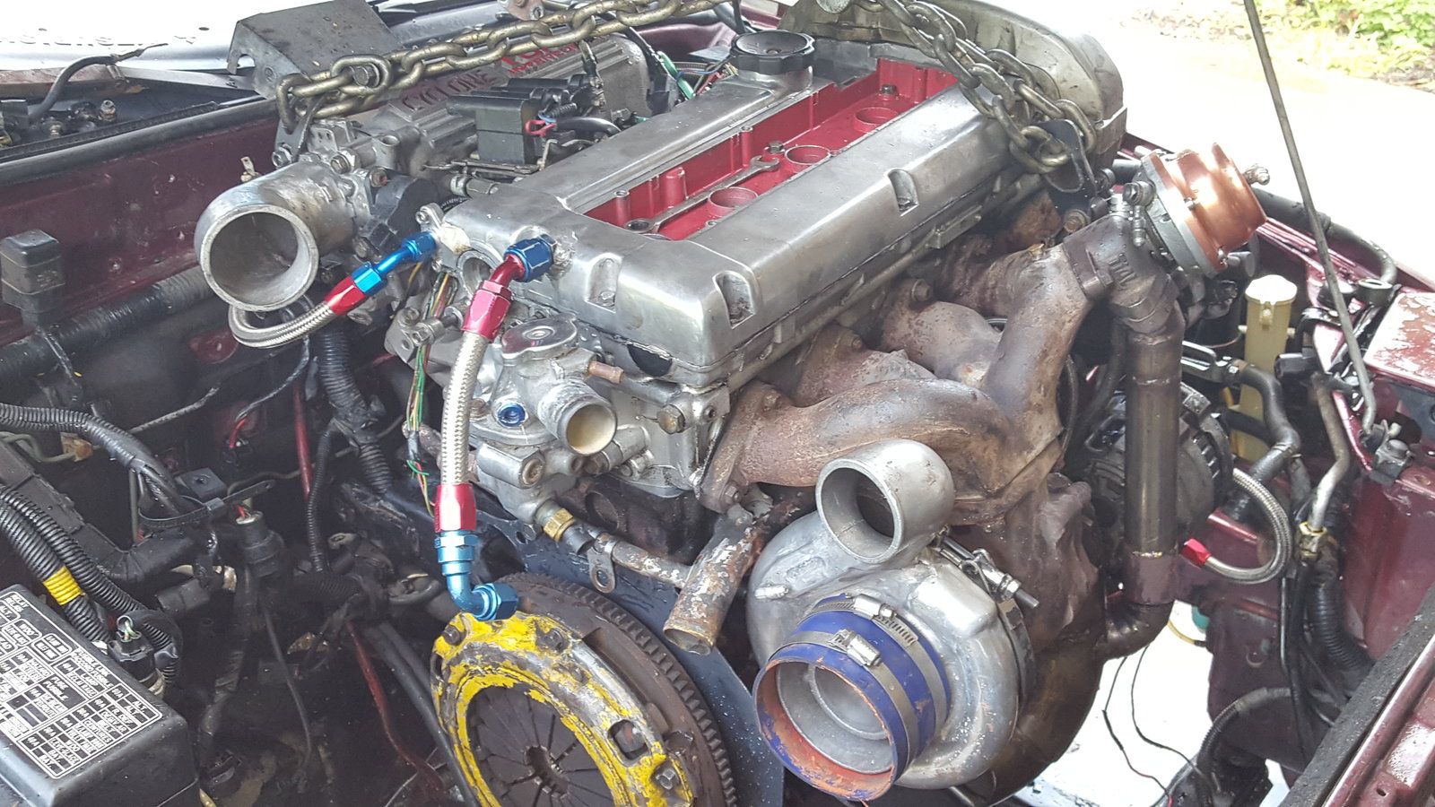

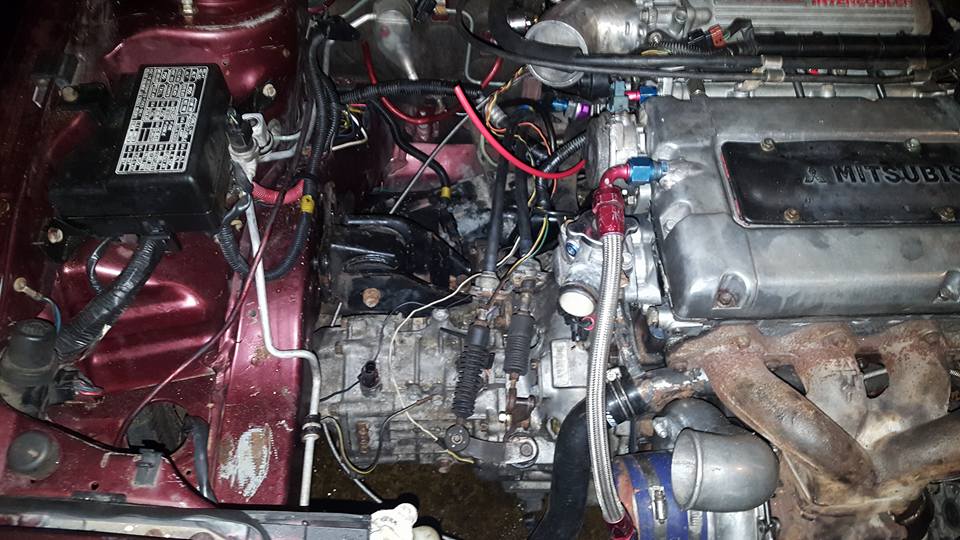

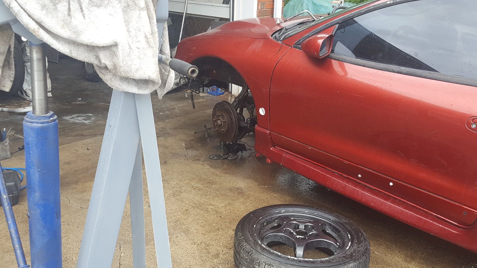

small update, been sick as hell, in hospital part of the time, just got out an last two nights worked on her after the sun went down.
The trans is ready to pull (one bellhousing bolt) then i'll pull the engine since there's more room after the tranny is out.
Small issue I ran into is there's no room for my FMIC from the 2g to fitthis car it's justWAY too big.. so unless I want to pin my hood down, remove the entire bumper support center and cut up the PS cooler line im going to temporarily do something I tested years ago to get me by.. That's runningno intercooler and just some meth injection for cooling, this won't be my everyday daily driver so if I spray enough I think i'll be ok especially since I'm on e85 these day.

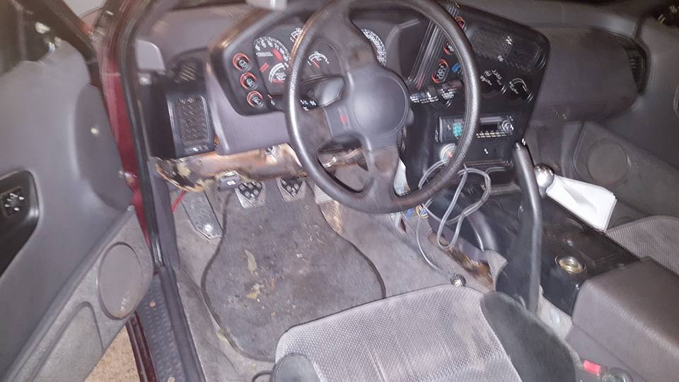

here's a couple pics...hopefully I getthe engine out tomorrow as well and start pulling the harness as some one wanted it and and I need to wirethe stand alone into the bay.
sorry the pic is bad, I had grease on the camera lense as usuall when using the phone
small update, I've been sick as a dog for almost two weeks, in the hospital for some of it, but I'm intercooler from the2g out and feeling a little better and last night and today worked on it some after the sun went down and things cooled off..
I've gotthe trans ready to drop out, justone bell housing bolt left holding it on, then once t's free i'll pull the engine since there's a little more room doing them separate..
I realized my FMIC from the 2g is WAY too large to fit on the1g without removing a ton of things I consider somewhat vital for a daily driven car (hood latch, PS cooler, the complete front bumper support) I don't mind modding them but this core is so large I would have to Pin my hood, relocate the PS line, and remove the complete center

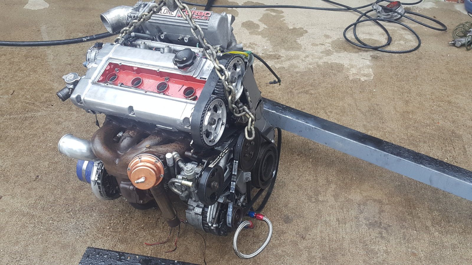

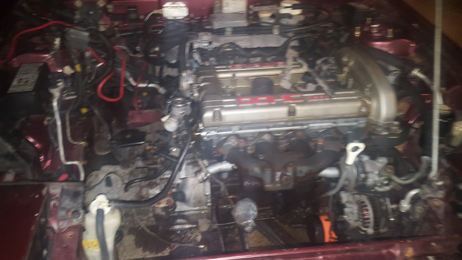

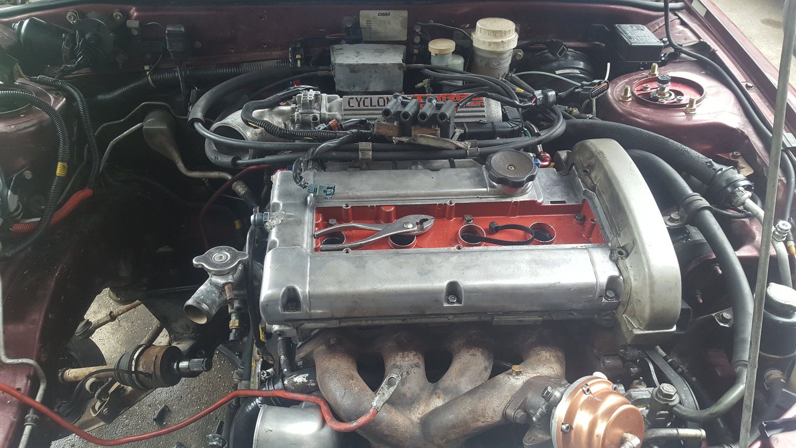

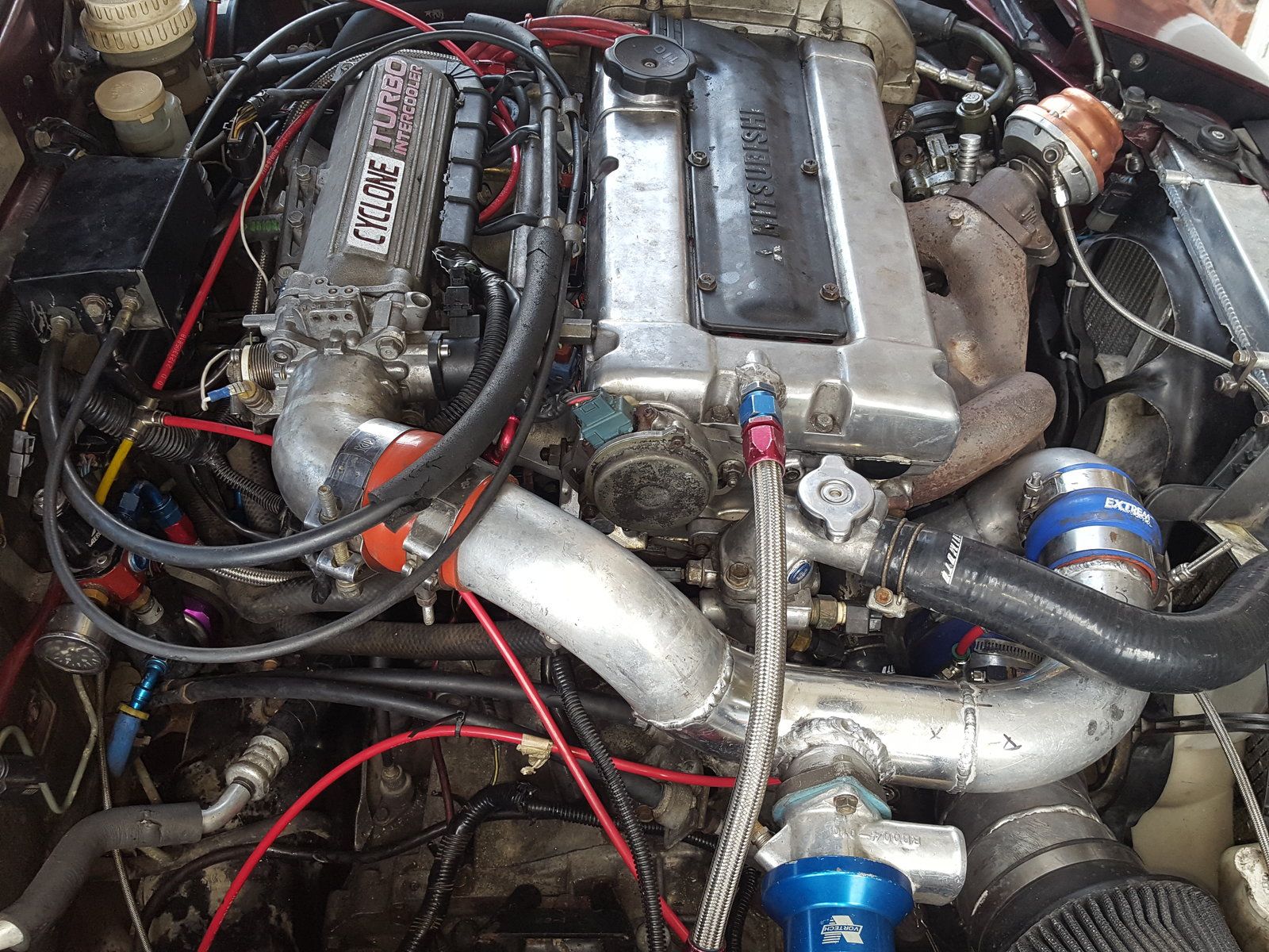

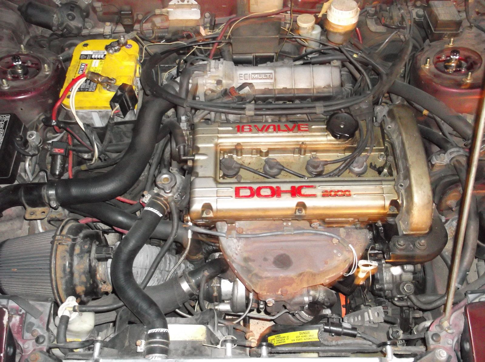

got TONS done today... old engine and trans out, new engine in, fuel system ran and plumbed, and byuilt a patch loom to run the stand alone through the OEM wiring harness... I was going to strip the entire bay and run just the stand alone harness but as more and more aspects of the uild pop up withtheir own suprising new costs and time investments many of the things I had planned to do all at once are now going to be done in stages, and to be honest I'm damn anxiouse to have a awd DSM on the streets again this summer so I don't mind putting a few things off until later (mainly appearances mods and paint) but that just keeps her sleeper, and I likethat anyway. I just wish she was AUTO! I been dying to play with an auto dsm for several years now but again it's something that just hasn't fit the budget. But this trans is toast (or at least the 1-2 synchro is basically non-existant, I only hope I have time and money to pull it apart, replace some synchros and shim the thing to hold some power so it doesn't fly apart the first week I get to go play with it on the streeets.

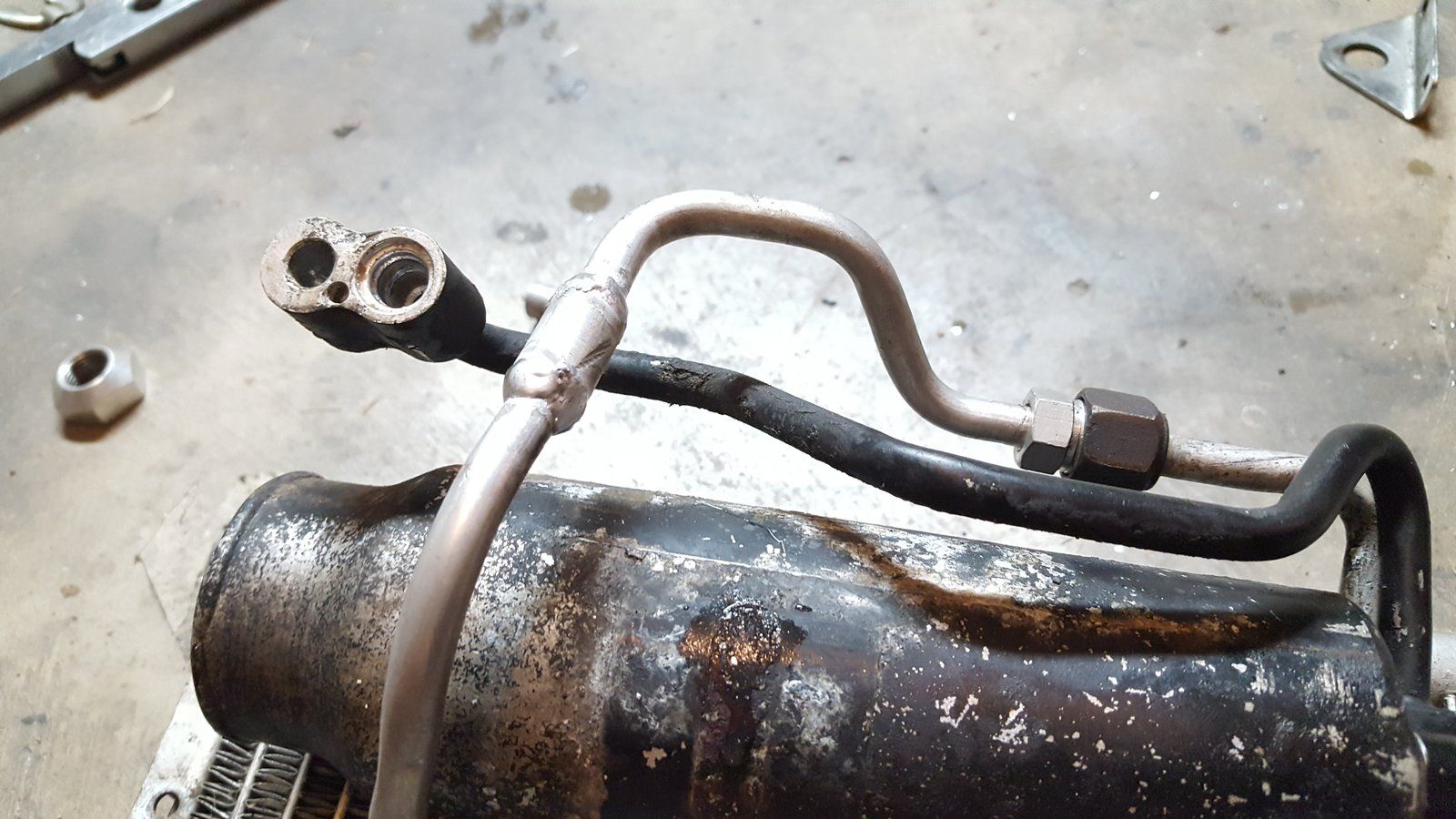

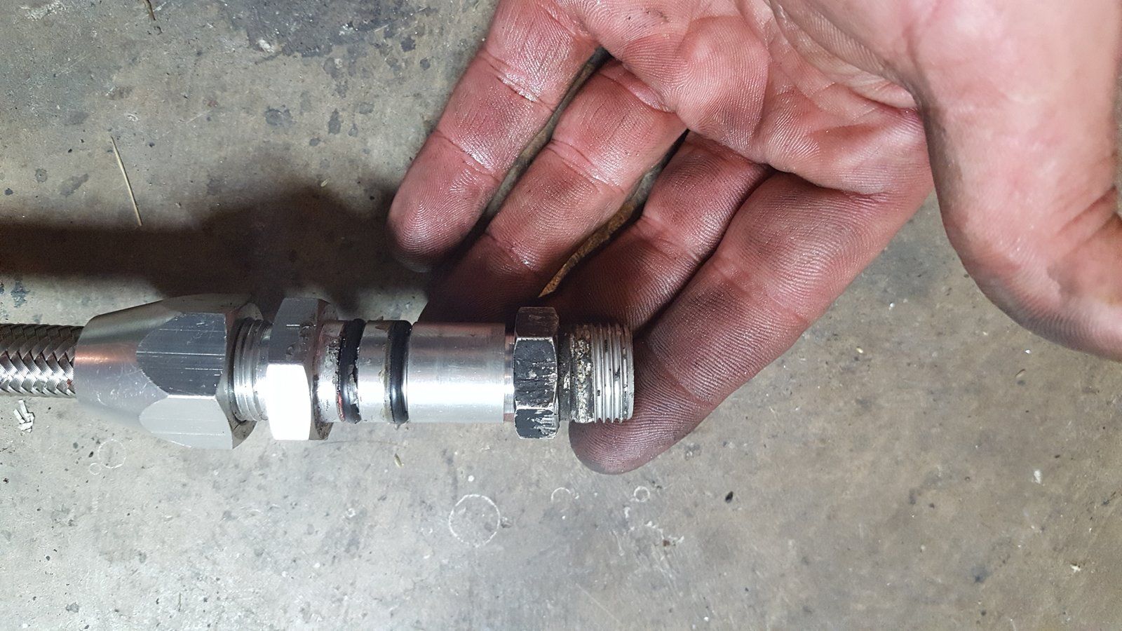

I replaced all of the O-rings at every A/C componenet junction hoping to solve myleak, (I think I still need tokeep looking although it is holding vacuum longer now and vacuuming down further) BUt being the guy I am I will NOT own a car that doens'thave working AC that can make you feel like you just plopped down in 4 feet of snow on a hot day :D

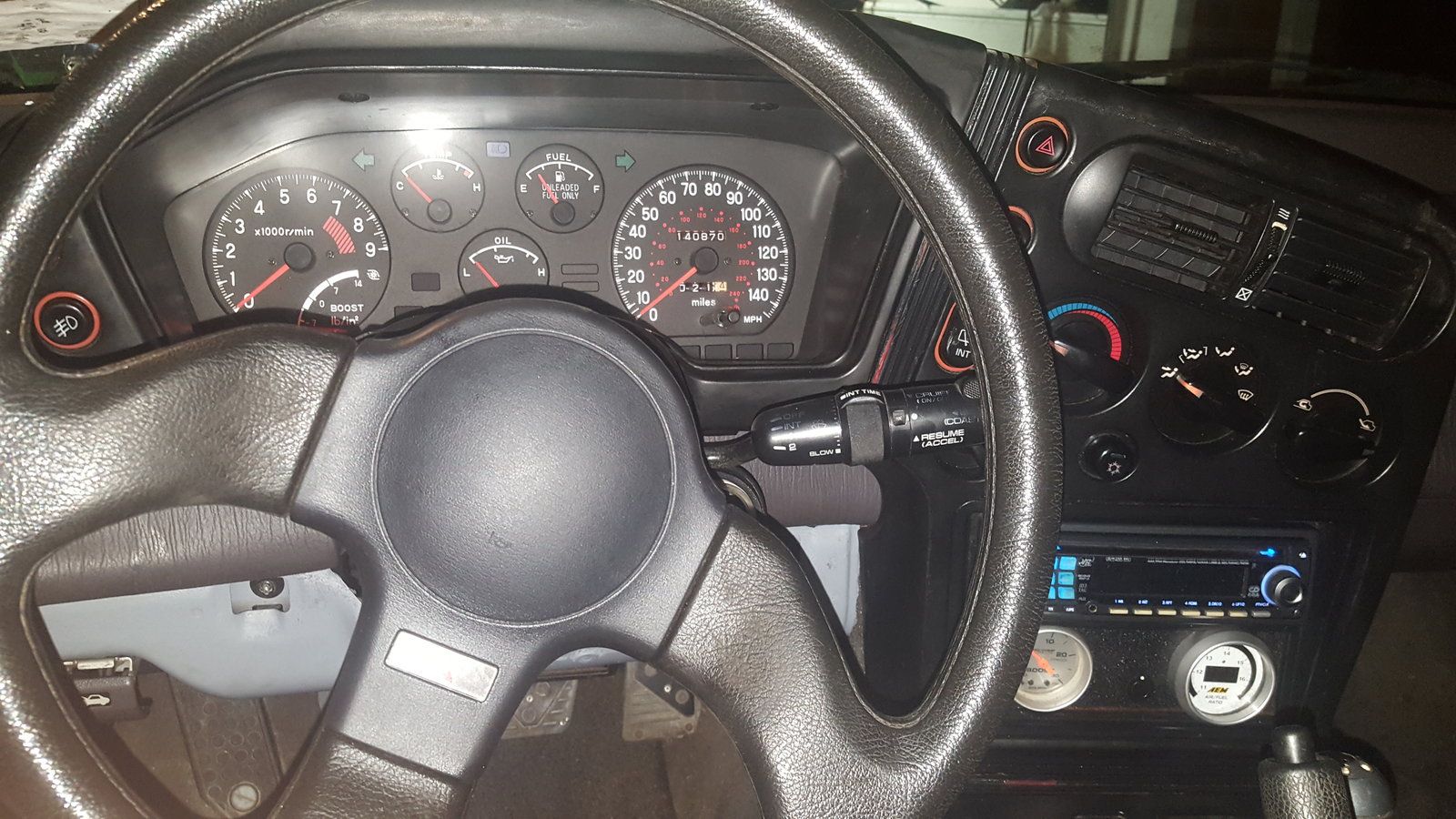

Here's a few pics for everyone......all of this was done between 9pm and 2AM last night and picked back up at 7am this morning and am finally calling it a day due tio back pain at 5pm
the fuel system is parallel 255's (the HP version) each has it's own outlet out of the tank then they merge together with a Y coupling that takes the two -6AN fittings and comes out as one -8, but I use a reducer and go back down to -6 line all the way to the rail (no need for 8 at this point o probably ever with my goals) Running a fuel lap filter and a aeromotive AFPR on the firewall, spitting through RC engineering 1600cc injectors (really wanting to step back down to 1000's or so, I never some close to maxing these out and I'm happy with where my power is)
I think I mentioned yesterday that due to space constraints in the 1g bumper area, I'm going to have to leave my FMIC sit in the garage andjust run methanol tocool the charge.. I am kinda excited to play wtiht that again and work the tune more than my previouse experiment,, I wil be installing the Nitrous but probably not using it, unless absolutely needed or I get a good dare, but with a 3 bolt rear end I'm kinda scared of things flying apart.

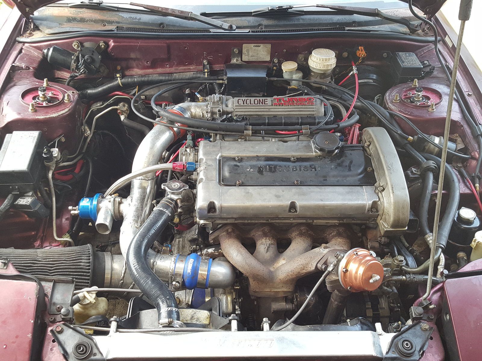

Another day of getting a shit ton accomplished on the dsm. Finished bolting the engine in, installed, sorted and finished the entire ECU and knock monitoring systems installed so the engine should fire right up.. (had some issues to sort out with the MPI relay and some grounds from having the battery in the trunk, but got er finished). I also finished pulling the pedal assembly out to fix the worn clutch pedal and reinstalled it and the rest of the column and interior. Th...en I said f*** it, I don't have the money for a better clutch or to rebuild the trans right now, so I might as well put them in too.. and I did LOL...
Only thing left are to install the transfer case, bolt up the driver side half shaft and install the starter.

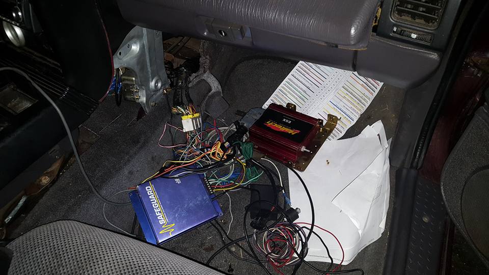

I still have to build intercooler piping, wire a MAP and IAT sensors for the speed density setup, but I honestly can't believe how frickin close I really am to having it back together!!

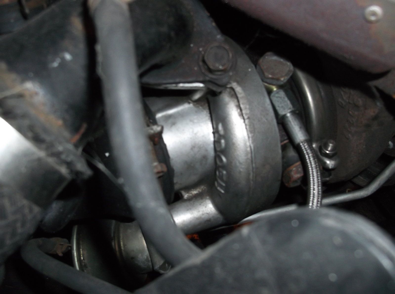

The one problem I now have to address is that the t-netics header and tial wastegate location are keeping the hood from closing, so I hopefully can just removing some of the bracing under the hood to solve that, or I might say f*** it and break out the plasma cutter. :)
Oh... And the one other thing to actually make it streetable is to fab a 2 foot piece of pipe to join the down pipe too the rest of the exhaust. Then I can test drive it. Woo woo!!!!

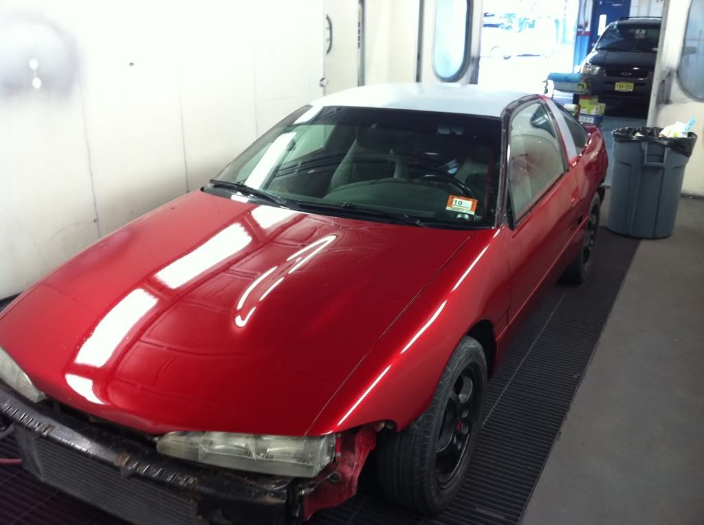

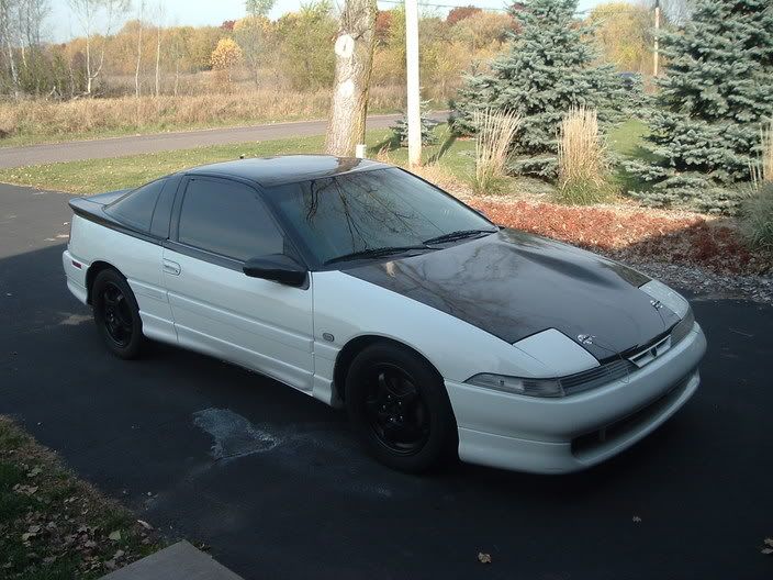

Well, I've thought myself into a dilemma, what color to paint her? I originally wanted a white/Black panda scheme, but looking through some pics to decide on painting the spoiler black or not I started noticing a lot of bright red 1g's that were just beautiful, even saw one in gun metal grey that I loved, but at this point I think I could use some help... Do I go
White/Black like this
Or with a Red/Black like this one...
I even found a thread where I a guy went the color I mentioned earlier (same as my 2g was) but couldn't find a pic of it finished... here's a pic of that
doesn't pop as uch as regular old red does though IMO
Anyway, some help deciding, even though I have to live with it LOL
But at this point that second pic of the red car with black wheels is making me drool, plus going from bburgandy to red won't be as large of a change as going from burgundy to white.....
I've decided on the red and black, does anyone know if that car is a factory red or some other red?

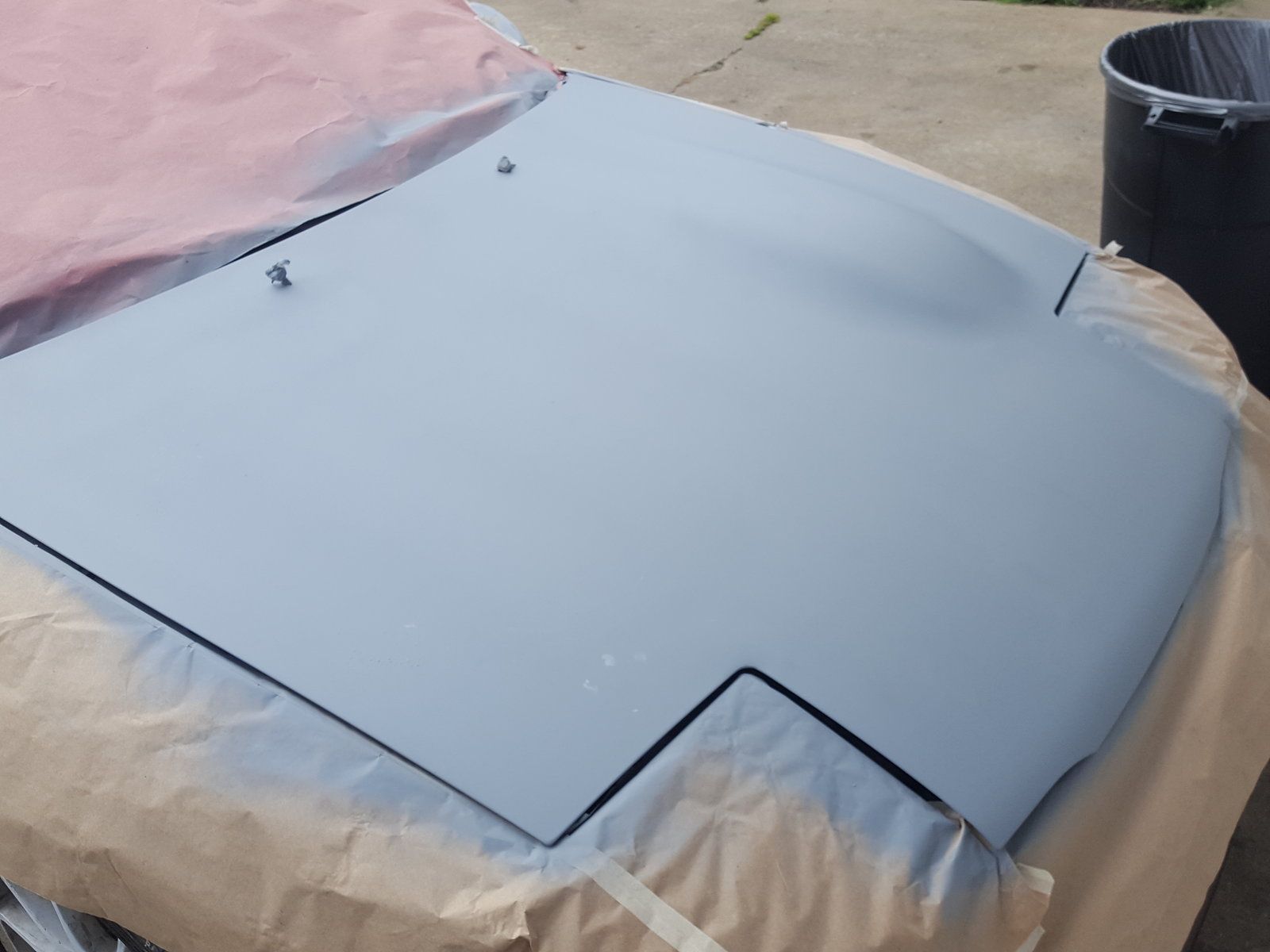

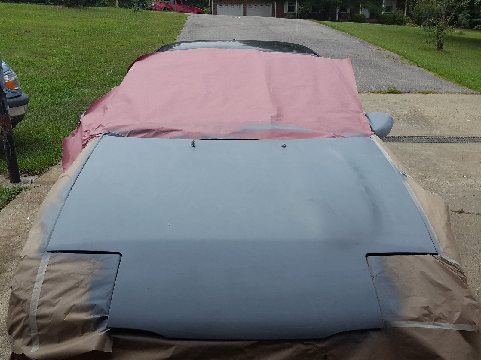

I started priming the hood and mirrors since they were in bad shape I just wish I had cash to go ahead and prime the entire car. Plus is Been so damn hot here I haven't been able to stand being outside to work on it.

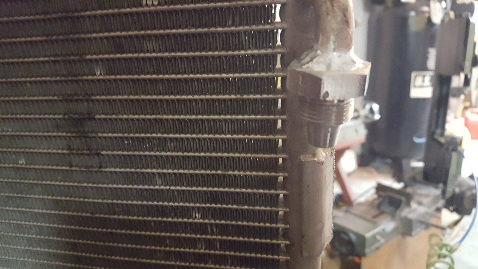

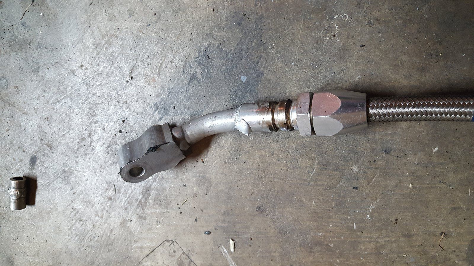

Time for an update. Took the car out today and one of the fuel pumps melted in the tank (scary) once i got it back i took to making the a/c work. The 1g condenser was trash, and so was it's compressor, so I've finally finished retrofitting the 2g comp, cond. Barrier hoses, and made custom lines to fit this to the 1g parts without having to modify or damage them, so the system can be put to 100% oem easily if needed. Pics

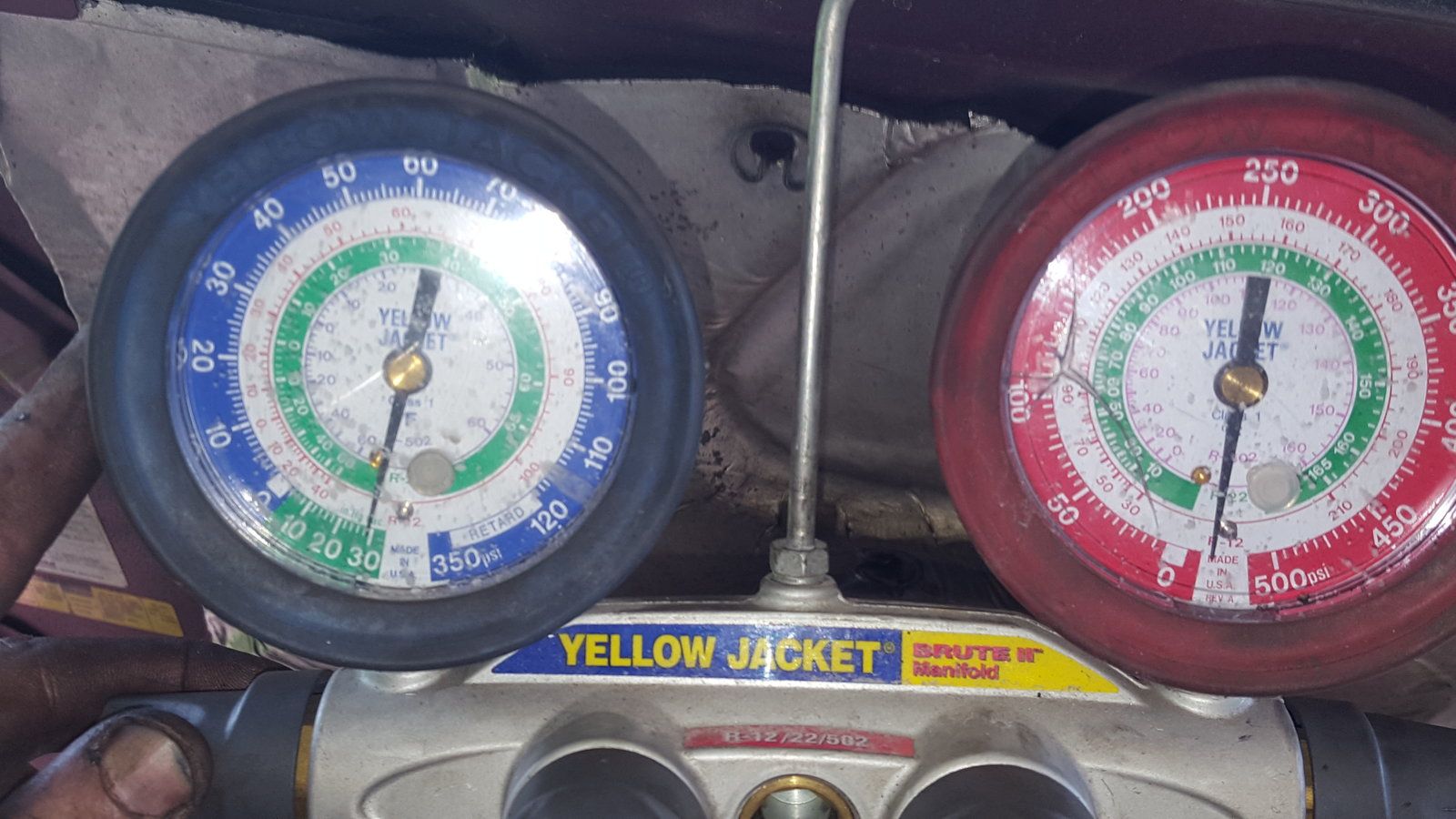

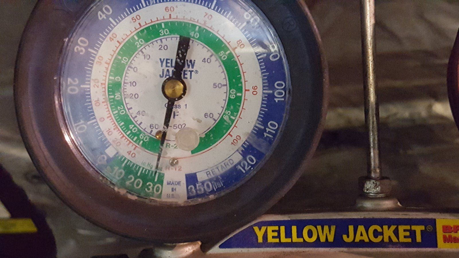

Wroth so much of the system now being originally designed for r134a, in theory the system should perform very well, or at least better than the original setup just being charged with r134a since it was designed for r12
Woooohoooo, the system vacuums down and holds beautifully! I'm very excited to get the last set back taken care of so i can concentrate on getting her plated and insured.
I'm surprised how well the custom lines and 2g condenser fit, it was almost like it was meant to be.
Now i just need to find a new receiver/drier to toss on her tomorrow and i can start dumping in the refrigerant! I can't wait, i really hope in not let down by a last minute failure of some sort, but to the best of my ability the system should be solid.
Then i can focus on finding a decent FMIC core that someone is willing to trade for mine since I'd have to ditch the hood latch to make it fit on this car. I'm hoping the alky injection will suffice for the time being.
In the air conditioning works perfectly. There was one tiny pinhole in a weld I had to fix then I pulled another vacuum put oil in and charge the system and she works great
