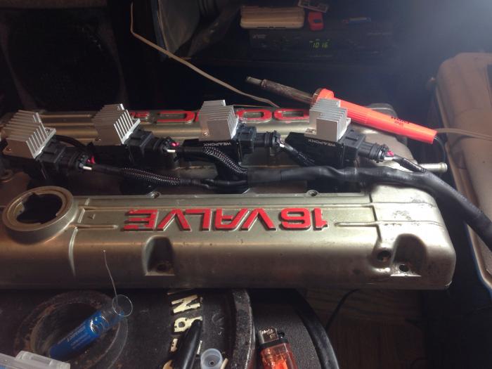

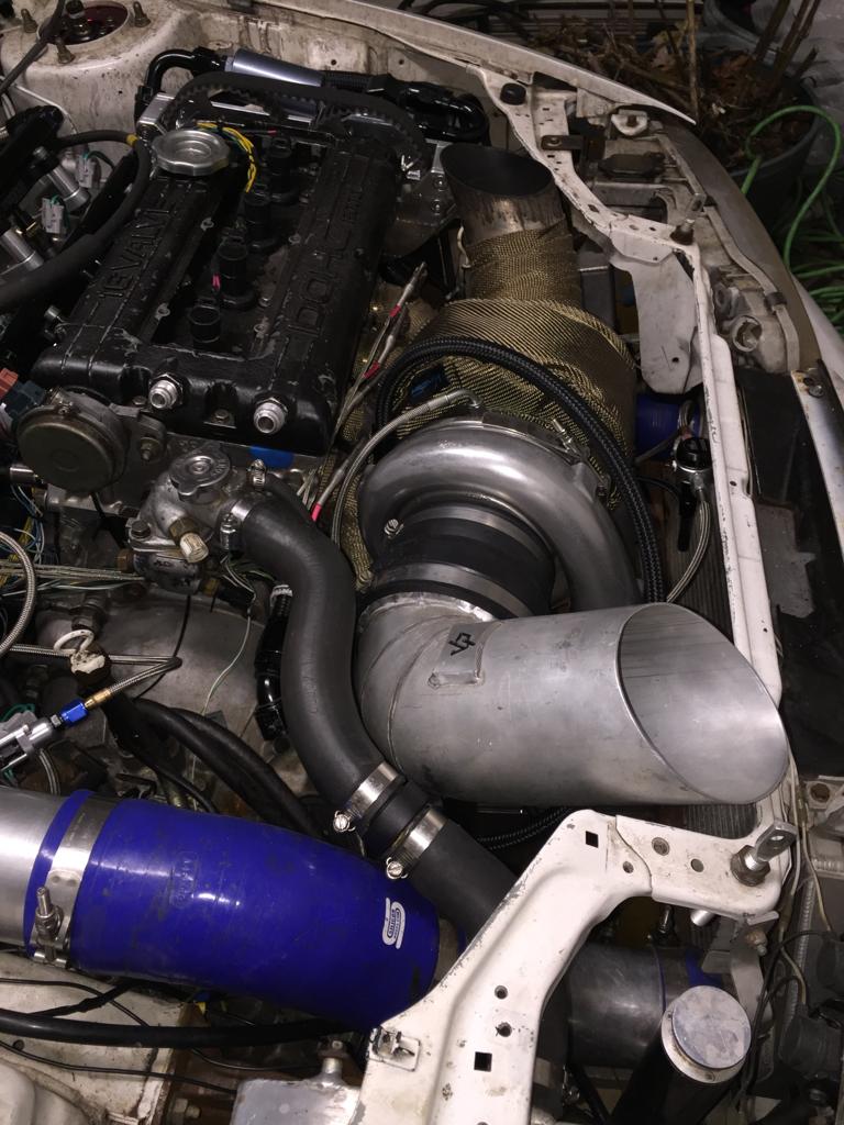

Update- Bought a new ignition system. Was able to get some of the wiring done today. I can't wait to test it out and get this car to the track.

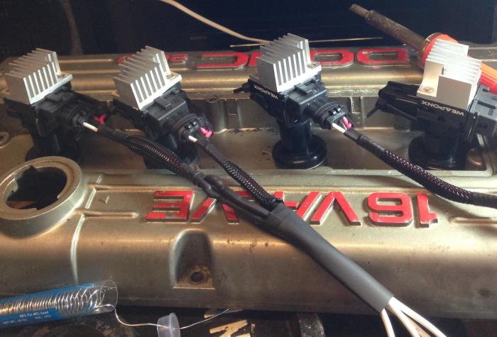

Just finished up the harness. Just have to wire it into the car now and make a cover plate.
So what is the deal with thoes coils? Did you try gapping your plugs down further, like 0.015 - 0.013?
Mine are very tightly gapped, if I remember correctly at .018 I had severe blowout.
The car is looking very good!
I didn't bother gaping them smaller. I had already decided that this was the limit of the ignition I had. The new coils don't use a cdi box each coil has it's own sperate igniter. This is a 4 channel smart coil setup. With these I can adjust dwell time to help get a better spark.
