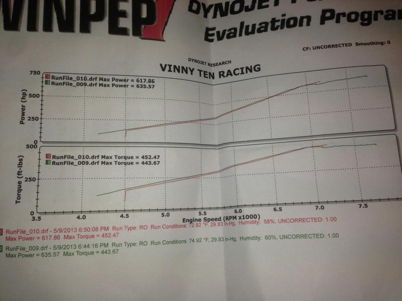

Actually just got home from the dyno. I'm happy with what the car made on just 35psi but at the same time know there is a lot left on the table. Converter is still slipping way to much to be used on my setup. Car was only seeing 95mph @ 8k in 3rd:confused::ohdamn::banghead: I'll be contacting Mike at sinister to see where we go from here.
Only revved the car to 8k to get a baseline of what the car is doing. As well as the pull were only full throttle from about 6k. Had to end tuning early because of bad carrier bearings causing a nasty thumping.

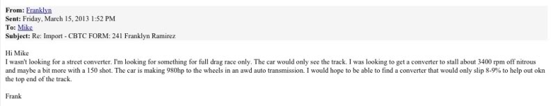

Yeah I'm really considering that converter as a temp fix. Honestly I'm just looking for one that will stall to 32-3300 and be really tight up top. I'm thinking about installing a pressure gauge on my cooler line to see whats really going on.

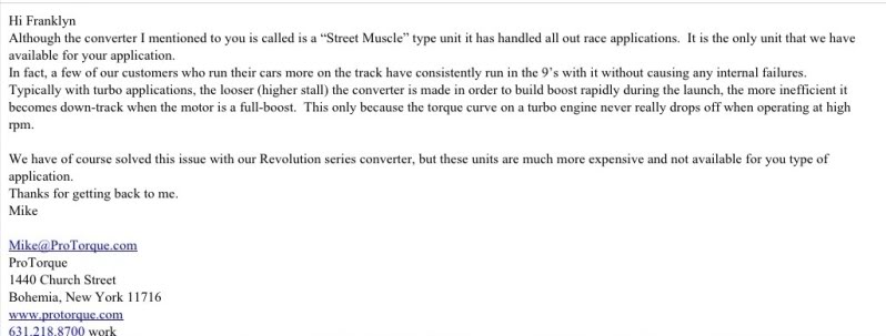

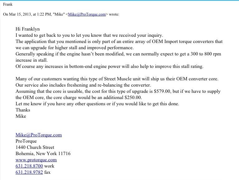

I had already tried getting pro torque to make me a converter. They told me the best the could do was a restall.

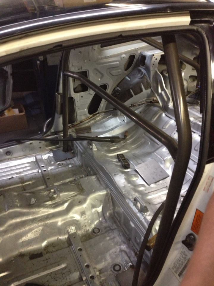

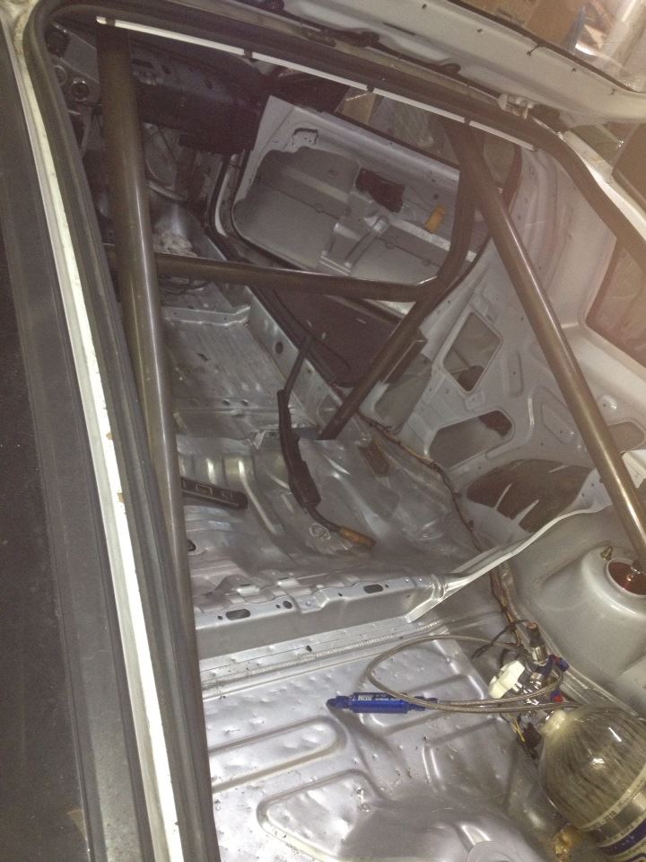

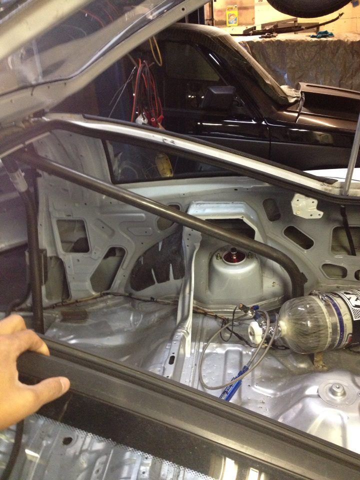

Hey guys just an update. Taking the car to have the cage installed tomorrow. Went out and bought a 2g trans and precision converter. So hopefully in two weeks I should see the track.
Hmmm Going to look for my old invoice. Joe sent me one with no core. sorry I missed your reply. Who is doing the cage ??? Mtk welding race car does work for ivey tune and can help you out with the cage
2 more weeks. The suspense really stinks. Good move to the 2g trans and PI converter.
what kind of cage? 25.5 or 10 point? chromoly or mild steel
12point chromoly cage. Kris thanks for the pic please feel free to post more of the progress. I'd love to see how it is coming along since I can't get out there to see it.
