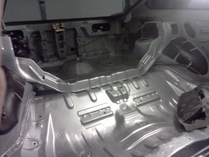

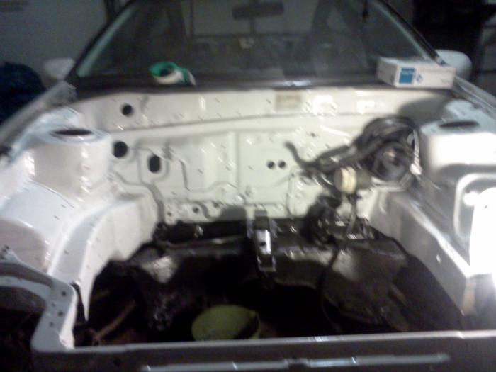

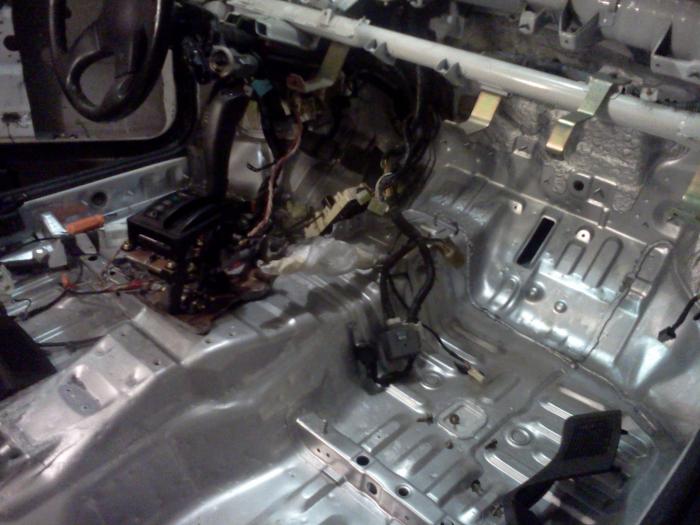

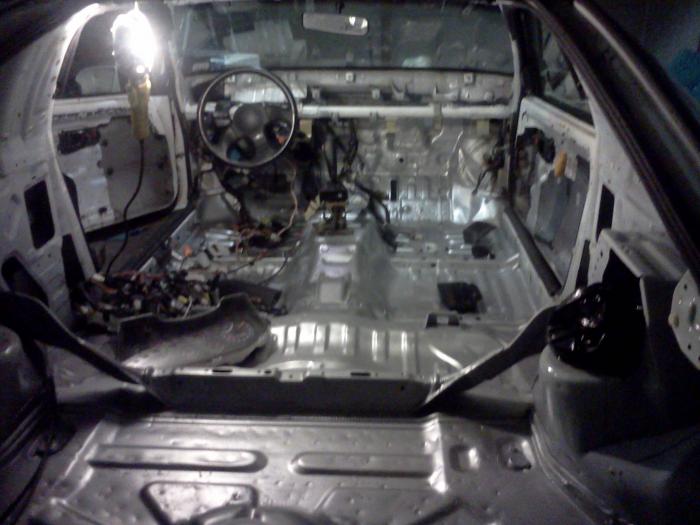

Since we got the car we have put it on a serious diet, taking out all but the absolute necessary. All sound damping material has been removed doors gutted out and window motors removed. Fuel tank, spare, all interior plastics, all power seat belt equipment, anything that could go is basically gone.

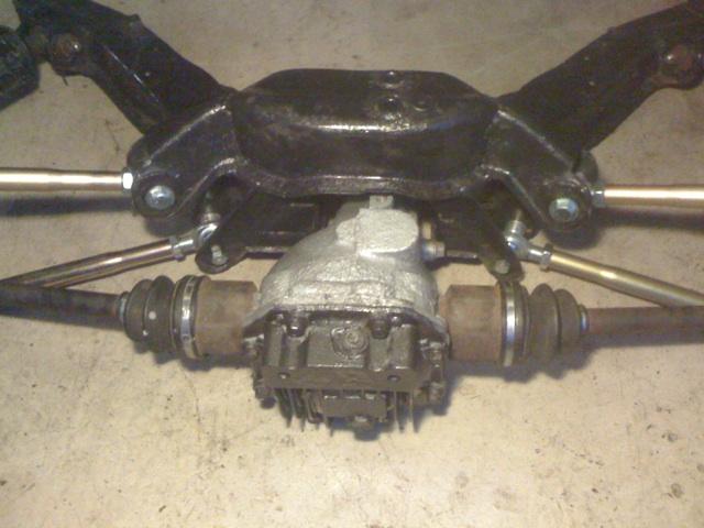

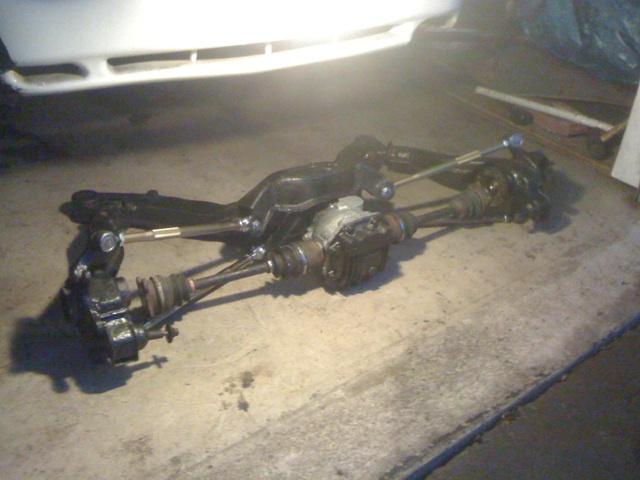

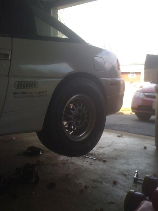

We also pulled down the rear subframe and rear did all bushings and installed four adjustable control arms. Removed minor surface rust and repainted the entire underbody. The engine bay was completely gutted, cleaned and repainted as well as the interior.

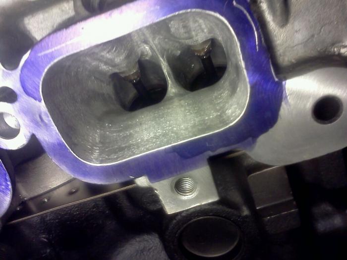

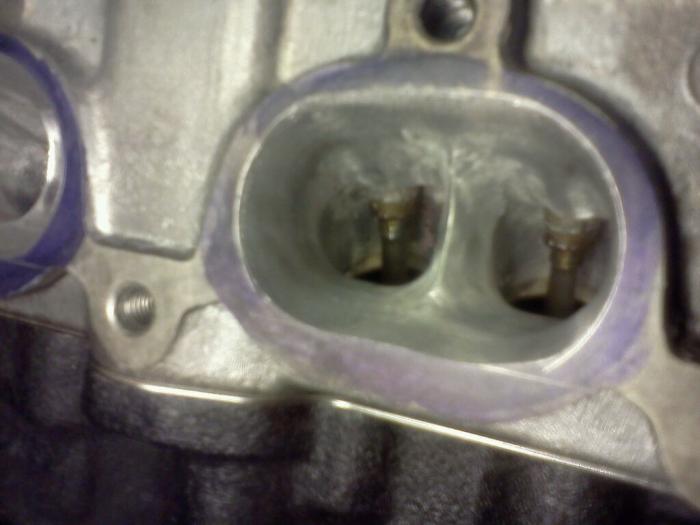

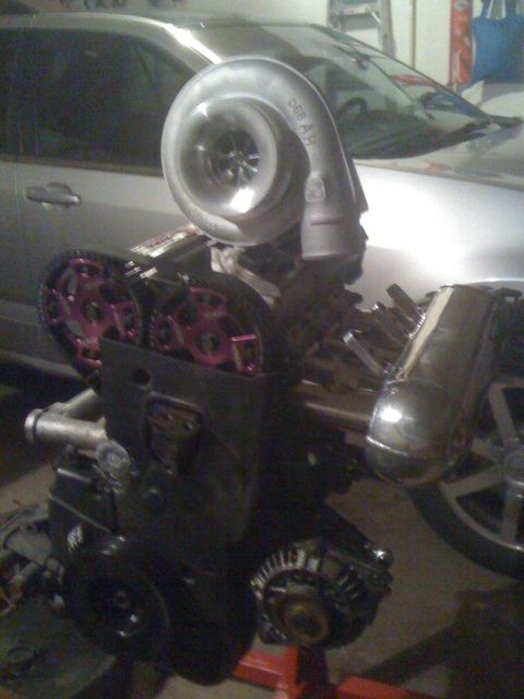

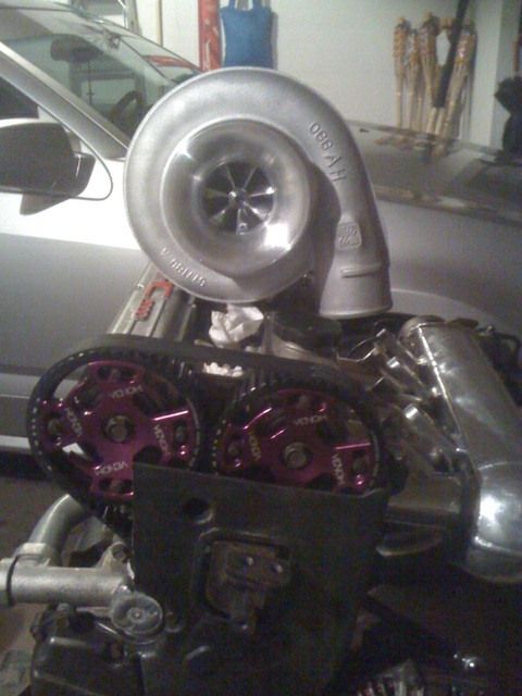

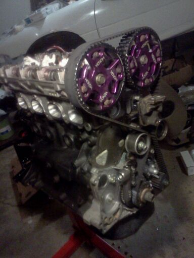

The motor we decided to go with a 6 bolt 2.3 Wiseco HD, R&R aluminum rod and Eagle 100mm crank combo. Everything fully balanced and blue printed. The head is fully worked with Supertech valves, Kiggly springs, GSC S3 cams and a full port and polish.

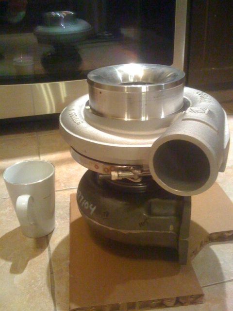

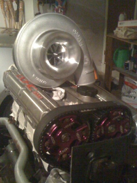

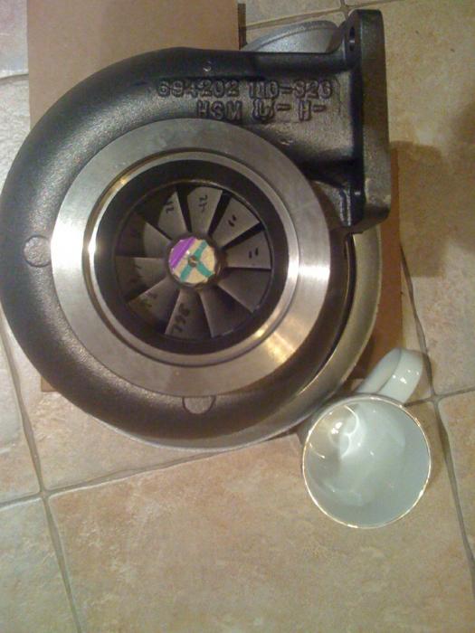

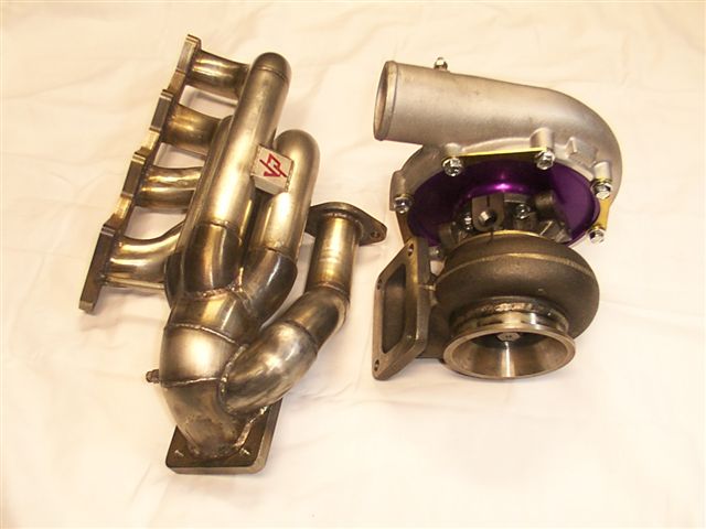

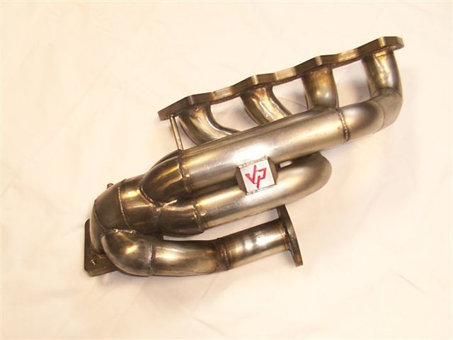

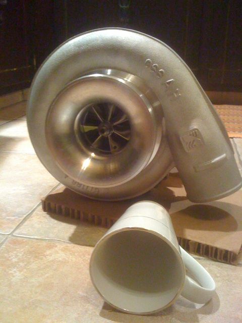

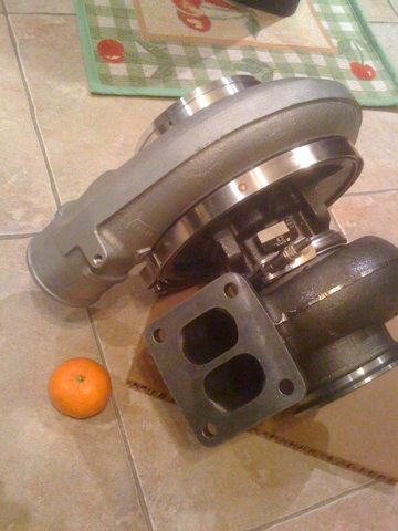

For a turbo we went with a Boug Warner 67mm. For turbo manifold we have the JMF t4 divided top mount. We are going to be running e85 and nitrous.

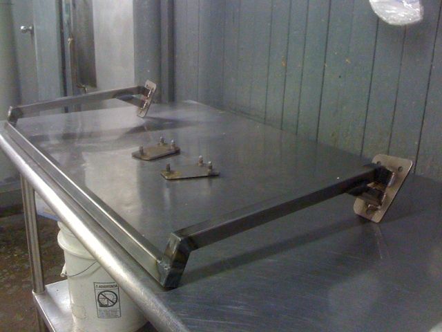

look like a fun build! How are you planning to mount your rear sway bar with the adjustable control arms?

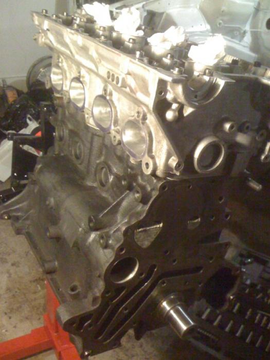

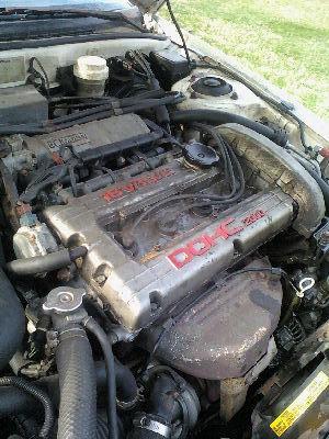

Always loved the white 1gb talons. Is that a completely filled block?

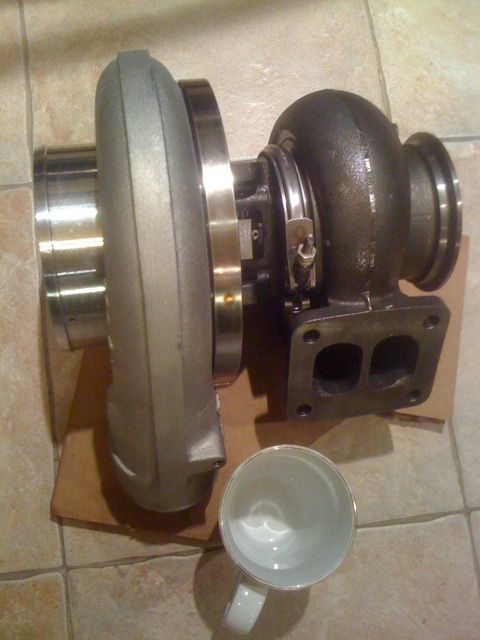

The block is 3/4 filled. I just took some pictures of the turbo I'll post up when I get home.:thumb::sneaky::hellyeah::rocks:

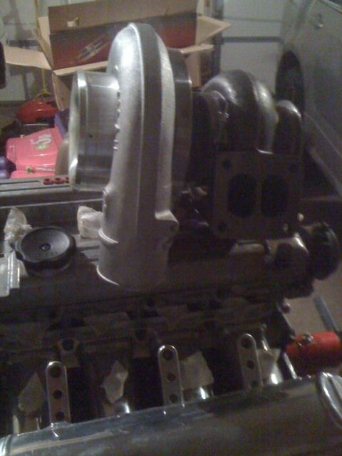

As promised here are the pictures of the newest member of the family.:)
I cant wait for the manifold to come so I can marry it off :D:thumb:
The block is 3/4 filled with cement. You fill the coolant paths with cement to make the block stronger. I only filled it 3/4 to allow cooling where combustion will be taking place.

Where in some ways the 2.3 may be a blessing in others it may be a hindrance. It will be great to spool up and get on boost quickly, but it will not be able to rev as high as a 2.0. I hope we may have overcome this issue running the aluminum rods for the reduced weight of the rod itself should take away from the added stress on the bearings. Hopefully the 28" slicks will eliminate the need to rev 3rd out to above 9k.

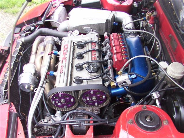

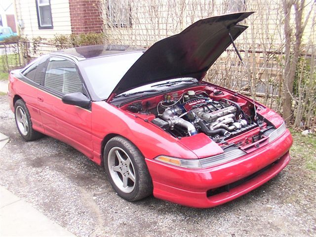

For your viewing pleasure I figured I'd give some more incite to where I've been with these cars.

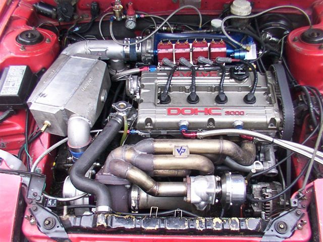

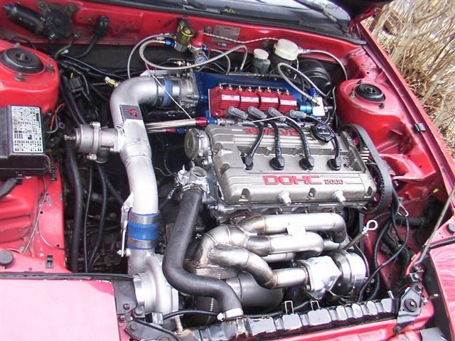

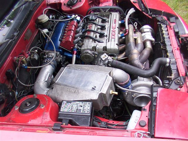

Here's some pictures of my setup back in 03'. Strictly alcohol car with a innovative t76 @ 45psi an a 250 shot.. I still wounder why I couldn't get that car to drive with out breaking parts...:aha::rolleyes:
Yes the manifold was equal length.

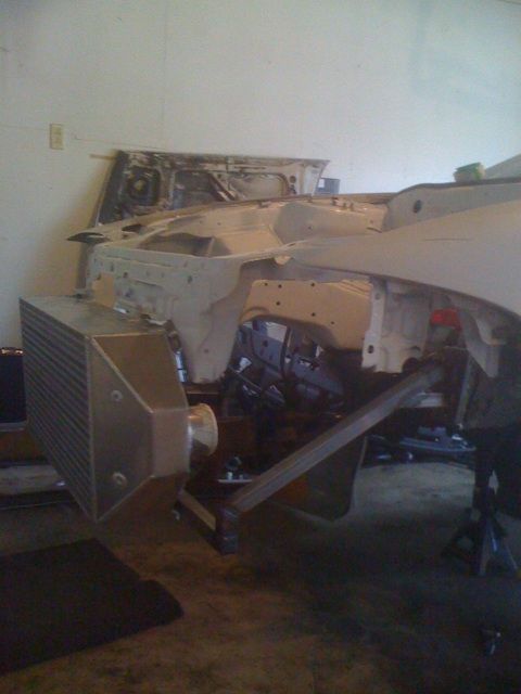

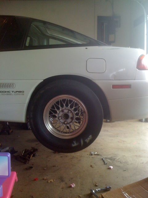

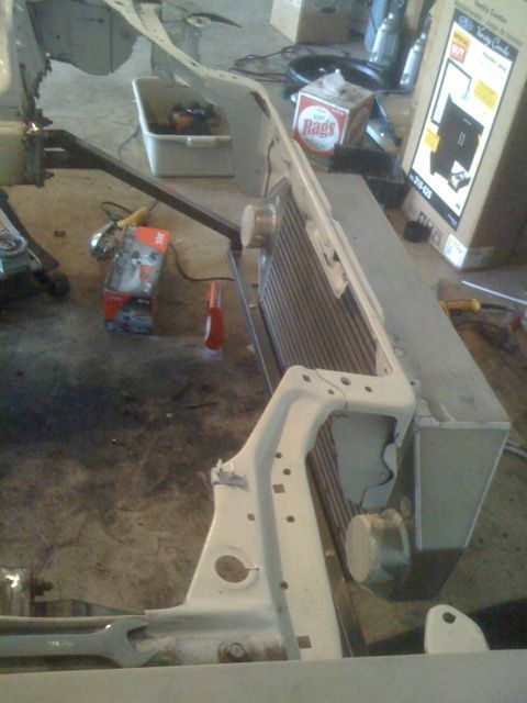

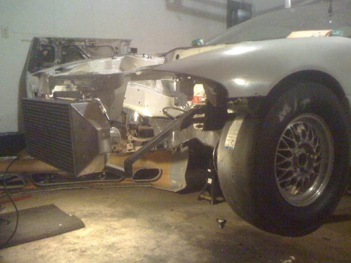

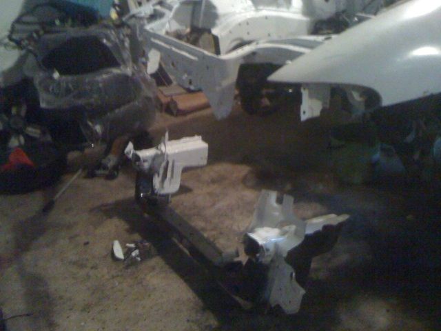

I have some more updates finally got the radiator support welded up and intercooler mounted. Also installed the Megan coilovers and mounted one of the slicks to check fitment. :thumb:

Nice build, what Ignition Setup is that? Never seen 4 individual MSD coils setup like that for a DSM, I can see how you light off 45psi. :hellyeah:
