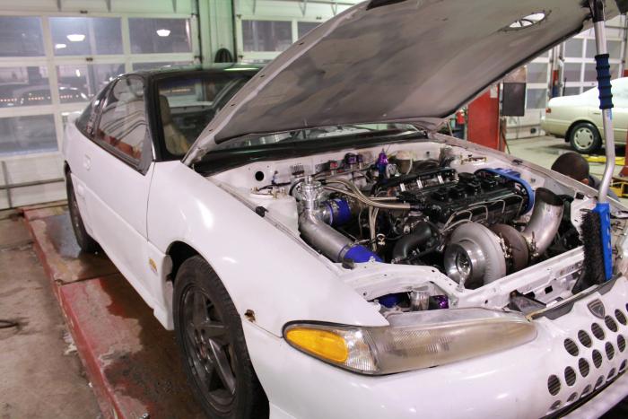

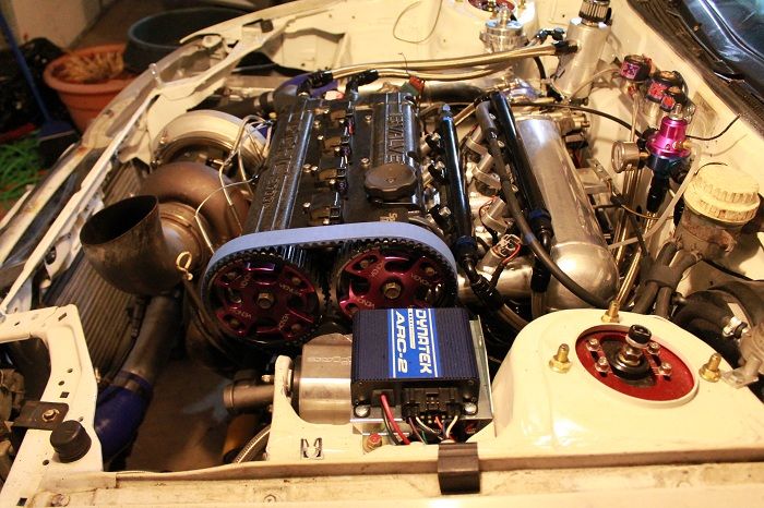

8 sec 1gb auto awd panda build
got 2 questions
what motor mounts you running and where did you get that plate for the hood for the exhaust

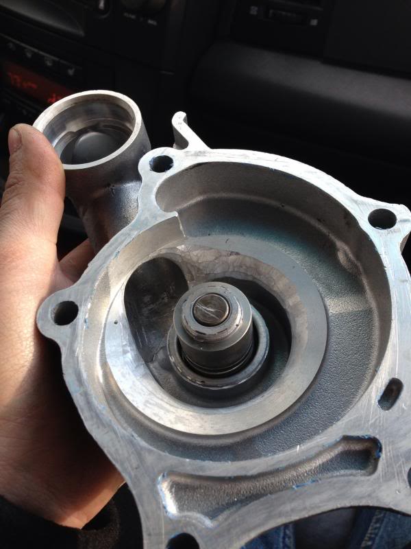

Hey guys sorry it took so long to get back to your questions.

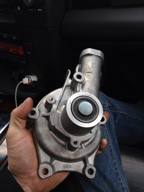

What model and brand water pump did you install? Vey interesting.
The water pump is a Davies Craig EWp115.
got 2 questions
The motor mounts are the Avid racing 3 piece billet mounts for 1g auto. The plate is just a piece of sheet metal that I cut to the shape I wanted, formed and riveted to the hood.

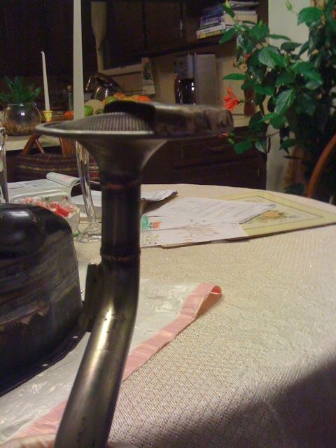

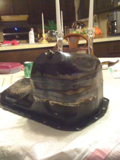

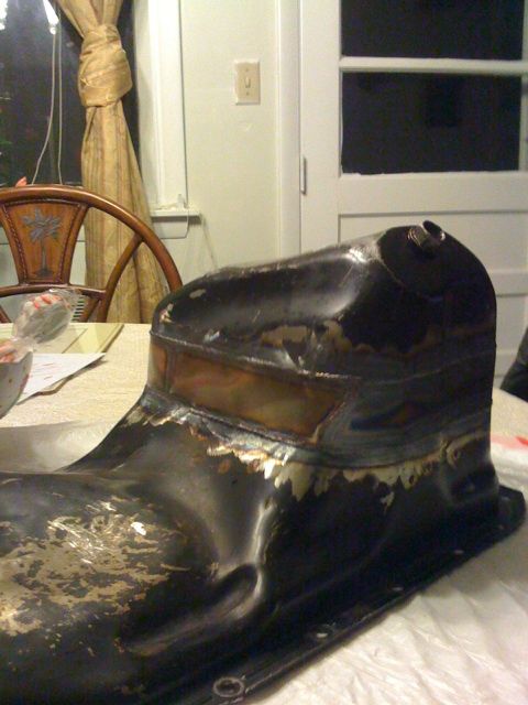

Took the pan off and had it extended about an inch and a half. I measured it to be about almost a quart and a half more oil. Hopefully this will help prevent the pickup from being uncovered during hard launches.

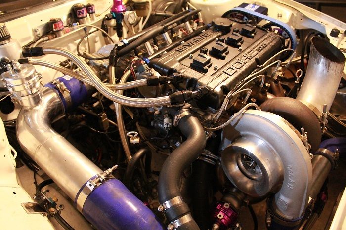

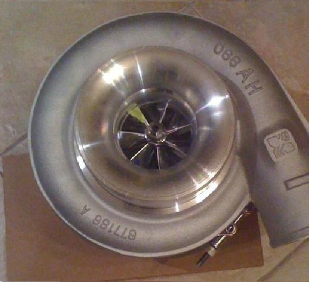

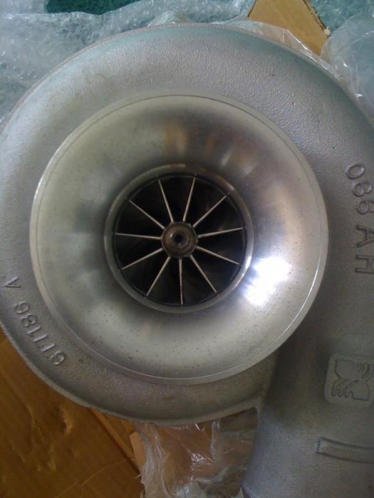

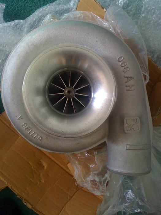

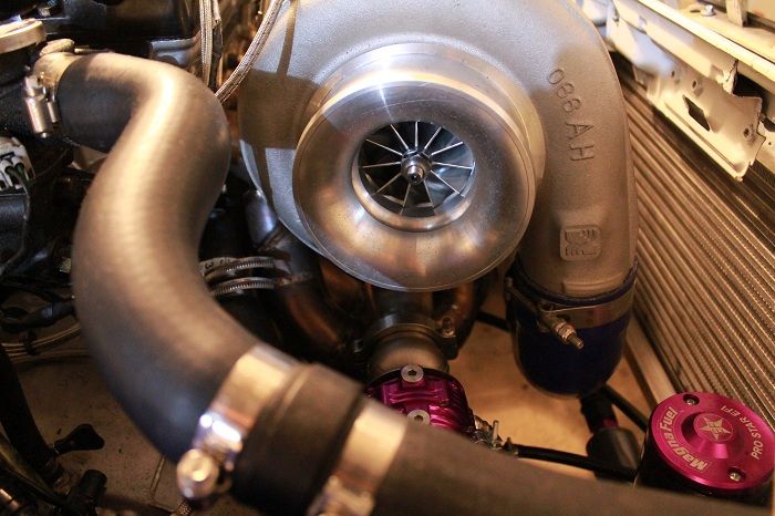

On another note had a bit of a change of heart on the S467 sooo.... I gave my friends at Force Inductions a call so I could send in my S467 in and have them work miracles. :rocks: So now I have a S472 with the new ETR wheel. They use the same turbo as a core, take off the 67 compressor. Then install they're ETR wheel, machine the compressor cover to fit, and then pull the new turbo out of hat. LOL I'm so excited and ready to see what this turbo can really pitch at me. Thanks again for all those watching and just know this car will be at the track very soon. :shhh:

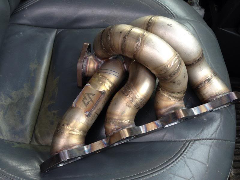

*Picture #3 is the before picture.

What kind of billet wheel is this??? any closer details on it?? Thought s467 use comp wheel from BW EFR 91-80..which is rated about 94lbs..
Great build Sir :thumb:
Thanks
You are correct the s467 uses the bw efr wheel. But this is no longer a s467 it is now a s472. Its basically a custom turbo made by Force Inductions. They engineered they're own compressor wheel for BW turbo's. They were able to modify my s467 to the s472 with the custom comp wheel. This new wheel is supposed to flow 12-15lbs more than the BW67(forgot exactly how much they told me). Should be good for about 150 more hp.

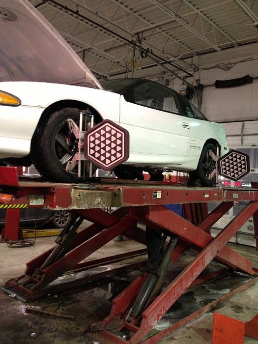

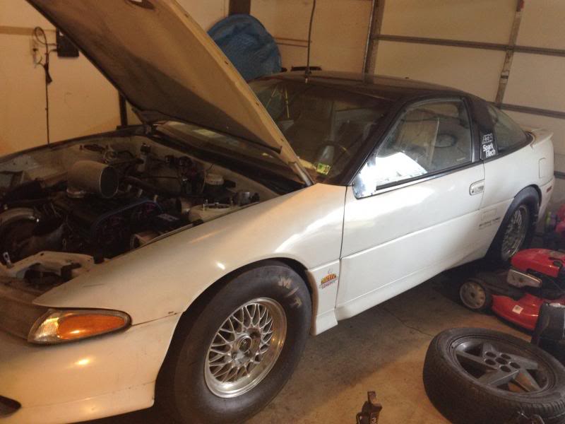

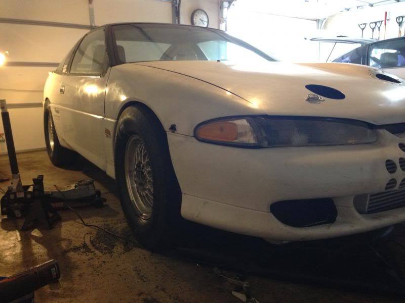

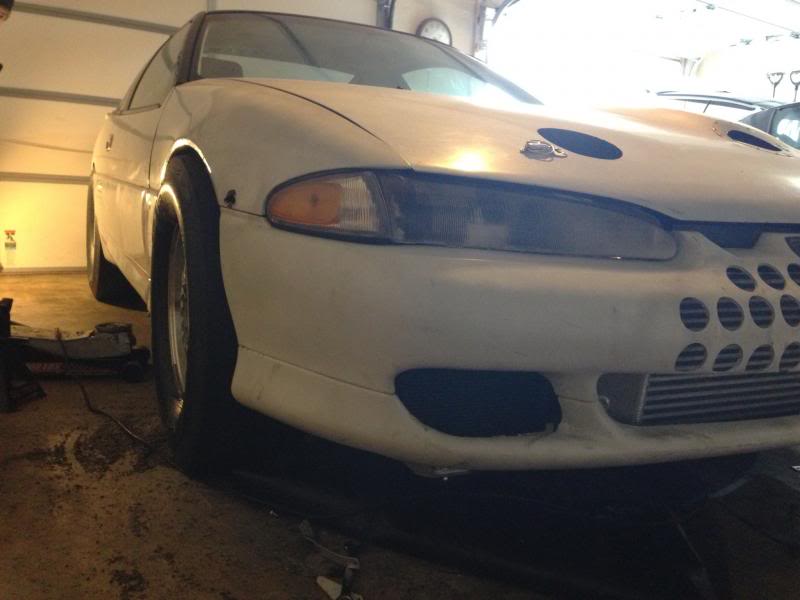

Finally got a chance to work on the car. Got the turbo back on and took a drive to the alignment shop in this peaceful tri-state blizzard. Blizzard + powerful car -sway bars- wipers and headlights= no fun LOL Well anyways here are the pictures. Got my dyno date for the 19th and cant wait :D :hellyeah:

Who did the work on the oil pan and the oil pick up tube? I am interested in doing the same thing.

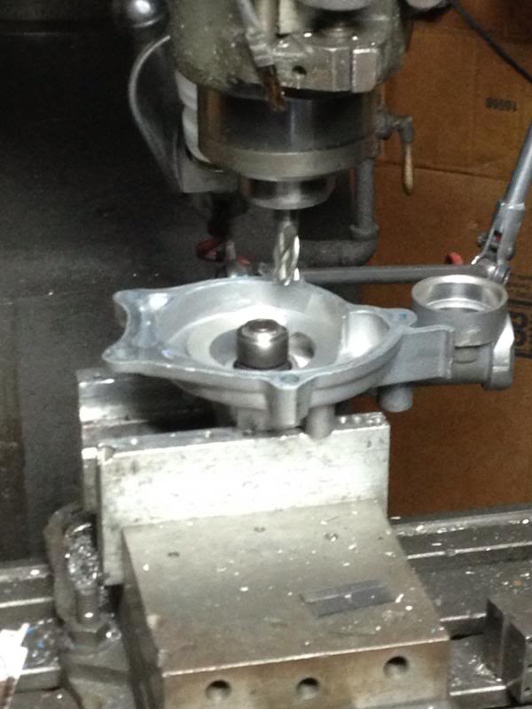

My same fabricator that did pretty much all the other one off parts on my car. Including the water pump I haven't got a chance to post pictures of yet. For more info just pm me.
Trying on some new shoes!!:rocks::hellyeah::thumb:

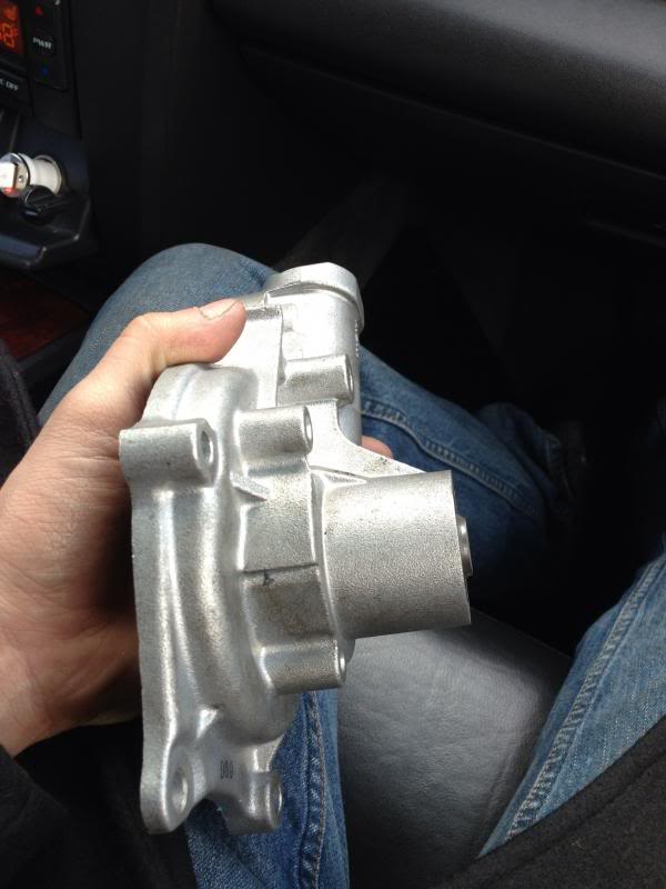

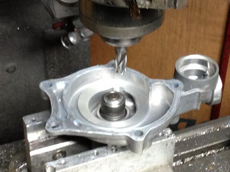

Water pump mods

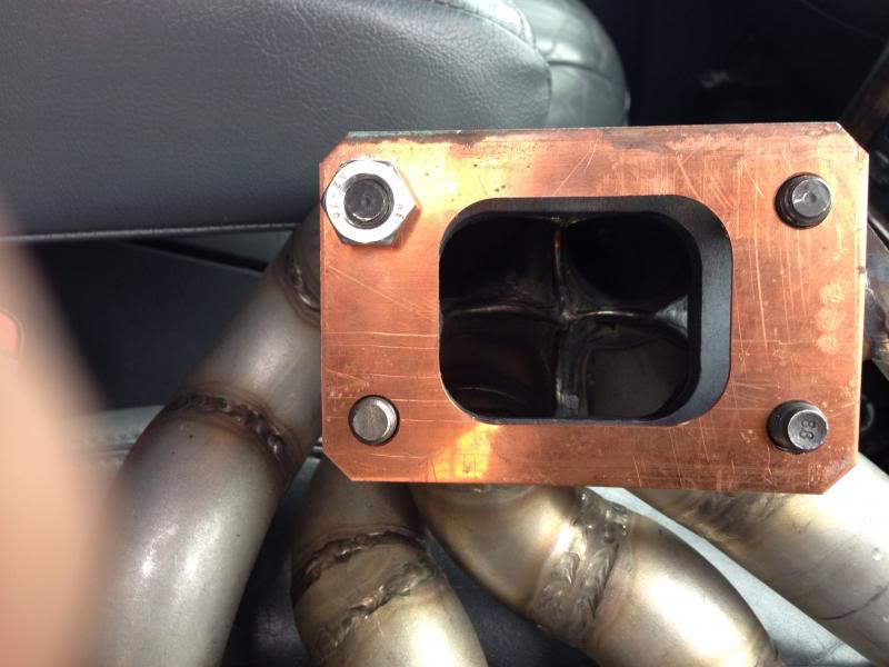

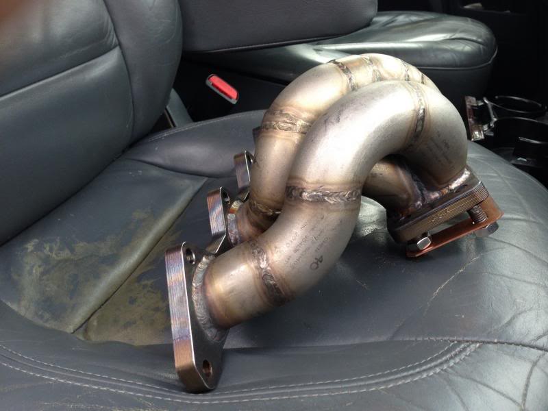

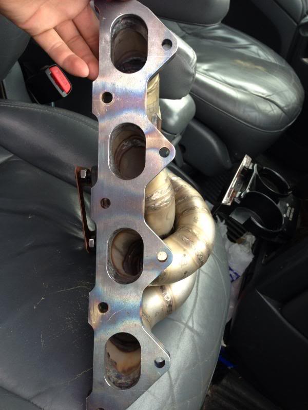

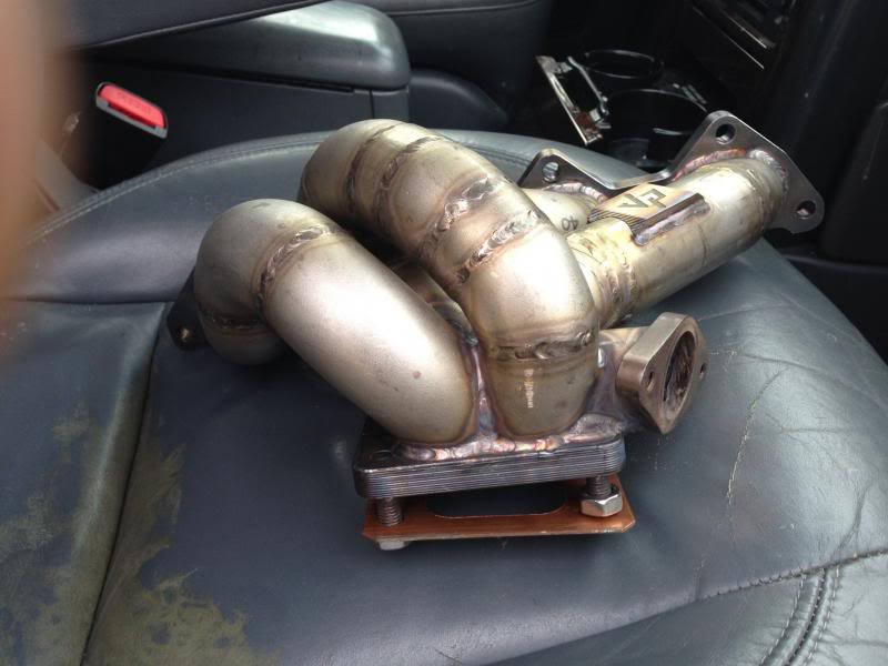

New manifold for my street car. Fits power steering stock radiator with evo8 fan and a 6262.
