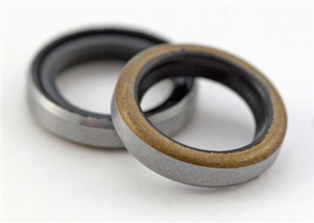

I plan on doing it myself but all I know is that I have a 1g N/T throttle body and not sure on the year.. so I don’t even know what seals to buy; could you help me out?
I'd have to guess that's a 91-94 NA TB but please do not only take my word for it. The below information will be based on this assumption.
RTM says the turbo seals will fit a NA TB:
"NOTE: These seals are sized to fit turbo DSM throttle bodies, however, they will also work with non-turbo throttle bodies. The only meaningful difference between a turbo and a non-turbo throttle body is the depth of the shaft seal bore is slightly shallower on an NT throttle body. This will cause the shaft seals to protrude about 1mm from the face of the throttle body but this will cause no issues with sealing or anything else."

You're probably going to be doing this yourself. IIRC turbo seals will work in a 91+ NT TB. Supporting vendors should have the seals in stock.
