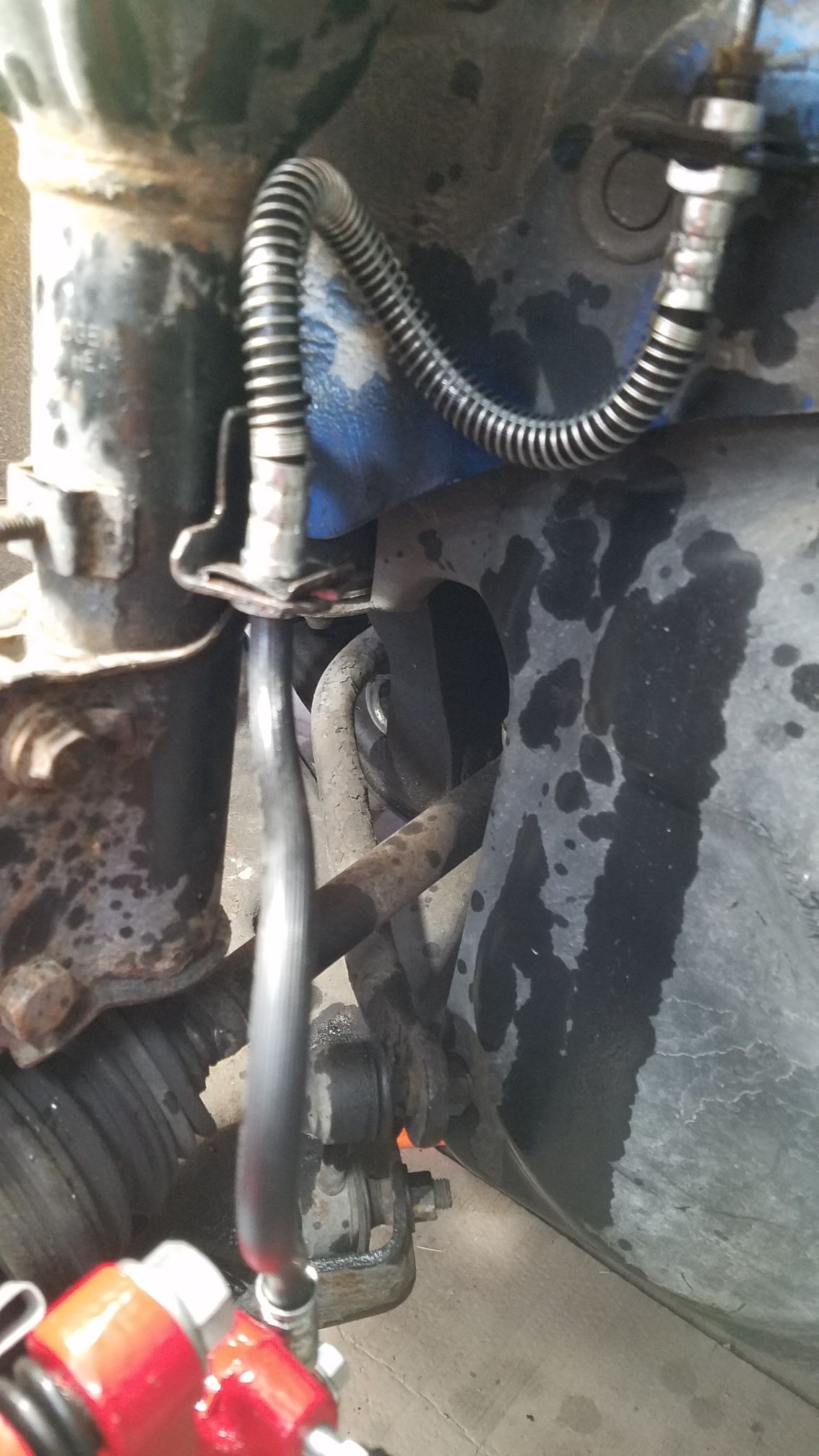

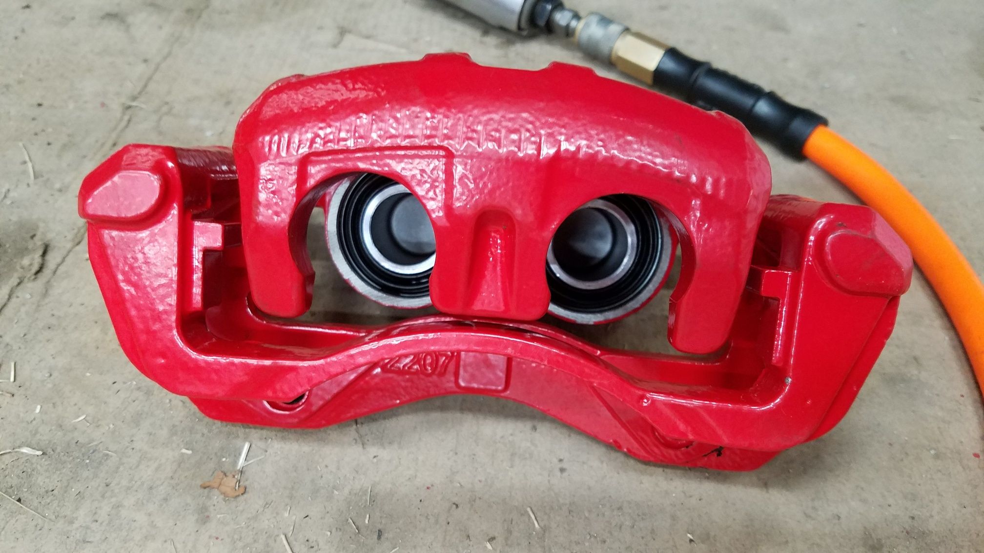

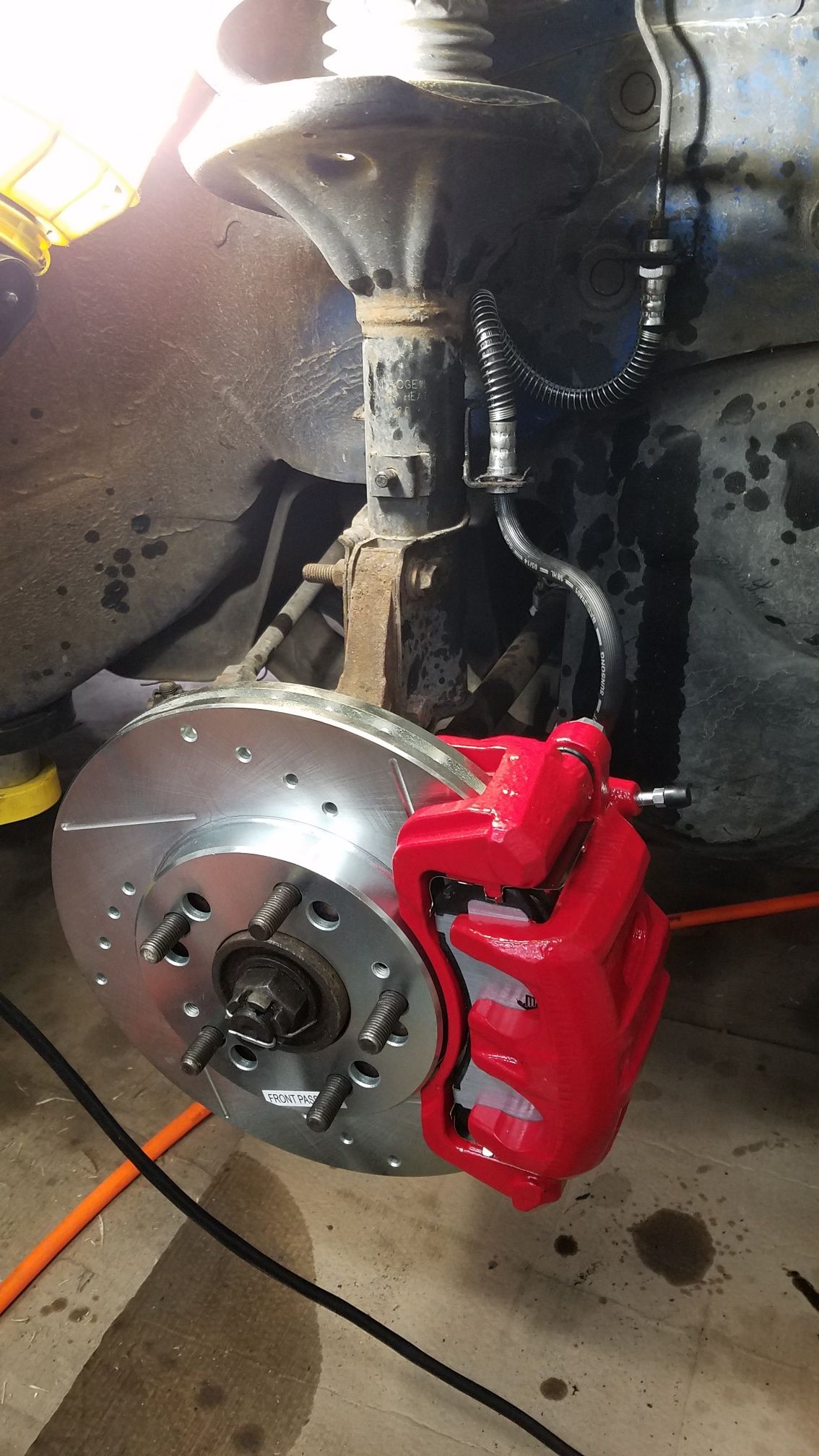

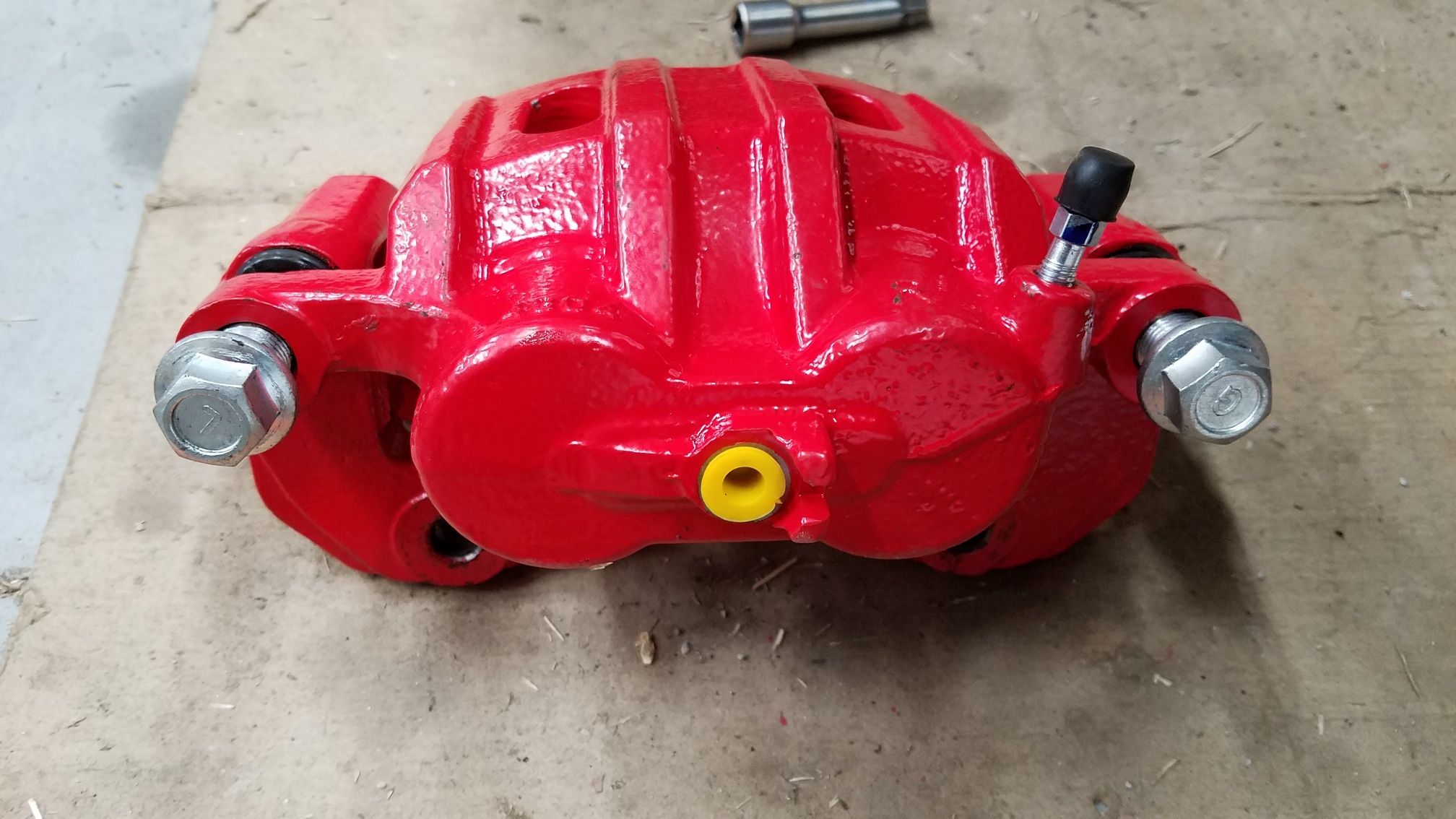

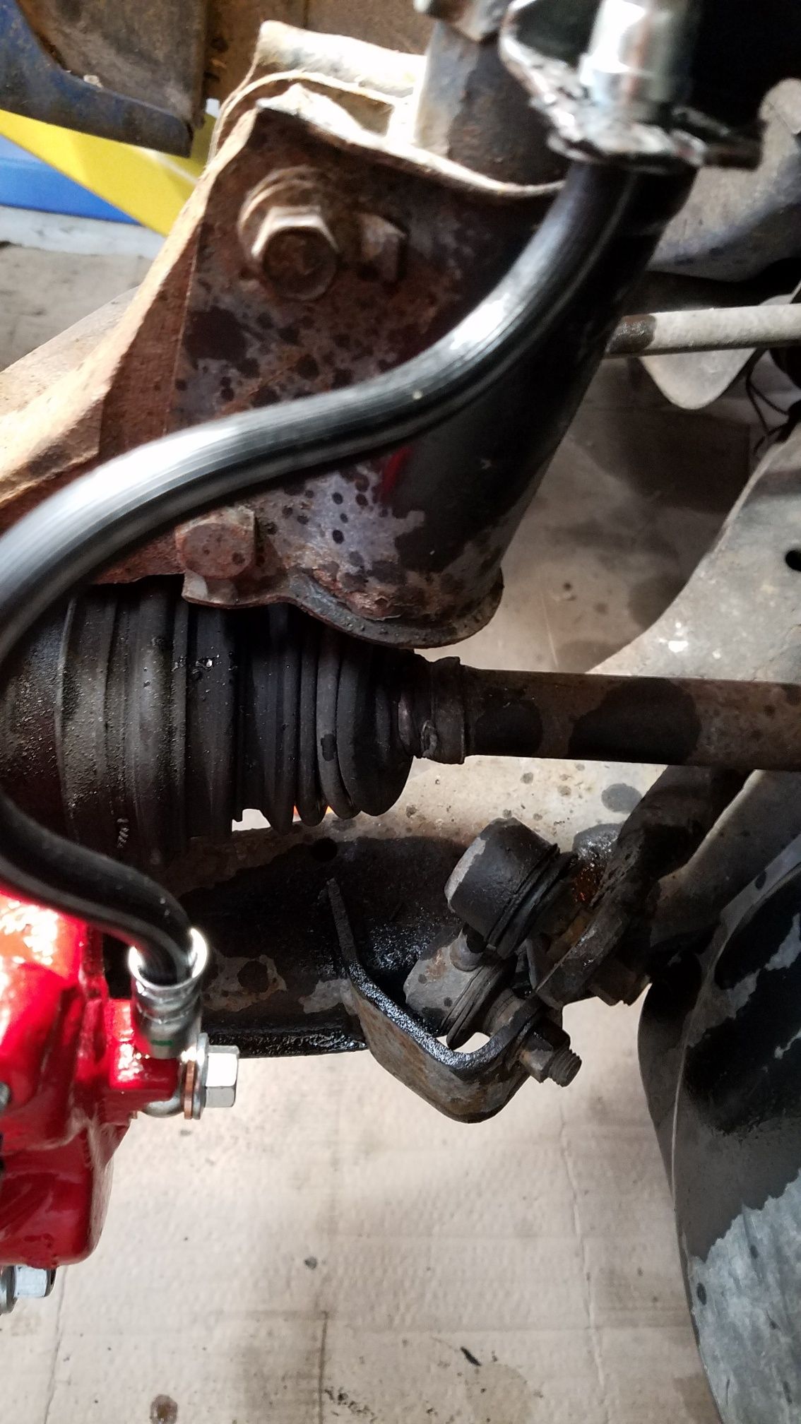

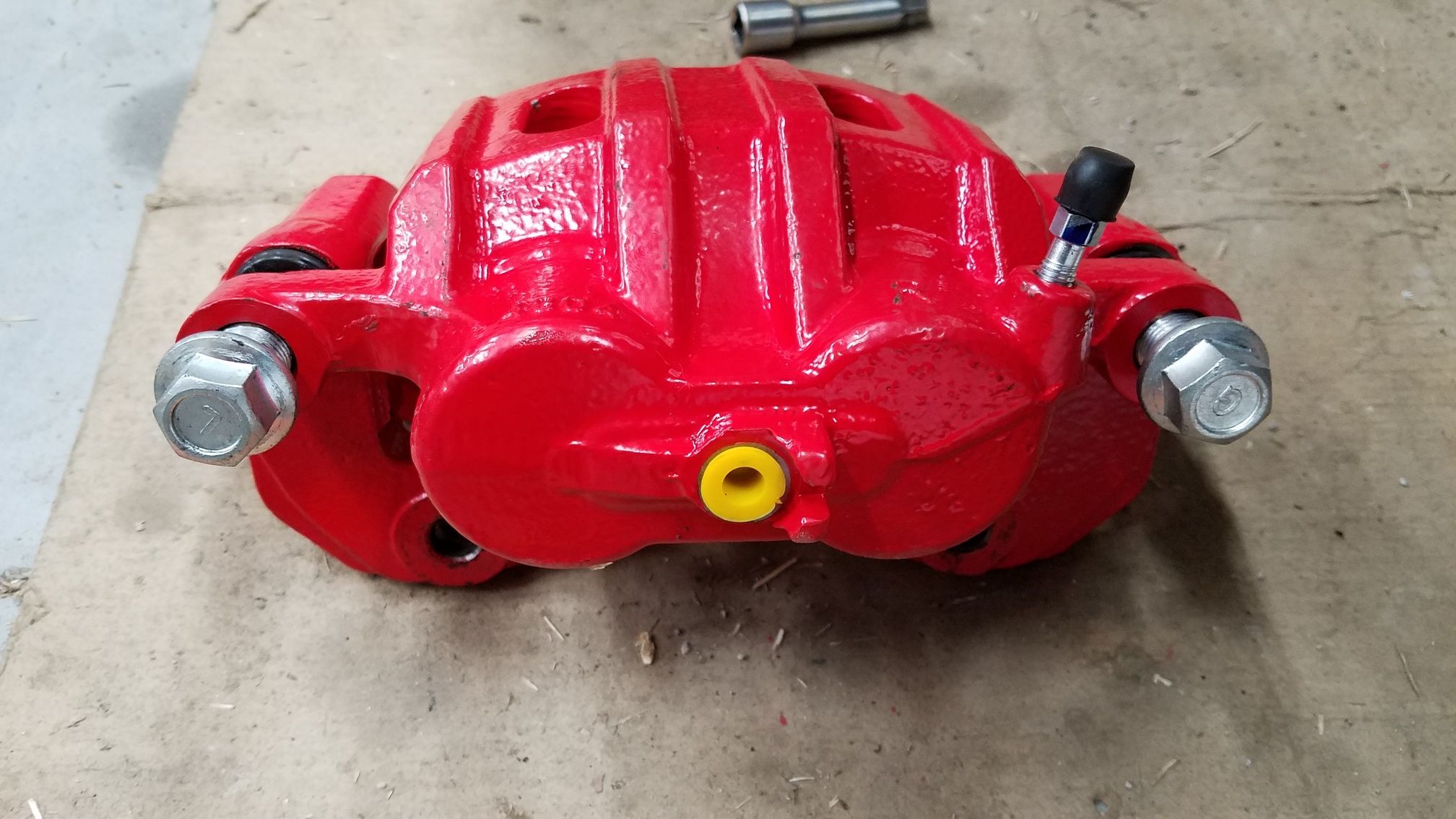

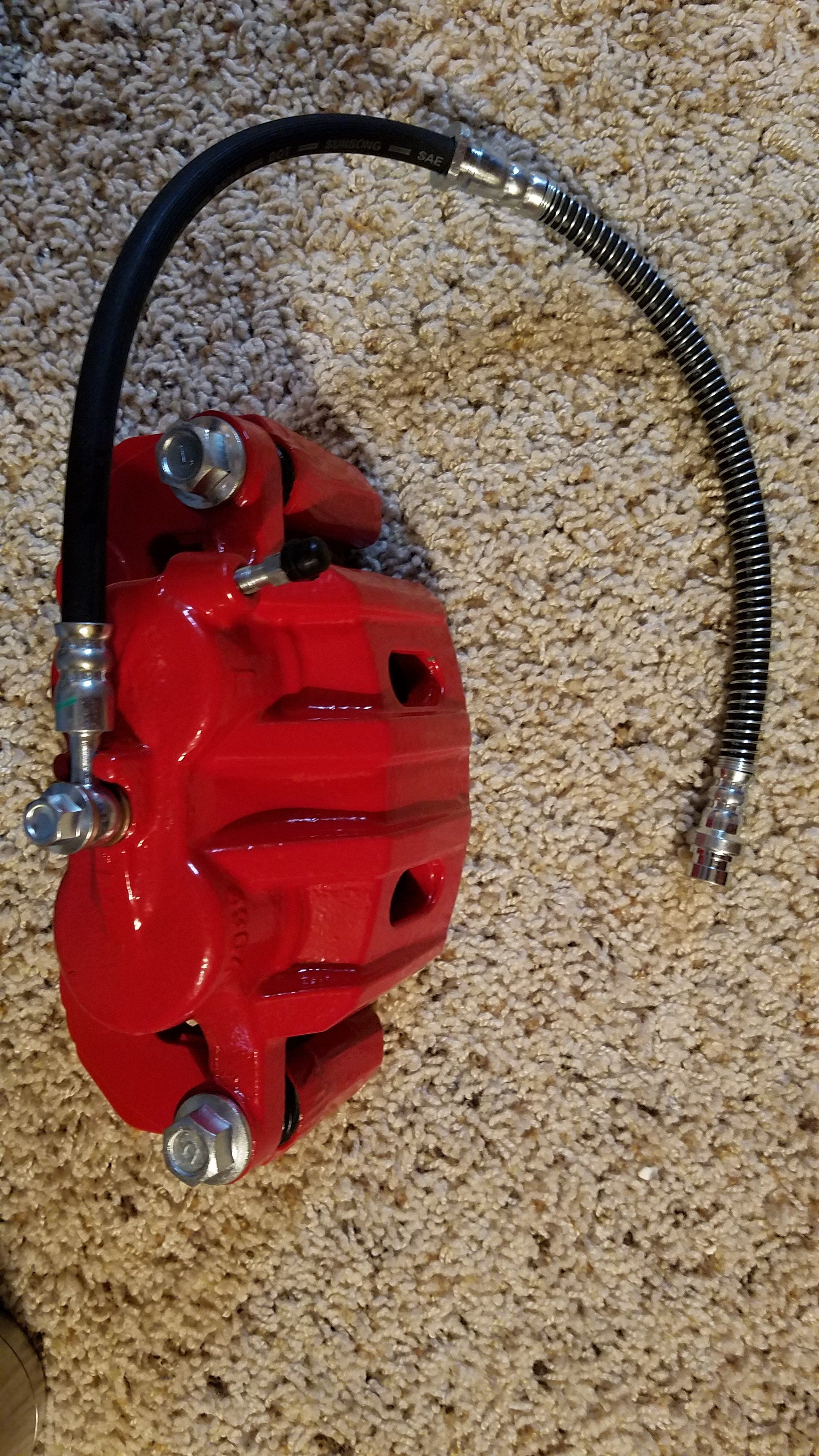

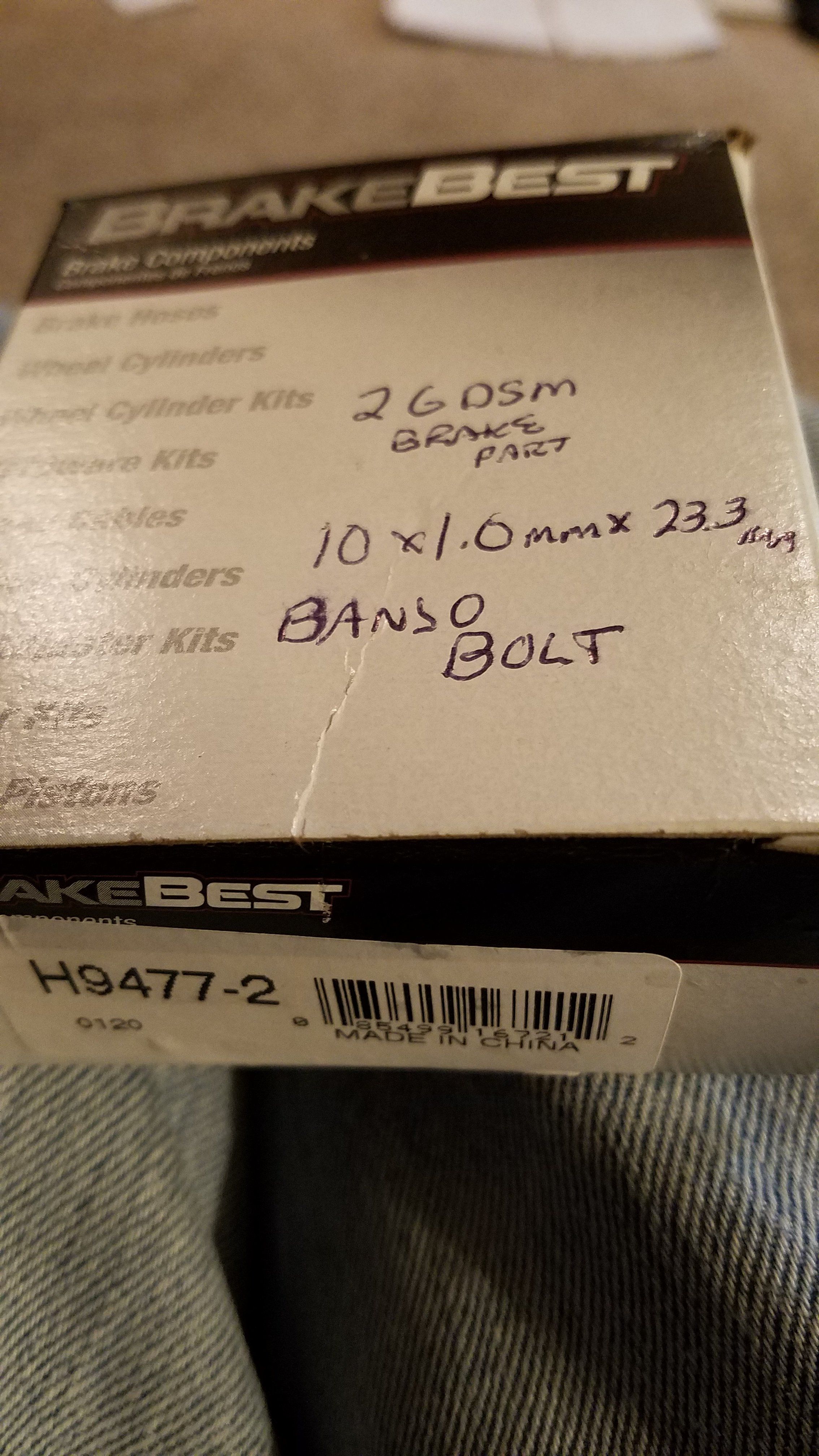

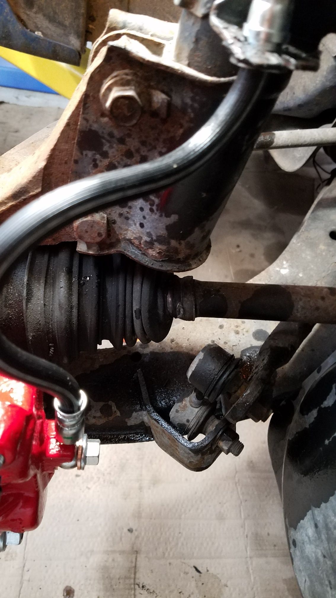

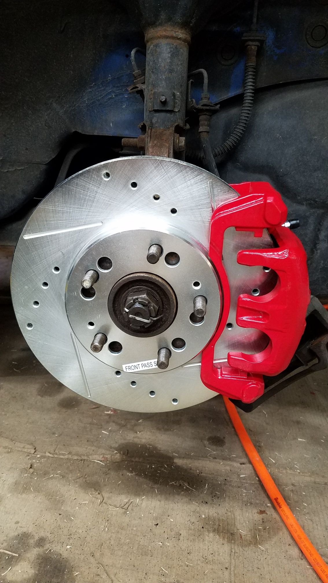

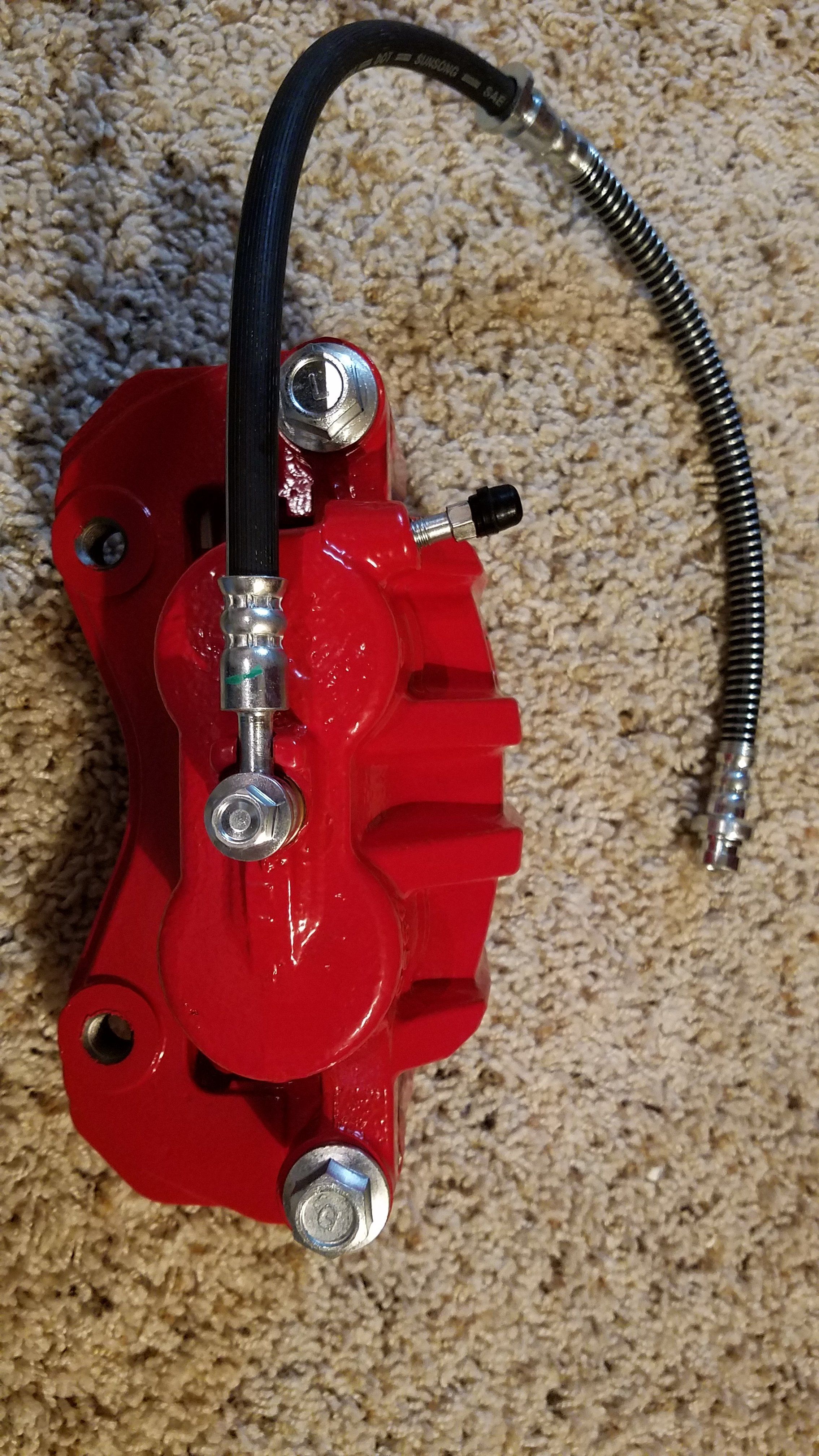

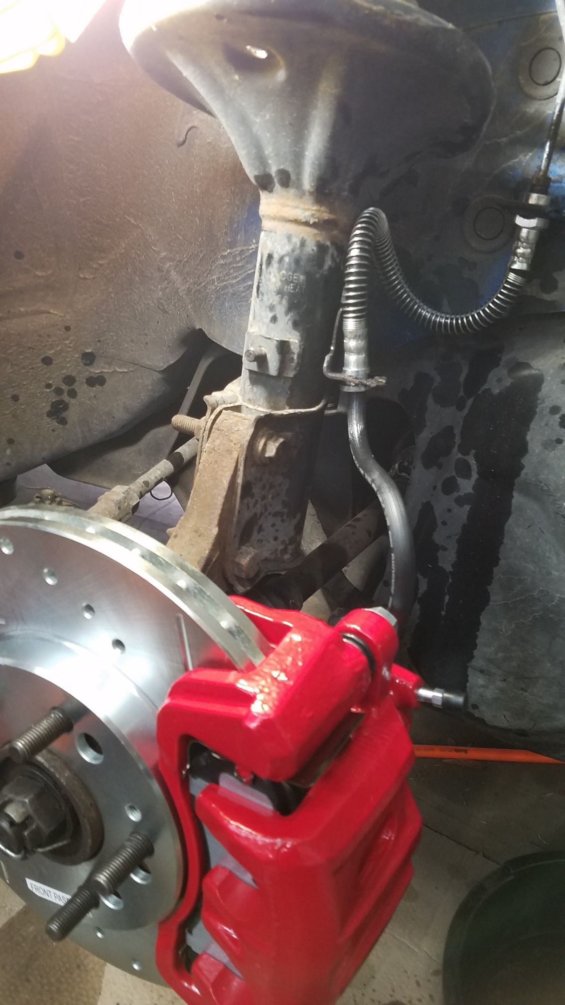

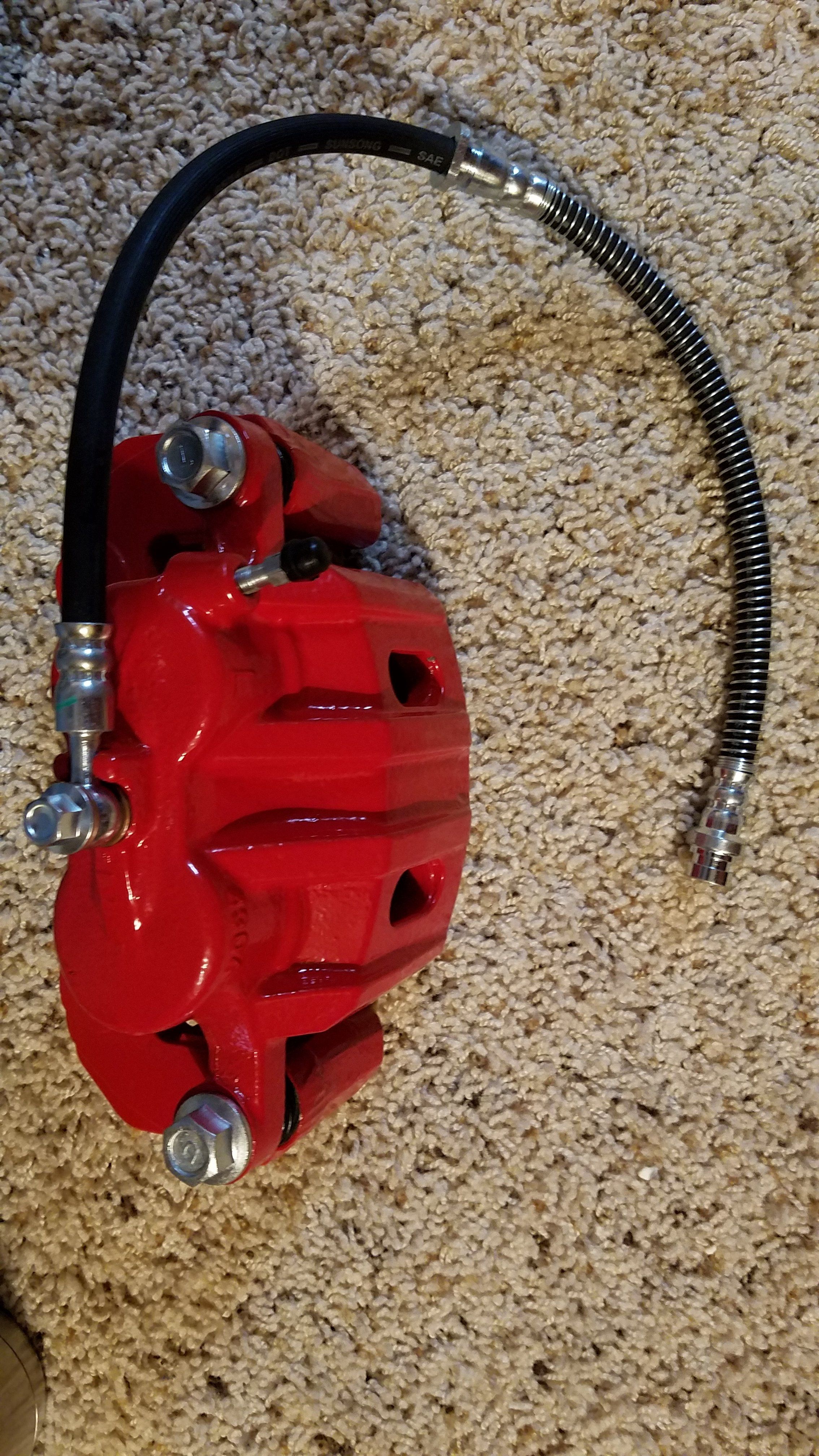

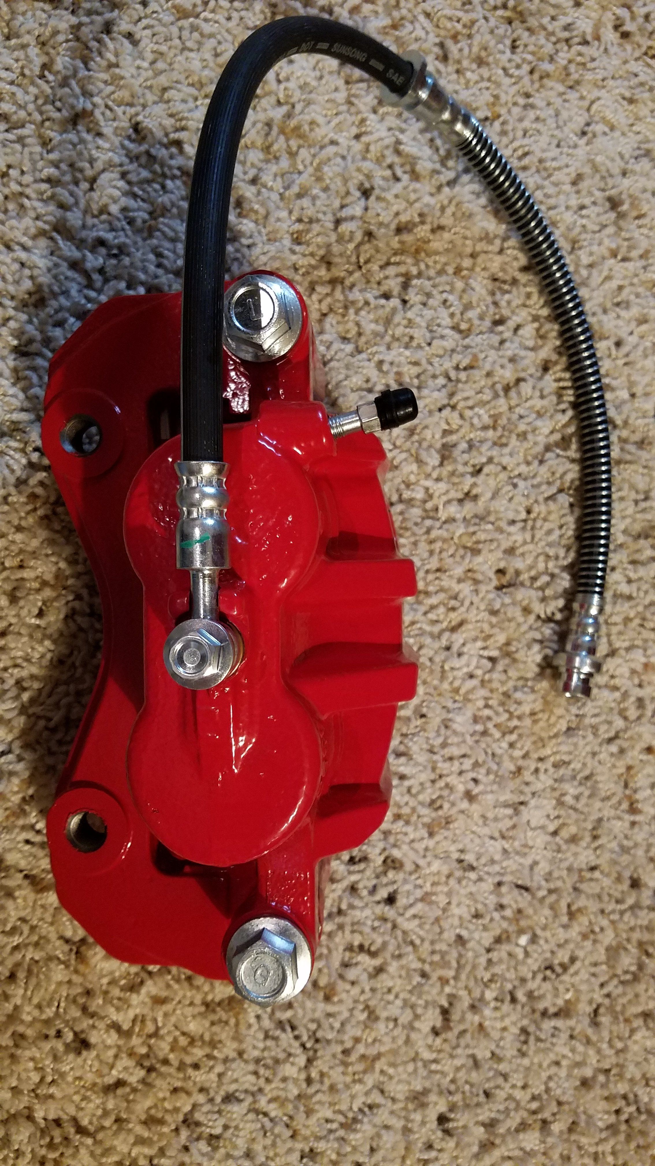

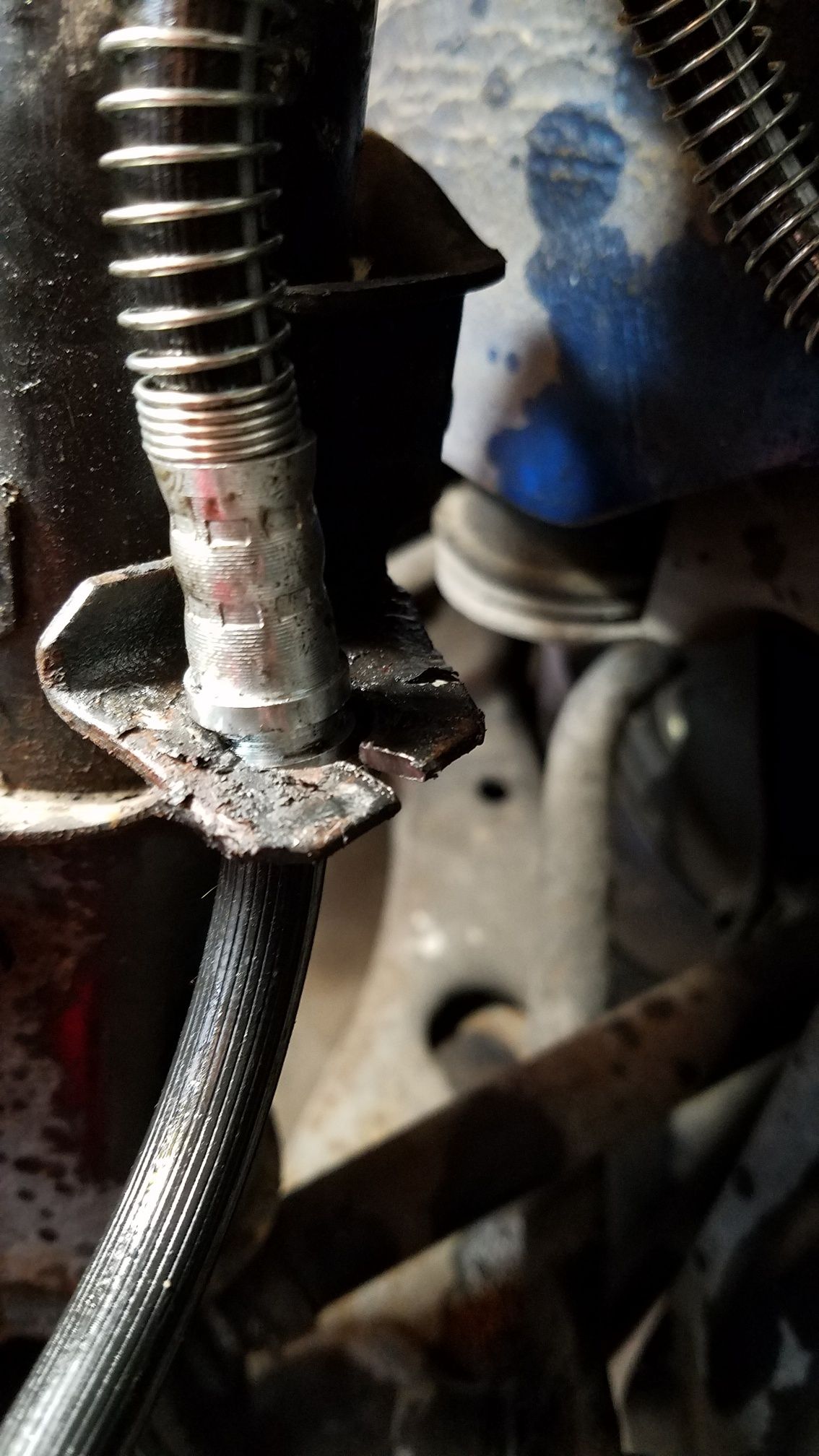

Here are the banjo bolts I ordered from Oriellys so you know they will work. They are 2mm longer but work just fine. Even comes with the crush washers!
I checked it ALL out for sure first.
