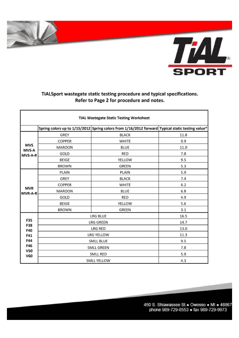

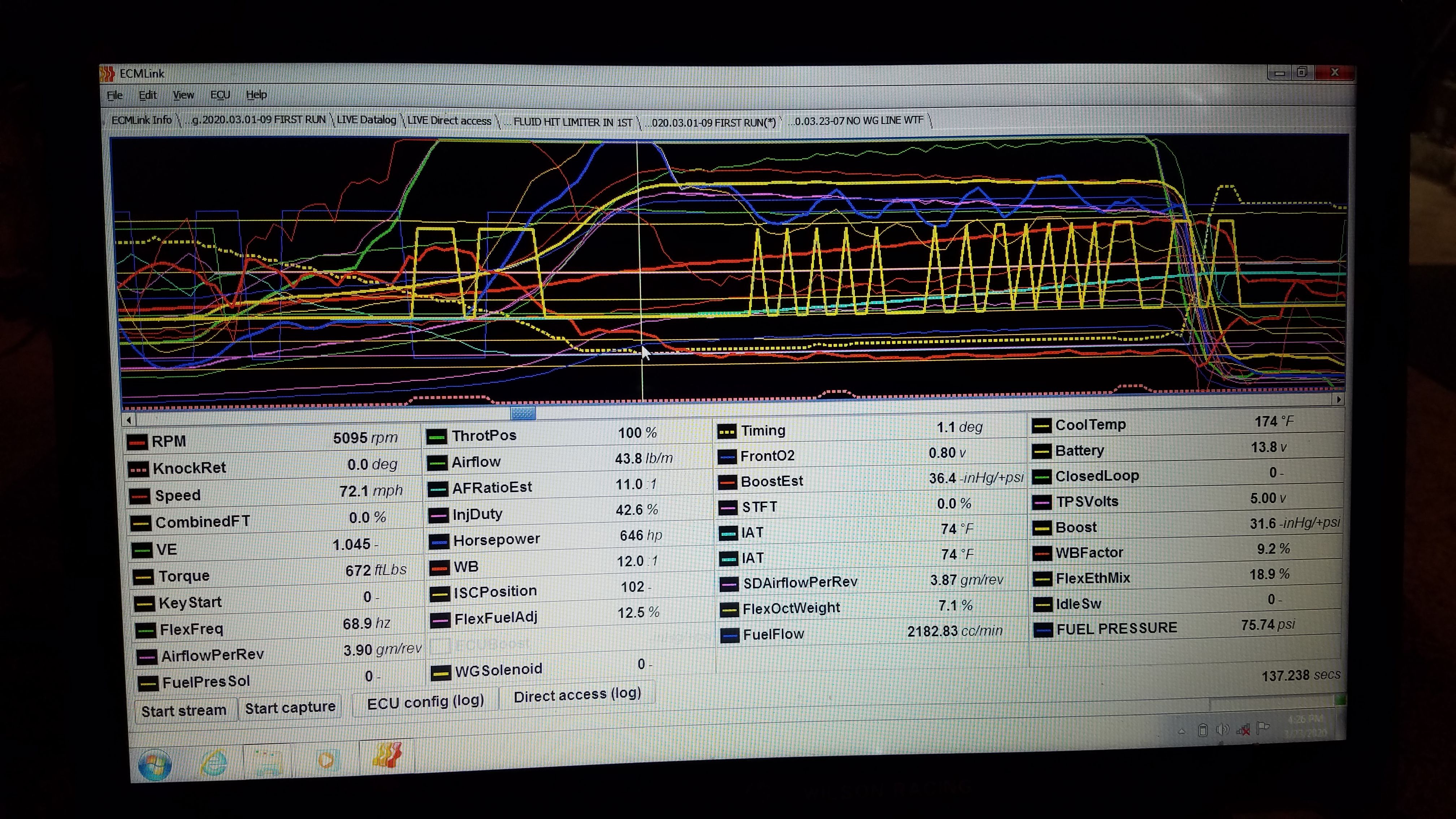

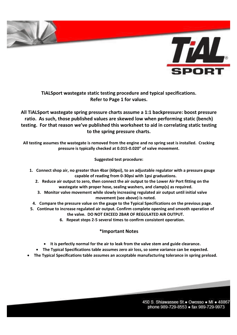

I don't wan't to hear this whole pandemic/martial law/everyone dying blah blah. We want more boost! Hope tomorrow is a better day for you.I have to find my TIAL 38 fiting to use both ports. Today was a sh**ty day for me so I took a well deserved break from cars today. I have big hopes for running both ports. I ran just the top port but no adjustment. Bottom port seems to lower pressure as @rabenne points to so before doing the 2 ports, I'm going to go make a run with the line off and try a 3rd gear pull and see what happens and keep the right foot ready to pedal her. Hopefully tomorrow will be a nicer day, it was gloomy all day here besides not "feeling it" today.
This pressure that @Vegas smith keeps puttin on me is wearin me out![]()

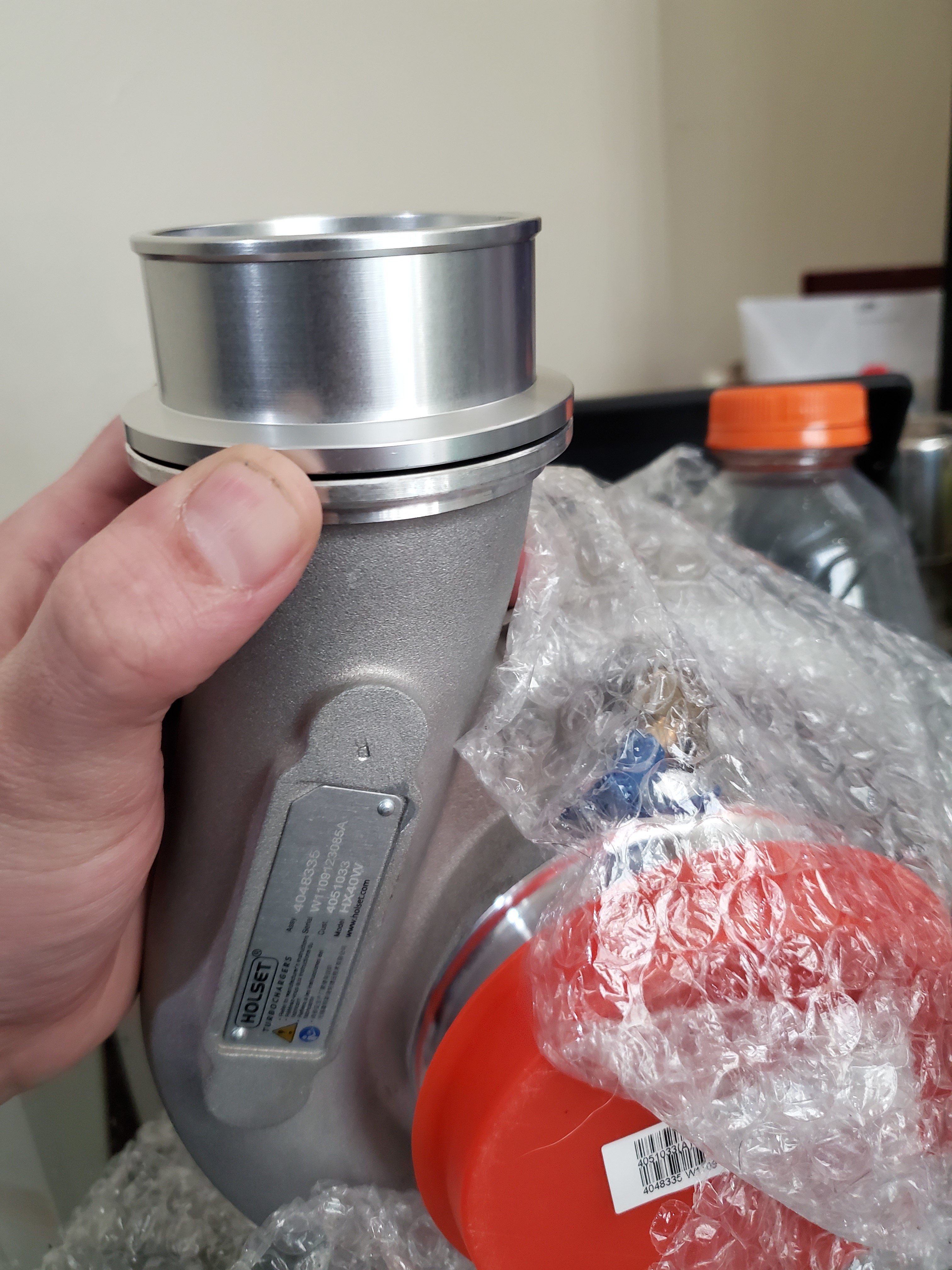

Right, like Tom Cruise????Just remove your plates before you give the tower a fly-by
