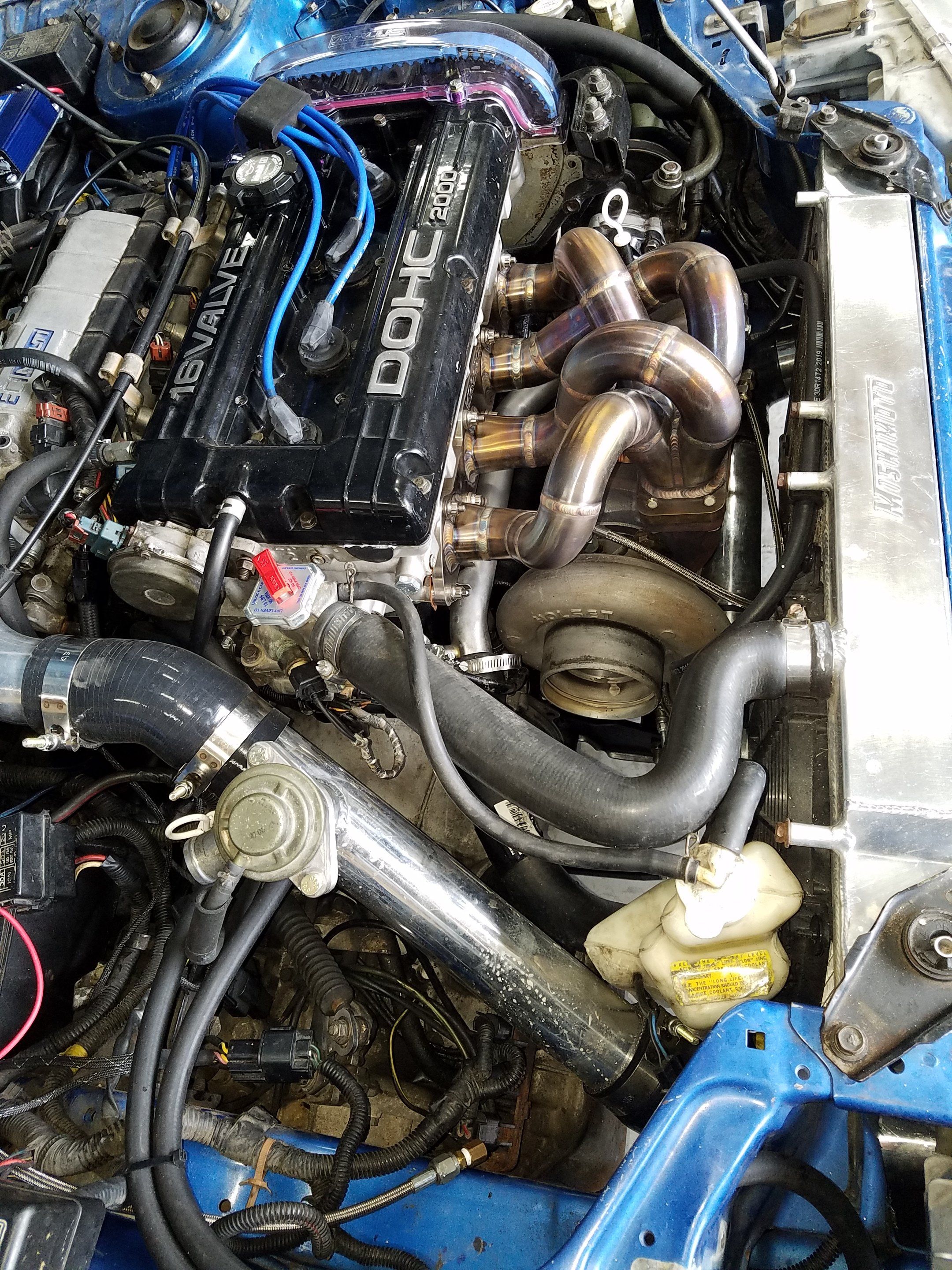

Been working 6 days a week at the good ole USPS to get everyone their Christmas gifts so haven't had much time to refine the tune. She is lean up top so it needs addressed. The TCU needs the 2-3 shift moved up about 500 rpm also. 2 step is needing lowered about 500 as I am on the stock converter so she only builds about 3#'s boost, BUT, she doesn't blow the tires off so that may be good. :thumb:
Well time for updates. They car will have a professional remote tune soon so I've been busy. I have the EBC installed and wired up for Link, IDK how much I'll have to use it, she runs very good on gate but its there.
The fuel pressure sensor to log with is installed and working great, that's a relief.

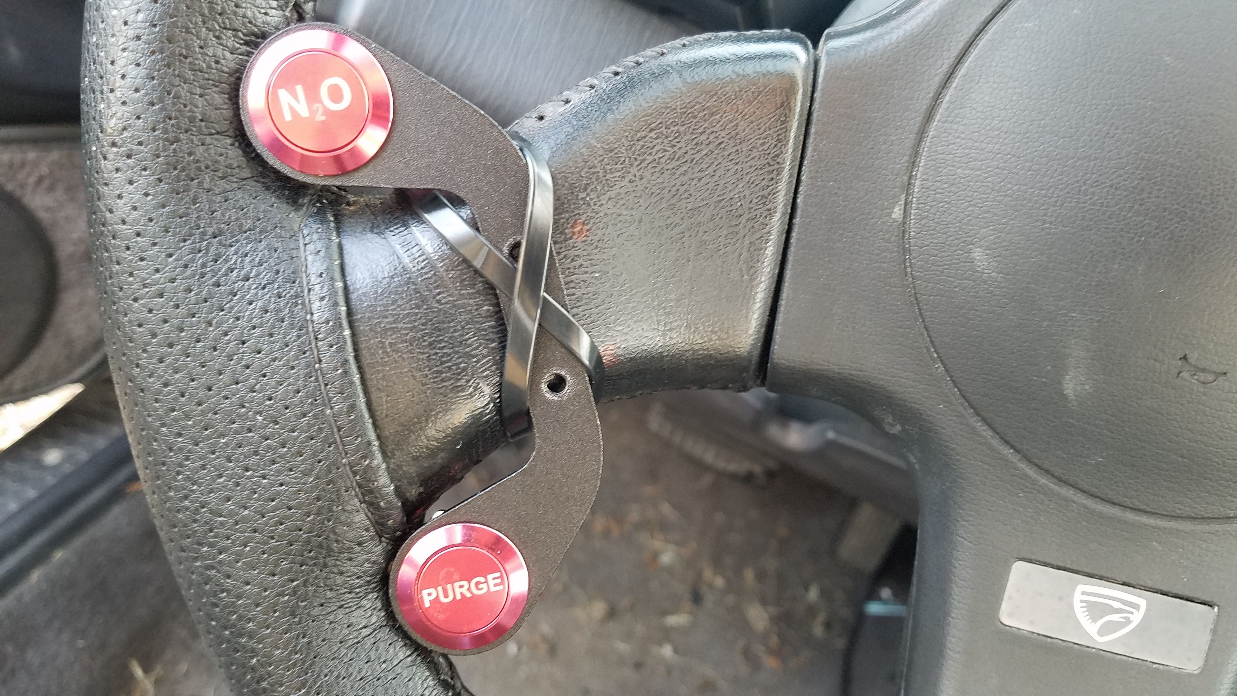

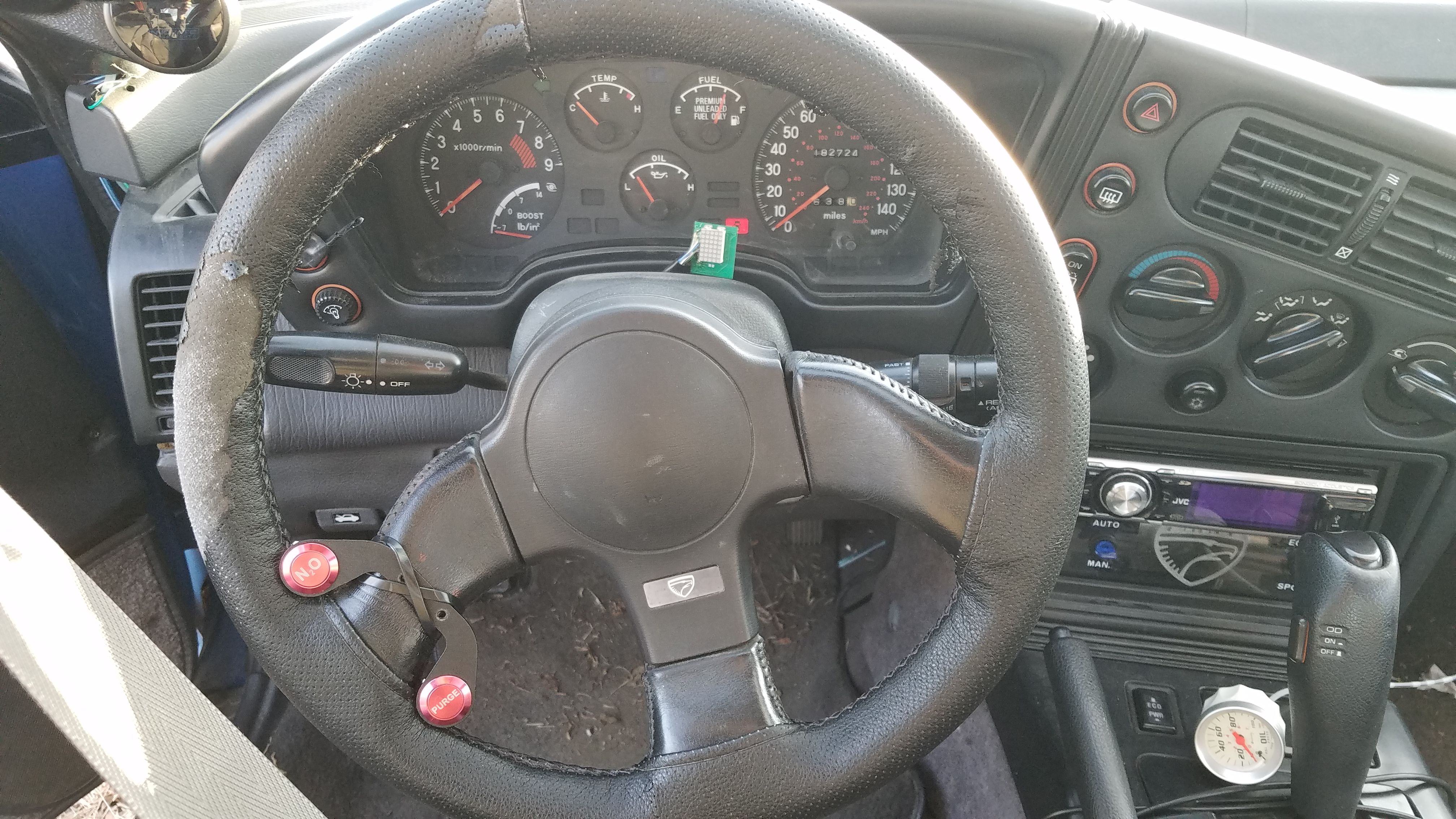

I have the NOS buttons semi-installed, they are solid at least. I rewired the FPS pigtail to run a relay activating the NOS for spoolup with a 75hp dry shot pill. Plans are to have it deactivate after a set amount of boost in 1st through LINK. I also have a override button for the NOS and a override button for "scramble" to open the boost up if needed.
I know, lots of tricky siht there but I love the car doing it all on its own AND ALL I NEED TO DO IS DRIVE HER.
Tune a a couple weeks on gas snd then on E85 for a FF tune and the car is "maybe" finished.

Boost and Wastegate override buttons are now ACTIVE and function as intended. :thumb:Hopefully fun times to come! :sneaky: :cool:
Thanks for following!!!
Marty

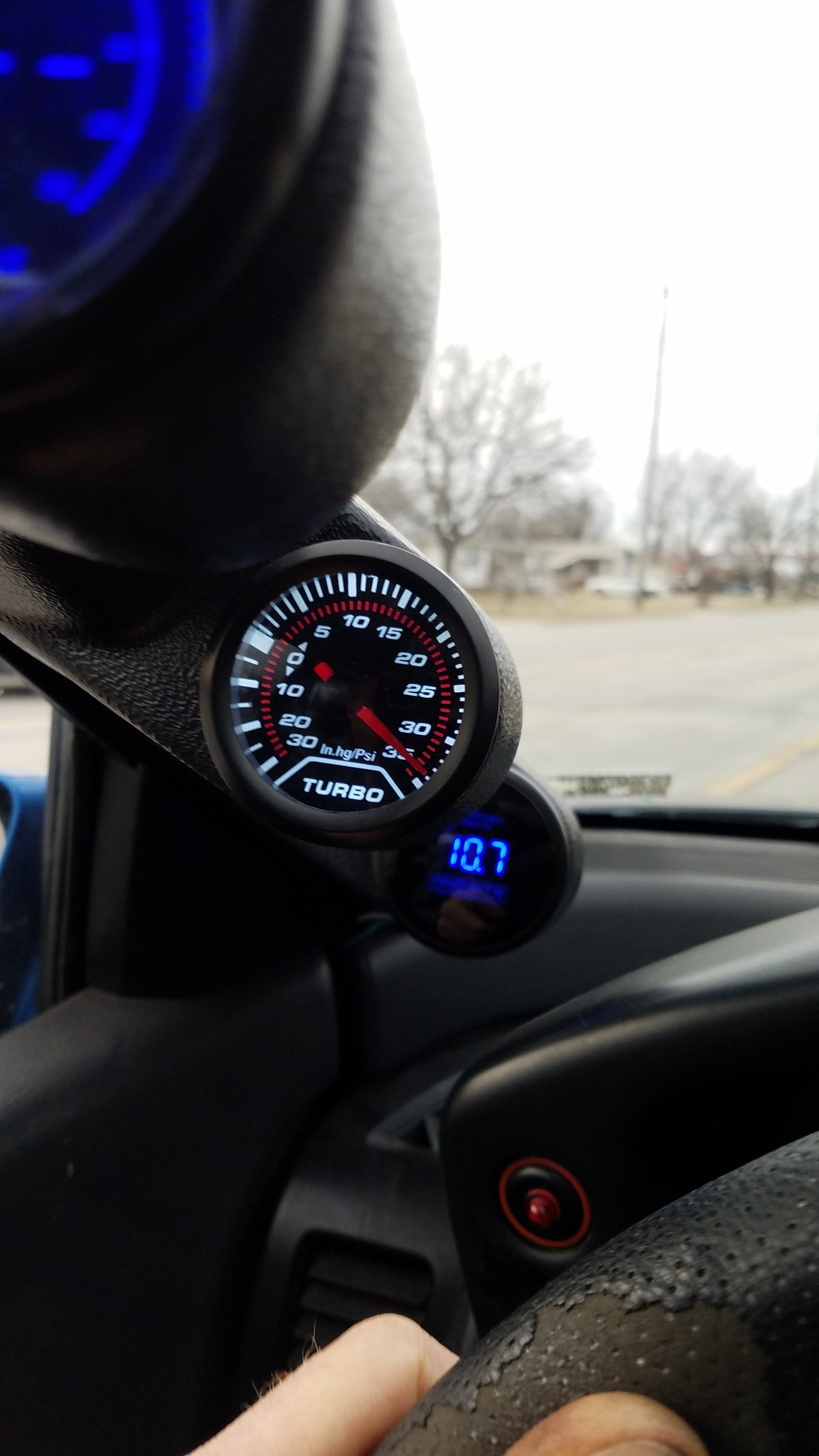

I'm still running that mechanical oil pressure gauge until she is tuned and then I will put an electronic one in the A pillar. Sorry for the "clutter". I have to many gadgets. ECU, TCU, N2O, EBC, FP SENDER, WB....I'm sure I'm missin somethin Sol....ROFL ROFL :cool:

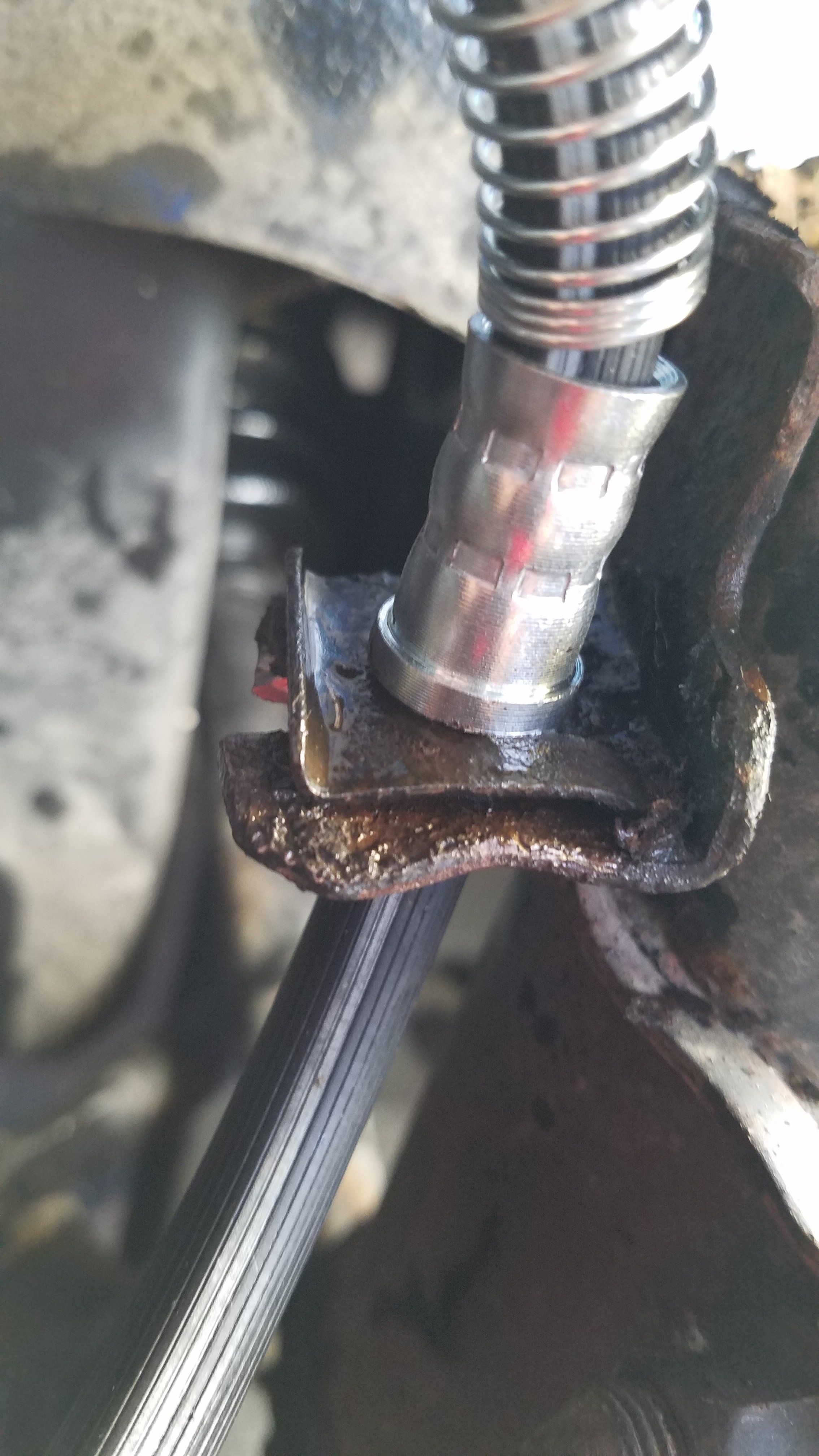

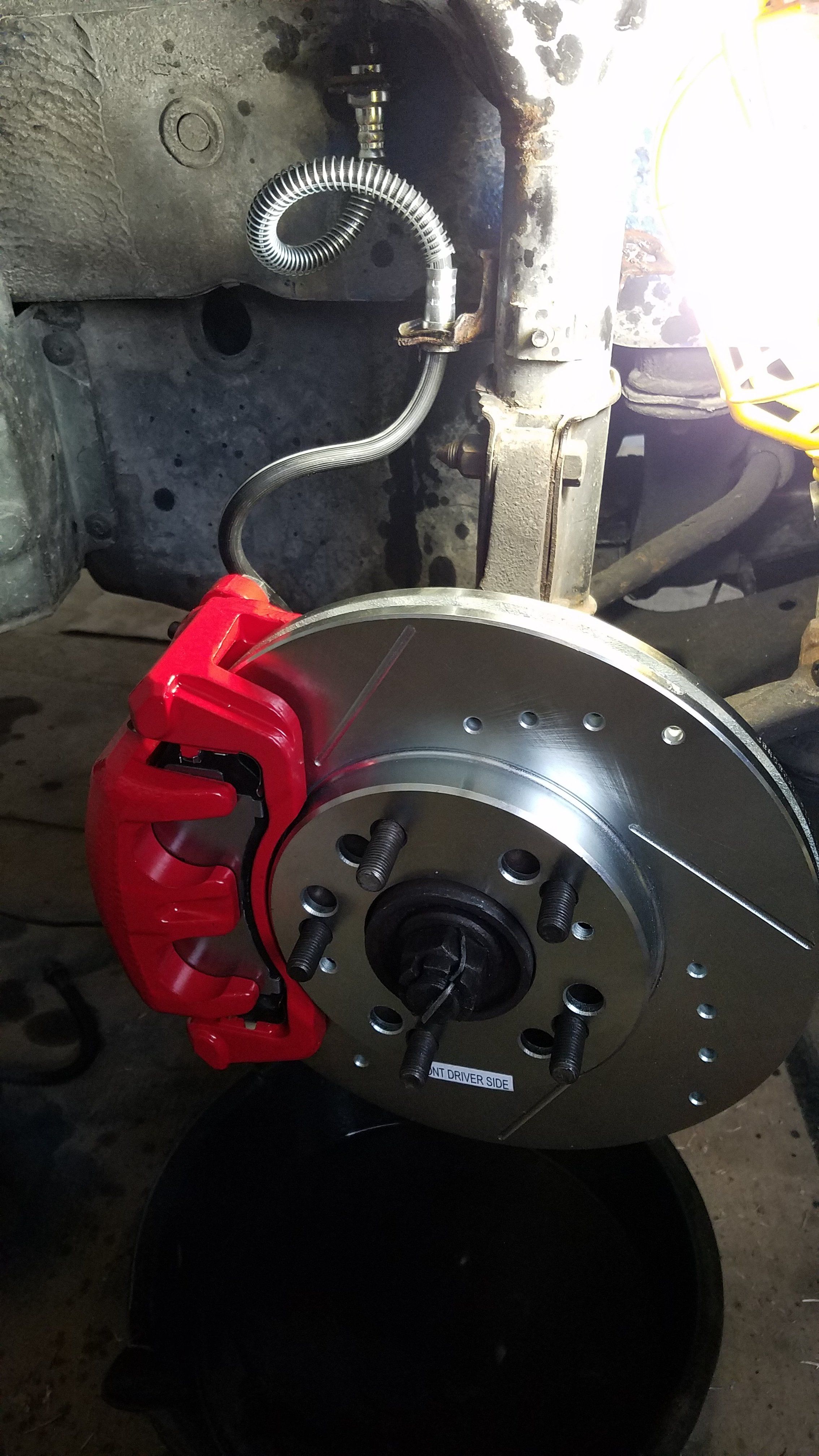

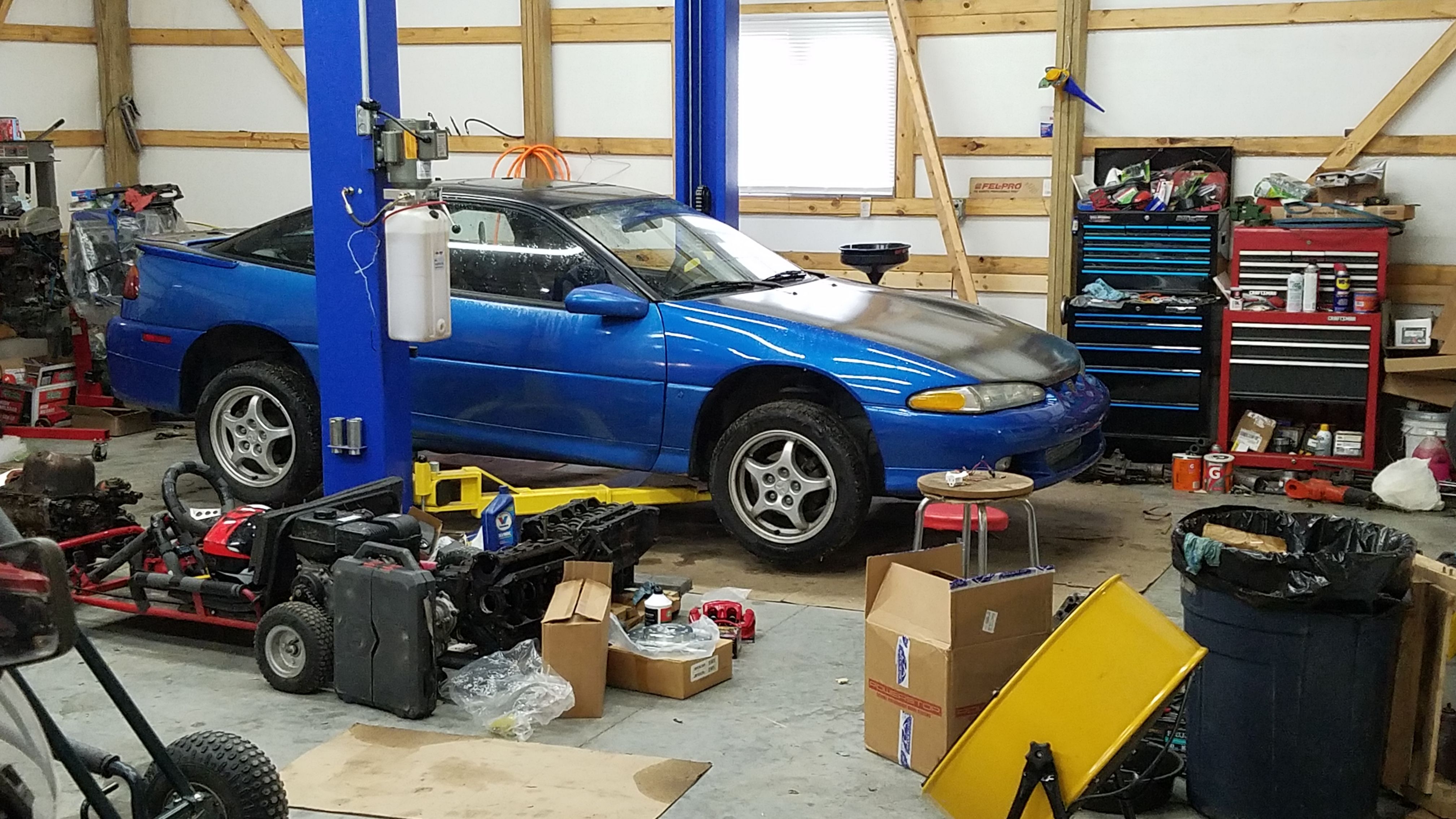

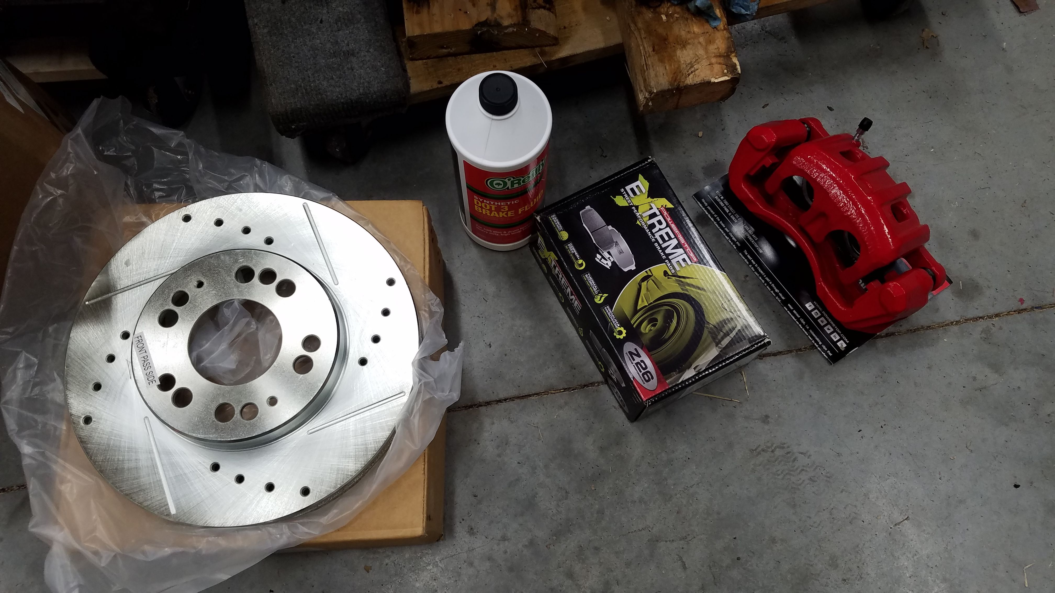

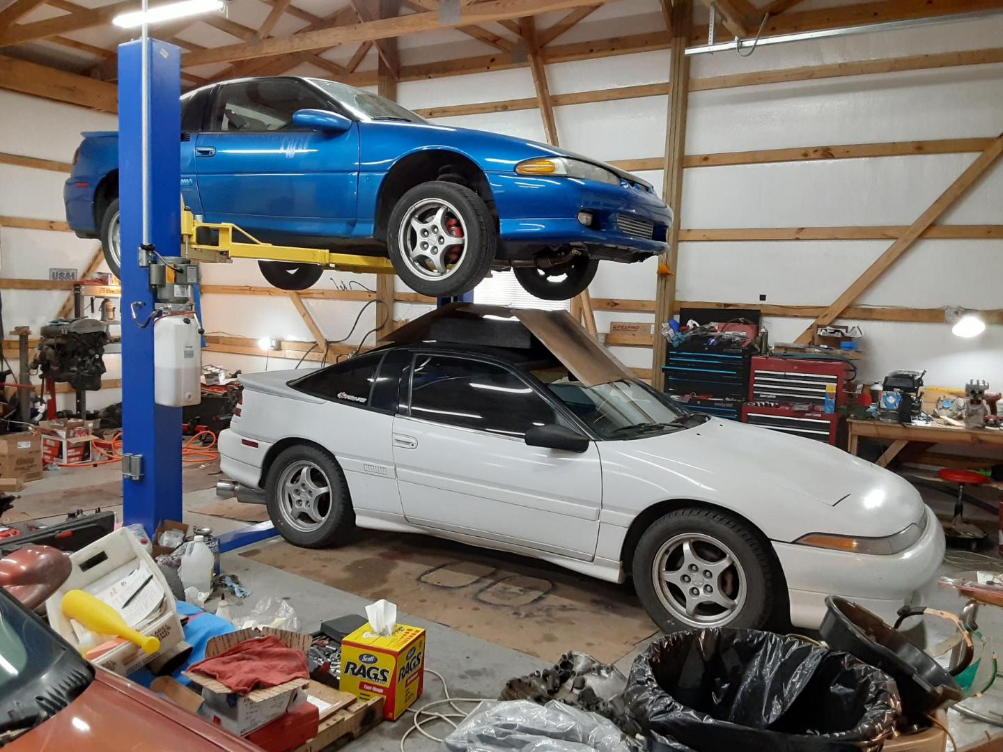

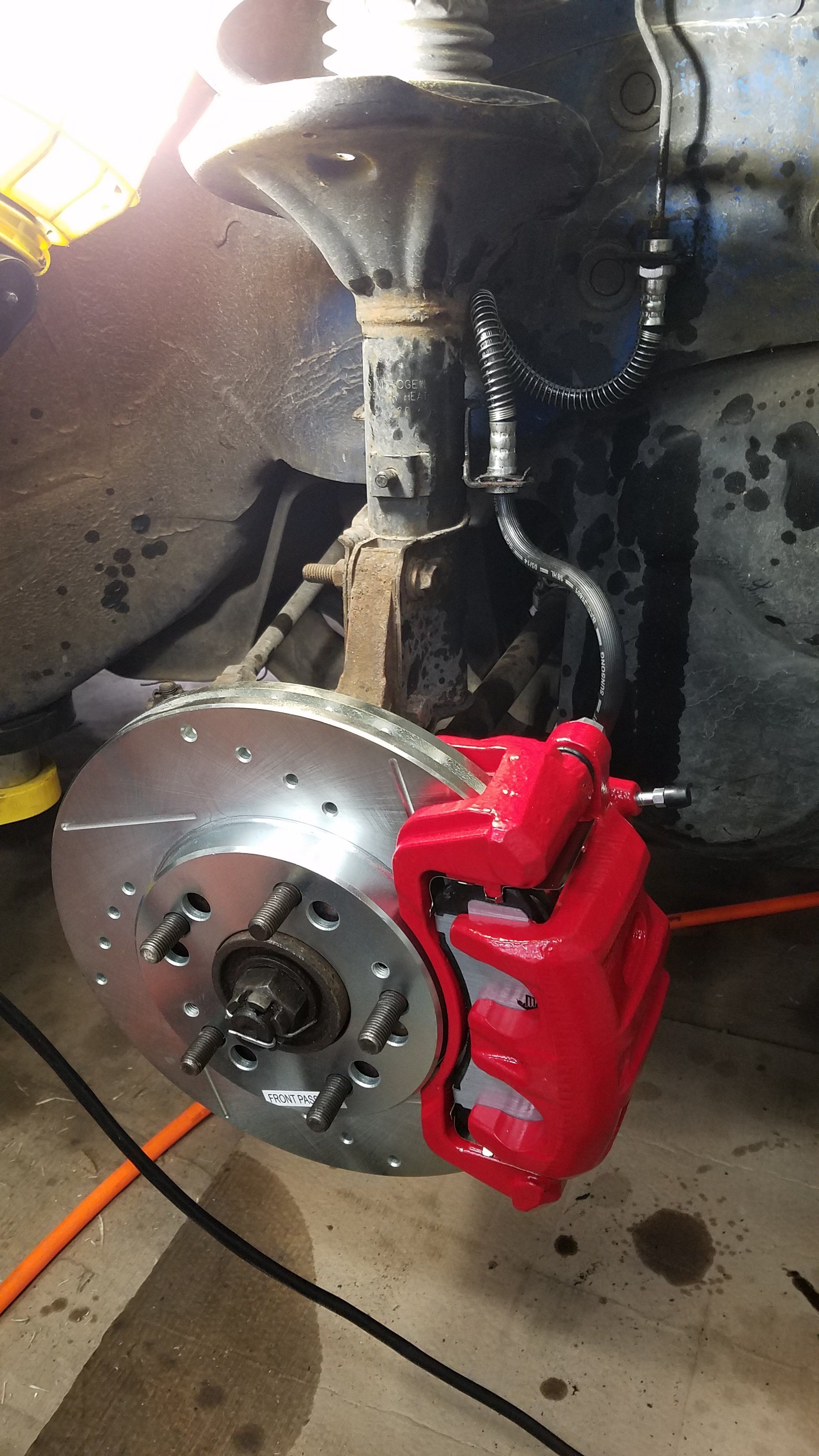

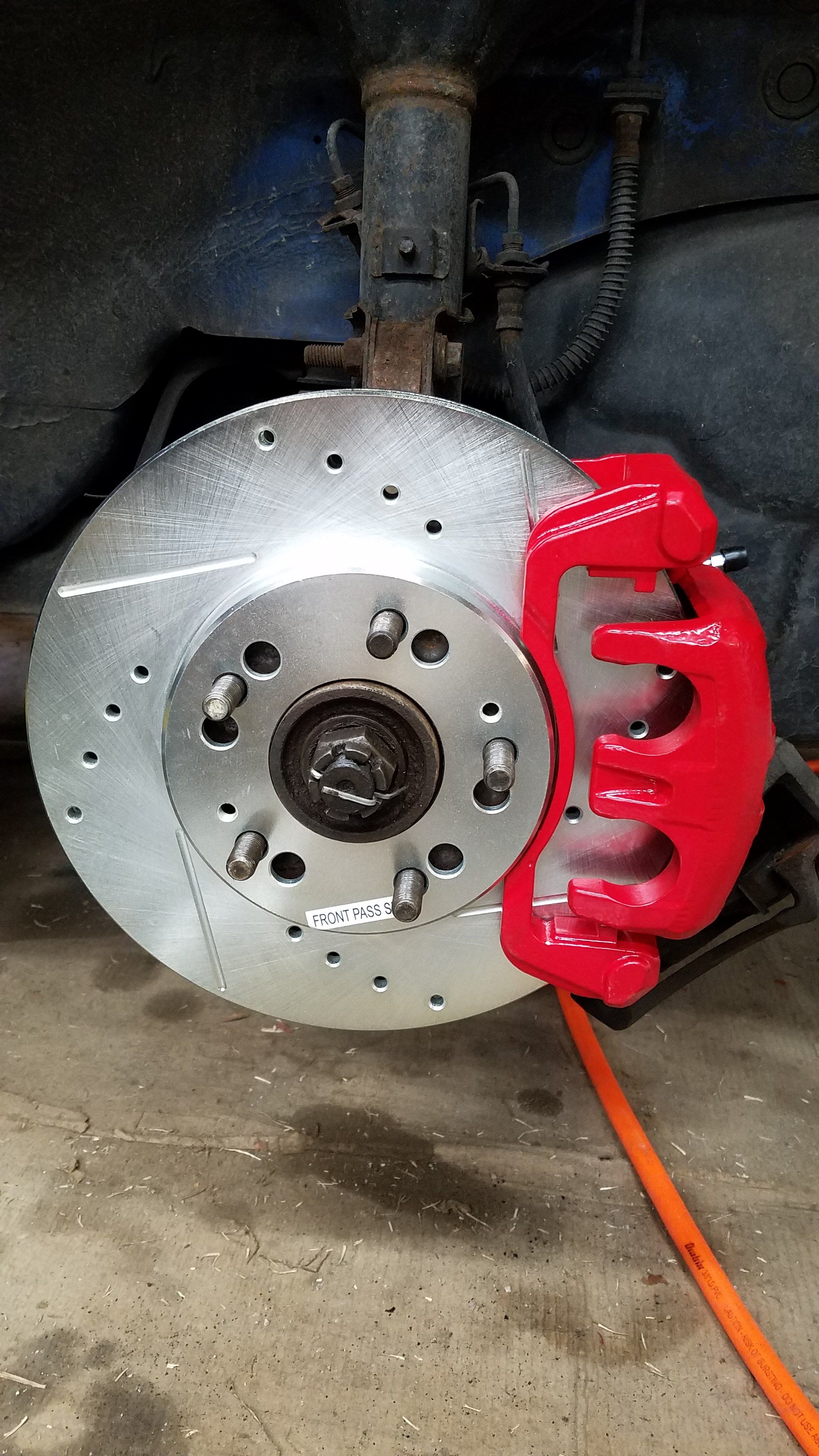

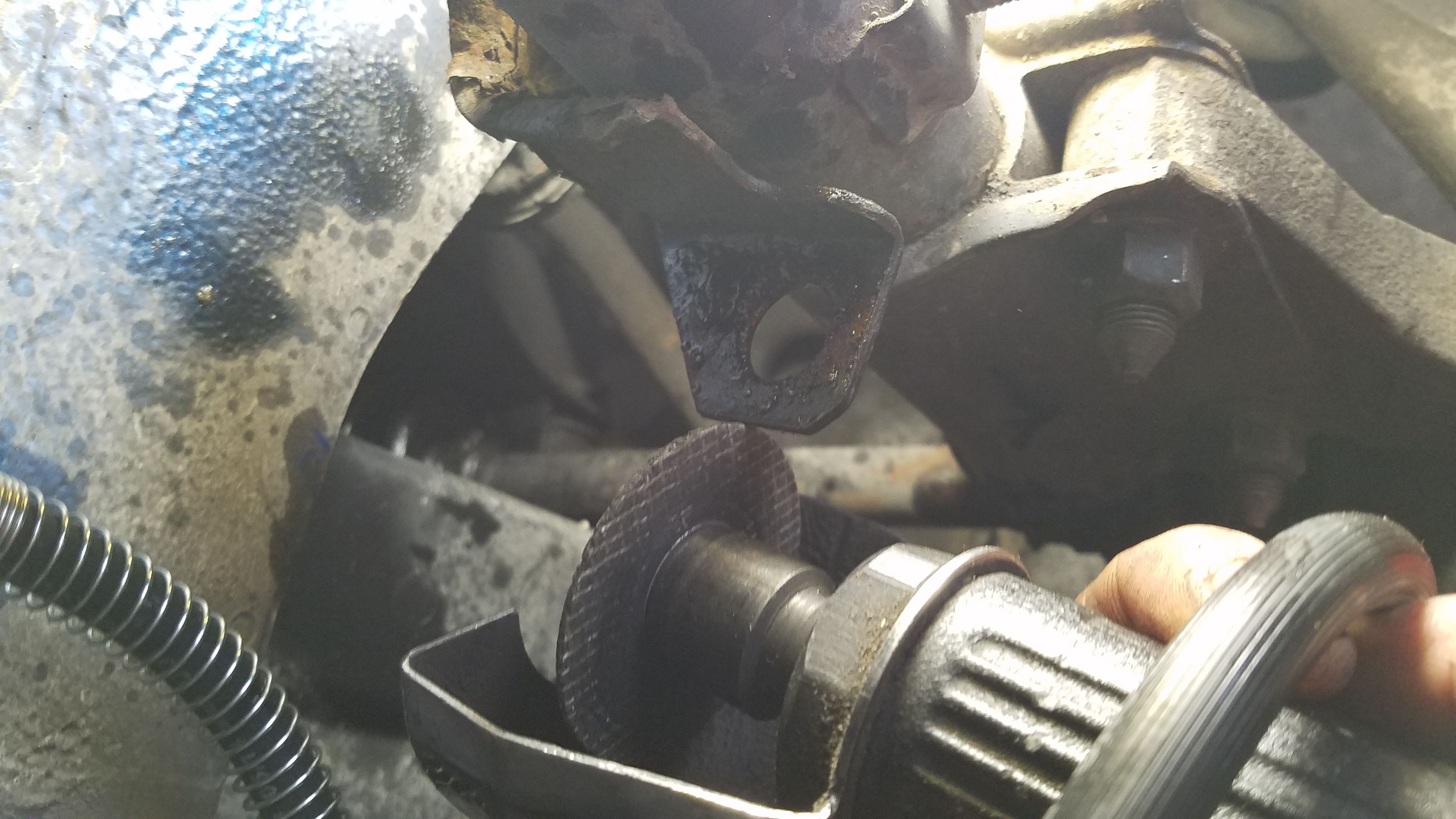

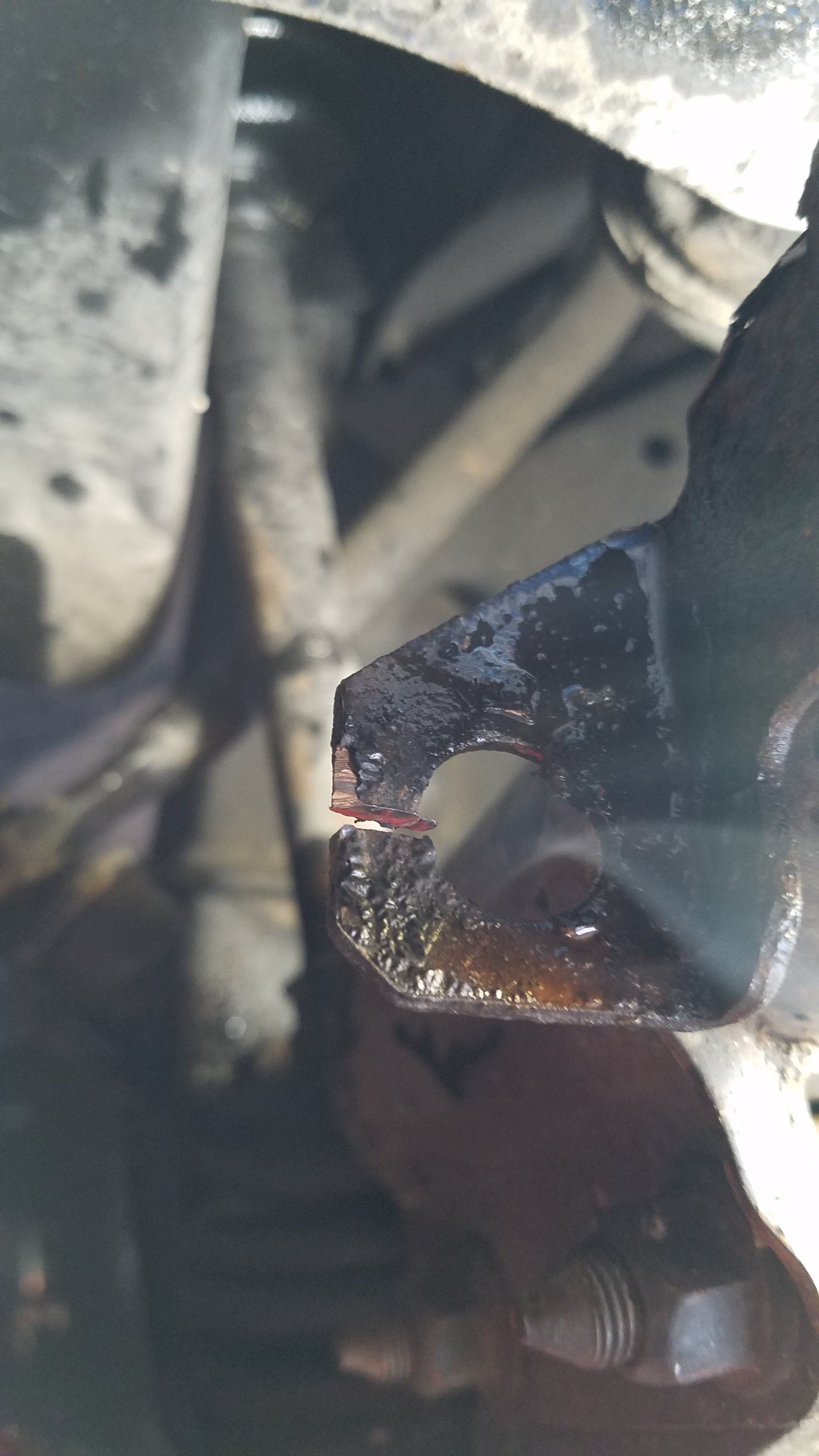

Since the car has picked up alot of speed, it was time to upgrade the binders. I had to order 2 2g front brake hoses and banjo bolts or this would have been about an hour long project....should be done by the weekend and she's clogging up my lift so gotta finish her up.
These are the PowerStop Z26 components. The next post should show the competed swap to the Dual piston/drilled and slotted setup.

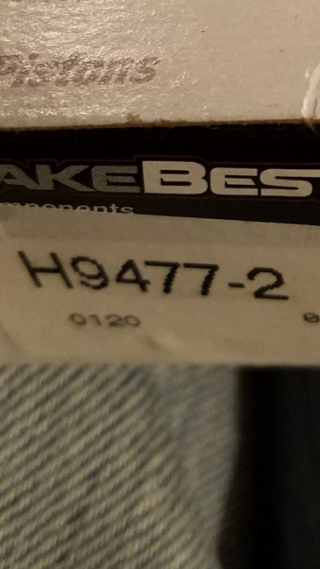

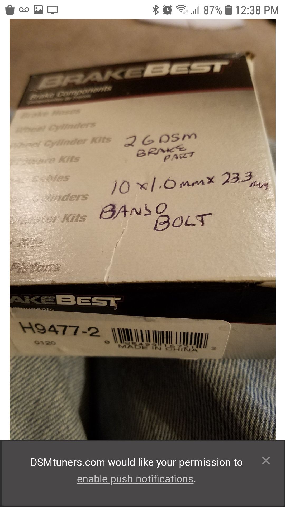

Because I've had several members ask WHICH banjo bolts i used, I added the part number/box from Oriellys that I used and they work perfect, BrakeBest #H9477-1. :thumb:
Marty

Knowbody has noticed the 2 7 bolt blocks on the dollies on the floor....yet...:cool:

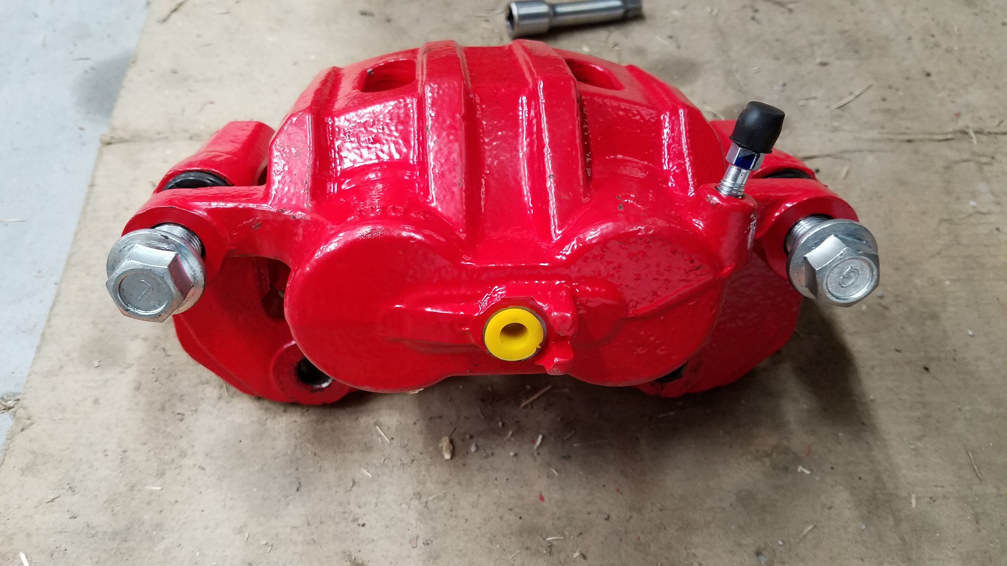

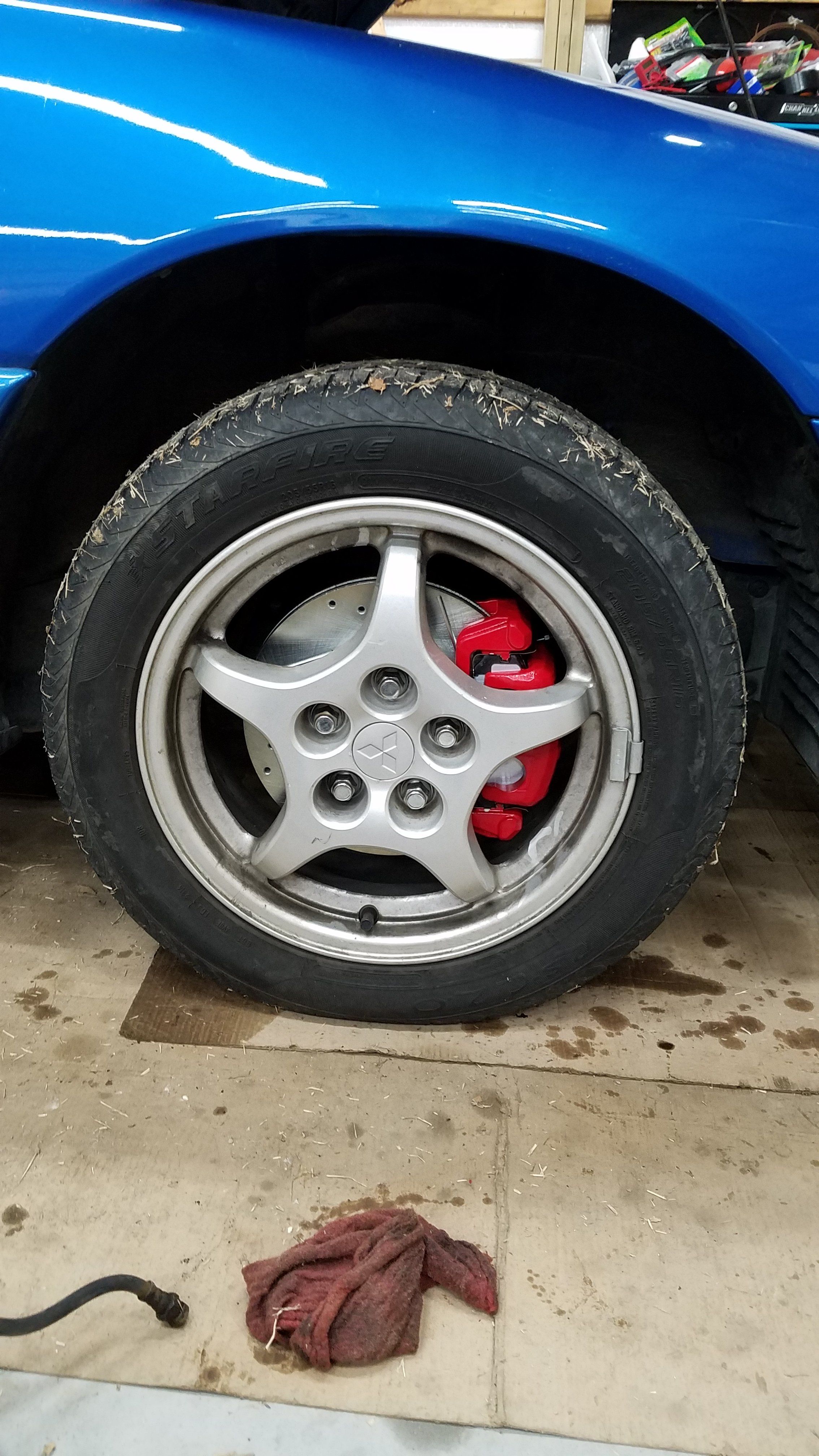

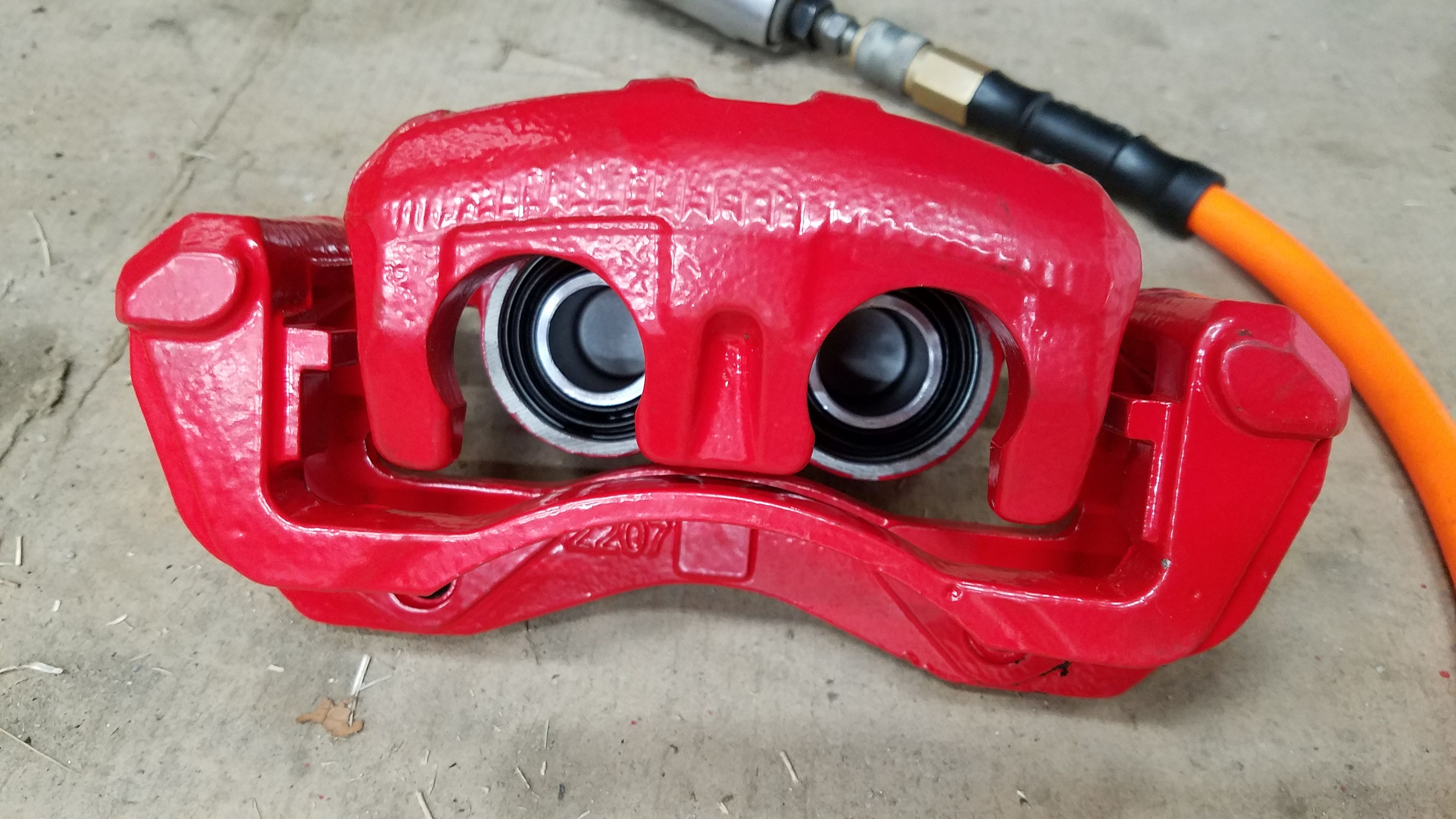

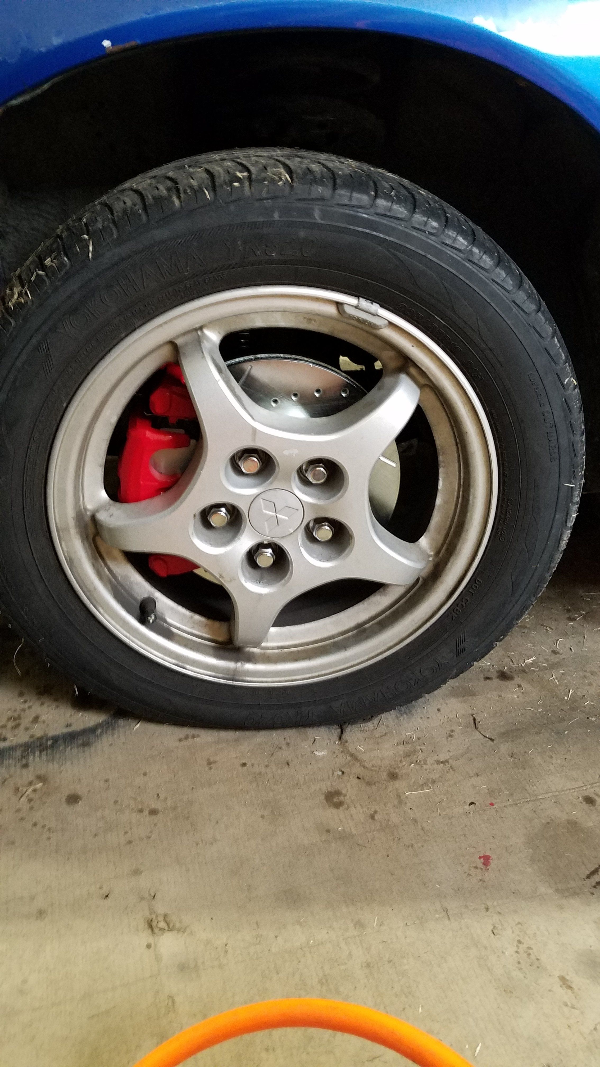

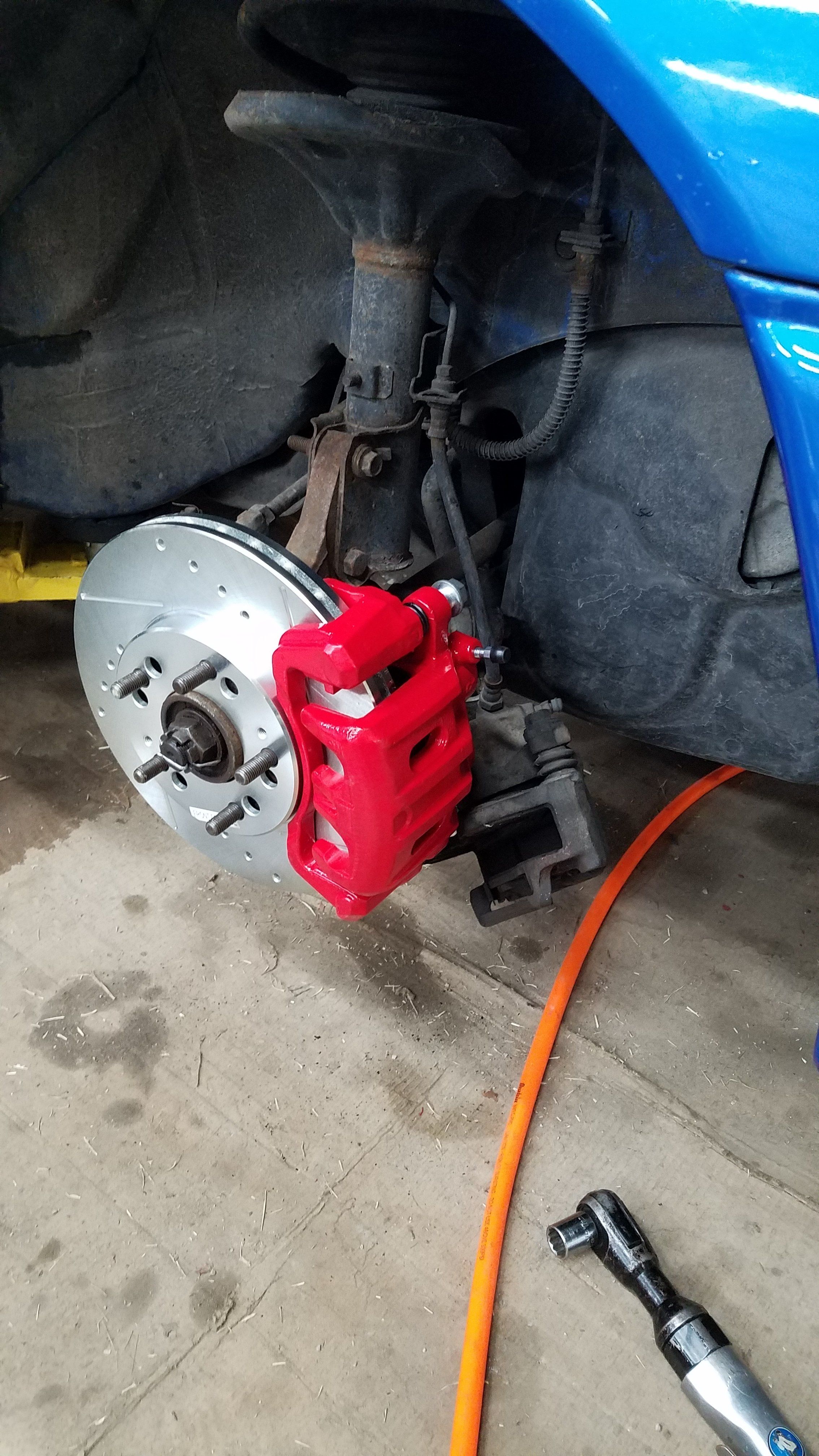

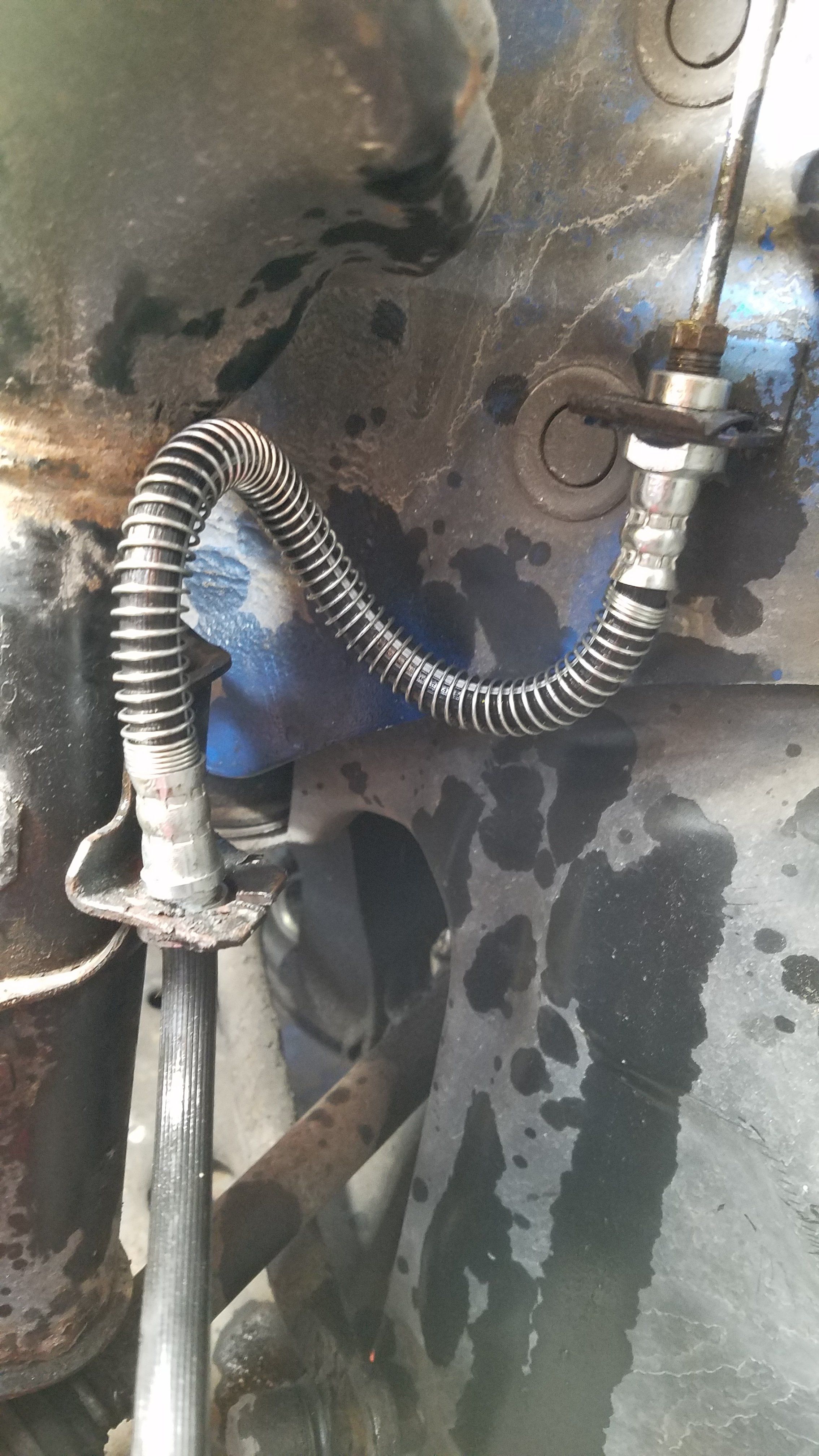

Alrighty, here's the new dual piston 2g calipers....yes they were ordered as 1994 calipers but I got banjo bolt fitting calipers so I think they are 2g by the looks. Anyway., a couple Oriellys banjo bolts and customized hose hold stays and we are IN business!
Here they are. If you have any questions about the hose hold downs just ask, it was pretty simple.
Marty

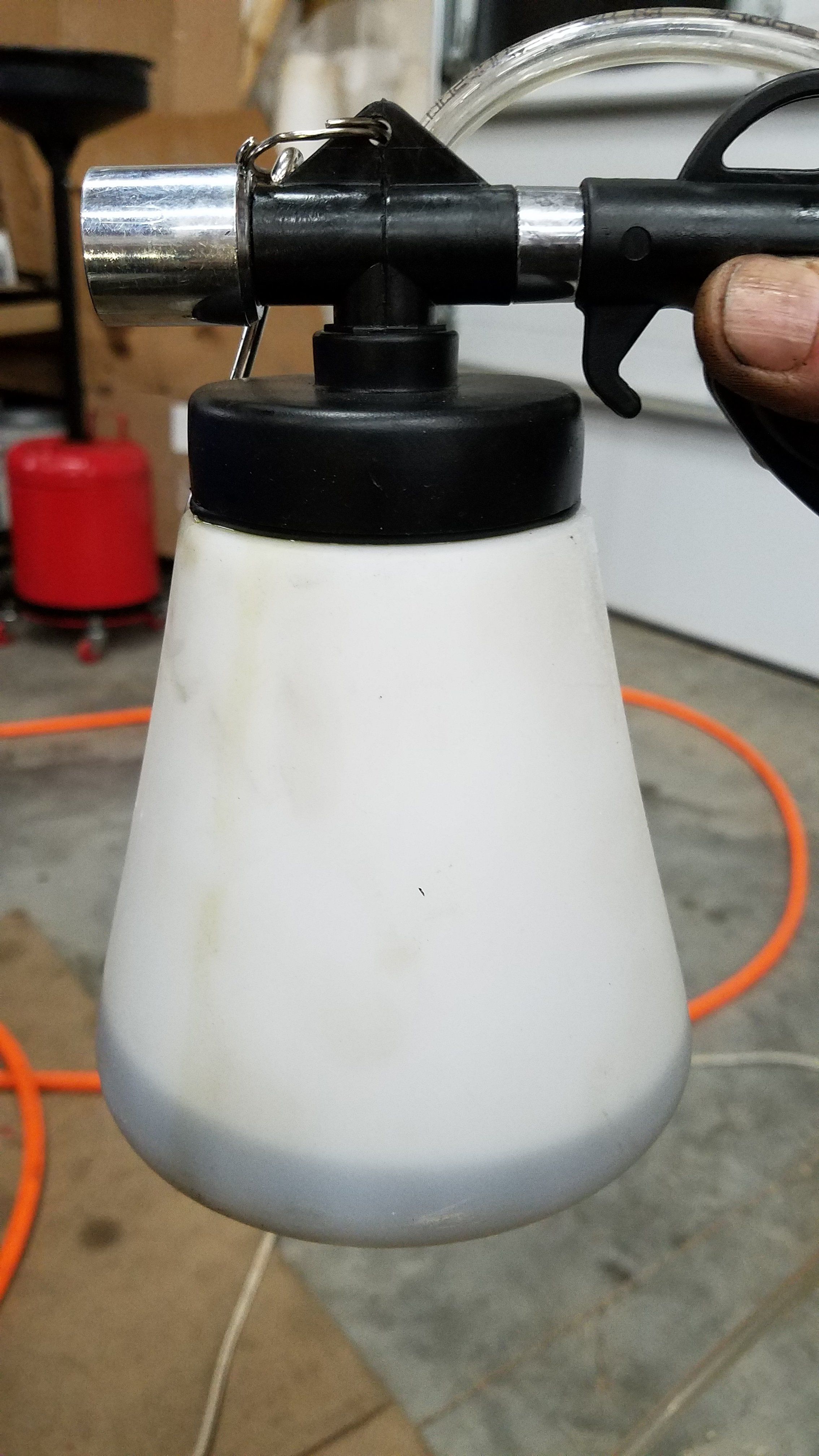

Oh yeah, just went to get groceries in her as a test after using the 1 man power bleeder!
